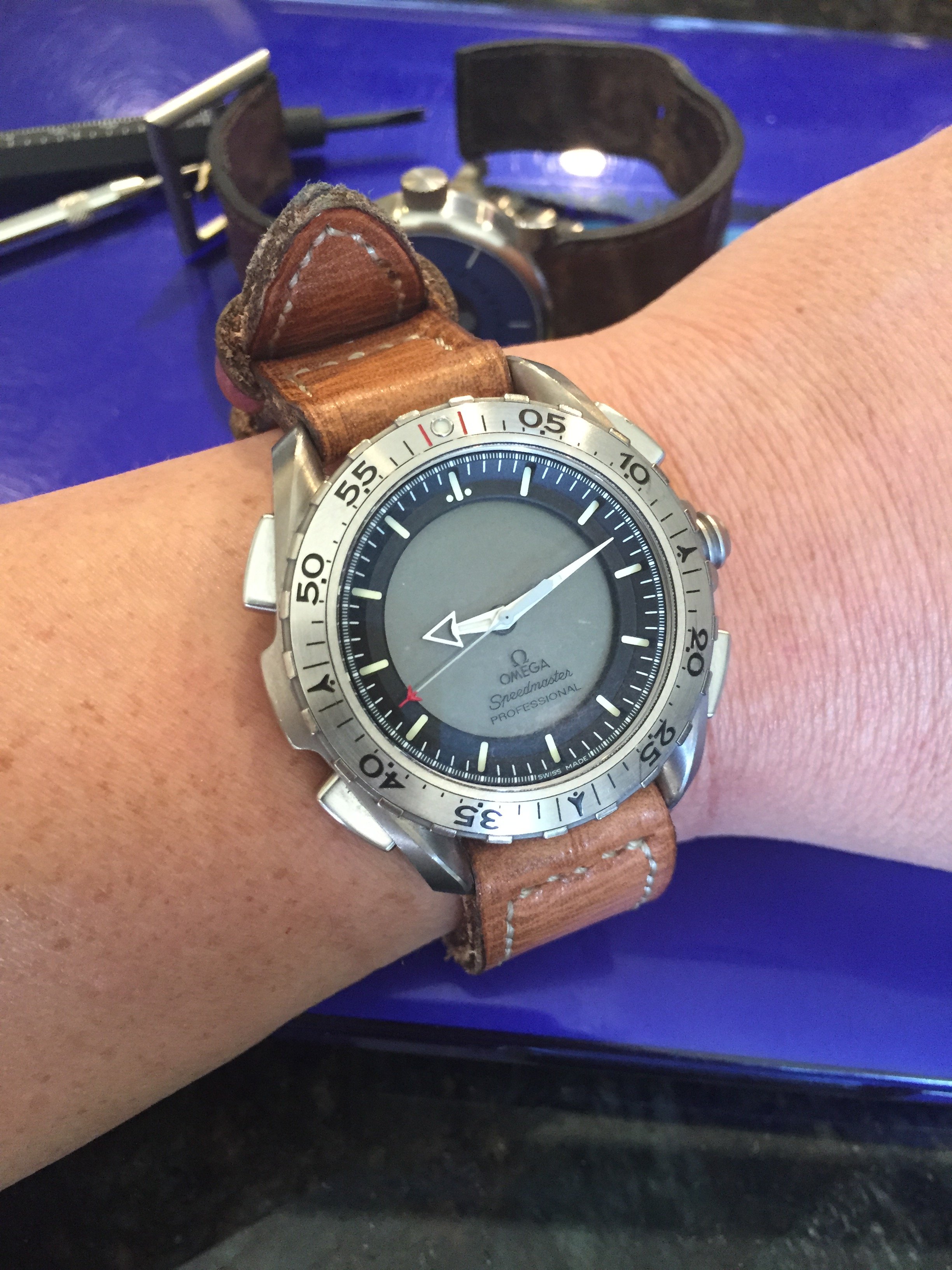

Dear all,
I had a chance to hold a X33 gen 1 and noticed that the pusher for the backlight, located at 7h, would not feel as a regular "Casio" pusher but would rather feel as a mechanical chronograph button: when you press it nothing happens until you press it a little bit further and make it "clic" to activate the light. Didn't test the other pushers but I was wondering if this is the correct behaviour. Seems like a way of preventing it from being activated accidentally.
Thanks

all of the pushers on mine behave this way. The travel isn't that much that I would expect to be a design feature.....but happy for someone who knows this for sure to chime in.
and a gratuitous pic
