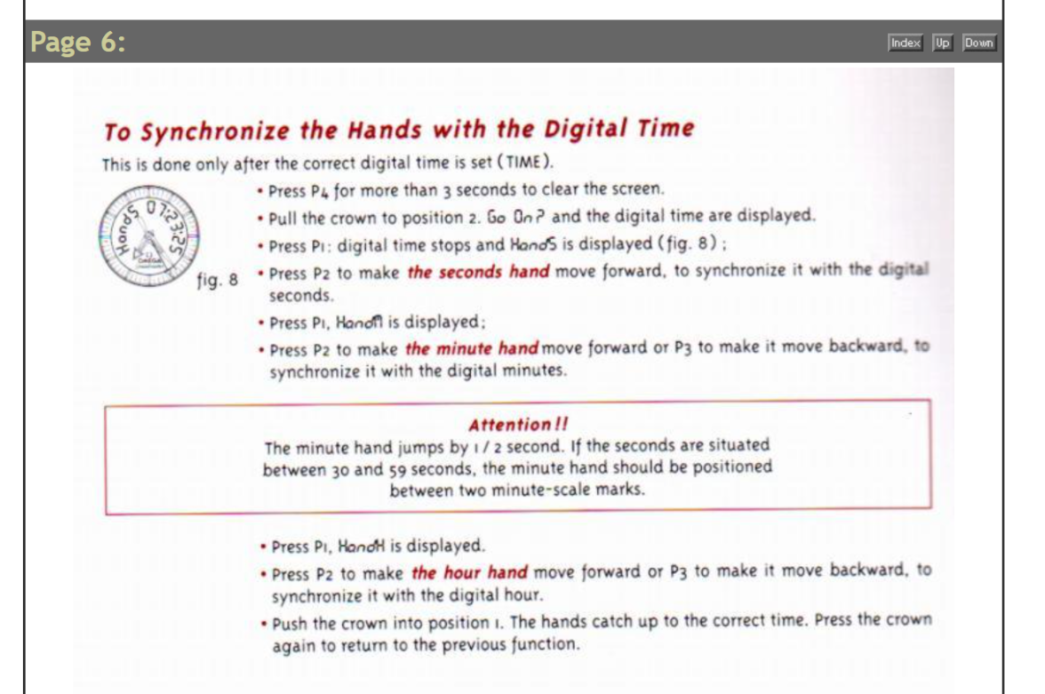

The hands will not sync with the LCD
Wait, have you tried the time resynchronization? Or have you tried it and it's not working?
Mine went out of sync like this out of the blue. I did this and the issue has never re-occurred.

As for the X-33 I was going to suggest the time sync procedure too, it's certainly worth trying since you don't mention other problems with your watch.
