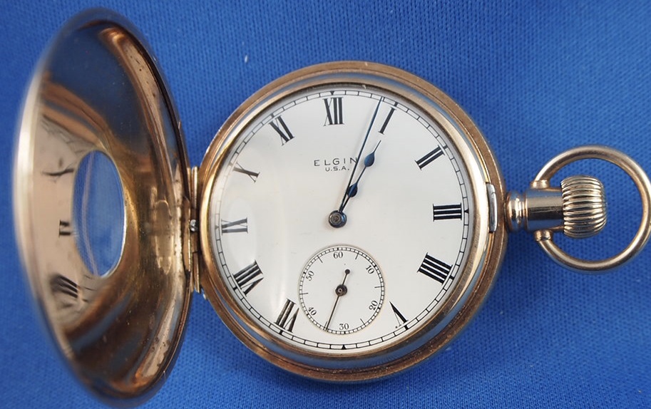

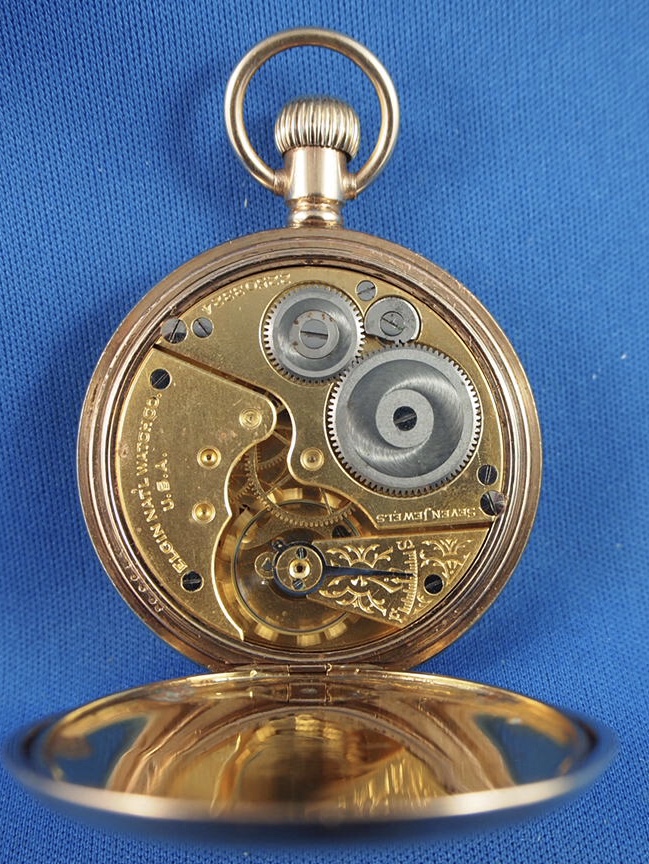

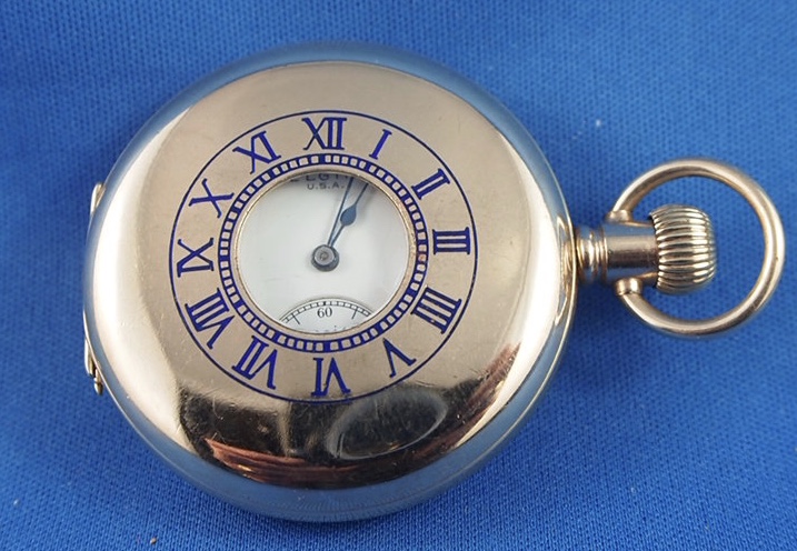

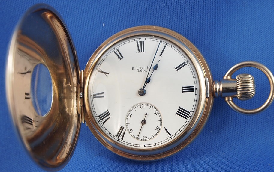

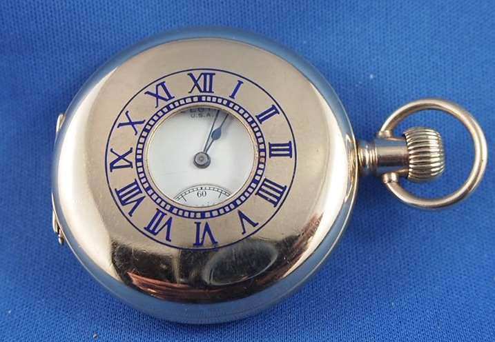

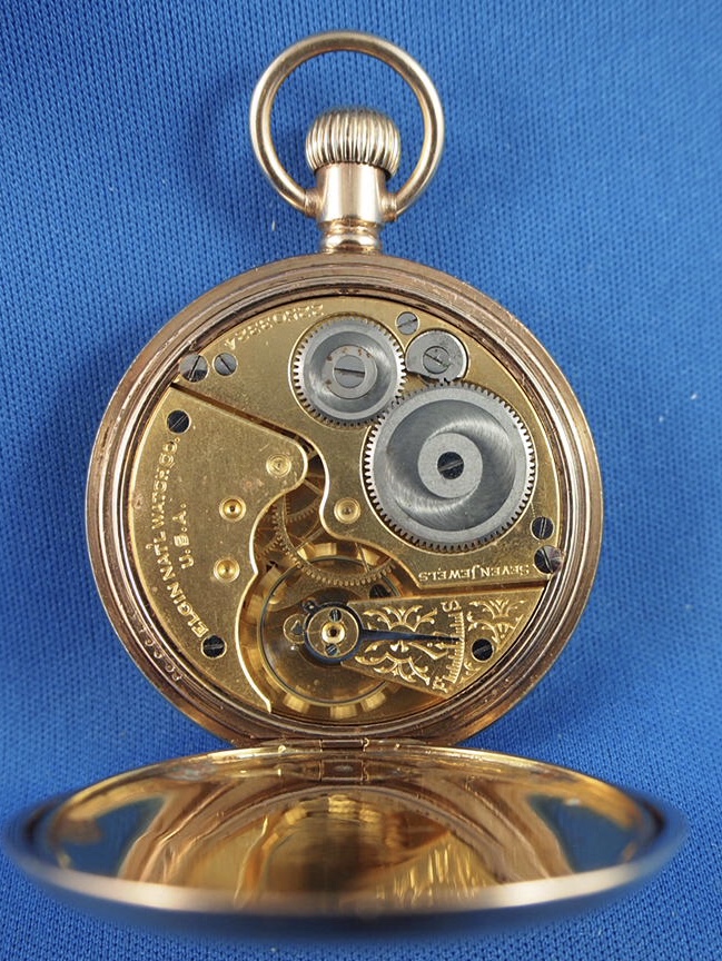

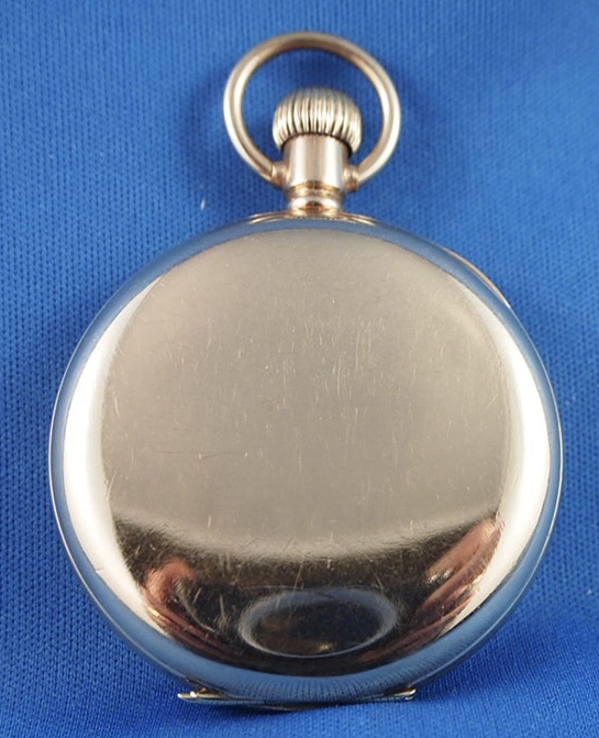

About 20 years ago, a fellow brought me the subject watch for an estimate for repair. The movement is only a 7-jewel model. When I quote on a 7 jewel watch, I quote a higher price than I do for watches with 15, 17, 19 jewels, or more. I usually have to contend with worn bearings on 7-jewel models. He declined the repair, and never picked it up! I took a look at it on Sunday, and decided it had possibilities. I’m sure it hasn’t been worked on after it left Elgin in 1919, or so. It had likely been lubed with whale oil! I could not believe how it was gummed up. It was difficult to take the movement apart. I had to peg the bearings, scrub it with Mr. Clean solution and water, rinse it, dry it thoroughly, and clean it again, in L & R Extra Fine cleaner. Even at that, I had to glass brush the congealed oil off the bearings, and re-clean it. Turned out nice!

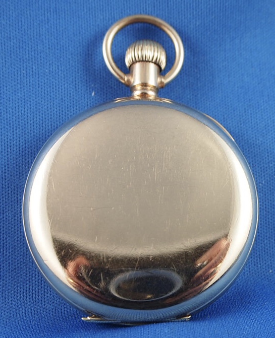

The case is a 10 year gold filled case. The style is called a Demi hunter (half hunter), and the numerals are translucent blue vitreous enamel. The enamel is not damaged, and that is unusual! The movement is Elgin. The inner cuvette indicates it was a presentation to the secretary of a union in Newtownards, County Cork, Ireland, in 1920. The hour hand is a “double spade” style, typical of a Demi-hunter, allowing the time to be read without opening the front cover.
Well, it has been returned to the family of the original owner. The watch was presented on September 27, 1920, as an award. The inner cuvette was engraved with all the details, and his name. He never used it. It was left to his son, same name, and he never used it. He, in turn, left it to his son, same name, and he never used it. To day, the great grandson of the original owner picked it up after I serviced it. He has the same name as the three previous owners! The third generation owner is now deceased. It is now in the hands of the fourth generation. The watch is now back in the original owner’s family, 6 days short of the original presentation date, 101 years ago. And to think that the watch was brought to me for repair decades ago, and the (then) owner declined the estimate, and never picked it up! I could have added it to my collection, and the family would have been none the wiser. Strangely, I feel good about letting it go!
Had you reached out to them or did someone happen to remember that the watch was with you for the last 20 years!?
15,996
48,111
I was rummaging in a box of orphan watches. Many of which were abandoned by their owners when they got the estimate for repair. That is where I stumbled on this one. Abandoned by the owner. It was still in the original repair bag with phone number. I slid it out of the bag and took another look at it. I decided it had potential. I spent about 5 hours working on it, ten days ago. What I uncovered was the watch you likely saw in the images. I checked the engraving on the cuvette, and discovered the initial and last name was the same as the guy who brought it to me. And a presentation date of Sept. 27, 1920 (101 years ago). I was torn. Do I keep it as my own, or do I try to contact the family. I did a reverse search on the phone number, and found the name was the same. I phoned the number, and a lady answered. I asked for her husband, and was told he died years ago. I told her who I was, and why I was calling. The watch belonged to her late husband’s grandfather, and I told her that for the price of the repair I had just finished (as per the original quote), the watch would be returned if the family wanted it. I sent her pictures. This all happened five days ago. Her son (fourth generation, and same name as his great grandfather, his grandfather, and his father) picked it up today! In six days, it is the 101st anniversary of the presentation in 1920. The family is overjoyed (and I feel good having done it!)

The fellow who picked it up today is the eldest of two sons of the deceased chap. It is tradition in that family that the eldest son is always named after the original owner of the watch. He, his father, grandfather and great grandfather all named the same. I spent about an hour with him today, giving him all the information he’ll need re: enjoying the watch, and the warnings about the DOs and the DONTs, I also sold him a treasure dome to keep it in when not in use. I asked if he had a 3-piece suit. He has one! I told him I bet he’ll wear that suit on Sunday! Yeah! I’d like to be there too, when the family gathers! (I also gave him a Waldemar pocket watch chain so he can wear it safely.)

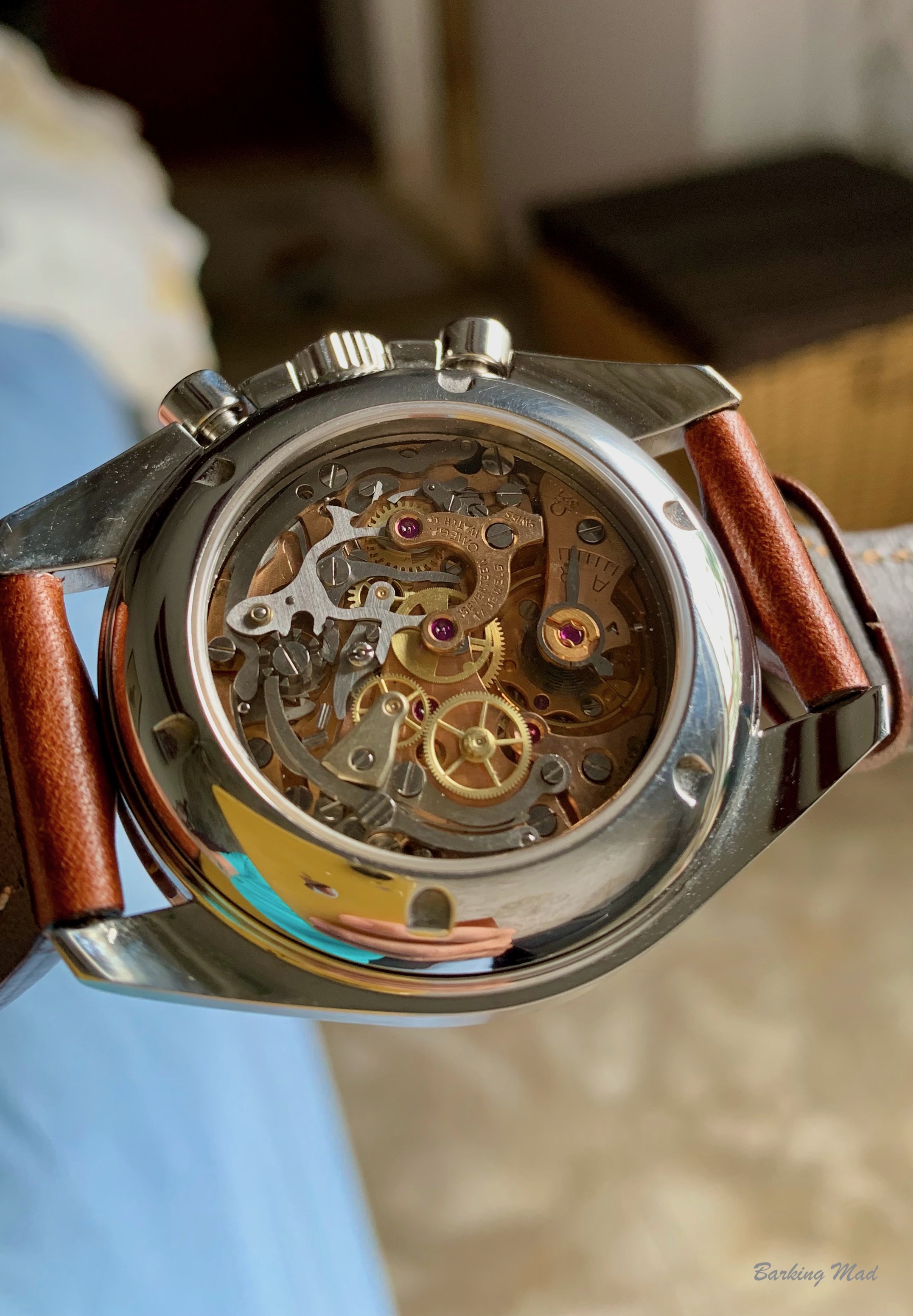

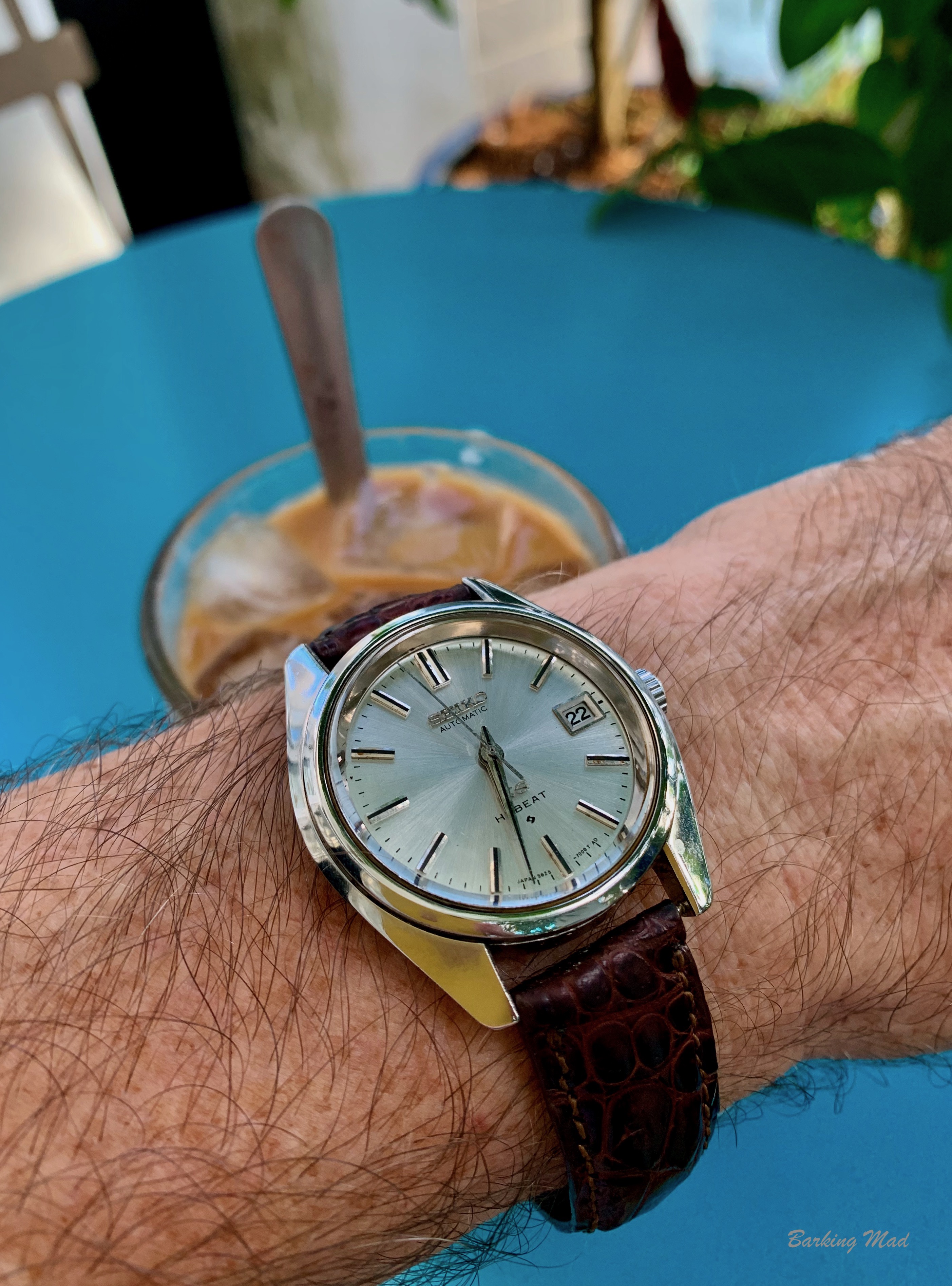

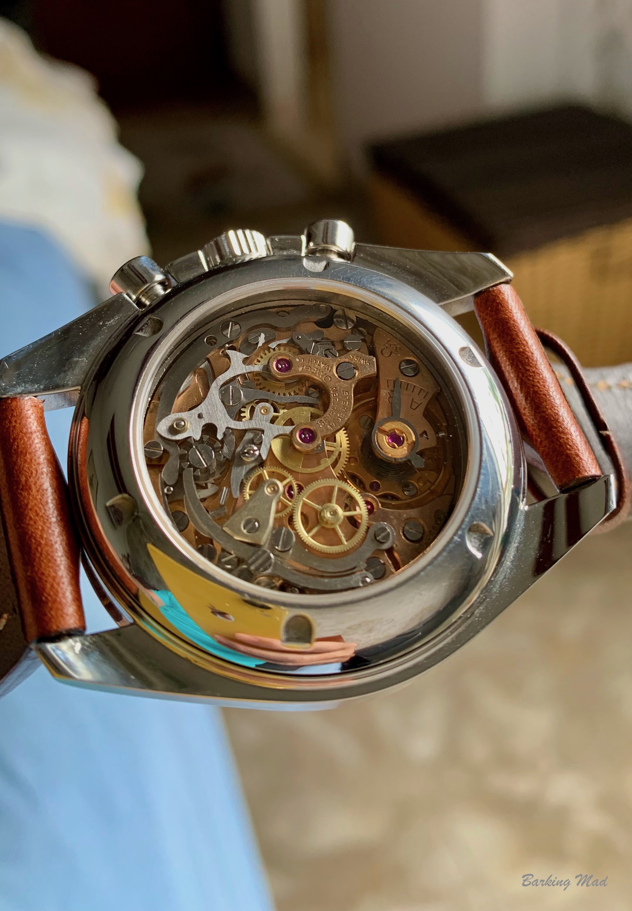

Bit of chatter about display backs lately and being one to oblige where possible, the beast that ticks within😀

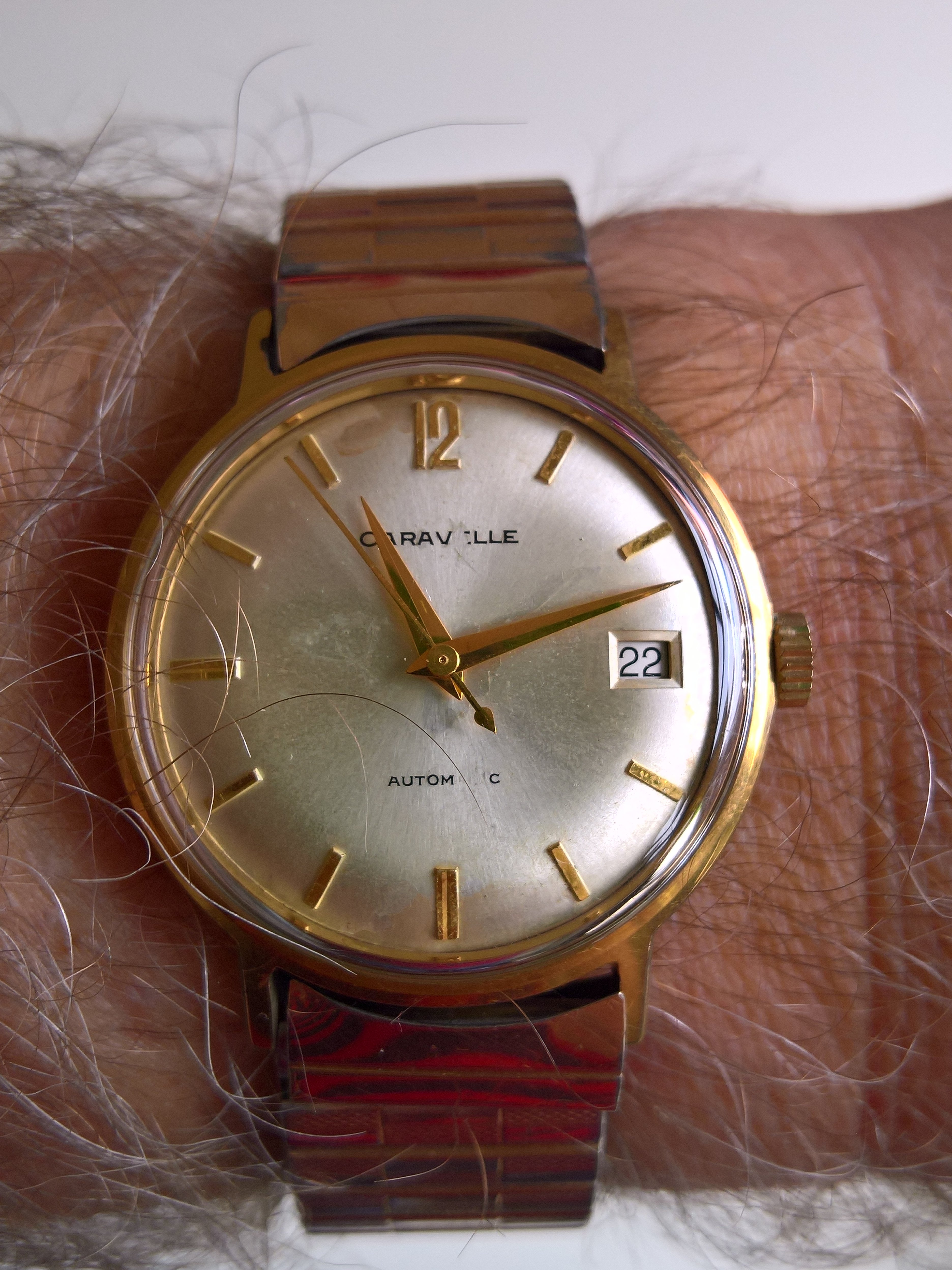

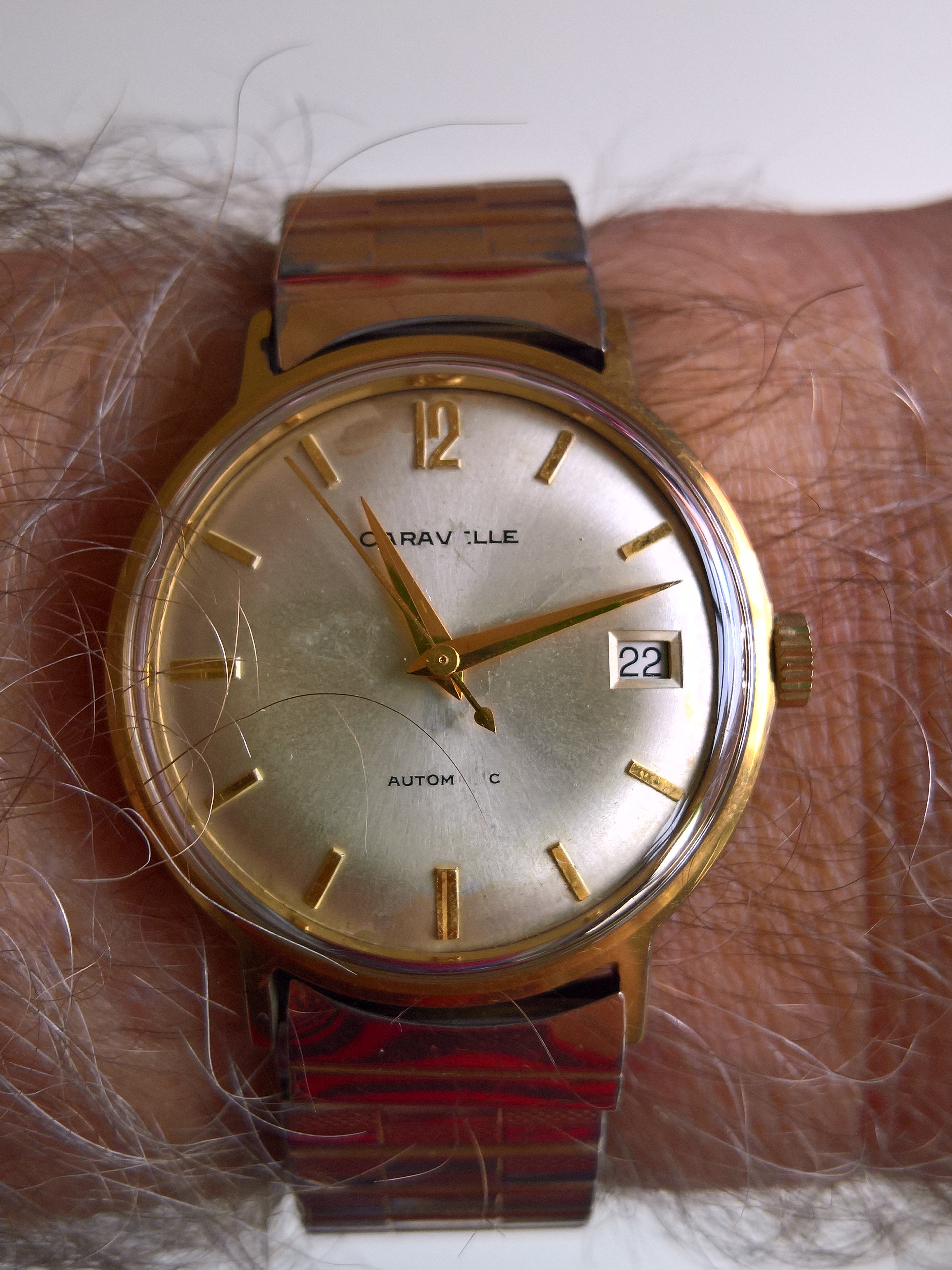

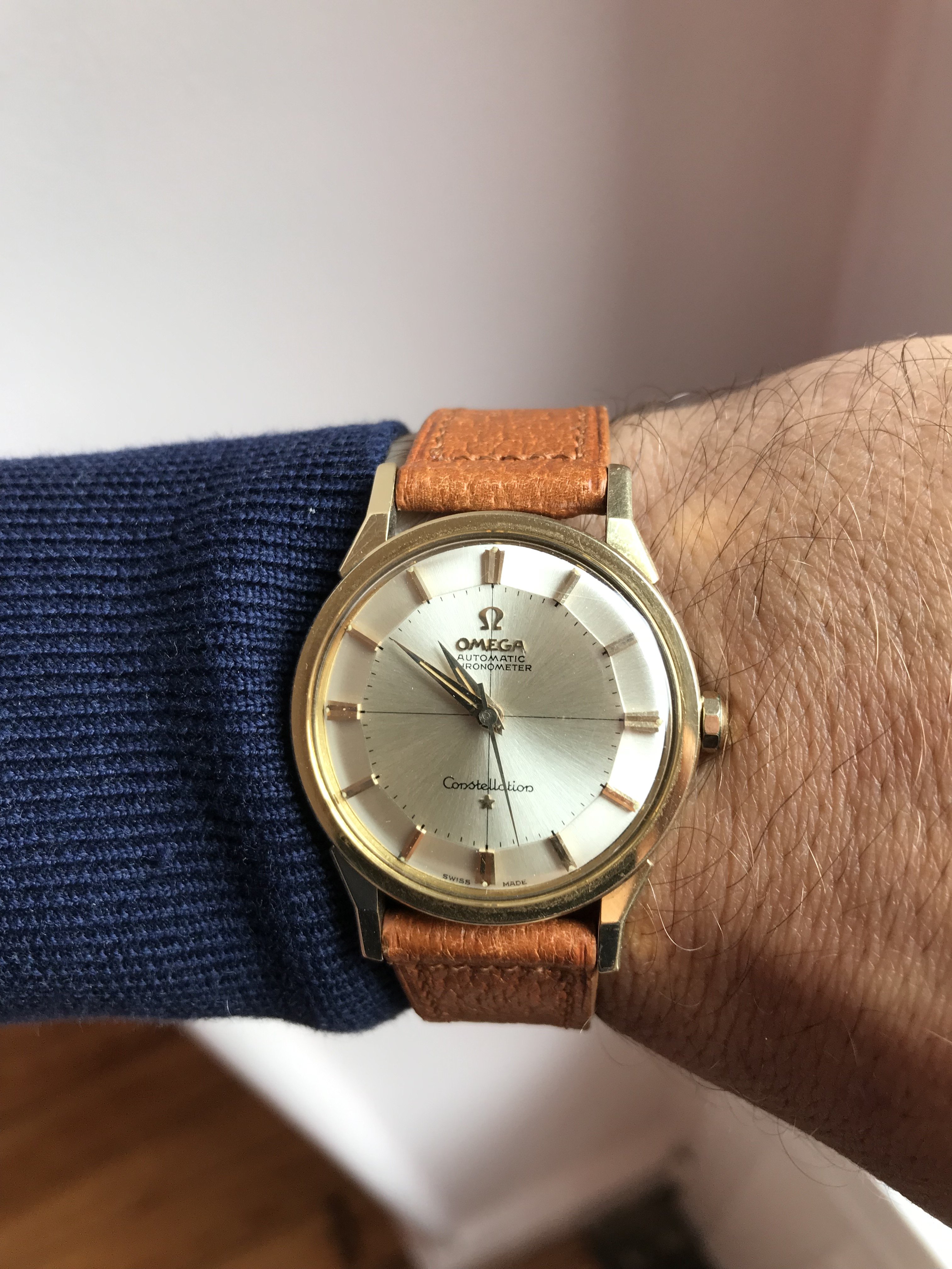

This just back from my WM. Been back twice with the watch gaining 5 minutes a day but now resolved problems with the hairspring and other minor work around the balance wheel, took a few weeks for him to sort so far more love than economics went into this.
Couldnt wait to try it on my wrist hence no strap, still have to decide what I will fit to it but had to see what it looked like on my wrist with my newly knitted mohair Jersey that my wife has just finished for me.
The jersey has a much longer story than the watch, with my previous wife starting to knit it about 25 years ago but never completed.
Completion required unpulling the 3/4 made jersey as apparently I have grown in dimensions since the mid 90's? who would have thought 🙄 but all solved now my 25 year old jersey is complete! and seems to match wonderfully with the new to me Caravelle. ::psy::
