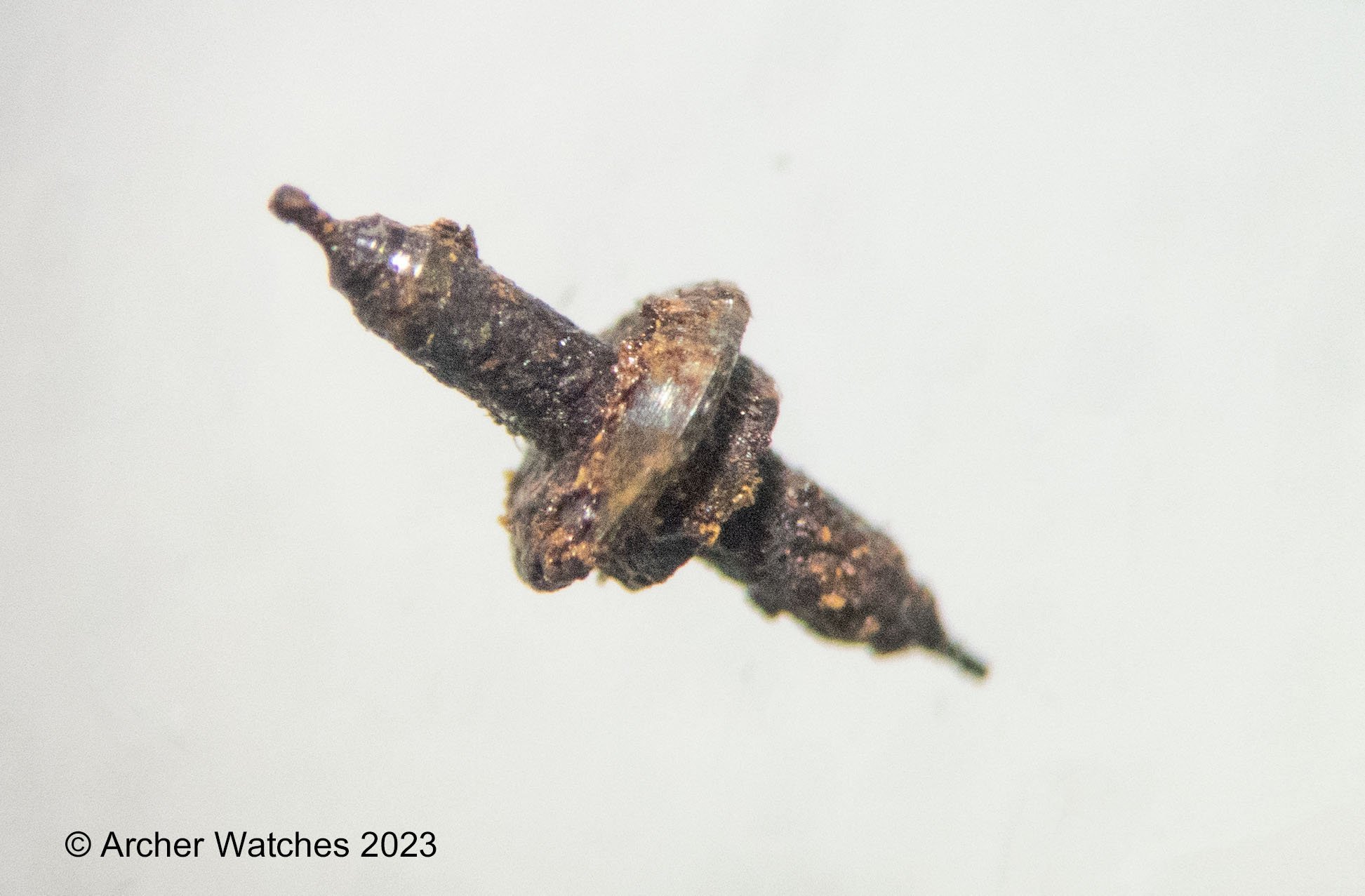

Not necessarily. Omega charges a flat rate, whereas many independent watchmakers will charge in an a la carte way, depending on what parts are needed. When you buy a second-hand watch to wear in the water, I would think that the cost of a full service would be part of the calculation. If that additional cost makes the watch more expensive than you wanted, then you should probably just flip it and buy a different watch as a beater. There are plenty of dive watches you can buy pre-owned for about $1000, add a service, and your total will be well under what you paid for the Seamaster.

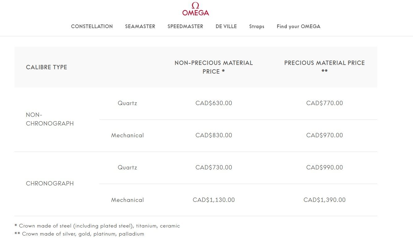

Just got off the phone with Omega and they are actually quoting $700($800 if they consider the 18K WG bezel a "precious metal" watch, which I hope not!) for full service and $300 for just waterproof service so still looking for local quotes if anyone is near Cleveland. Going on the Honeymoon mid August so a local guy just for time would be great. Omega is saying 5-6 week turn around which is cutting it close from when I should be receiving the watch next week.

Well, I personally don't know too many watchmakers who are going to fully service a watch for between $124 and $224. It actually would be less than that, once the cost of internal parts are included - the mainspring would be replaced (or complete barrel), plus any worn parts. There are virtually always worn parts.
I think they are in error on that one - Omega will charge precious metal prices on some two tone watches, but only when the crown is precious metal - see notes at the bottom below (this is for Canada):
Since the crown on your watch is made of stainless steel, you should get the lesser pricing...
