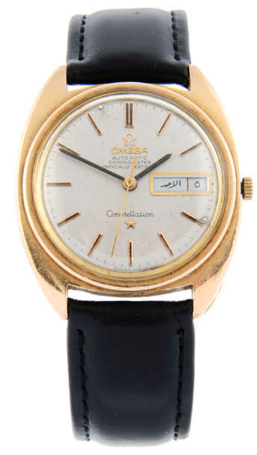

Second question, how much do you think the below is worth paying for? I think it's very pretty and (in my very limited experience) have not come across an arabic day date like this. It's intriguing and a good talking point etc.
I'd be super keen to hear your opinions and wisdom.
The details listed by the seller are:
Constellation, Gold plated case with stainless steel case back.
Case width 35mm.
Reference 168.019.
Signed automatic calibre 751, numbered 27638556.
Silvered dial with baton hour markers, Arabic script day and date aperture to three. Fitted to an unsigned black leather strap with gold plated pin buckle.

If you are confident that you know your stuff, auctions can be a good place to get good value for your money as long as you don't let your emotions run away with you in the bidding. However, they often have poor and incomplete photos, and they are as-is sales for the most part.
This particular piece is gold-capped, not gold plated, which is good. It has the wrong crown and probably some condition issues, but it's impossible to judge based on those photos. If those are really the quality of the photos shown in the auction, I wouldn't bid on it. If the artifacts are due to the way you transferred the photos, maybe you can find a way to improve them.

I’m not loving this example. Seems very dirty, heavily polished and worn down. Pictures are horrible. Crown does not look right either.
I am not a fan of auction houses. Most have sky high fees, upwards of 20% of final bid price. I understand that the auction houses have expenses to meet, but those percentages have been rising steadily over the years. eBay has its flaws, but at least you know that just have to pay sales tax (in the US) or customs.

That particular watch is a hot mess, even with the poor pictures. Apart from the crown, there are two weird spots on the dial (11 and 4). And it’s really dirty—so apparently not well cared for.
There are lots of C-cased Constellations out there. Look for one from a trusted seller here on OF.

The auction house is estimating £300-£400 +(30% fees). Is it worth that do you reckon?

By the way, the spots at 11 and 4 are steel pins protruding through dial...

Oh, that's a major issue. Probably the dial feet fell off and were reattached by soldering, damaging the dial. I would definitely stay away knowing that. You can find much better.
Not in my opinion, given the serious condition issues. But TBH, it's quite hard to put a correct value on poor examples. I just avoid them altogether.

Instead of taking the time and nurturing the dial feet and screws, someone cut the feet then soldered/melted new ones through, it's very common sadly
The Arabic day/date is pretty rare in usage, but as far as I heard from Archer, they were available during a service

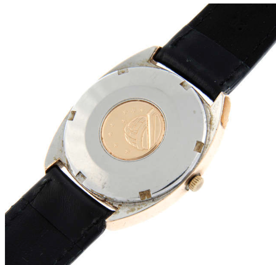

The caseback is in good shape
It's a pretty low meh watch, would be a good beater, I think the main value is the caseback, I can imagine paying $150 to it

I would also look at around 150 all in for parts value, unfortunately you know nothing about the health of the movement too.
If this is to be your first I think this is probably not the best... This is the sort of thing @kaplan and I eye off for parts to fix other projects.
If you are a new C-case enthusiast though please do drop by the C-case thread 😀
