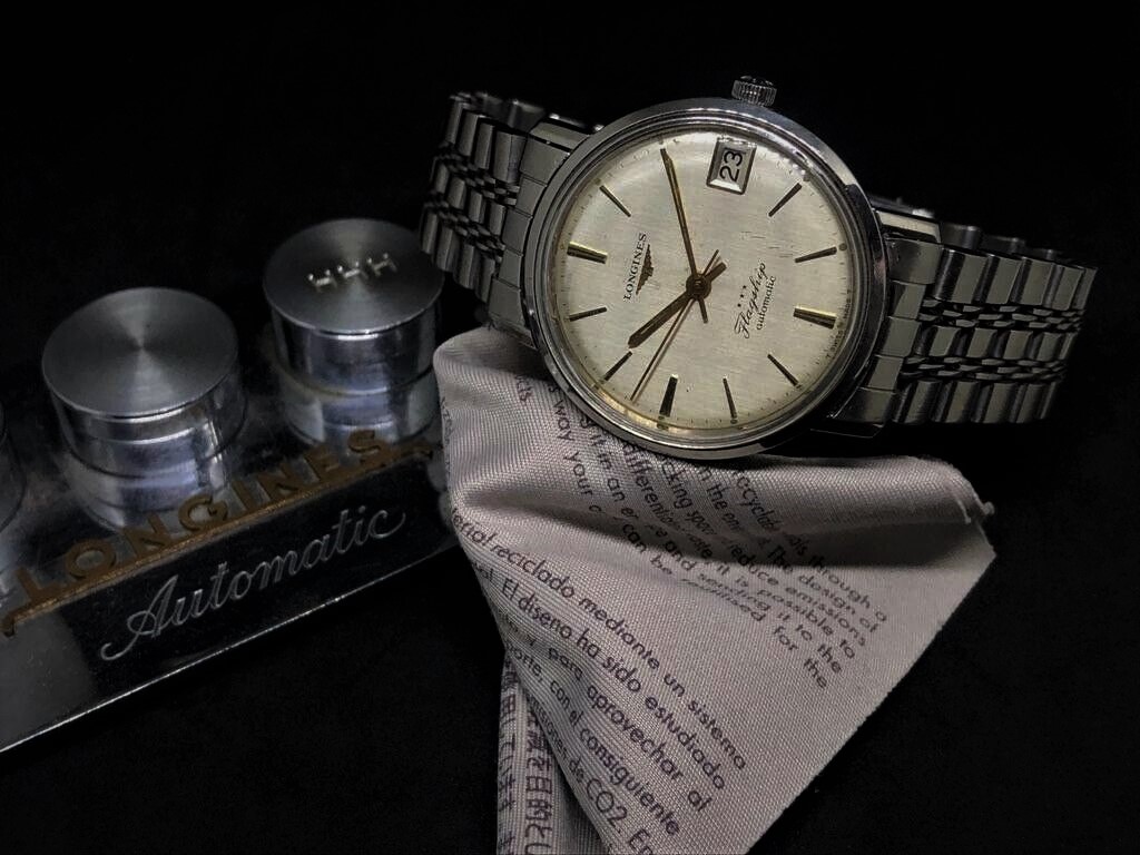

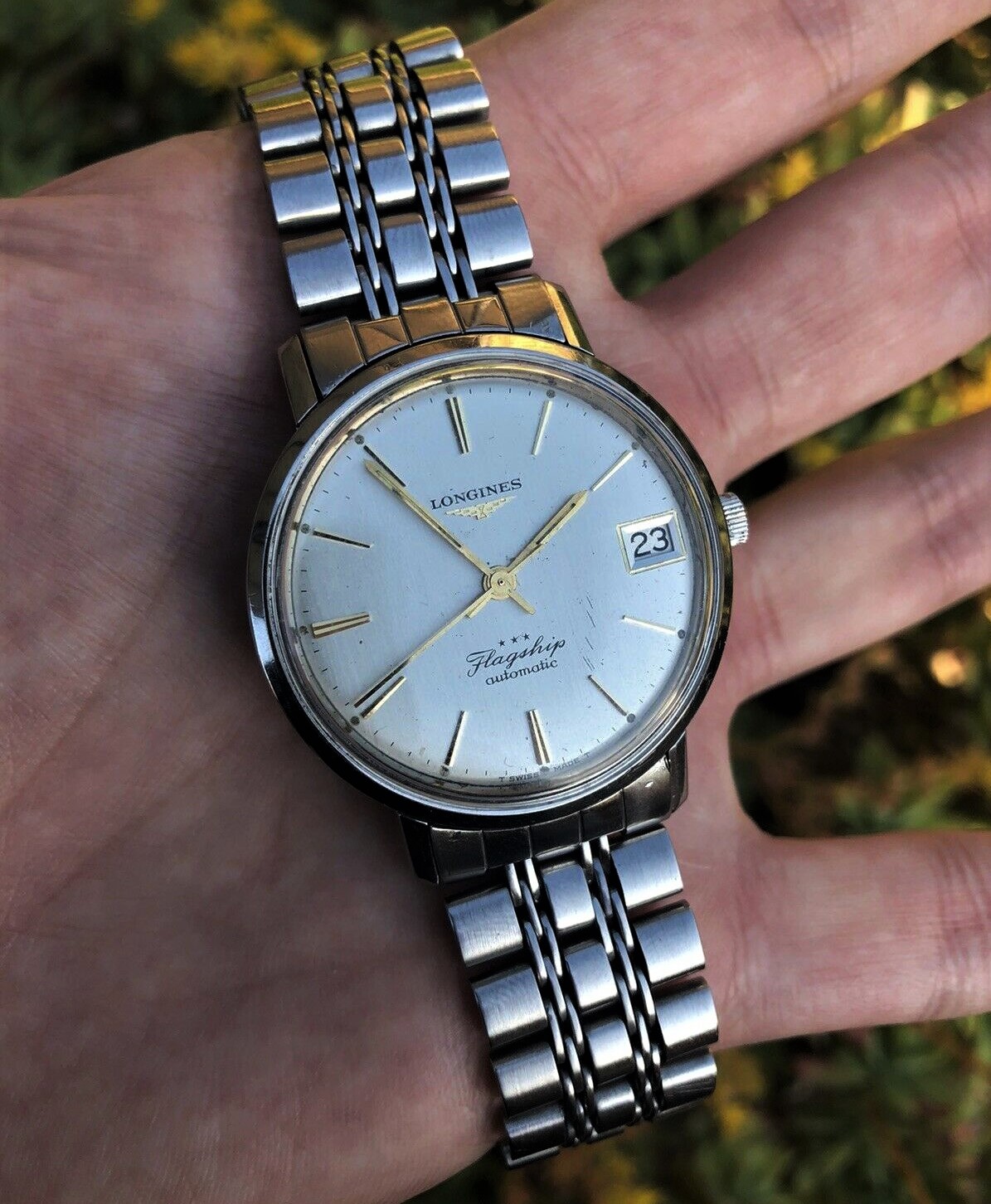

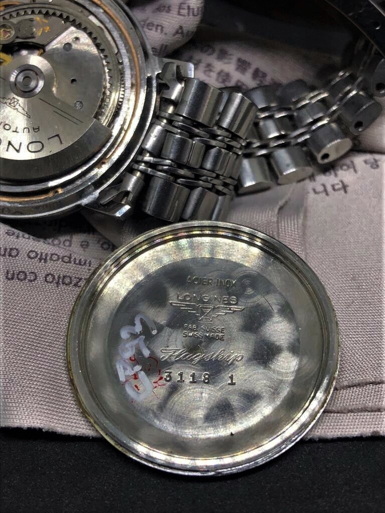

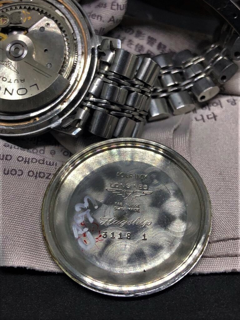

Good morning from Israel.

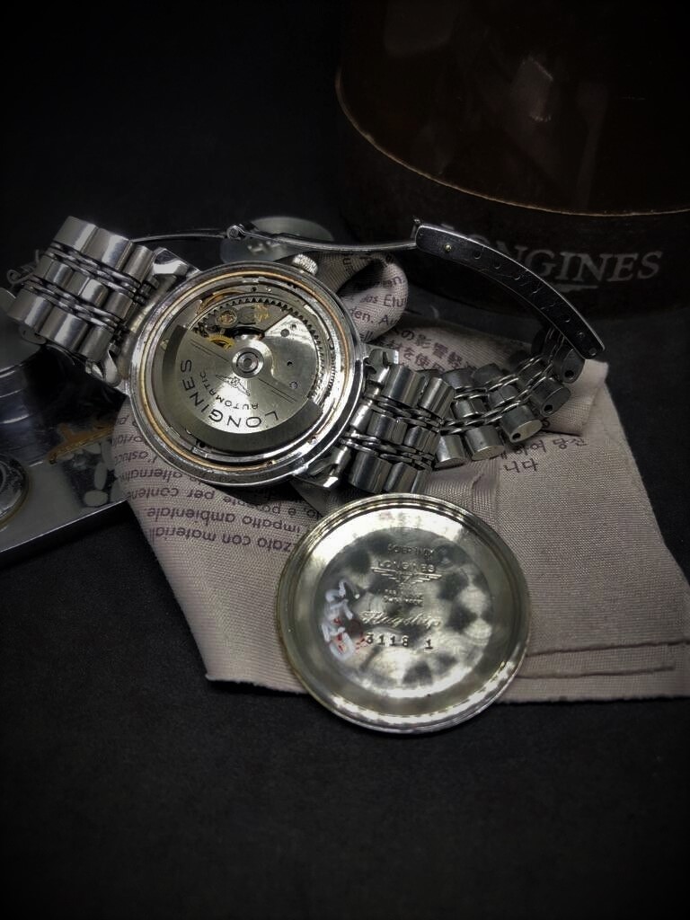

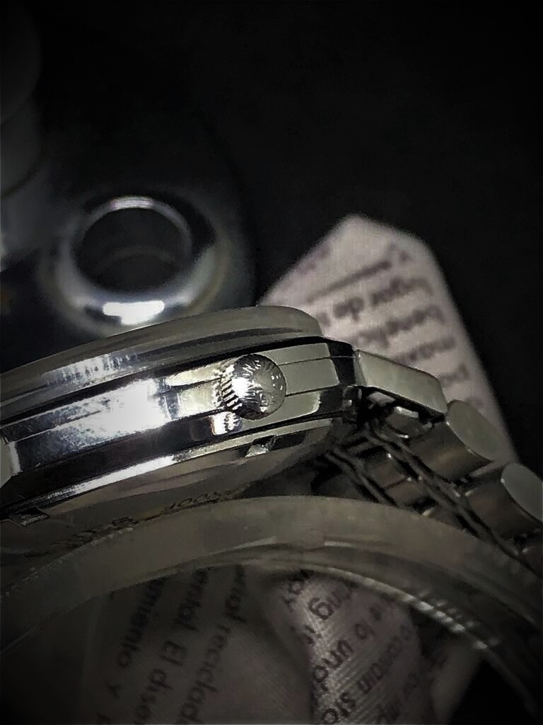

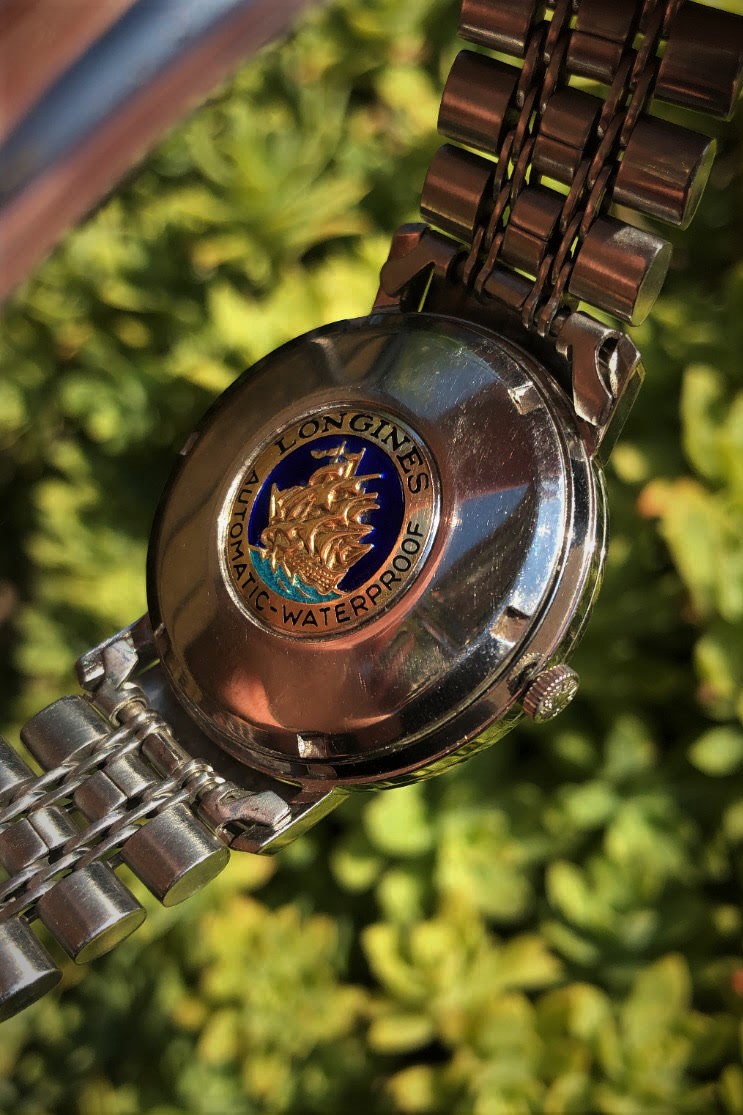

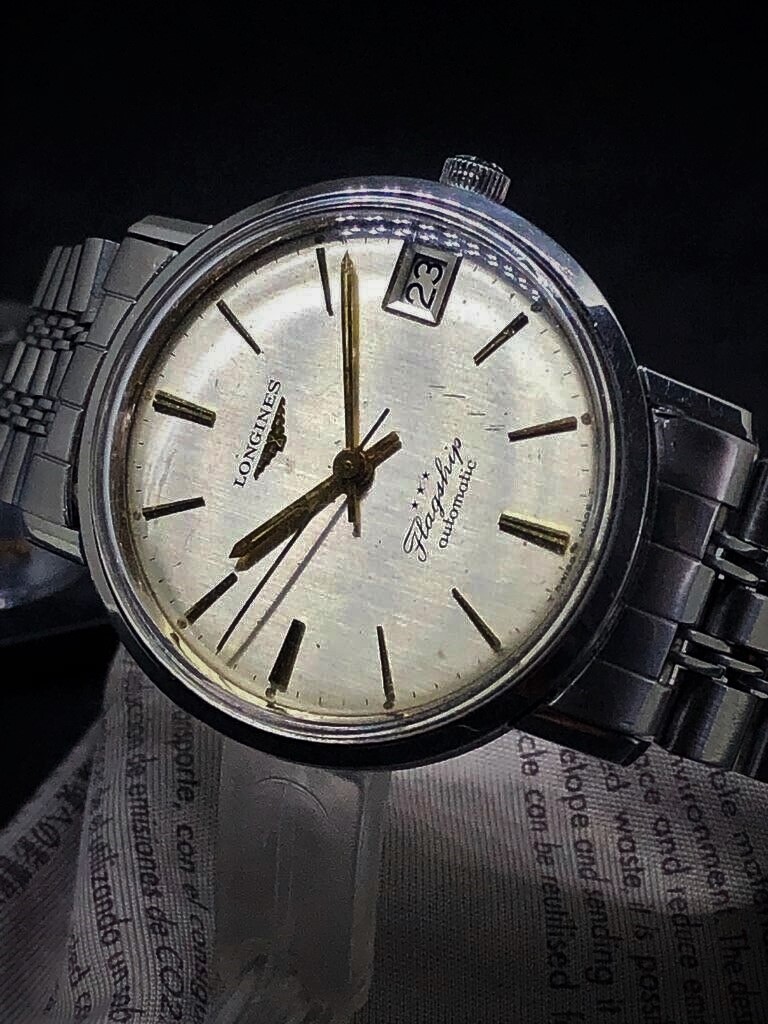

Just received this Longines Flagship i purchased for 750$, by the pictures and description it seemed to be a

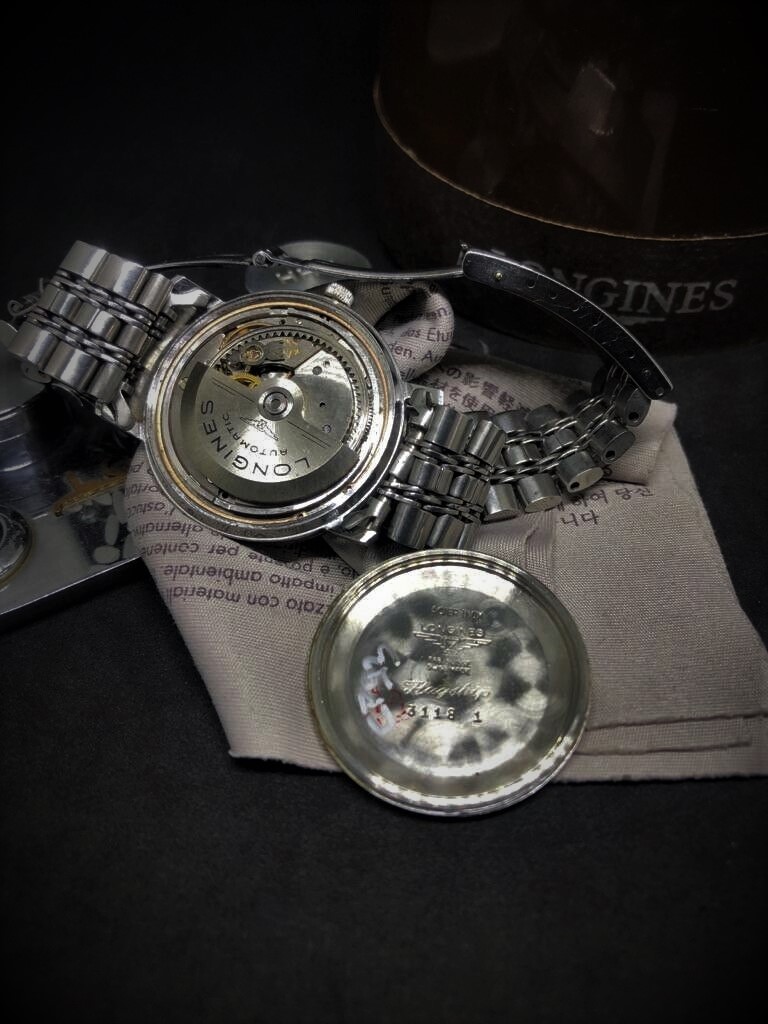

nice piece but as i opened the case back the movement almost fell out, only held in only by the crown stem.
I then took the watch to my old Russian watchmaker who added that the 345 movement was only charging in one direction and needed a new reversing wheel.
I quickly contacted the seller who assured me it was me it was sent in perfect condition. HaHa
Anyway, to cut a long story short i was offered 200$ to keep it and so i did.
Ordered an 75$ reversing wheel on eBay which hopefully should be here soon. I think the fix including parts and work will cost about 200$.
Good or bad decision in your opinion??
684
6,942

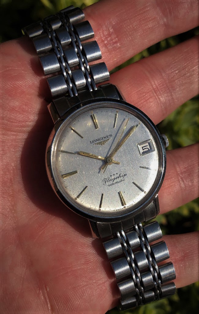

It’s a very nice and high quality watch from an era that Longines watches were equal to omega watches. I think you made the correct decision to keep it and service it.
479
1,553

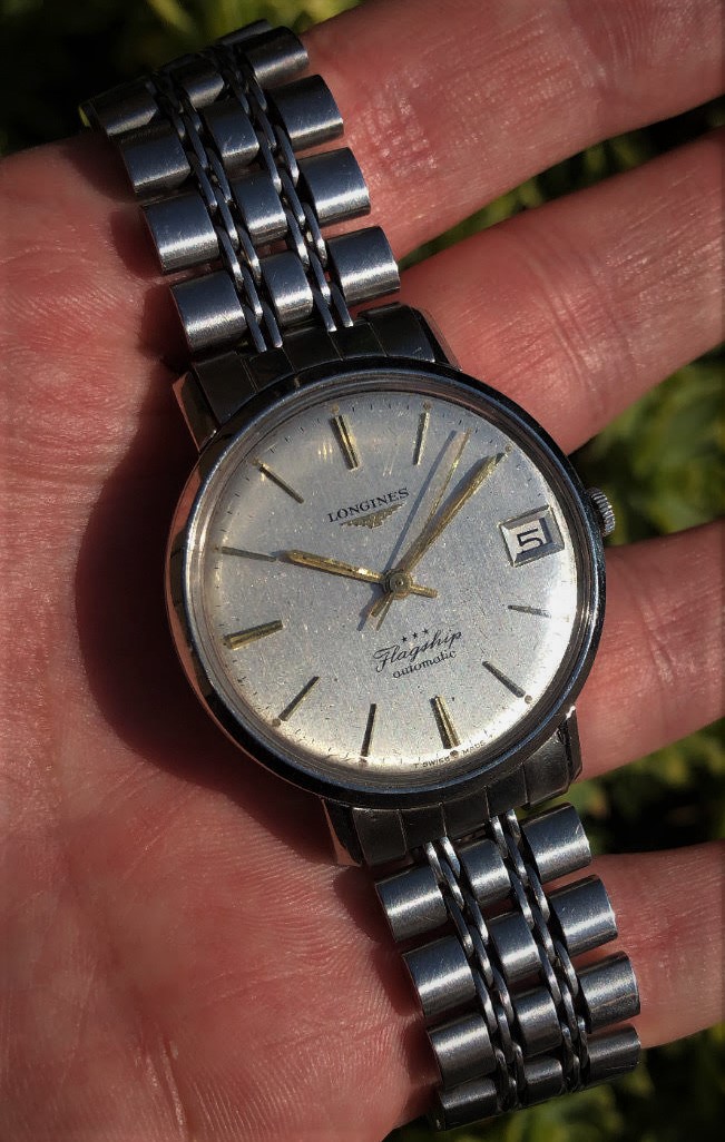

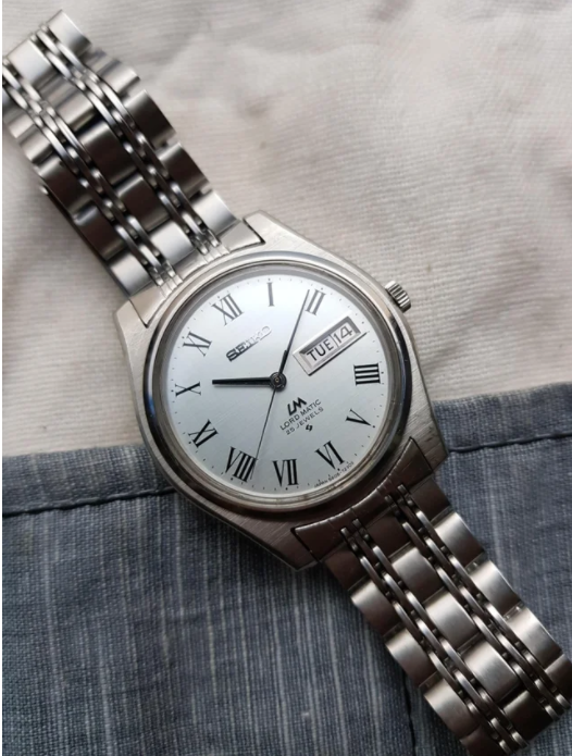

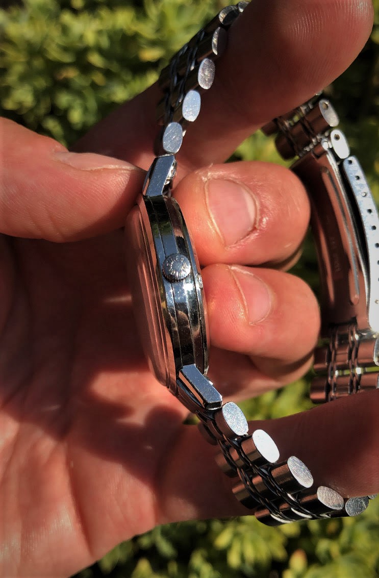

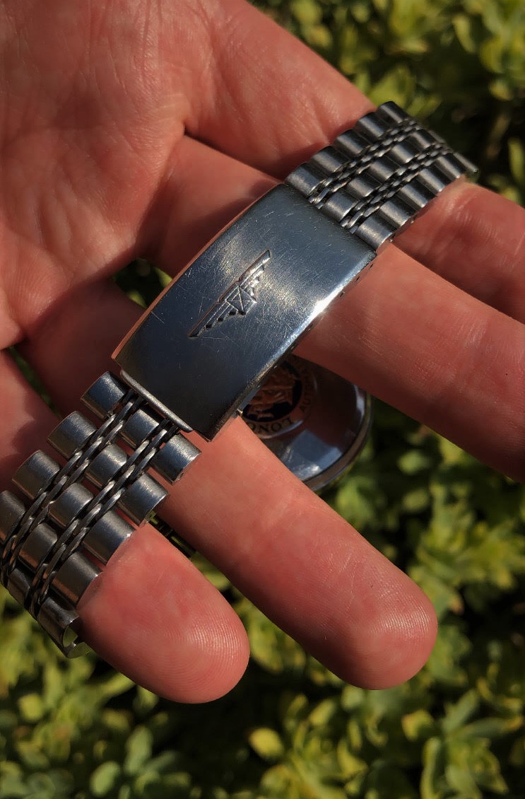

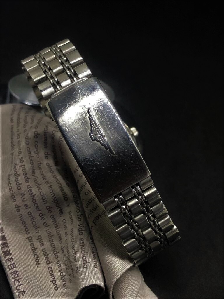

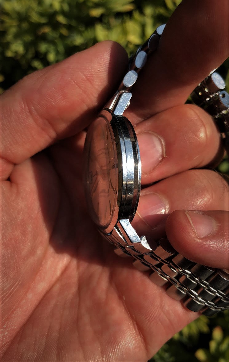

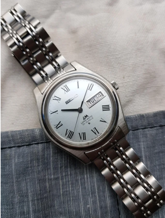

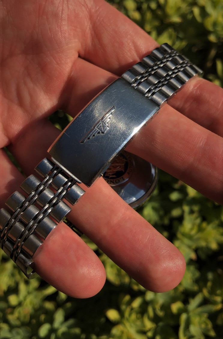

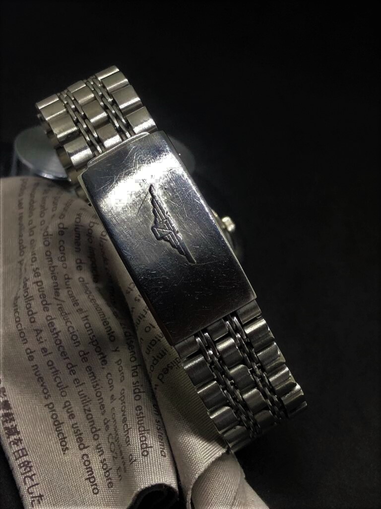

Looks good, but the bracelet seems to be put together from parts. The endlinks aren't for those links ( you can tell by the wide gap where the "beads" connect to the spring bar) And I'm pretty sure the actual bracelet part is for a Seiko or similar. (just in case it was billed as an "original bracelet")
But the clasp would be a good donor if you find something more appropriate. Or just find some better endlinks and enjoy the heck out of it.
24,838
55,263

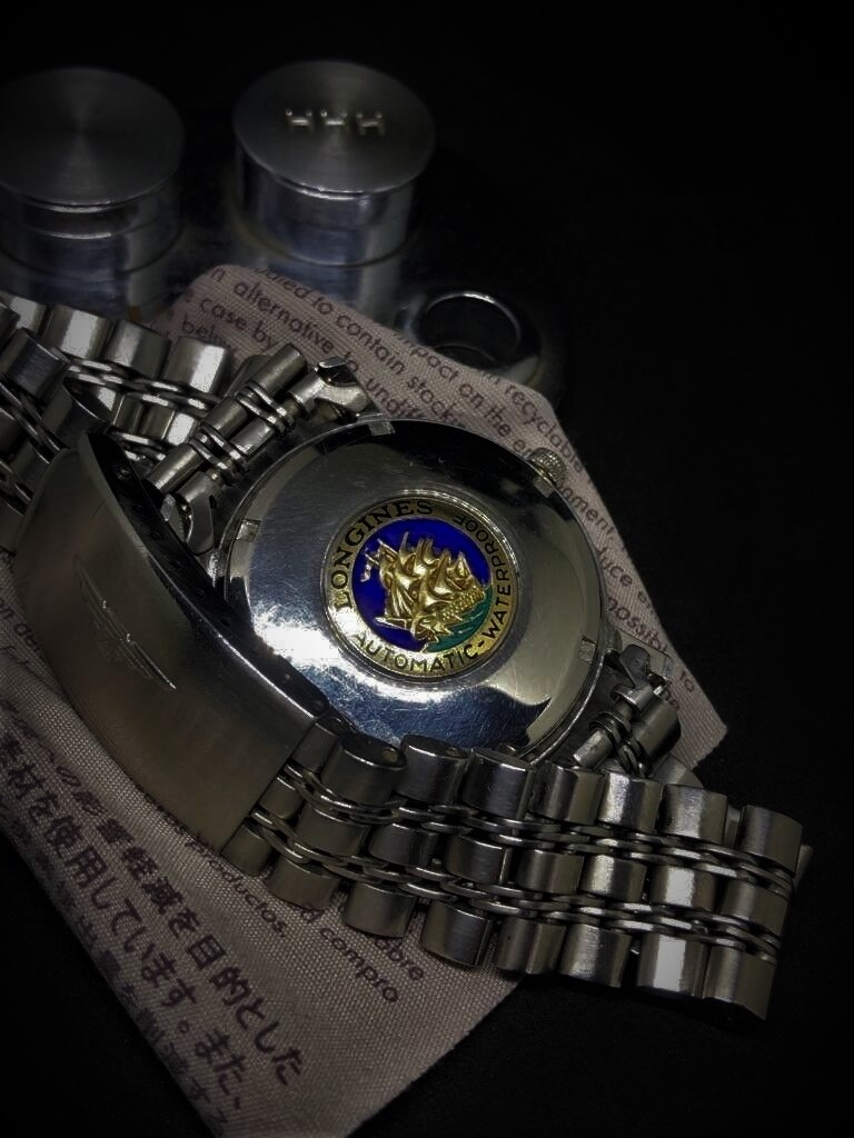

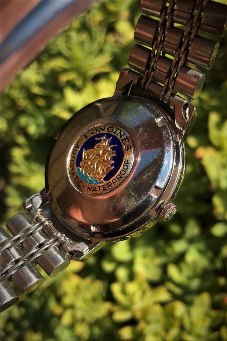

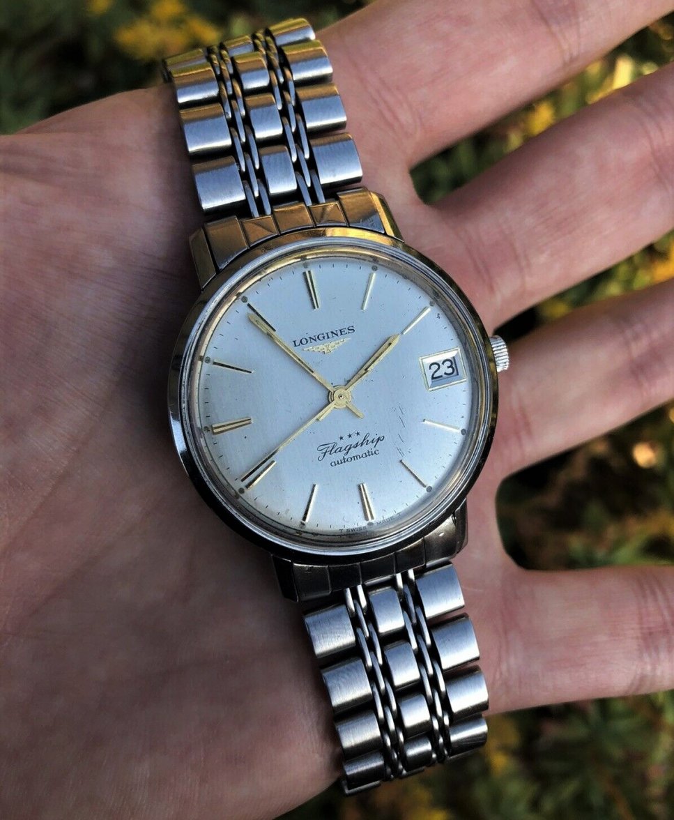

Once fixed up, it's going to be a really nice watch. The case-back is amazing.
