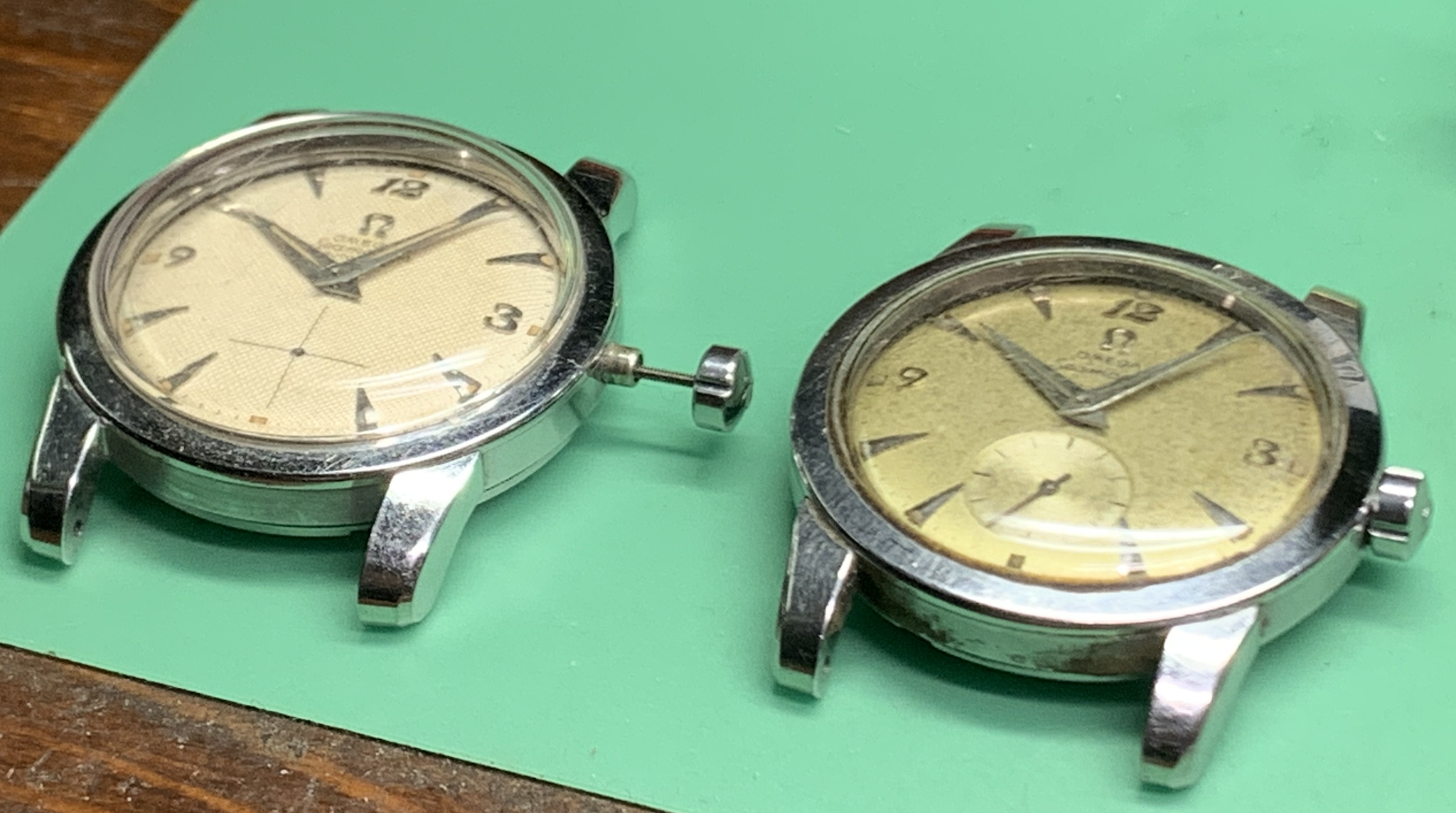

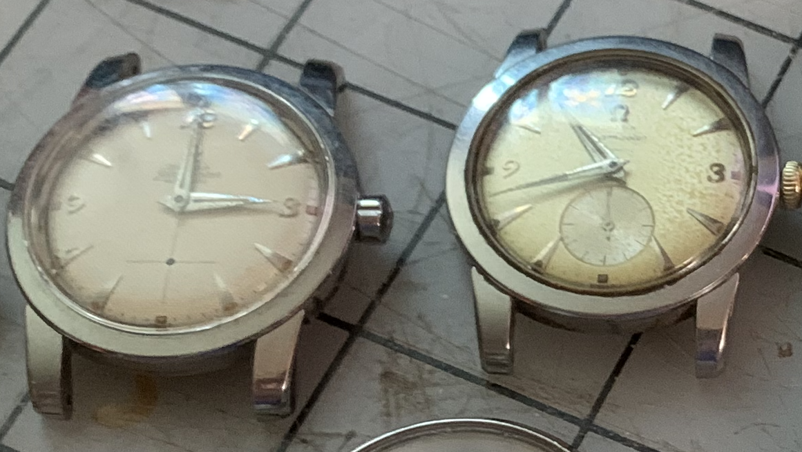

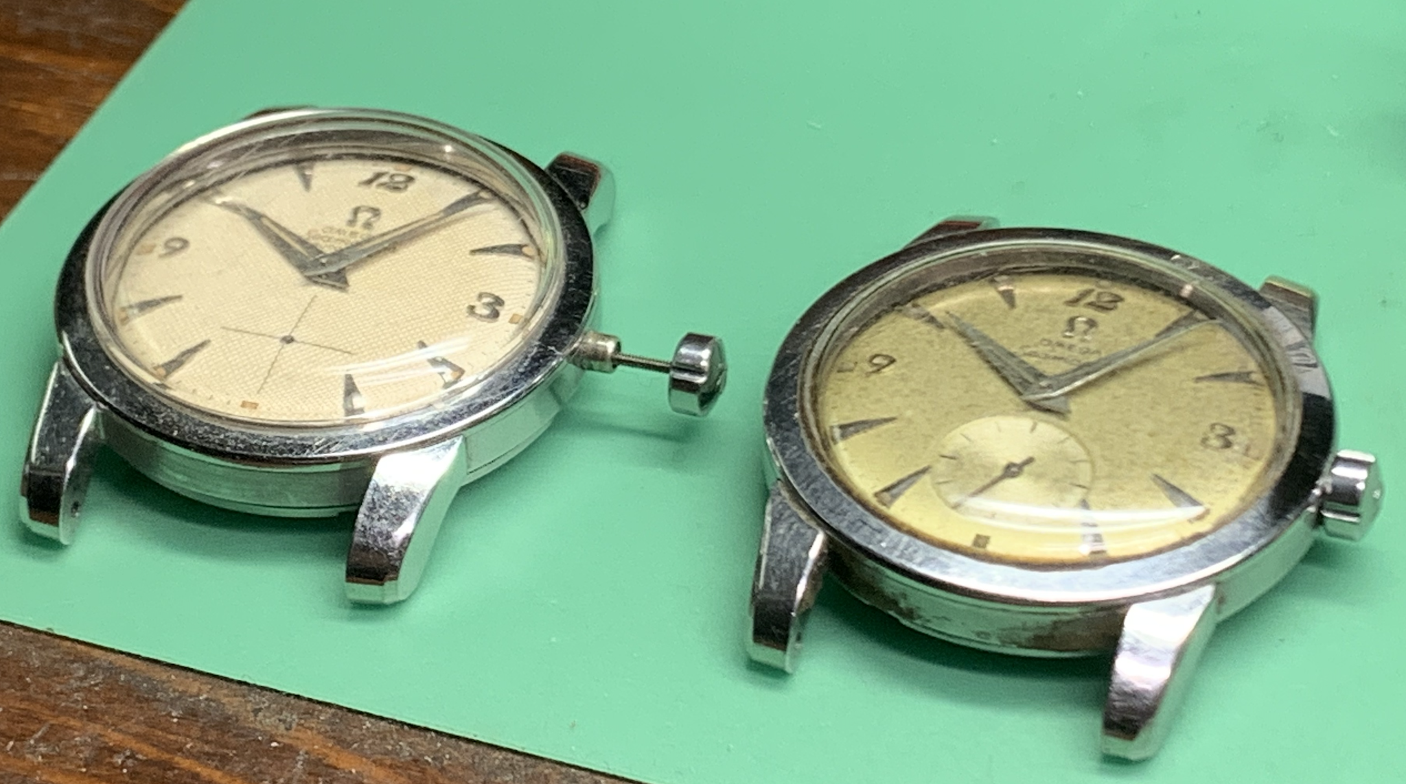

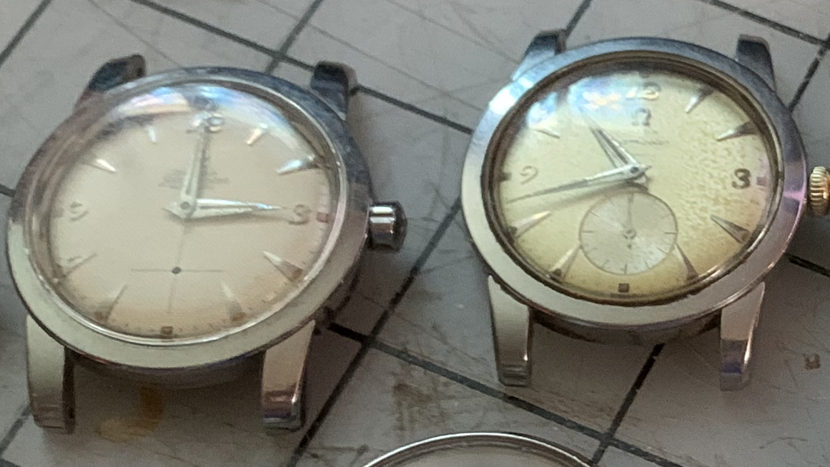

In my box of watches are a pair I call the 'twins.' These are nearly identical 2576 cases with a 344 bumper. Mostly identical apart from their dials. They also have close serial numbers 13456700 and 13456982.
The one on the left has does not work. I actually have the same crown for the one on the right but the threaded part is loose. The one on the right does work but needs a good service.

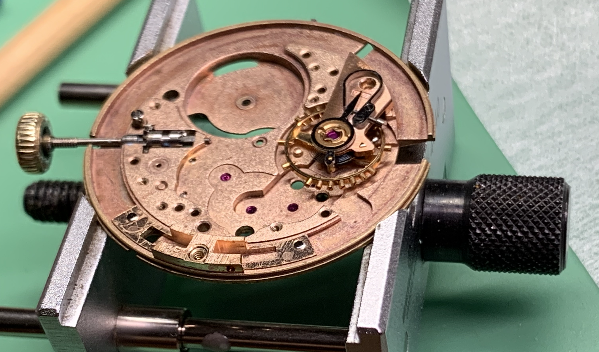

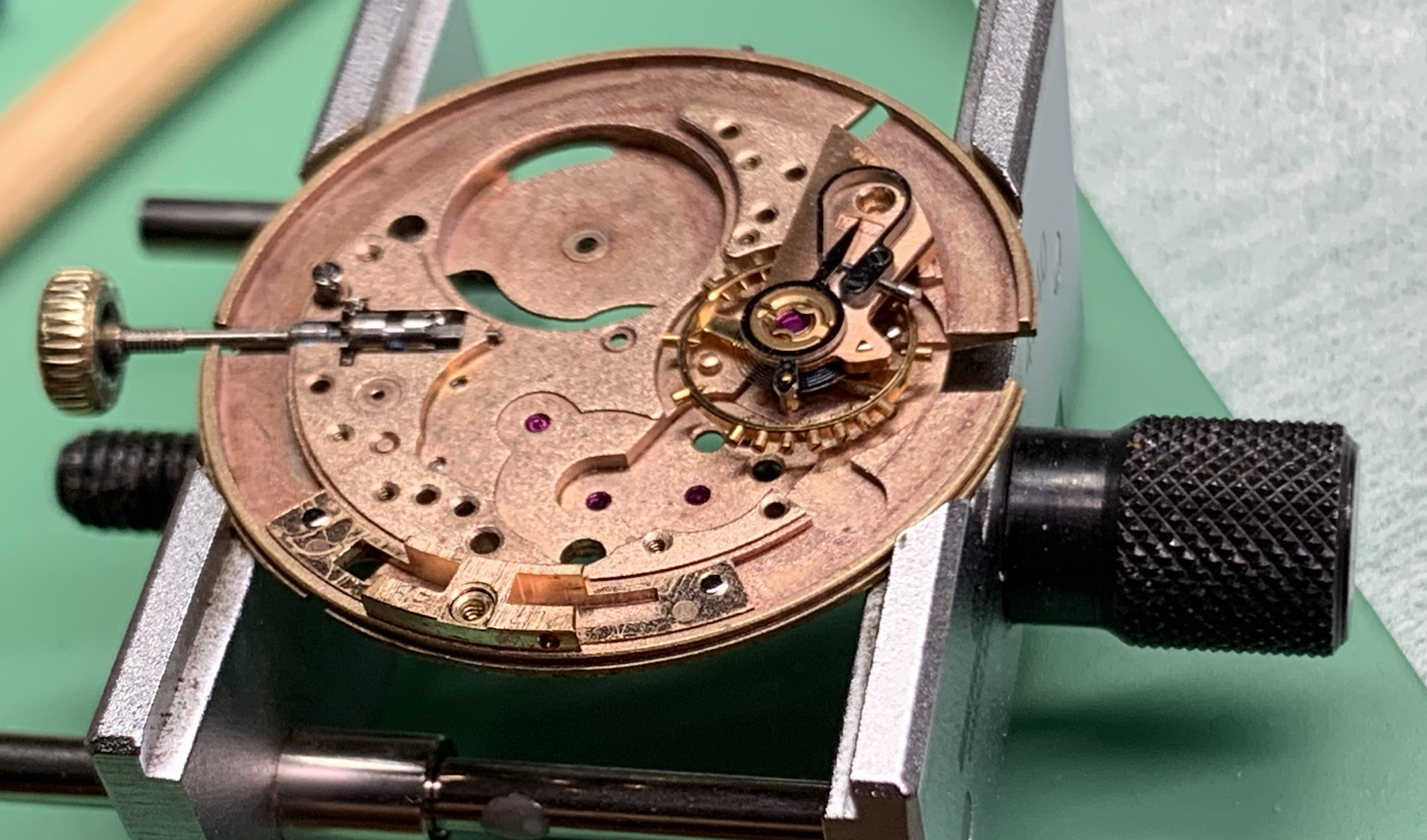

I decided to take the one on the left apart. The balance is stiff and does not turn freely.

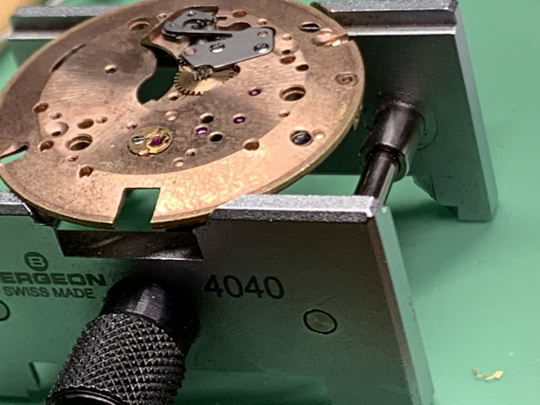

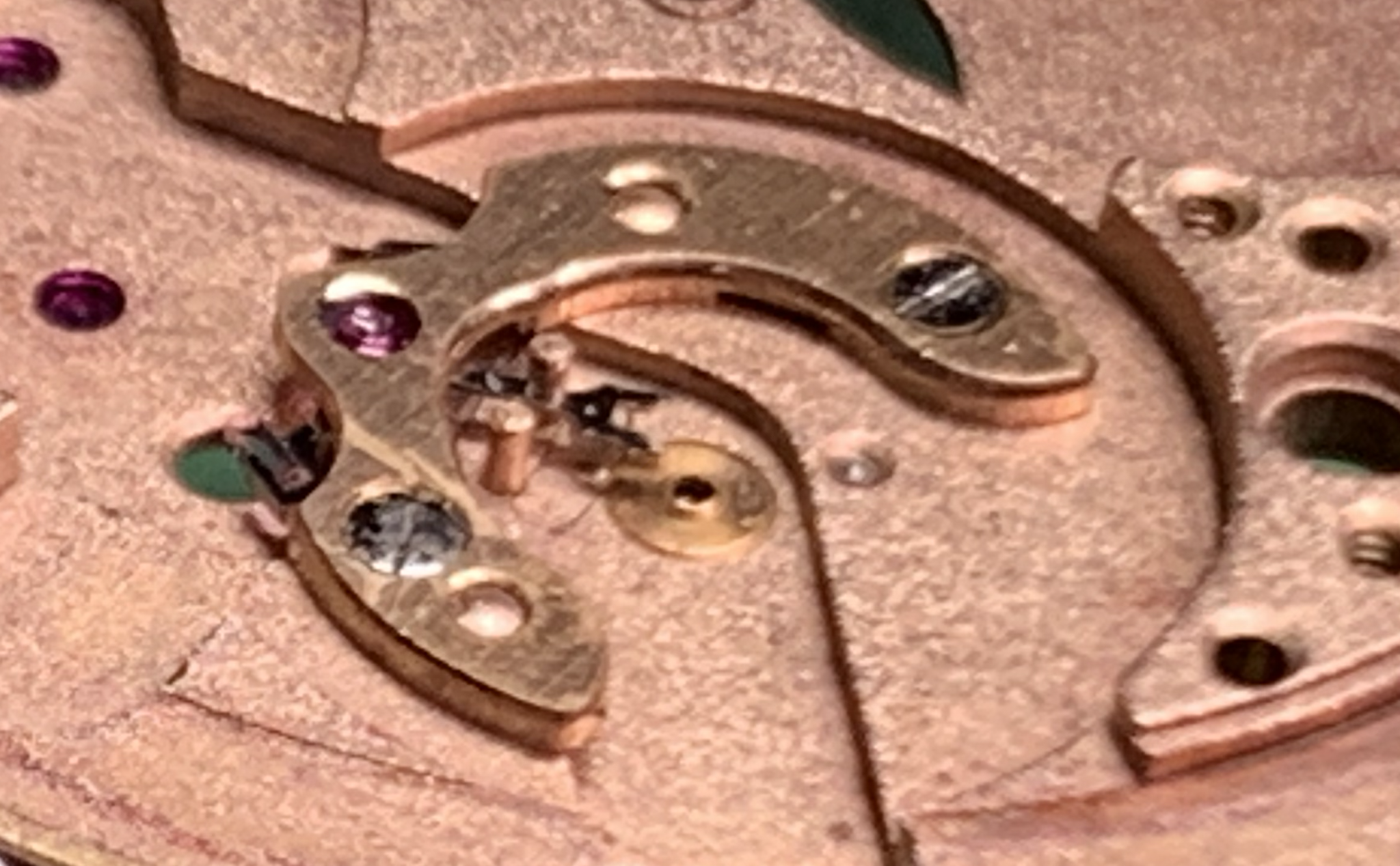

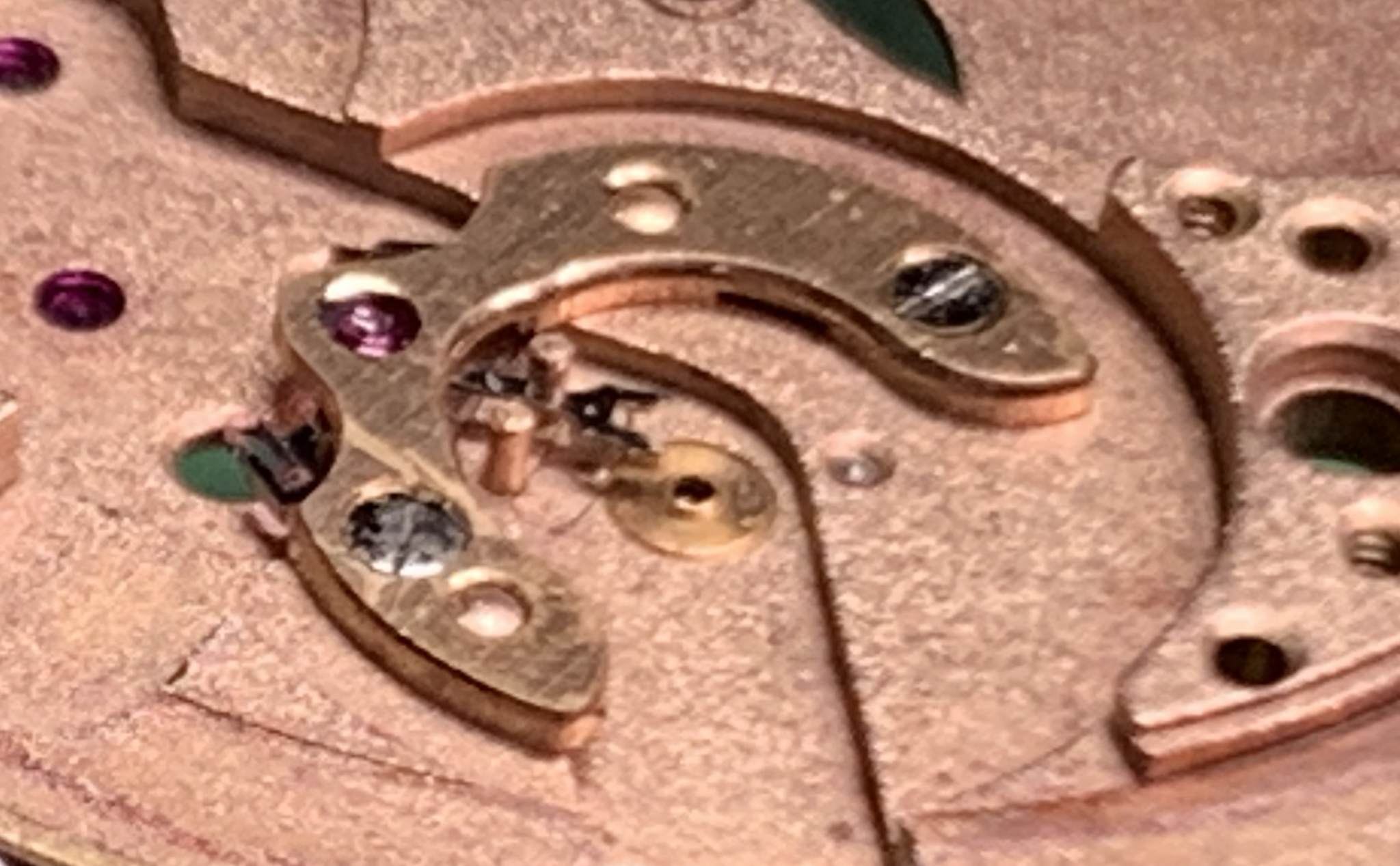

On disassembly I discovered a number of issues. The lower balance jewel incabloc spring was broken, leaving the jewel at a cockeyed angle. Screws were swapped between the pallet fork cock and the set lever spring. One of the screws on the set lever spring snapped off.

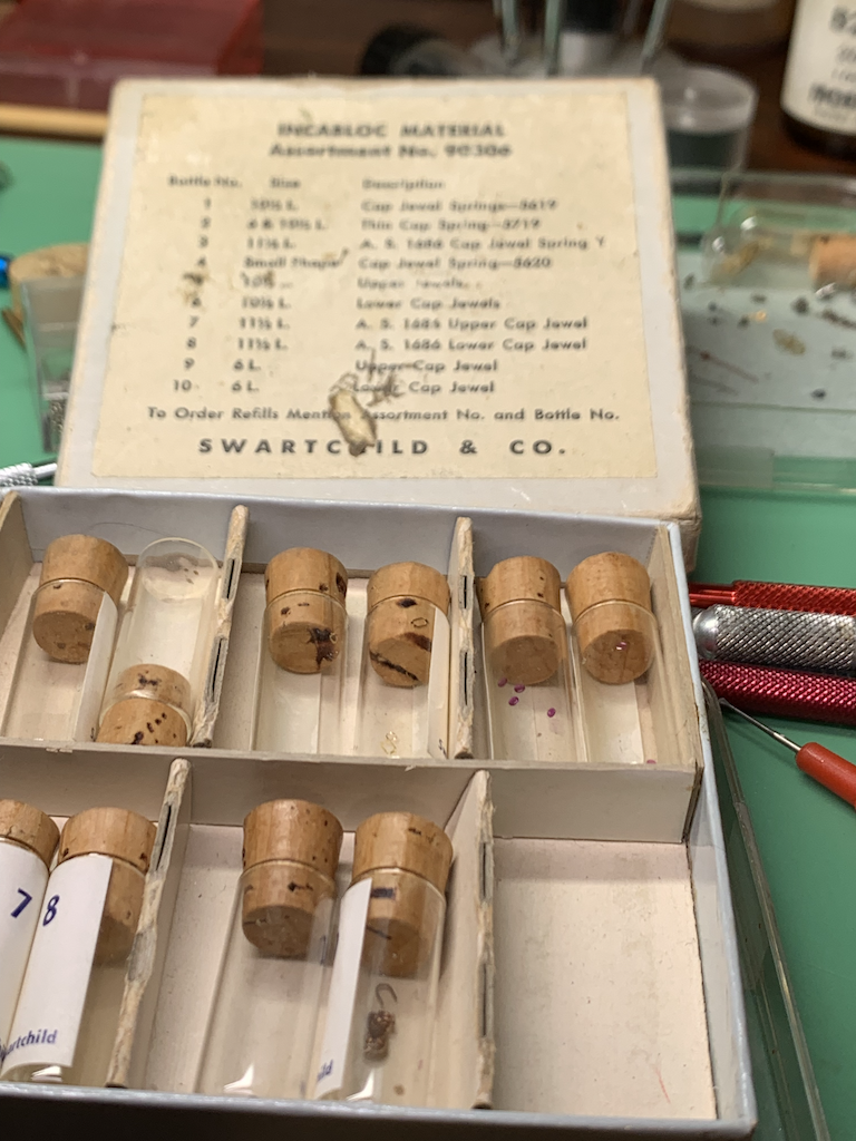

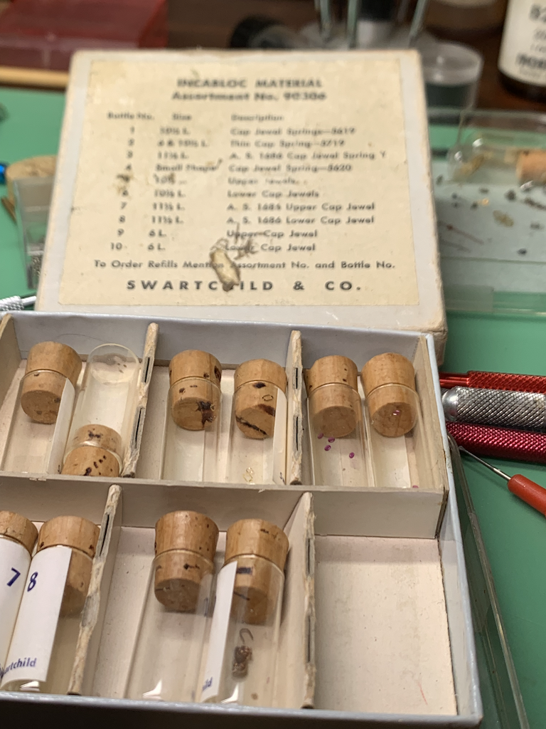

I noticed that the incabloc looked a lot like the one I swapped on the Val-72. I have an assortment of incabloc material.

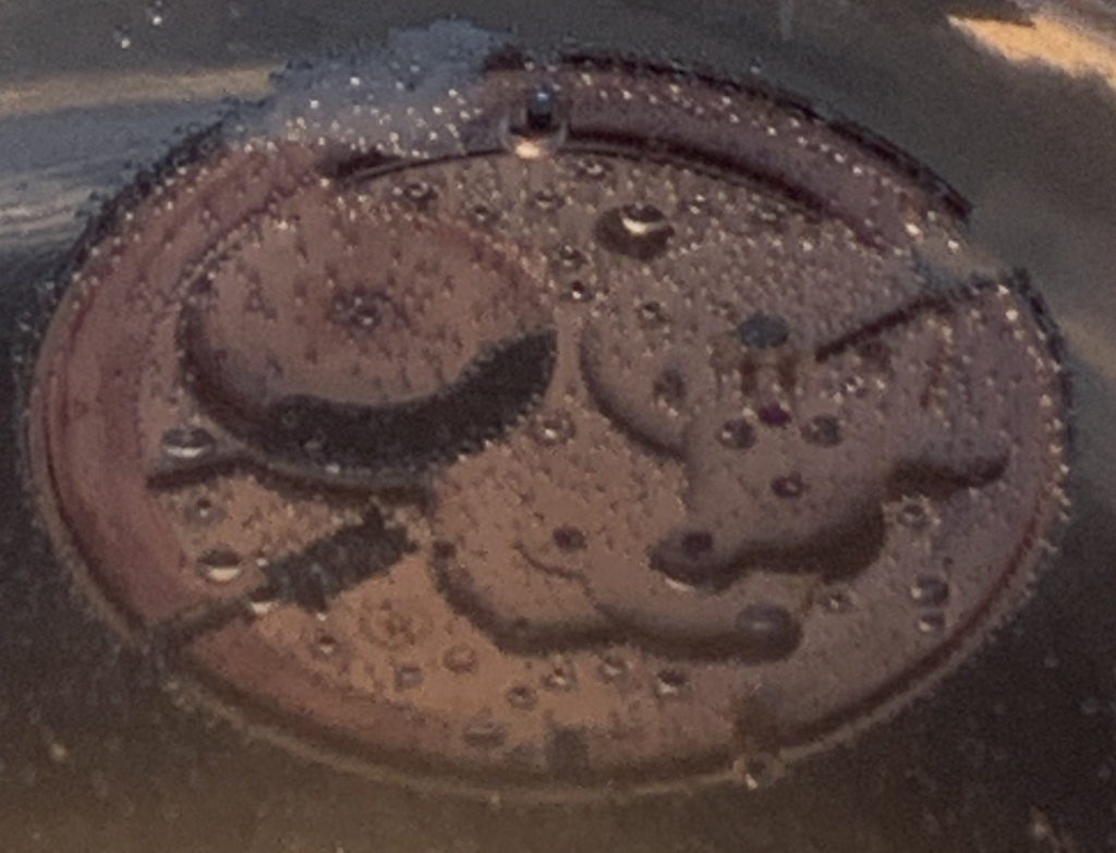

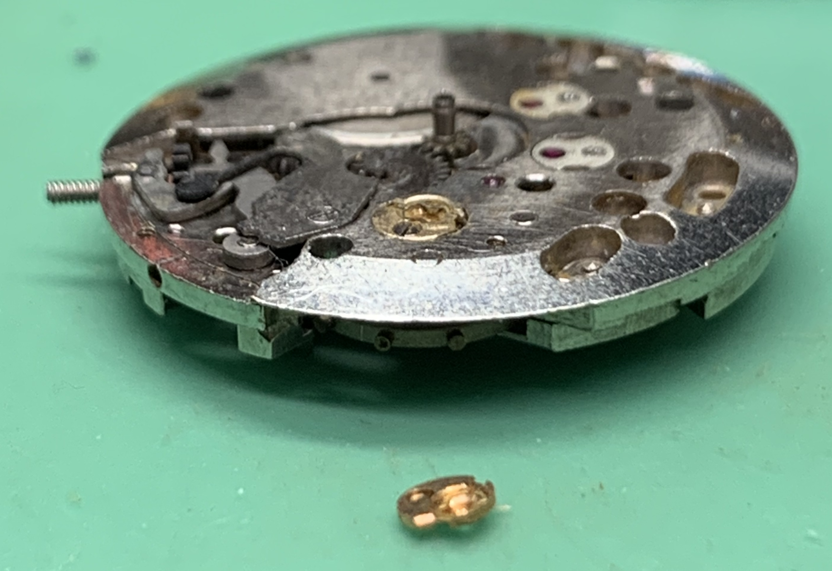

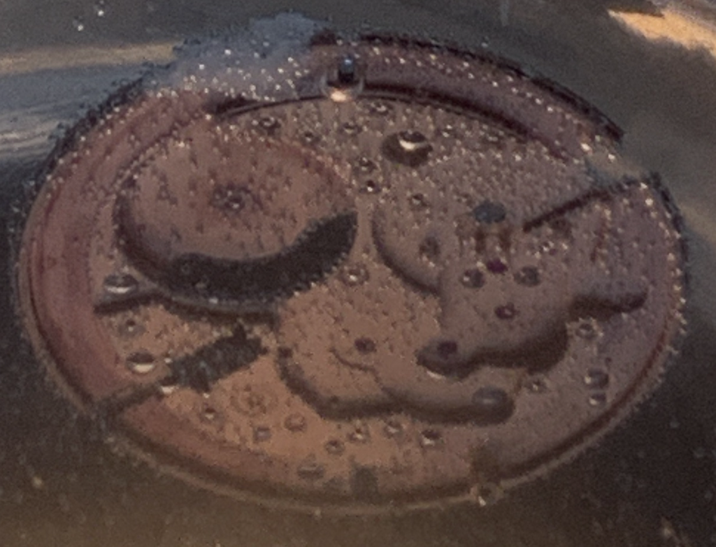

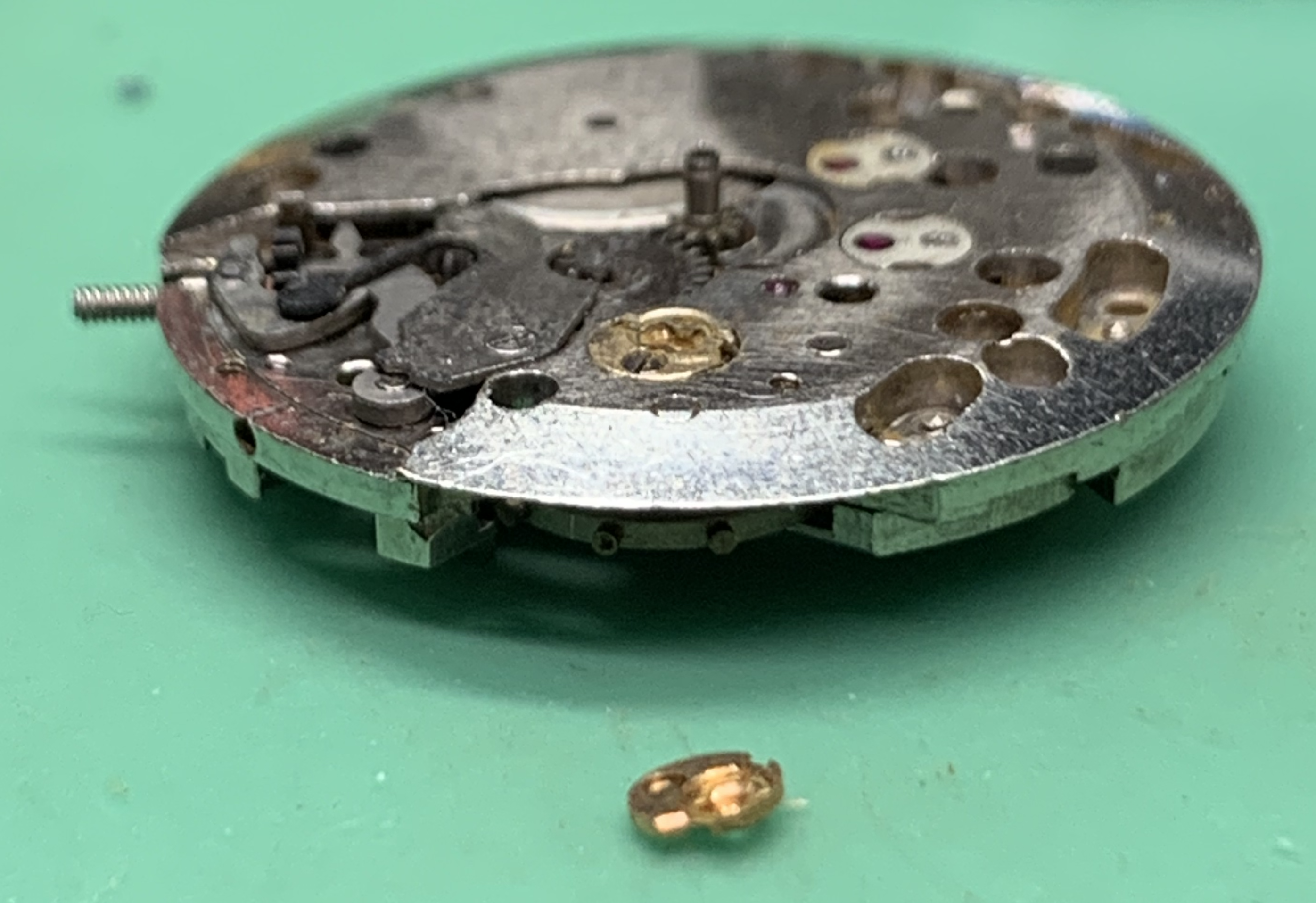

I decided to see if I could find a lower incabloc spring while dissolving the broken set lever screw in some alum.

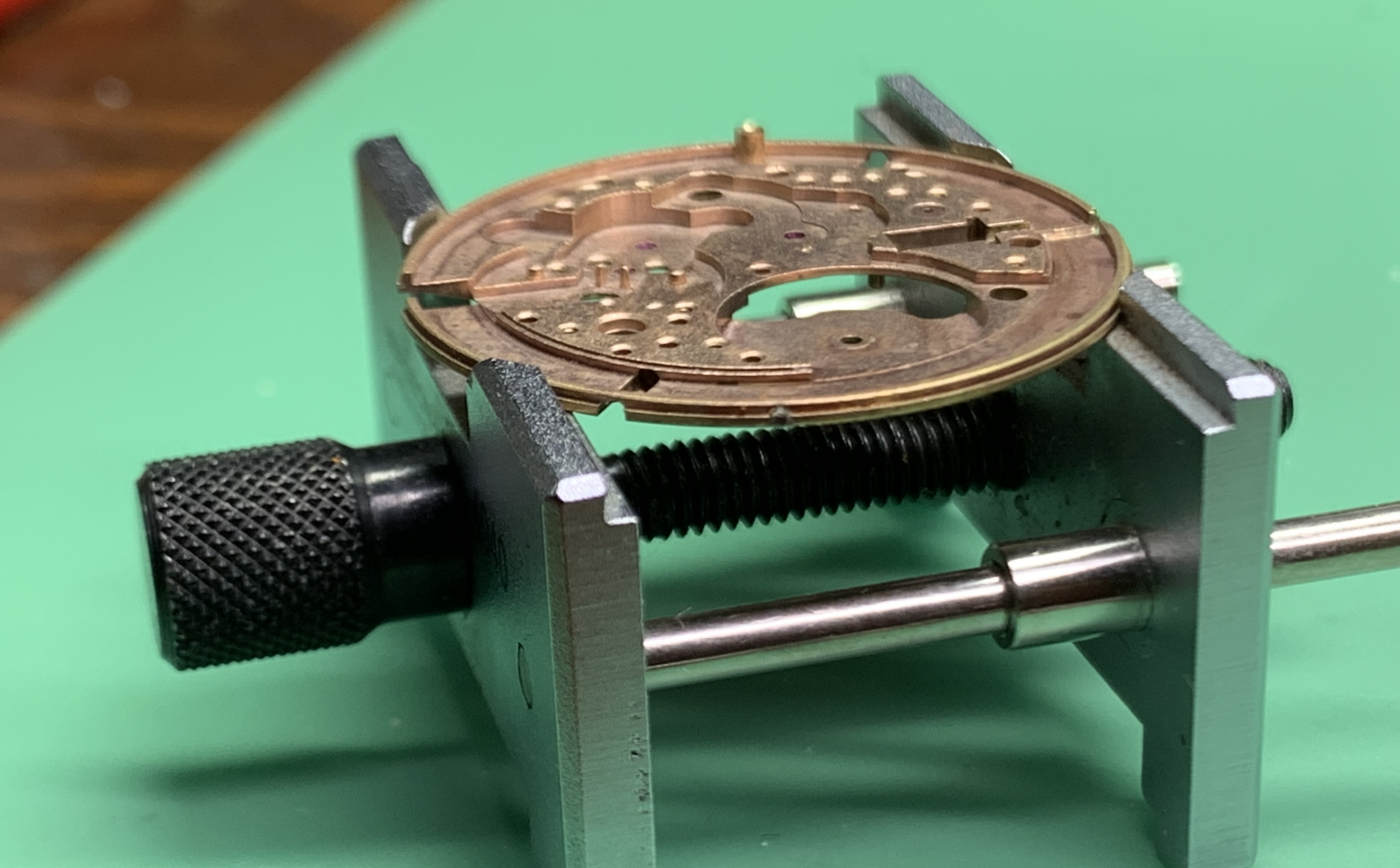

I put some wax over the case pin as this dissolved out on the 351.
Curiously while waiting for this to soak I discovered the Val-72 fits in one of the AS 1194 plates. The omega assembly also fits!

Now I have to wait for the screw to finish dissolving. I did find an incabloc spring so there is a good chance I can get this one ticking too. Too bad the sub seconds hand is missing. I have been spending a lot of time sorting watch hands this last week. I suspect the correct one is white steel, most of the ones I have are blued steel and are not Omega hands. I recently bought a sweep hand for one of the ladies dynamics. Such hands can be $$$

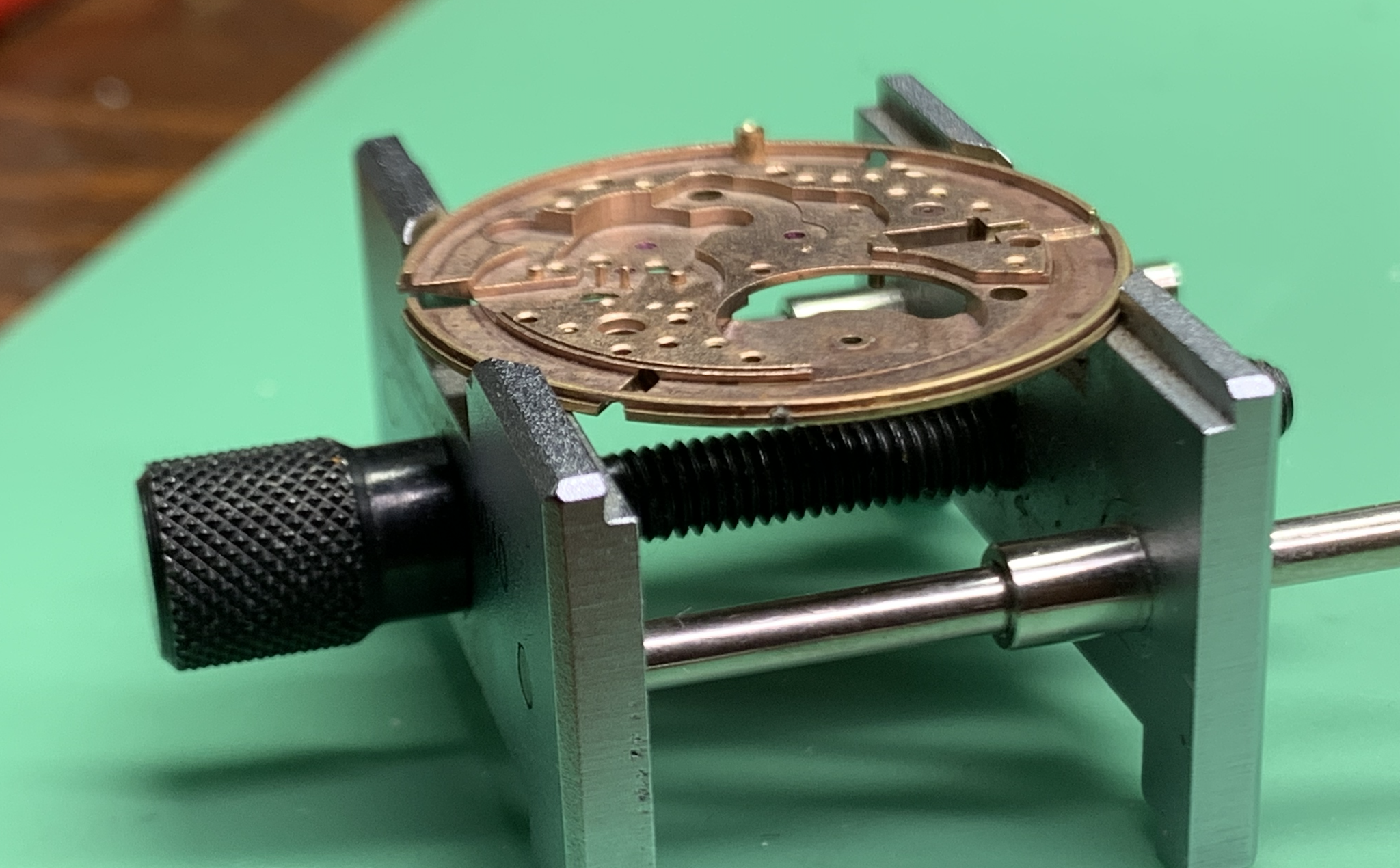

I do not like leaving my good watches apart. So as soon as the broken screw was out the plate was back on the bench.
The wax worked and the case pin is still intact.

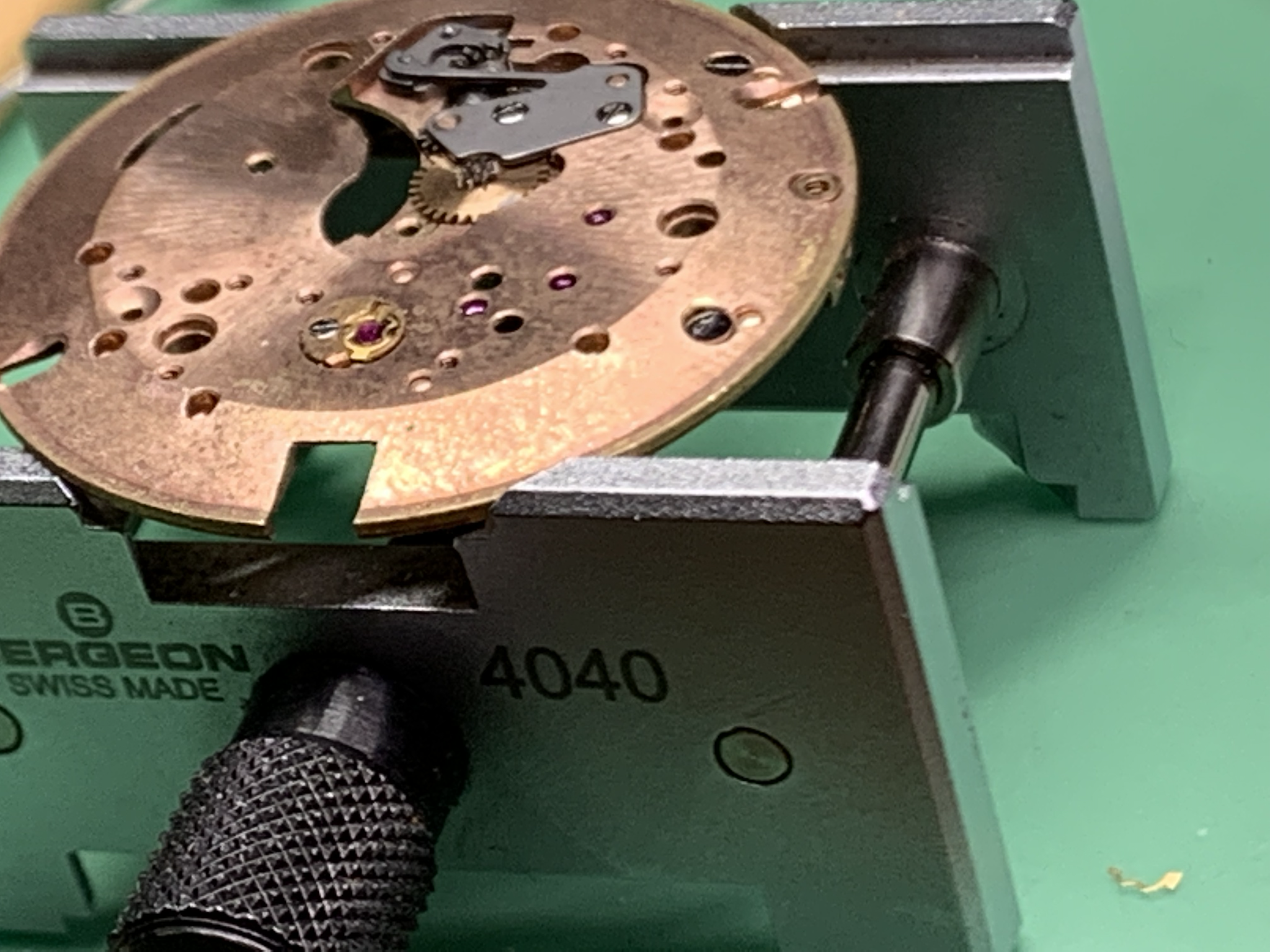

I like to work with the winding and set works first. More so in this case as the broken screw was on the set lever spring. Was the one on the left. Still had the screw as it was jamed into the pallet fork bridge. The watch was really dirty so I do not think I ever had it apart. I was also able to replace the incabloc spring with one from the assortment. This is what was keeping the watch from running.
I did not have the pallet fork bridge screw (as it was broken off in the wrong place.) I did find a screw in the assortment that was close. The finish on the top is not the same. Does fit and does not poke through the back.
Now the balance swings freely.
Three hours later and it ticks. These watches are so great to work on.

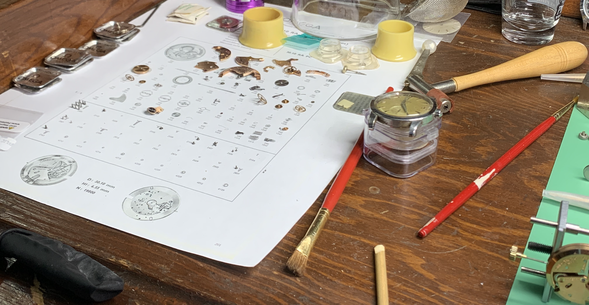

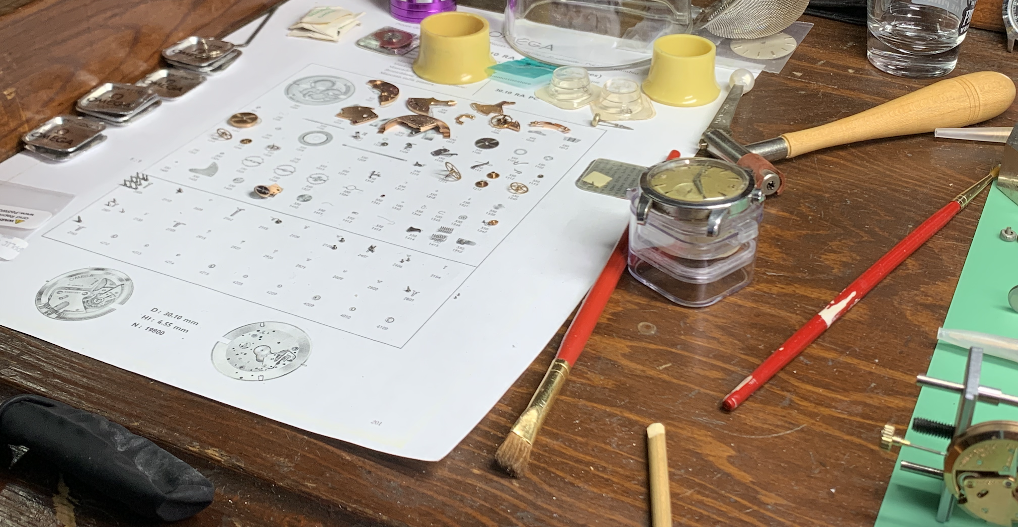

This seems beyond me at this point but I assume some day I'll have chaos like this as well so that being said Where do you get those paper part organizer sheets?
3,015
4,784
They come from the material houses websites. I mostly https://watchguy.co.uk/cgi-bin/files?subdir=Omega&dir=Technical Manuals&action=documents and Esslinger. One has to sort of fish around a bit. Follow links with in the site and look for a site director or map. Sometime manually edit the url to see if other names come up when the caliber number is changed.
I also have old books and magazines, Including some of the ones Omega produced contemporaneity with the watches.
The other good resource is the Bestfit catalogs. These were big telephone directories of every part available. Mostly for sale on eBay. But one of the material houses (I think they are the successor.) had the full catalogs for download.
A lot of eBay sellers clip these and use them for their auction images. This makes for an un intended use of eBay to see what the missing parts look like.
As much as that looks like chaos. It is well organized. The rule is only one watch apart at a time. (unless I am sorting parts.) I also note how clean the bench area is. Note the paint brushes. These are for keeping the work areas clean. Most people shed loose bits of skin and hair. (see the film Gattaca.) The finger cots help. Dirt and other peoples DNA also fall out of the watches. The alum process causes the screw to turn to black iron oxide. There are also sharpened bits of pegwood as the pegwood can get quite dirty. I used to use a lot of rodico, but @Archer says Omega recommends against it as it can collect this dirt and smear it about the watch.
The Swiss areas are surgically clean and the workers wear lab coats. I found one part one time literally up my sleeve. They get in the hair, and on ones shoulders, even the glasses or the loupe can catch a part.
I have taken to sweeping the floor even when I do not loose parts. I think they jump out of trays, and the magnets on the iPhone case and the flashlight do not help.
Now if only there was a brass and ruby magnet...

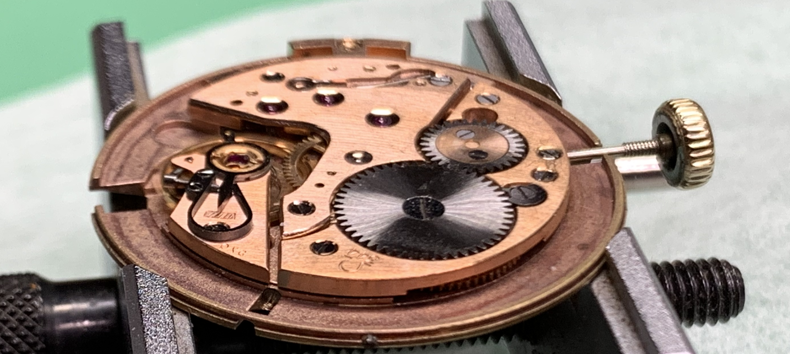

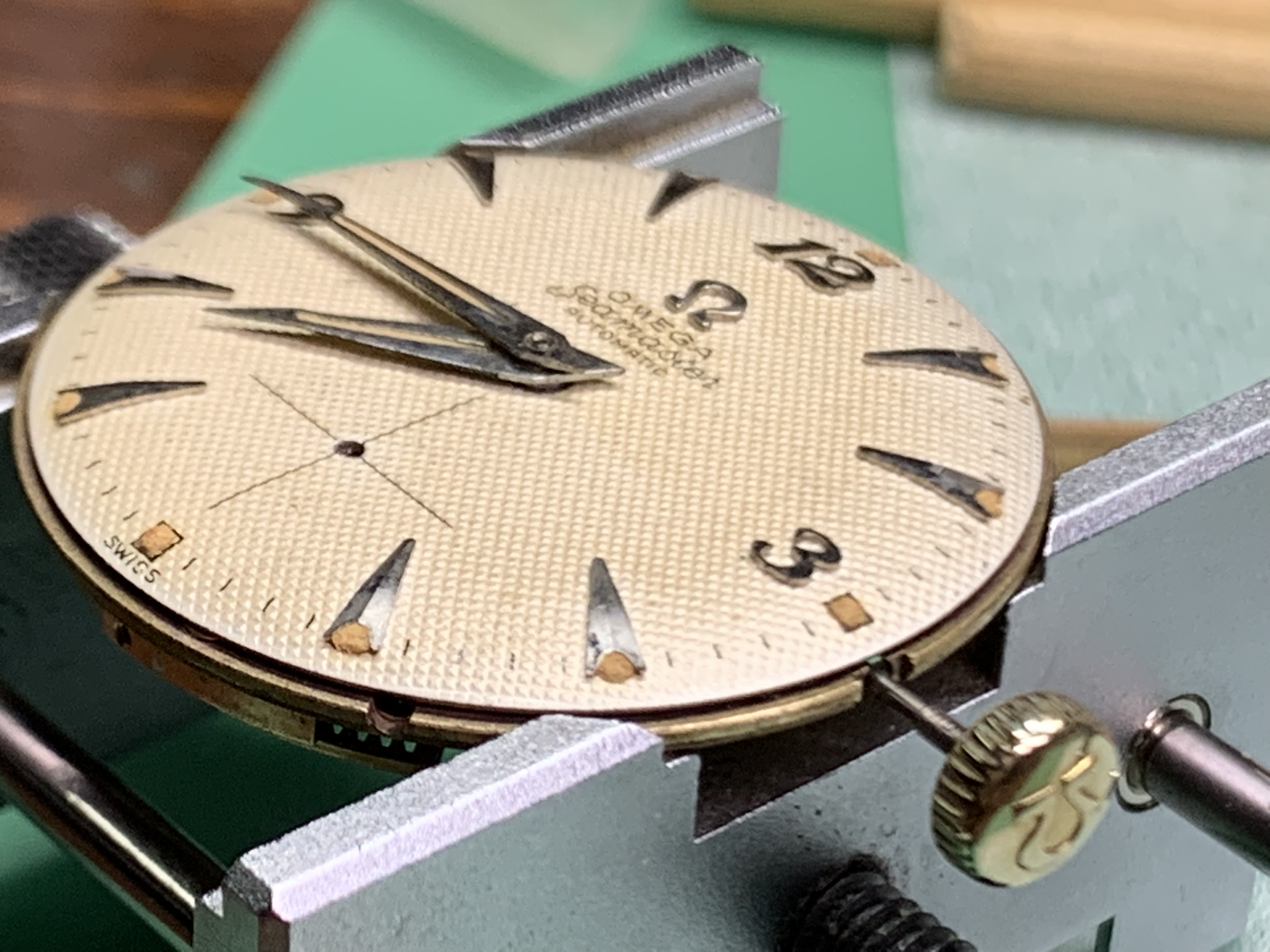

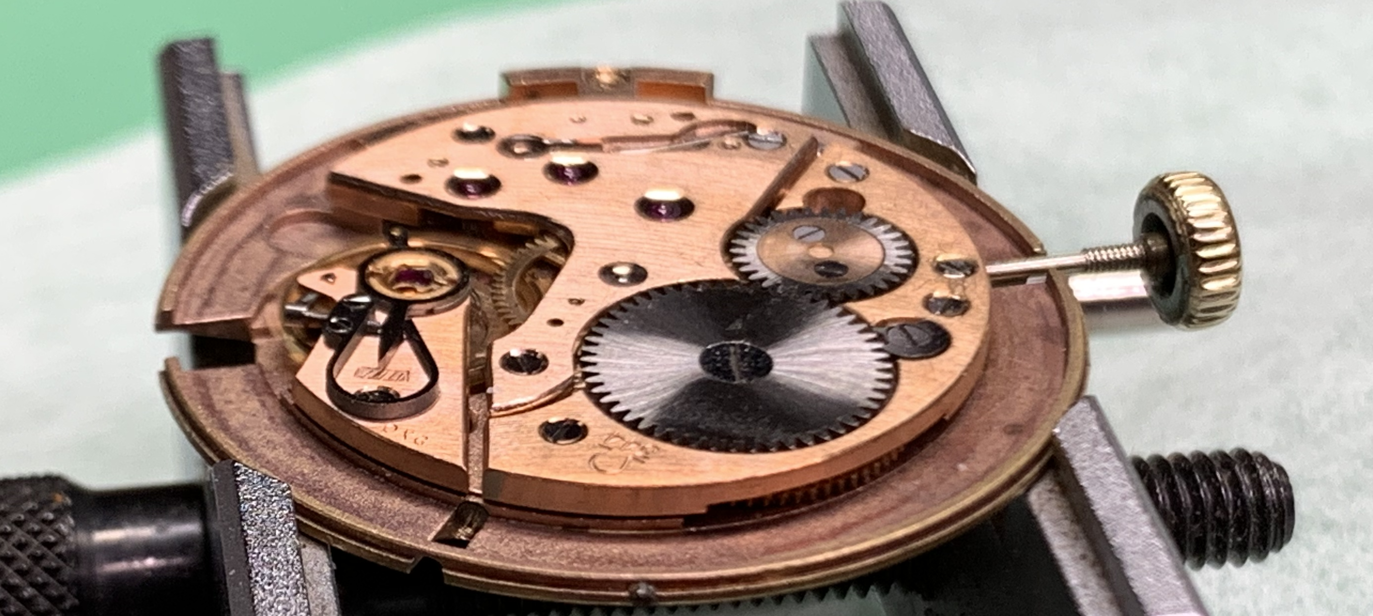

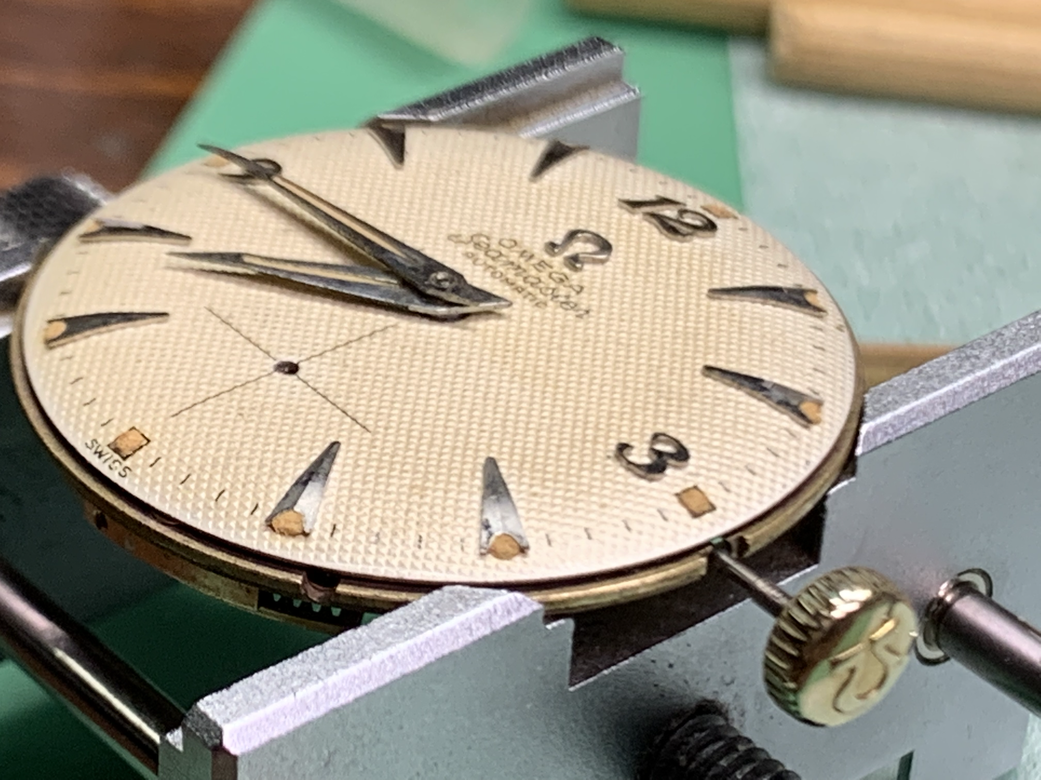

The waffel dial twin in back together.
And back in the case with all parts accounted for.
The stem and crown still need some work. The crown wobbles. It is interesting that when the watch winds the stem turns.
The sub seconds hand is also missing. That may be hard to source.
The only difference between the two watches seems to be the dial and hands.
I had not planned to clean this yet. The only reason I did it was to compare the parts to the 351.

That's an amazing pair of dials. I Can only imagine how hard it is to come by these parts after an hour, let alone decades. I know first hand how small and Elgin subsecond hand can be as it slides across the desk. How to find one in a pile on the desk, or worse an eBay listing. Ugh.
