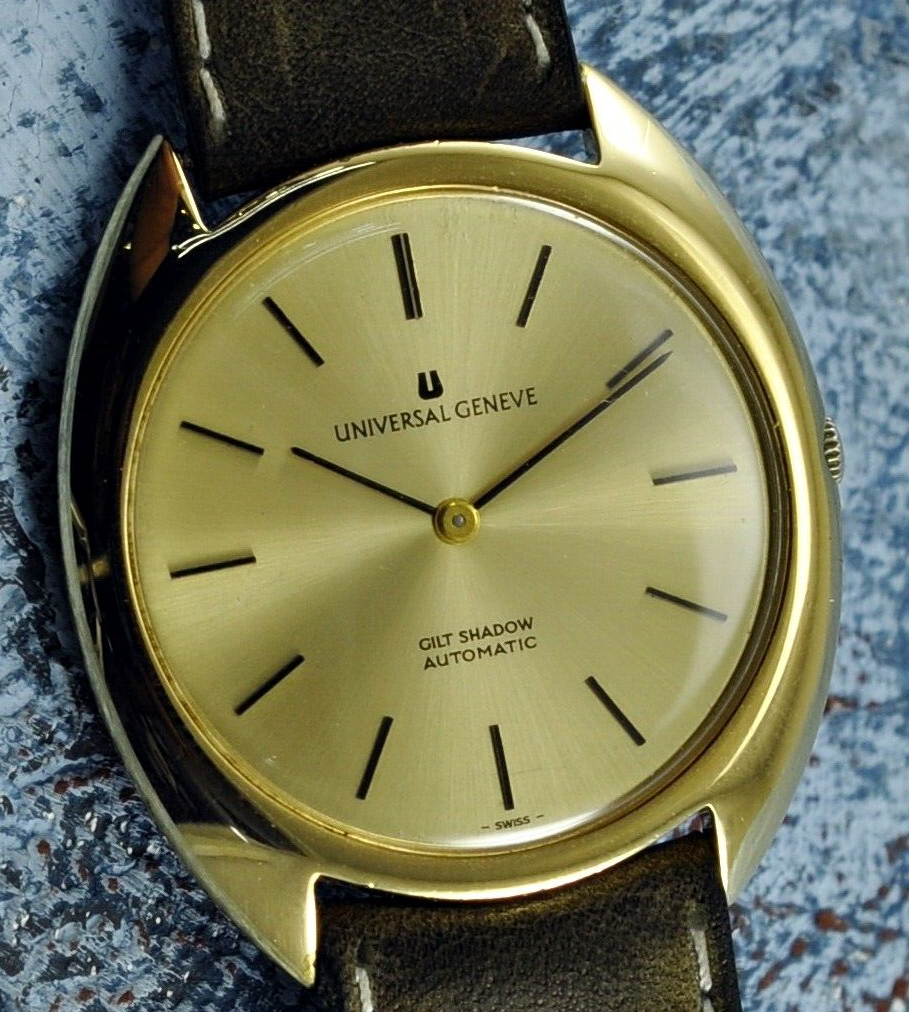

Hi all --
Realize there is limited information out there re: Universal Geneve (UG) logos, but I'm curious the community's understanding of the 1960s Big U logo. I've seen this logo with the brand name / wordmark stacked (e.g. Universal Geneve Golden shadow 18K Yellow Gold Automatic Men's Watch_636963 | eBay) as well as horizontal (e.g. 566.101 Ultra Slim Universal Geneve Gilt Shadow Micro Rotor Automatic Men watch | eBay).
While most watches during this logo generation seem to have the two words in the brand / wordmark stacked under the Big U, I've seen some horizontally written wordmarks that certainly look original. Can anyone confirm that some were originally written horizontally?
More broadly, does anyone have tips for differentiating redials versus originals quickly? Especially as many of the more complex dial variants were produced at a time when there was less vertical integration and standardization in the Swiss watch industry (and replacement service dials were common).
Thanks in advance!

I'm certainly no expert on the later watches with fat u logo, in fact just the presence of the fat U logo is enough to persuade me to look elsewhere.
It seems that the horizontal text format was much more common with the earlier logo with the printed thin U in a box. The stacked text format was much more common with the fat U.
However, both of those dials look completely legit to me and there are plenty of other examples of the fat U logo with horizontal text (an online search for Universal Geneve Gilt Shadow will reveal others).
More generally, identifying redials is largely common sense (i.e. does it look right? is it the same as others?) but the more dials you've studied, the quicker that process becomes.

Stacked wordmark example from above:
Horizontal wordmark example from above:
