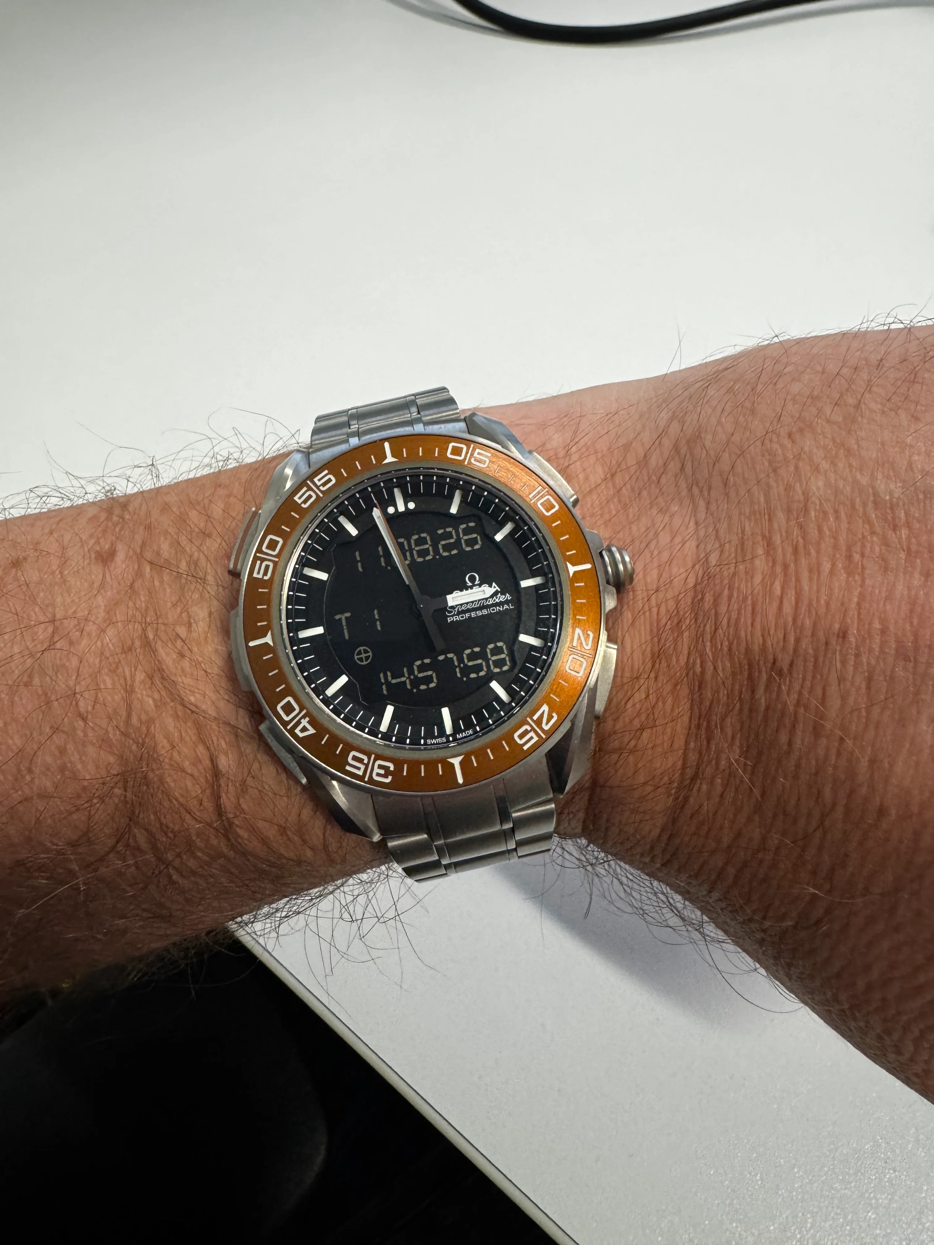

Here's mine, our exchange cused me to pull it from the safe 😀:

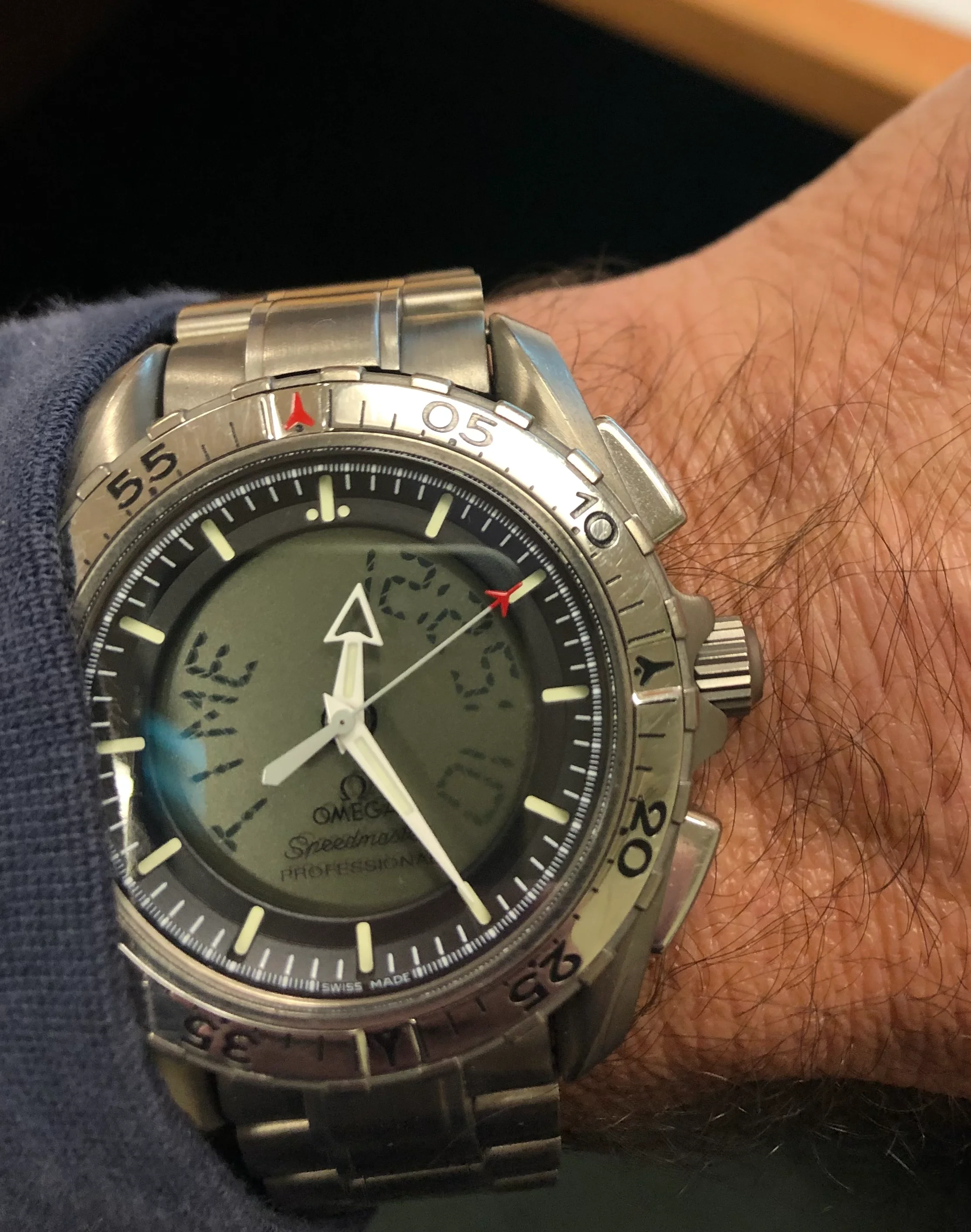

I expected my Gen-1 X-33 was going to get a new movement, after my battery issue, but it turned out to be dirty battery contacts... so you never know.
(Gen-1 is not supported by Omega officially, and why it went to Australia as did my '68 speedmaster)
