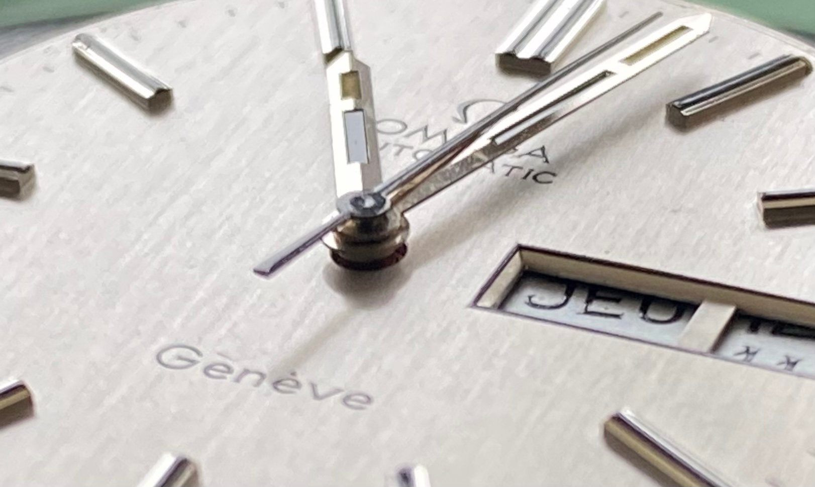

Like the title says… it’s an omega 1022 caliber. If I try to push the hand through the pinion that goes on (in the middle of the hour and minute hands) that same pinion goes down as well (and up again when I stop pushing).

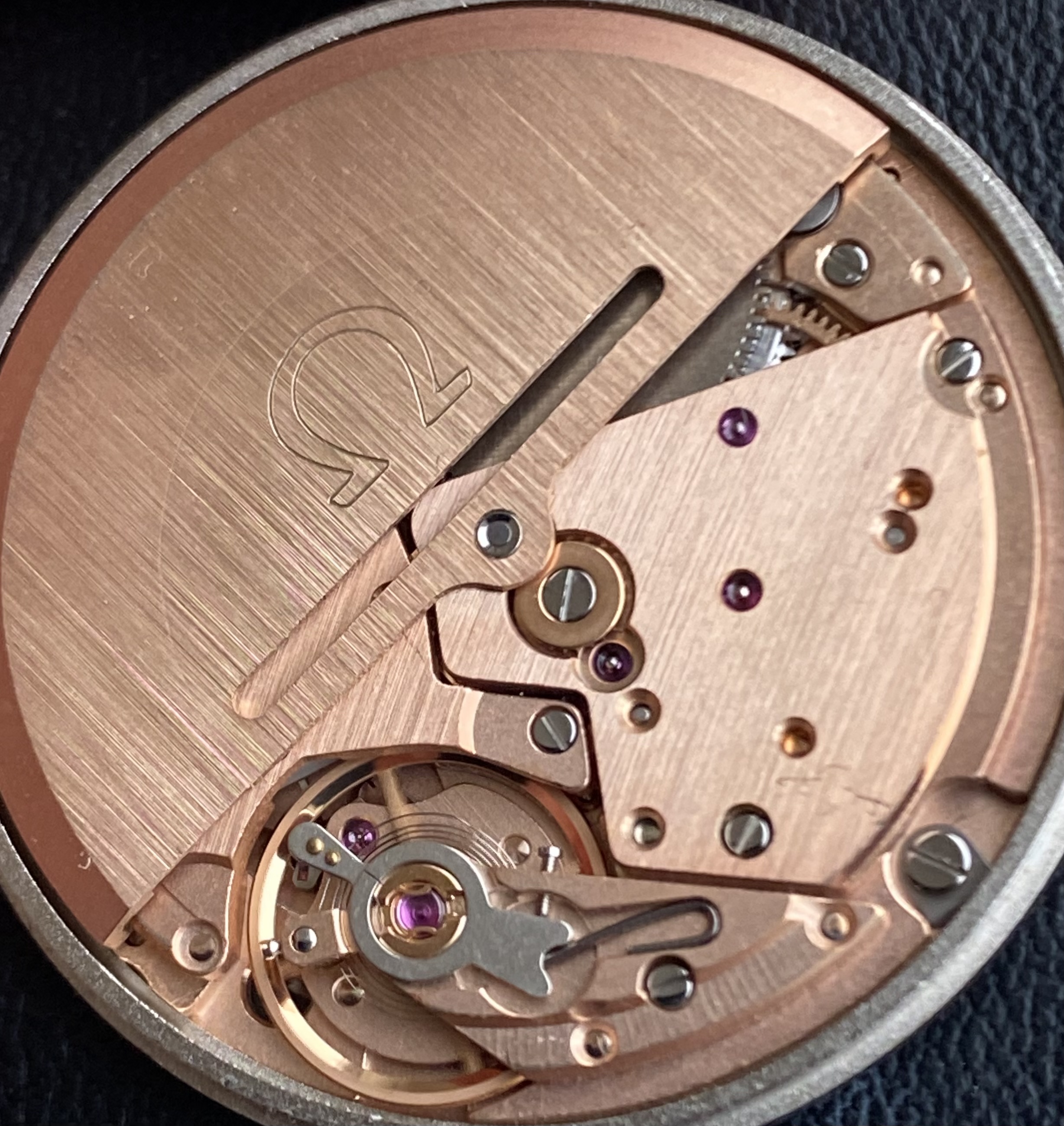

Would need to see what is (or is not) supporting the other end of the seconds pinion on the watchmaker side of the movement.

I'll Archer explain further but you will need to gain access to the back side of the second hand post and brace it. Poorly worded but at you try to push the hand on the post, the entire post will push down not allowing you to properly install the hand.
If you are unsure how to safely perform this, you should take it to a watchmaker. The counterweight will need to be removed.

356

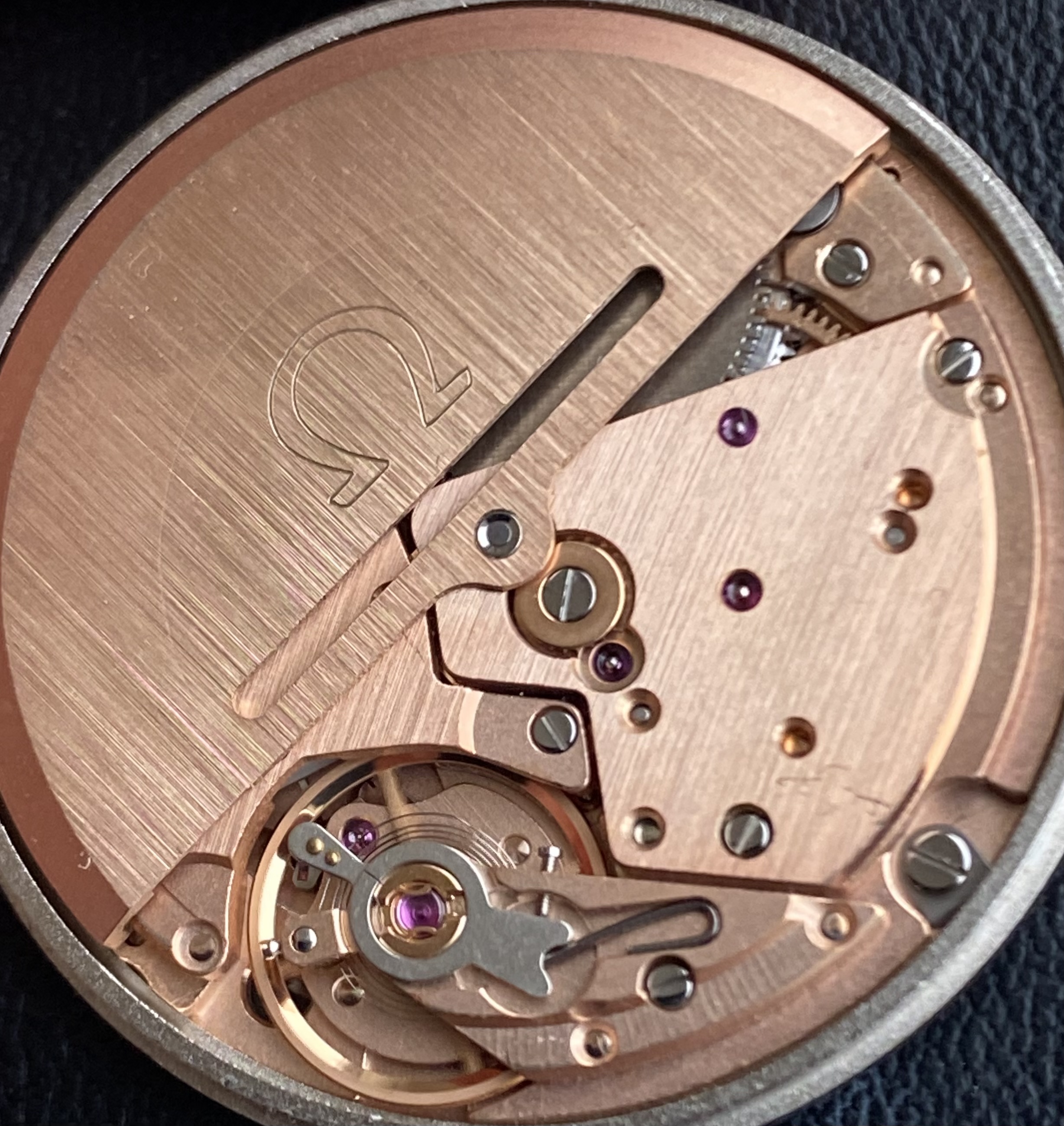

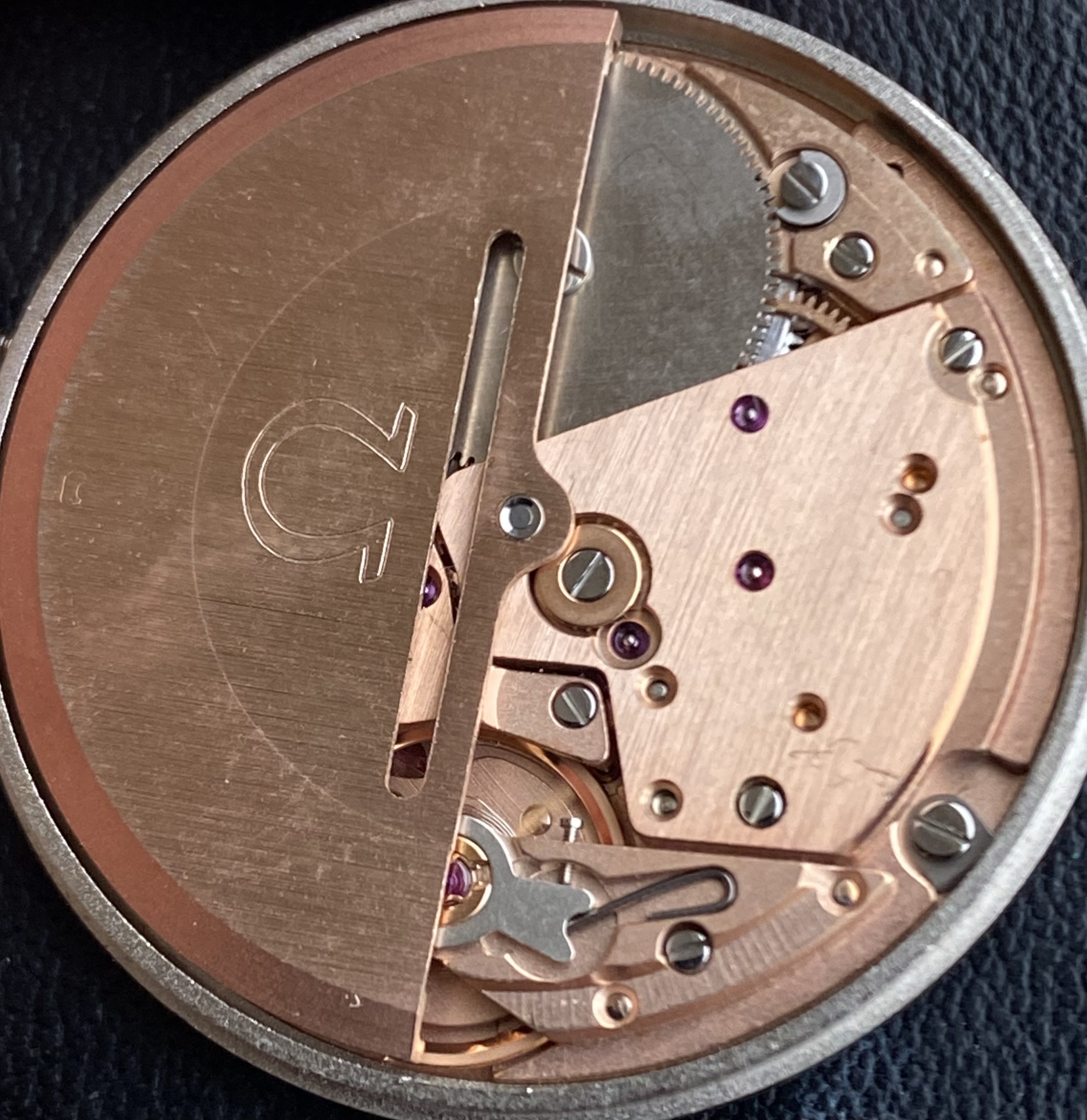

Thank you all for your help. Here are a couple of pictures of the movement side
I understood exactly what you meant and I was able to finally do it. Is this normal/good practice, though?

Remove the automatic winding system, and use a movement hold that will support the sweep seconds pinion.
That’s exactly what I did 😀 wasn’t that hard after all
