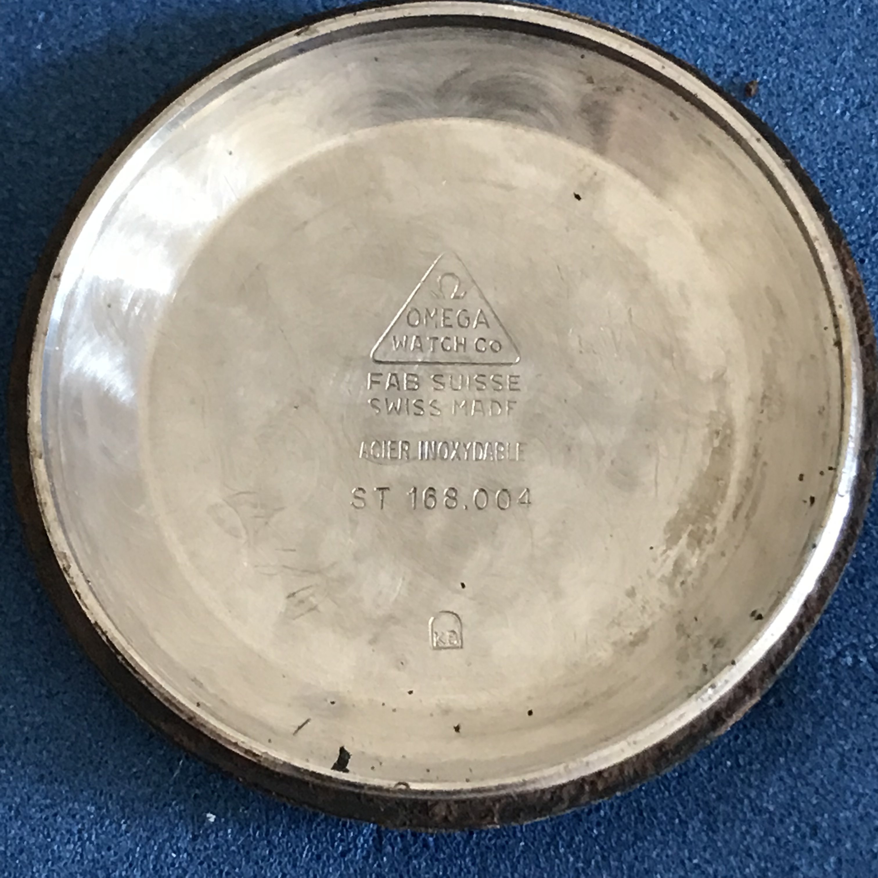

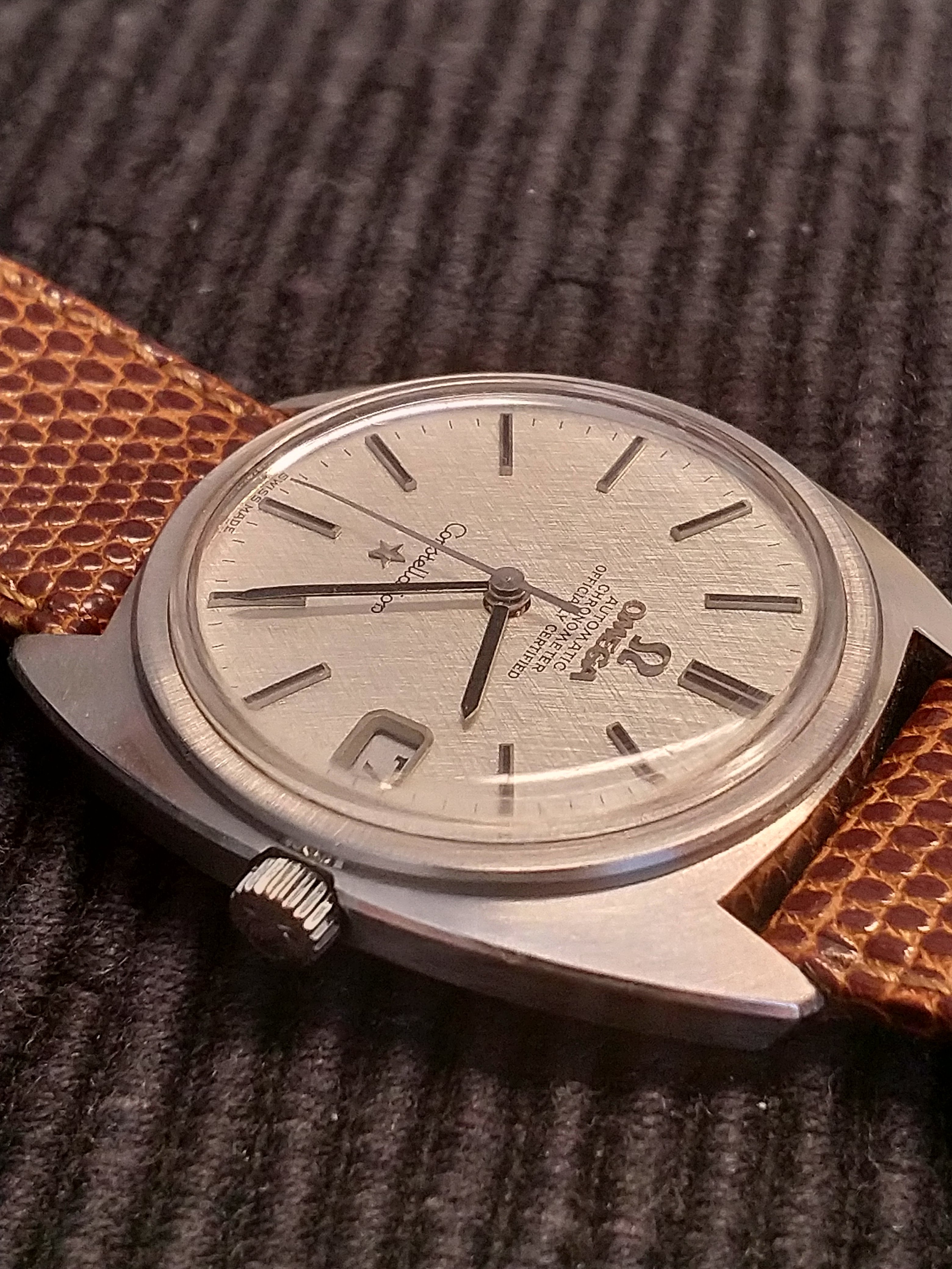

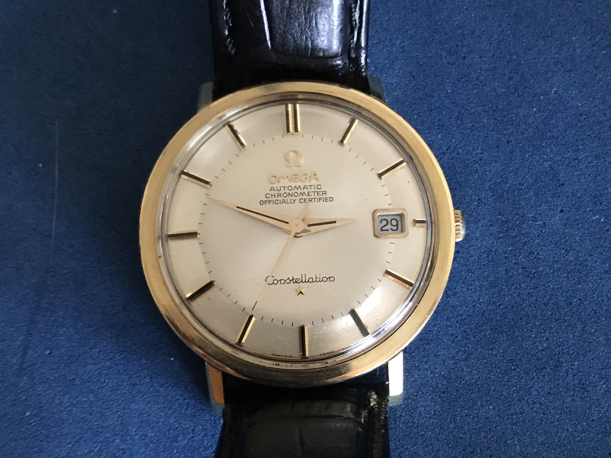

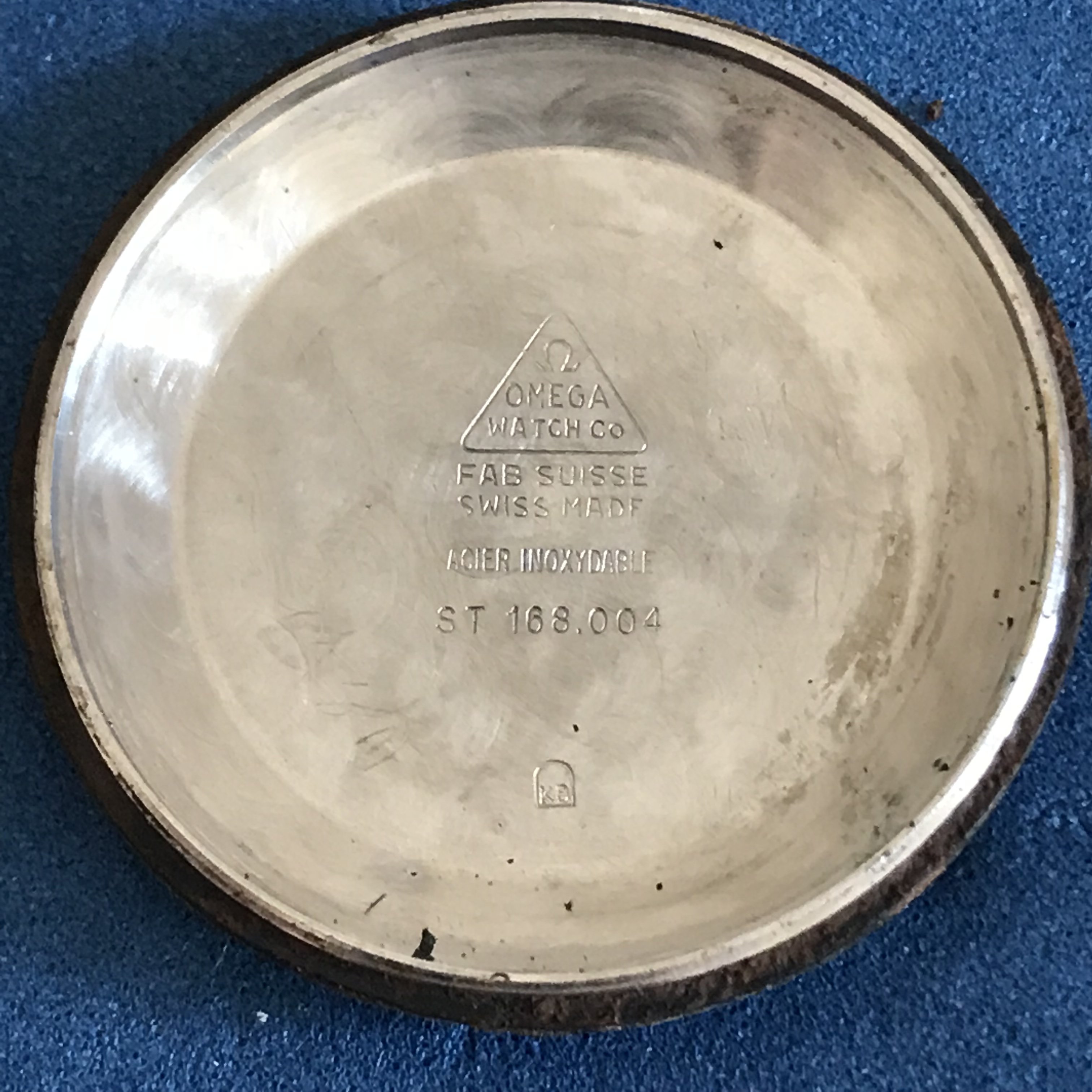

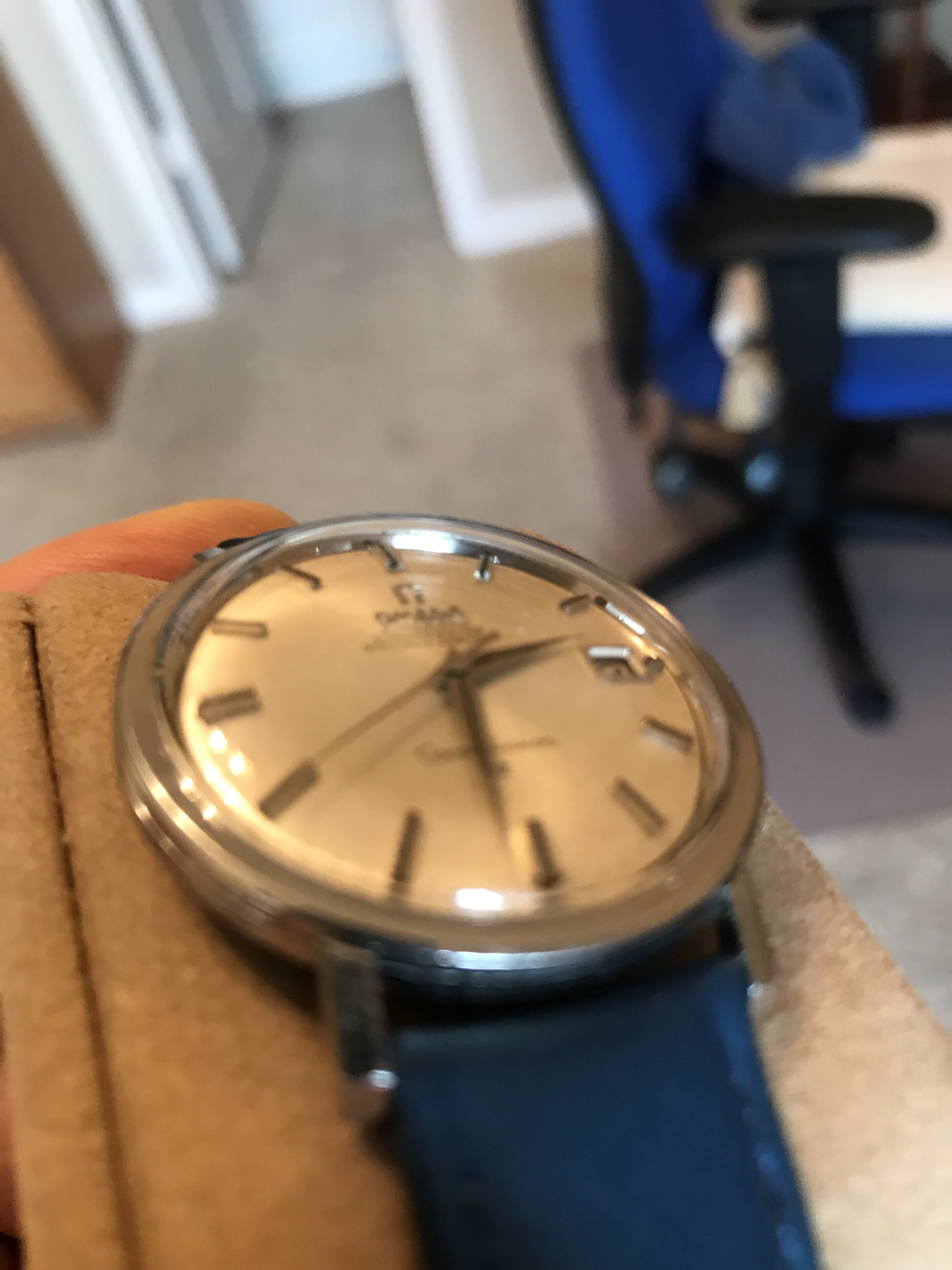

I dont have a favourite, but i would sure like to know who case maker KB is, as i have several hidden crown connies with this mark on them
18
3
Interesting. Lovely constellation. I'd like to know more about KB too. Really inadequate info on it.

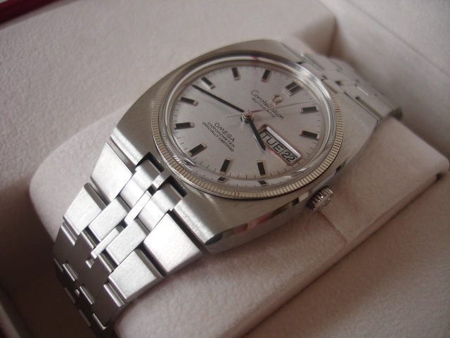

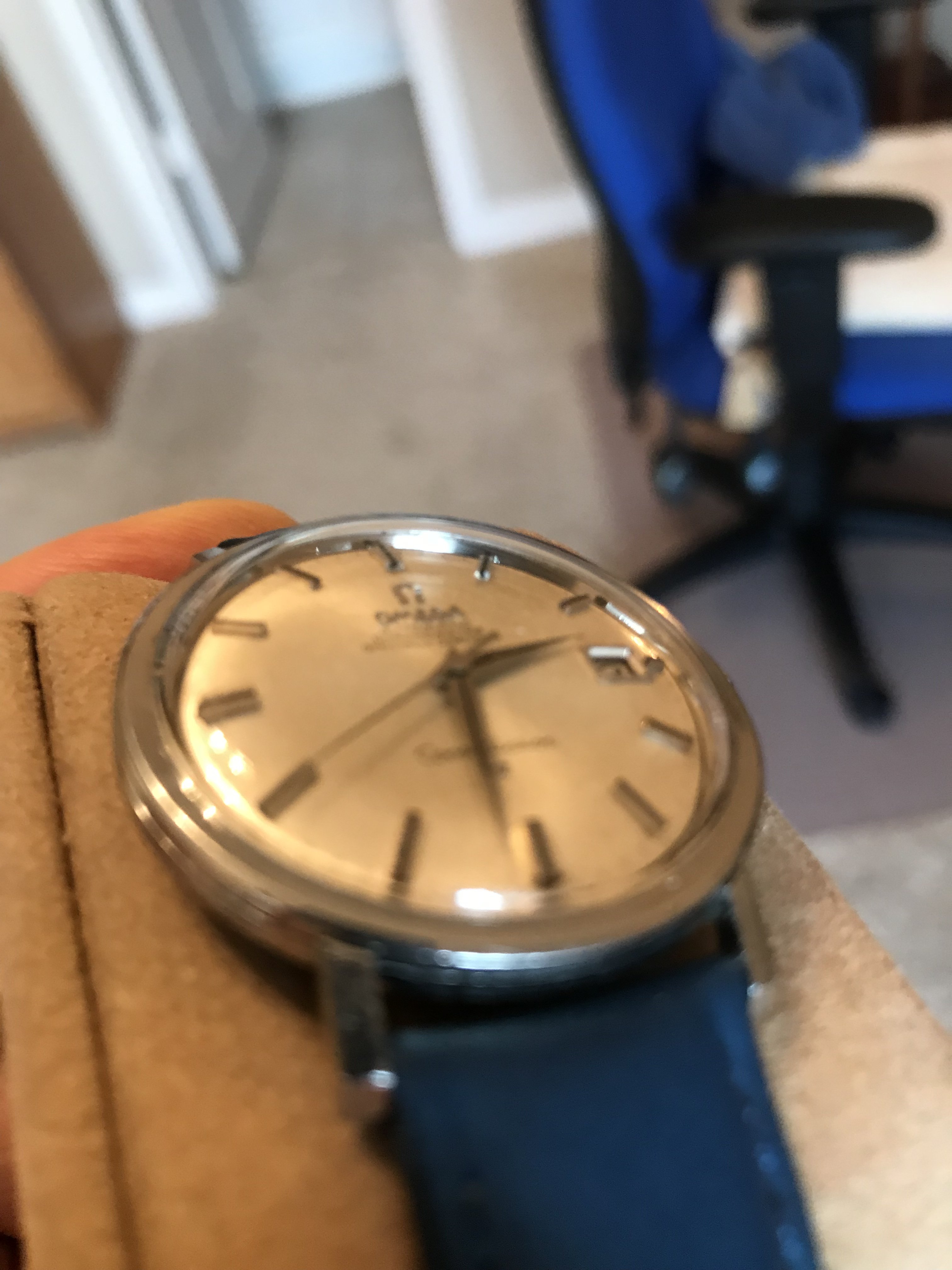

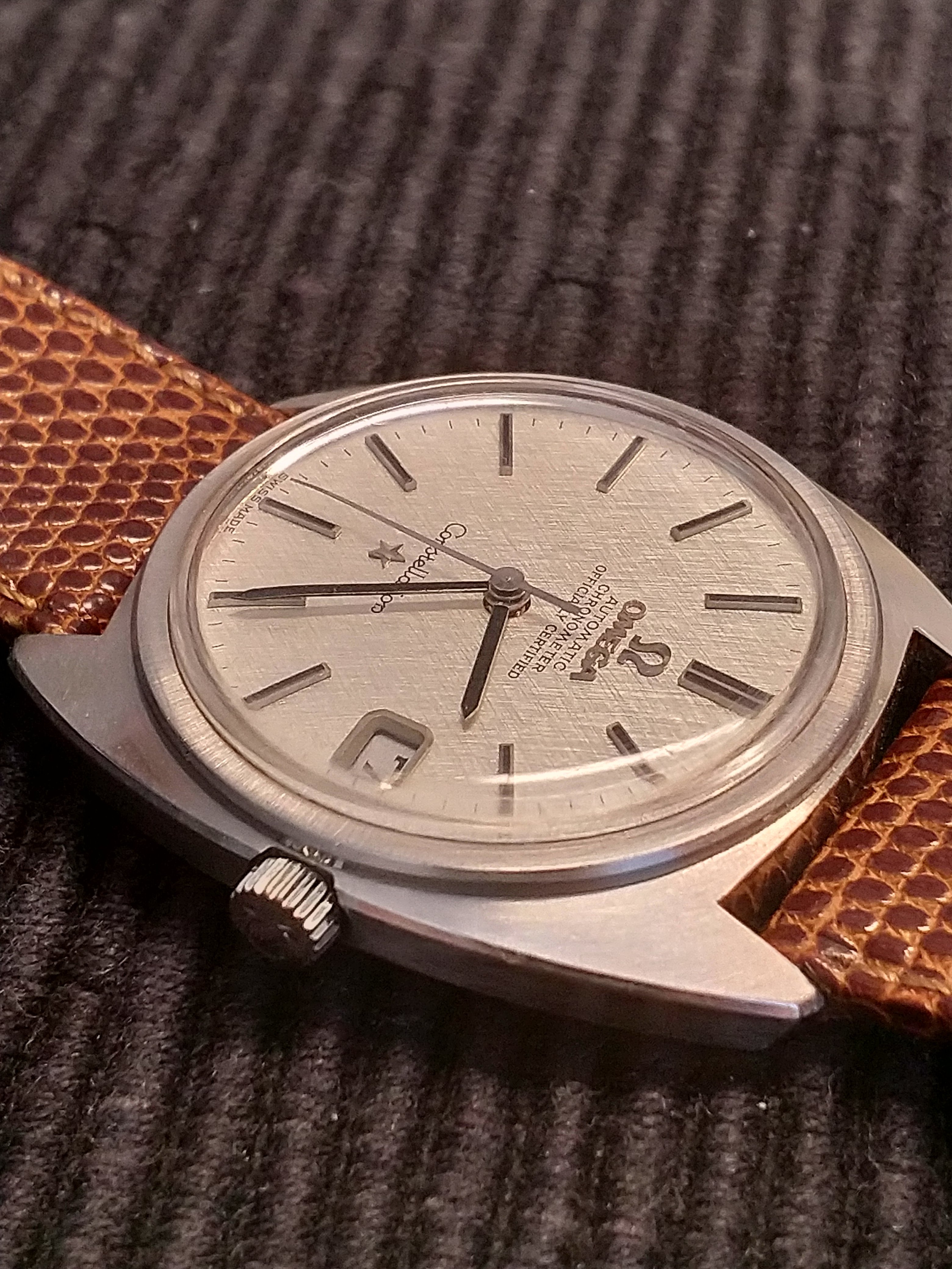

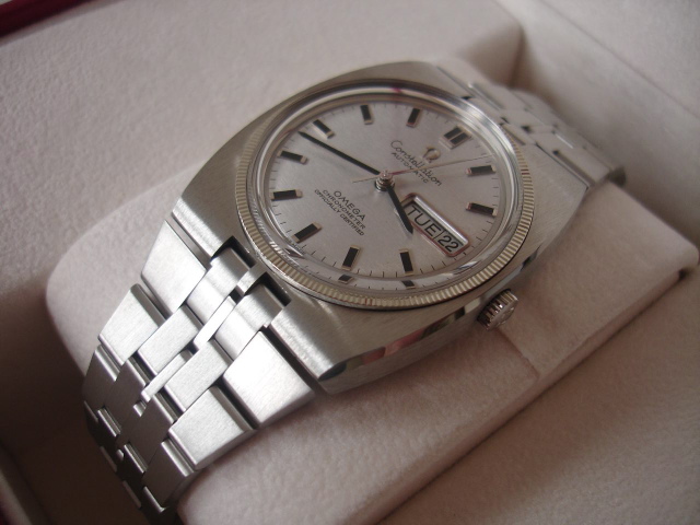

And while we are at it, does anyone know who SF were/are, who made the cases of the connie ref 168.045 (ST 368.0845) integrated bracelet models
i dont have a photo of my one, but here is a photo of a much nicer one shamelessly “borrowed” from the web ( apologies in advance)
I have a 168.0058. Looks similar

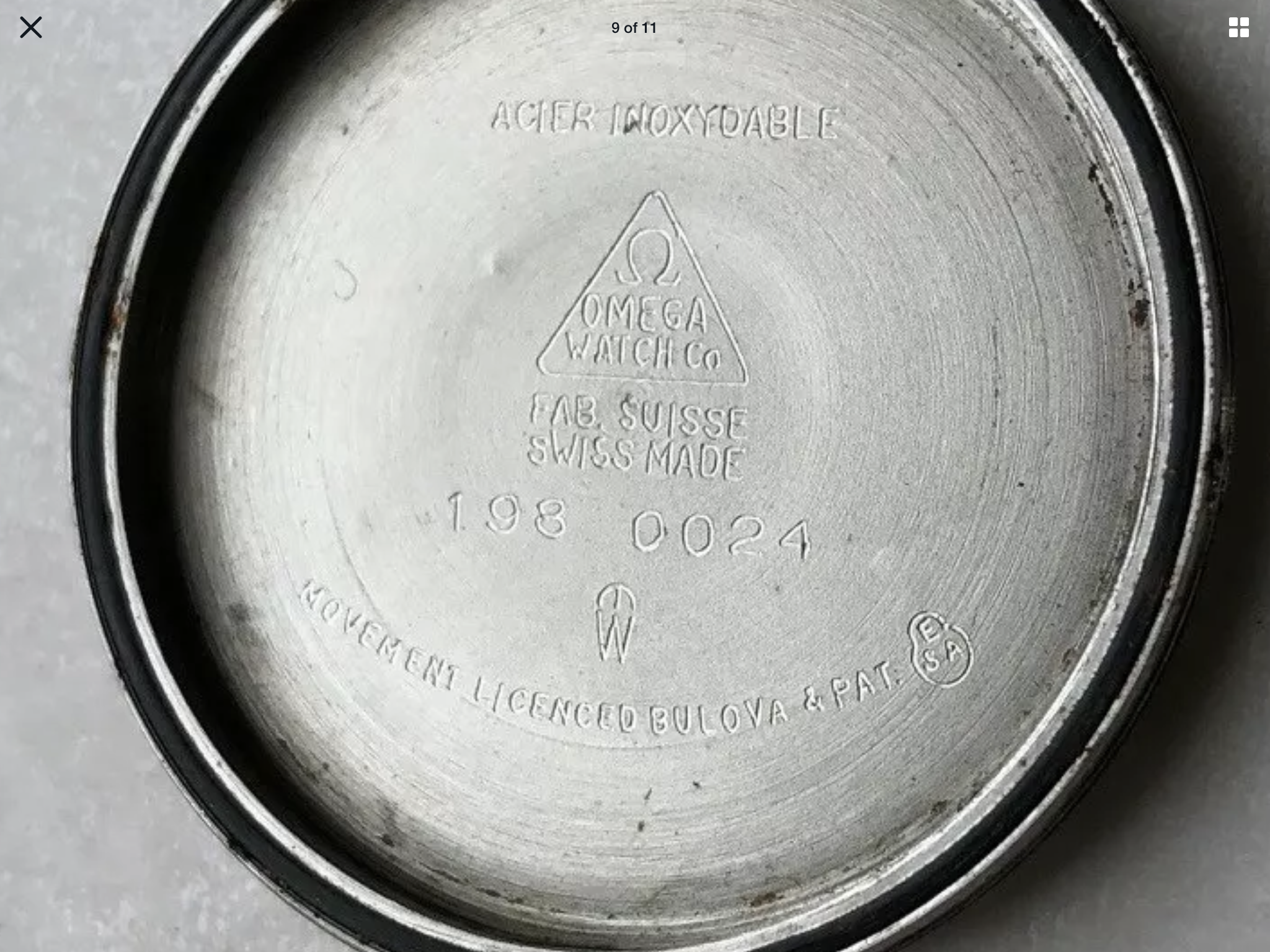

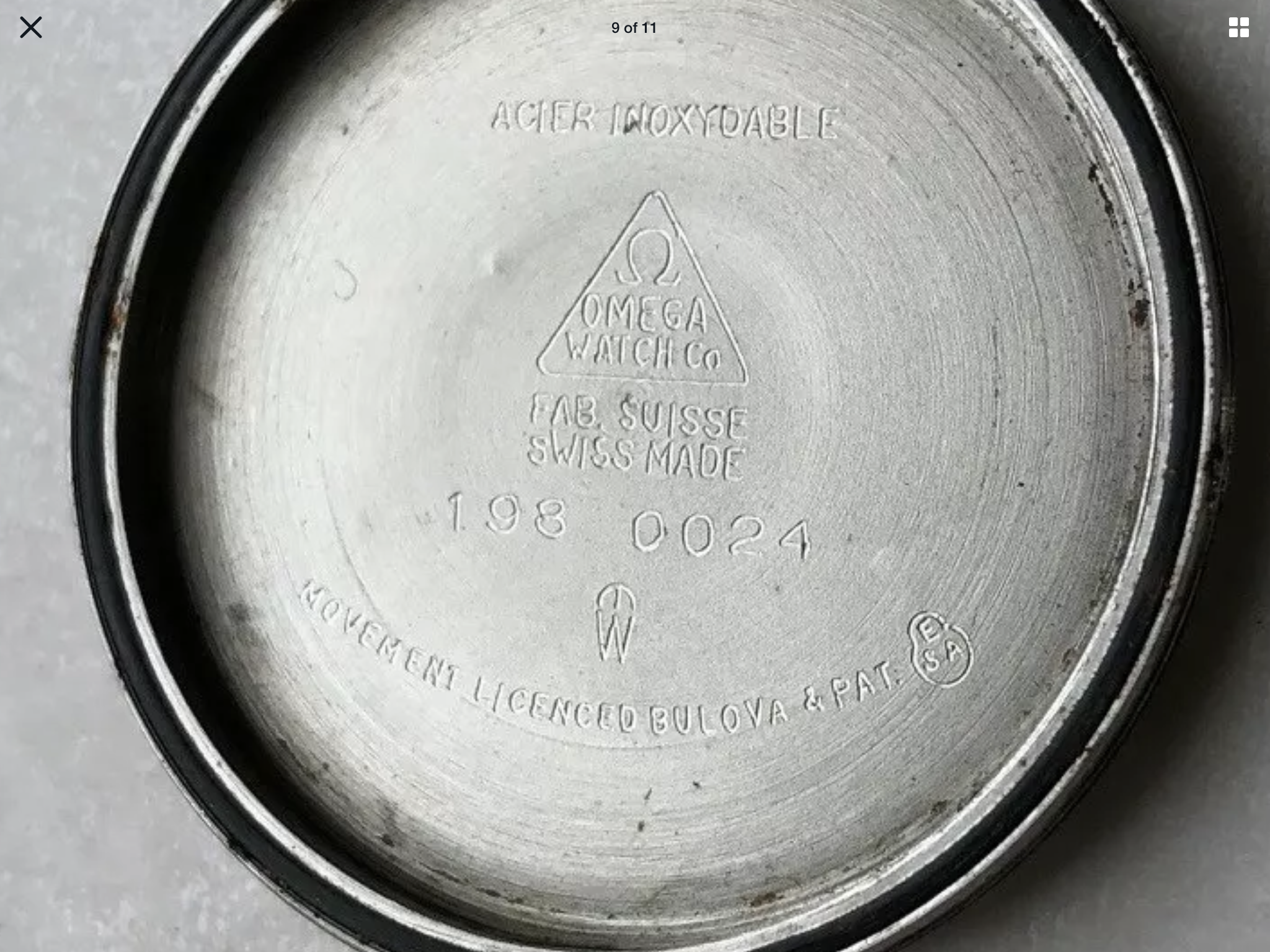

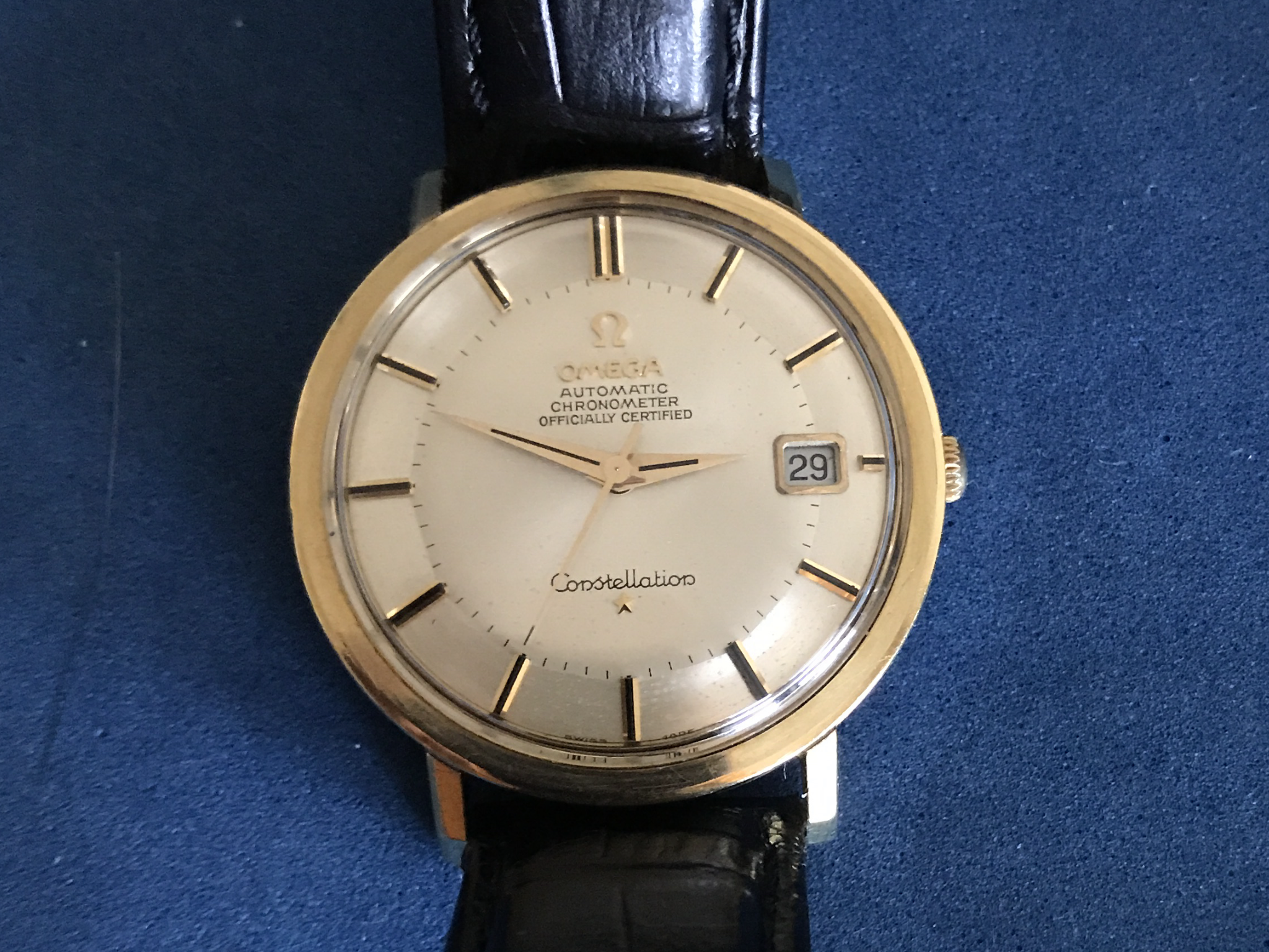

Another one for you, if I may?
anyone know the case maker, of what looks like an EW, found on this F300 Omega Connie Hummer, ref 198.0024 please?
