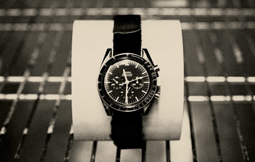

One last note... the only photos I have seen on the subject of the destructive NASA testing of the wristwatches, are no TEST photos but more probably MAINTENANCE photos as the Speedmasters shown are clearly "Professional" dial with crown guards 105.012 versions
( 1968 NASA photos ? ).
It's even a 105.012-66 CB 😁

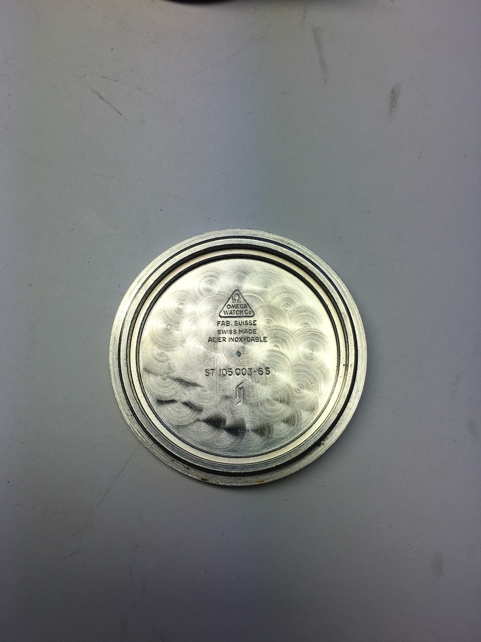

Did anyone ever end up figuring out the manufacturer of the -65s marked ZL? Or was it ZJ?

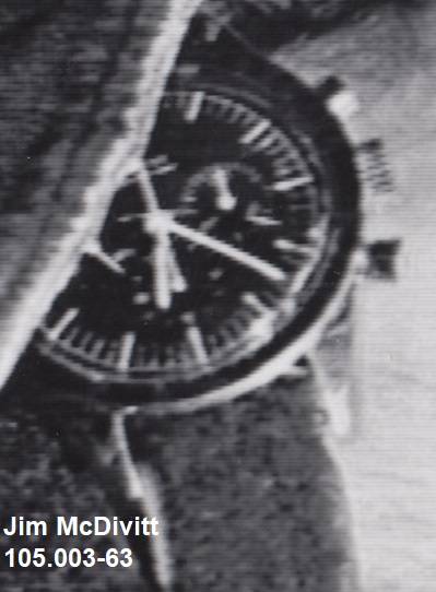

Well this is a farce.... It's clearly just a marketing ploy by omega exaggerating the guess work by us fan boy's. Fact is, seems to me we don't actually know. Nobody can lay their eyes on either of the watches - we simply don't have them... seems we aren't any closer to knowing than we were decades ago. Those quoted serials indicate a 105.002!!!! According to MWO they were simply not in the 105.003....So what gives here? IMO!

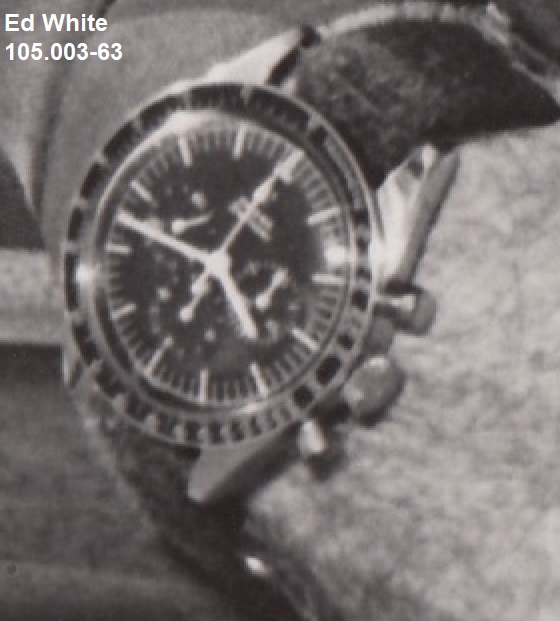

Maybe it was a 105.002-62 with baton drop hands? The moon watch only book states the 105.002-62 was also fitted (? later) with baton drop hands......So what makes everyone 100% convinced he wore a 105.003? Are the close ups of the bezel 70, case and pushers good enough to tell? And if he did, was it an early 63?... with a Swiss Made (only) dial? Has anyone seen the close up of the dial? And if it was one of those (do we actually know?)....well aren't those serials quoted in that fratello article a load of bunkim?

Look at the light shining off the inner rehort (at around 10) of the watch on Ed Whites arm?...Are these two photos good enough to exclude a B1 bezel, small pushers and a silver rehort ( found on the 105.002-62?)
I would say. Also, I can swear there is a ‘t Swiss made t’ on the dial in the top one. However : I’m fairly certain Omega know exactly what was delivered to NASA. They have all records. And there is no need for them to make such details public, other than to kindly be let known what sub reference was delivered/worn etc.
A good question. I've been looking out for an answer for that for years. It looks kind of like rj to my eye. or maybe a stylised g?

If Omega delivered 105.002s to NASA it would be known. They would know it. They also would have told it as such to all the sources quoted in this thread.
