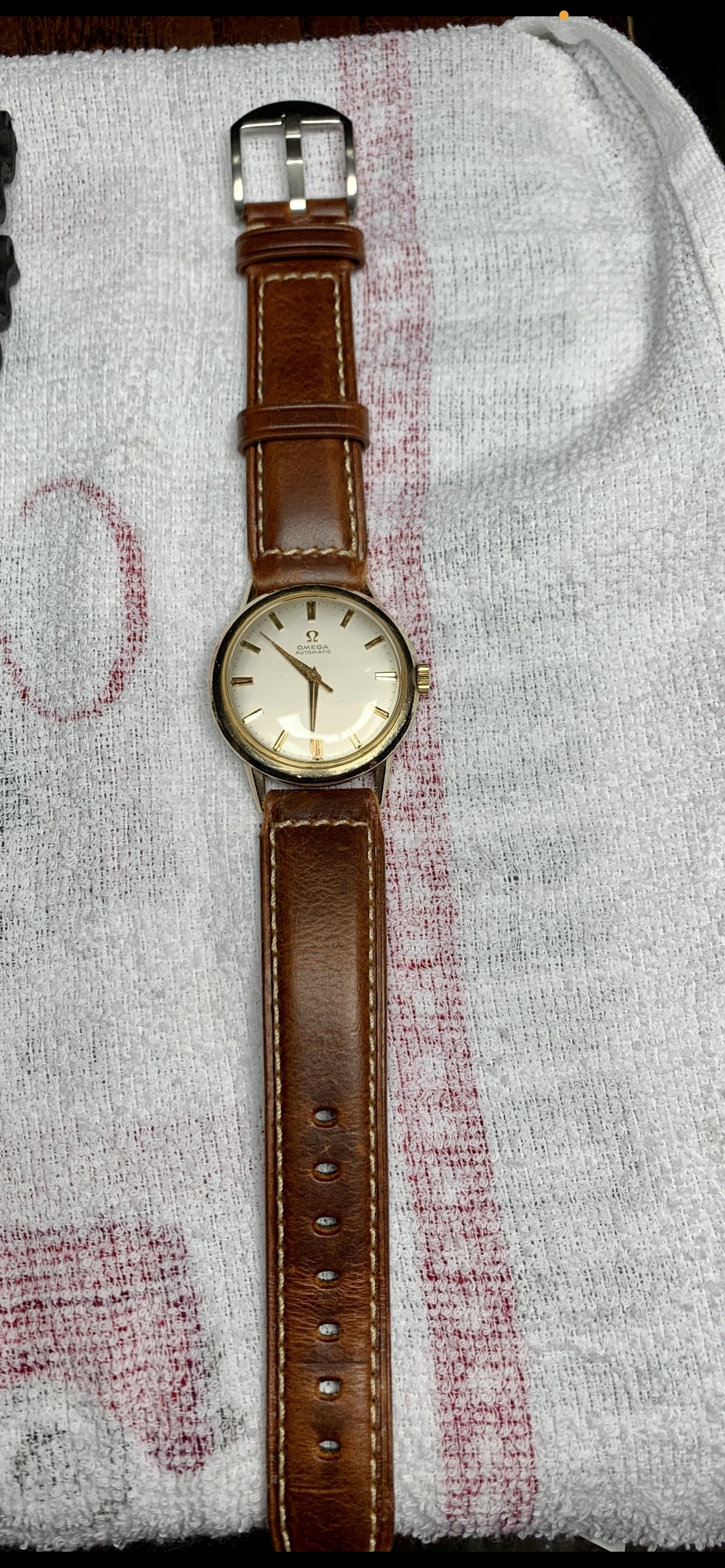

Hello, I am new to the forum so please forgive me if I’m not using proper etiquette. I received this Omega automatic from my father who has passed on many years ago. I was wondering what year and model it is? Any info would be greatly appreciated. John

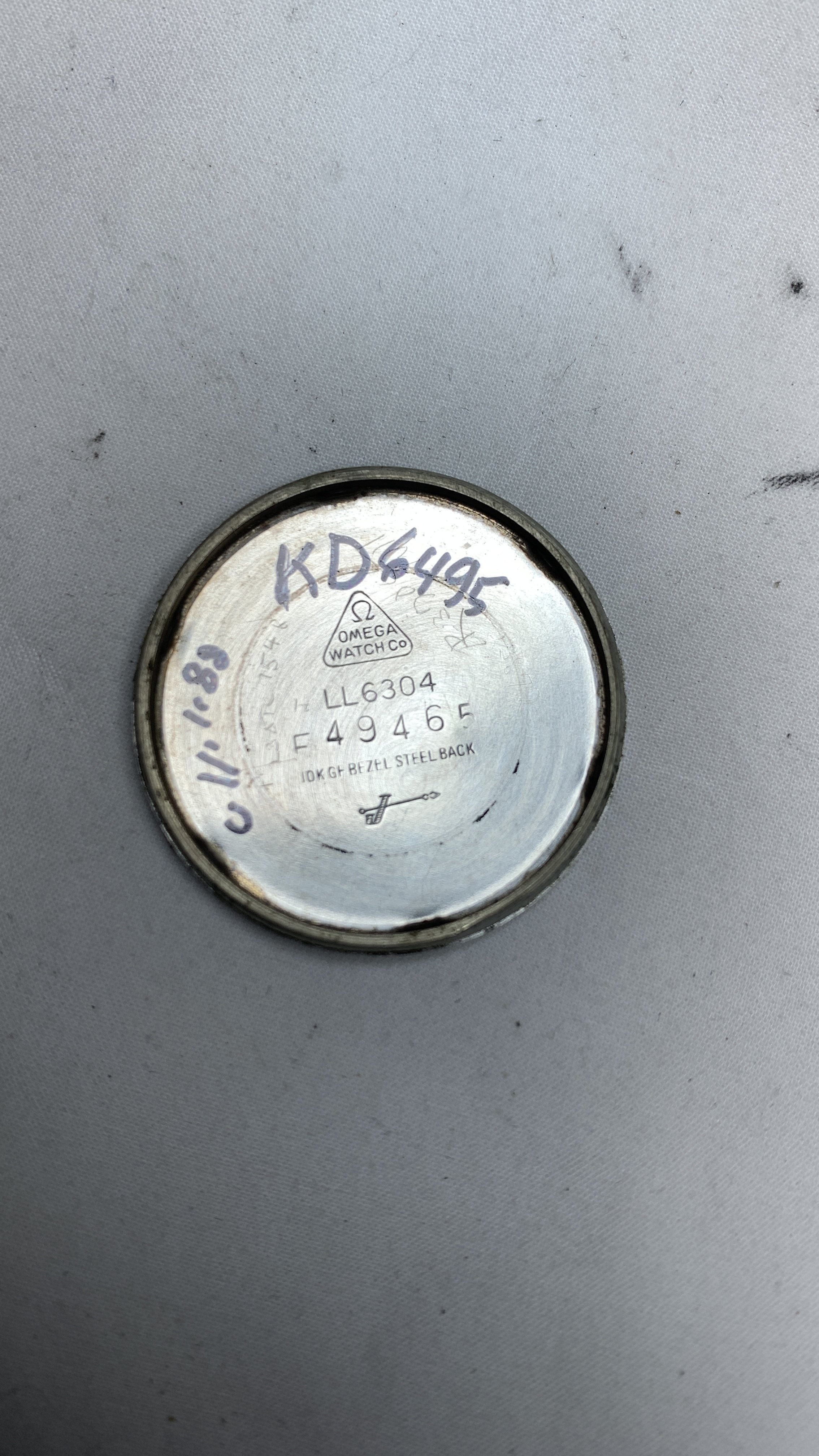

You'll need to get the case back off. If you're not comfortable doing it without causing damage have a watchmaker do it. The inside of the case back should have a reference number and the serial number on the movement will give you a good idea of the year it was manufactured. Many older watches like this didn't have a specific model name.

I found somewhere around 1957-1959. It has lume on the hands and the markers. Also, it has just Swiss not Swiss made below the 6 o’clock marker.

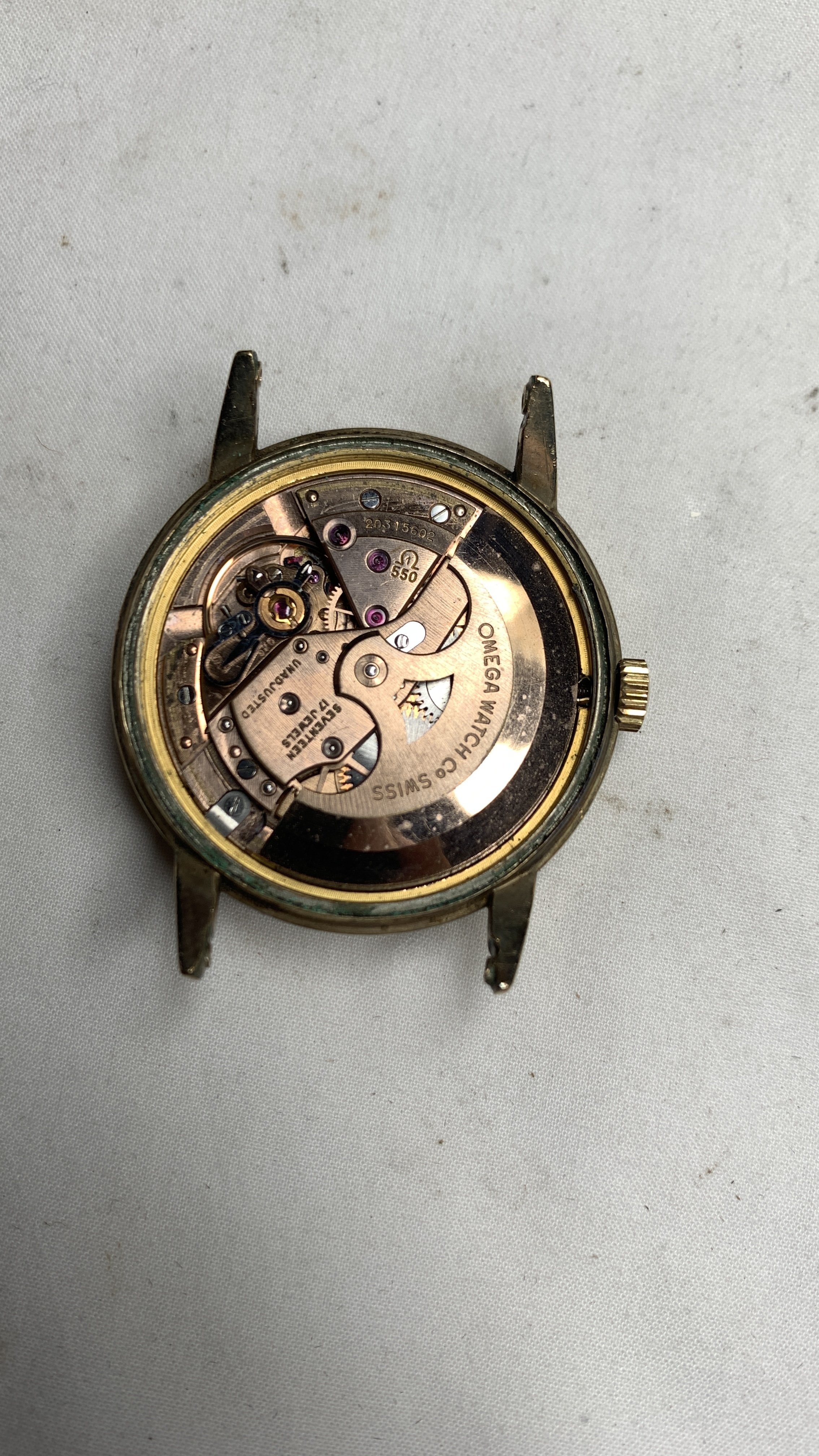

So I took the back off and this is what I have. Started looking online to break down the numbers. Not to easy. Thanks again

No no, I appreciate it. It looks like it was serviced back in 1982. So it’s been 40 years. I thought it had never been serviced. Thanks again! John

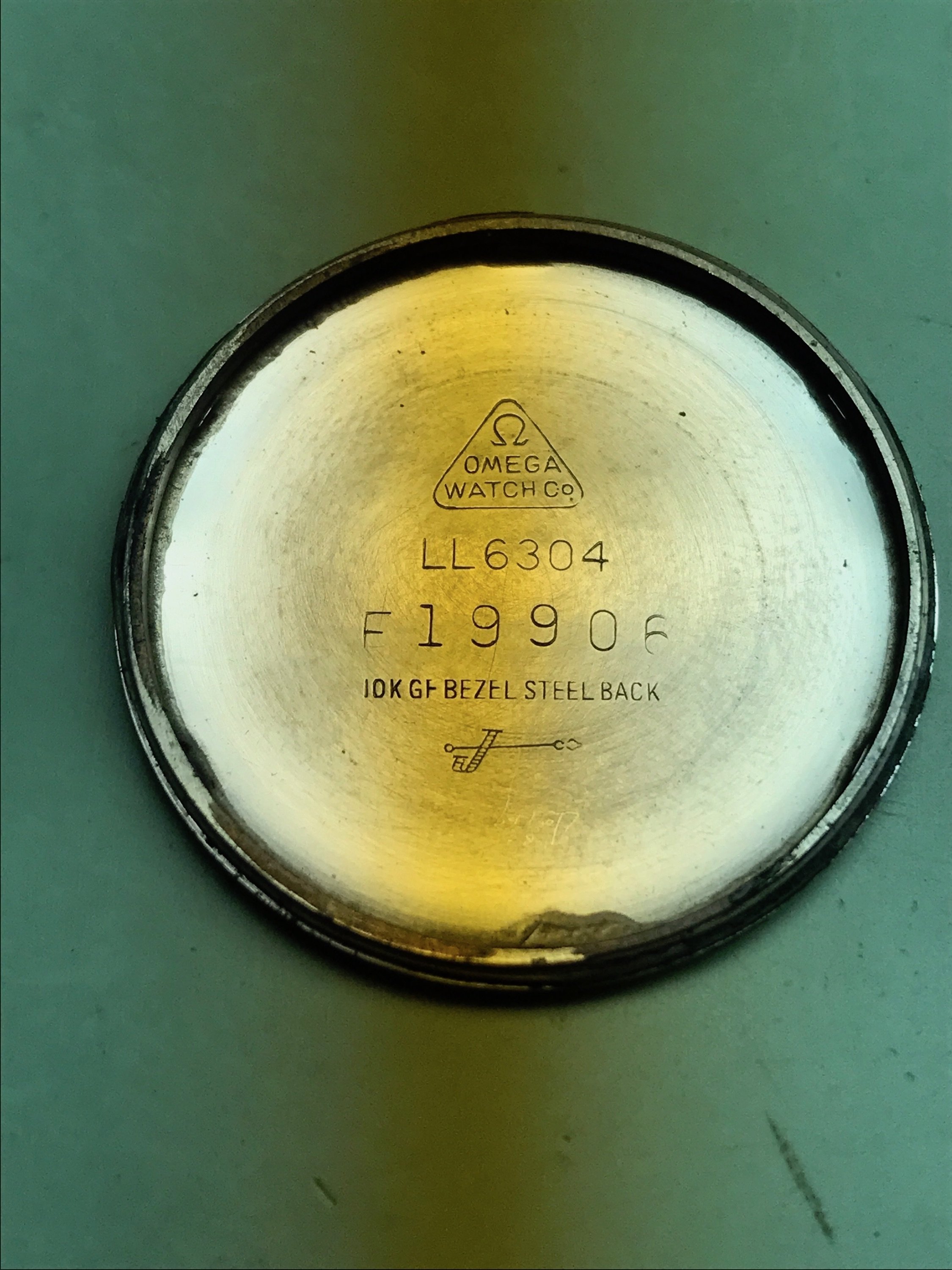

Awesome Thanks! Does f 49465 mean anything?
I am guessing it is a case serial number, but I may be wrong.
