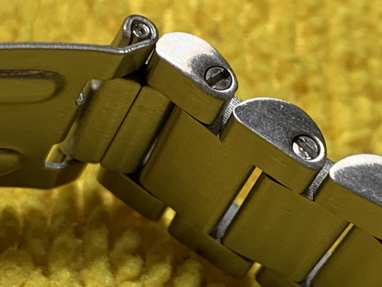

When swapping out a bracelet clasp on a Forstner 1450 for an OEM Omega clasp, what tool is needed? I'm not talking about screws or the spring bar to adjust sizing on the clasp, but rather what looks like it might be a pin on the hinge of the clasp where it meets the bracelet.

Please show a good photo under high magnification. Is it a press-fit pin?

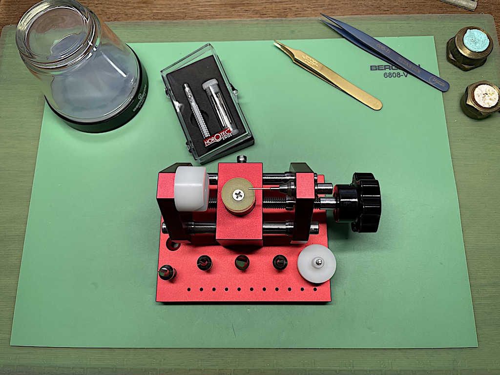

If it's a friction pin, this video will show you how to handle it. If it's a rivet, you'd have to drill it out, which is not a job for the faint of heart.

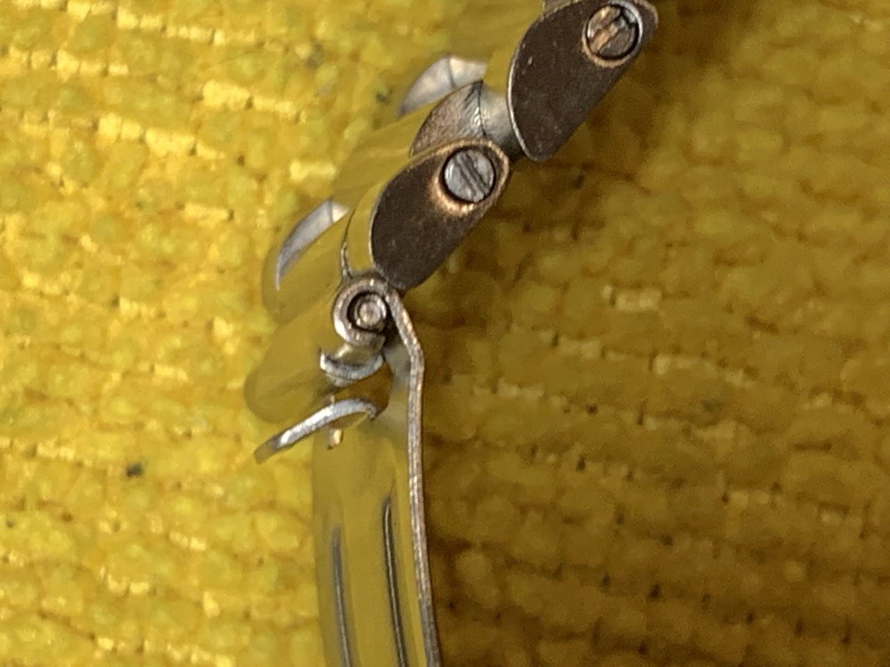

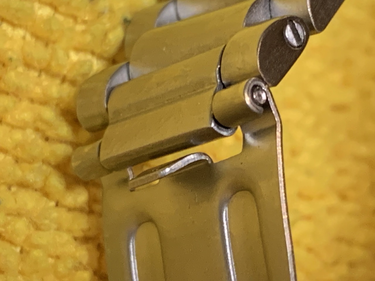

Here are pics. This is a Forstner 1450. I'm referring to the hinge where the clasp meets the bracelet. (I'm not referring to the screws in the links). I want to remove the Forstner branded clasp and install an Omega branded clasp for a more OEM vintage look.

You can either hammer it out with a pin (as shown in the video) or press it out using a tool like @JimInOz showed. There are cheaper versions of that tool that will work, but aren't built to last.

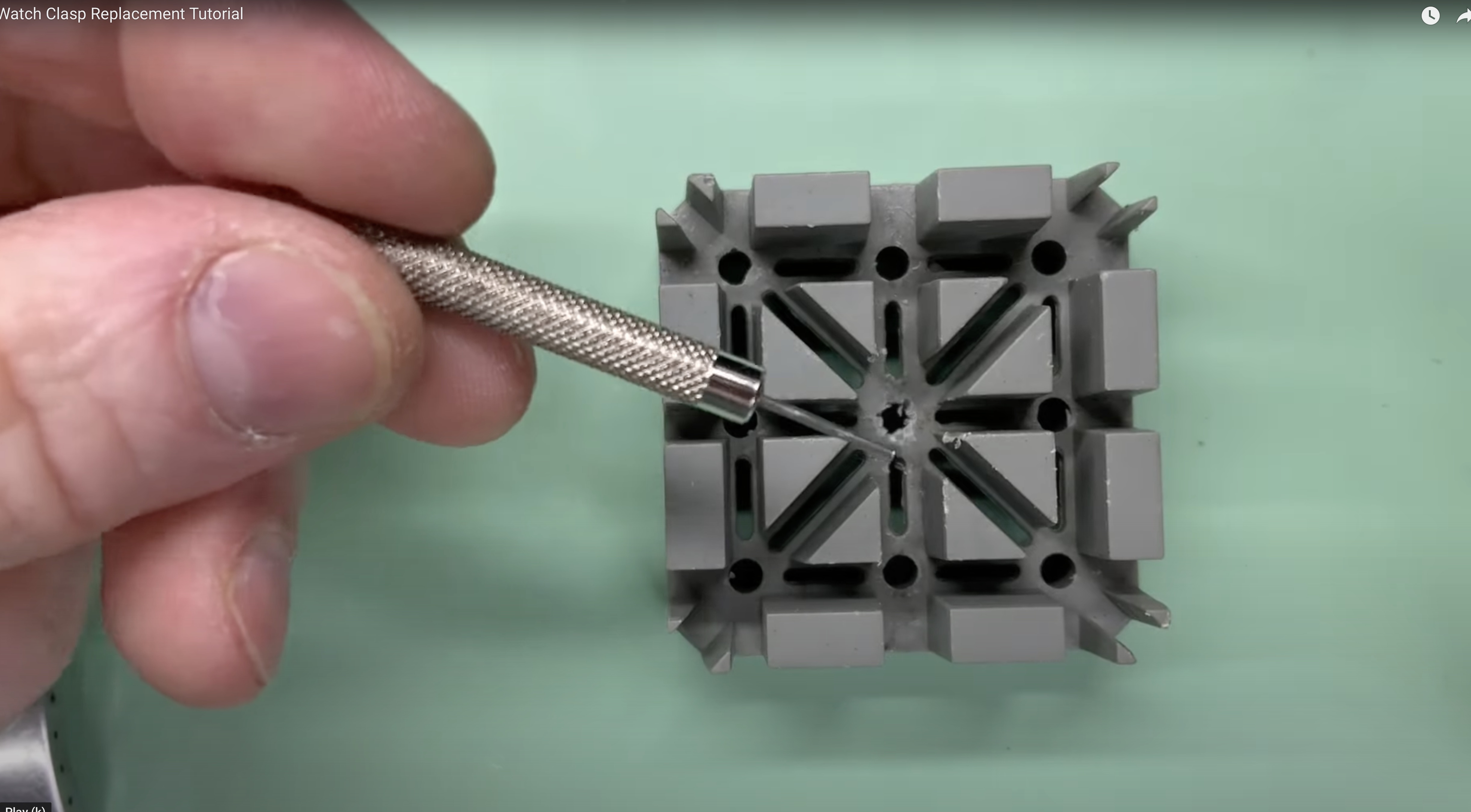

Thanks folks. What tool / part number is this that is used in the video to drive out the pin?

Search Amazon for "watch bracelet tool" and you will find a bunch of cheap kits. You can also buy those punches separately on Amazon. Search "watch bracelet link punch" or similar.
