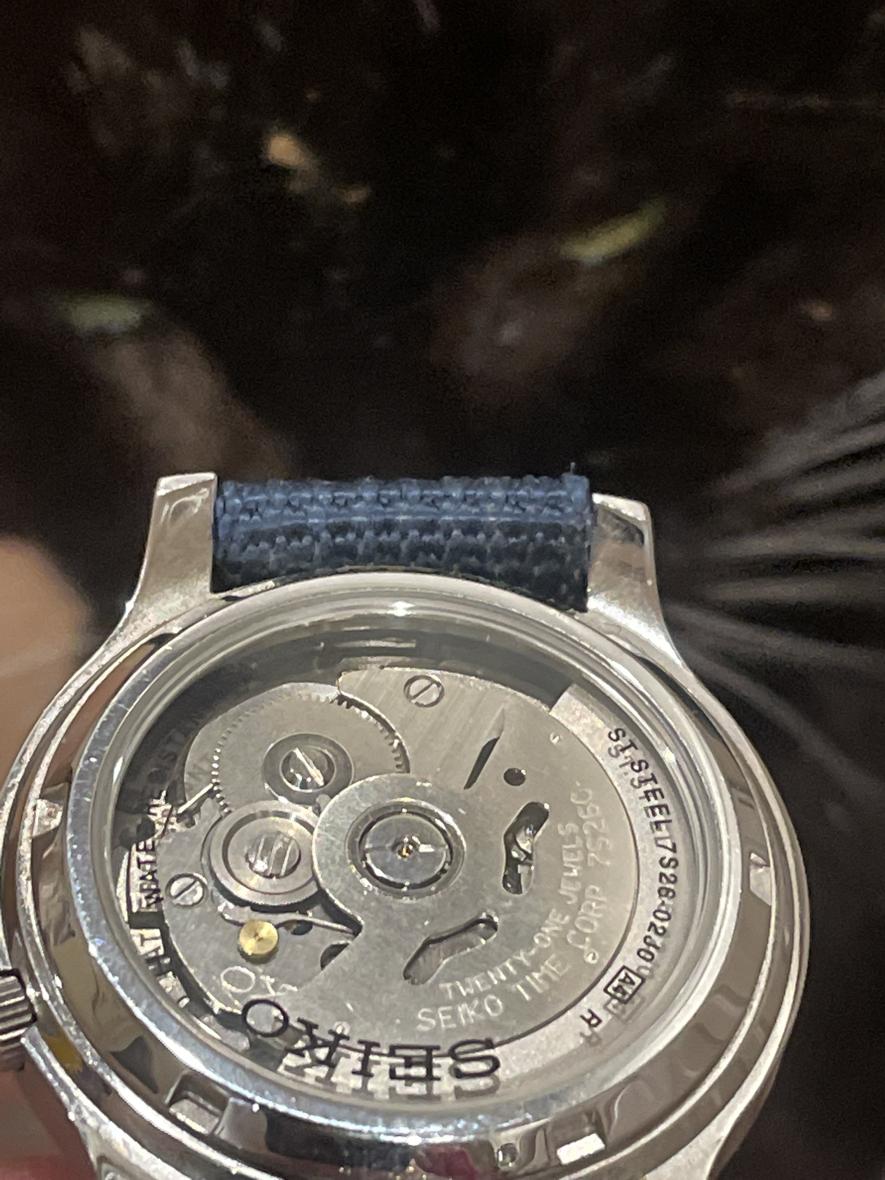

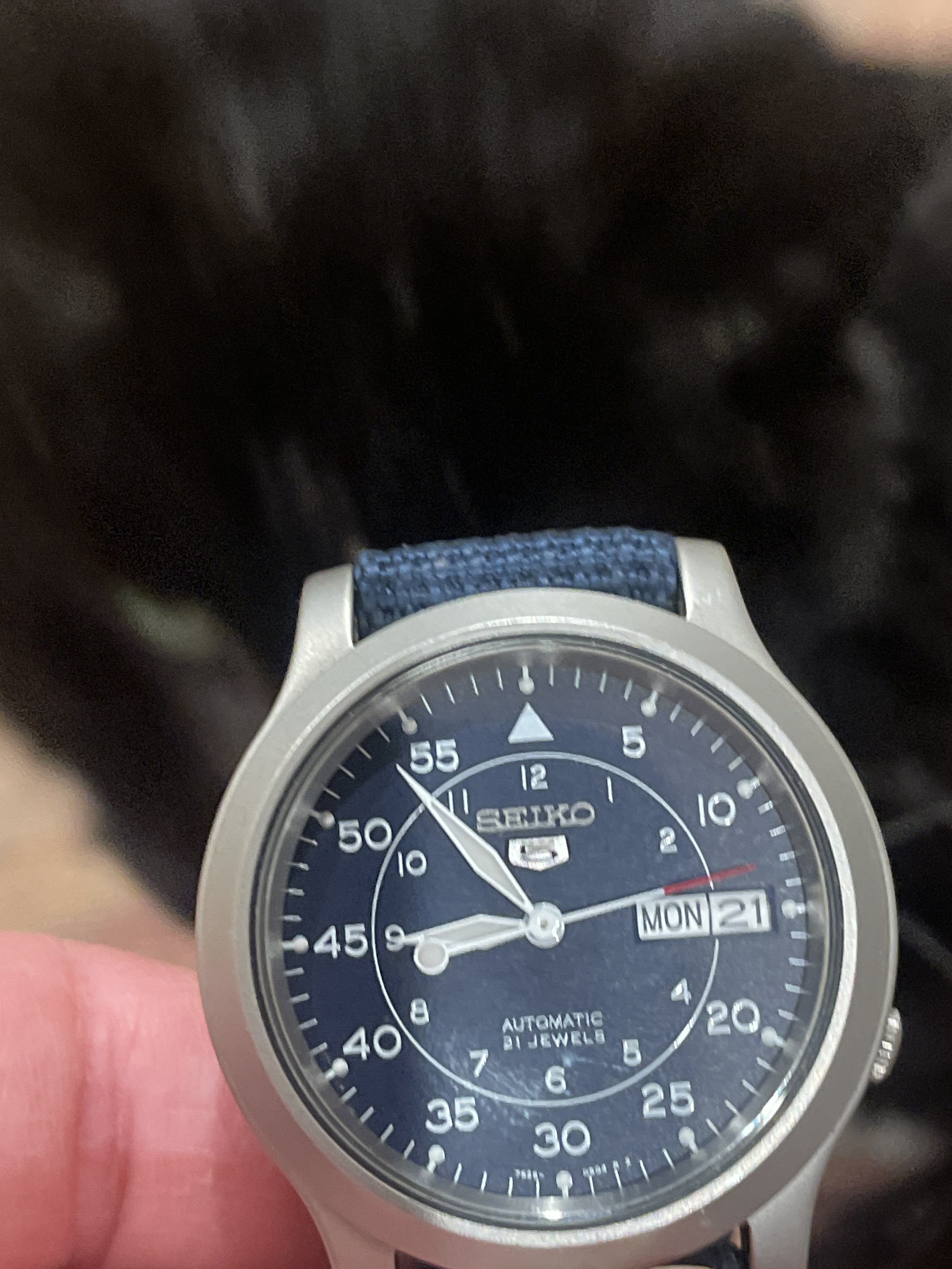

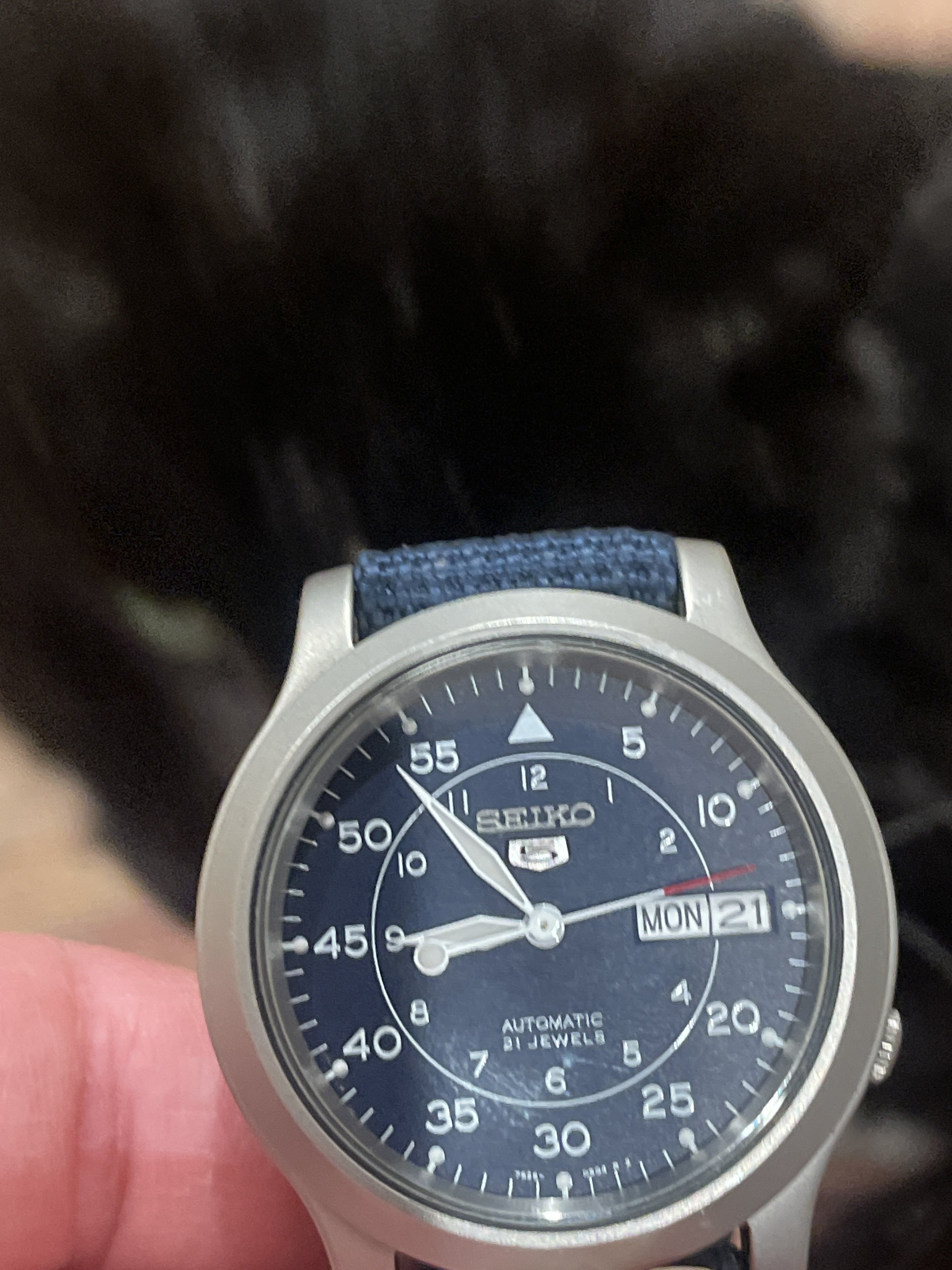

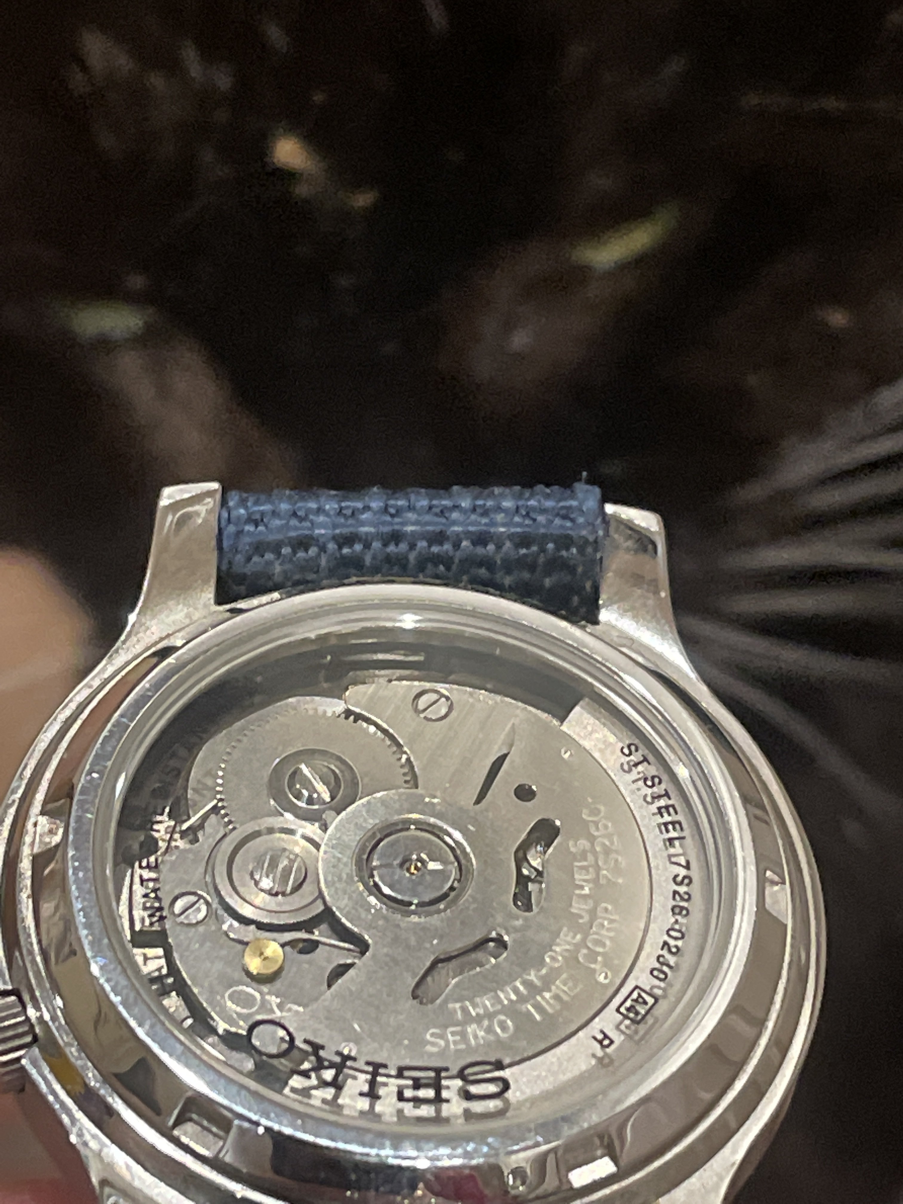

I leave a cheaper seiko in my car in case I forget a watch. However I forgot about the watch I left in my car in case I forgot my watch so it’s been in there through several sub zero f weeks. I dug it out yesterday seems to be okay but I need to remember to bring it in give it a full test run.

Not this this proves much of anything but I finally remembered to bring in the cheap seiko I had in my dash. I left it in there incase I forget a watch but then forgot about it so it’s been sitting in the car all winter with many weeks hovering around 0. This seiko cost 60 bucks new on some Amazon flash sale a few years back. I think they are around 100-120 now but I still see them on sale occasionally. Anyway I just wasn’t sure how the extended cold might effect the oils etc but it’s running fine and no condensation on the display back when I brought it in the house. I guess a well spent sixty bucks
