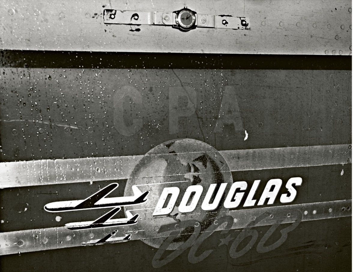

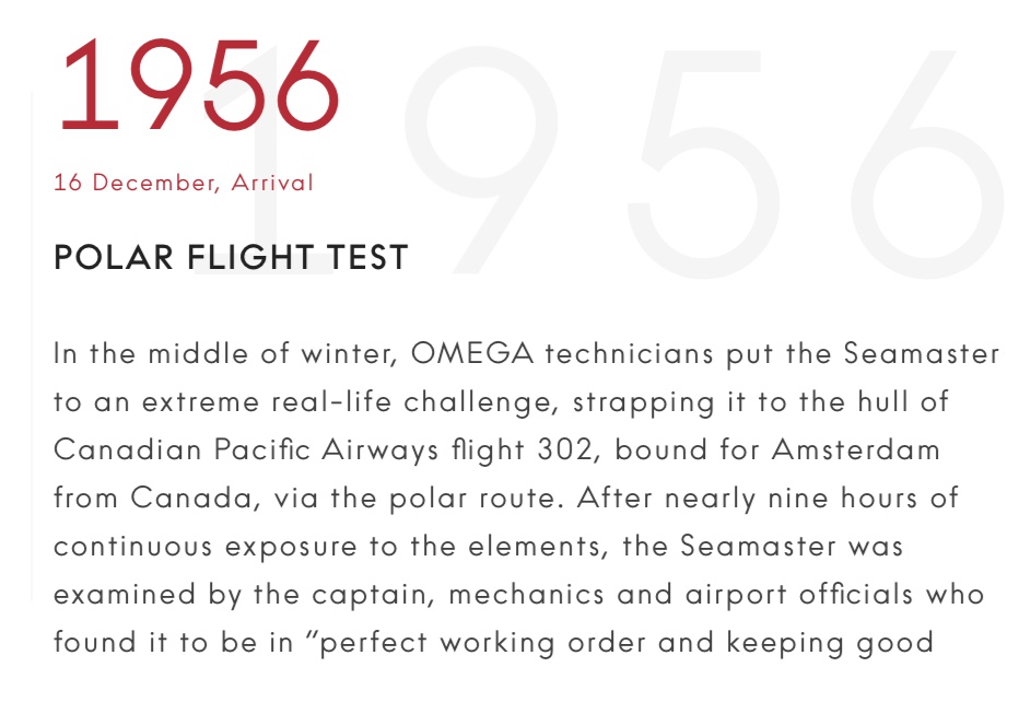

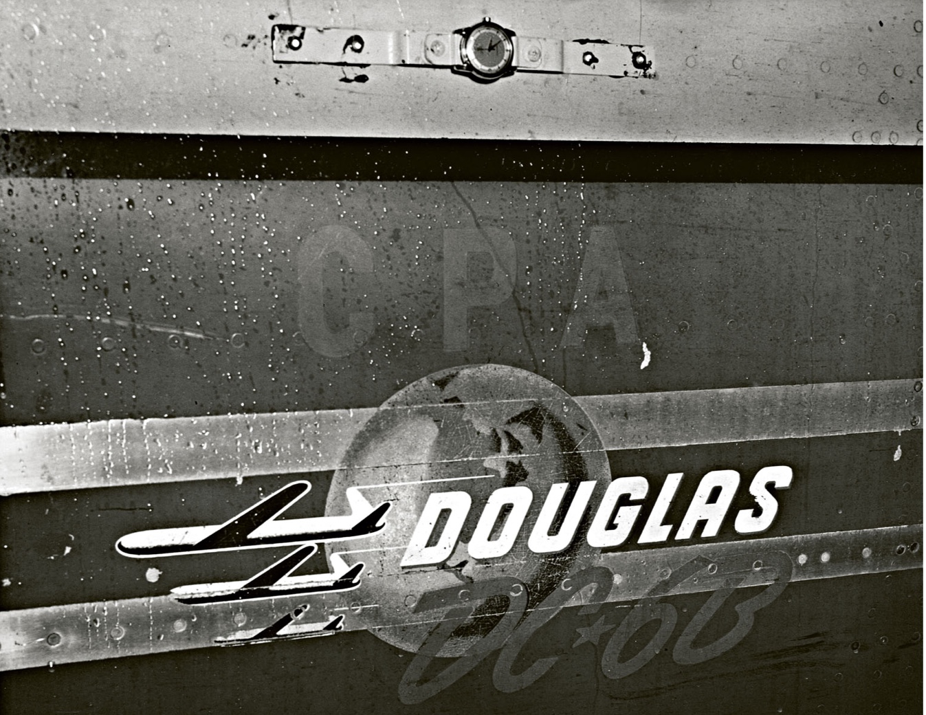

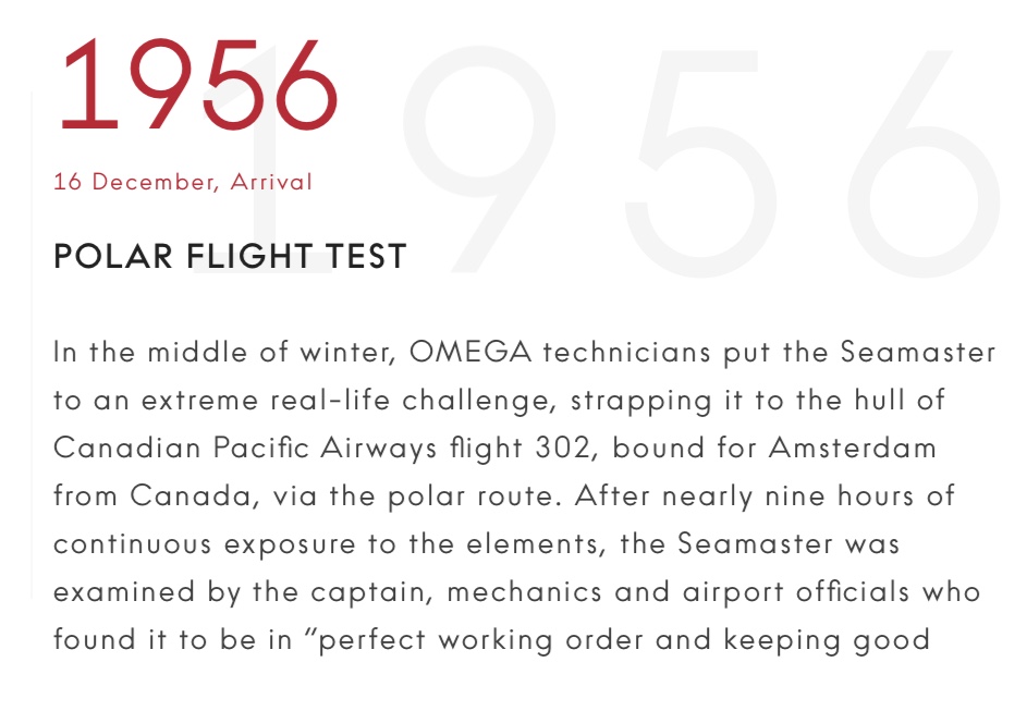

I recall an old advert for a standard (now vintage) Omega flown strapped to the side of a plane (Seamaster / prop plane maybe) it would have still had a hard ride and got pretty cold. It worked fine on landing so modern watches should do the same or better. Perhaps someone has a copy of that advert handy. ;0)
Not the Seamaster your referring to but I read that about the Zenith A385:
https://monochrome-watches.com/zenith-chronomaster-revival-a385-introducing-price/
