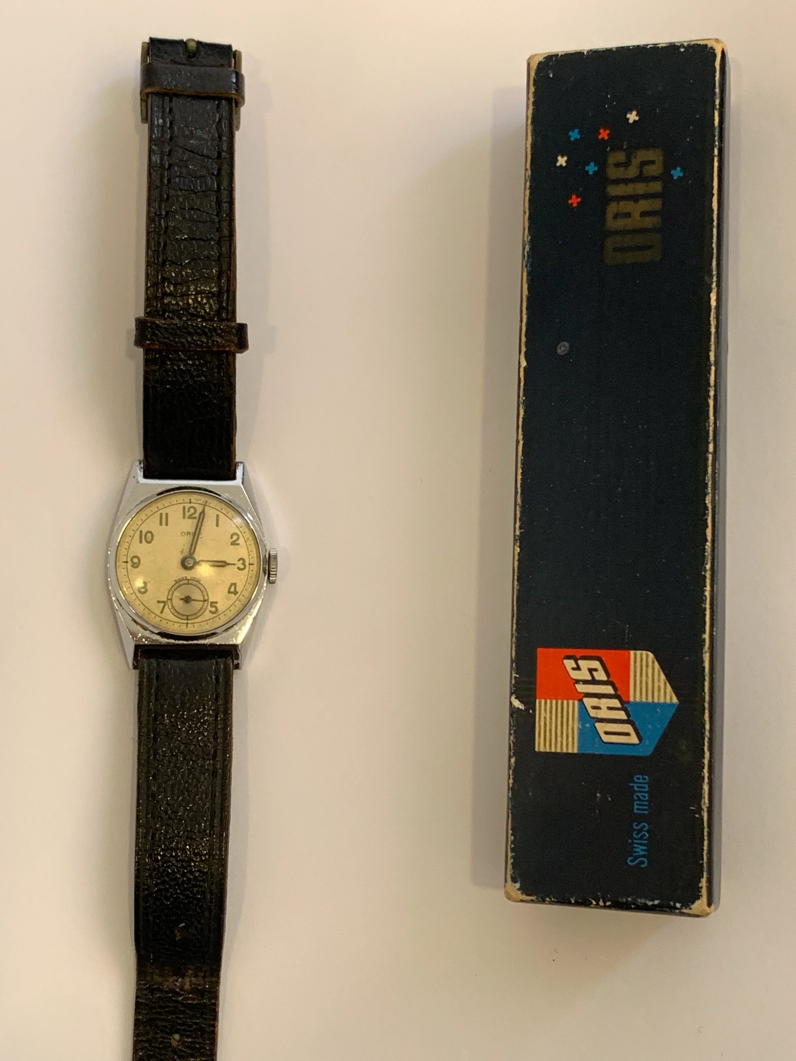

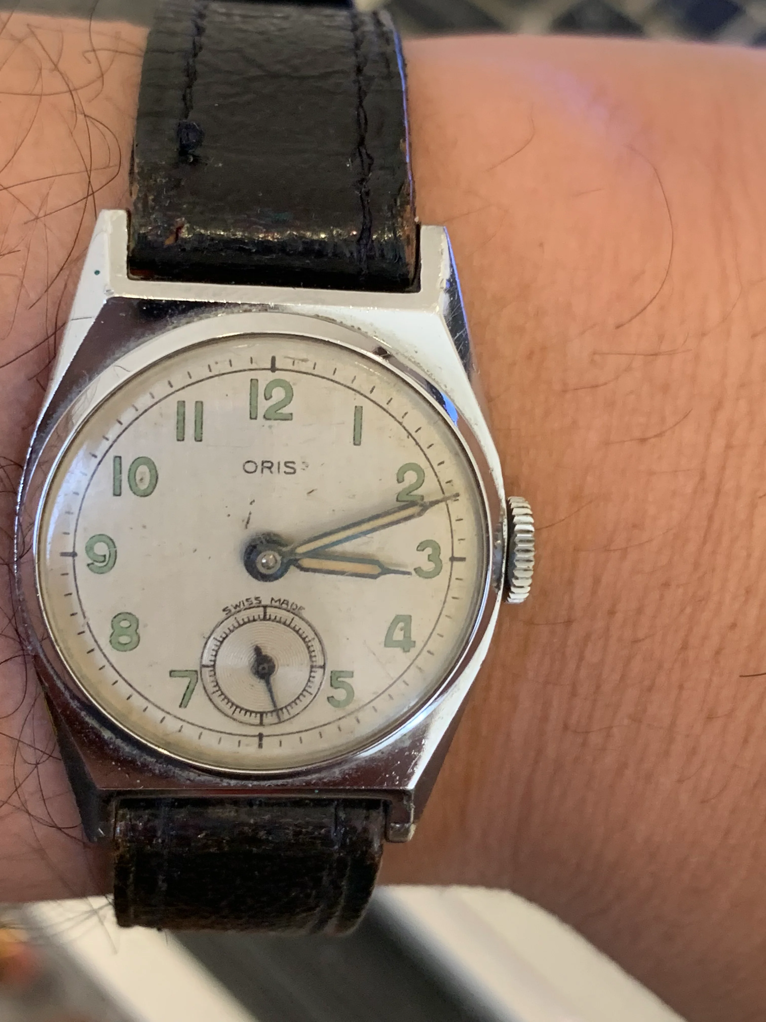

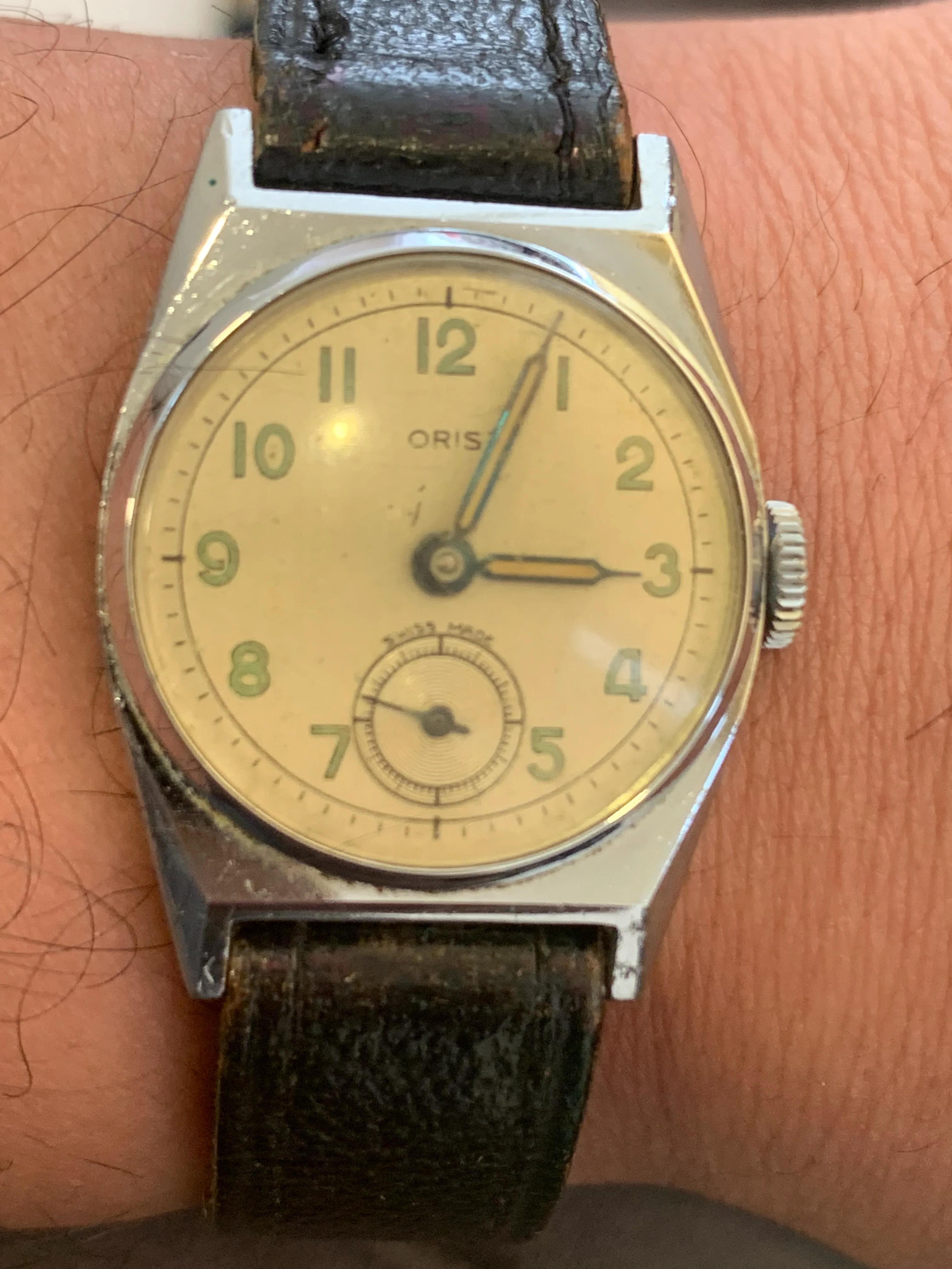

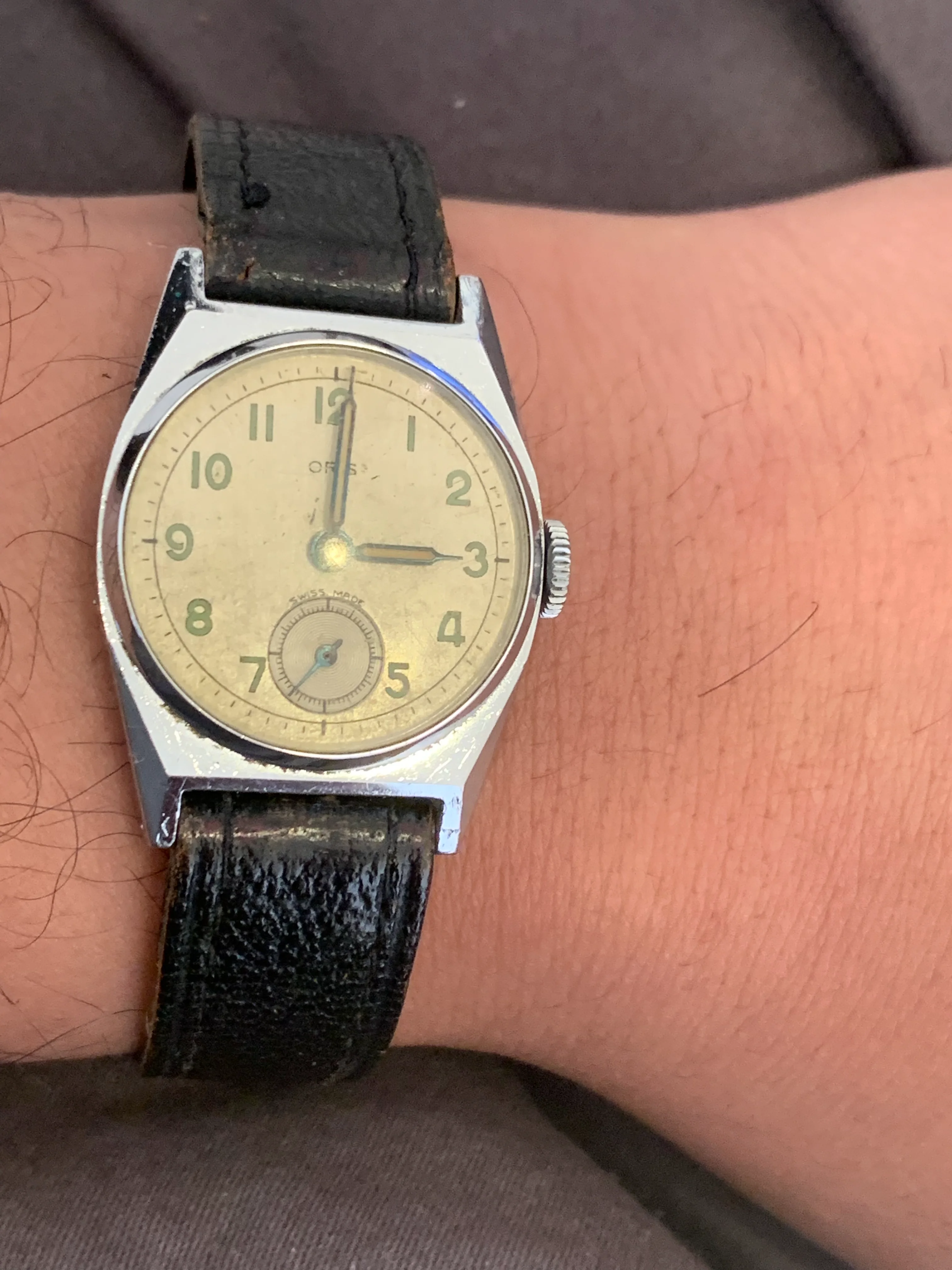

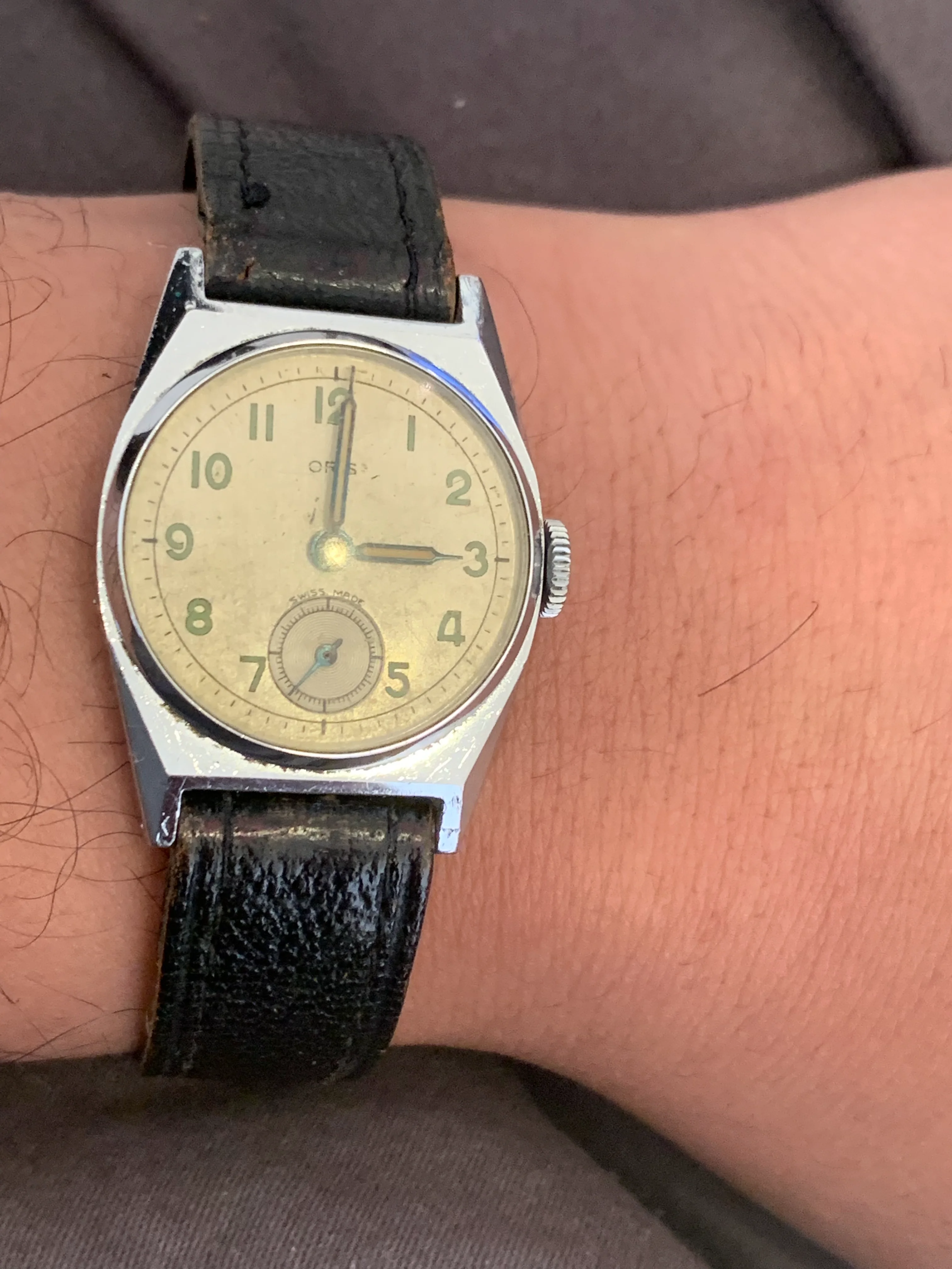

I picked this vintage Oris watch with a box. I assume this military style dates back to the 1940s. In addition to being reasonably priced at around $60 and working well for its age, I appreciate the simple design and military vibe. On the downside, this watch contains seven jewels I believe, and from what I understand, their lifespan is finite because there are fewer jeweled holes in the plates, which can deteriorate with time. That such a tiny watch has endured throughout the years is nice, though. Do you think I should wear and wind it frequently, or would once or twice a week suffice? And I'll take care of any service-related suggestions in the future.

lol, my point which could be wrong as I am gaining knowledge by time was I read tons of threads warning against buying such low jewels and that it is not a good buy by any means and how easy it can stop working. I needed to check if those kinds of watches can be used for normal wear off course not for sports activities like horse riding 😁, but just if I can wear it and forget about it and any sudden move during current pact and fast life can affect the movement and watch in general —so I asked for your experience, but your comment gives me relief. 😁

We used to get all these posts from guys asking if it was okay to wear their watch Submariner in the rain and dumb things like that. There are a ton of old wives tales out there about what is and what isn't a good watch. The truth is that yeah, a seven jewel watch will wear out more quickly than a seventeen jewel watch. But a seventeen jewel watch that has been worn every day for fifty years without a service is going to be more worn out than a seven jewel watch which has been regularly serviced and generally better taken care of. So, it's a hard thing to gauge, each watch we look at needs to be evaluated on its merits.

As an aside, the Oris brand has gone uptown with the current line of watches. I’ve known Oris watches for many years, originally aimed at the market demand for inexpensive watches. Decades ago, Oris watches with low jewel counts, but jewelled lever escapements were a cut above, for example, Timex. Fast forward to the Oris watch of today which is aimed at a much different market. As has been said, low jewel count watches tend to wear out faster than higher jewel count watches. And because of their lower initial purchase price, they generally were retired when expensive repairs were required. Will Oris watches such as the subject watch “stand the test of time”? Well, think about it.
