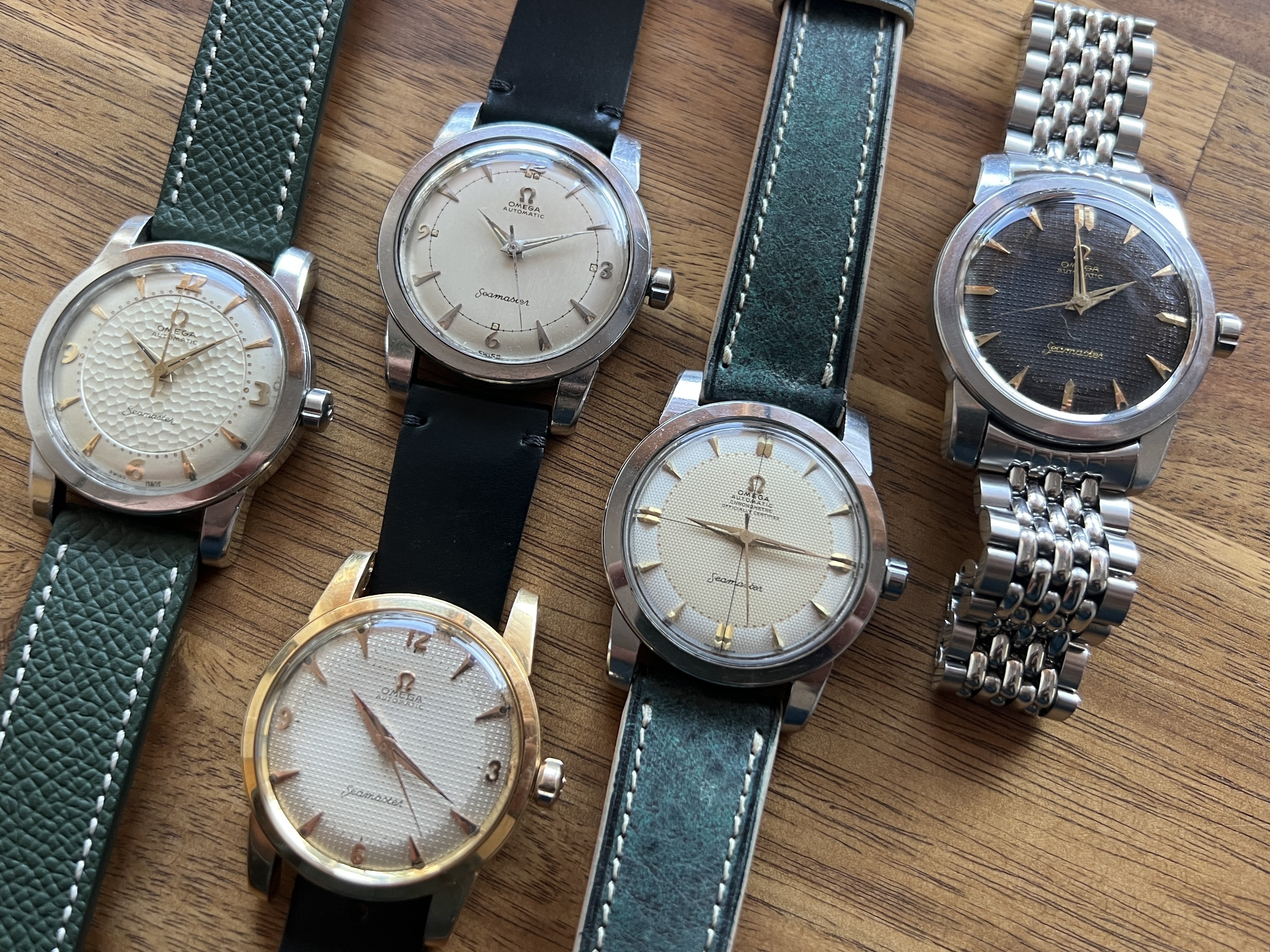

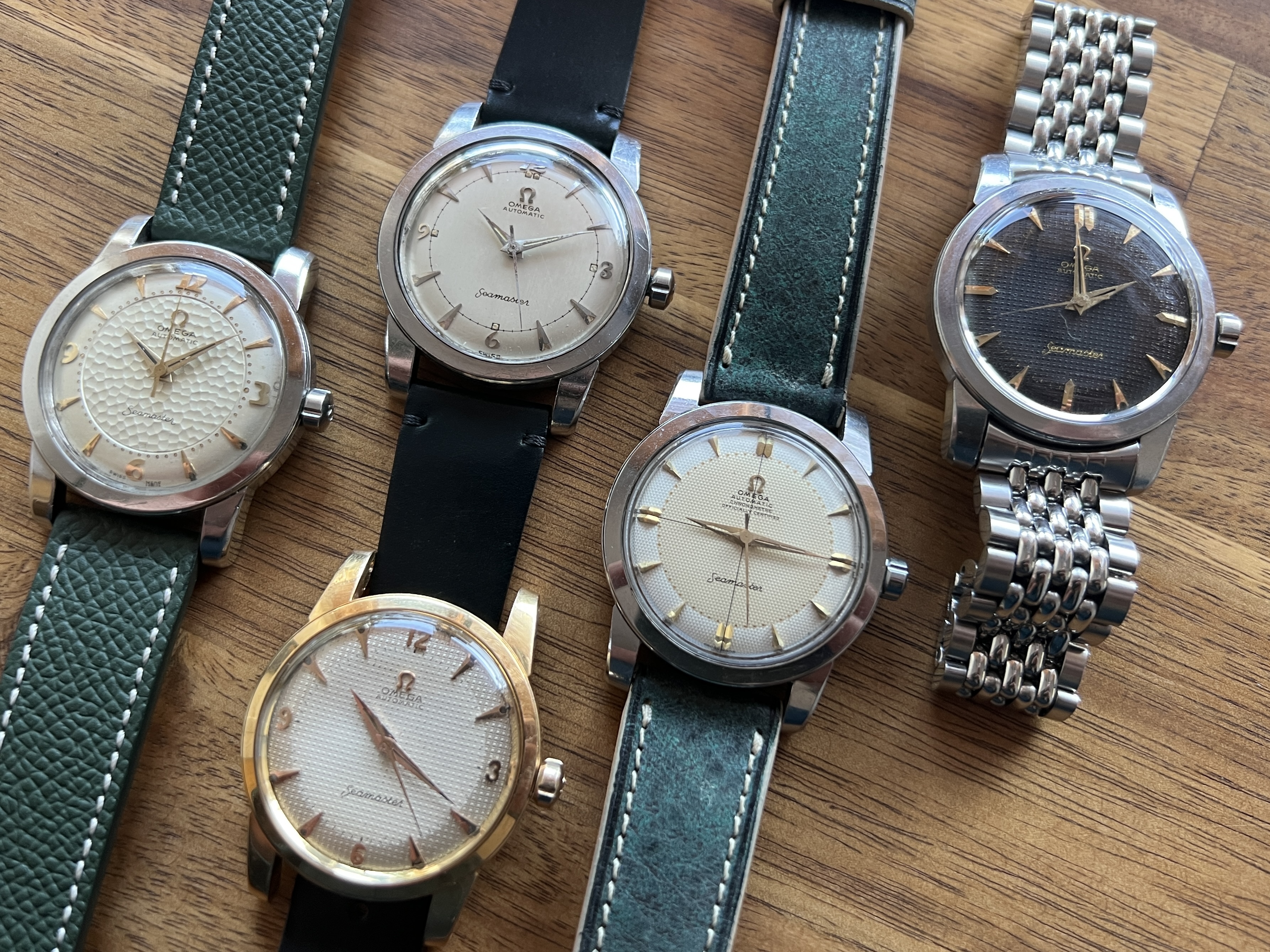

We have a few “Show me your…”-threads here, and I find they’re a great source for inspiration and serve as a very useful reference. You’ve found a dial configuration that you haven’t seen before? Chances are, there’s another example in the collection of someone on OF. What we don’t have yet is such a thread for the Seamaster reference 2577 - in my opinion one that deserves it, maybe even more so than all the others. There is a staggering variety within the reference, possibly the biggest number of in-reference layouts of any Omega: Different calibers, case and case back styles, a number of distinct dials that I can’t count. It doesn’t even say Seamaster on all of them, and the others carry the famous name either on the top or the bottom half of the dial.
(A group shot that already hints at the diversity: White and black dials; plain and two-tone; even or with golf ball, honeycomb or hobnail structure; chronometer certified or not; steel or gold, … Picture of the COSC one with courtesy of @iamvr )

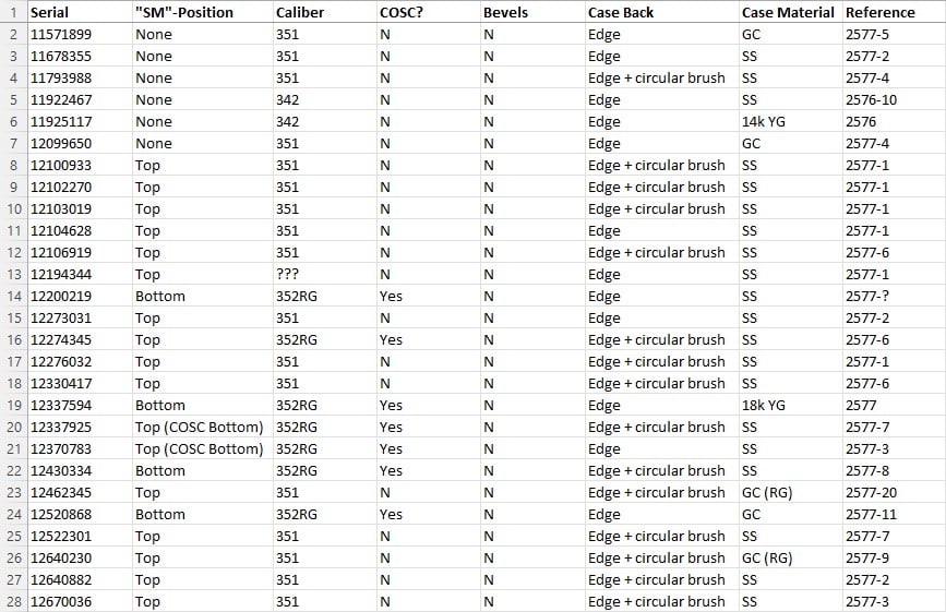

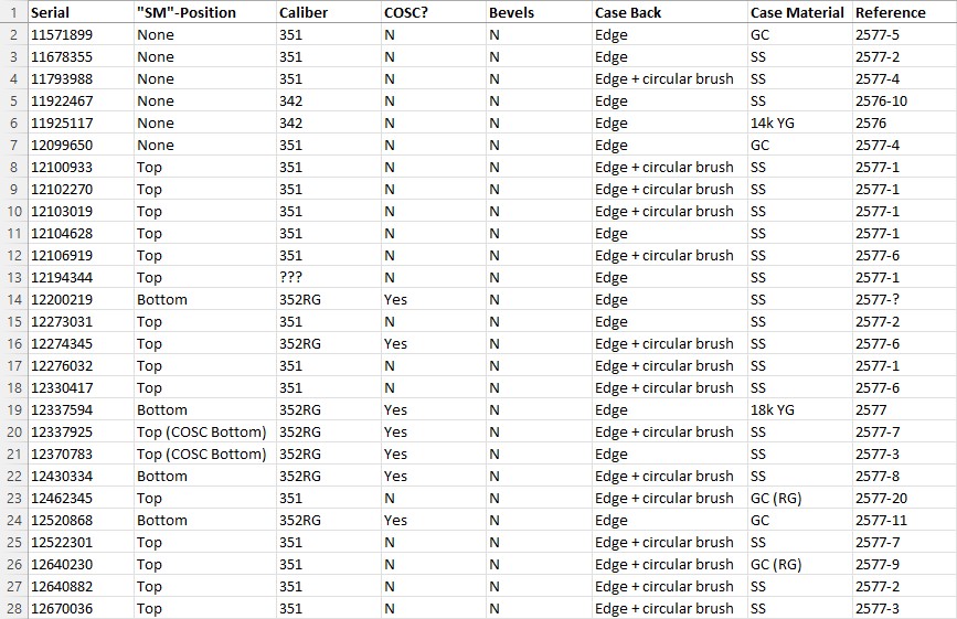

Anyway: Before I lose all readers going full-nerd on caliber designations, what I actually want to do is give an introduction to the differences within the 2577-reference and try to establish roughly when they were introduced, so that we have it all in one place. It’s one of the most common Seamasters, produced from ca. 1948-1955 in vast numbers, which means that questions about the legitimacy of examples come up quite frequently. I’ve noted down 60+ examples with serials and a few details over the years and maybe those numbers are interesting to the OF-public.
(Note that I have deleted 3-4 examples that were obvious “Franken-watches”. A dial without the Seamaster name on a cal. 354 that wasn’t introduced until 1952, for example, can’t be right)

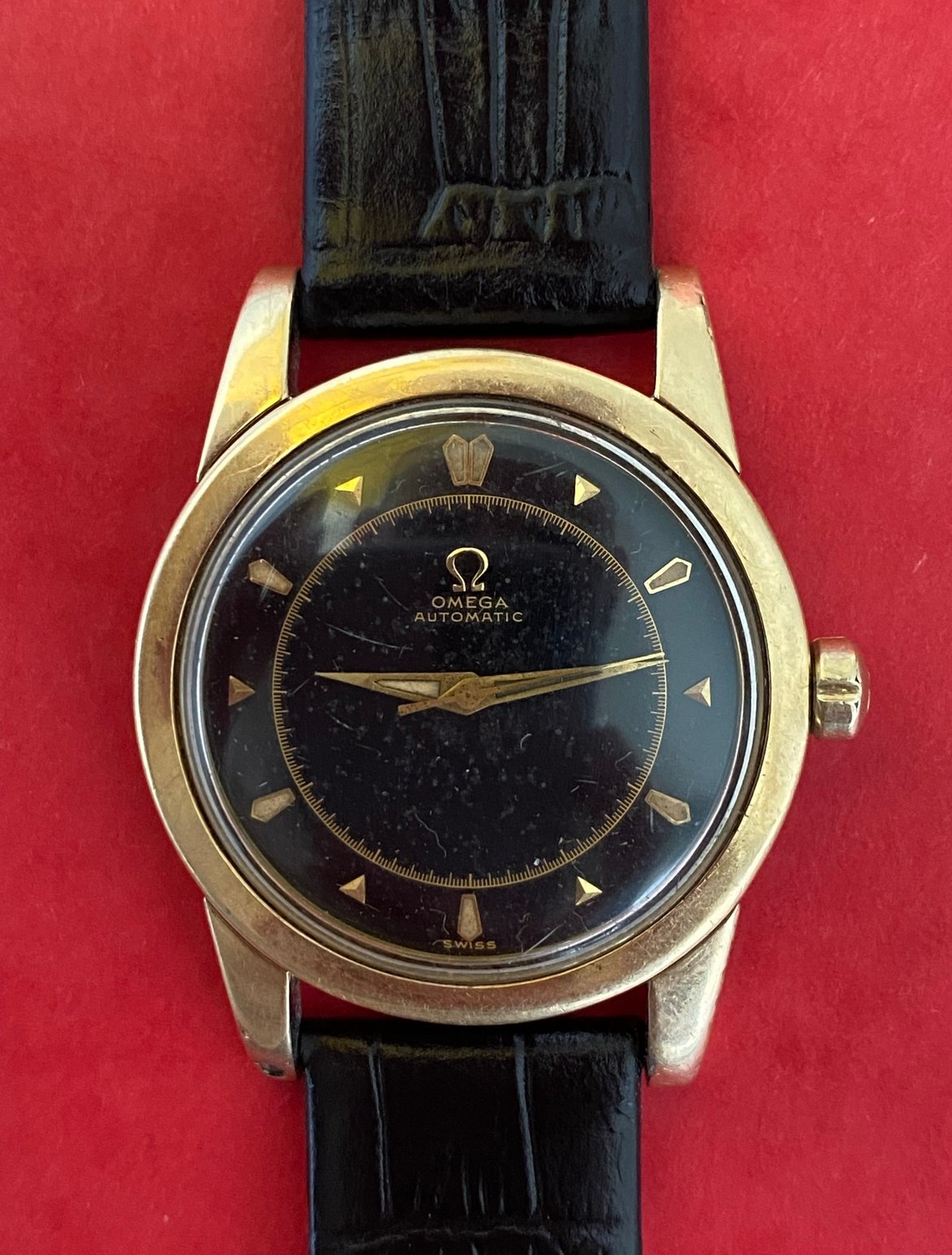

Interestingly, the earliest examples, while they certainly are Seamasters, do not say so on the dial. They are rather scarce: Even including the sub-second sister 2576, I’ve only found 6 examples so far which you can find in the list below. The earliest is a 11.57m serial, and it seems that the Seamaster name found it’s way on the dial at the 12.1m serial mark.
(Possibly a 1948 example with the serial 11571899)

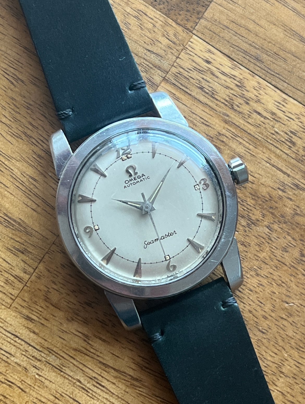

(An early 1950s 2577 with “Seamaster” in the top half of the dial. Note the typical “mirror”-numerals, while later examples switched to applied ones)

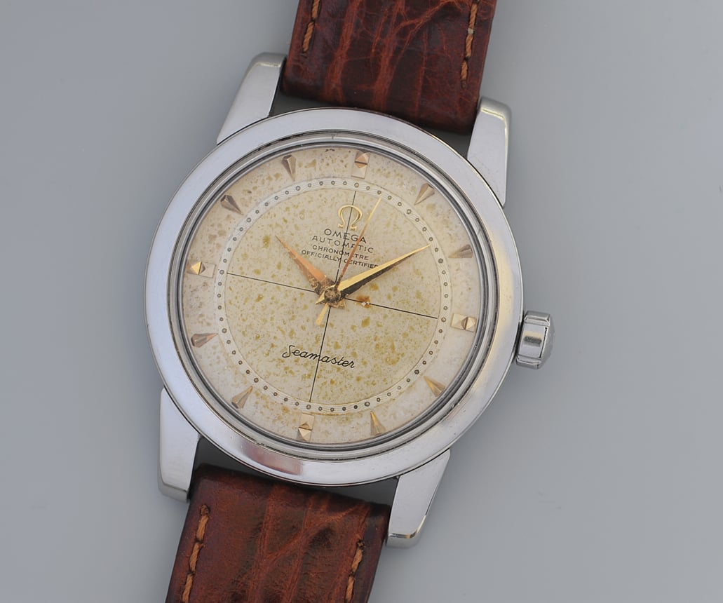

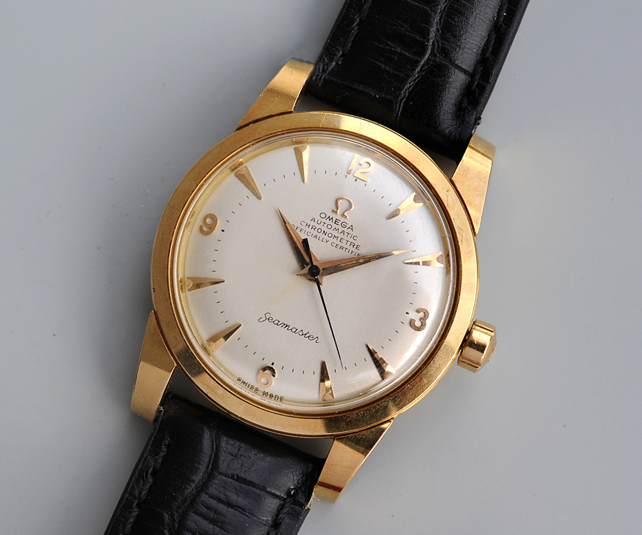

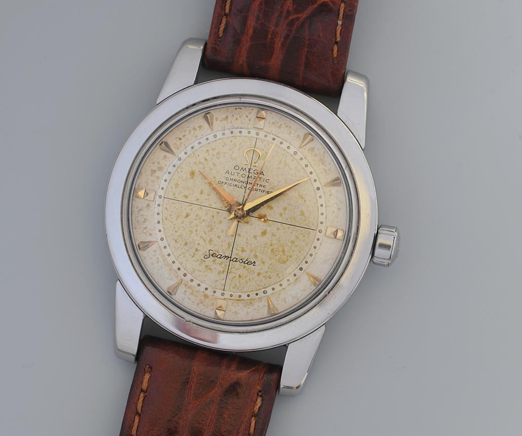

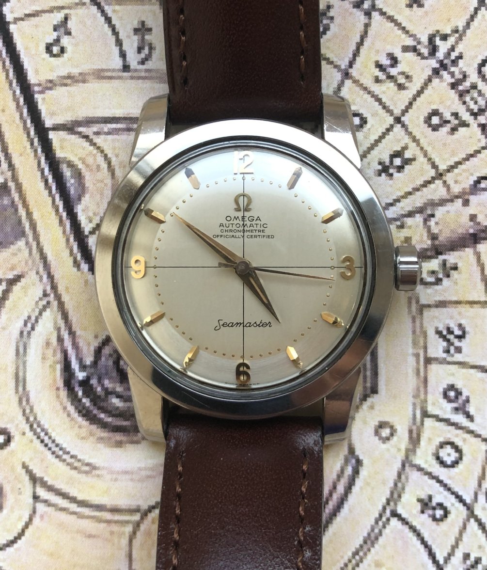

Do note that this is only valid for non-chronometer versions: The cal. 352RG chronometer certified ones showed “chronometer” on the top and “Seamaster” on the bottom much earlier. Omega also experimented with layouts, it seemed: “Seamaster” at the top and “chronometre” at the bottom was a legit variation. The “officially certified” was introduced in 1951 - before that, the dials simply read “chronometre”.
(A chronometre certified example by @iamvr - one of the nicest ones you’ll ever come across)

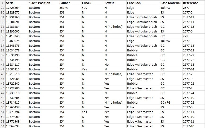

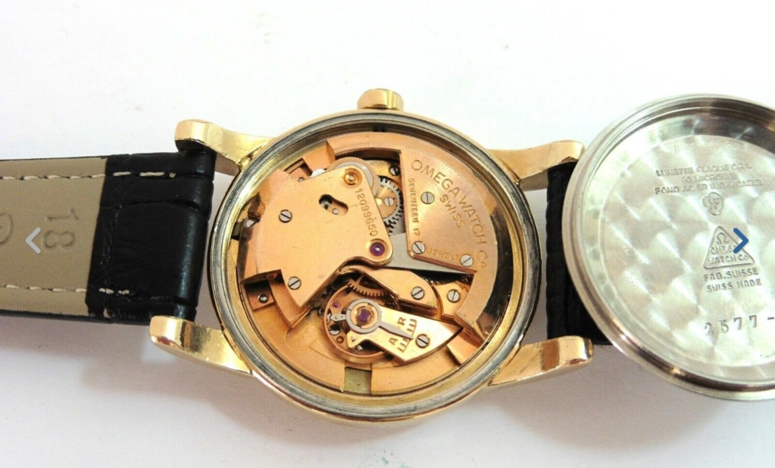

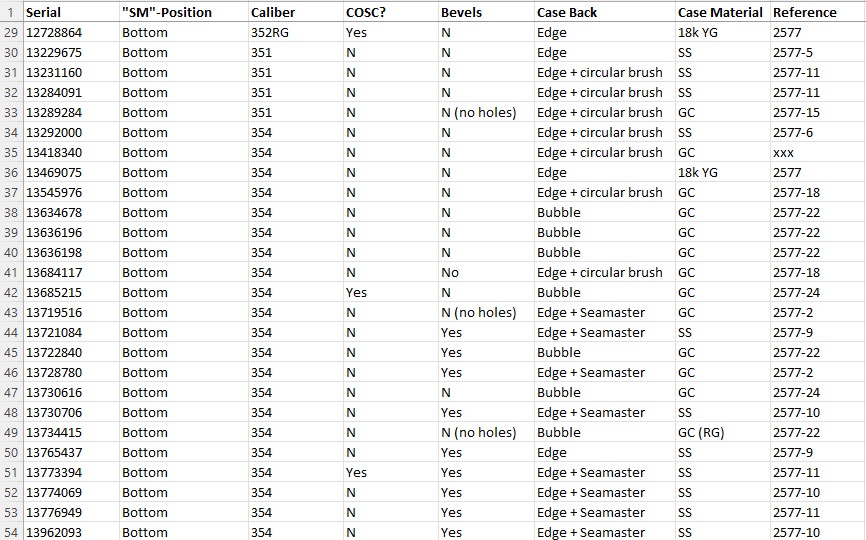

As mentioned previously, the reference likely started with the cal. 351 bumper automatic for regular examples and the cal. 352 for the chronometre versions. This seems to have lasted until ca. the 13,29m serial, at which point the updated cal. 354 was introduced. It replaced both previous calibers, as it was available in chronometre-spec, too.
The latest serial known to me so far is 13.96m. Since the reference was produced until 1955, I’d expect 14m serials to exist, too - maybe even ca. 14.5m serials.

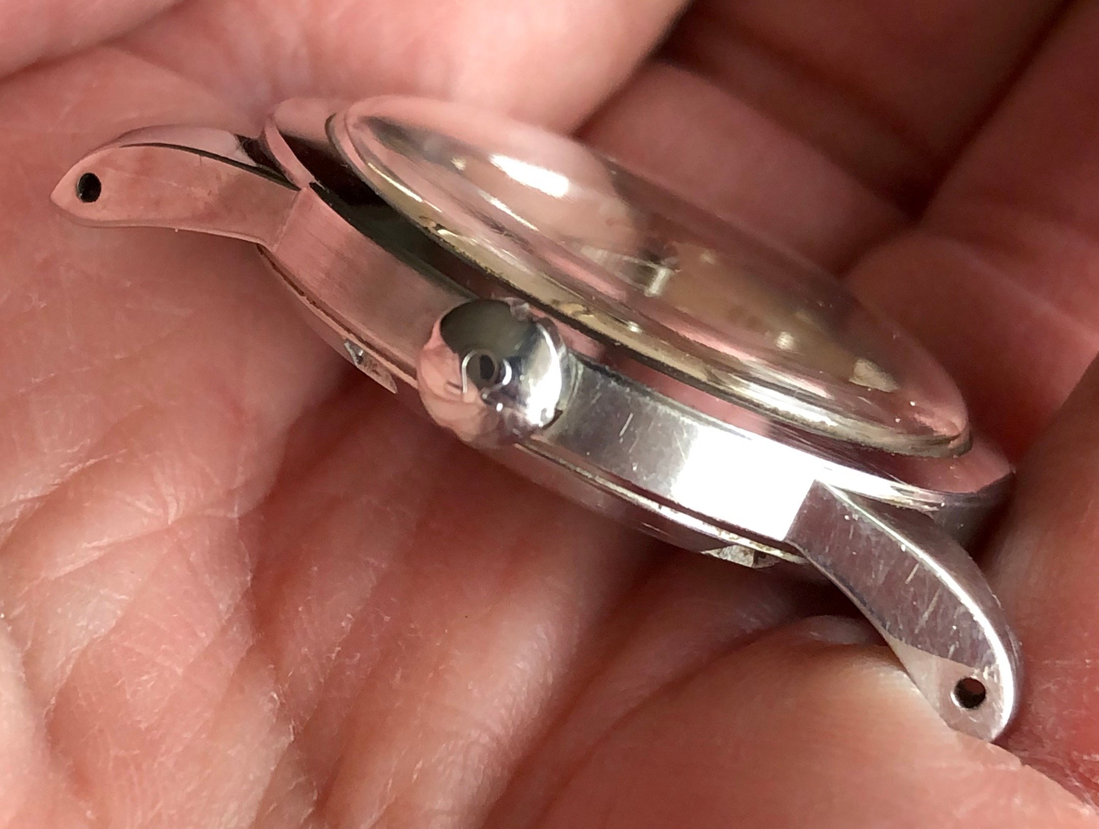

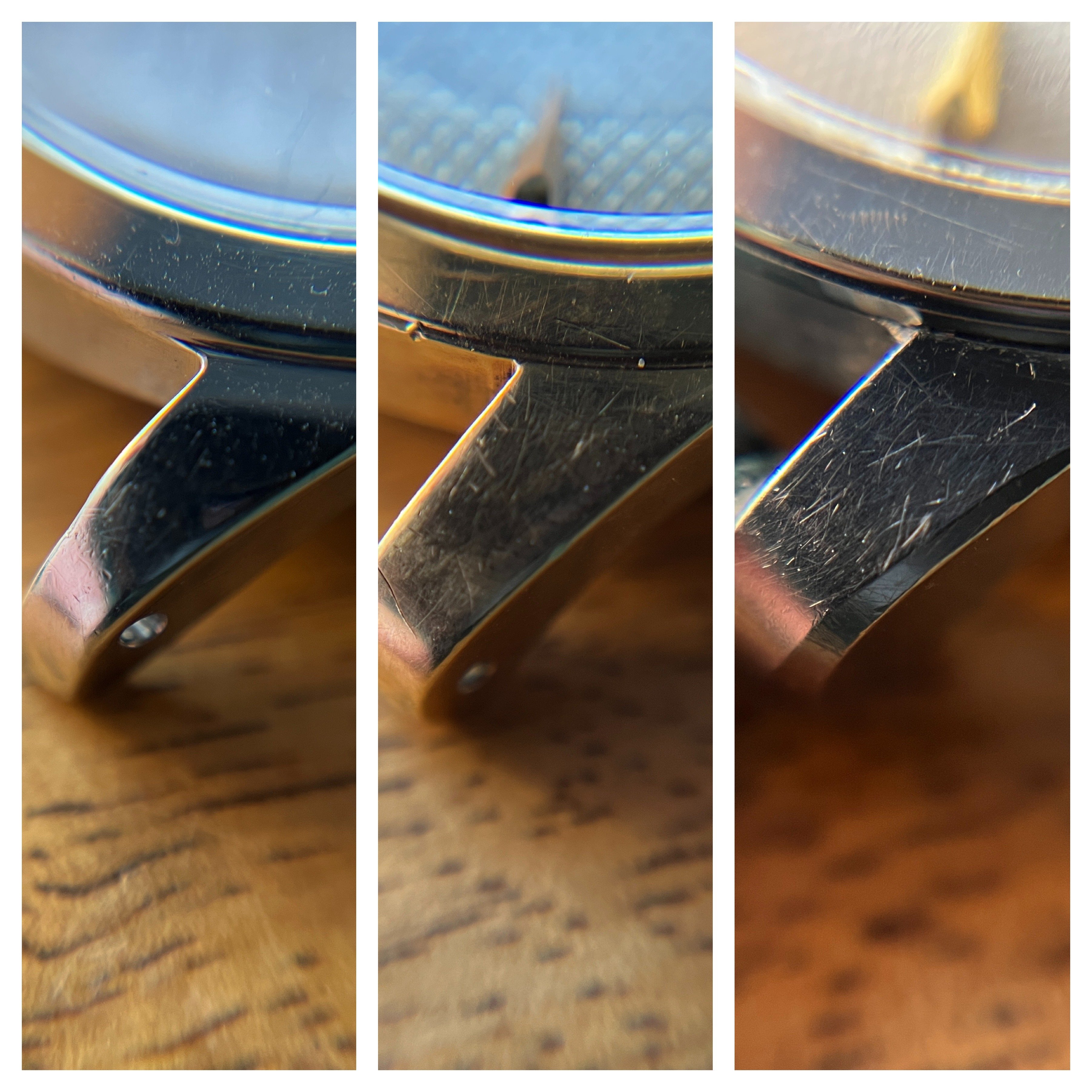

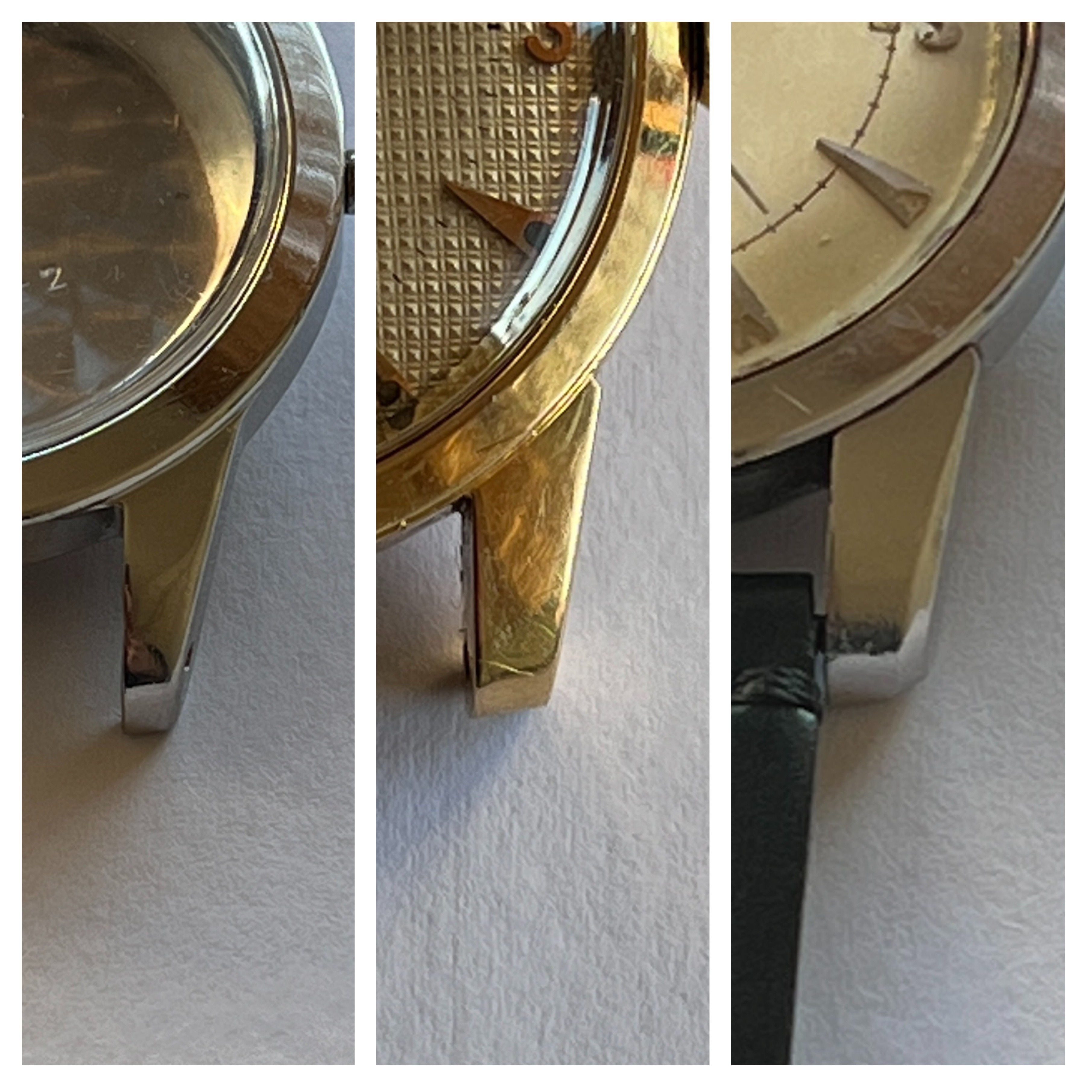

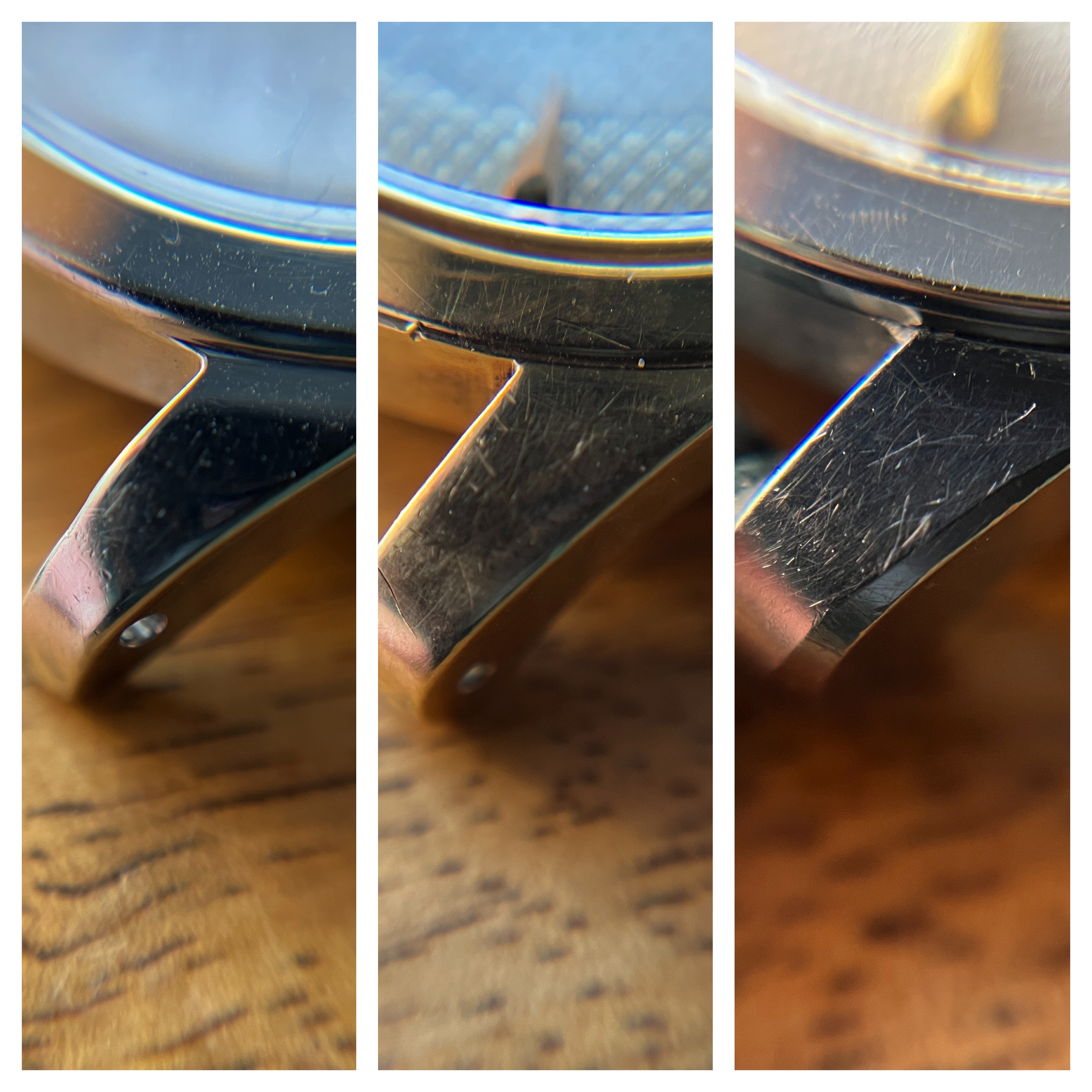

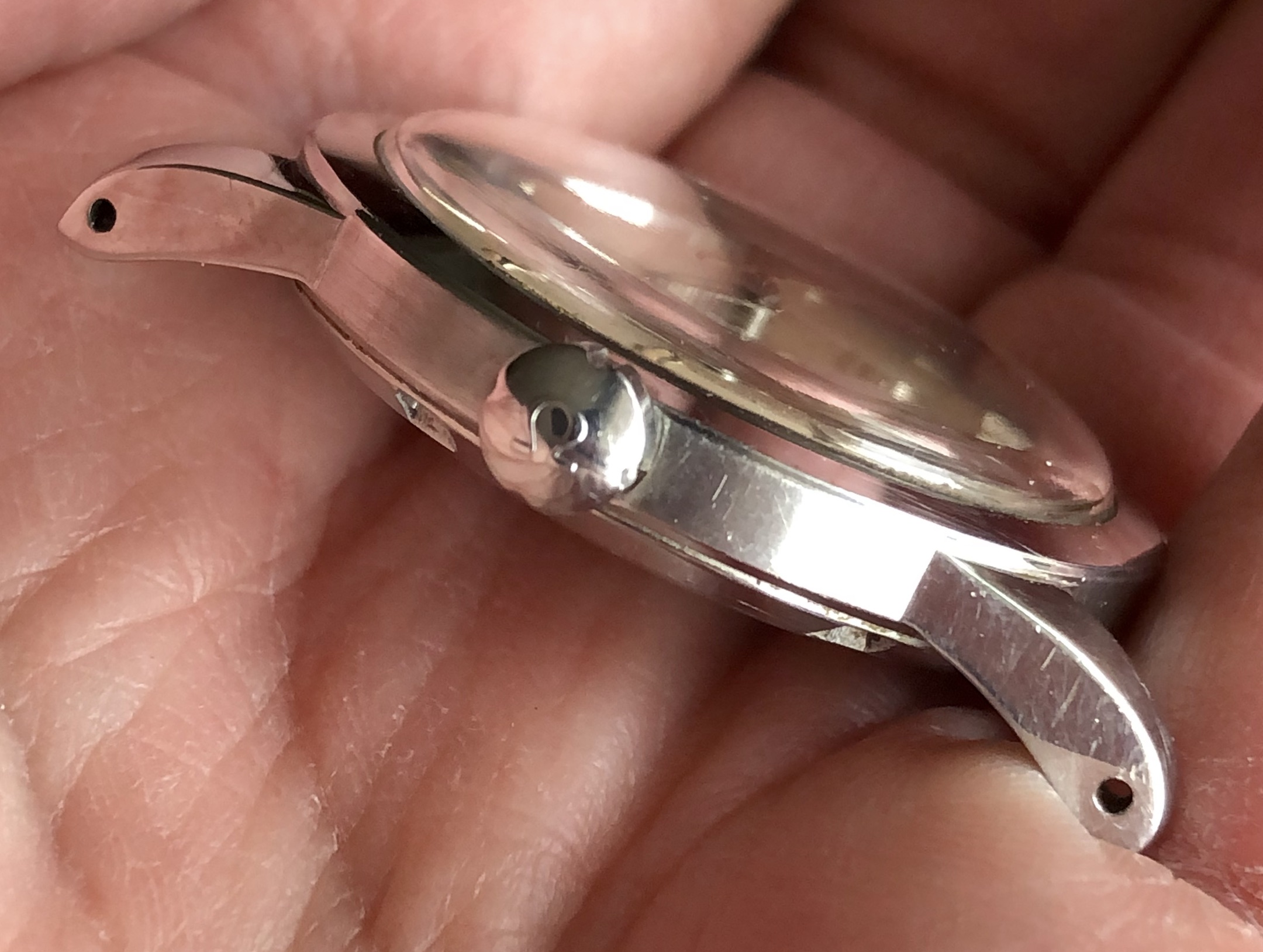

Stainless steel: The earlier cases had thinner lugs, lug holes for the spring bars (with only a few later exceptions), no bevels and occur ca. up to serials 13,72m. From then on, the lugs became much beefier and had a distinct bevel on their outside edge.
Gold-capped: The gold-capped cases went through the same design change as their steel siblings, with the exception that the thicker, beveled lugs on them were introduced a little later.
Solid gold cases were a different story: They had slightly thicker lugs from the start, albeit also without a bevel. Throughout the whole production range, their style was never updated to the thicker, beveled lugs. For comparison:
(Left to right: Early, thin lugs; slightly thicker lugs of a solid gold case; later, thicker, beveled lugs)

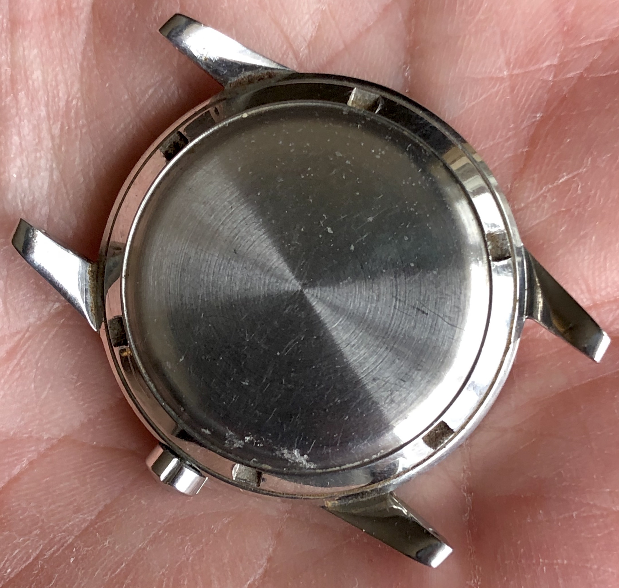

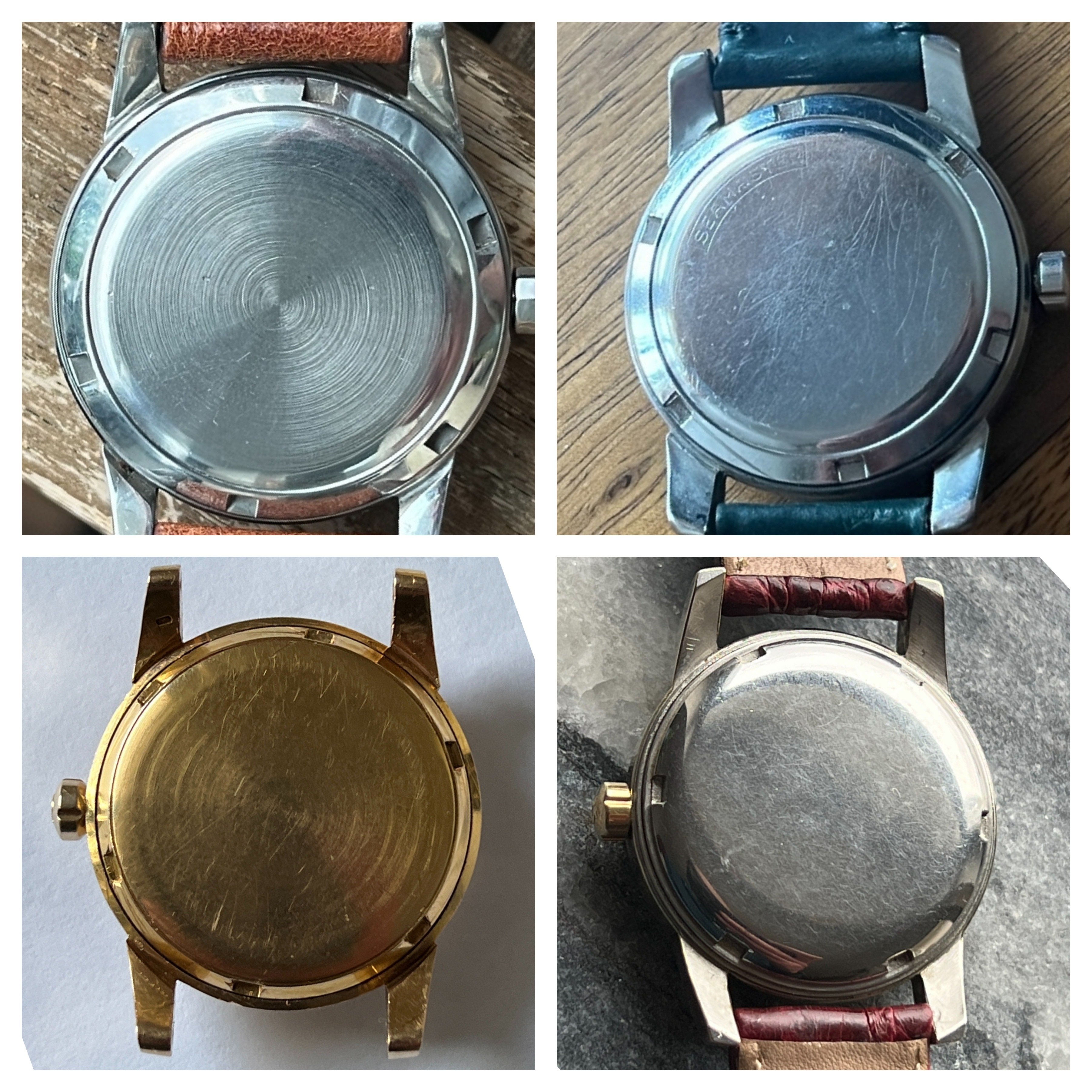

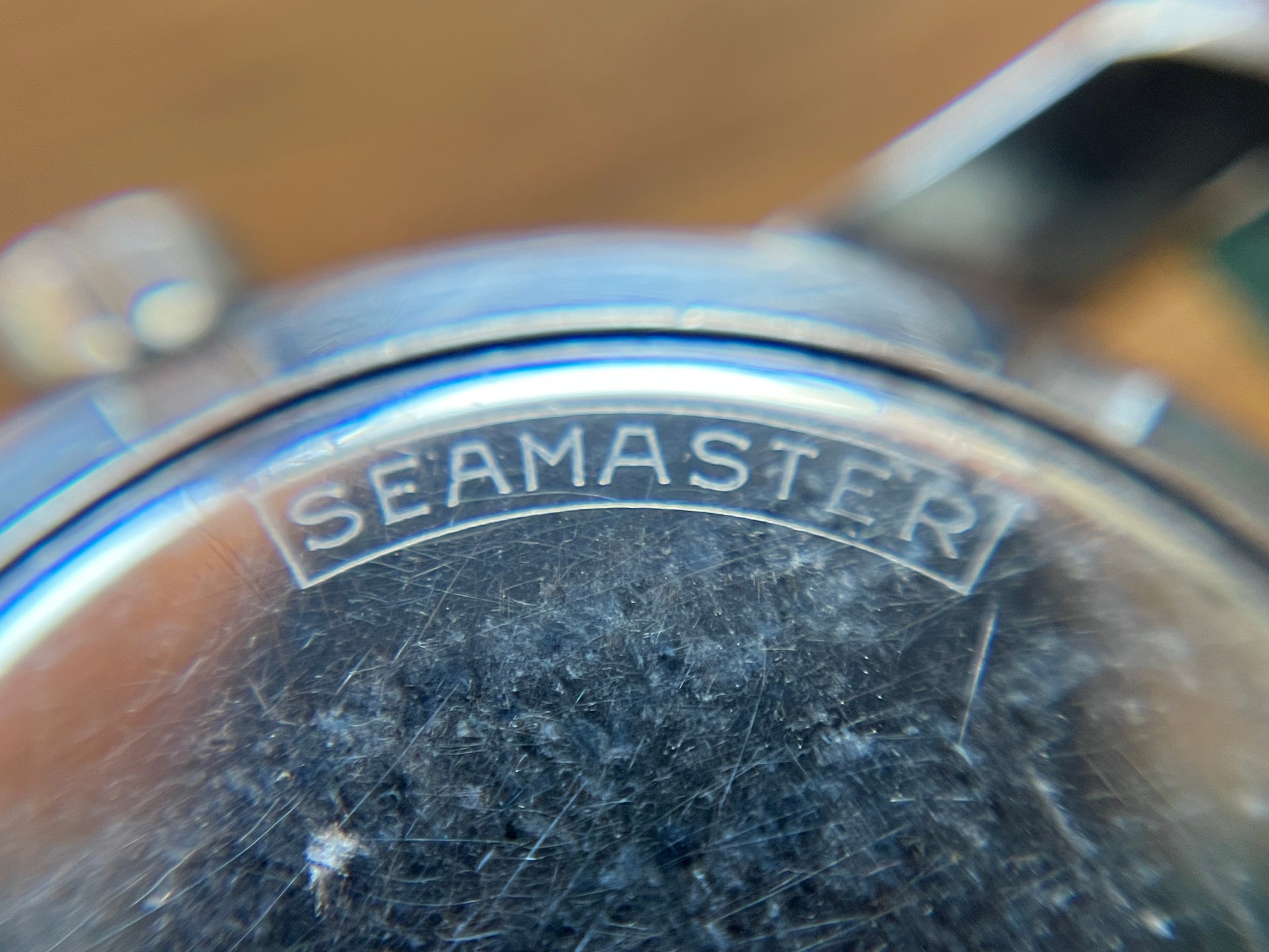

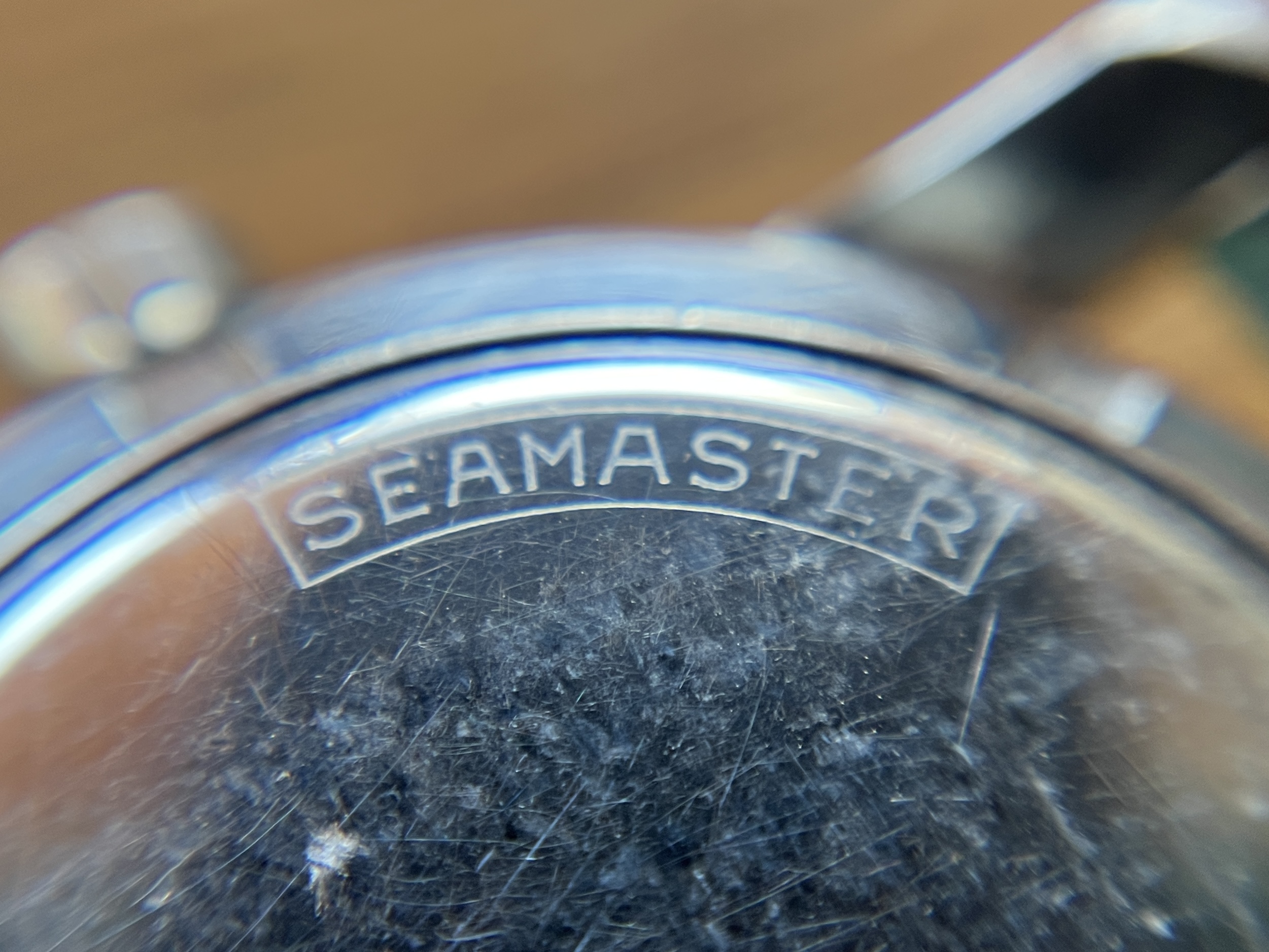

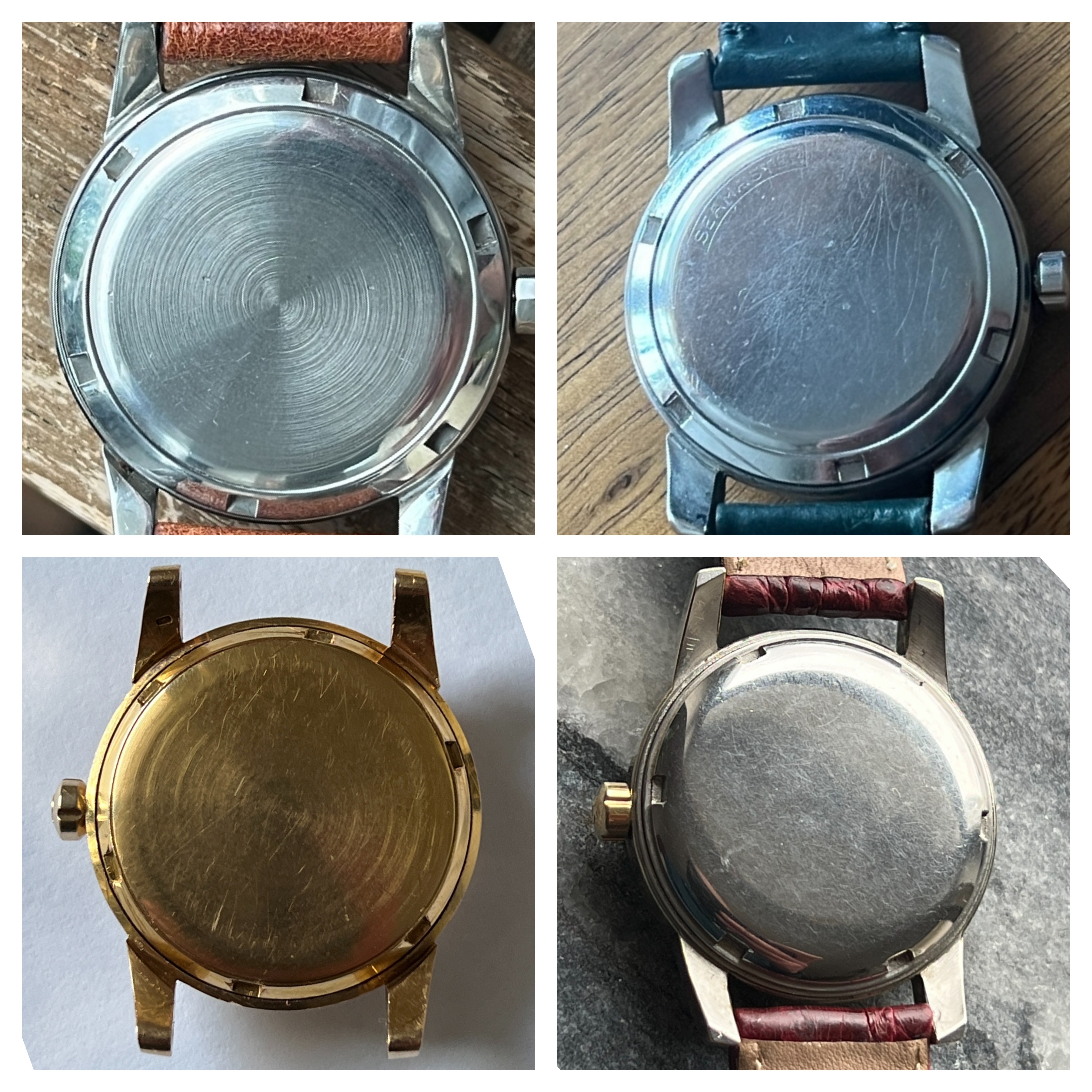

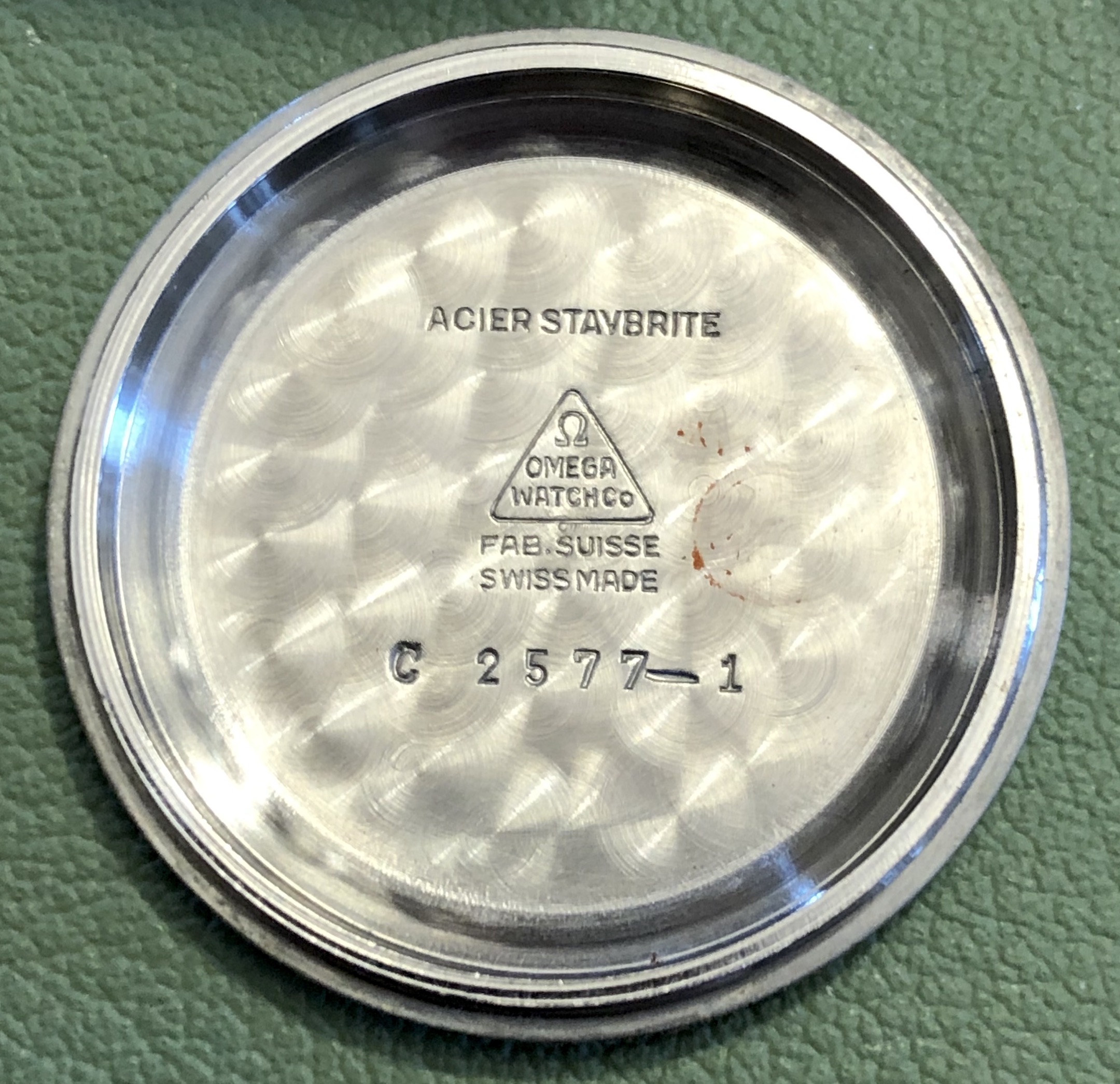

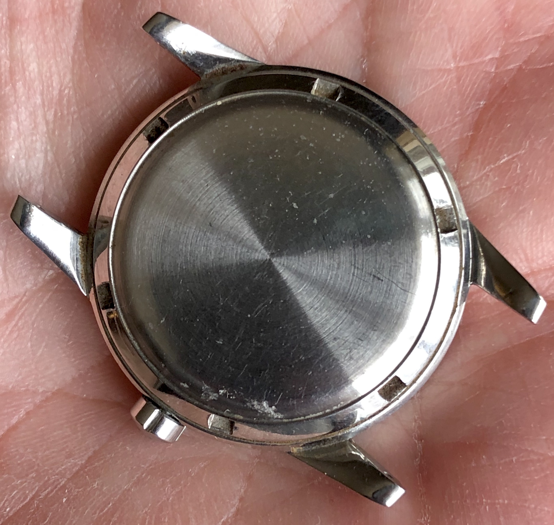

The screw case backs also went through different designs. Initially, the showed a circular groove and a circular brushing, which is lost on many examples due to polishing. With the introduction of the beveled lugs, the case back was also updated: It now gained a framed “SEAMASTER” in capital letters and lost the brushing. Roughly at the same time, another style of case back came to life: A polished “bubble back” style without the circular groove that can only be found on the sub-references 2577-22, -23, and -24. Again, those rules don’t apply for the solid gold examples.
(Clockwise from top left: Early case back with circular brushing and clearly visible circular groove; later, updated case back with framed “SEAMASTER” still visible in the top left corner; the “bubble back” case back without inscription or groove; a solid gold case back)
(A closer look at the framed “SEAMASTER”)

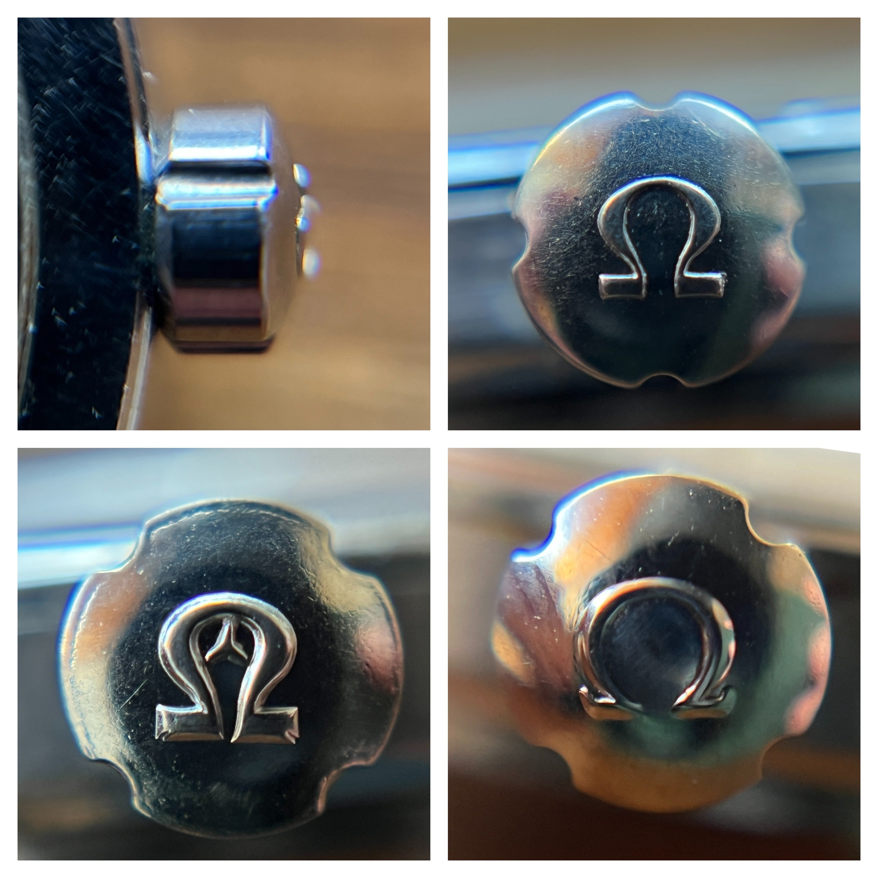

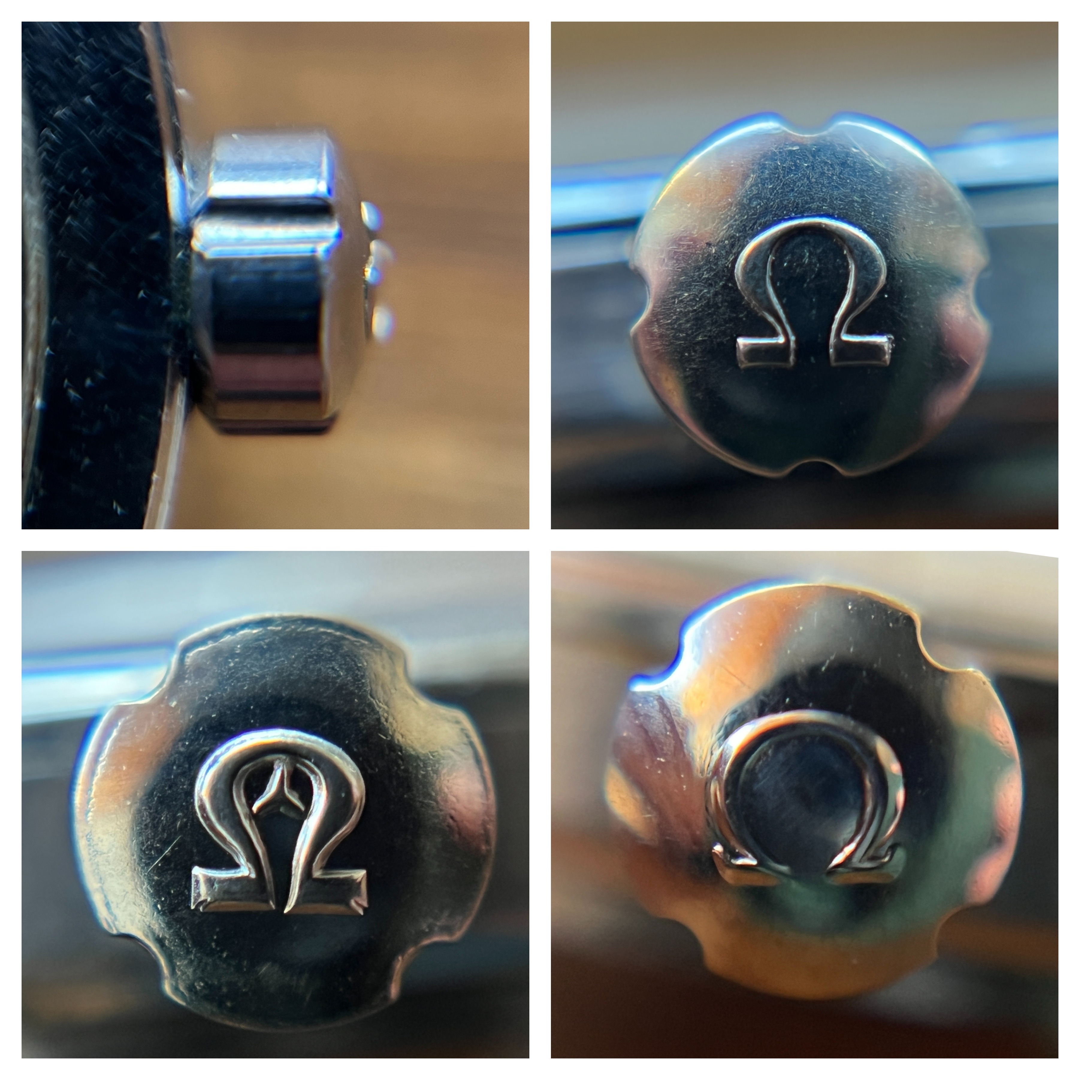

For once, a feature Omega did not change multiple time during the 7-year production. There’s exactly one correct style for the reference, at that is the famous “clover”-style crown.
Of course, many were replaced during services in the meantime, and only the examples with the flat feet Omega logo are truly period correct. Personally, I wouldn’t push a good 2577 with a service crown out of bed: Replacements are relatively easy to find.
(Clockwise from top left: top view on the clover crown; the period-correct standard example; a modern service item; a rather uncommon “Naiad”-example)

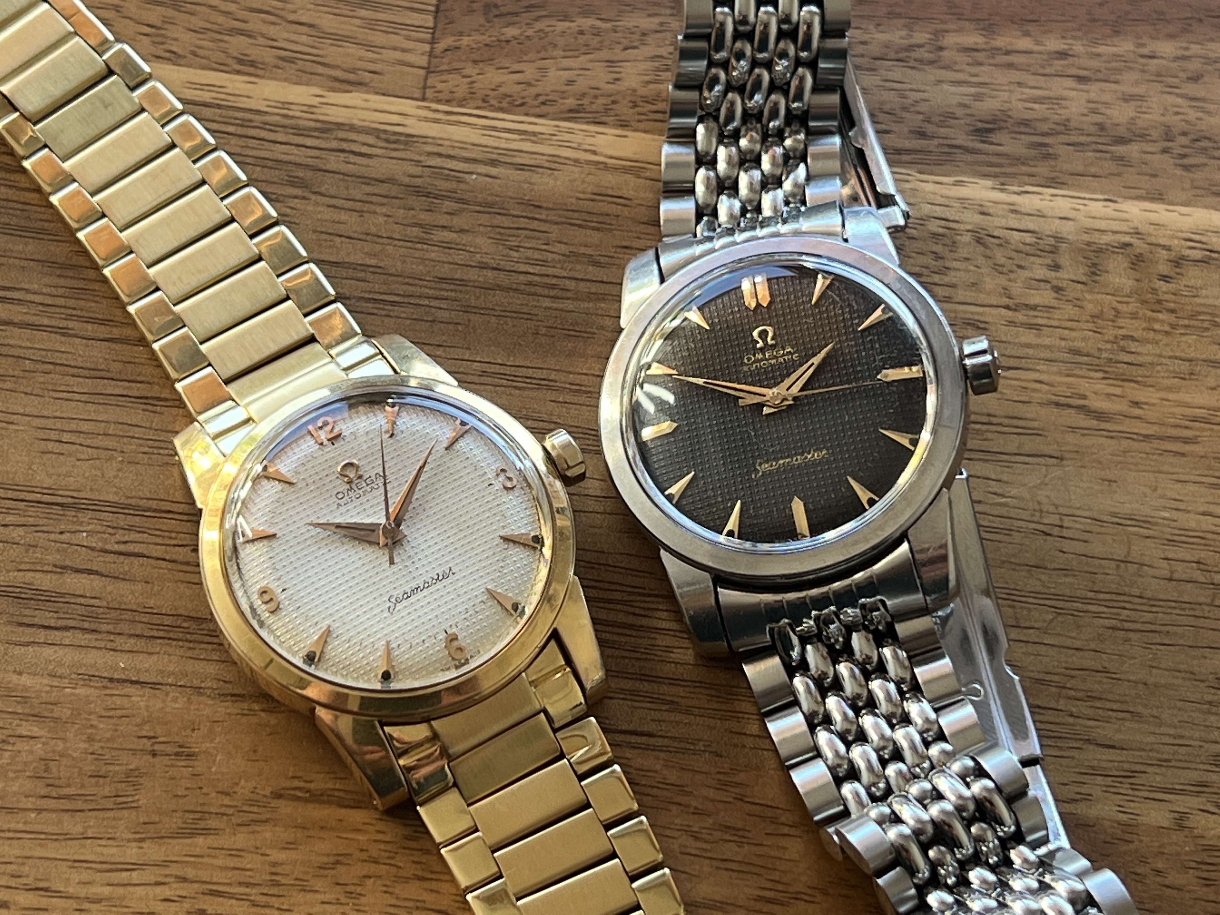

This is a slightly odd topic, as I believe there isn’t actually a “correct” bracelet. I believe the beads of rice bracelet was introduced in the mid-50s, the 7077 flatlink in 1957. Accordingly, during the production of the 2577, both options were not available, even though they fit rather nicely:
(Left: A 7077 flatlink in 18k yellow gold. They also came in rose gold and, most commonly, in steel. The endlinks that connect them to the 2577-case are #4; Right: 5-row Beads of Rice bracelets are also a great fit and much more common. Early examples had a sliding clasp and unstamped end links, more commonly you’ll find 1502 bracelets with #11 end links. They all fit the same)

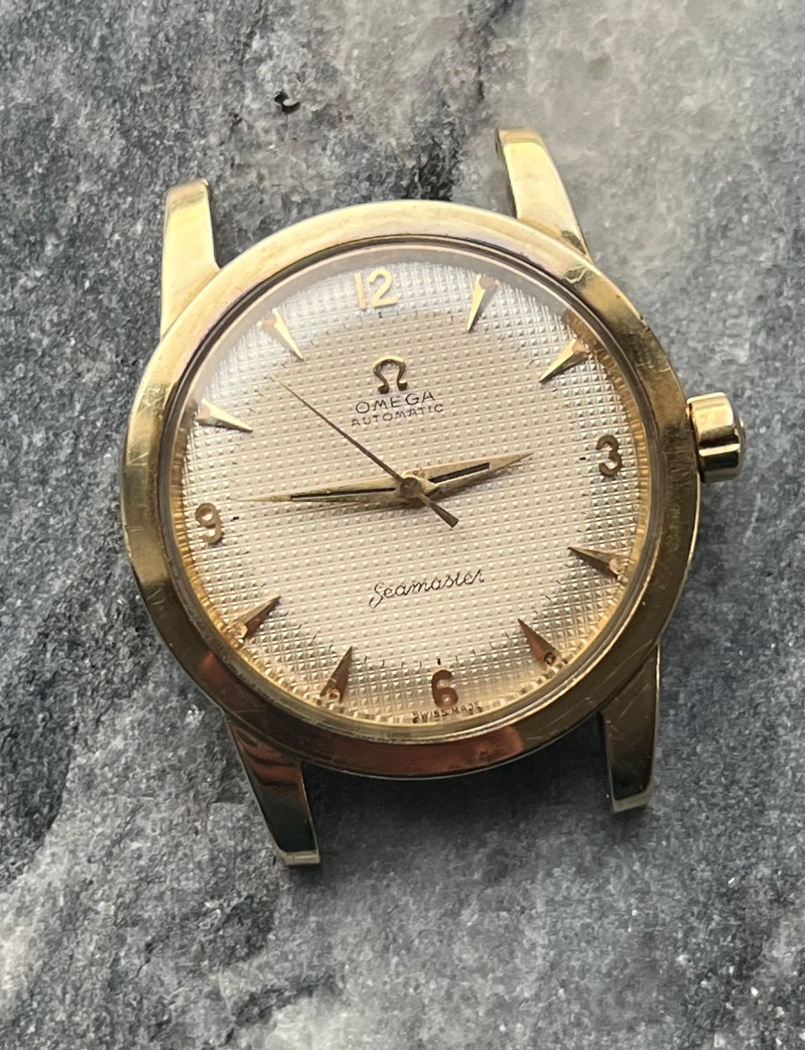

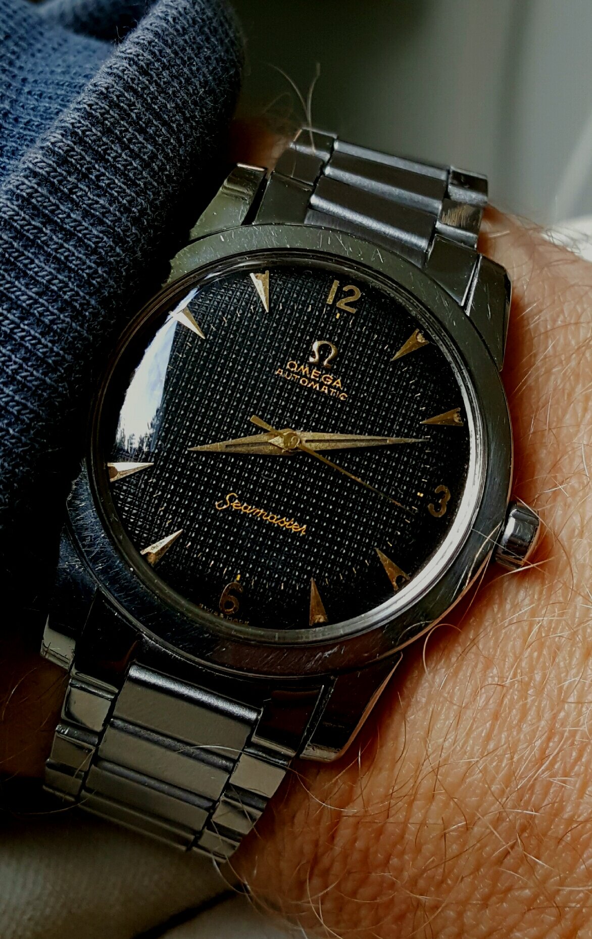

Breguet numerals are a among my favorite style features of 50s Omegas:

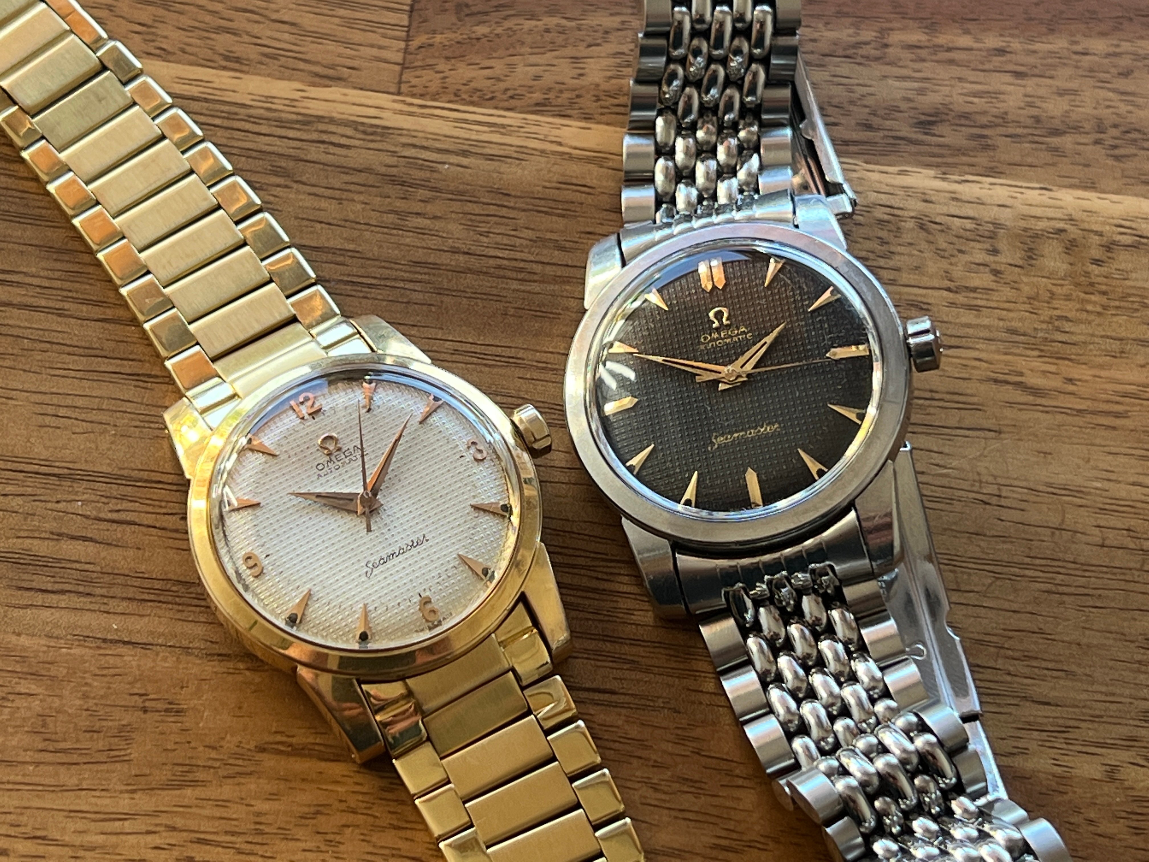

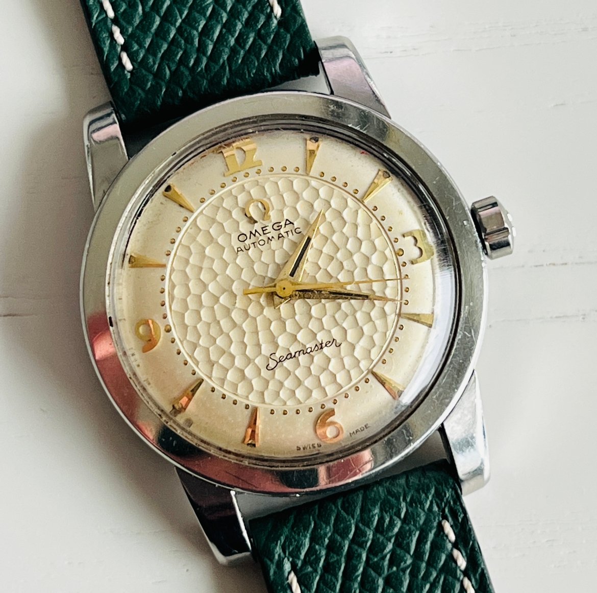

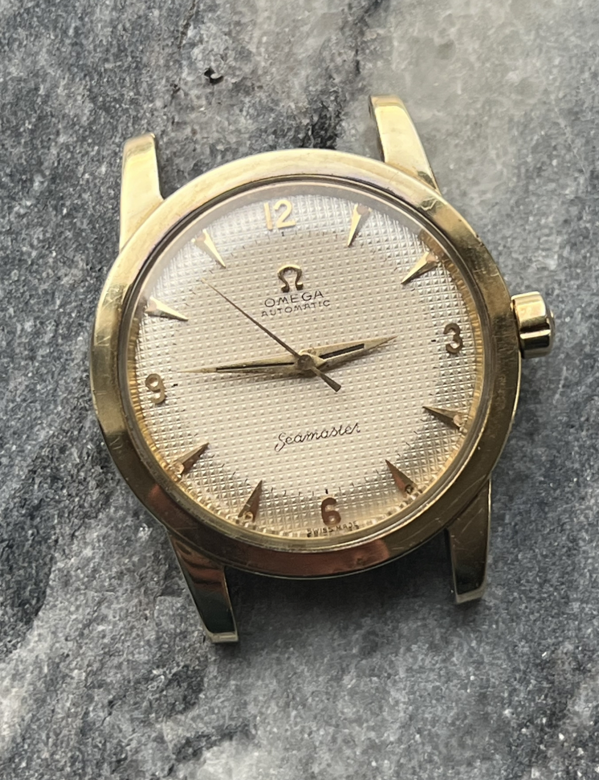

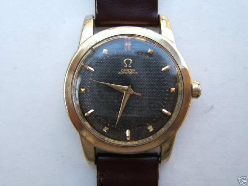

Another two-tone hobnail dial example. Note that, contrary to the one shown in my previous post, this one is gold-capped with unusually sharp lugs.

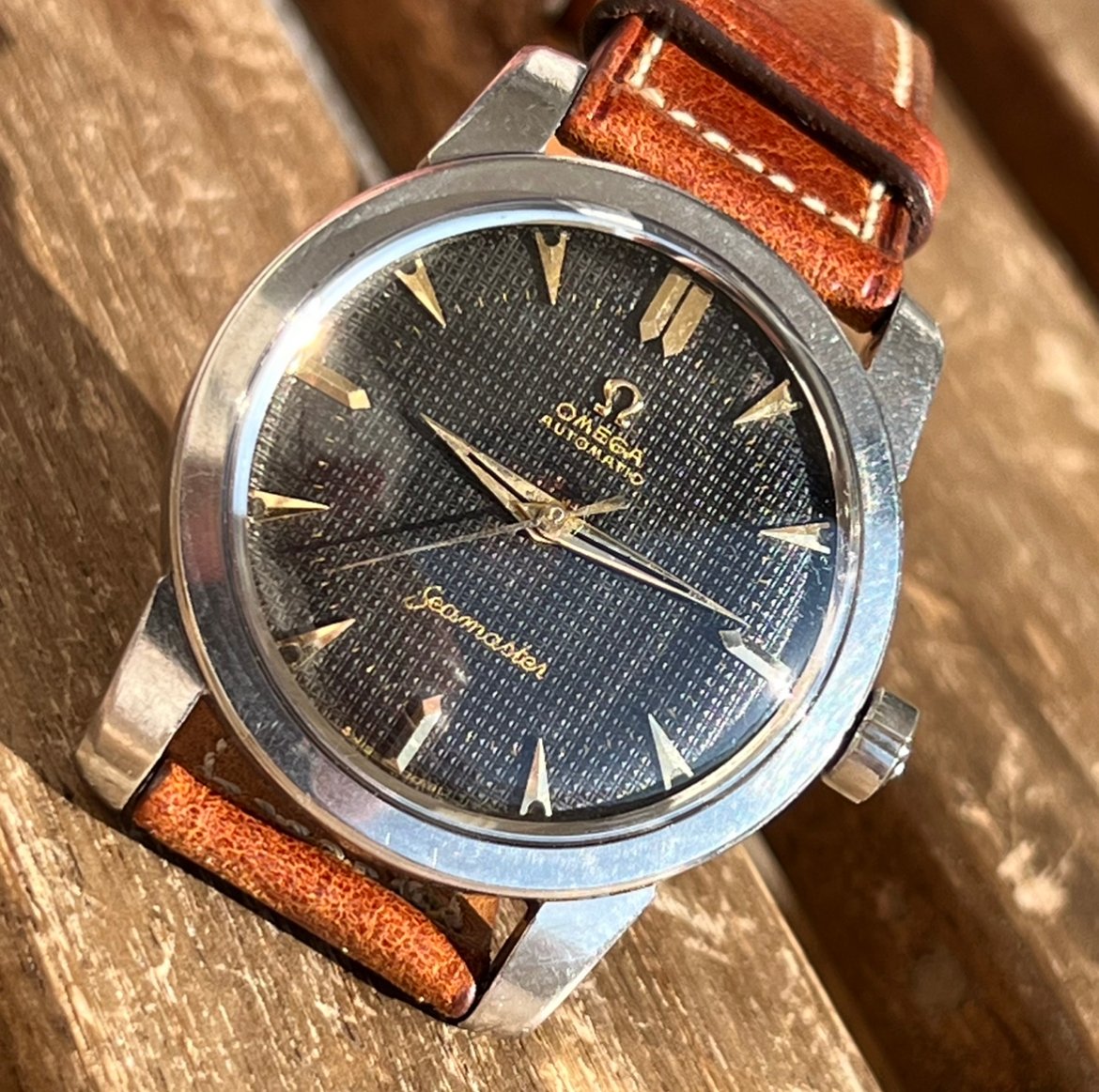

A better picture of the black hobnail dial shown above, one of my favorite watches

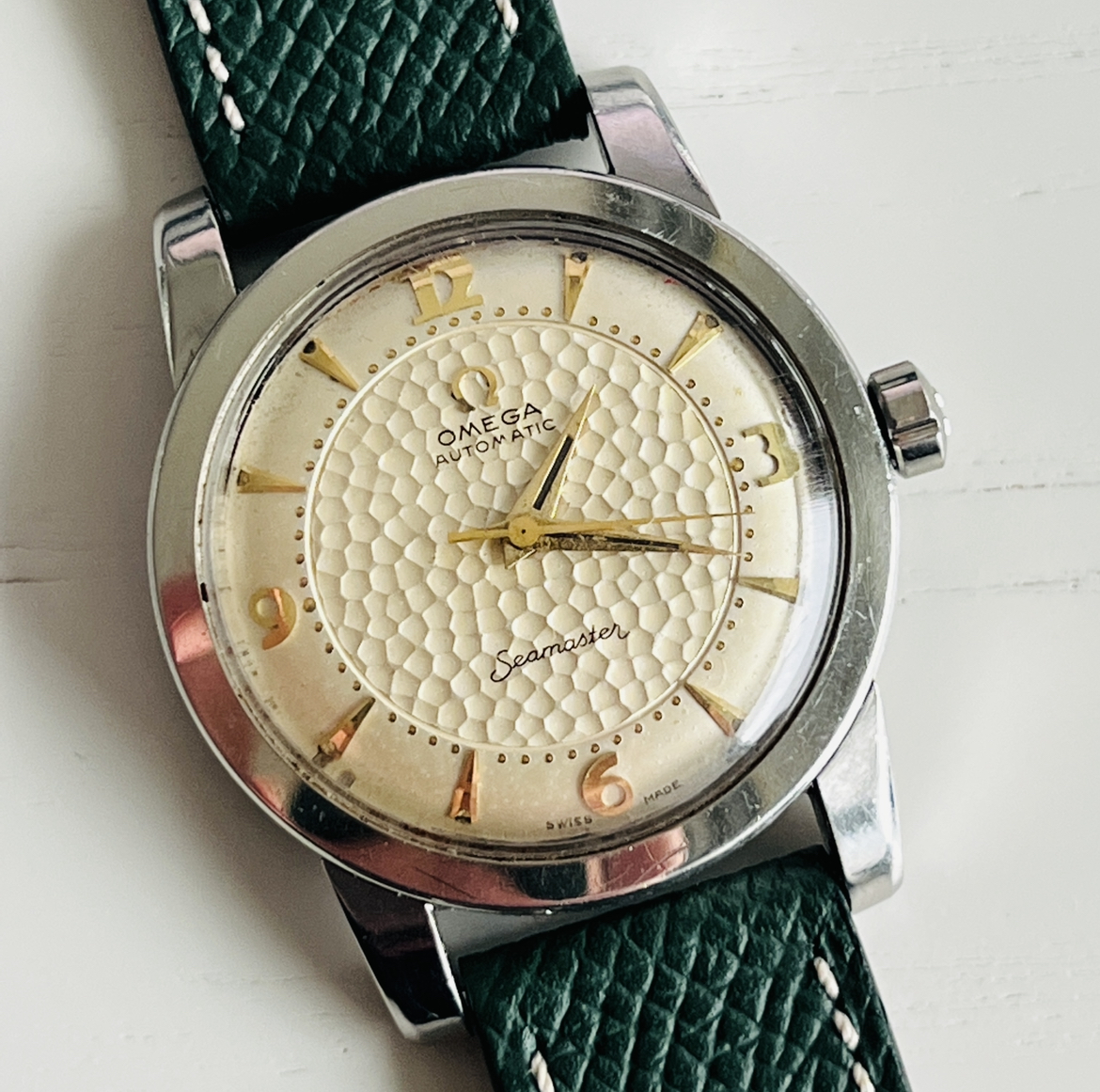

A recent arrival, and a rather uncommon one, the “golf ball dial”. It’s a funky piece, in numerous ways. The structure of the dial is more pronounced than the picture might make you believe. Then, there are a few oddities: The font of the numerals is, I believe, unique to this particular incarnation. The Omega logo is different from all other 2577s, in fact it might even be different to all other Omegas from the period. It’s not the regular flat feet one, but a much larger variant that we saw again in the 70s. It might also be the only non-Chronometer 2577 to come with those little gold dots as minute ticks. Either way: It’s even more fun than I imagined and I’m still stoked to have found one.

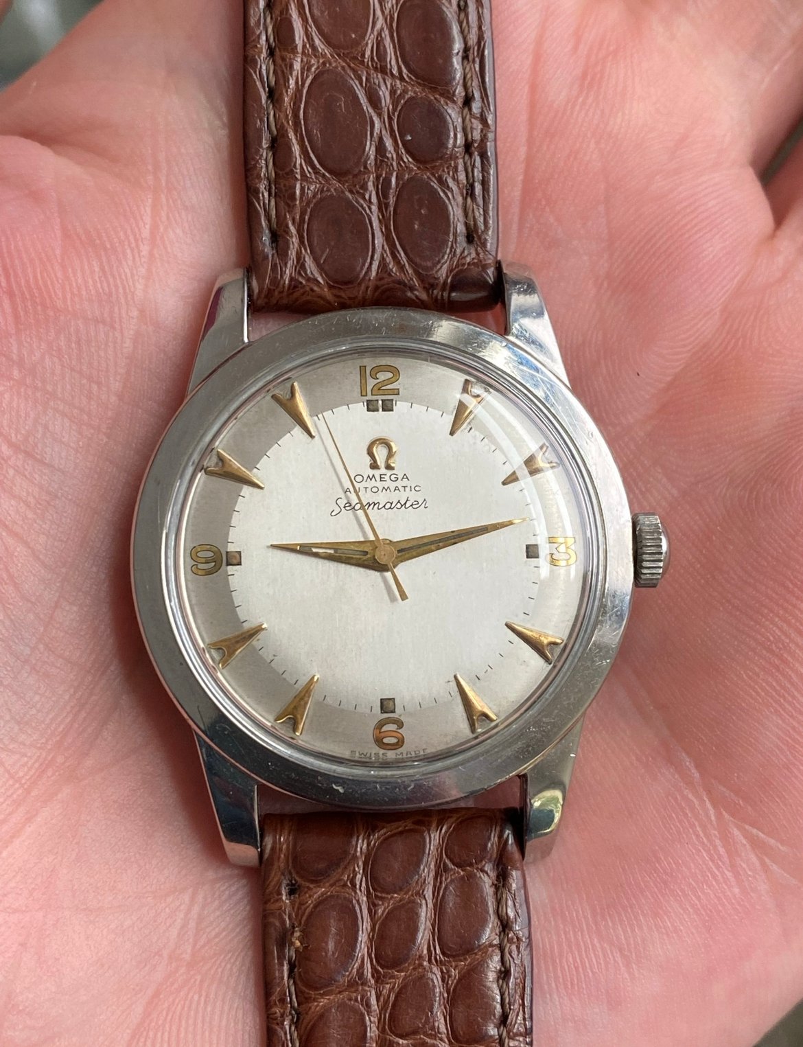

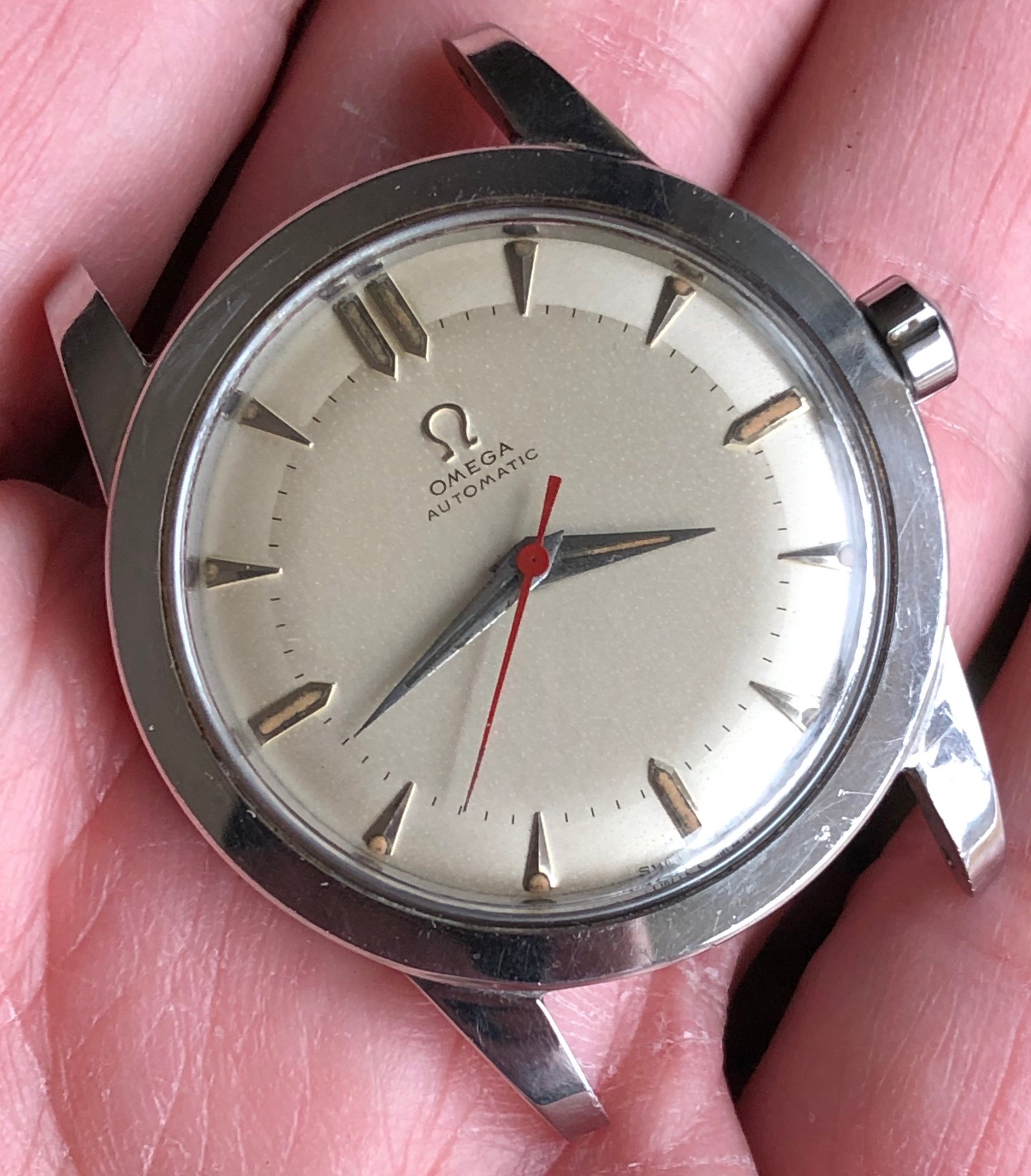

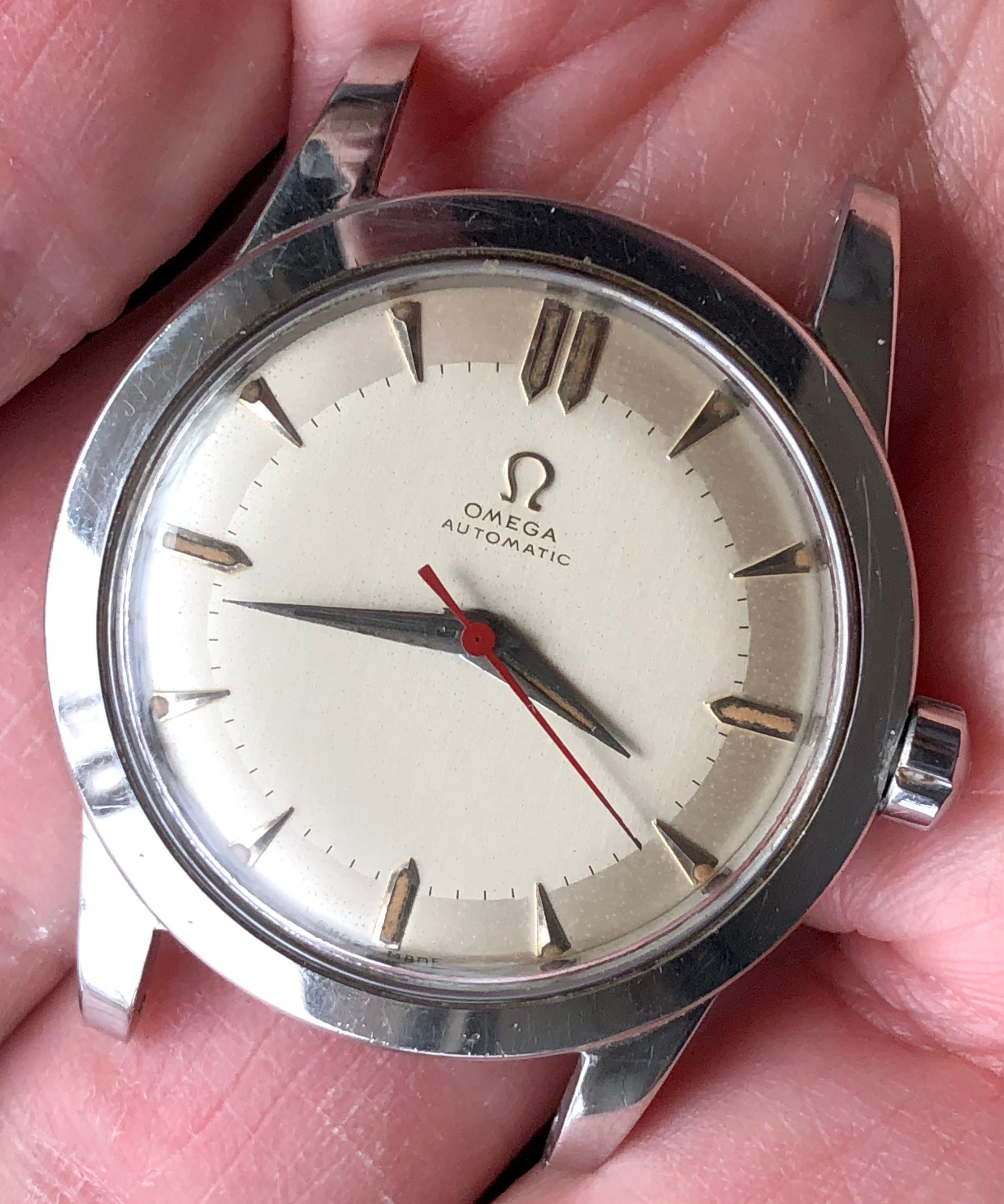

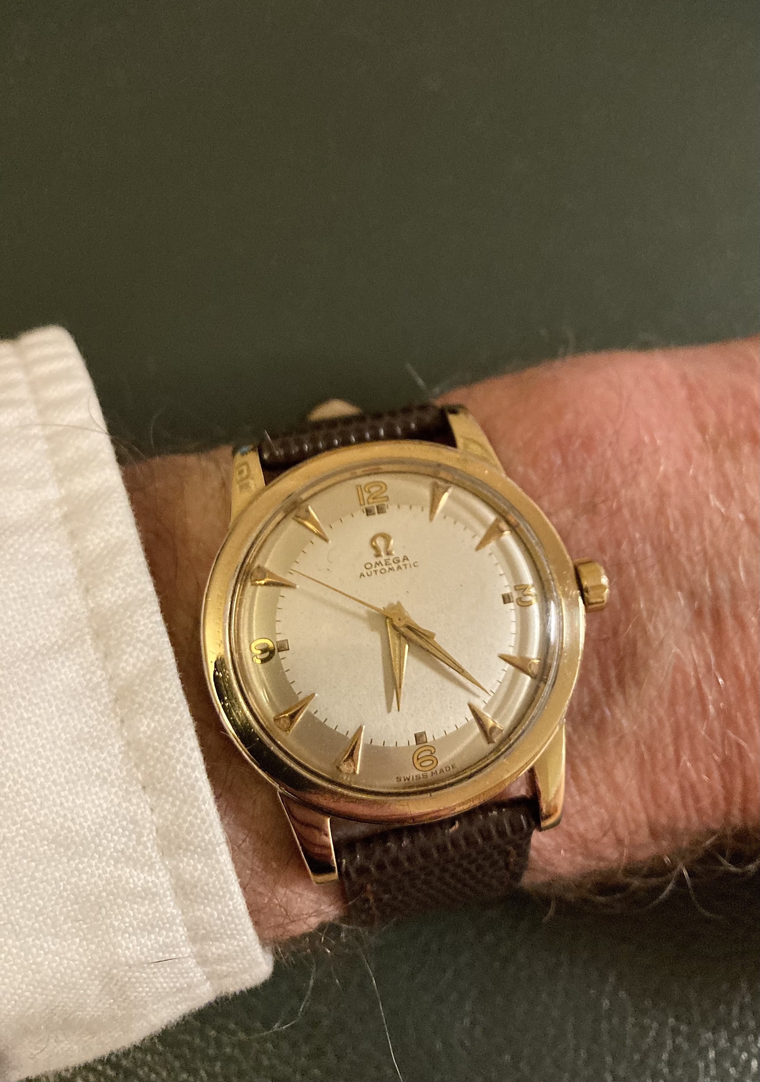

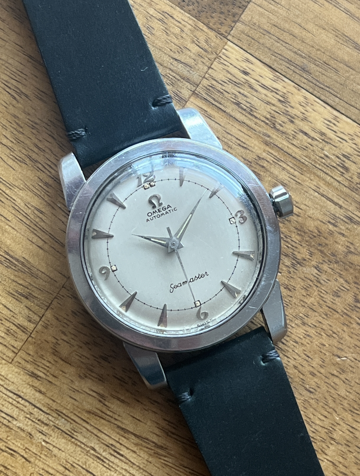

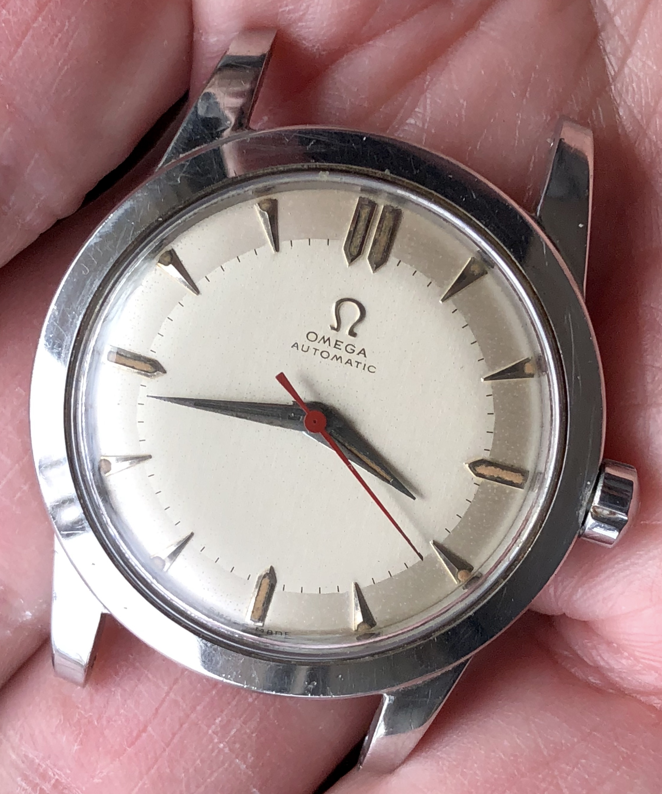

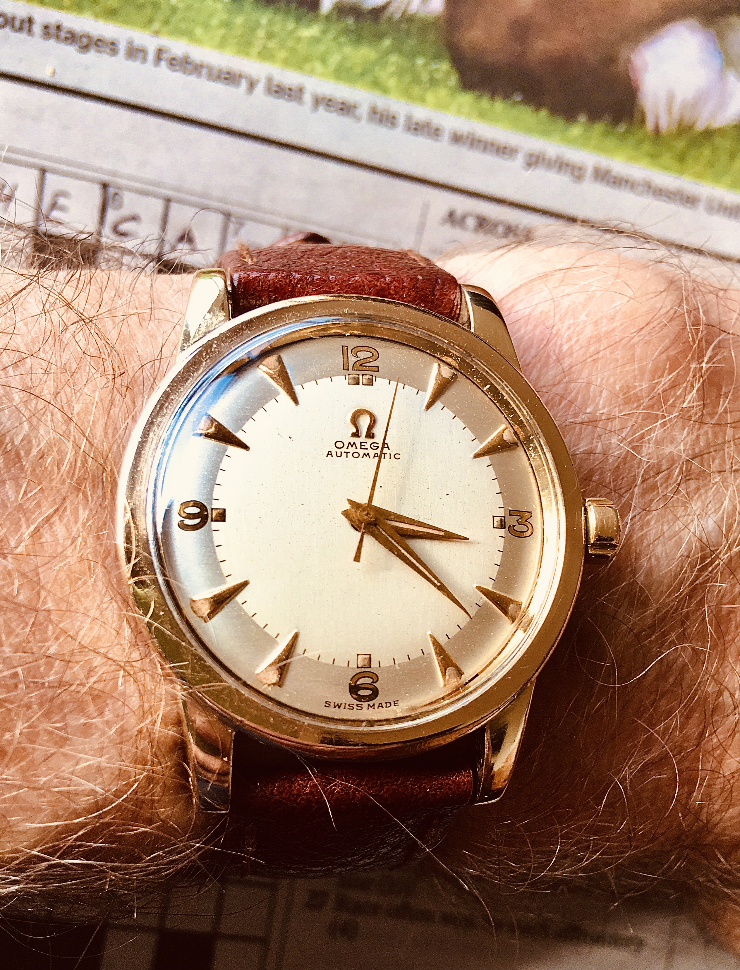

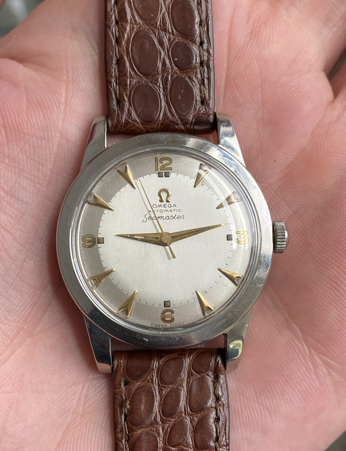

Here’s my 1950 2577 cal 351
Nice example without the model name, do I have your serial in the list in my first post?
10,805
16,814
Very nice example. I'll be surprised if that is 1950, I would have thought 1948 or 49 based on the lack of SM text. As above, share the first part of your serial and we can dig deeper.

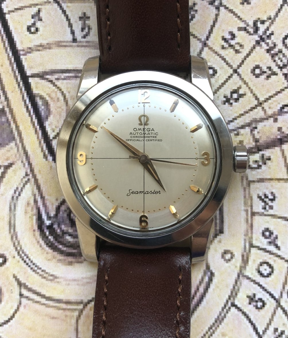

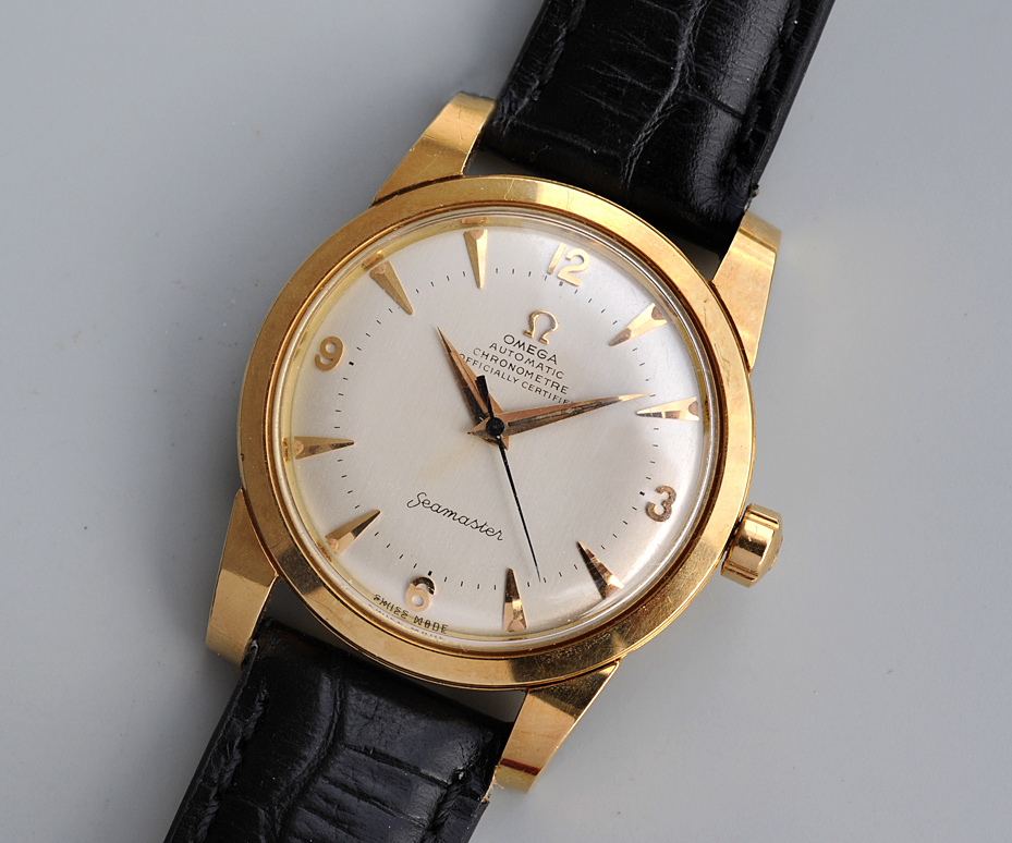

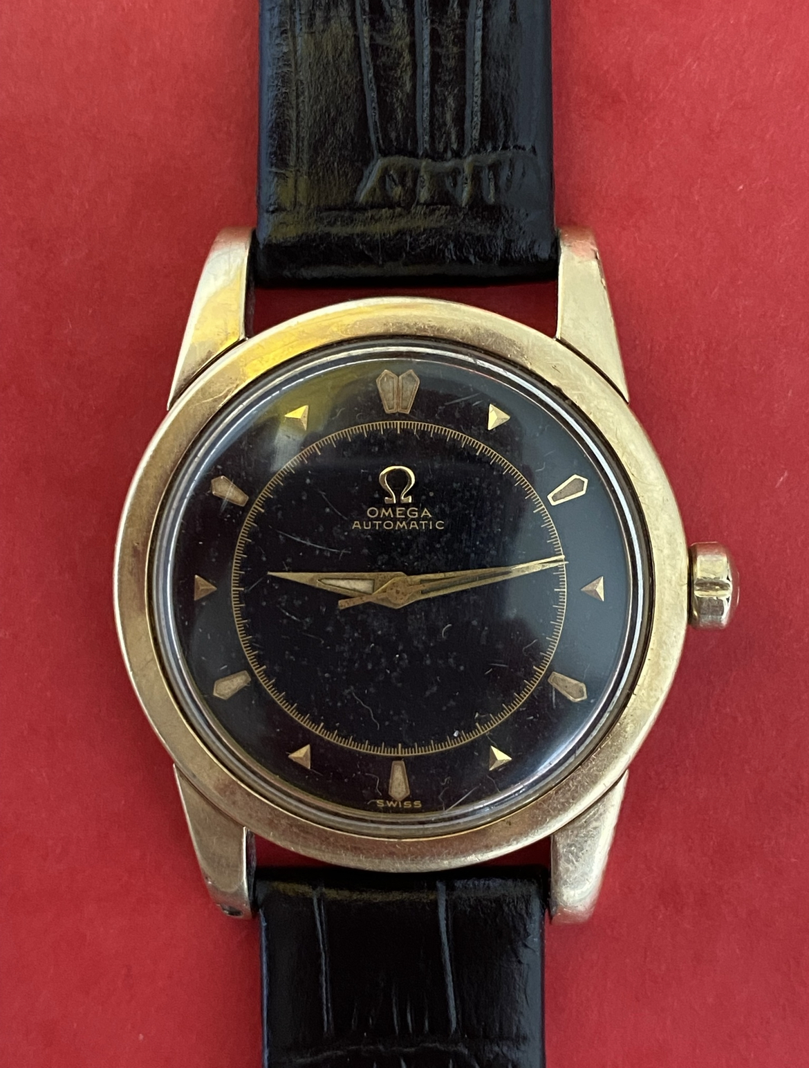

Here are some of mine

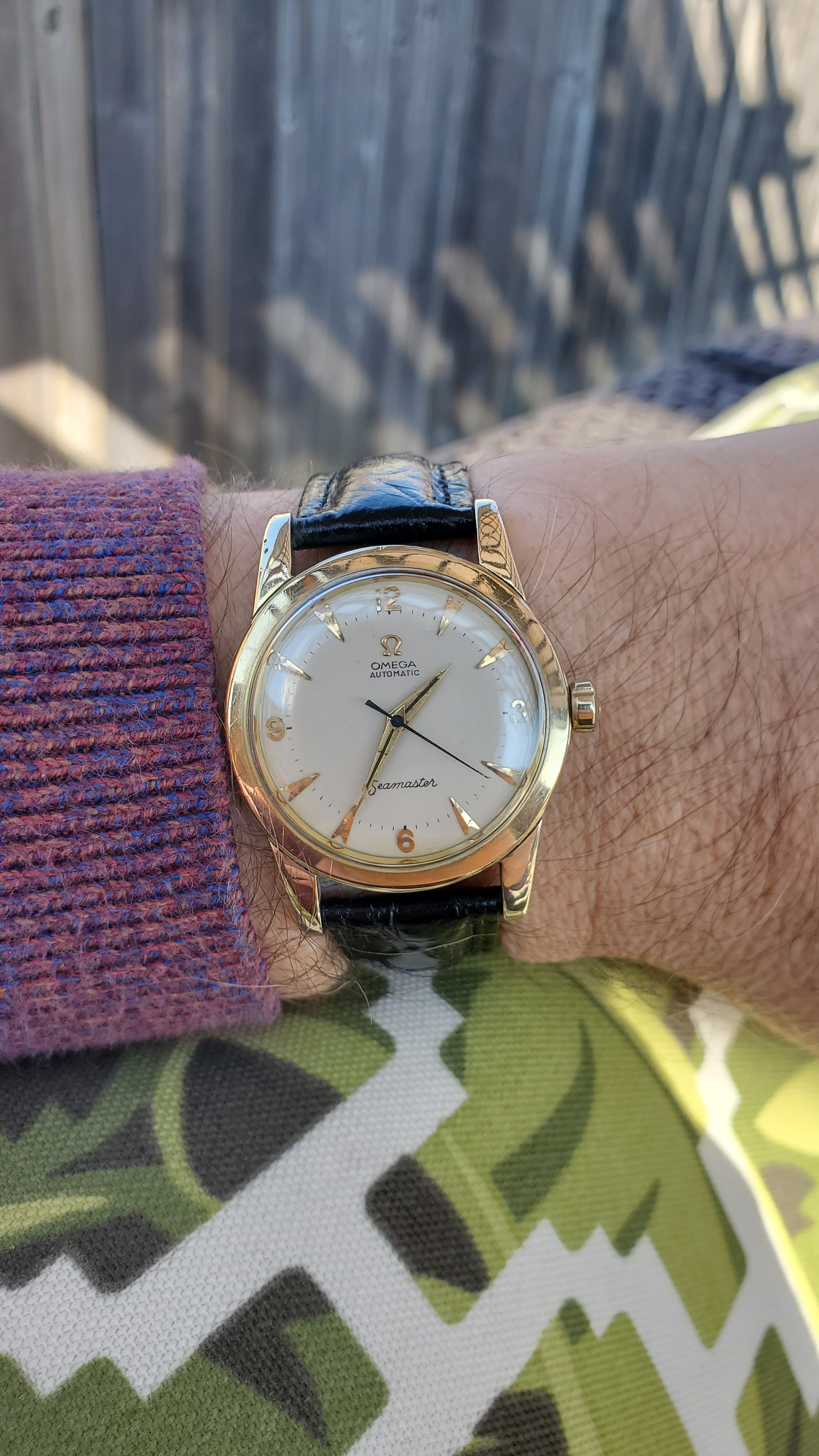

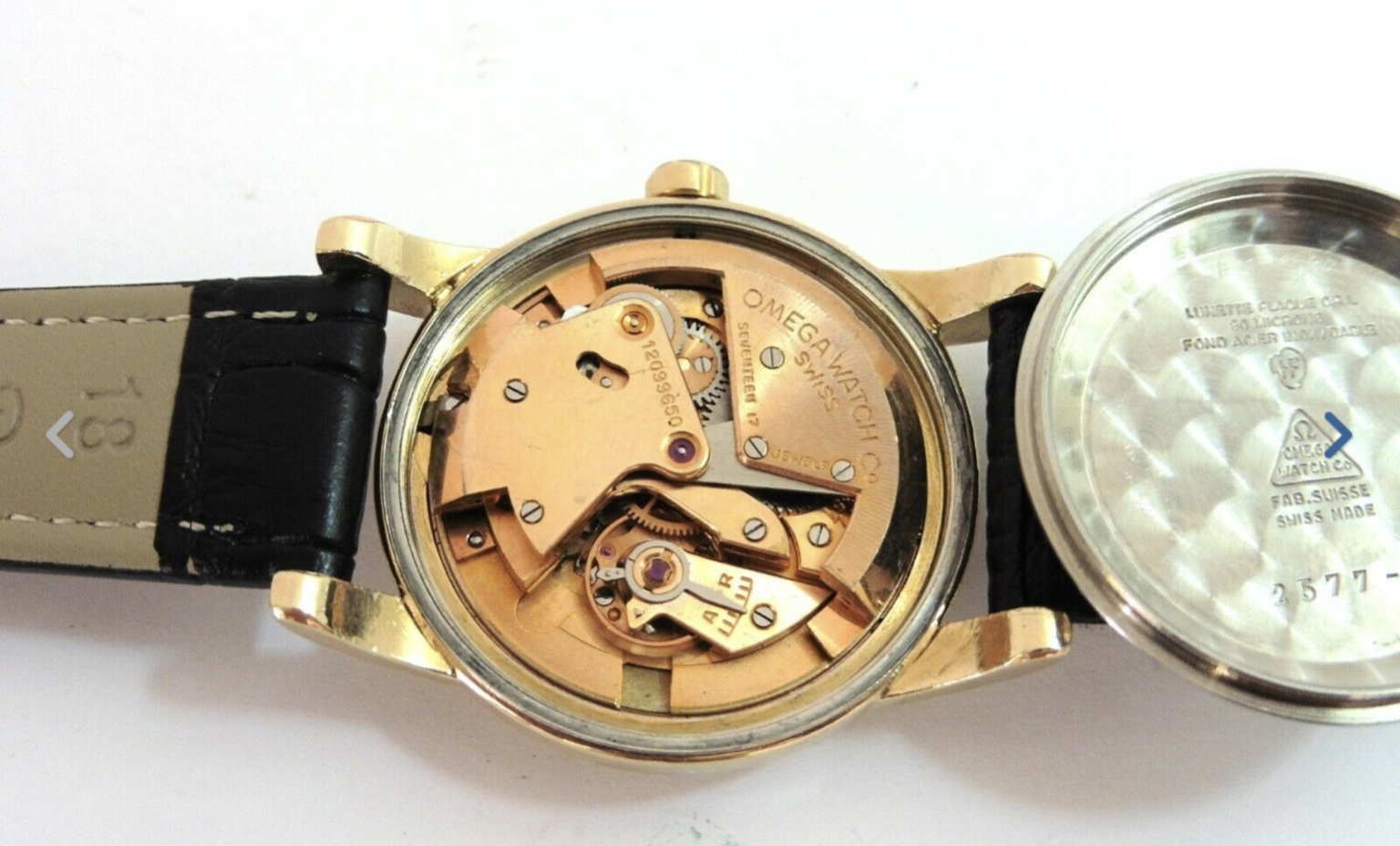

a near mint 18K chronometre with cal 352, serial 12.52xxxx
a later SS one with serial 13.242xxx, cal. 354 with uncommon dial
I think 2577 was cross-referenced with ref 2520

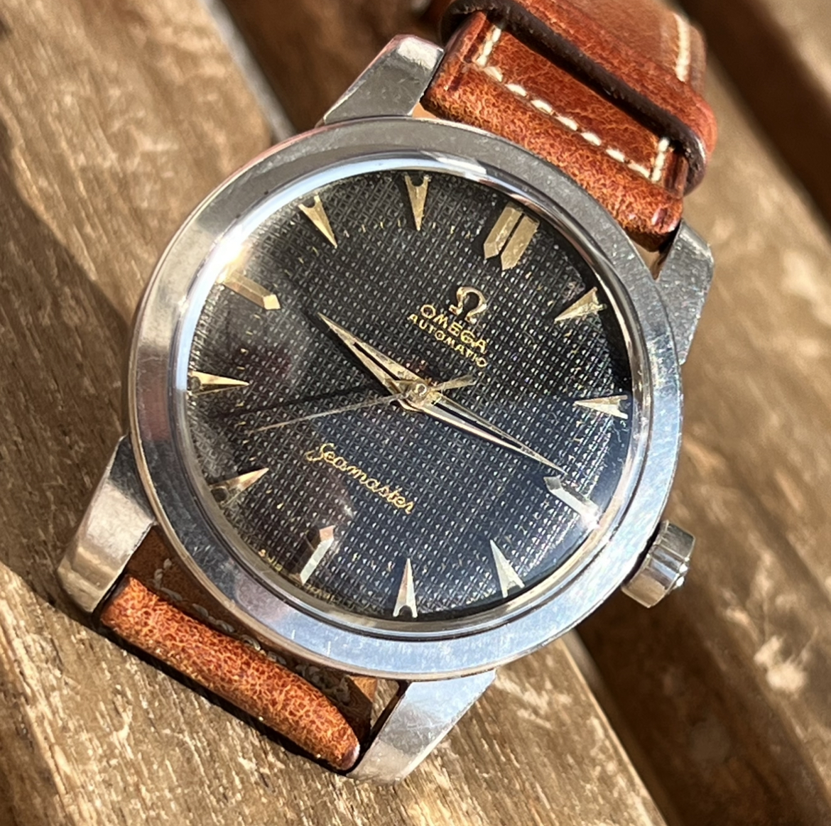

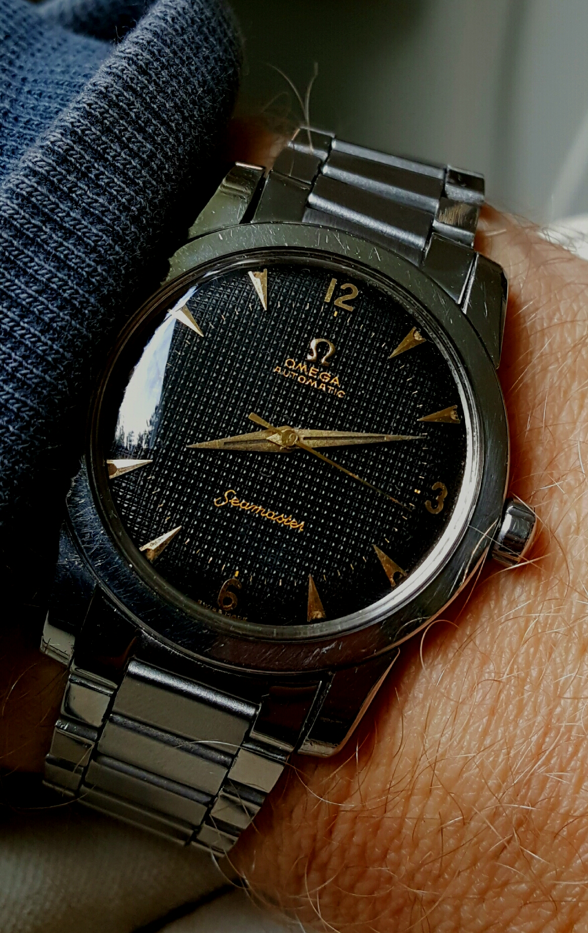

Here’s my contribution, black waffle dial from 1952.

Thank you, and I’m more than happy to. It’s 12099650. I’d have liked it to be a 1949 number, which would have made it a ‘birth year' watch but, given that I have this, and it is nice, I’ve decided to adopt my wife’s practice and remove a year (or two in her case) from my actual year of birth 😉
10,805
16,814
Fair enough, that is the highest serial seen so far without the text so I guess you might be right!

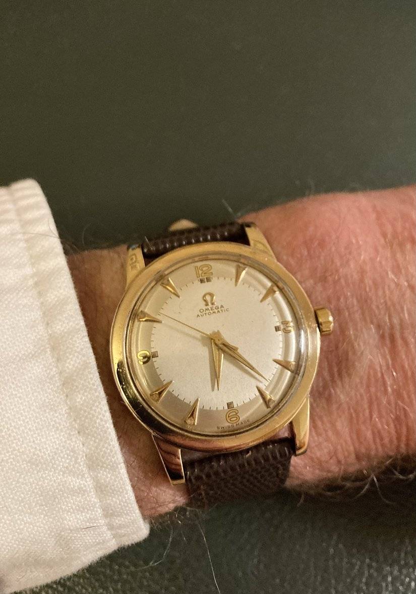

Here is mine with a redial unfortunately, but similar look to the above nice chronometer. Missing Swiss made and lume, but has same markers and blued second hand. 2577-10 gold filled, serial 12.67m, 351.

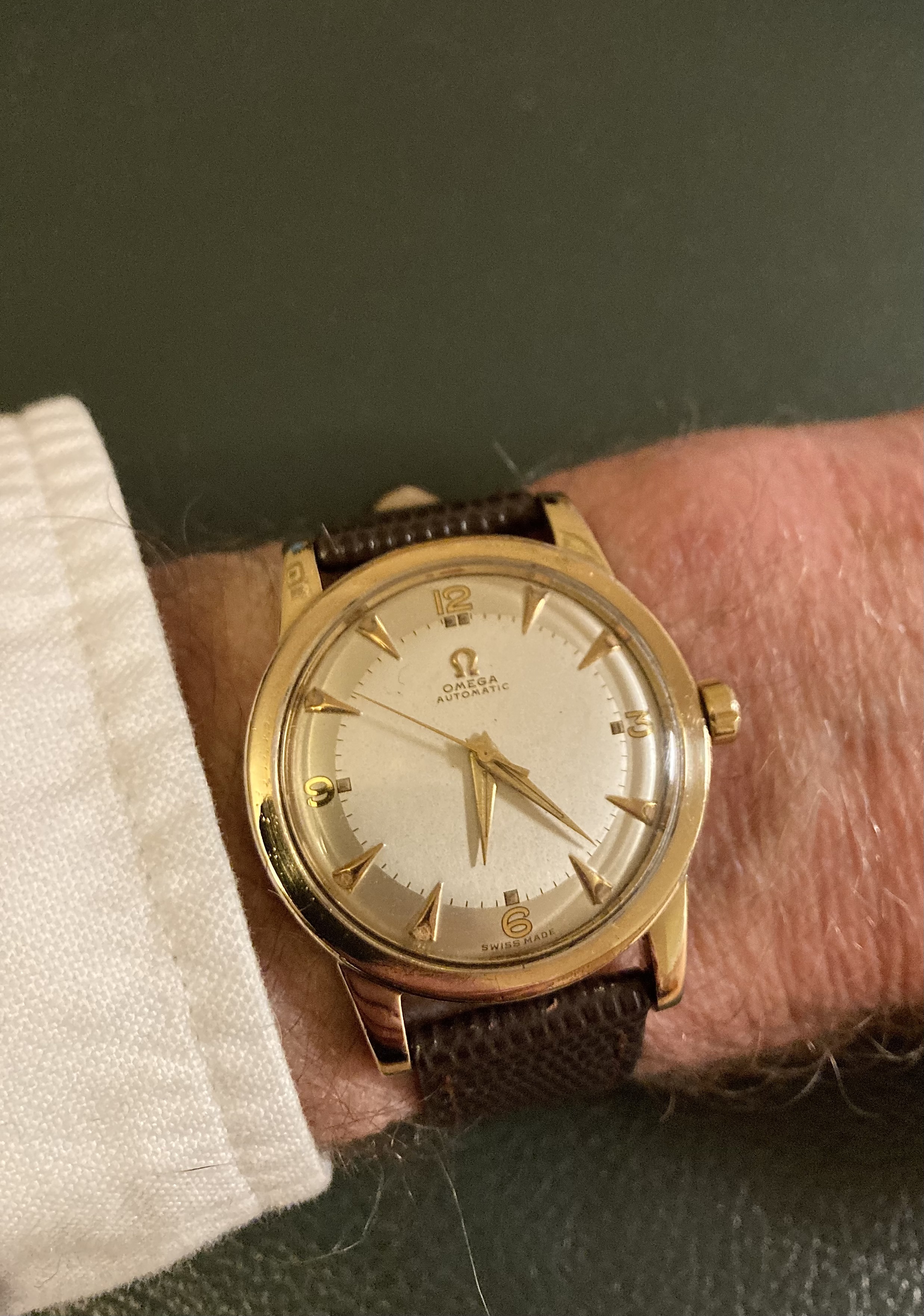

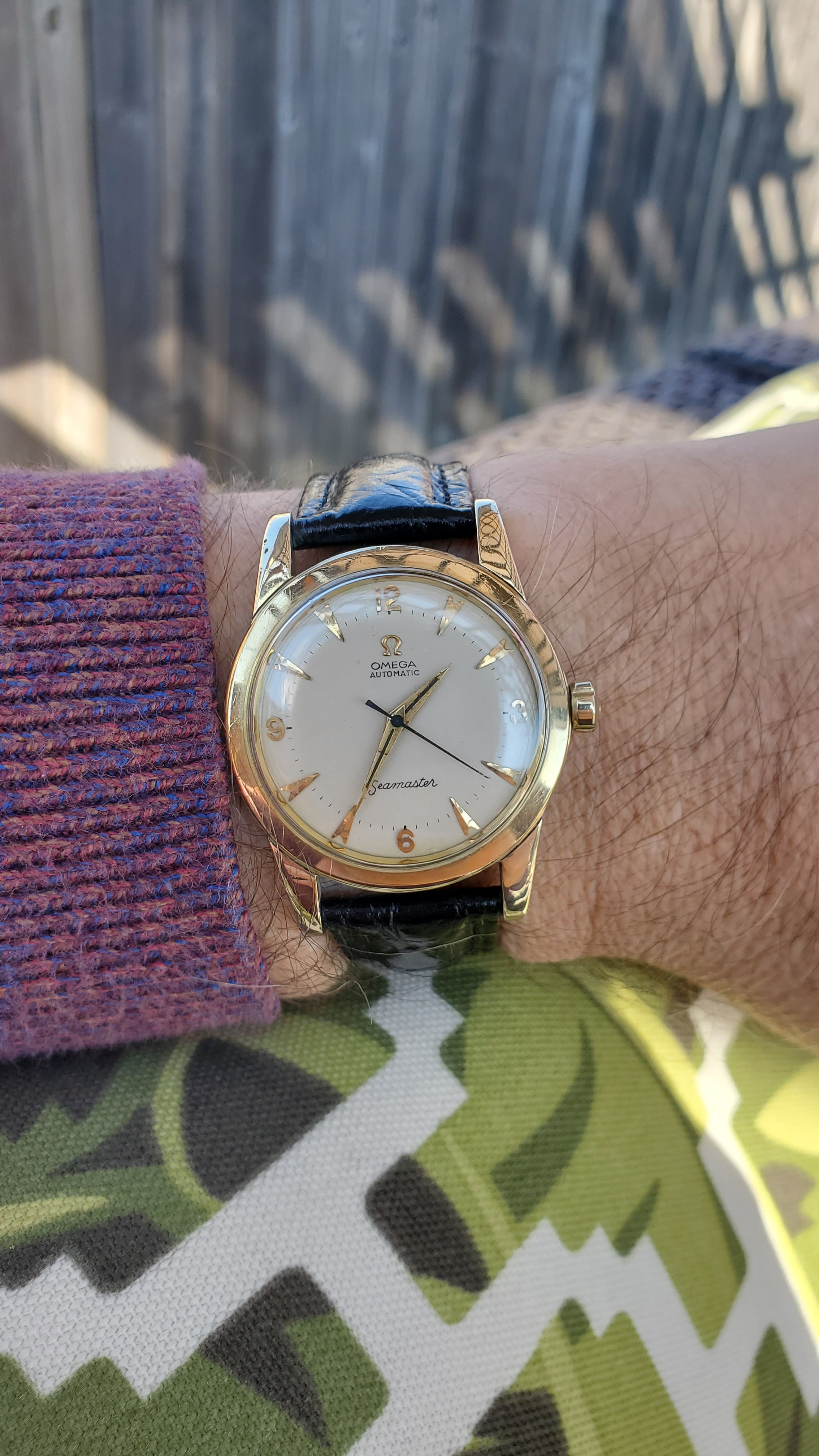

Here's my contribution....the only one I have at the moment...but I think I need one of those chronometer versions asap

If I remember correctly, the thinner lugs stainless steel case has no removable bezel, while the thick lugs ss case has a removable bezel. Am I right?

Yup, for solid gold examples, I believe. That 18k Chronometre of yours is in an uncanny condition. Absolutely stunning!

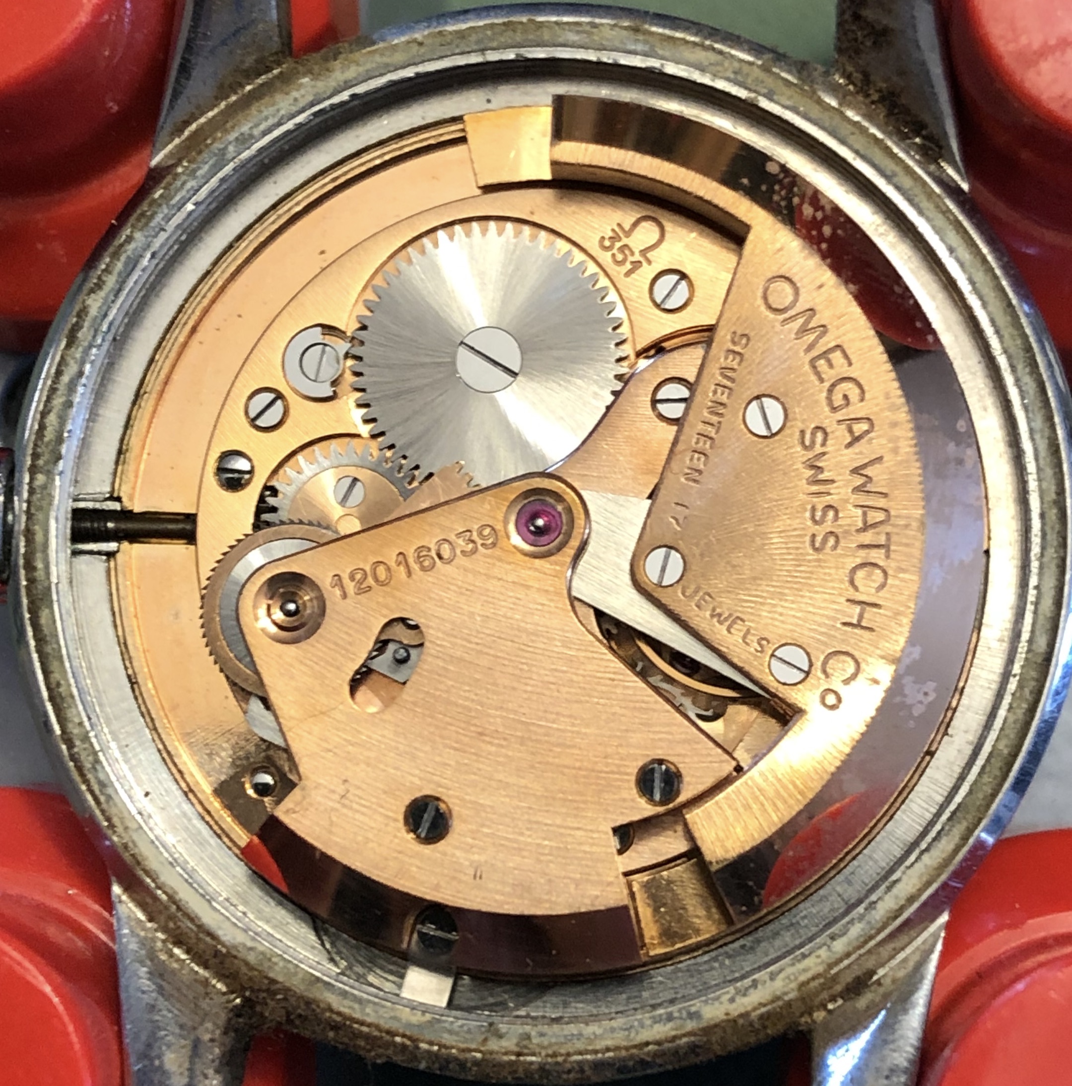

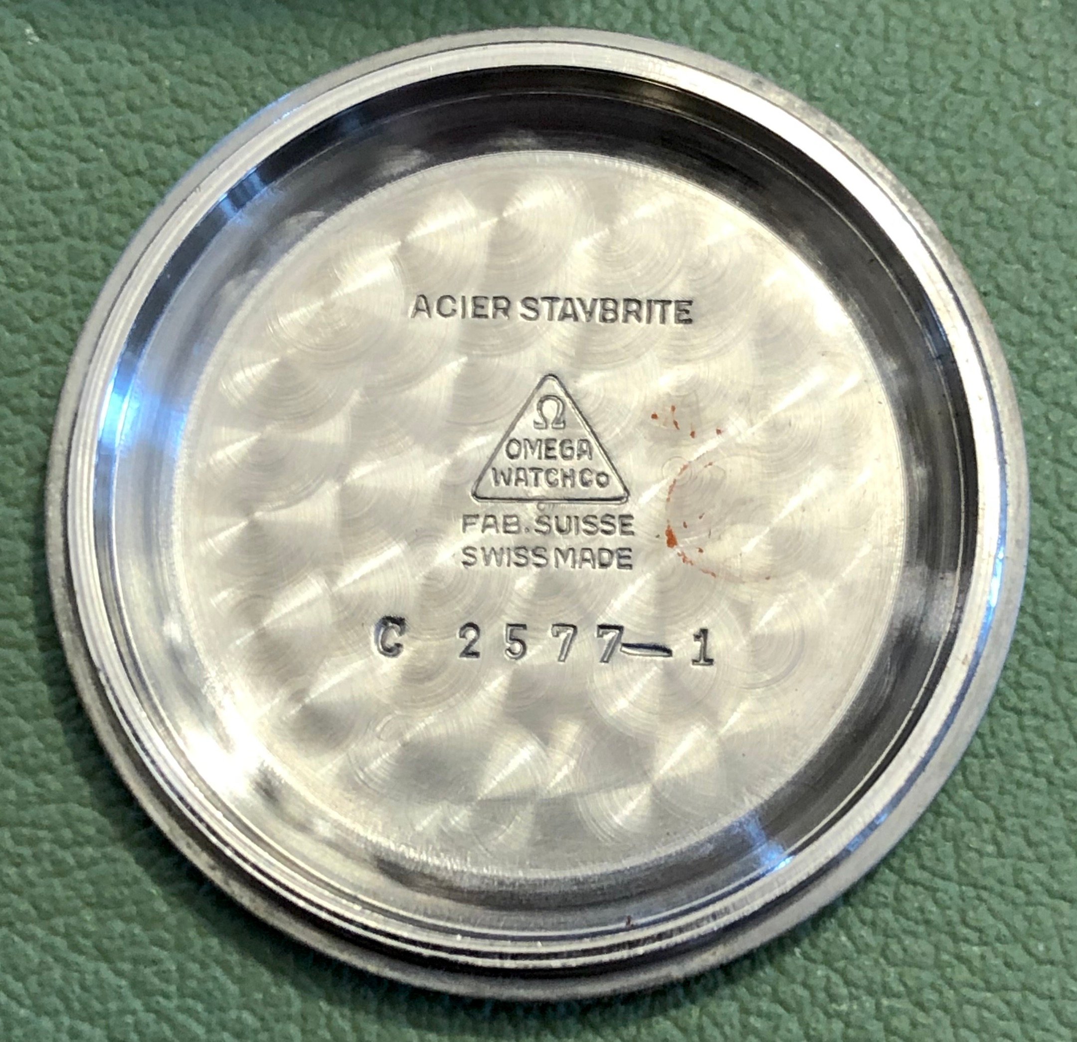

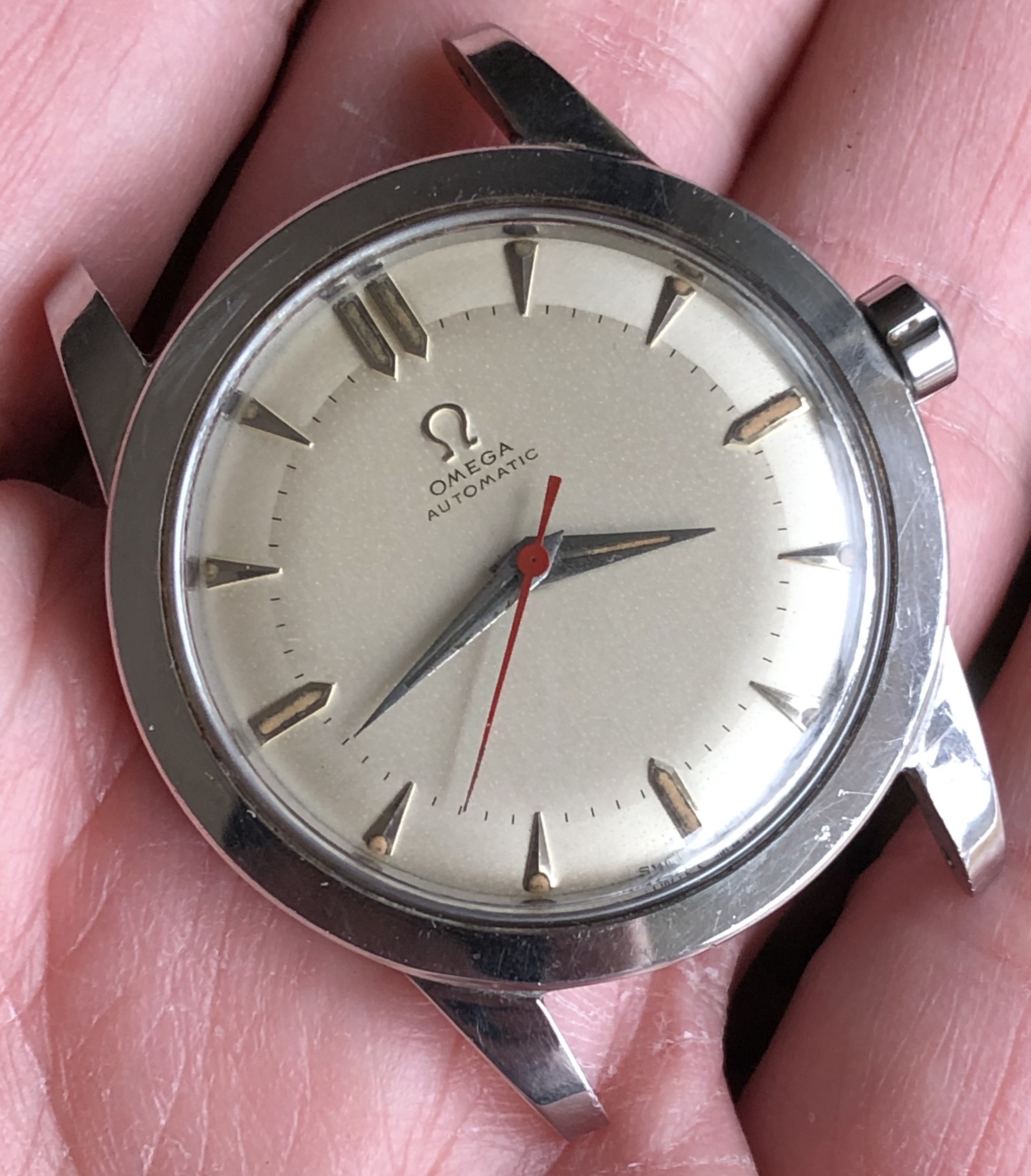

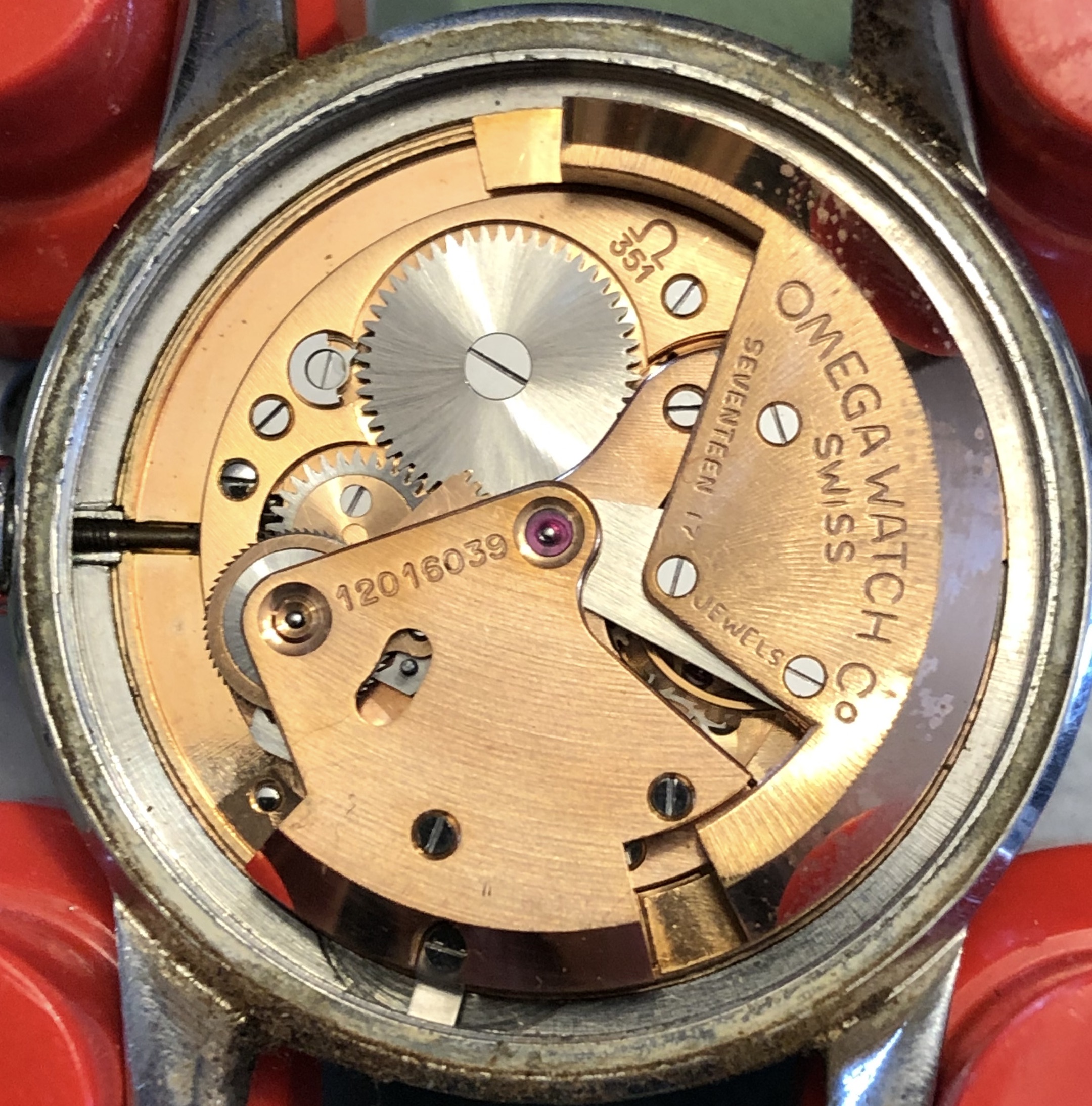

No-Seamaster, 12,016,039, cal 351, SS, 2577-1.
Awesome, thanks! Will add it to the list and update it on occasion in the first post.
Good point, and yes.

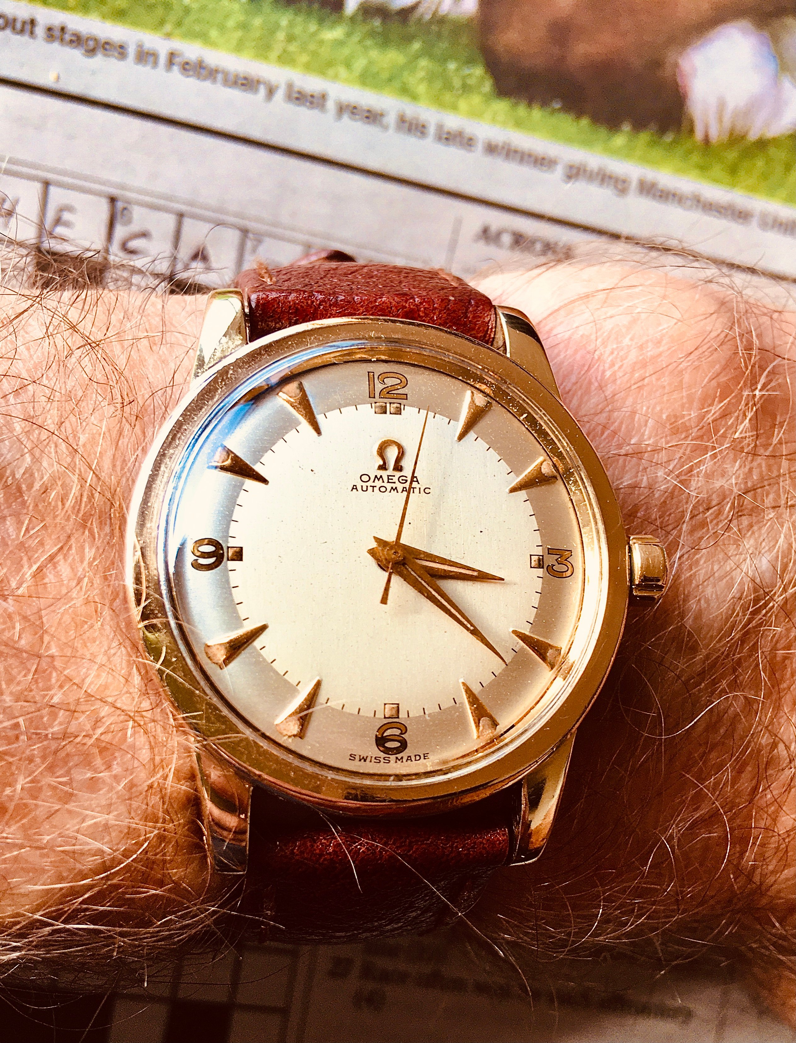

I bought it on eBay a few years back.
This is a better photo.
The starting price was £400 but no one else bid and I got it at that price.
I was worried that I’d missed something in the photos and that no one else bid for it because they’d all realised something that I hadn’t 😵‍💫
