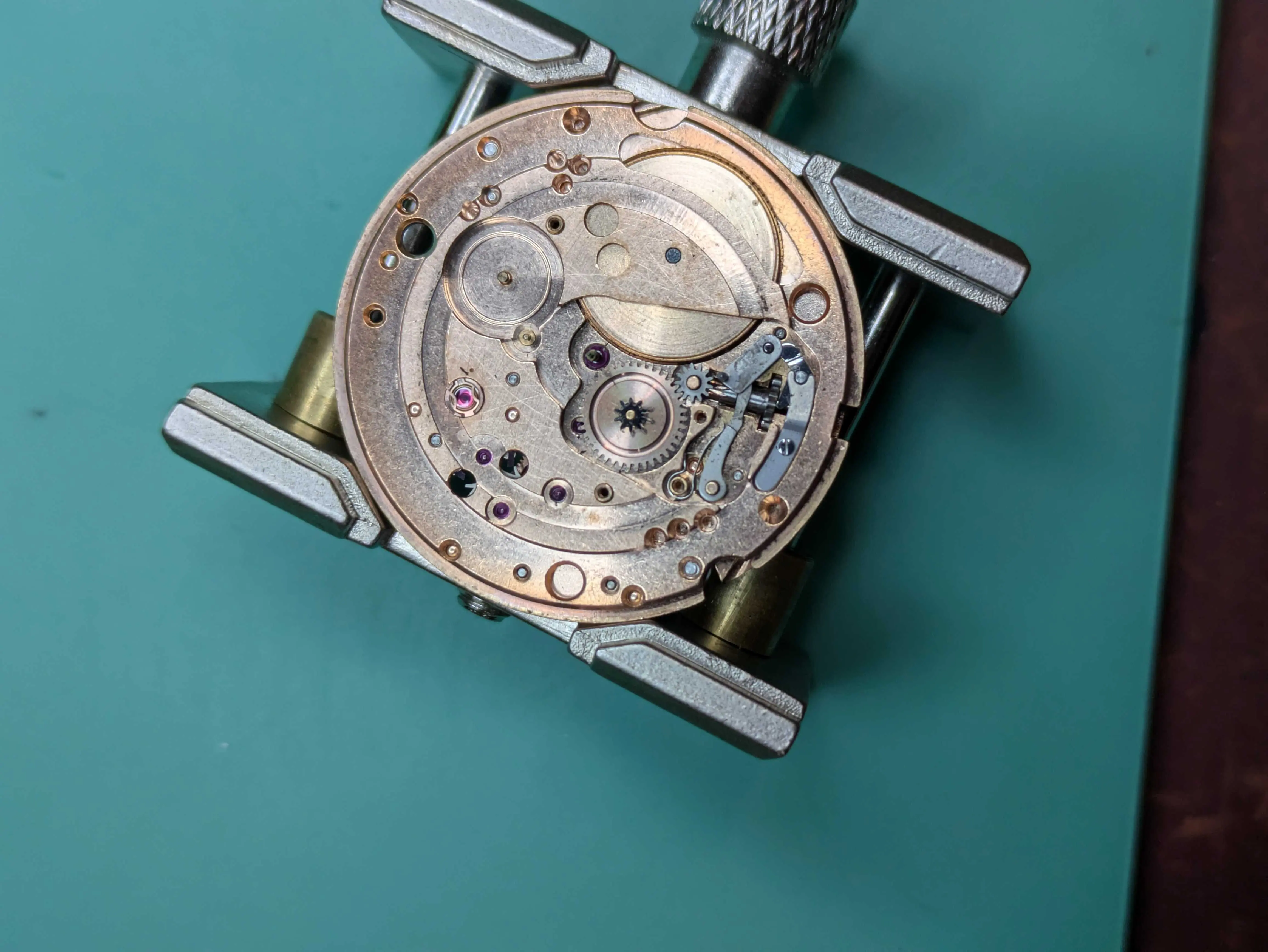

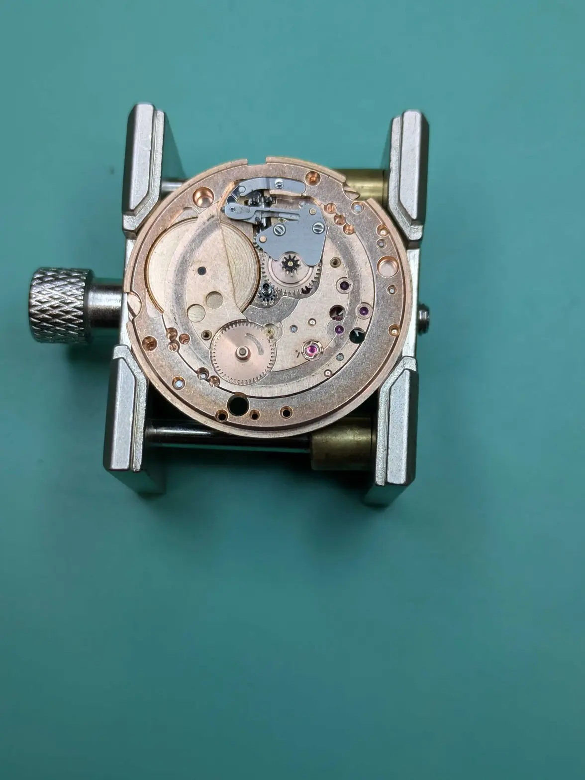

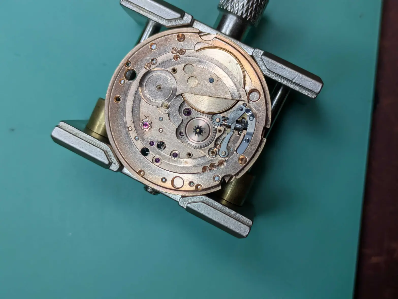

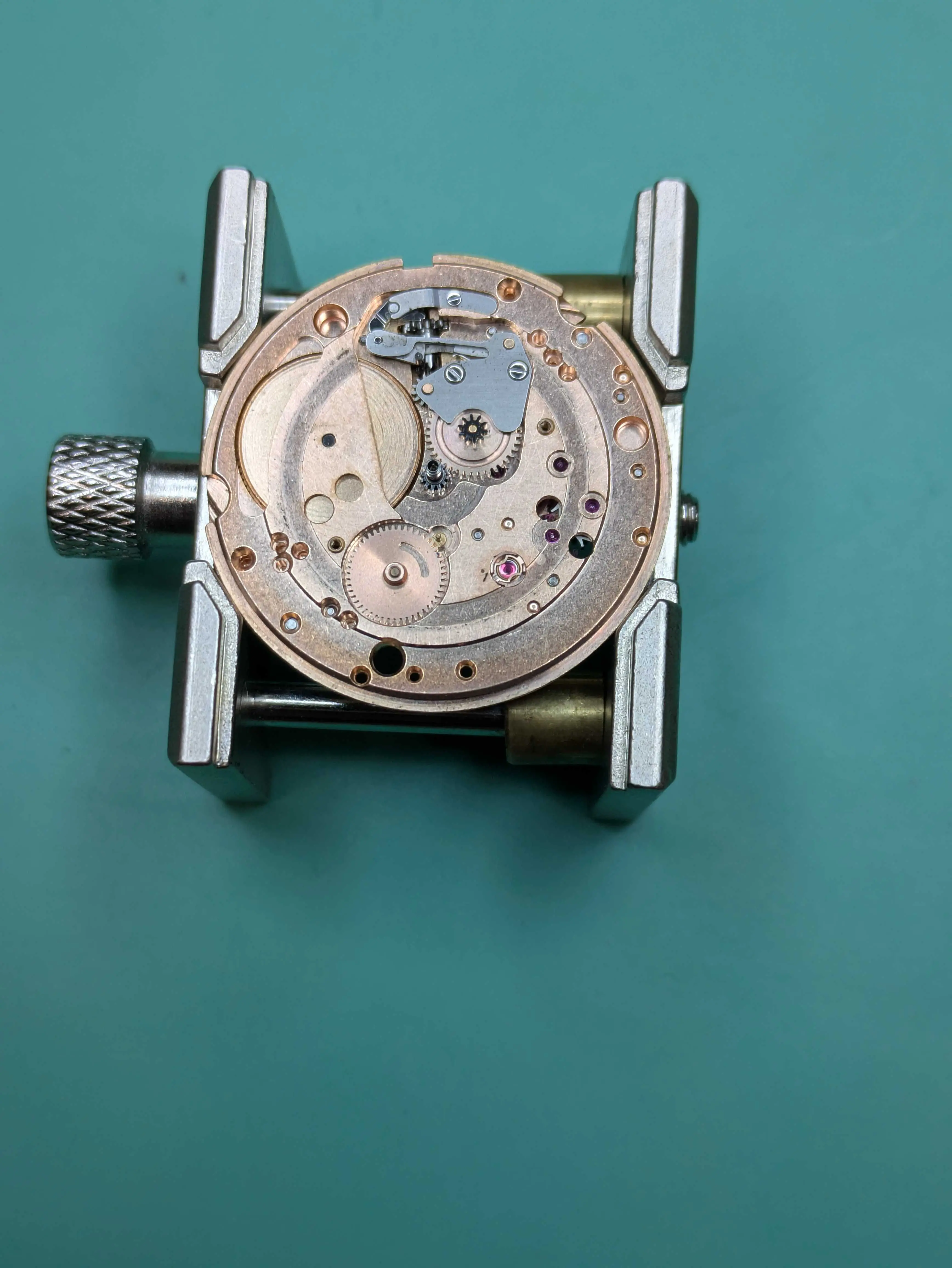

Some photos of the 613 I pulled apart at one point for clarity of what I'm discussing:
I've now heard a few times (this time from a friend who sent their dad's watch to a NAWCC member) that one shouldn't use the quick-set date on a 563 (and presumably 613), as it is very fragile.
This got me thinking: I have a 613 I tore apart and frankly, the quickset, though awkward, doesn't have any parts that look particularly fragile? Can someone share what the failure mechanism is for these? This seems like a fairly robust mechanism.

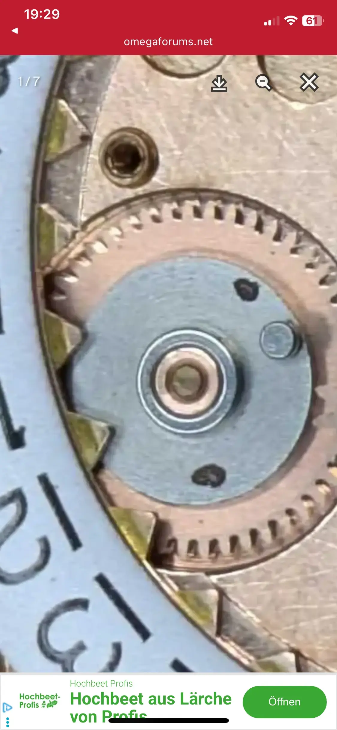

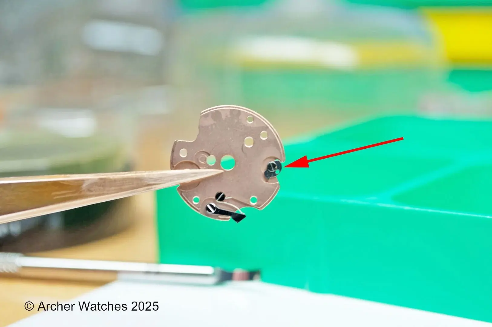

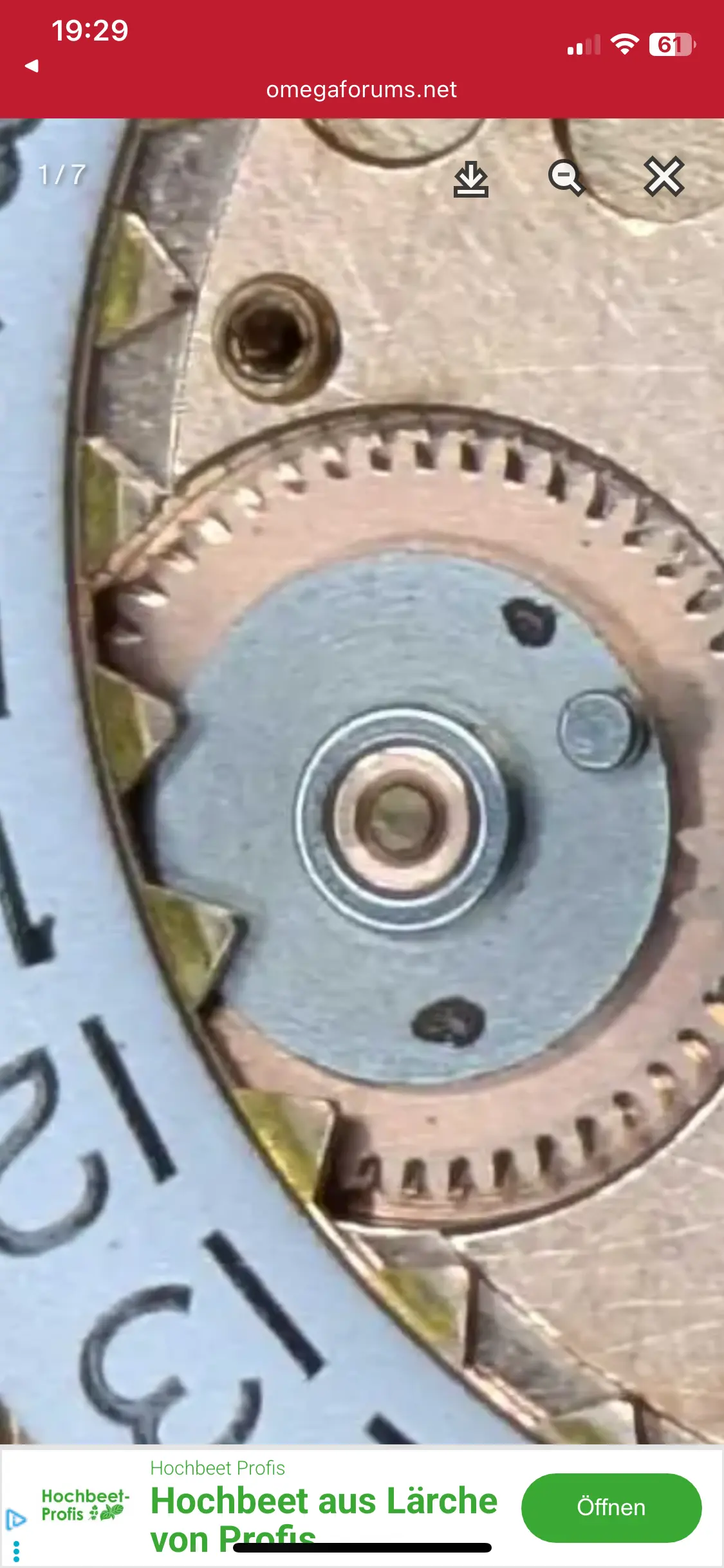

Well, you are not showing the important part - mounted to the date indicator guard.
I think calling it fragile is a bit much, but I sort of understand it in a way. One of the issues with the way this specific quick set system works, is that it is by pulling the crown fully out, past the time setting position. Unfortunately when you try to just set the time, you can easily pull too far, and inadvertently activate the quick set when the date might already be in the process of changing.

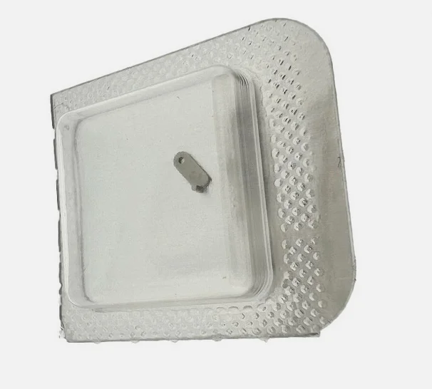

So I can't say specifically what is being referred to, but my guess is that it's the date corrector. There as an older design, but Omega replaced that with a newer design.

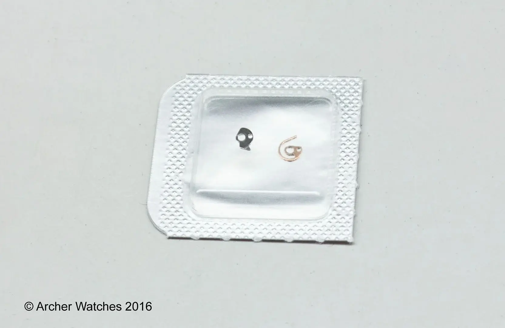

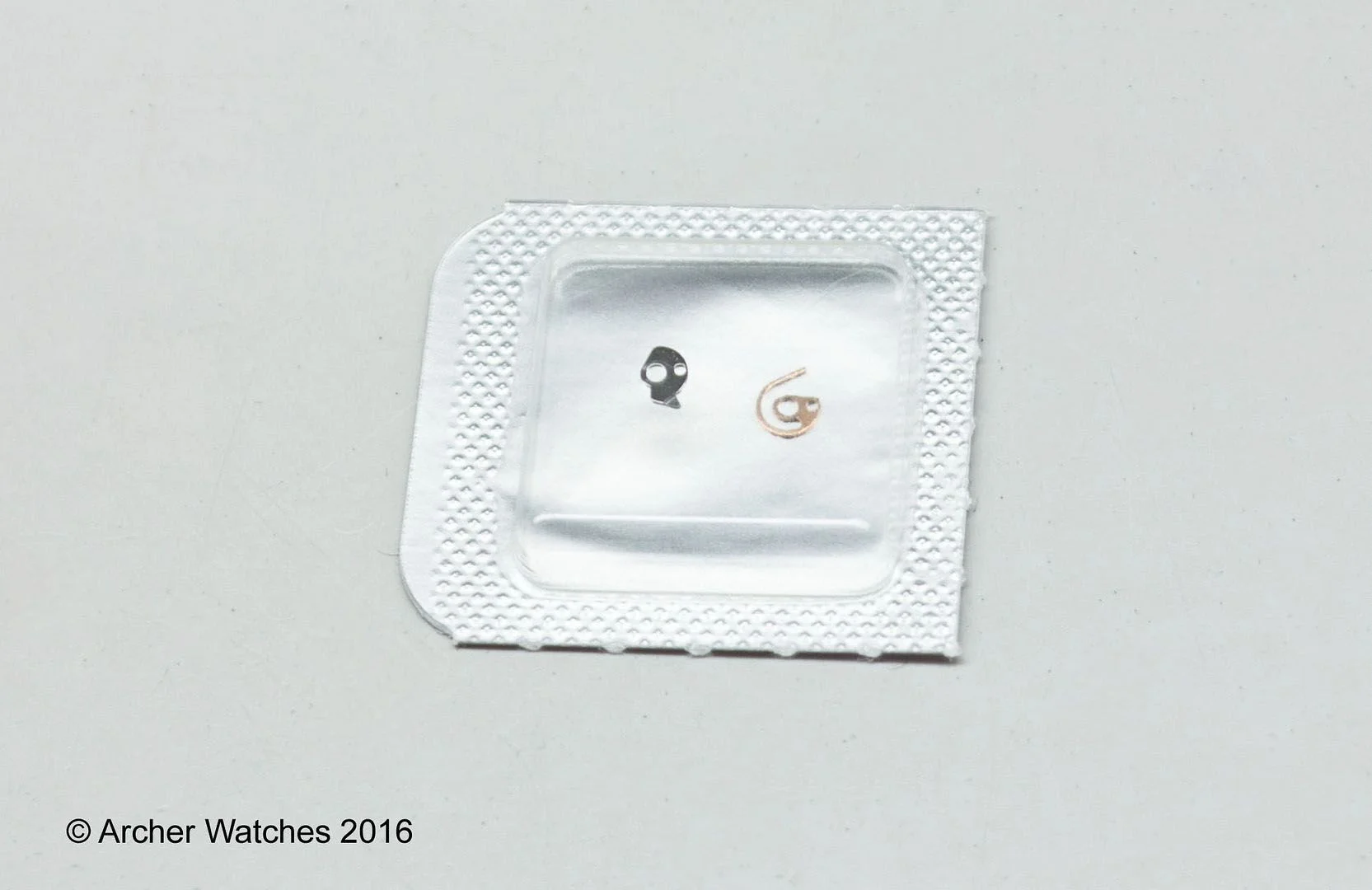

The old design is the steel part that is laying on top of the package, and the new part is still in the package. The old part had no flexibility, so if you did engage the quick set when the date is changing, there's no give there. So this would either damage the teeth on the date indicator, or if you really forced it hard you might snap off the fine post that actuates this part, which is on the date corrector lever. Mind you even with the 100's of these that I have serviced, I can only recall one or maybe two of those levers having the post broken off.

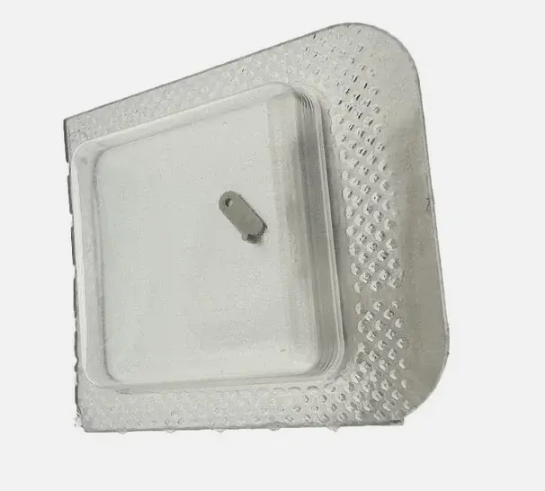

The new corrector design is made to flex and basically deflect around the teeth of the date indicator if you activate the quick set at the wrong time. Sometimes the thin end will simply snap off, so it's possible that this is what is being referred to as fragile. But that is short sighted IMO, for the following reason...
New date corrector is approx, $25
New date indicator is approx, $65
New date corrector lever is approx, $95
So if anything is going to fail, you want it to be the corrector.

OH! That makes a lot more sense. Though, I don't think I actually HAVE any further parts on my watch. Just the ones above, plus a cover plate. So it is just the pin above that does it.
That said, that is a 613, not a 564, so maybe the design is different? This would definitely cause the problem though.
Thank you!

What I find fails in many of my examples is the setting Yoke.
They are expensive at around 80 bucks or so in the usual marketplaces.
Not sure if these are machined or cast. Somewhere I have a thread where I attempted to cut one with the fiber laser.
The little pin breaks off easy.

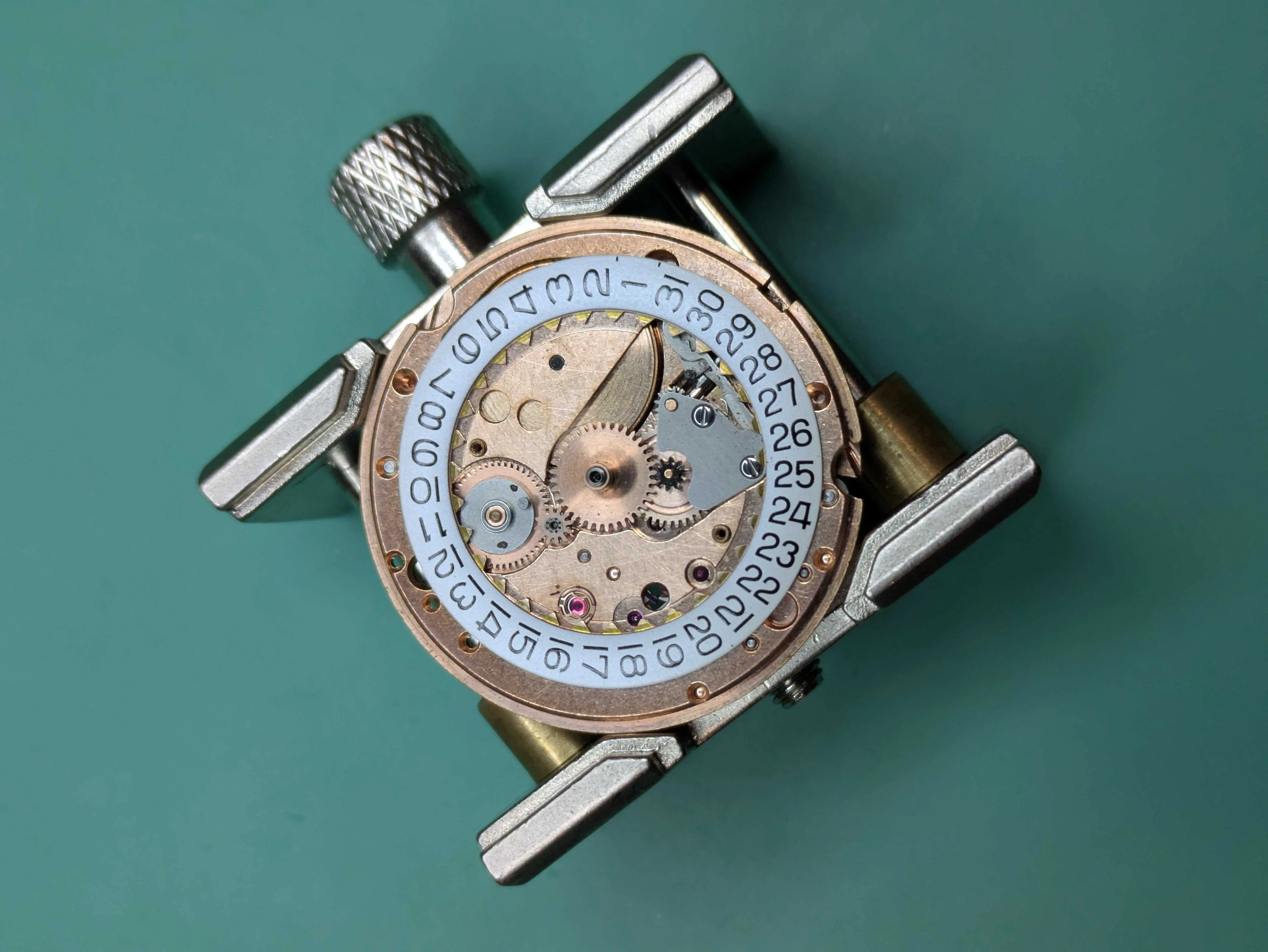

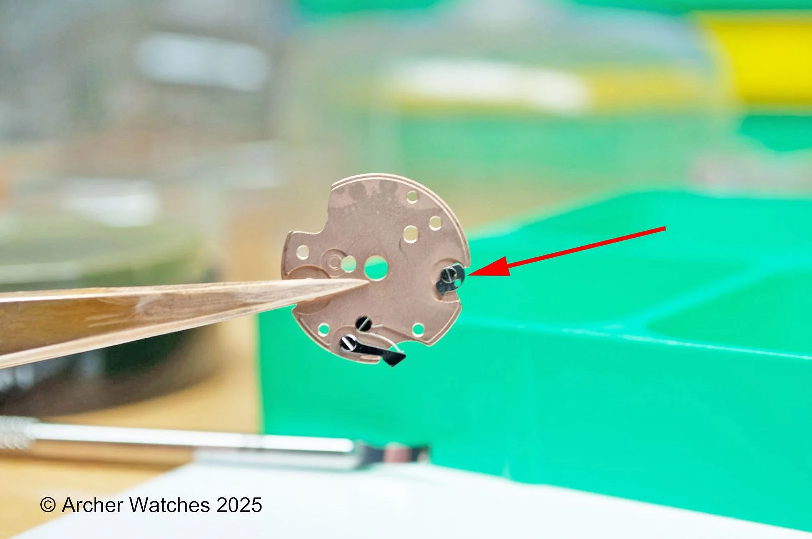

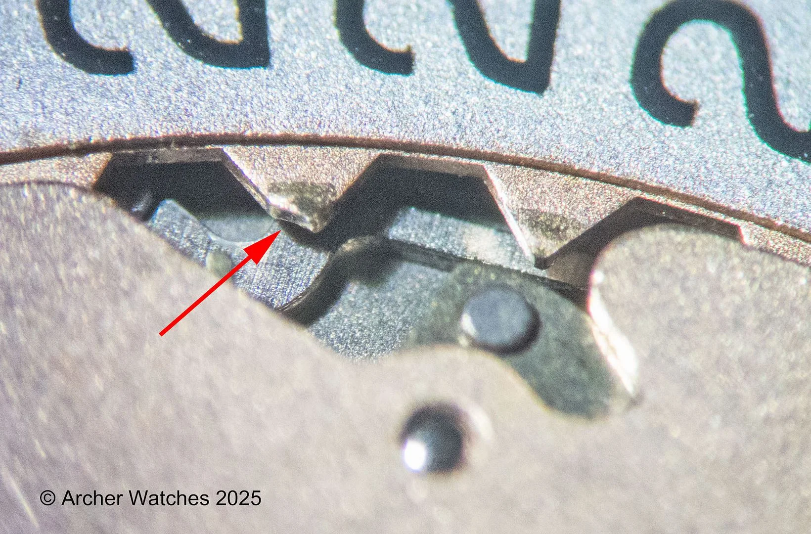

Then you need some parts...the jumper, jumper spring, and date corrector are all mounted to the underside of the guard. That pin on the lever won't do anything by itself. The underside should look like this:

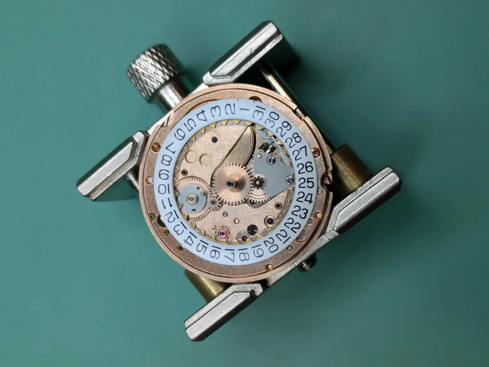

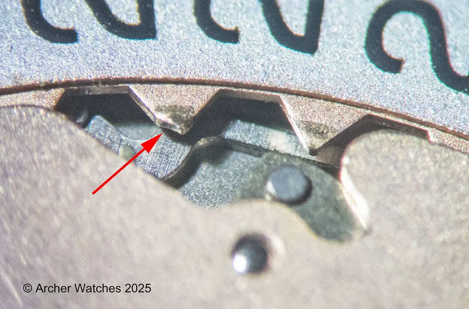

Arrow points to the old design as this was when I was taking it apart. Again this has no give to it, so you can often end up with damage to the teeth of the date indicator, like this:
That date indicator had to be replaced...

Oh! RIGHT! I do have those parts. I see now! Thank you for being patient with my foolishness. I recall trying to line the pin up with that silly little guy in the past (I took FRIGHTENINGLY few photos of this tear down... it was my 5th or 6th 601 based in a row, so I figured I knew what I was doing apparently!).
I completely mis-interpreted what you were saying about where that replacement piece goes. I thought it went on the 'normal' date advance, not the quick set.
I guess I have to pick up a couple more of these so I can remind myself again 😁
Also, that carnage 🙁

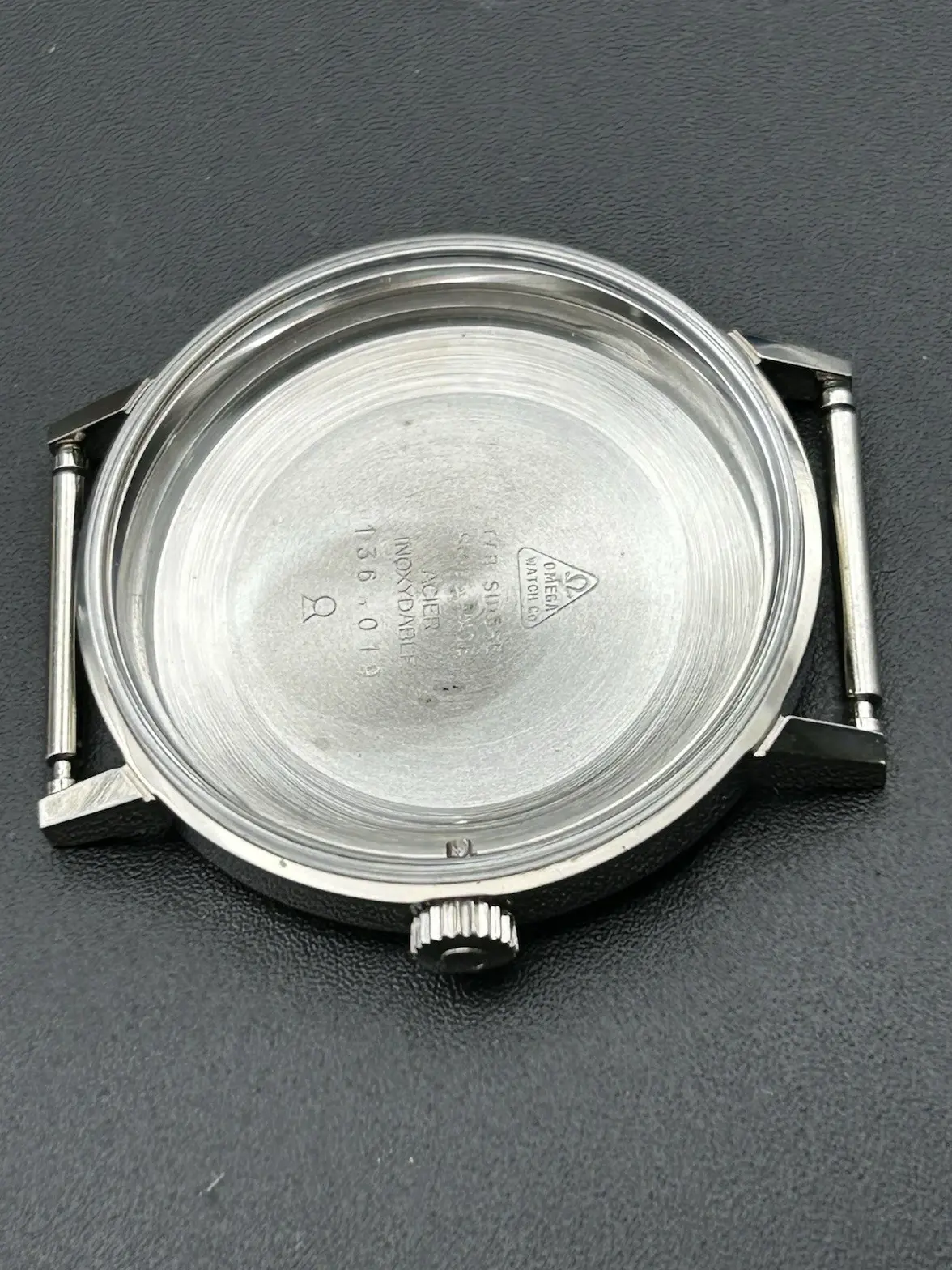

I just bought this movement from eBay, and im not an experienced watchmaker so I don't know if I bit of more than I can chew..
Also Im looking for a movement ring holder for this movement and the Seamaster deville 136.019 case, any tips on where I should start to look? Didn't have much luck on eBay..

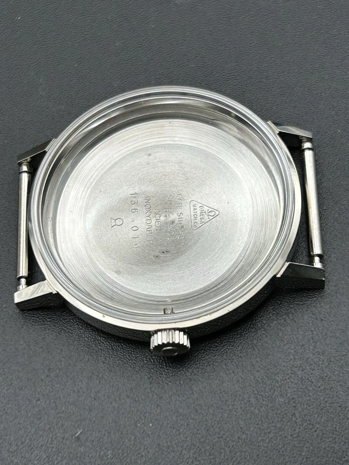

Are you sure of the case number? I don't see any ring listed for this case.
Yes, here's a photo of the case I just bought. Does it not use a ring ?
As I said, no ring is shown in the bill of materials. Have you tried fitting the movement?
