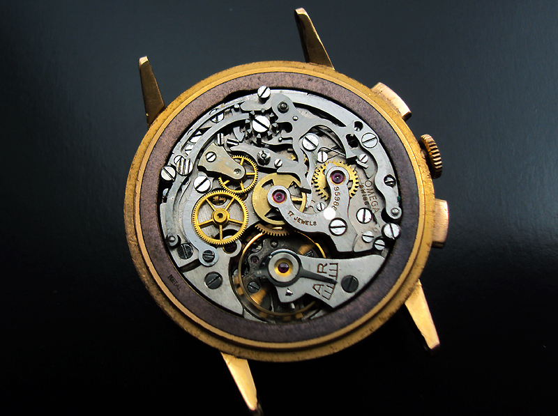

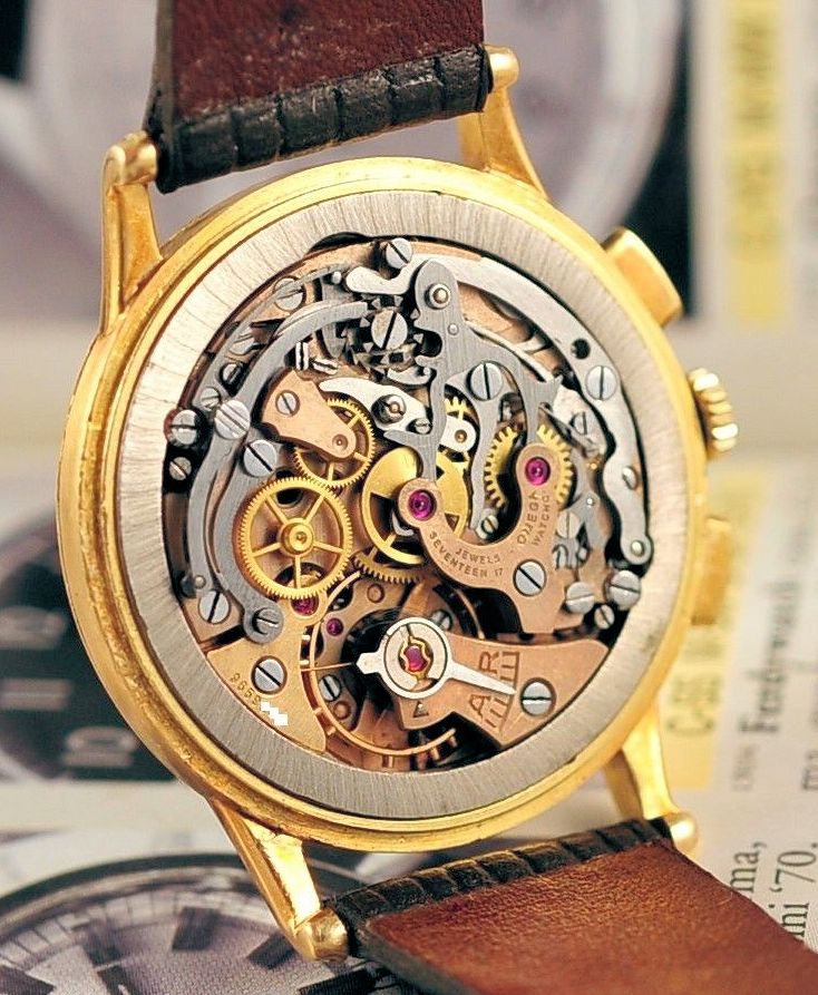

What is wrong with this movement?

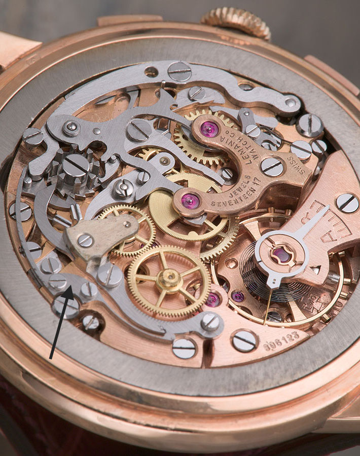

How about this type of Lemania 2310 movement with a replaced Omega bridge (or modified Lemania Bridge)?
EDIT: Actually I think it's an Omega 321 and Lemania 2310 combined with parts from both movements because there are some parts which are from a 321 as well like the part I showed with an arrow which is different in the 2 movements. The serial number could also be explained this way.

Before pointing out differences, please remember that the Lemania 2310 is a two registers chronograph, while the Omega 27CHRO/321 is a three registers one. With respect to the serial number, the engraving by Omega is different from the Lemania.
This said, the movement shown at the beginning of the post certainly shows many differences from a 9 millions Omega 27CHRO.

I still don't know the answer, but I do believe that the movement is not all original as I tried to imply in my first response (although now I realize I was not clear at all in that post). My assumption is that an 9M Omega serial would be from the early 1940s, and that an Omega chrono movement from that era would not look like this. Presumably it wouldn't even be shock-protected.

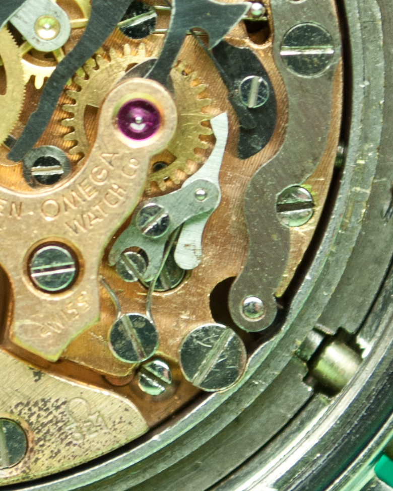

As a concluding note, here is an original Omega 27CHRO with a 9 millions serial number:
I leave the differences with the movement shown at the beginning of this thread to the attention of the forum members. 😀

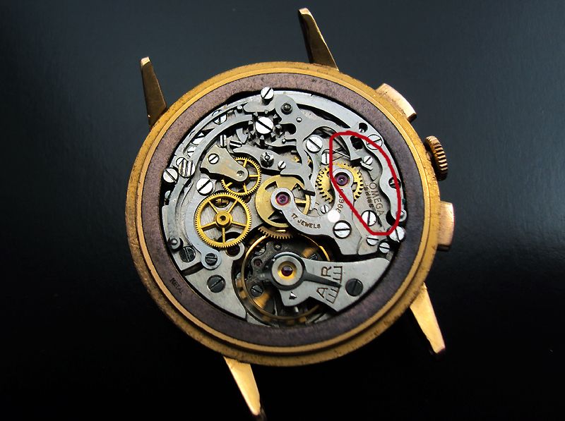

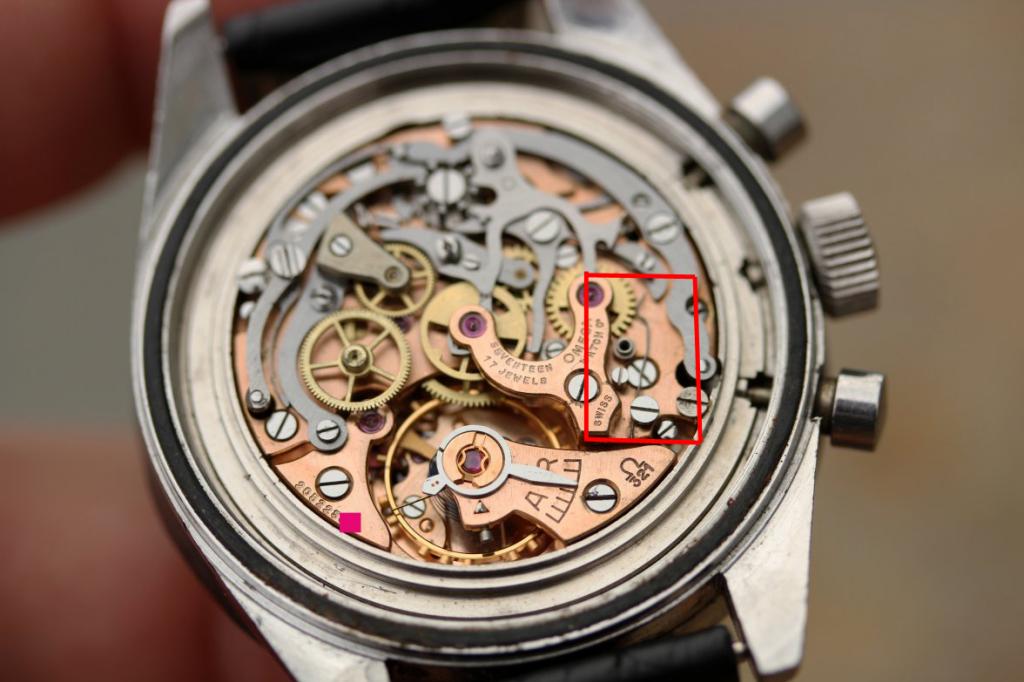

The minute recording spring highlighted in the following picture:
is the one that originally equipped the 27CHRO designed by Piguet and was successively changed in the 321 version of the movement.

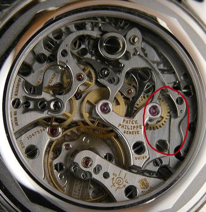

However, the arrangement has been retained in the high grade versions of the Lemania movement, as the one adopted by Patek:
The thing is that the movement shown at the beginning of this thread is by no means a 27CHRO.

At this point one should wonder: why the original design of the minute recording spring of the 27CHRO was changed in the Lemania 2310/ Omega 320-21 version of the movement, which are essentially mass produced calibers, and on the contrary retained in a high grade movement such as the Patek CH27-70?
Strange, isn't it? 😎

No wires allowed in Geneva seal movements. Criterion number twelve.

Of course. However, since we should not accept criterions without sound mechanical reasons, we are essentially left with the same doubt. 😎
