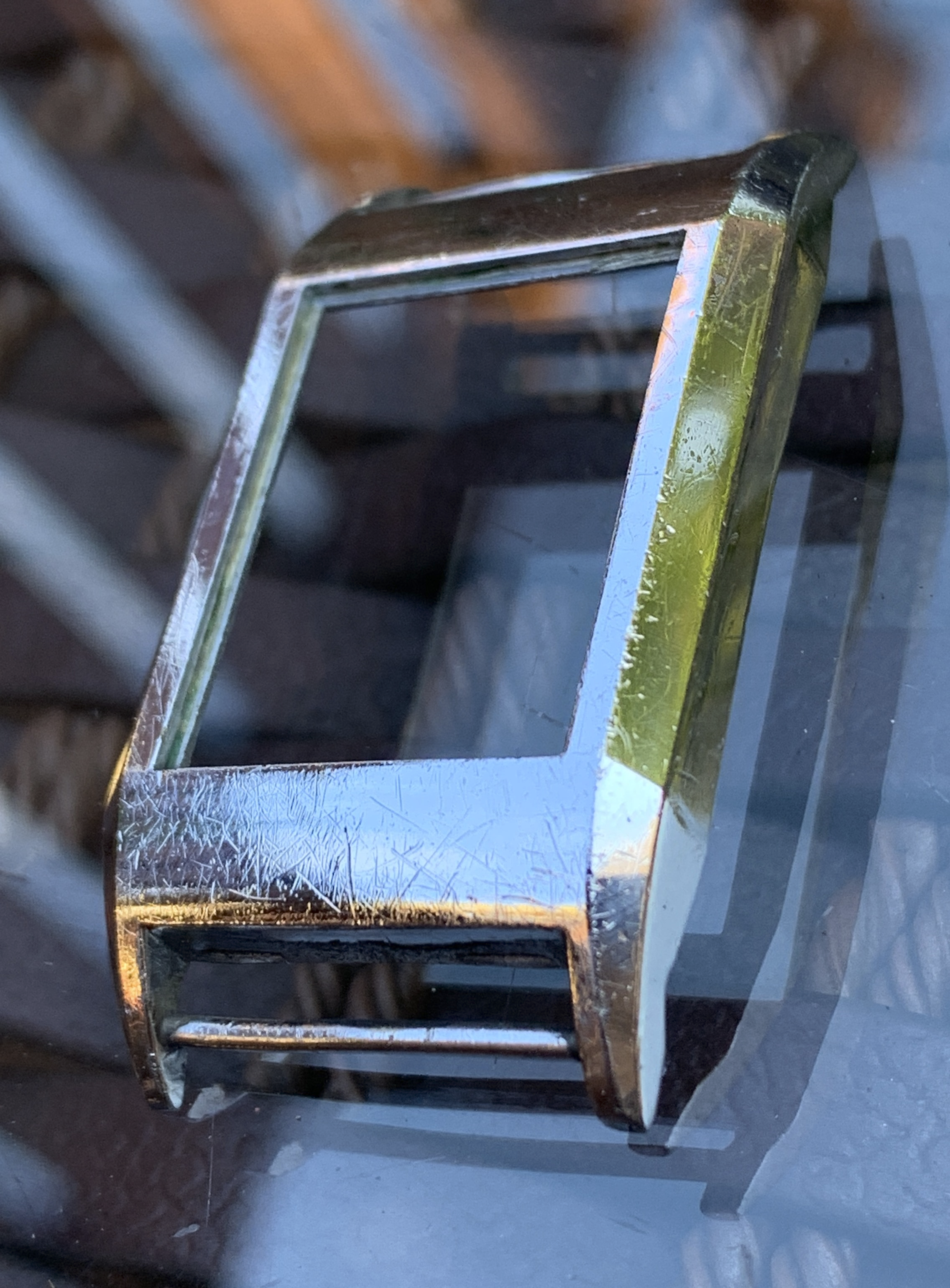

Is the case stainless steel or chrome plate?

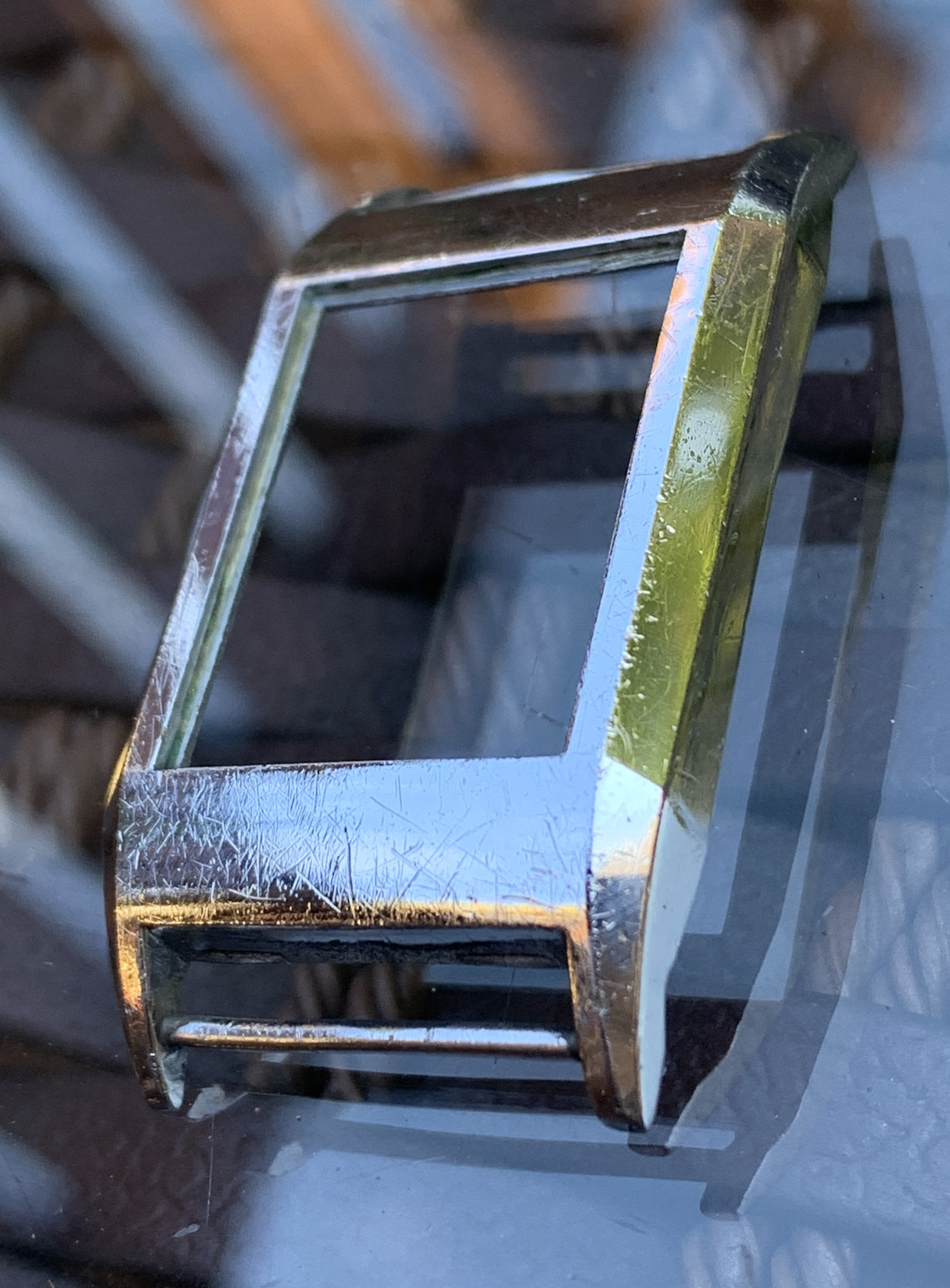

From the look it's plate
Looks like chrome to me
I find a chrome plated case that has degraded over time as quite unsightly. It doesn't age well imo.
The techniques used for case restoration for chrome and stainless are different.

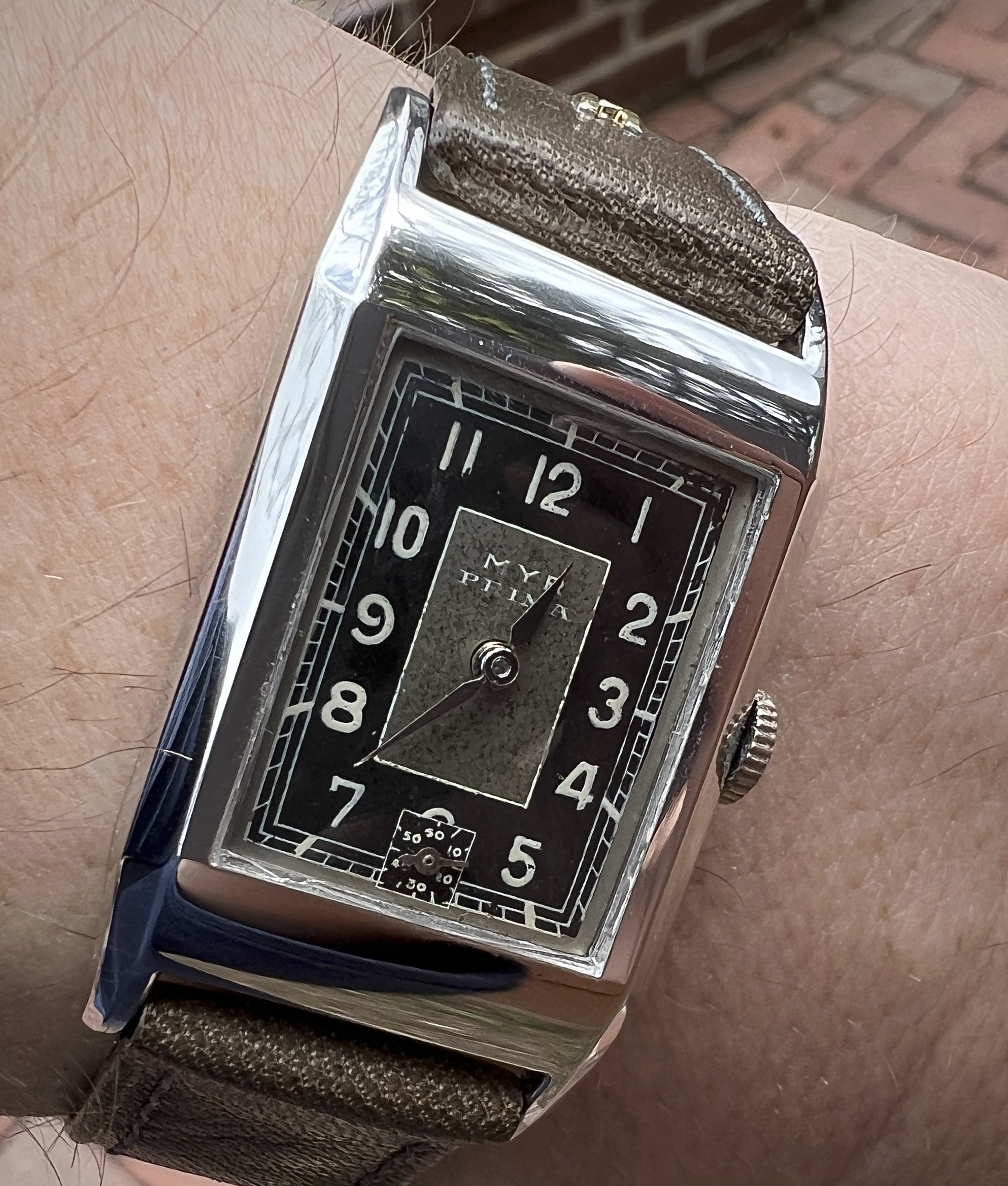

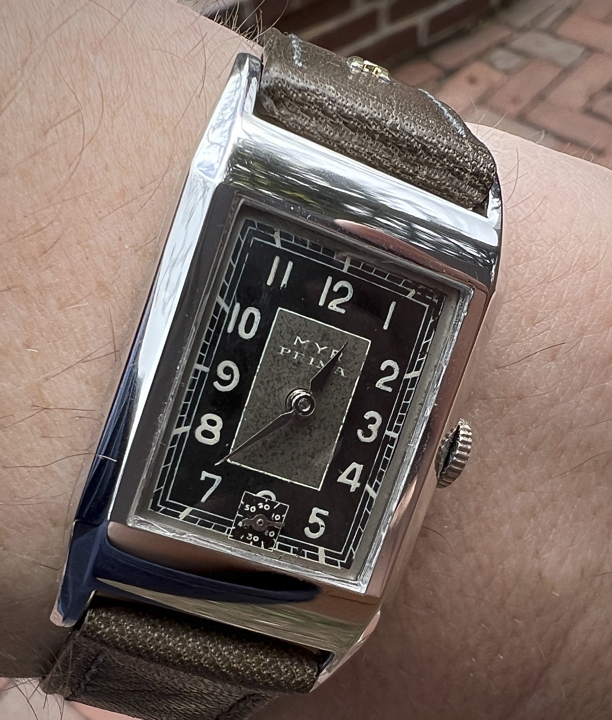

I have a similar type of watch with chrome plating for which I sent to Replateit for restoration.
7
Looks nice, i would try to restore the edgelines a little.
