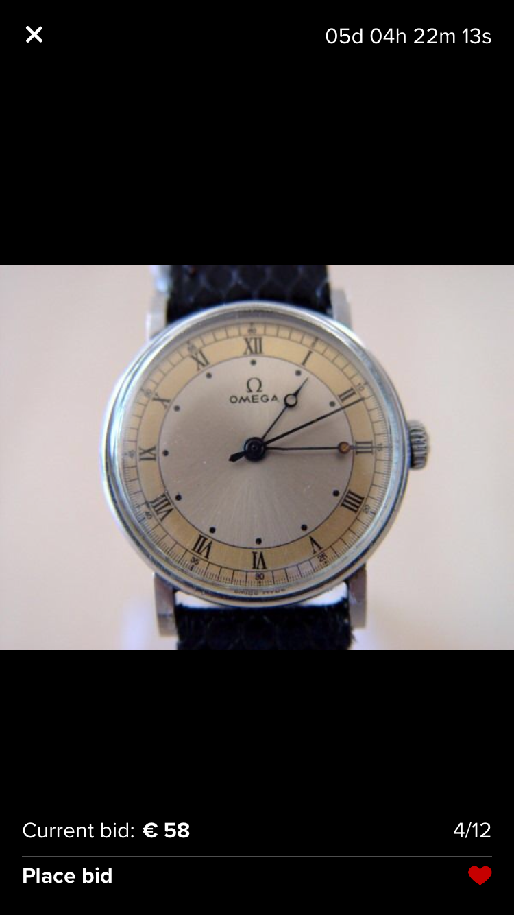

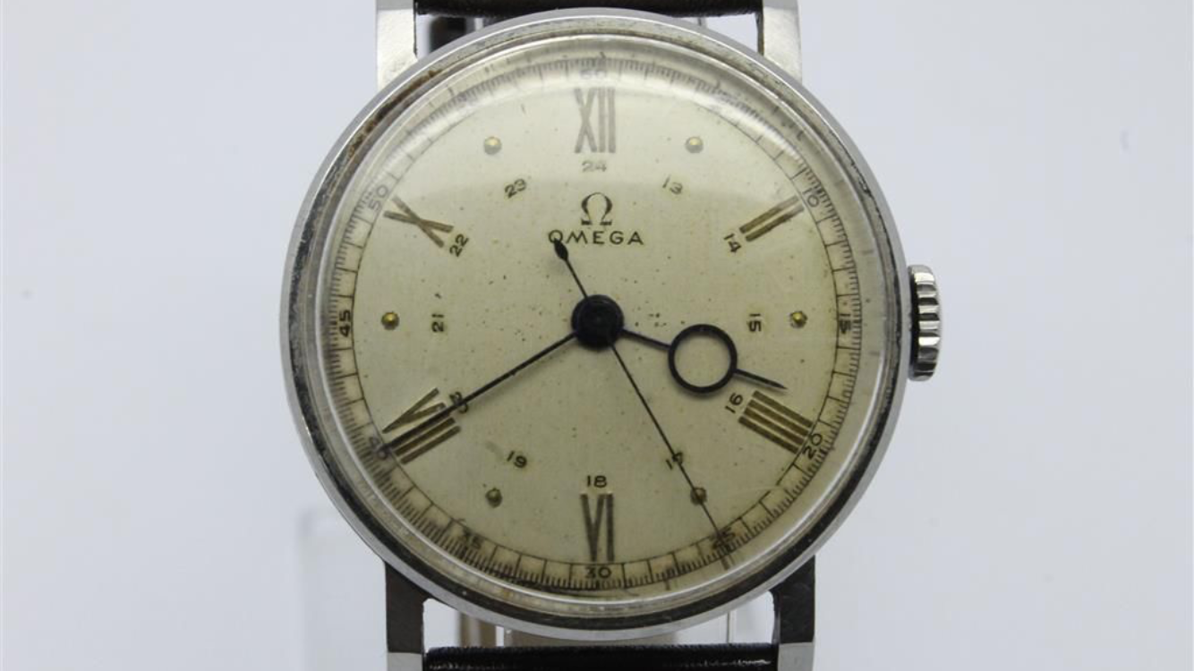

Hoping to find some info on this. I’m assuming it’s not original because I’m having trouble finding anything like it. It’s in Turkey 🤔. It’s listed as a 30T2 movement but looks like a 30T2SCrg to me but I’ve admittedly only seen one example. The caseback also has a series of numbers that doesn’t google to any specific reference. As I write out all my doubts it makes me pretty sure it’s a mess even with my limited knowledge, but it looks cool.
Any help is appreciated.
349
228
The seconds hand seems a stylistic mismatch for the hour and minute hands (seconds hand is too stubby, too short fo that minute hand). The minute hand lume DOES look like Radium to me though, which jives with the pre-tritium lack of T markings on the dial.
The dial itself looks a little to modern for the watch and the Omega logo looks like it's from the late 60's era of styling to my eye.
If I had to guess, I'd go with a 1960's era restoration in a country that still used radium to lume hands at that time - like, say, Turkey?
This is only my opinion based on supposition though - I have never seen that exact watch style before.

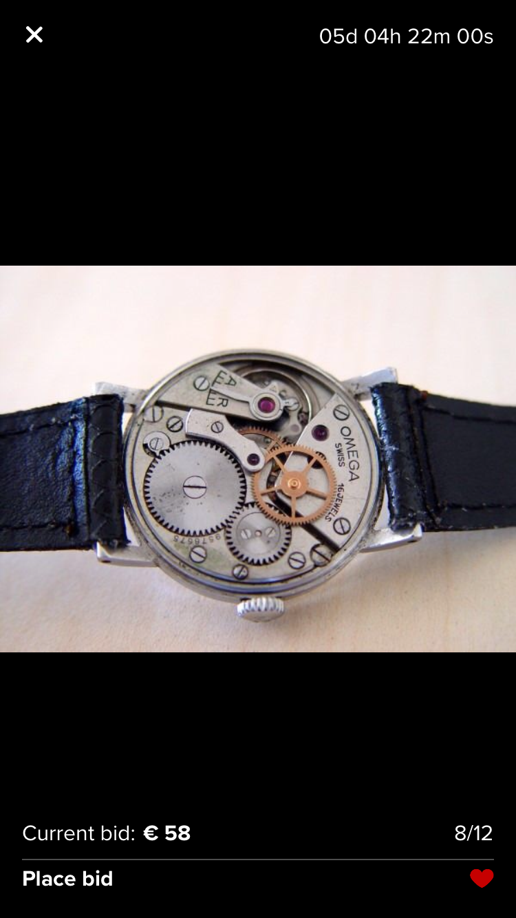

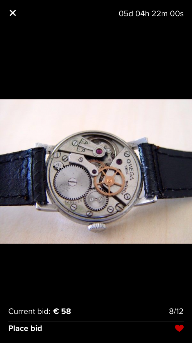

Thoughts on the mvmt?
349
228
Sorry, you need a watchmaker familiar with 30T2 variants to comment, I would not be able to tell them apart from a photo.
13,493
31,814
Dial - Fantasy redial
Hands - Moon style, should have no lume, could be original to the watch.
Movement - Looks like a run of the mill 30T2SC.

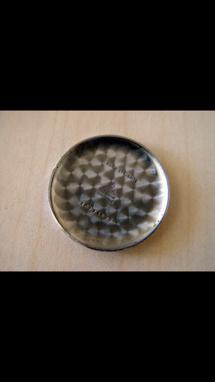

Numbers inside case back is a case serial number, not to be confused with a movement serial number (they aren't supposed to match).
Collector value - Nil

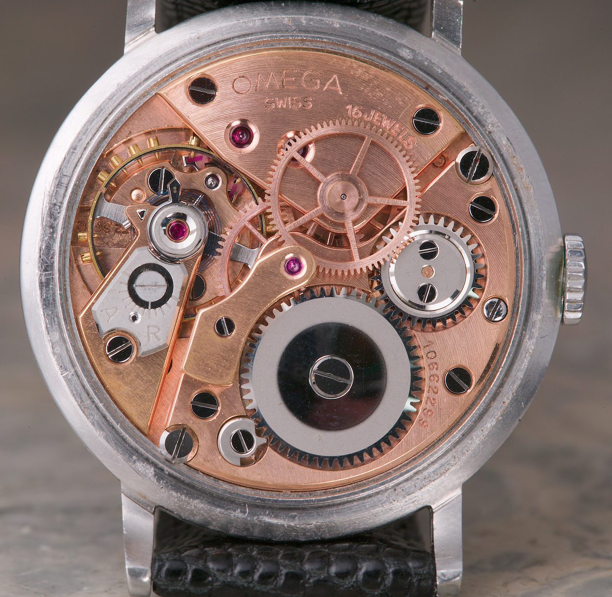

Photo below is an rg.
67
57

It is very simple:
IMO it is a correct ref. 2242 (civilian version, hence only 16J, the Techron would require 18J) with a totally wrongly restored dial - and most probably the second hand is also a wrong replacement. - the rest of the watch looks legitimate

It is very simple:

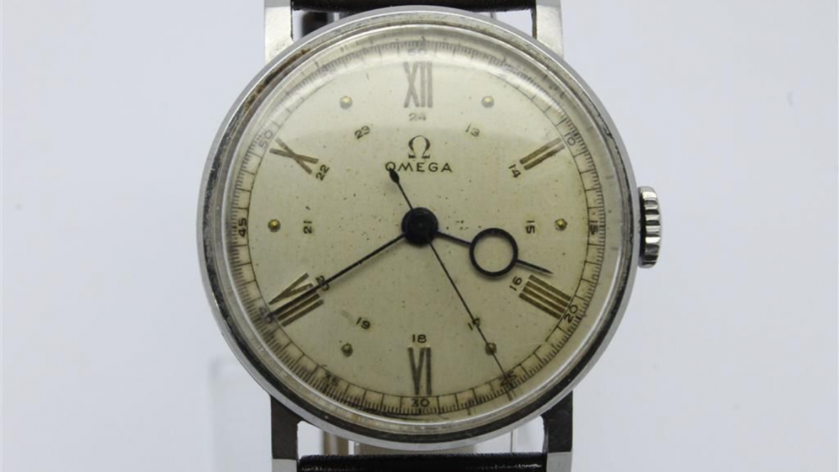

A similarly themed but original dial would look something like this?
3,653
7,770
Yes, this is one known version but there are several others, just google Omega ref. 2242... don´t focus too much on the dial - what is much more important is the correct case and movement for the repective reference and matching movement and case serial numbers (at least in early watches like your´s, in younger SS watches there was no case serial number but just a "case number" often referred to as reference number). However, it is different with gold watches, they kept their case serial numbers.

...Photo below is an rg.
Polite ignoramus question, please no flamers - so, some RGs have on a bridge the rubric "Adjusted Five Positions..." etc - but, not all? What's the rationale there, pls?
18,326
27,695
That is on the chronometer rated pieces. Not all have that. So if thats on the diial then the movement will have that in some movement families they have slightly different caliber numbers. So you need to check that as well. Lots of cobblers together pieces out there.
