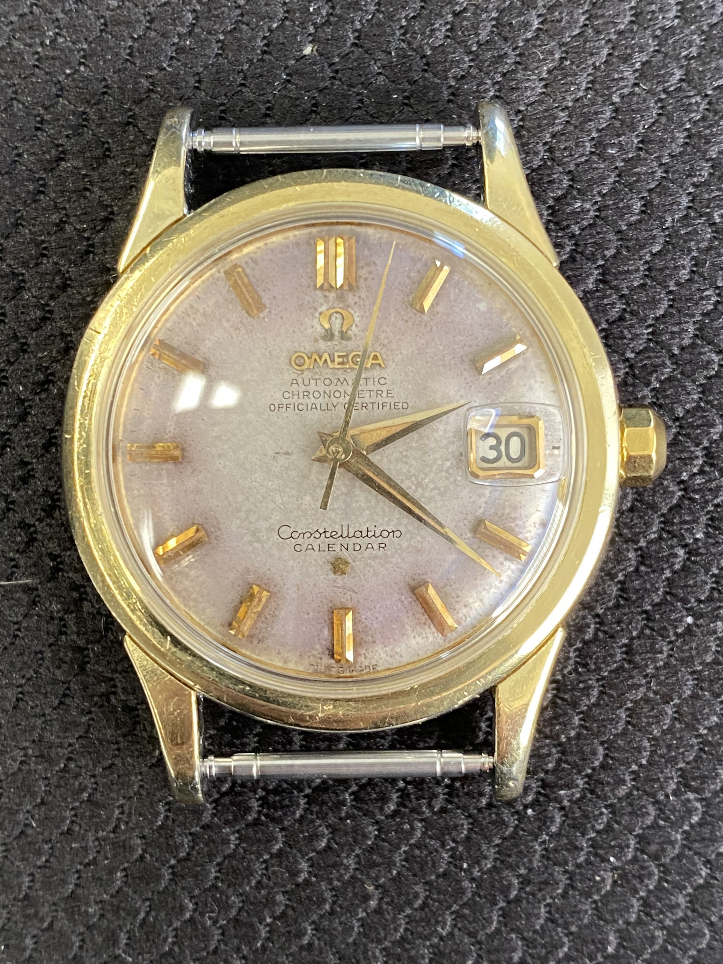

I just had a really positive experience with it. My local Auckland agents (Nairns) took an initial look at these two watches, determined they needed to go to Bienne, quoted NZ$1400 (~US$1000) fixed price for a "full monty" (including shipping, etc). I specifically asked for the Constellation dial to be left alone, which they requested on my behalf, with the proviso that if the big O thought it needed replacing they'd get back in touch. Told me it might be up to 16 weeks. Well, it only took nine weeks, Connie dial untouched and with new signed cyclops crystal, new decagonal crown (not original original, but genuine Omega) to replace a generic, both watches came back in fantastic condition with character intact. Baggies of replaced parts showed how much internal work was done. In my opinion, well worth the money spent (especially as I picked up both watches with faults for good prices originally). I'll be doing it again.
I'm sure others have had bad experiences. But maybe -- just maybe -- 2021 Omega is responding to the concerns of the enthusiast community and doing what the customer is asking when that's reasonable.
