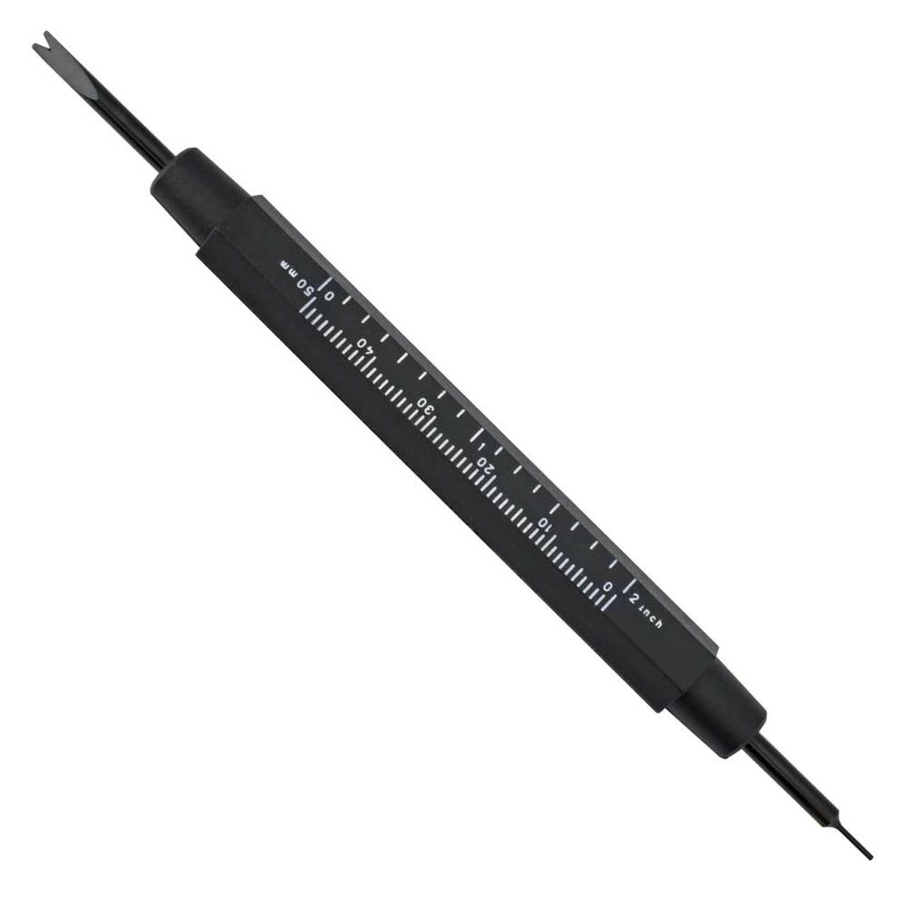

hi,
could you kindly point me to tools that are of good quality to change straps?
i want to avoid damaging screws, etc
thank you!

thanks...i just watched a youtube video on how to change a strap and it doesn't seem too complicated in principle but the guy is slipping a lot...

I've never asked a boutique to change a strap so wouldn't know if they charge for it, I'd expect not as it'd take a technician a couple of minutes and they're all about the customer service.
Whether your technician scratches it or not is another question, I'd wager even the most experienced tech will scratch a watch every now and again.
My advice, try it yourself, the up the back of the lugs if you like and don't worry, the watch will pick up scratches, a couple more won't kill it.

They don't charge you for it, but never assume the person wielding the spring bar tool or screwdriver is any more competent than yourself. And you have a lot more interest in having the job done right than anybody else. Get a good springbar tool and screwdriver and do the job yourself. Tape the lugs for added security. Surprisingly many posters here don't mind making a mess of the lug's undersides with repeated strap changes, but the goal should be to prevent any errant scratches. Even being super careful you might have a nick once in awhile, but overall try for good work.

makes sense, thank you guys. I guess a bergeon springbar tool it will be then!
maybe i'll put tape at strategic places to mitigate risk/damage

Bonus 2c: if you have a good relationship with your WM they will usually throw in a couple quick strap changes for free - and they genuinely are more competent than me!

probably there is no single best tool for different watches / strap or spring bar designs
i found out sometimes a small flat head screwdriver works better, sometimes tweezer and so on
the best thing is quick-release straps for me, without needing a tool

I like the Bergeon 6111 (or 8111 more fancy) because it IS the best tool. Flat fork for leather strap. Small fork for bracelet, pin tool for when the lugs are drilled.

Sorry for the n00b question but are quick release spring bars available for Omega watches?

My dude if you are going to the OB just buy their tool set, it’s 10 bucks and comes in a nice kit that can store your bracelet, and extra springs. If you butter the boutique enough you might have them give you spare straight and curved ones or if they are uptight charge 4.99 each pair LOL. When the watch technician changed mine at the boutique he did it with lightning speed though LOL
