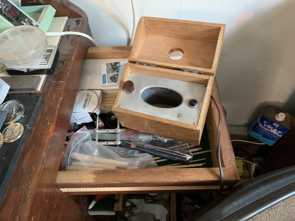

My demagnitiser is really old. Been using it a lot lately. Especially when sorting parts.

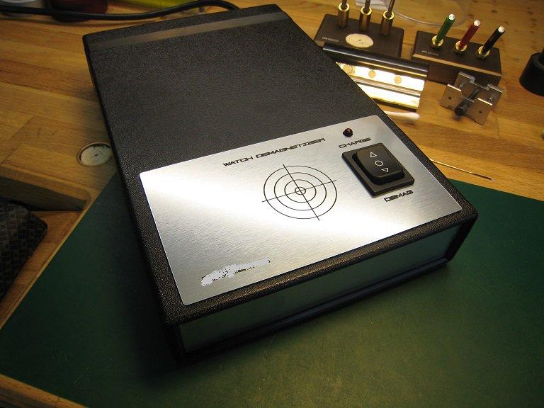

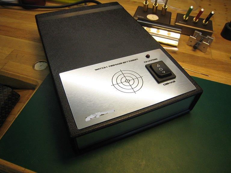

If you know a litte about electronics - you can easily build one! (or even use the cheap chinese cra........ones for parts)
Here is a page that describes the basics.
A coil and a capacitor forms a LC-circuit and - Viola, you have a automatic demagnetizer and do not need to slowly pull the part away etc to get things to work!
Here is one I built years ago.
231
301
Nice! If I'd had the knowledge and the time I'd have done that.
In the end I just bought one of the Elma ones. It works and provides peace of mind, and although not cheap it's less than I've spent on a bracelet, more than once..

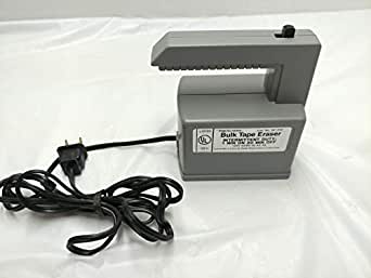

Sorry folks, but I have to ask. Can something like this be used for watches and parts?
384
375

Search for this on Amazon, several brands carry it. Cheap and works perfect.
