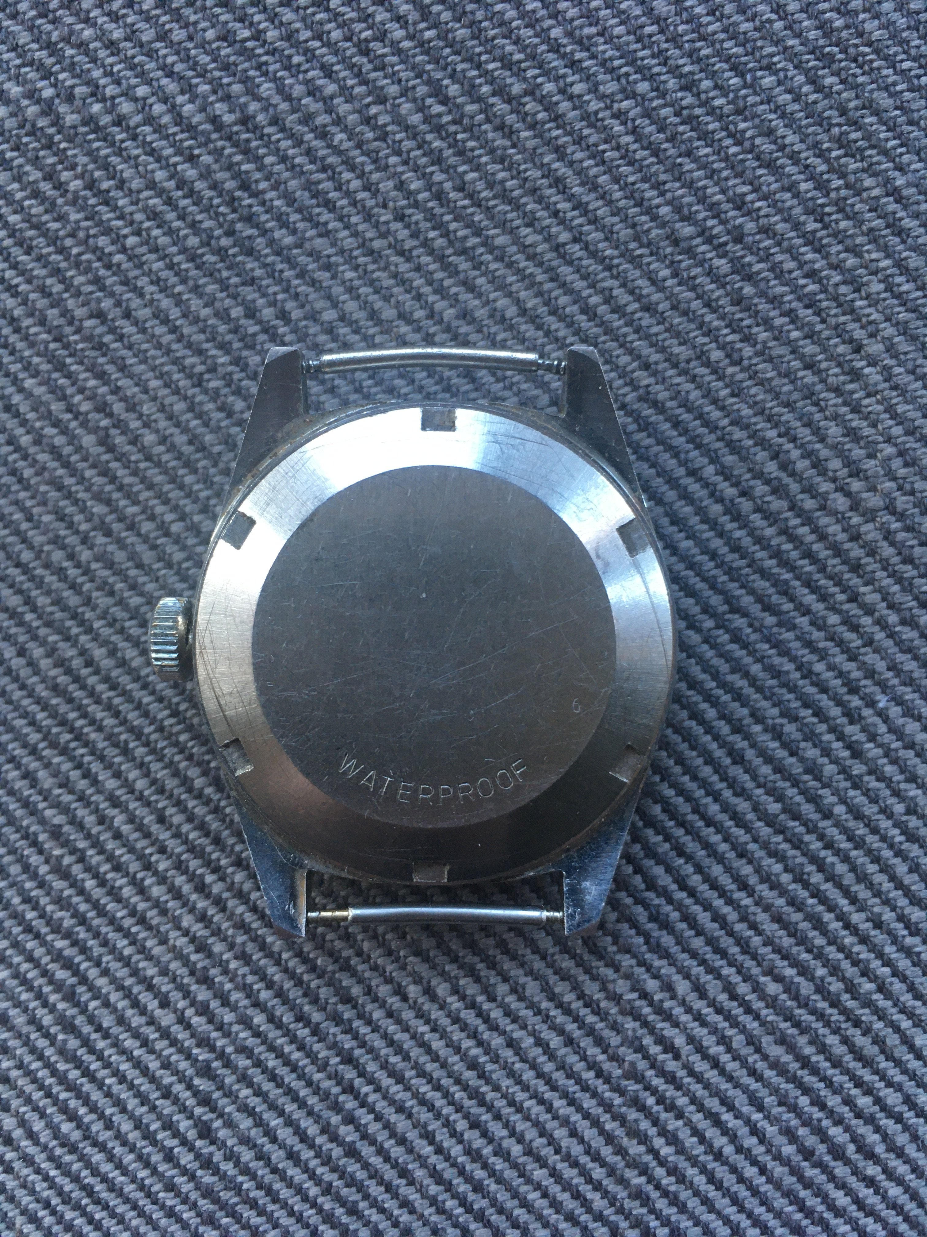

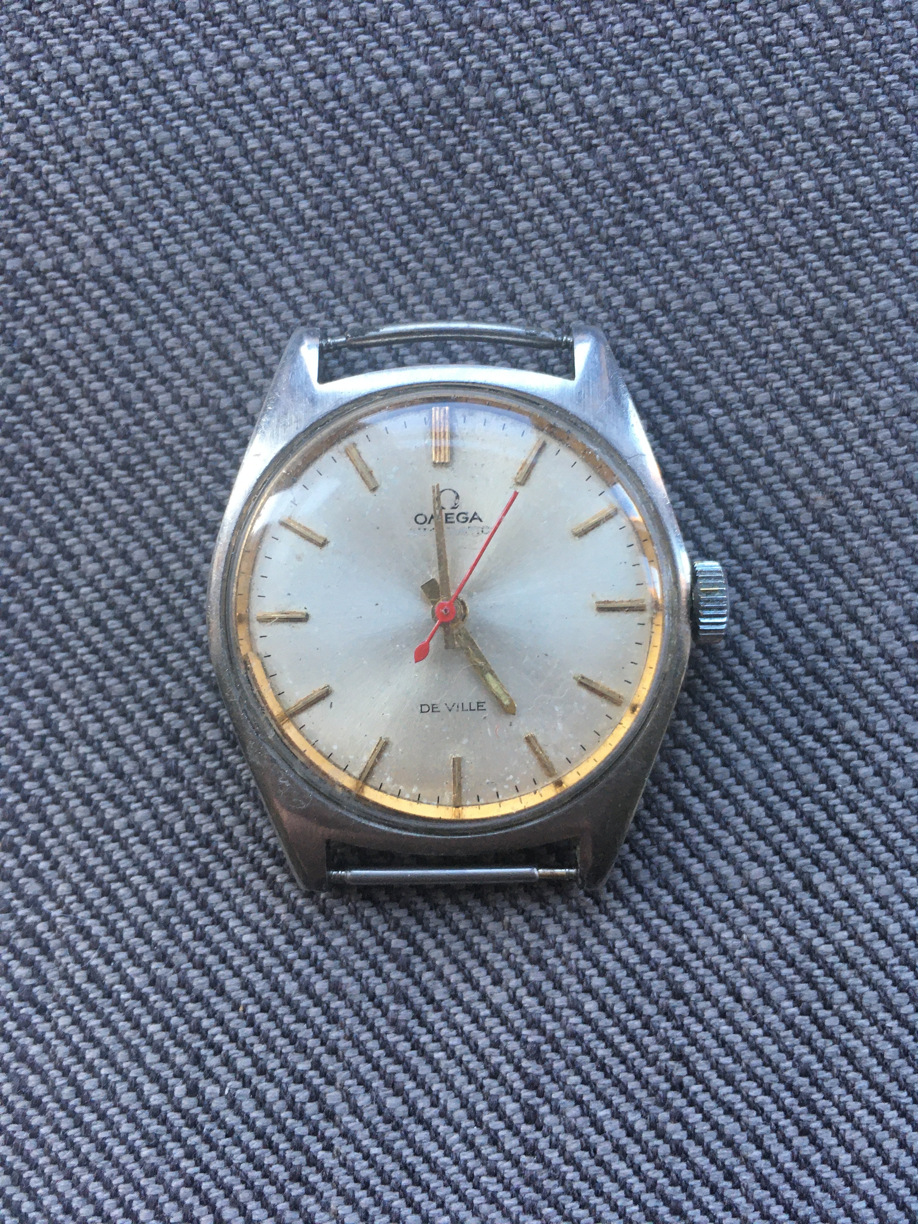

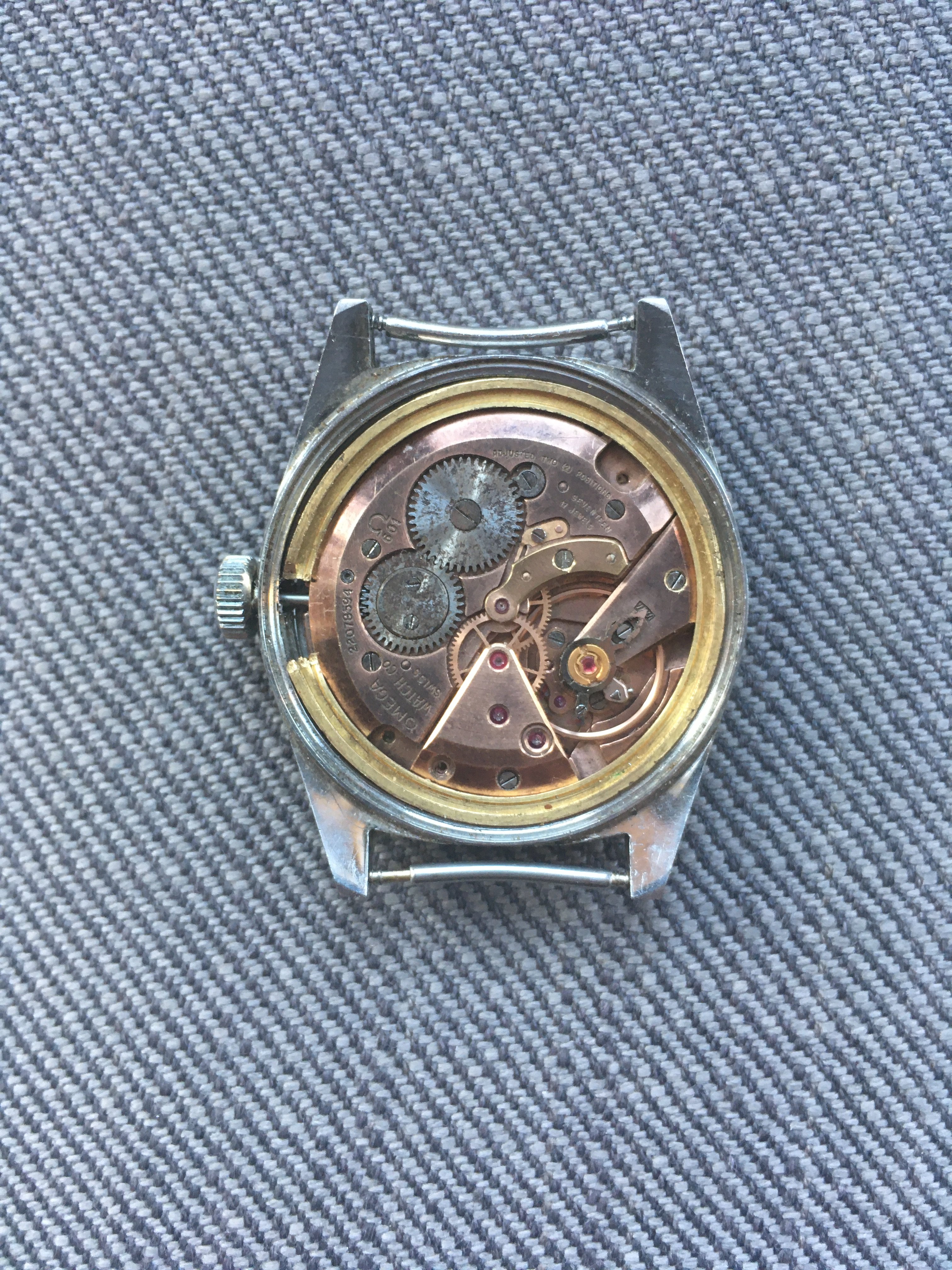

I spotted a cheap one recently. However, upon closer inspection, too many things weren't right with it. I know little to nothing about what to look for, but my layman's observations were as follows;
The hands are wrong. The minute hand (at least) has been replaced or is maybe even broken.
The unsigned crown is a replacement.
The watch is rough in general, with a 'ding' in the case, opposite the crown.

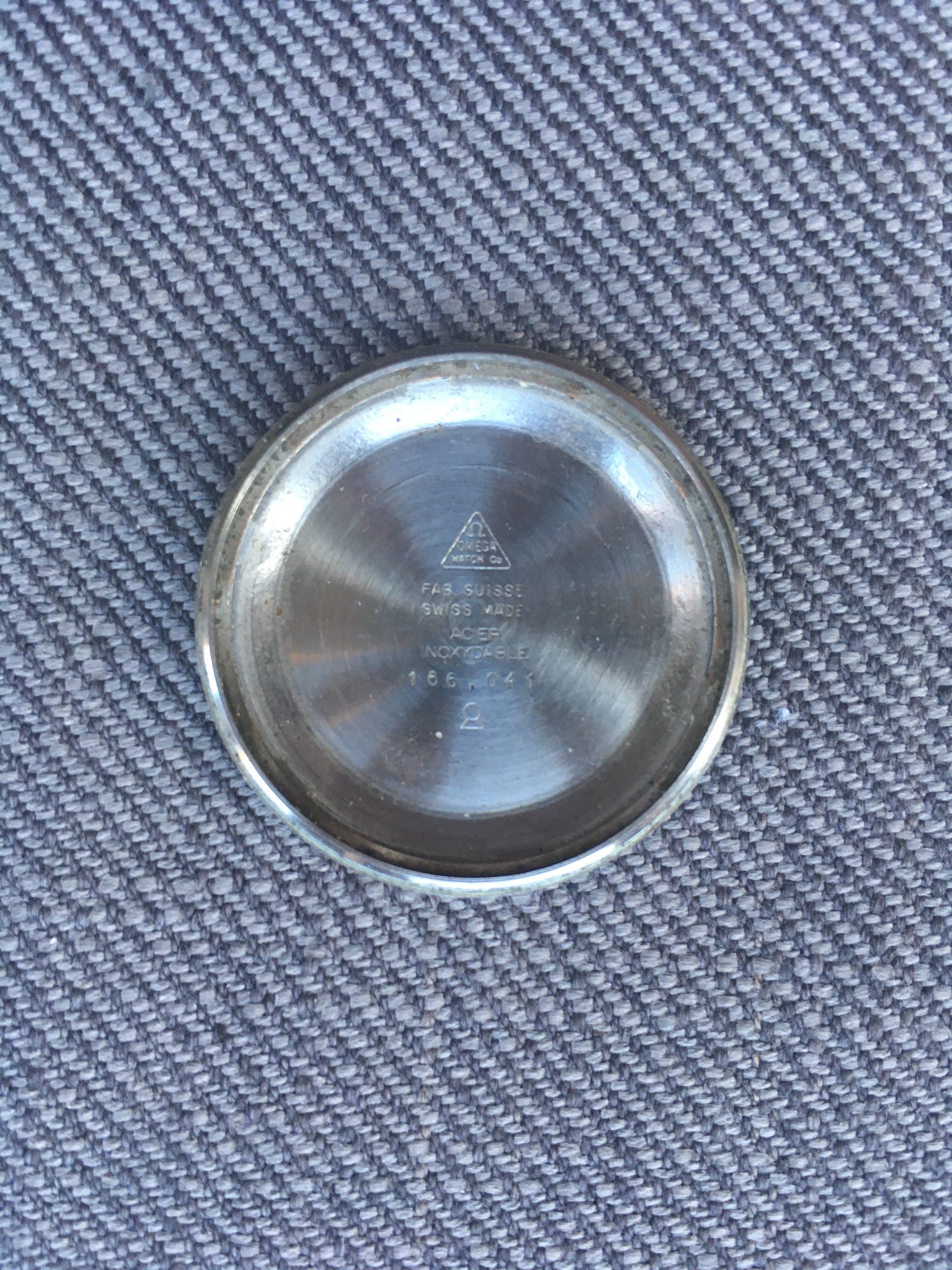

The 166.041 case wouldn't have come with a 601 movement (22078594 1965 year)?
The De Ville dial wouldn't have come with the 166.041 (Geneve?) case?
Would gold hands and indices have come with a gold case?
The strap is a replacement.
So, this one was discounted from my search. Fast forward a couple of weeks, and drunken me submits an offer, expecting it to be refused. It was accepted almost immediately 😀

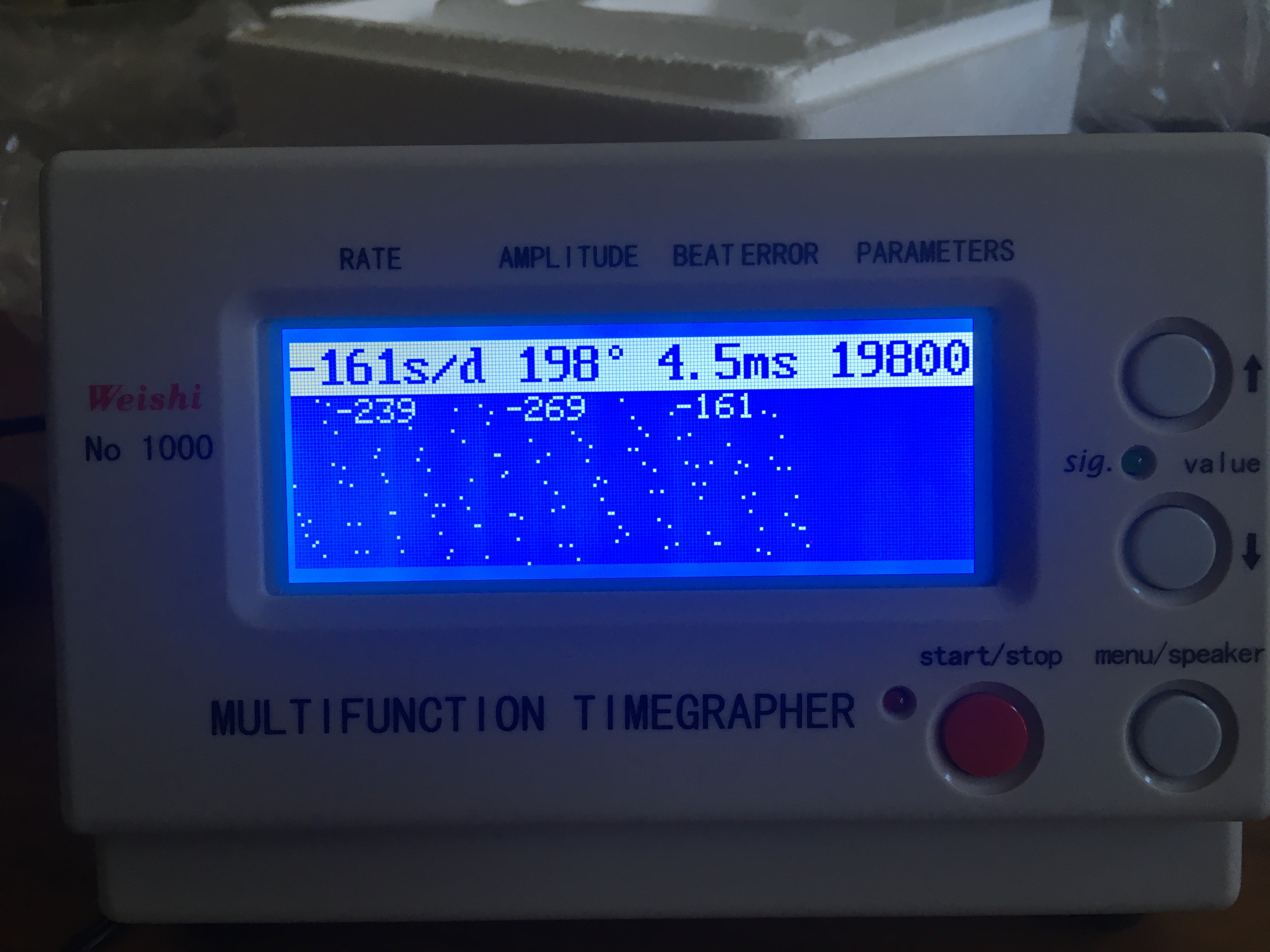

So what have I bought, and is it worth doing anything to? I popped it on my timegrapher, and it clearly needs some work. There are a few other defects which weren't visible in the advert photos, such as the chapter ring type-thing, being split.

By the time you overcome the obvious problems, and then delve into the not so obvious problems, and set aside trying to do anything about the rust, you’ll have a watch that likely will never please you because you’ll have more into it than it’s worth. Call it a lesson learned. Parts bin would be a good place for it.
30,276
78,129
Well, that has a few issues certainly...
Movement needs service and has had moisture inside.
Wrong movement for the case.
Enlargement ring looks to be butchered up and maybe from another watch.
Hands as you mention...
On the bright side, the tension ring in the crystal is supposed to be split, so that just need to be put back correctly.
Will cost far more to put right than it's worthy, unless you are doing the work yourself. Even then, if many parts are needed you might be under water.

I'm no expert by any stretch of the imagination. But an additional observations: The hands do not only seem out of place, the seem to be at an angle in respect to the dial. So I gues there was an attempt to shoehorn the dial on to a different case and movement.
I fear that it will probably take quite an investment to make a working watch out of this. First because the movement might need extensive work, second because you'll need a fitting dial and hands. Then again, it will definitely be unique if you do. But as I said, I'm no expert. So I will be happy to be corrected.
8,174
36,709
I like the way that someone half-heartedly attempted to remove 'Automatic' from the dial to help match with the hand wound movement. Class. 😁
