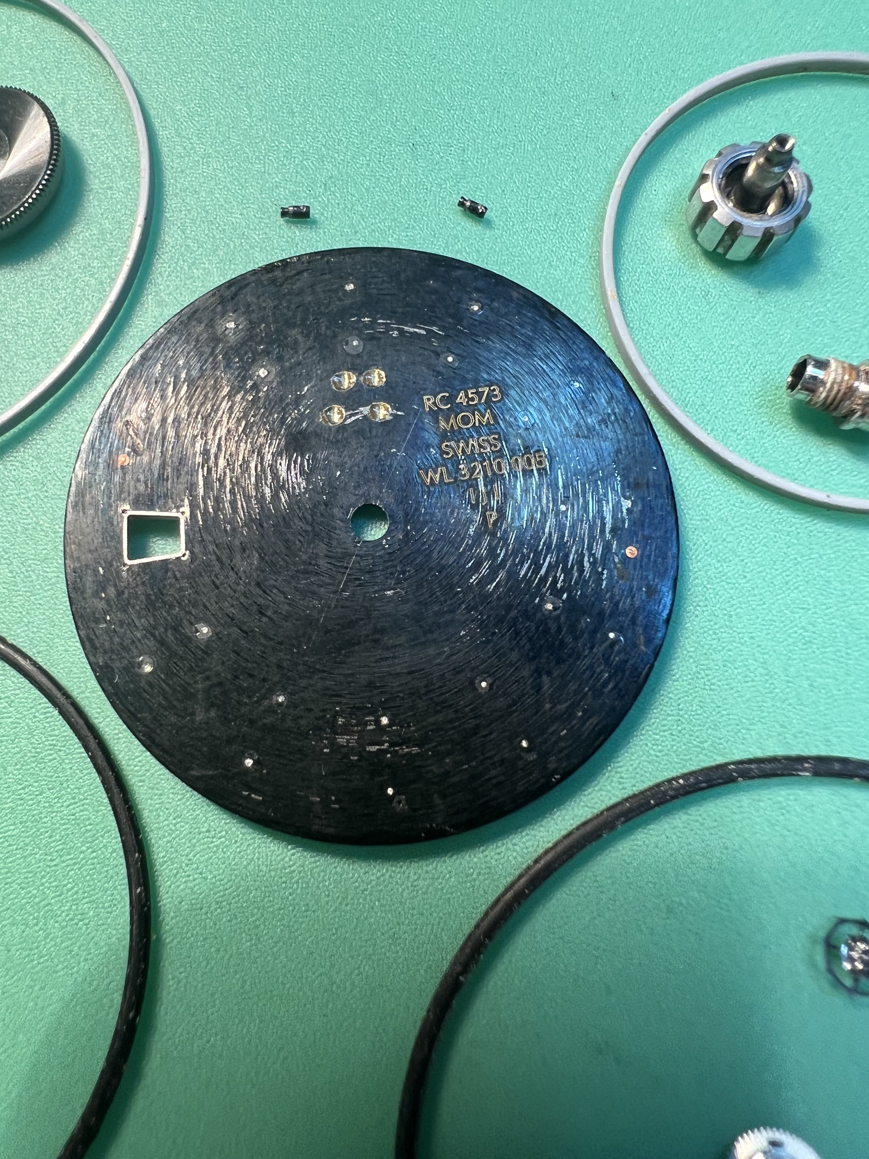

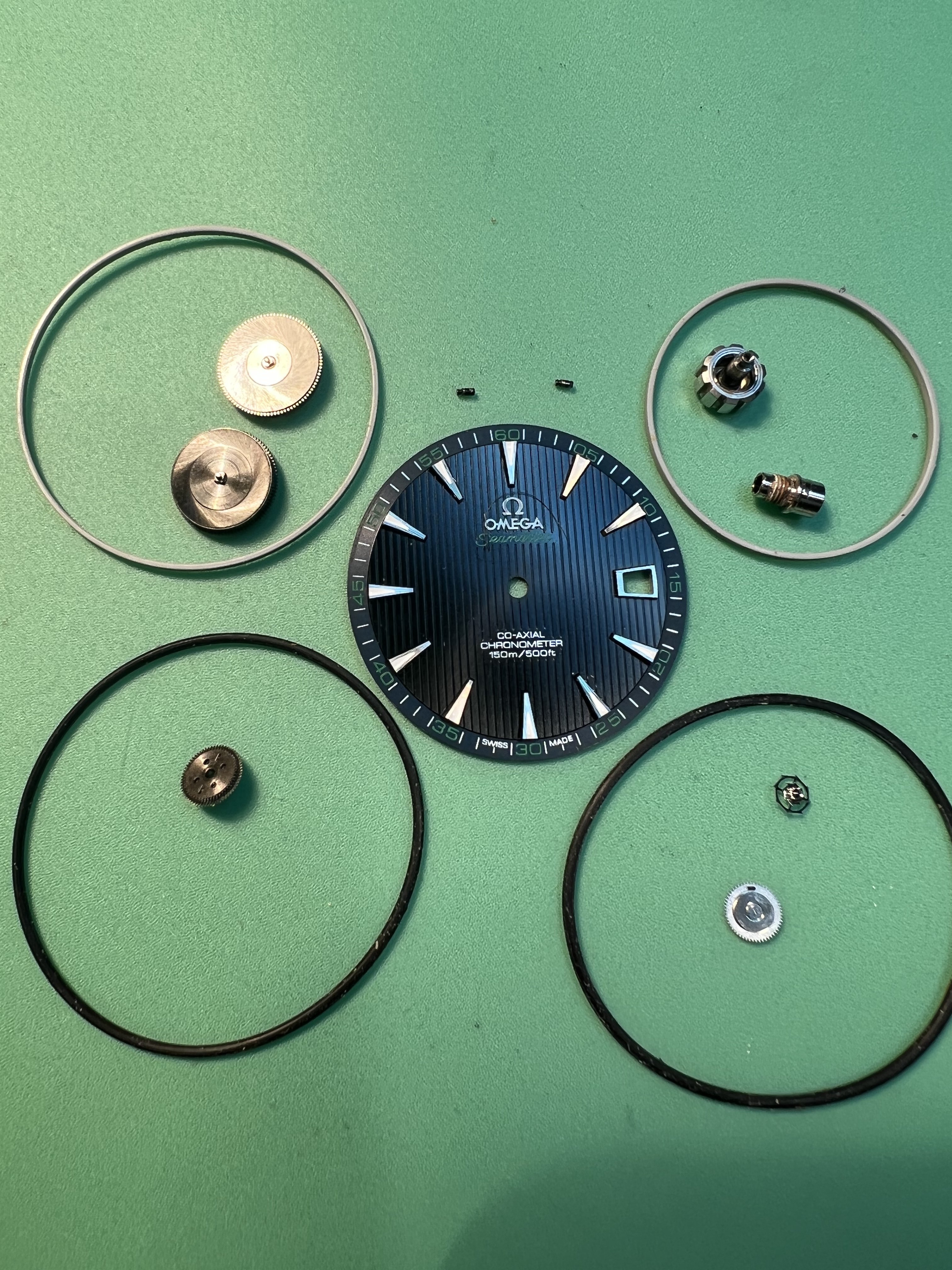

Here are the parts returned from Omega after repair. The clues are in the thread title and the 2 smallest parts above the dial

Are you asking a legitimate question, or do you already know and want people to guess? The dial feet broke off. Or were broken off during the service. That's a whole lot of parts to replace, so I sure hope this was under warranty.

Yes Ive had it for 5+ years and never wore it golfing, until I chatted with AD and asked him if it would be ok to do so, and he said sure. I wore it once for 18 holes. The next day the dial had rotated with the 12:00 marker almost to the 3:00 position. Both feet were sheared off. Unfortunately no longer under warranty very costly. Learned this lesson the hard way!!
I'm guessing that those double-sided sticky dial pads weren't deemed appropriate? I can see the helpful AD would want to rake you over for the cost of his ill-chosen advice. Bummer.

That happened from one round of golf? Do you swing a golf club like Bryson Dechambeau? I would think there was already stress placed on dial feet for that to happen.

Ha! Hardly!! My mistake for consulting the Watch seller , not the watchmaker. I’ve worn it regularly but not hard.
Sheared off dial feet more typically happens when there’s a drop.
