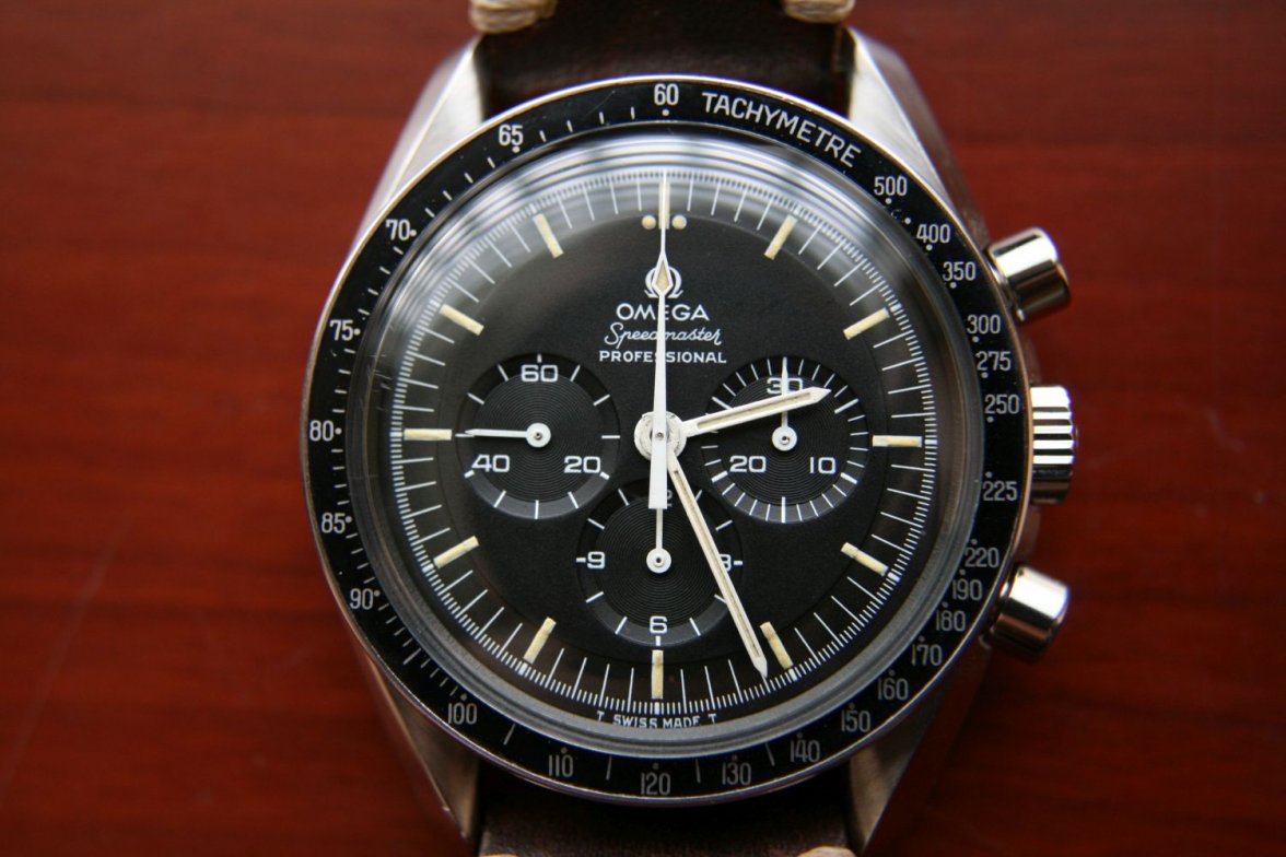

What do you think about this Speedmaster misprint bezel?

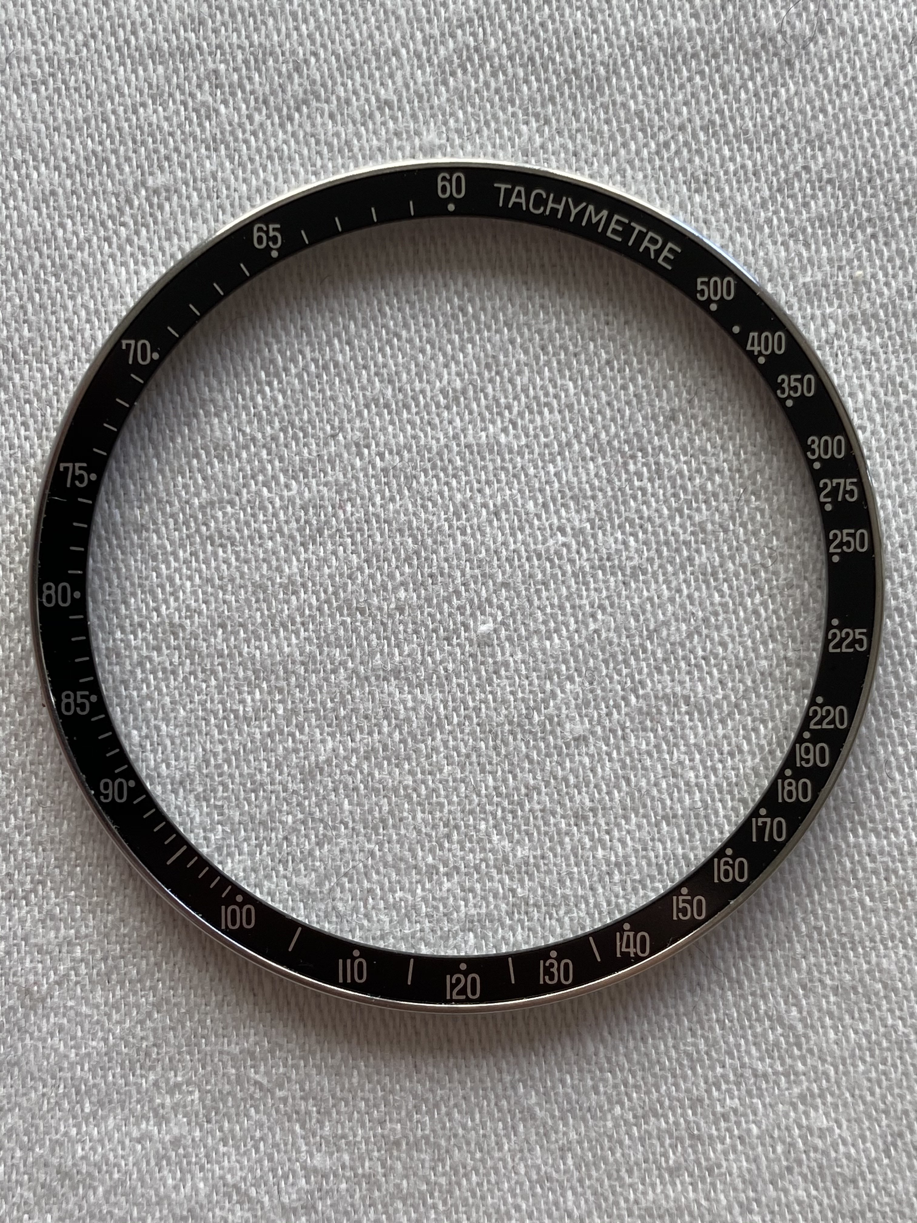

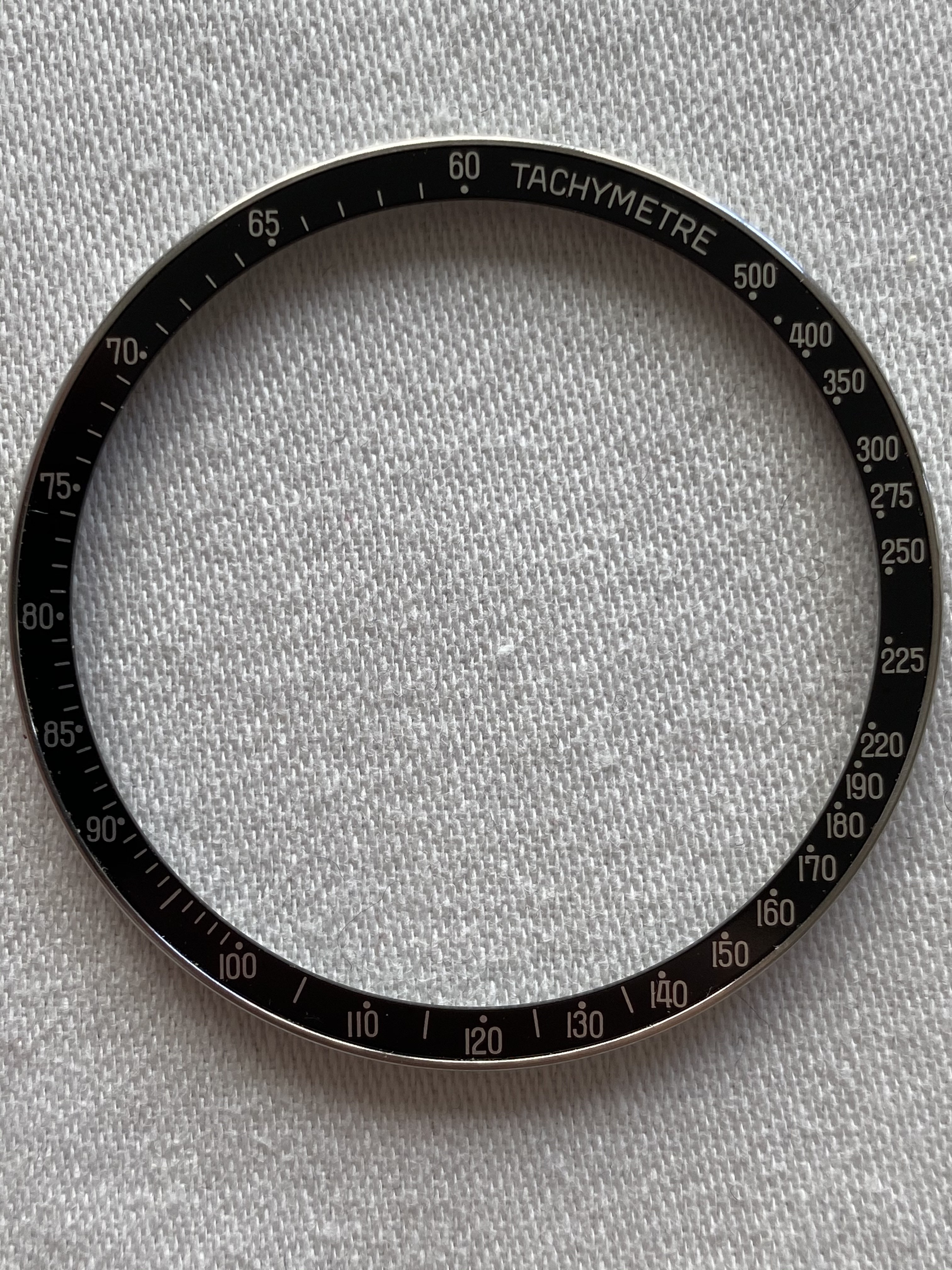

Two more pictures of the misprint bezel!
Looking forward to seeing the bezel on your watch! I'll bet you can't wait to get it installed!!
