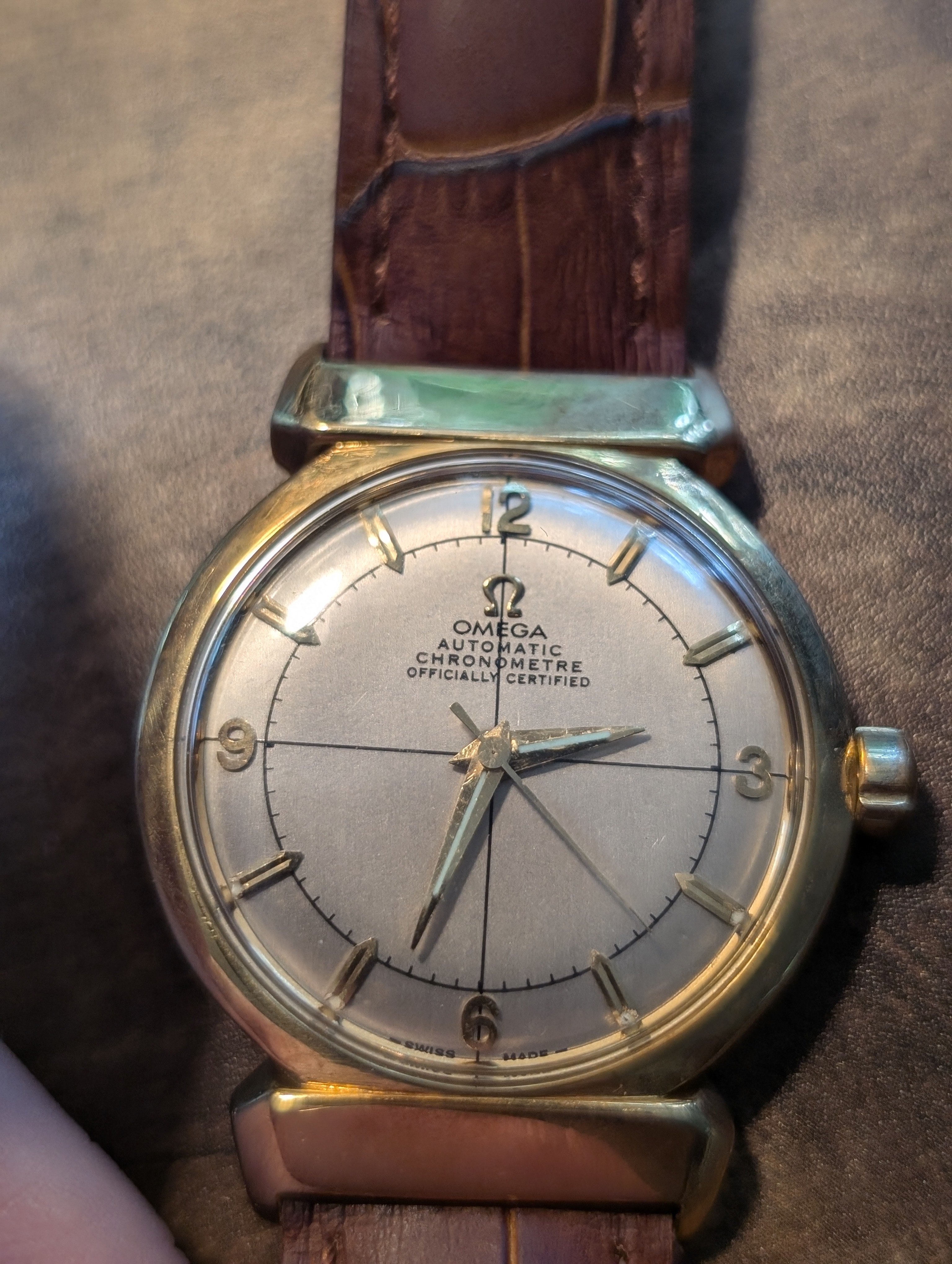

Hello new friends
I bought this watch about 15 years ago for a few hundred dollars. I thought it was a steal at the time and then completely forgot I owned it. I just opened an old box and found it.
Does anyone know what I have?
I never opened it when I bought it the first time and I still haven't opened it today. It is still working perfectly, although I did have to change the time.
10,804
16,814
A redialled original 1940s bumper model at a guess.
13,492
31,811

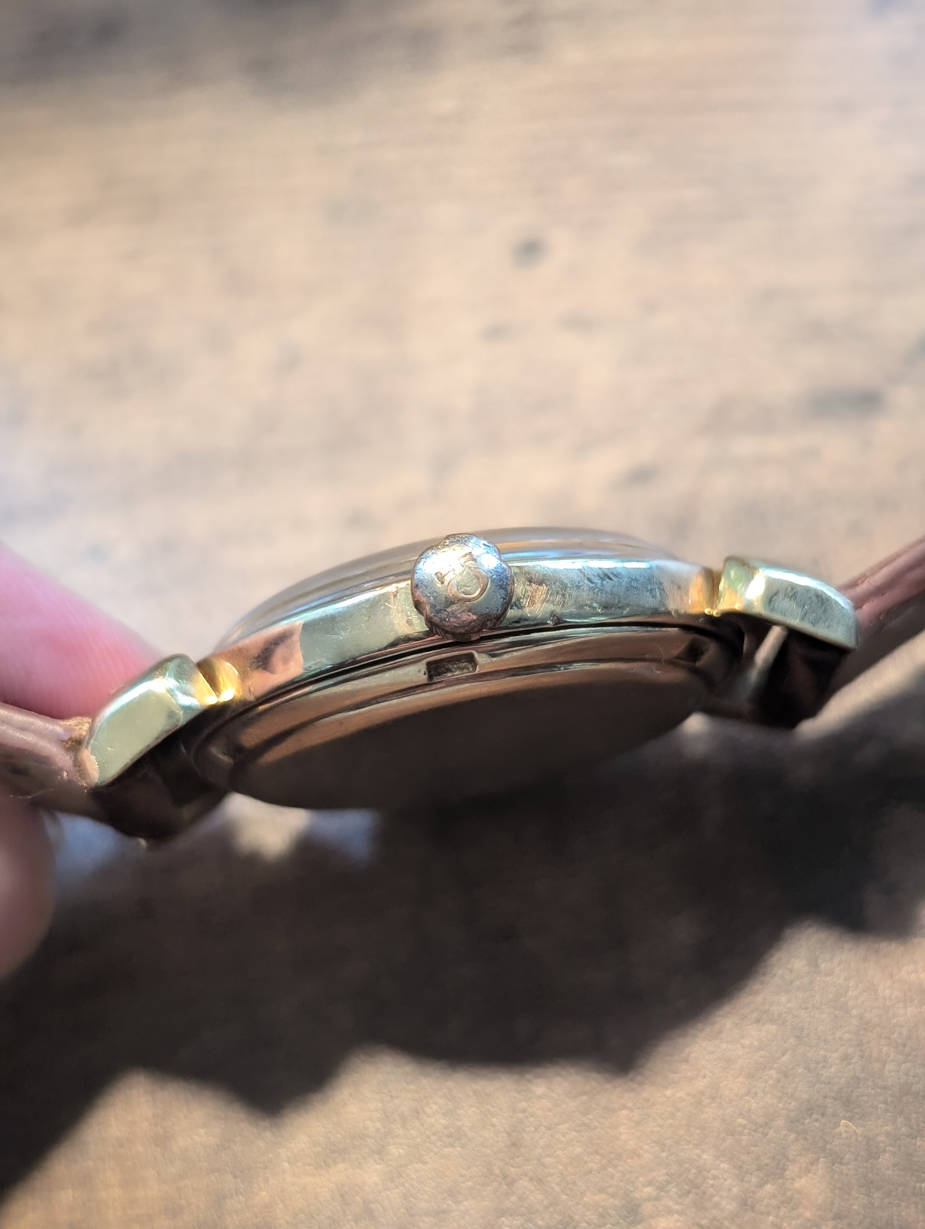

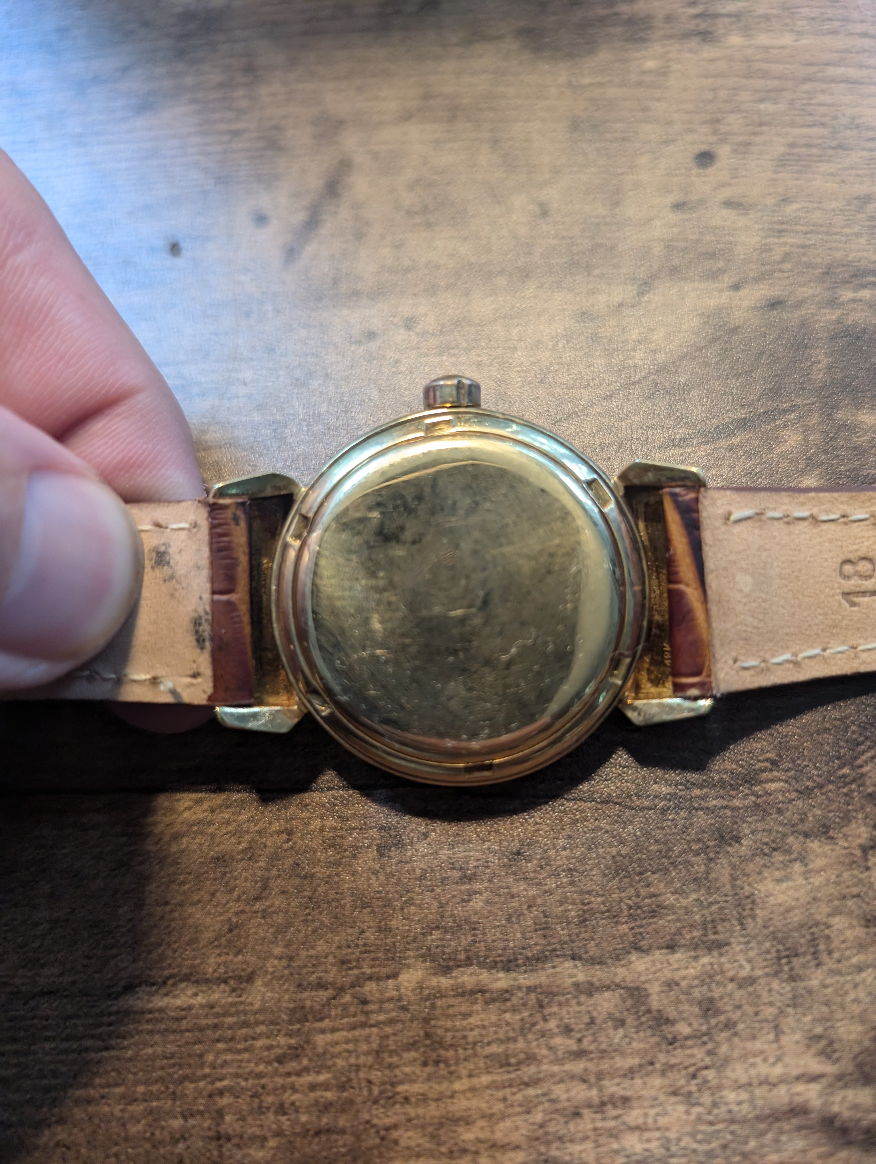

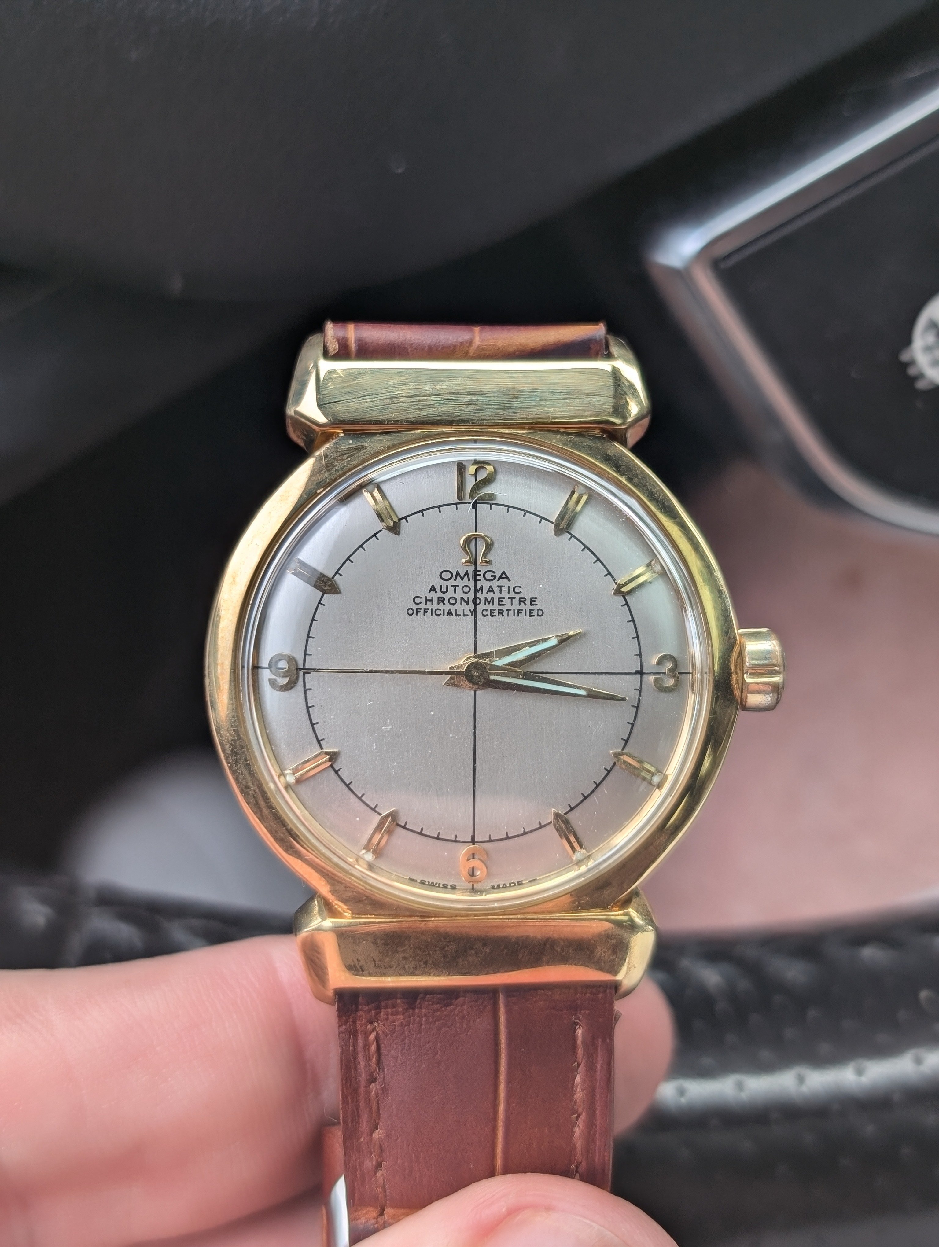

Looks like a ref 14324 with a poorly refinished dial.
18K gold, caliber 352/354, ca early 1950s.
An uncommon reference unfortunately in very poor condition.
