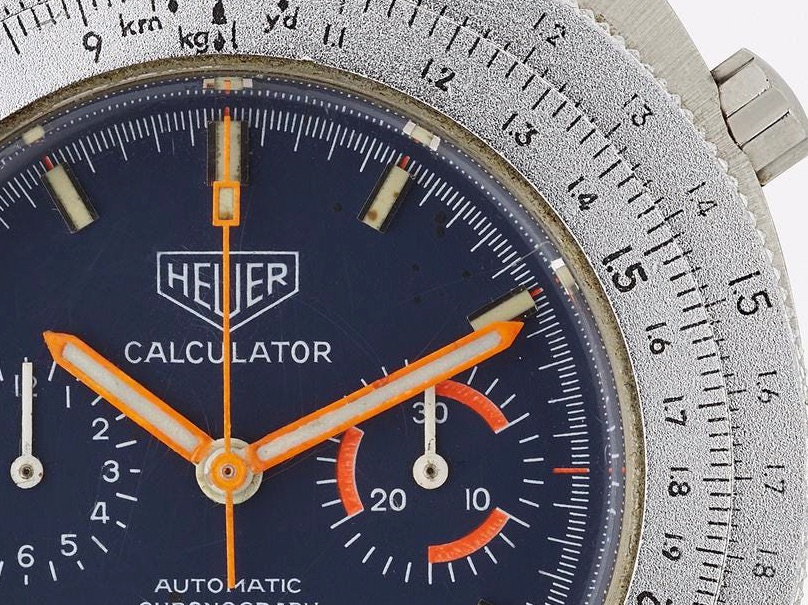

There is discoloring and spots on the dial around the 1 marker. What causes this? Is it rust? Bad gasket? Will it continue to get worse?
I am trying to learn. Thanks!

Yup- moisture got in and condensation caused the droplets which are now damage. Damage like this is very common and not always related to someone swimming or showering with the watch.
When the rear seal and crown seal (and pushers too if it’s a chronograph) start to age they lose their ability to keep the moisture out- it can be sweat from the skin or even ambient humidity. Go from a hot humid day outside into air conditioning and it can happen if the seals are compromised. I don’t wear watches with vintage crowns or aren’t waterproof in the heat of swampy summer.
For those who just have to have that original crown and throw caution to the wind regarding the rock hard/goo like gasket inside- this is your future.

I don’t think it would be a huge issue if people actually serviced their watches more than every 20 years (crazy watch people here withstanding of course) and had the gaskets replaced. But as I said before- if you have a vintage crown, you roll the dice.

I think in some cases where you see the even patina it is long term exposure. But with droplets like shown in the OP’s picture, it looks like the dial “sweat” and the moisture penetrated the finish and spotted the lume.
I attribute moldy hand lume and corrosion to minute moisture settling under the crystal (up surface) and the hands sitting in that humid cloud at the top of the biosphere- but the dial sits lower.
