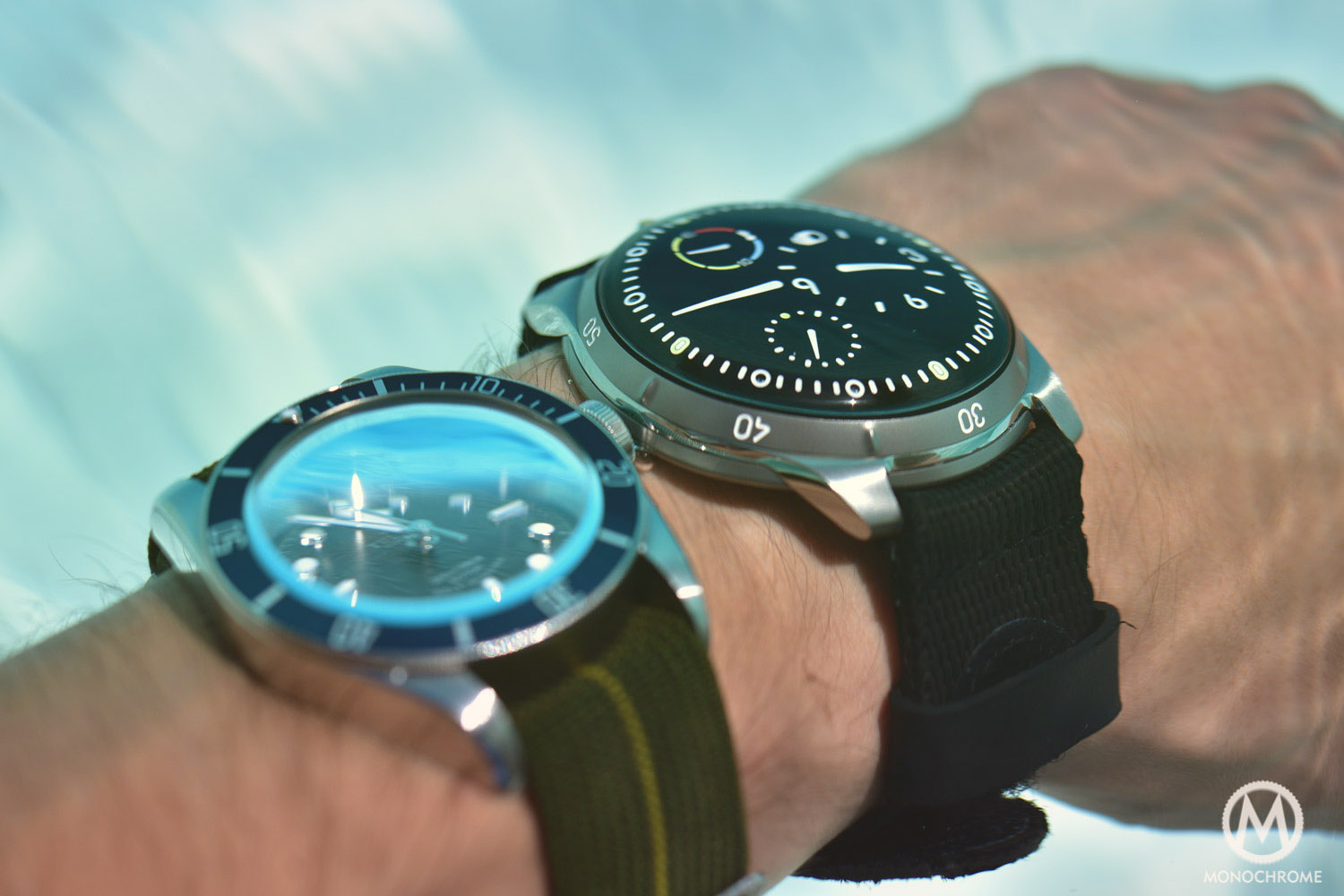

What problem was this watch intending to solve?
Water resistance isn’t it...
Was only joking about a water-filled Speedy approximating the oil filled ressence type 5 - the latter solving for only one minor thing (cool though):
That is groovy!
Cool, just asking because there are people out there who think the movements in these run in oil, and they do not. There are quartz oil filled watches, but no mechanical movements I know of running in oil...the balance amplitude would be pretty bad.
Yeah, magnets are the magic in this watch as I understand it (the oil filled compartment components being moved by magnets from the underside), which use of magnets has always seemed curious, in my ignorance, given the usual voodoo of magnets and movements.
