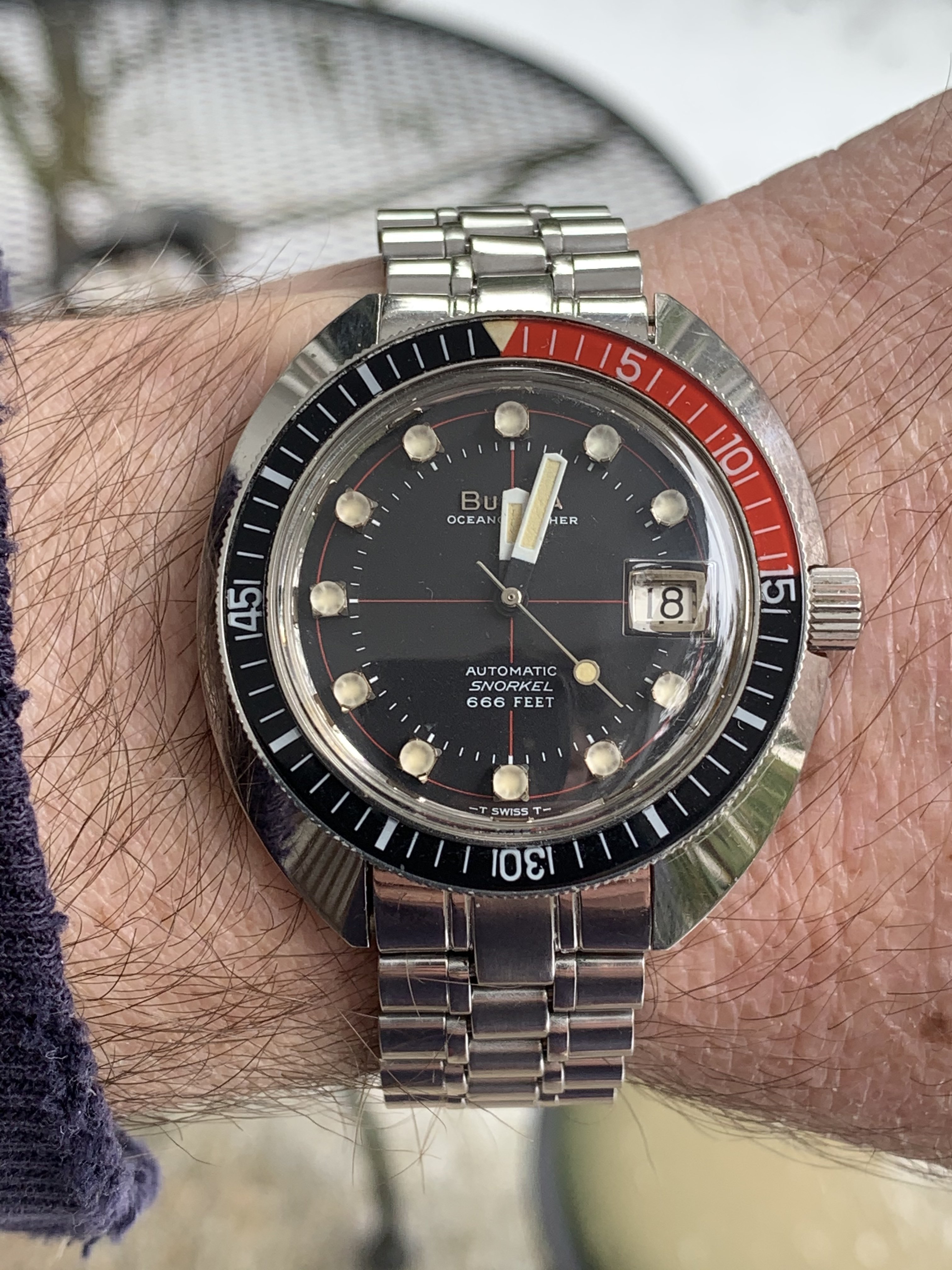

Snorkel, baby!!
Sure, it says 666 on the dial, and the rear seal is fresh- but I have an original crown on it….not a chance I plan on getting this near water. If I really wanted one to wear to the depths, I would get the current reissue.
This is all common sense guys. If it hasn’t passed a pressure test in the last few years, assume it has no water resistance whatsoever. If it has fresh seals and passed- then dunk away.
If you wear vintage and really want to tempt fate- it’s your watch- go for it.

Snorkel, baby!!

Regarding vintage Speedmasters, implicit in this thread is that most likely, if you find that flat-foot crown you’ve been searching for to finish your 1960’s restoration, the seals are shot and you needn’t bother testing it as it won’t pass anyway. My guess is that age is as bad or worse for seals than use, like with constant winding.
16,305
45,025
Yup! I love how obsessed people get about original crowns…which although may add to collectibility, speaks to a watch that hasn’t been serviced properly in the recent past (unless the watchmaker was able to replace the captured gasket inside).
Any of my vintage watches I intend to wear in any weather other than dry and sunny have fresh replacement crowns at the time of service (factory if available or generic if not). Original crowns are kept in my parts box and labeled.
I’m not making these points to convince those who have their opinions, just caution people new to vintage who may get the wrong idea from those who like to play it fast and loose.
Originality is awesome- original rubber is a gamble.
