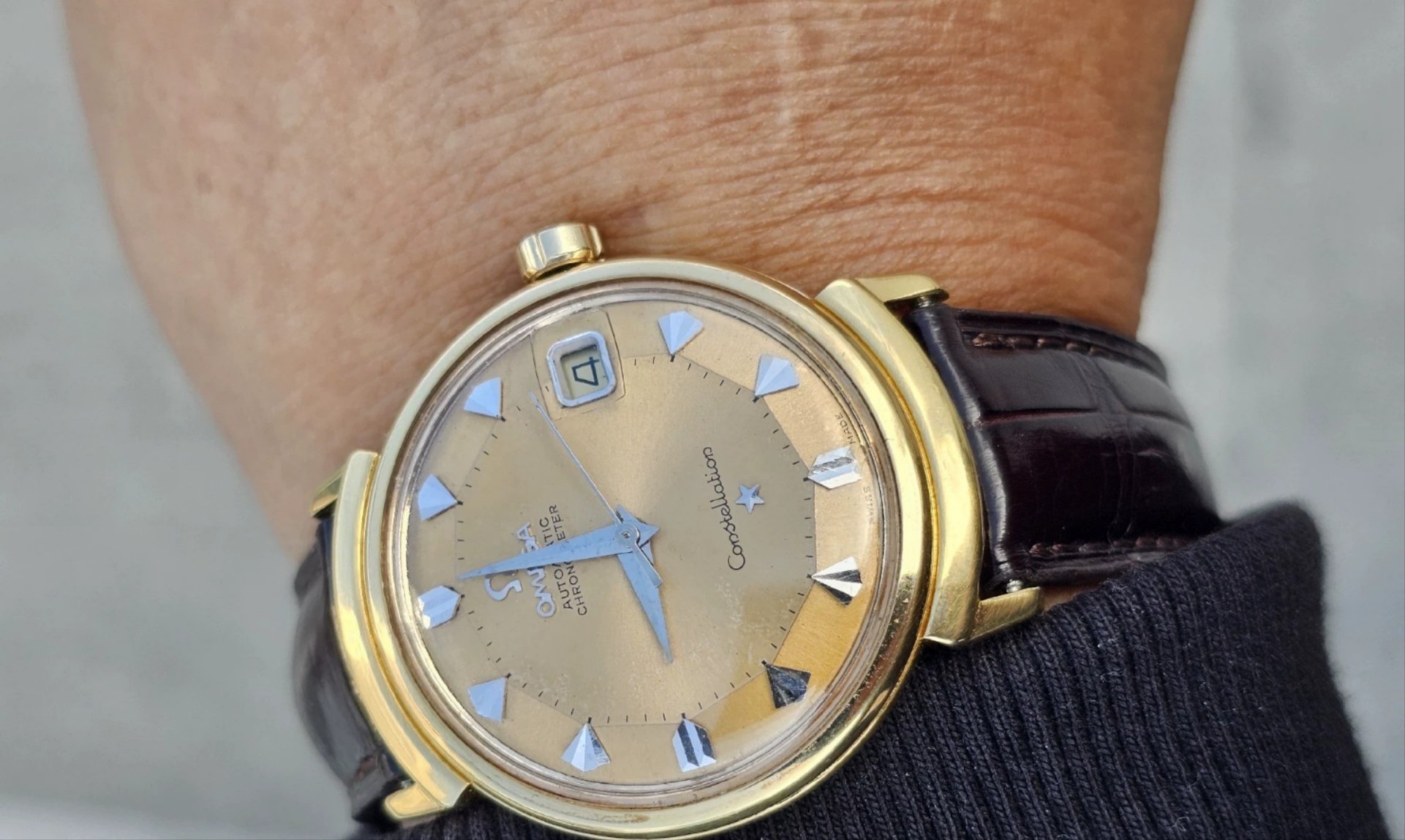

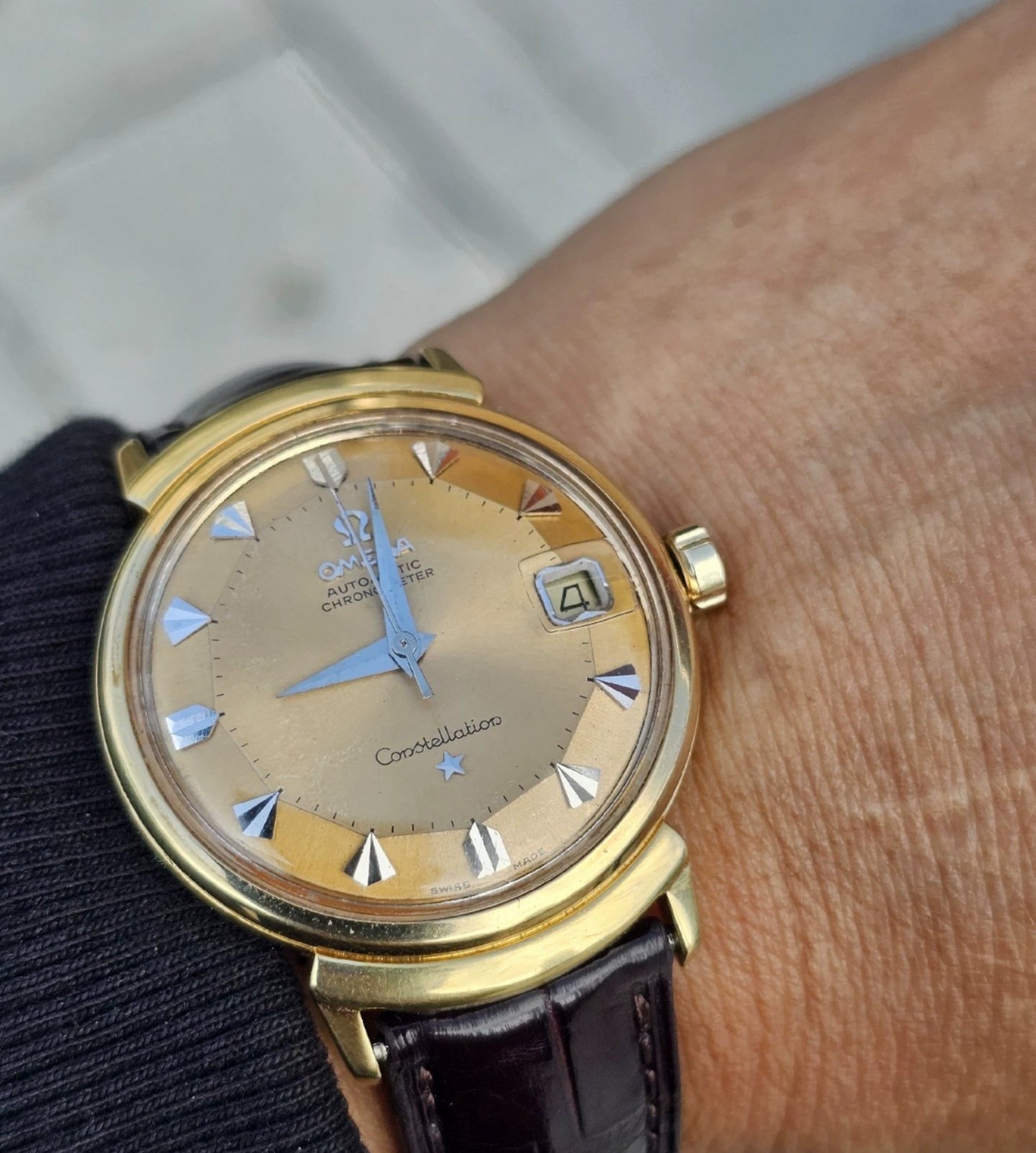

WG hardware on gold dial
2,814
6,941
I’ve seen c-case Connies with this design choice, I wonder if they’re from the same timeframe.
13,489
31,801
C-case would be from at least a decade later.

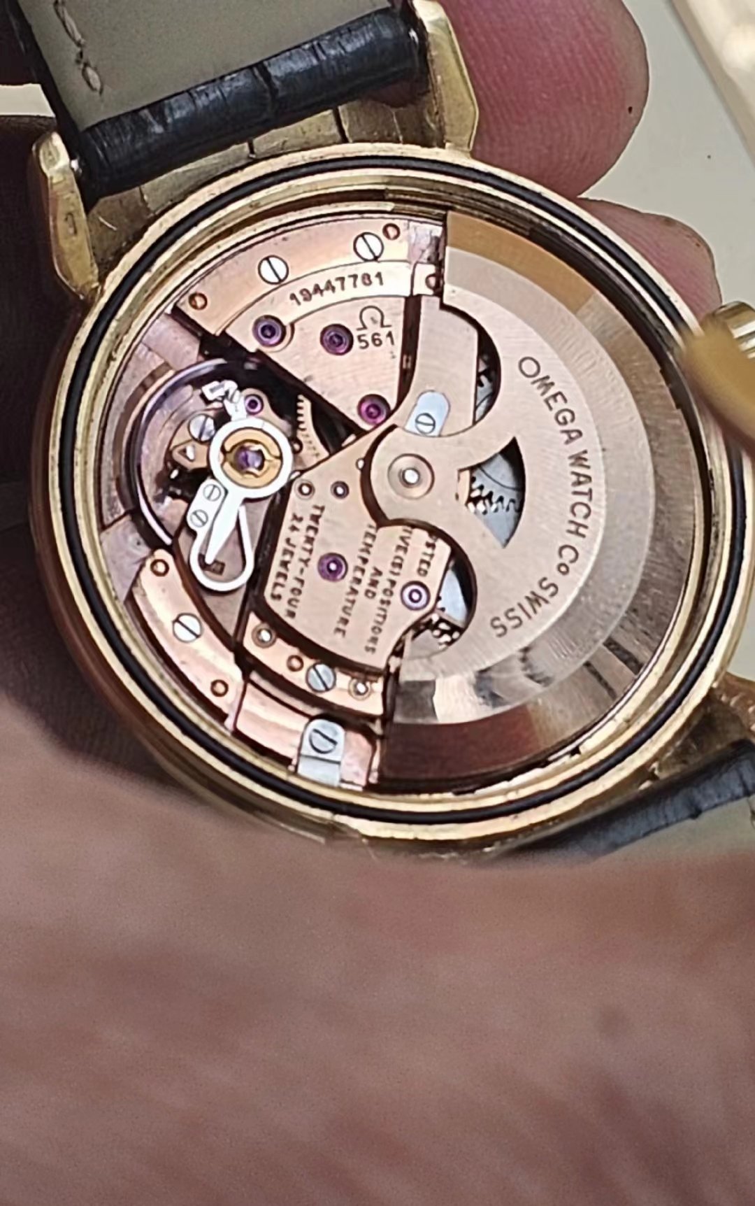

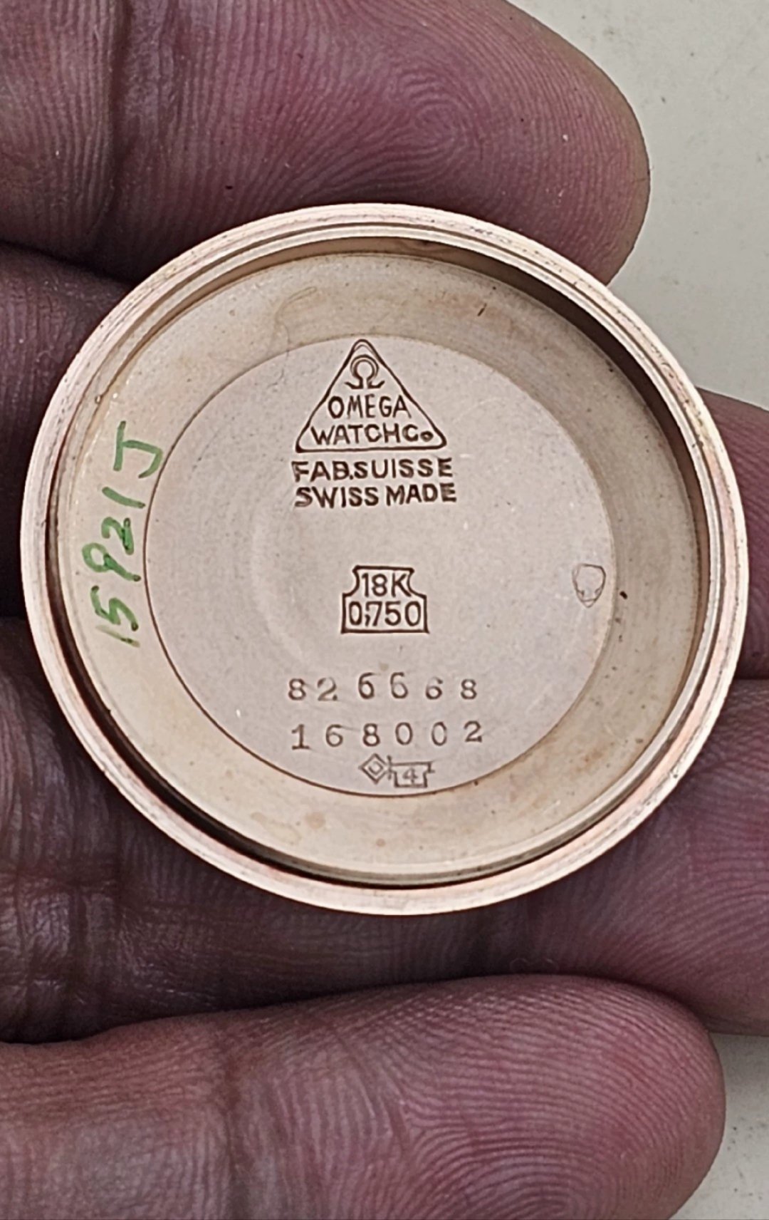

If I recall correctly, all the 168.002 I have seen is with "officially certificate" text, do you have pic of the movement and back of the dial?
558
2,681
Here you go:
2,677
3,151

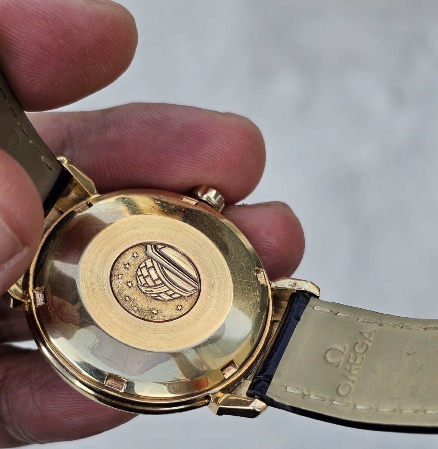

Not that there's anything wrong with it, but a lot of signs this could be a parts watch, I see the touch
The caseback touch up, the pivoted later service seconds hand, don't know this model but the crown looks like a replacement as well?
219
209
Franken or not, that's a funky watch. I don't know how to feel about that combination.
558
2,681
TBH I don't like the combo...
