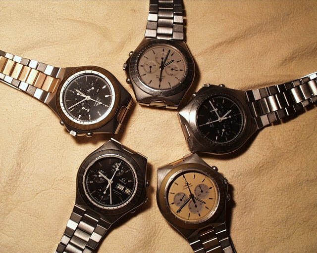

That there is a Speedmaster Teutonic
Actually several of them
Why don't you see or hear of them often?
3,861
8,804
Because the DON and the dot next to 90 both have a dot over 100. 馃槜
馃う Doh!
Found an image of the DON and enlarged it. I can see the dot is clearly over the 90 in these early bezels. I am assuming pre 1970?
Learn something new every day, if you open your eyes and look carefully. ::rimshot::
