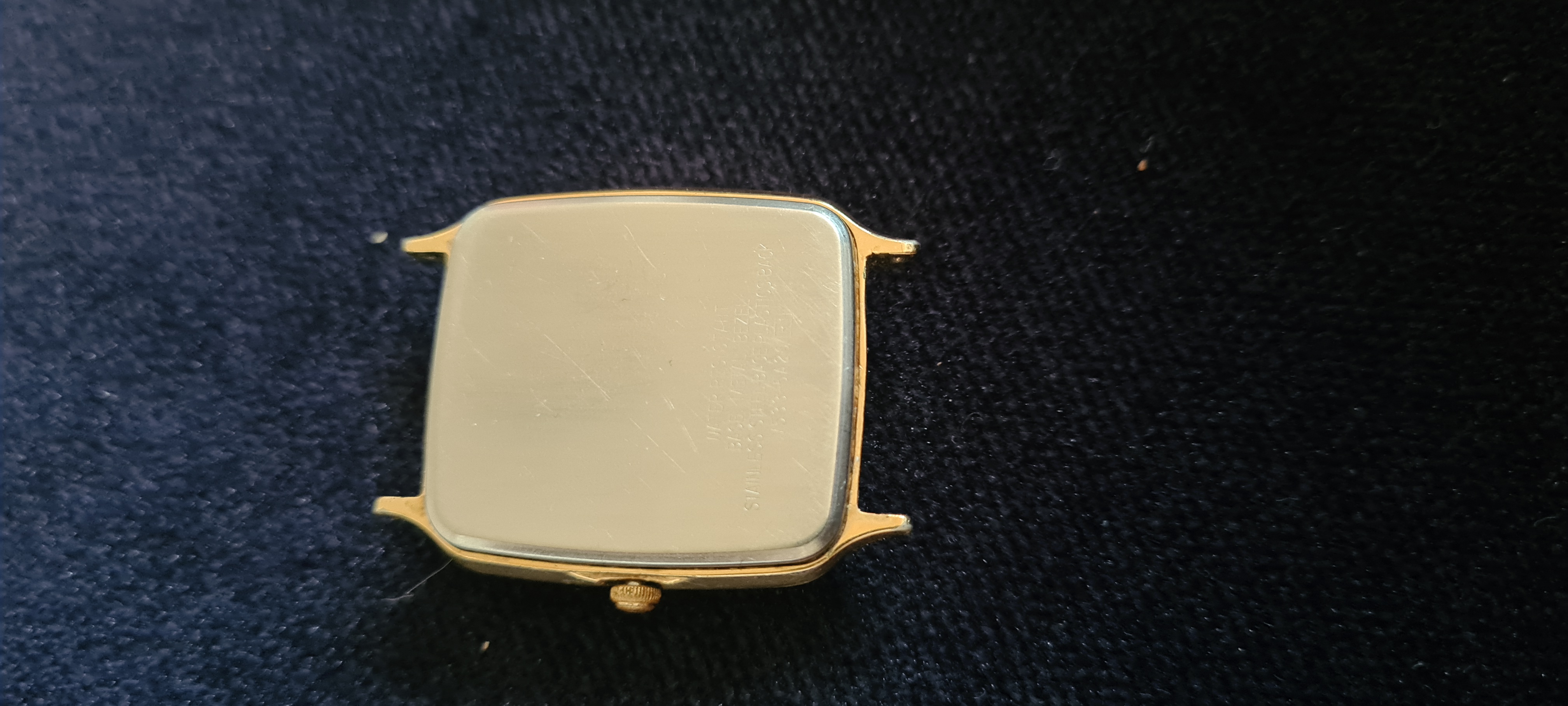

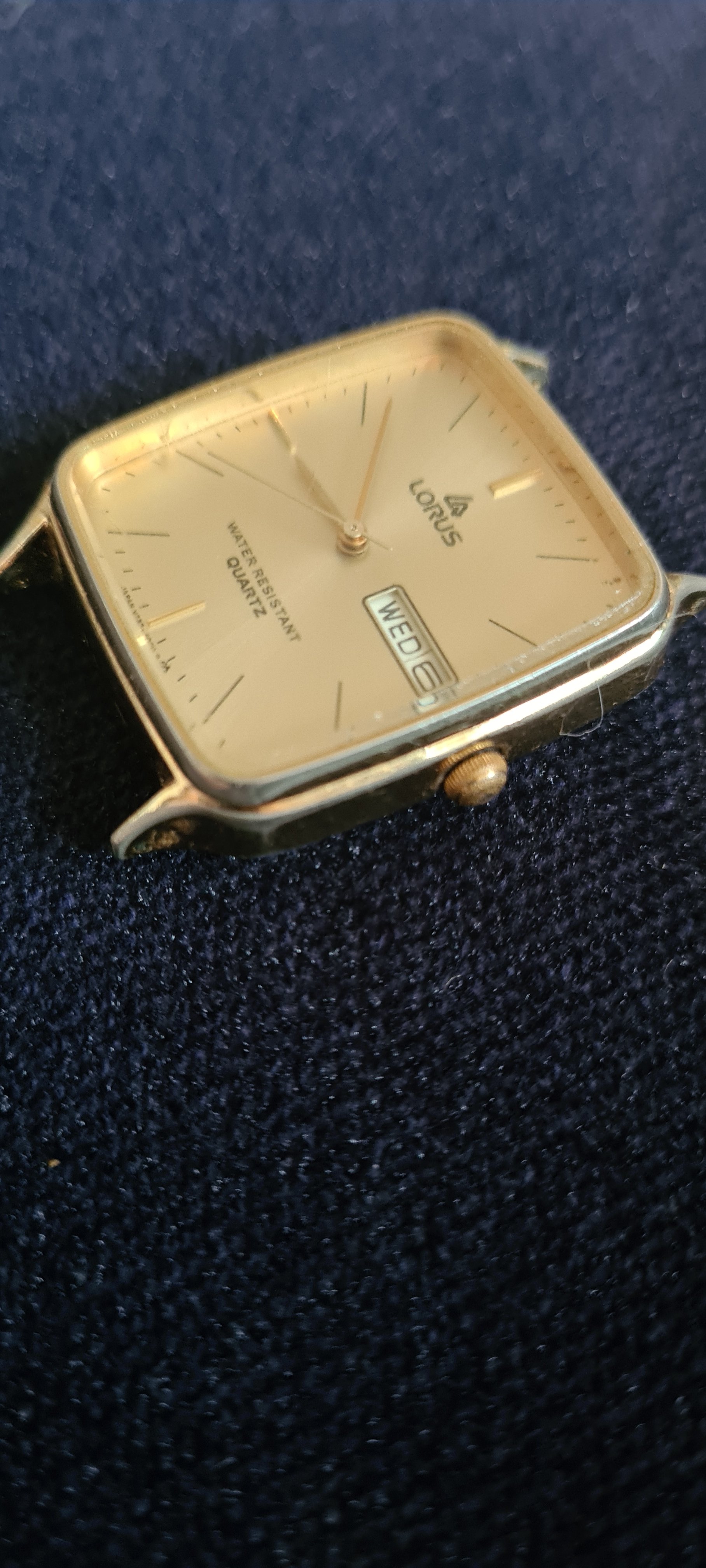

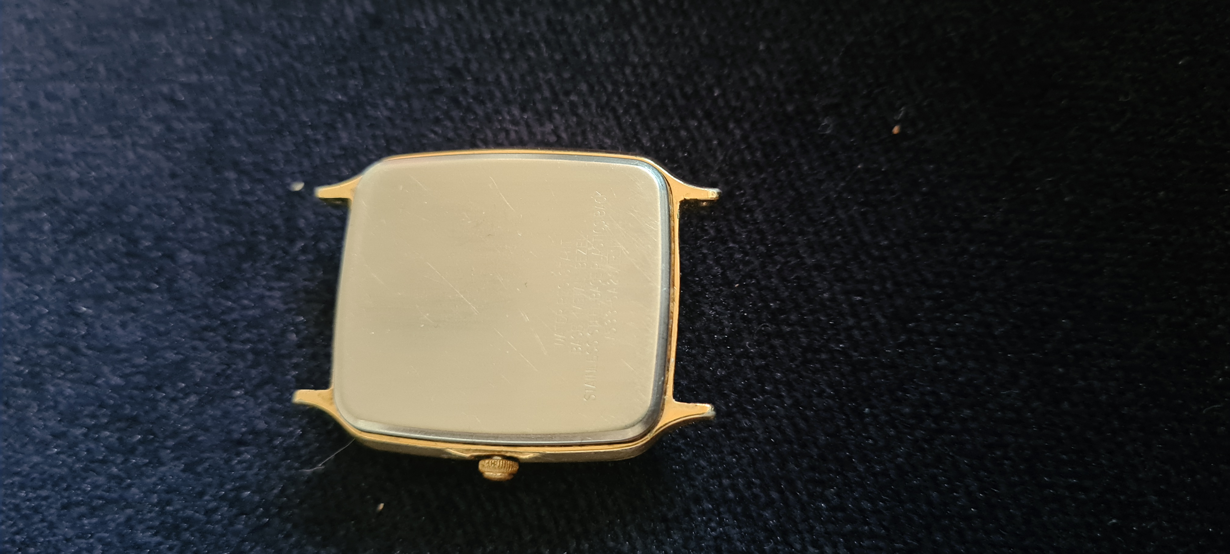

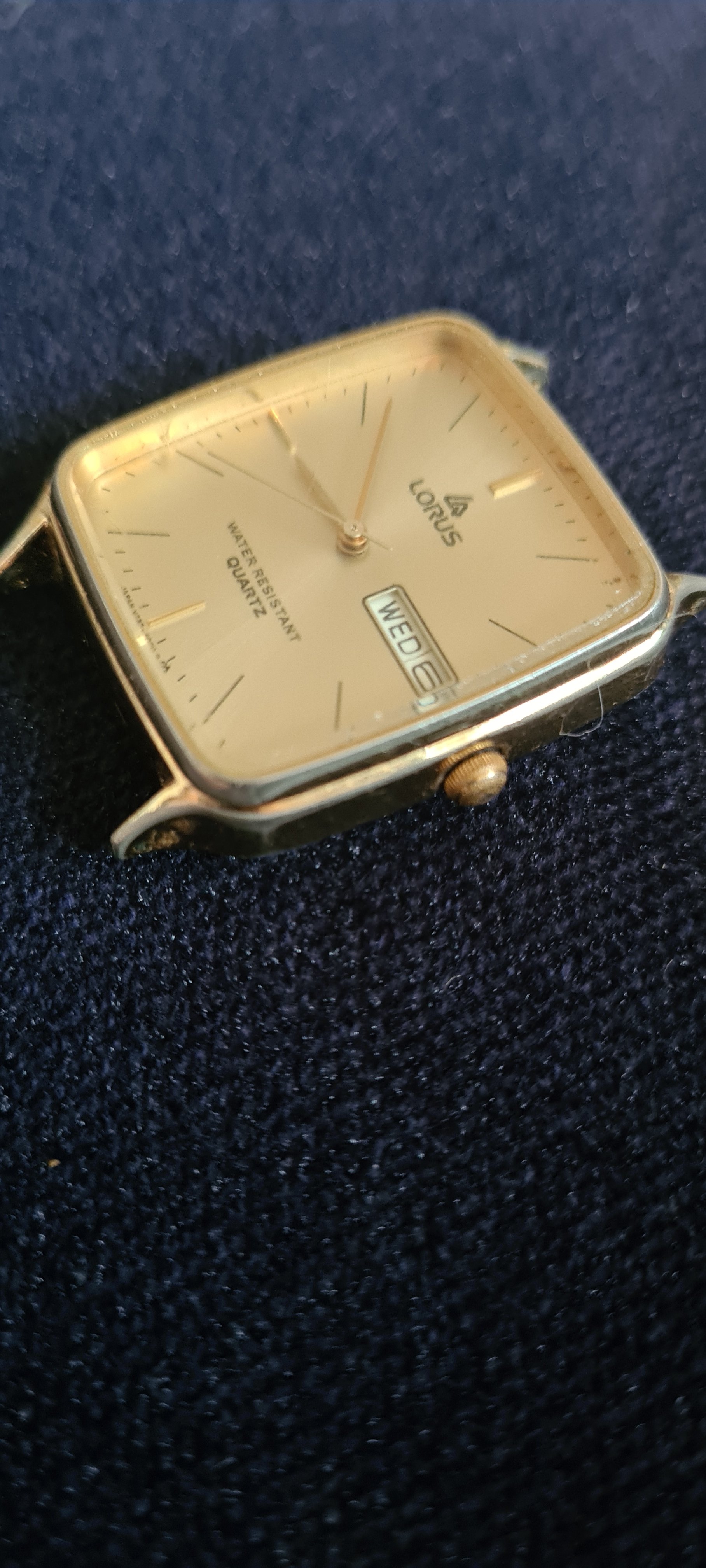

Probably best for dry weather wear but the water resistance of watches is sometimes underated. My grandfather wore a cheap Lorus quartz with a snap back case for 30 years in South Wales which is pretty wet. I would bet he never had the gaskets changed when going to a market stall for a £3 battery change but the thing shows no signs of water ingress and 4 years after his passing the watch is still working perfectly. j

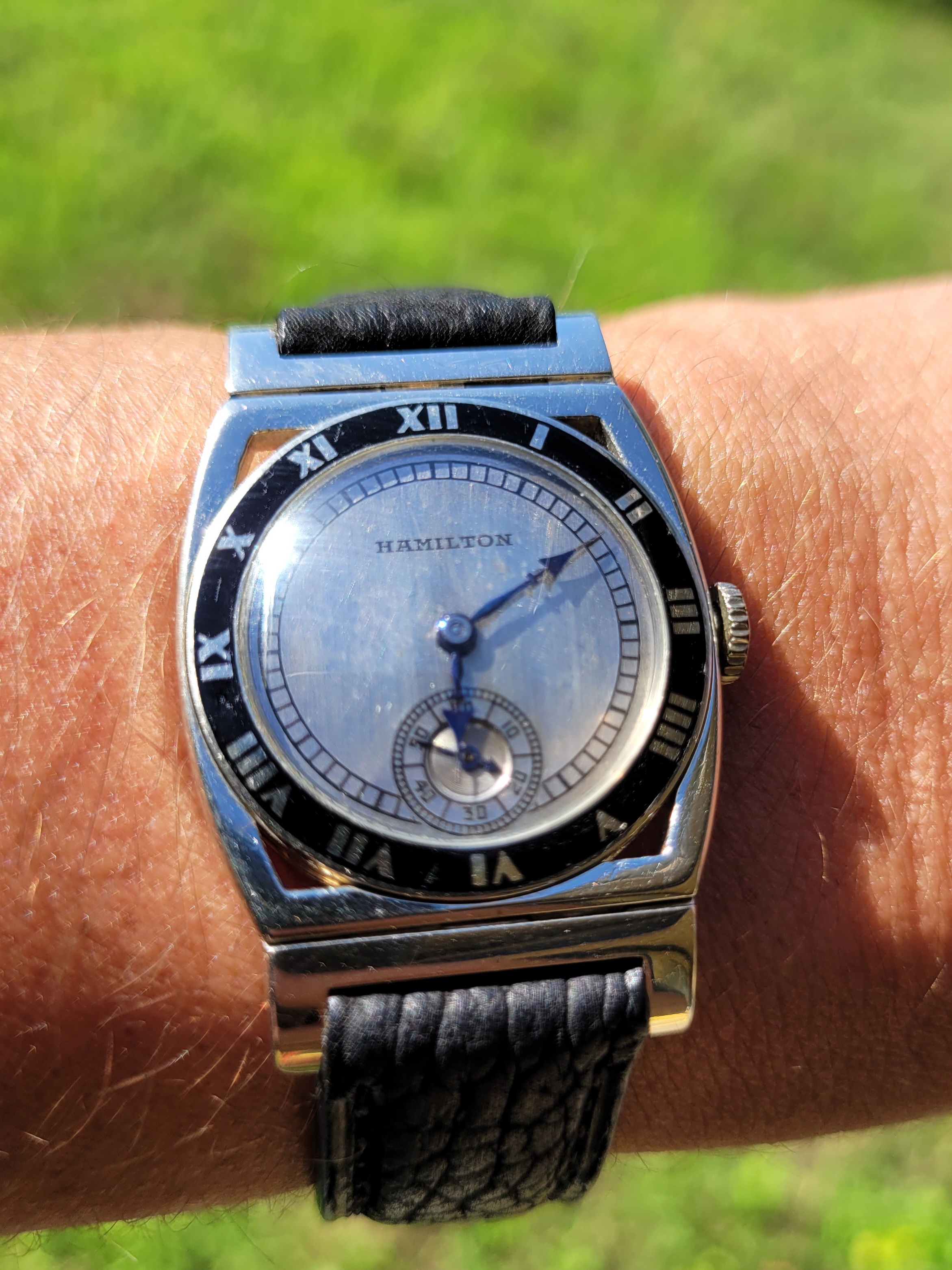

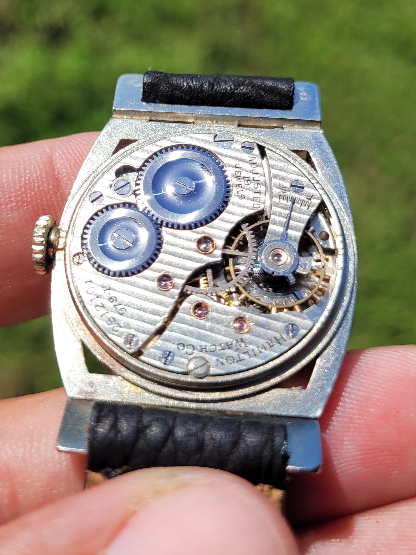

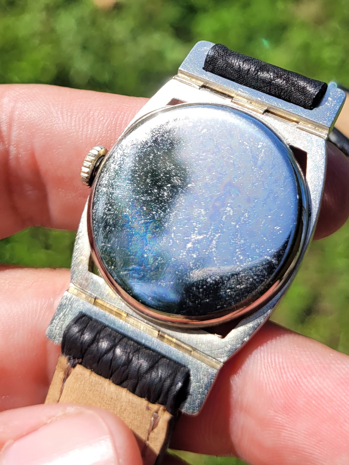

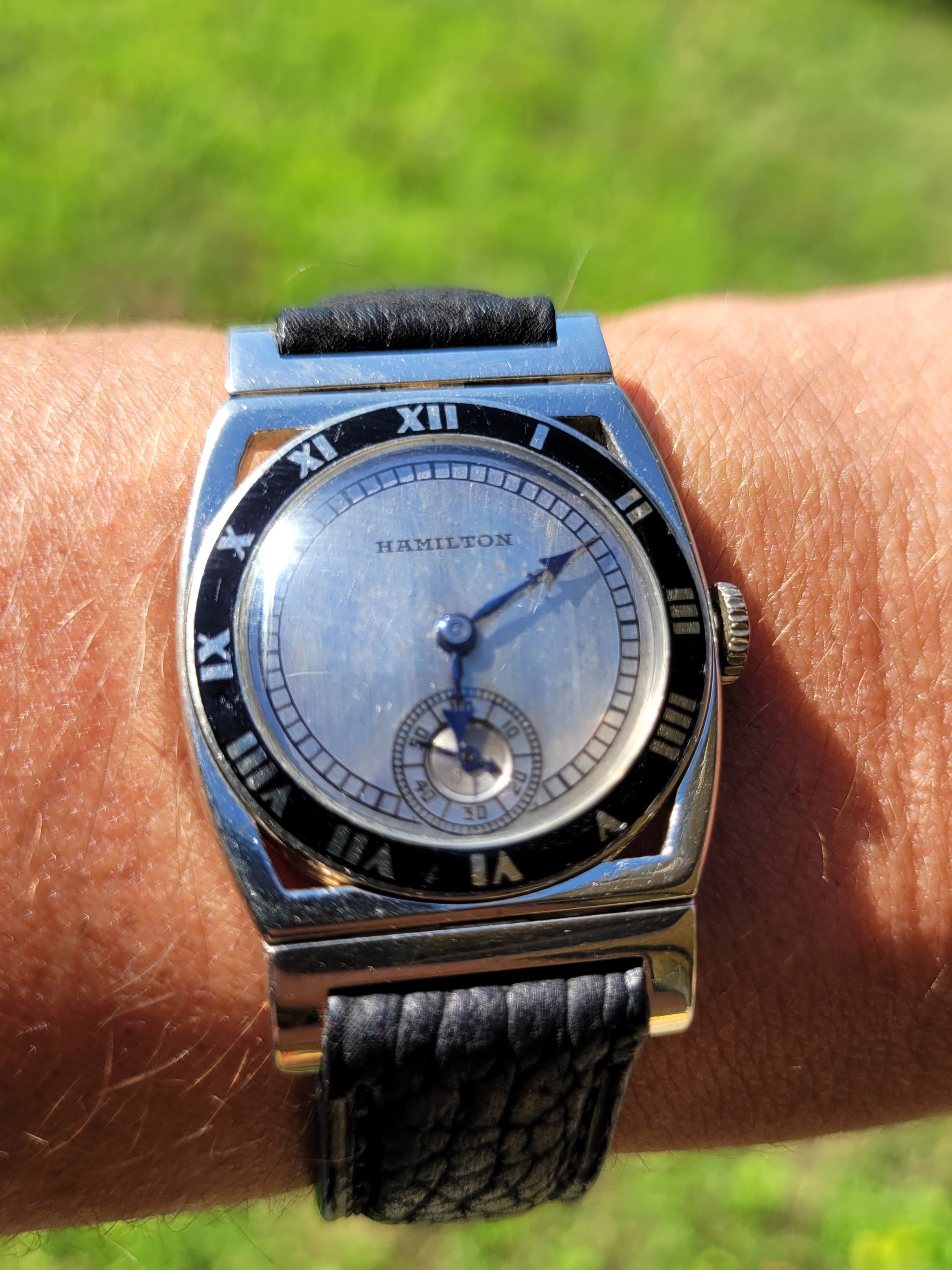

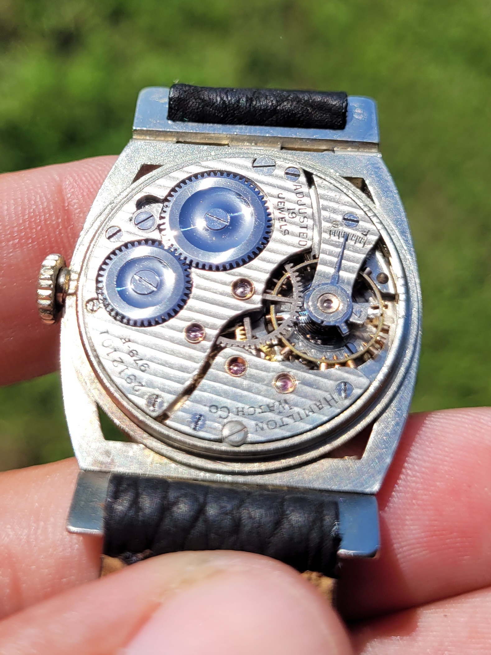

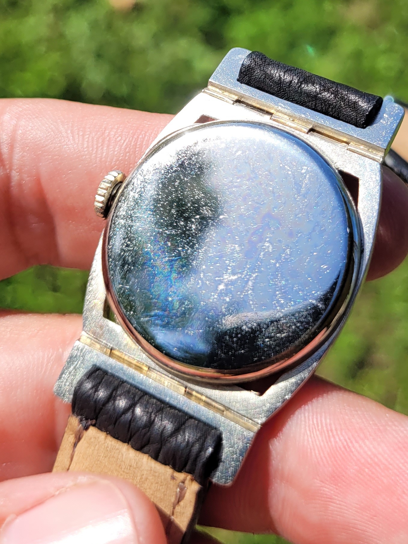

I wore my Hamilton Piping Rock today. It was warm and muggy here, 98°F and 32% humidity. I spent five or six hours out running errands in it. I have no A/C in the daily driver. I just got home, it's still 97°F out. The case back has a bit of sweat on it, after popping the back off, the movement itself is dry as a bone.
