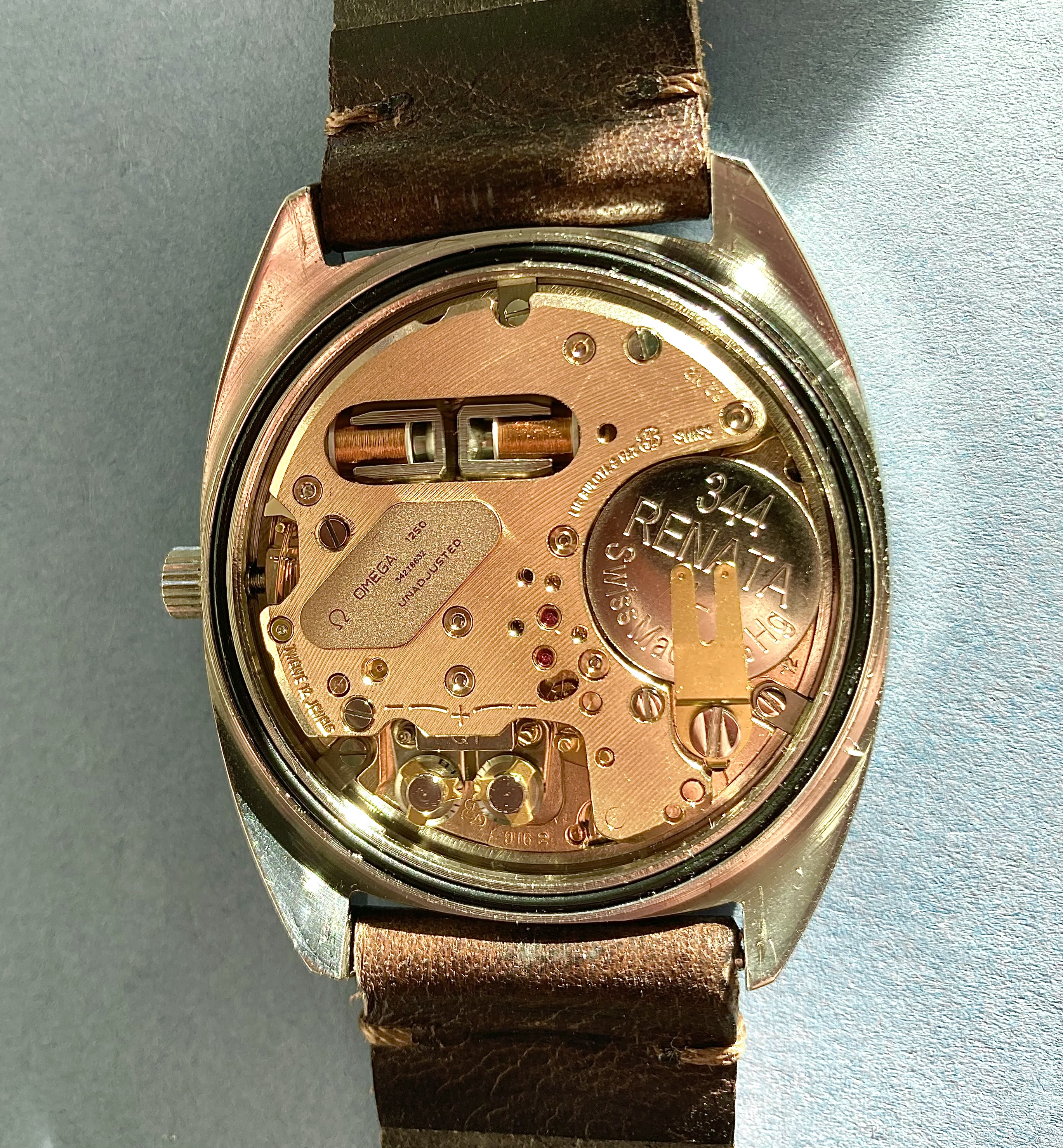

I was wondering if anyone has recommendations for watchmakers that have experience with vintage Omega quartz movements from the 1970-1980s? I have an old DeVille quartz (192.0028) that is working great but probably has not been serviced since it left the factory 50-years ago!. These old quartz movement are as much mechanical as they are electrical. No watchmaker in my area will touch them.
I found a few placed online but I would trust recommendations from collectors more. My DeVille is not really worth enough to justify sending it to Omega.
My watch specifically has a Cal. 1325, which is a 15-jewel quartz movement. I actually picked it up on a steal of a deal thinking I would flip it to help me save up for a Speedmaster...but it is just too damn cool to let go.

Two very important parts for this movement are no longer available - the motor and the circuit. So if either of those are the problem, you are out of luck. Your watchmaker would have to try to find these parts on the open market, and hope they are good when he buys them. This is why people aren't really interest in fixing these.
You could always send it to Omega...but that will cut into your profits certainly.

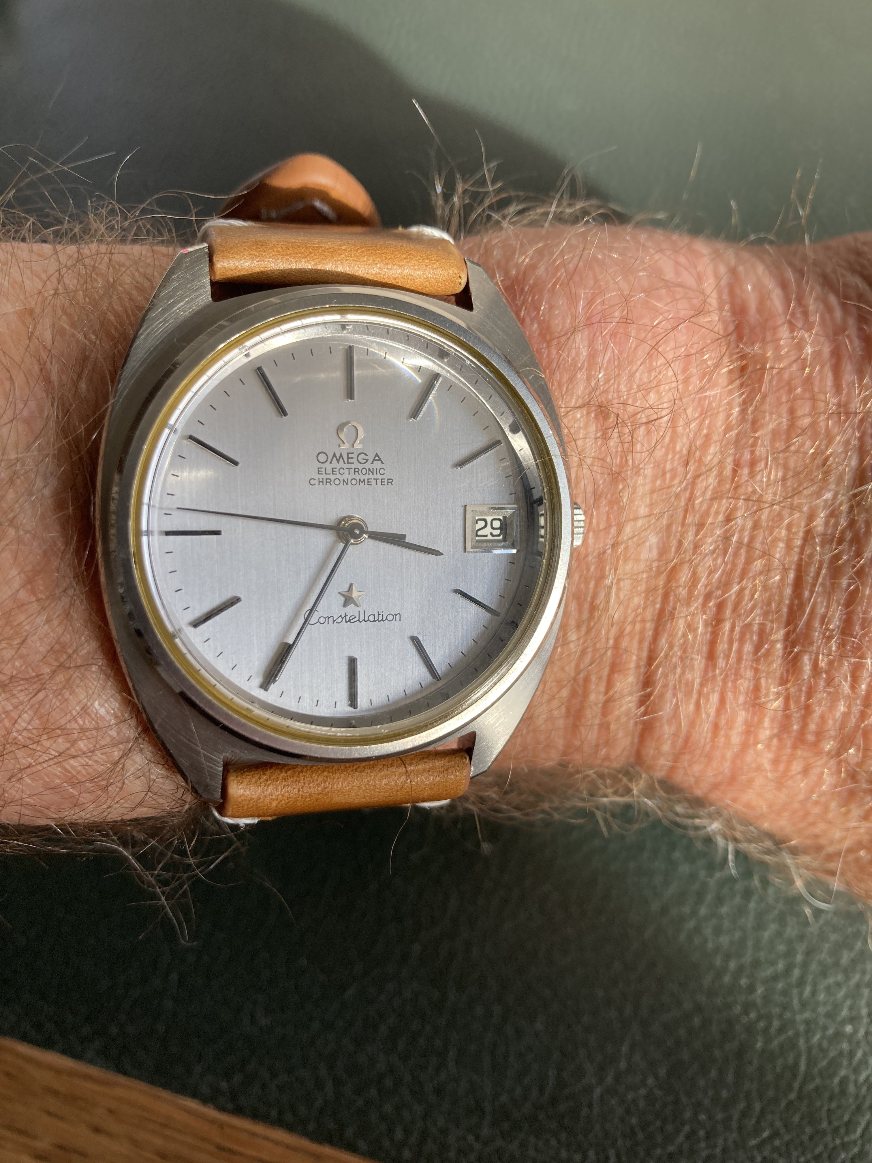

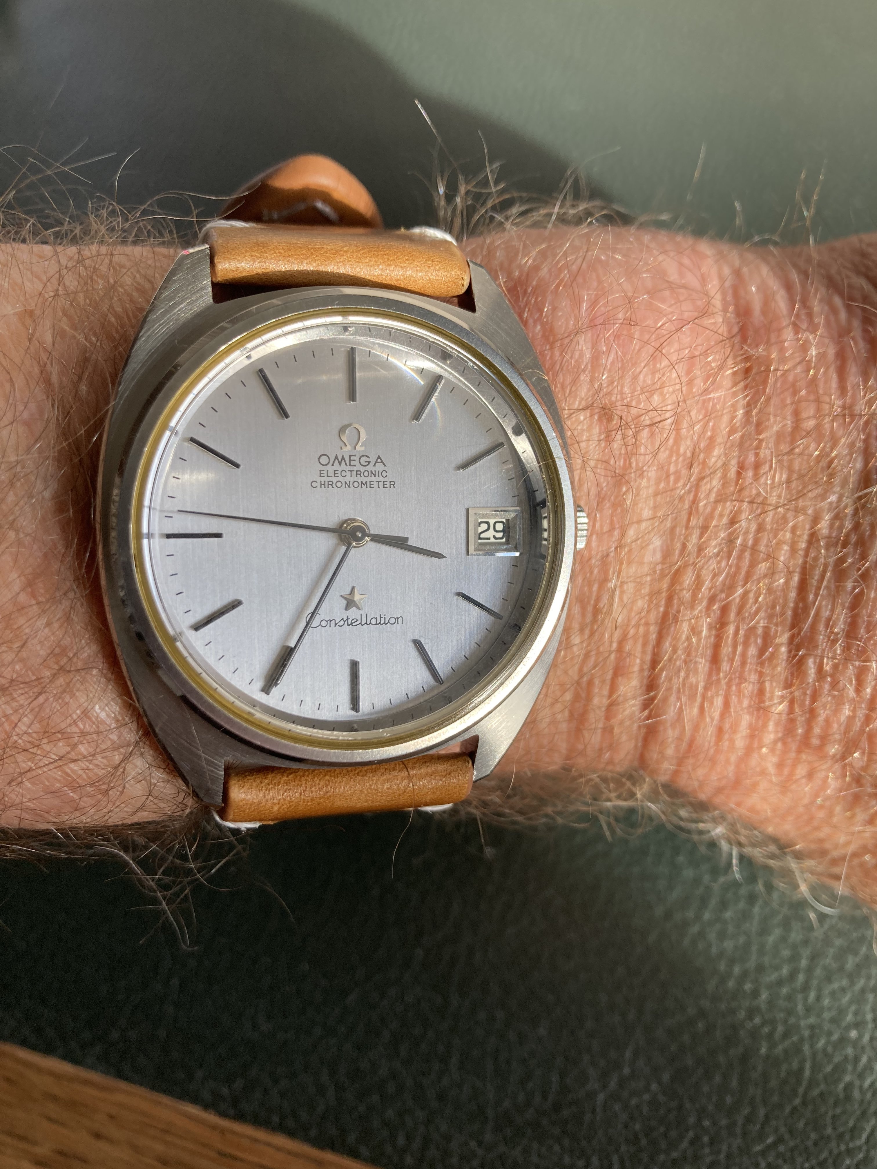

The Croydon Service Centre in Greater London was recommended to me and were happy to help with my cal 1250 Constellation.

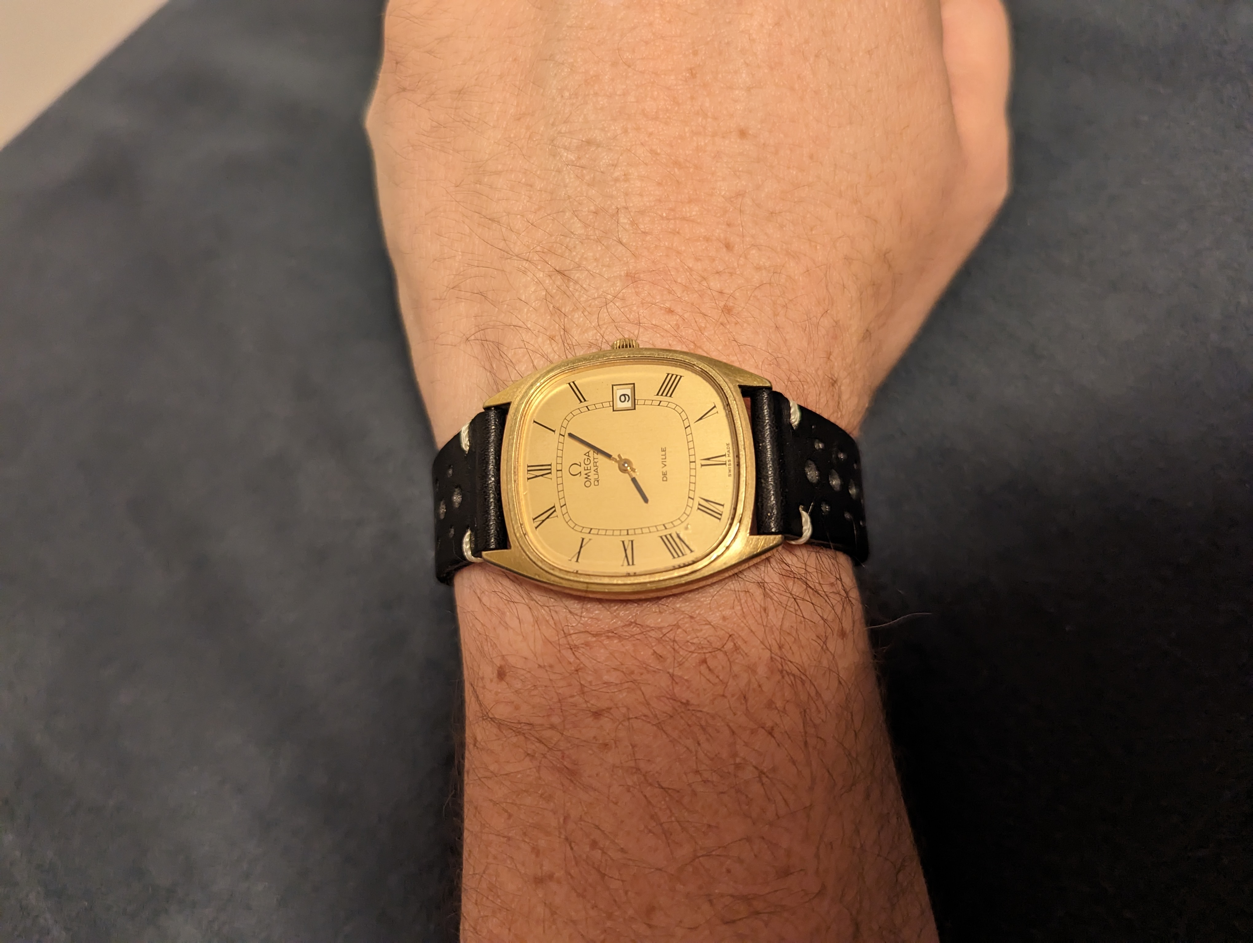

Try Nesbit’s fine watch repair in Seattle, WA. You can email [email protected] with some details and she may be able to help you.

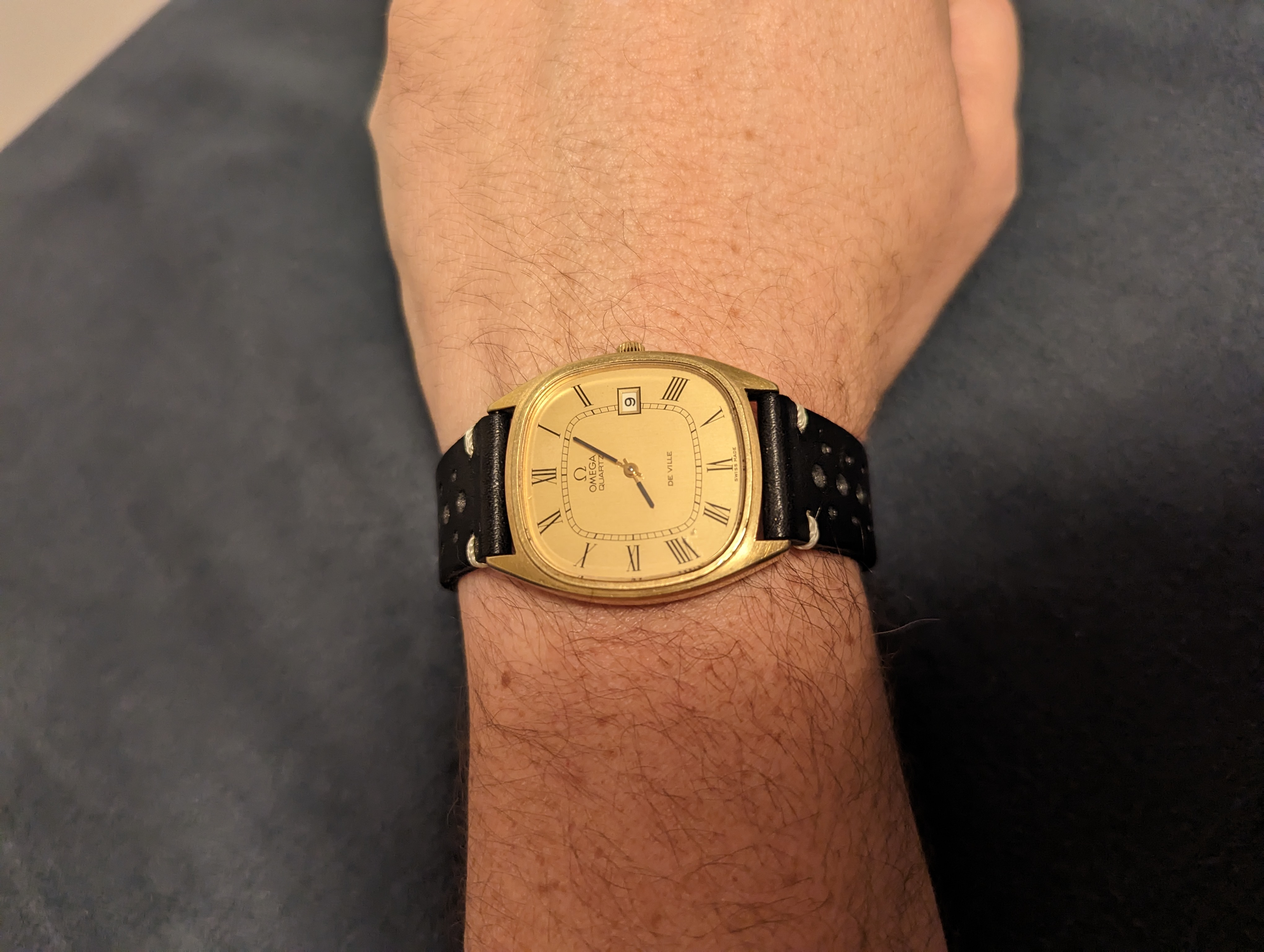

On a side note, I have a 1985 18K gold DeVille quartz. I don’t wear it very often and wondering if it will harm the movement to only run it when wearing. Which will be a couple times a month.
