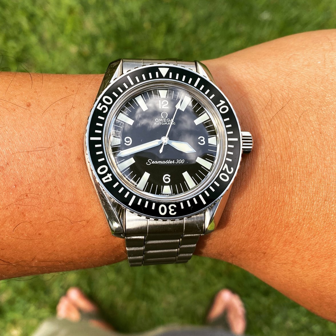

I recently acquired a Watchco Seamaster 300 and would like to have it serviced. The movement is running slow and erratic on the timegrapher, the crown sticks and probobly needs new gaskets. Omega and Nesbits wont service it due to mixed parts ( date vs non date but the parts are genuine omega). Any recommendations of a US based watch repair? Much appreciated!

just about any reputable watchmaker should have no issues with it... where are you based in the States? Some forum members will be happy to recommend.

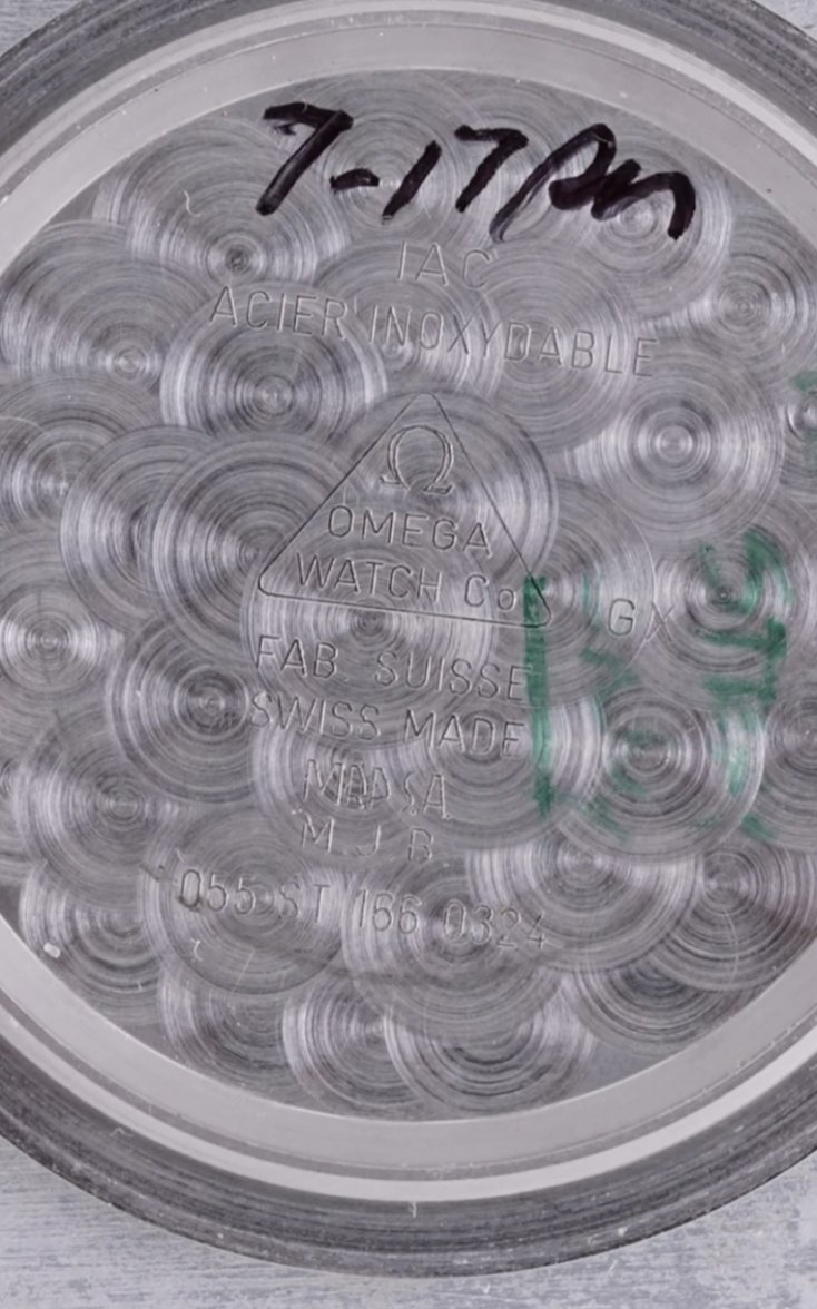

Why all these guesses? Clarification pls. Which reference is inside your case back?

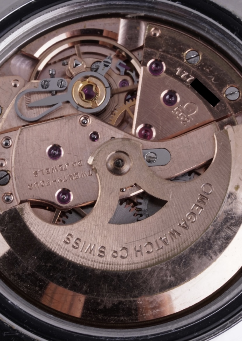

I have a 552 but they said the case seems to be for a 565 date.
This is what I thought it might be. Nesbit may not really understand these so I’m not completely surprised that they made this conclusion. The 1660324 case is technically a date case, but of course it works fine with non date movements and dials. They just don’t get it, so best to move on and deal with someone who does.
5,631
5,815
the very point of WatchCo is that they used 166.0324 cases. 166 means date except when it's not.

Looking at the movement, the rotor has been scraping on the case back - you can see the evidence on both. Based on that, I'd say your prediction is unlikely. Usually when the movement gets this far, there are other things that are worn as well. Very few of these ever come into my shop (55X. 56X, and 75X) that don't need parts, particularly in the automatic winding. And yes, those parts are expensive, and getting more expensive all the time.
