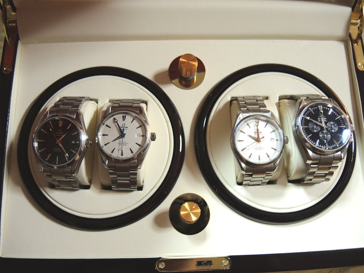

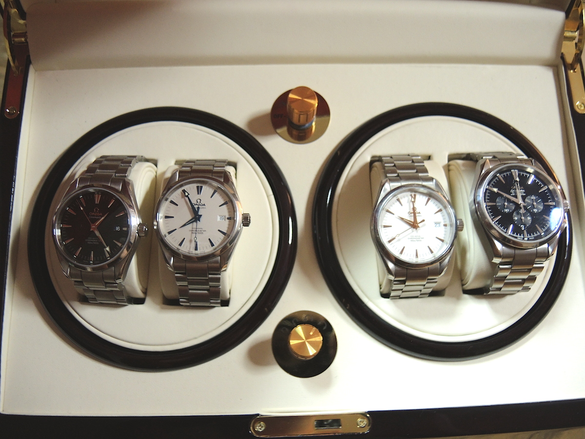

I hv a 4 watch winder that i bought from Amazon a few yrs ago - there seems to be a wide range out there ranging from $150 - $1000. Mine is on the cheaper end. The wood is fake, and the plastic / leatherette material on the cushions is starting to peel / crack but the winder works really well.
My collection has never been bigger than 4 watches at any time so 1 on the wrist and 3 on the winder. I’ve rarely had to manually wind, or set a watch. Usually if i havent worn a watch in a while, all i need to do is adjusting the minutes so time is accurate as its either become too slow or too fast, but generally watches stay wound and on the correct date. With the accuracy and stability of modern movements, even if i dont wear a particular watch for a month, its usually only out by 1-3 mins at most.
As you can see each dual watch case has its own control and there are 4 settings to determine no. Of turns per day - i have mine set to max TPD (~900) and those are split in either direction.
The winder comes on itself several times during the day and just ticks away on my dresser. For the price i paid, I’m really impressed with the quality and longevity this has lasted. I dont have the pictured watches anymore but Winder is still performing flawlessly.
