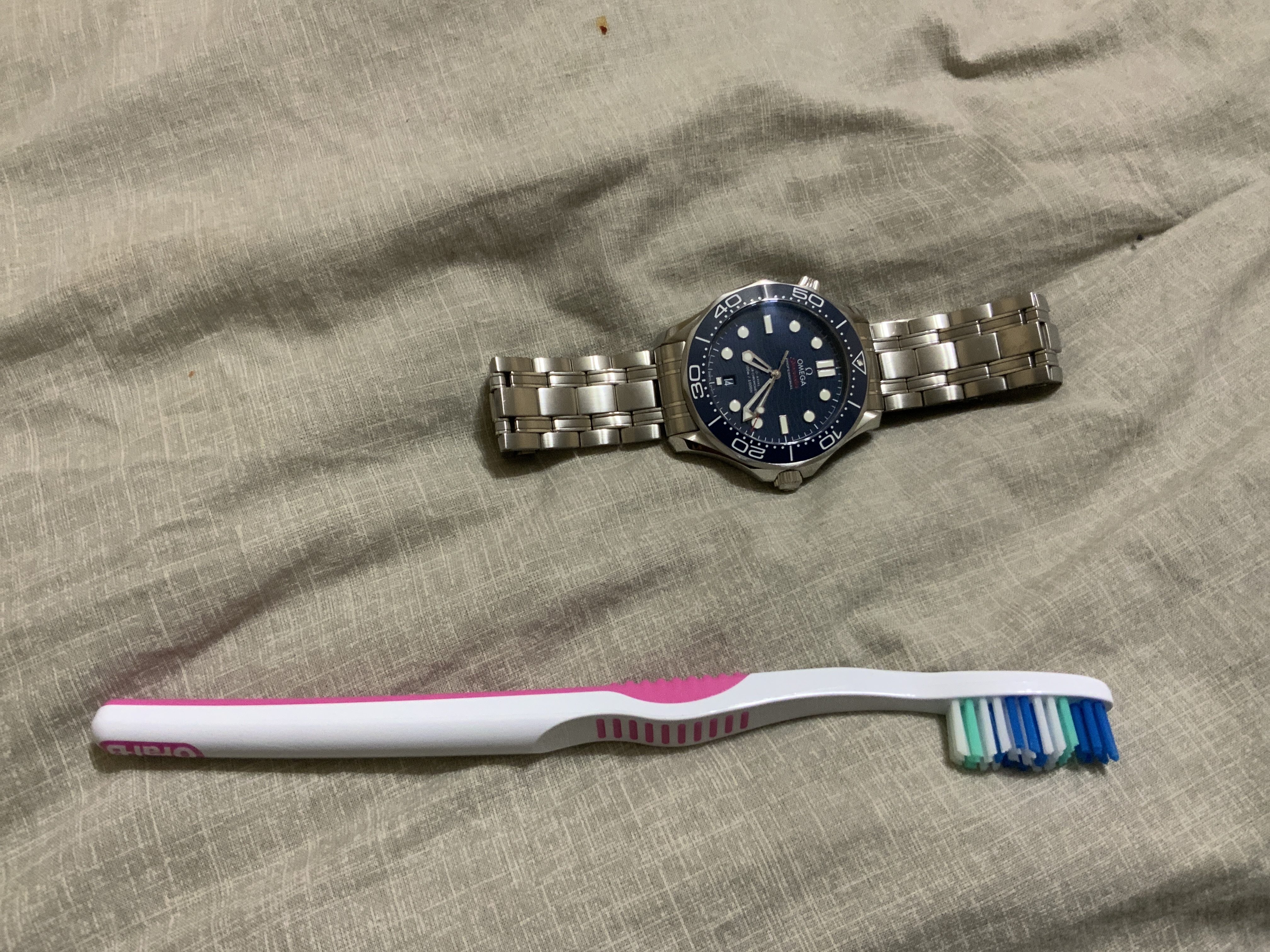

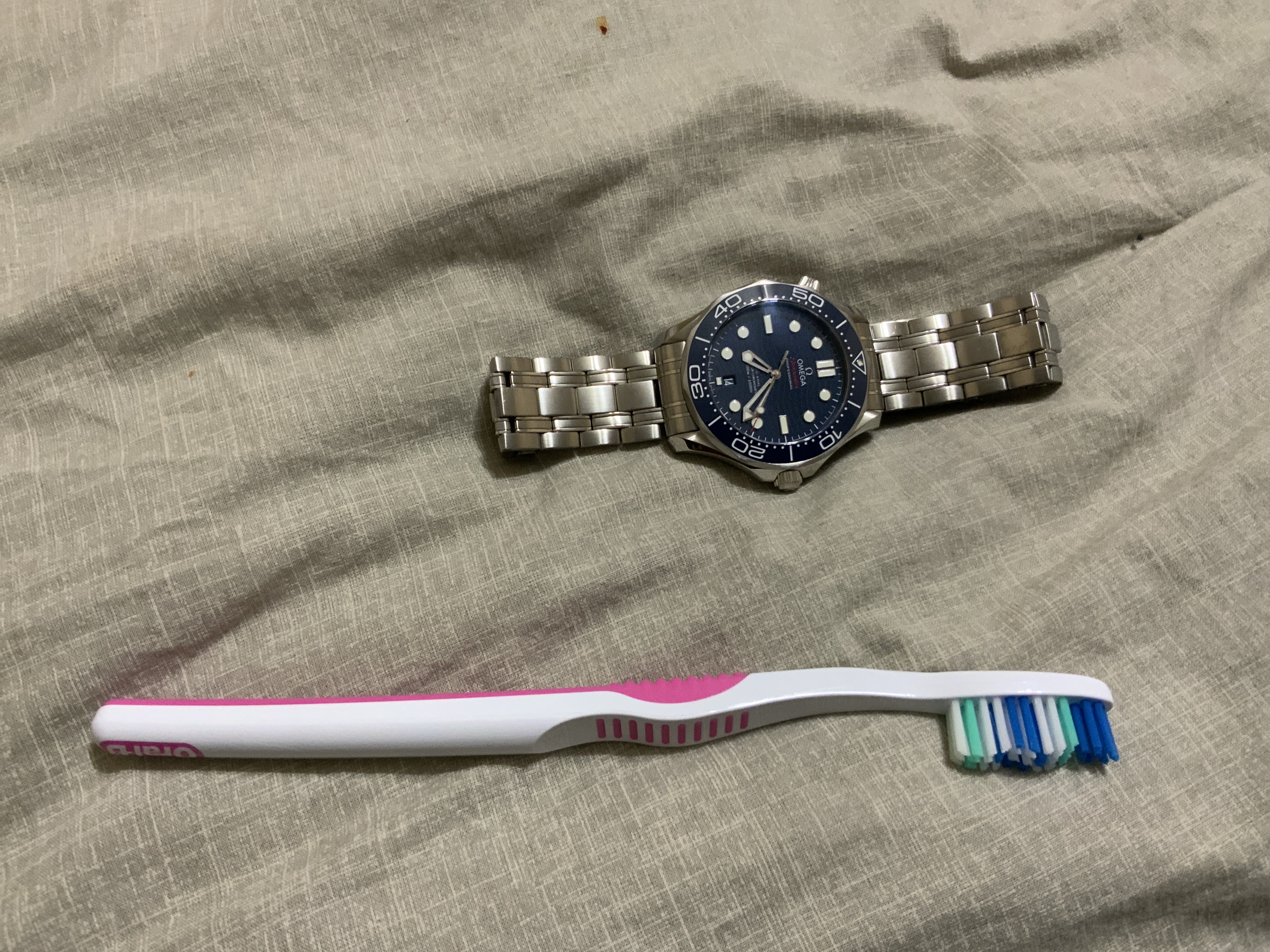

This question might be dumb but if I use this brush should I be worried about the chrome accents getting scratched? I try to lightly scrub but not hard enough to scratch anything, should I be worried? The threads are soft but still I tried following the instructions from the omega site, but anything softer for a brush and I’m in the make up territory and i don’t know if those are meant for cleaning... Thanks!

I don't think there is any chrome on that watch. What are you referring to?
I think he means the polished areas.

Extra soft toothbrush and a light touch works well. Never had a problem when I cleaned my bracelets.

You would be better using a shaving brush, or a quality 1" paint brush.
These have tapered bristles to get into joins and seams and much softer than a hard toothbrush with flat ended bristles.

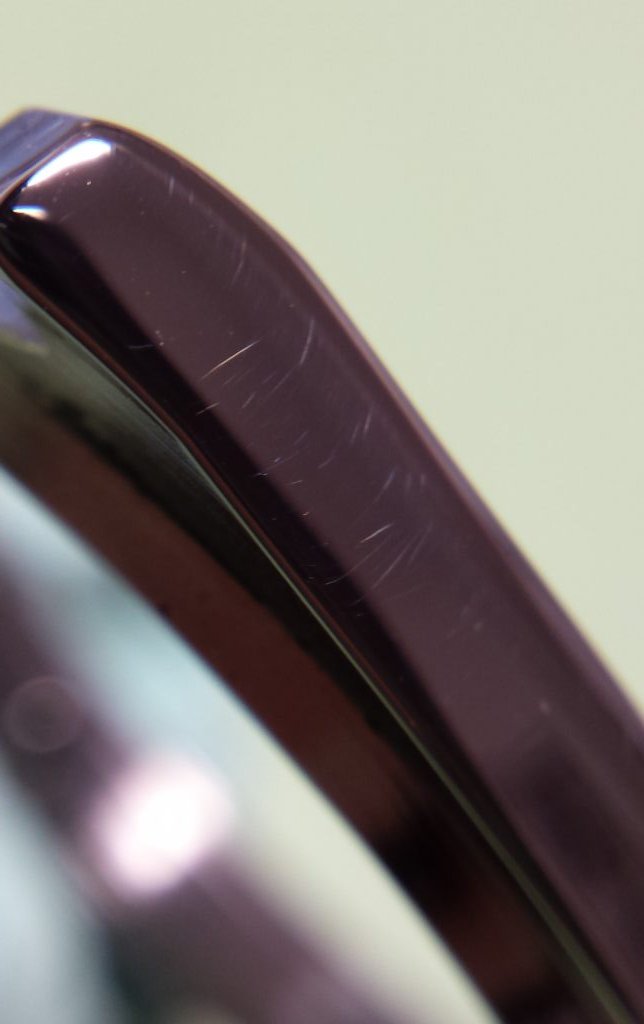

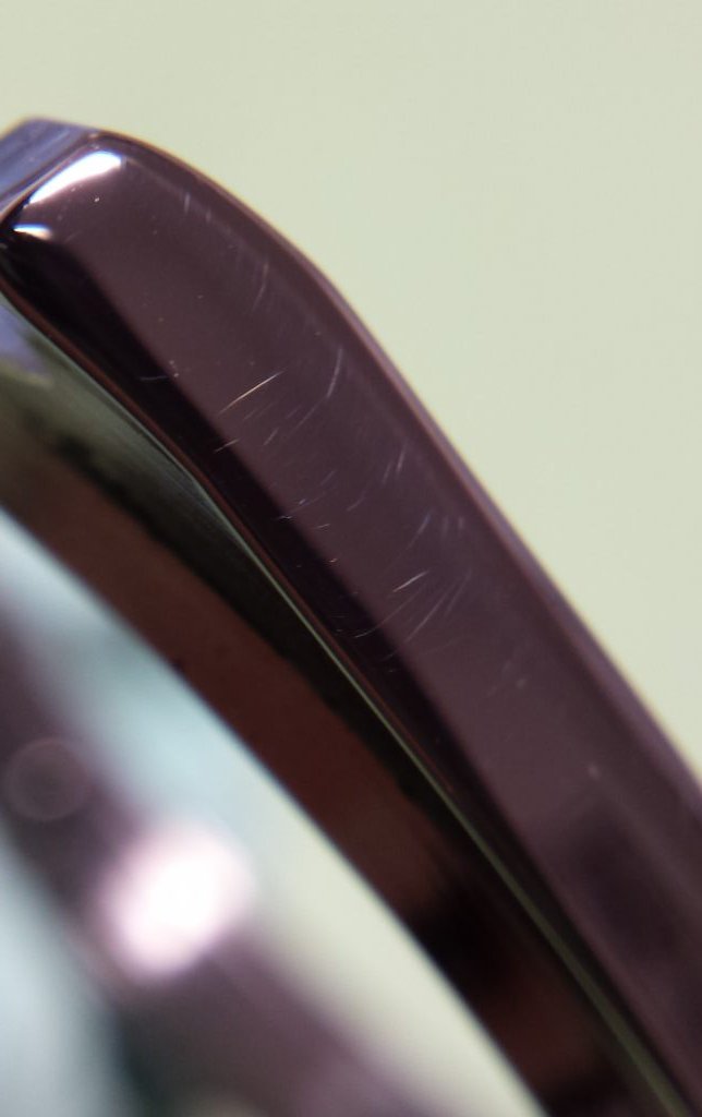

Believe or not a soft toothbrush can scratch a stainless steel case, of course, you're going to need a 10X loupe to notice. I found this site on the internet which explains the risks of using a toothbrush and also recommends what techniques should be used to clean the case and bracelet. Yes, one is steam cleaning after you remove the movement... there's a thread about steam cleaning, and, if you don't have the ability to steam clean or have an ultrasonic cleaner, the recommendation is to use a microfiber cloth lightly dipped in an ammonia based cleaner.

But we are obsessive here at Adjusting Vintage Watches, whether we’re adjusting to positions or polishing a case, so what does the case side look like when magnified?
Here’s the case photographed at a raking angle under the LED. The light micro-scratches are easy to see.
A toothbrush will scrape off the gunk but leave small scratches behind, and removing those scratches will take some equipment and skill.
