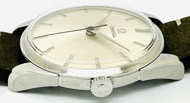

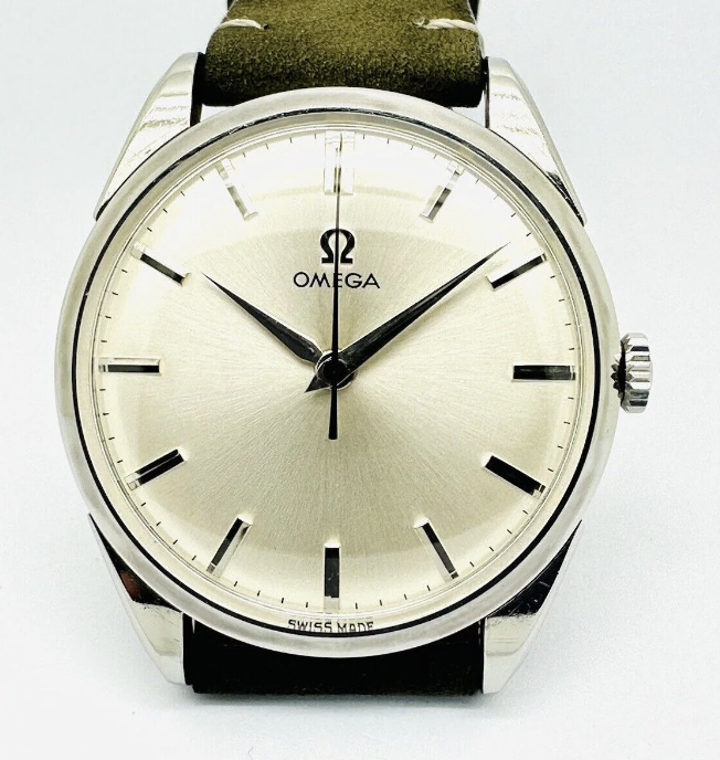

Hey folks,
Considering buying this Omega from a local dealer.
Apparently all parts are original and it has not refurbished/restored. Watch has also been recently serviced and apparently runs well. It looks to be in very good condition so I feel a little suspicious and just wanted to check with someone with more experience and knowledge than me to see if this is an okay deal/watch. Asking price is around 1200 USD.
Thanks!
Aleks

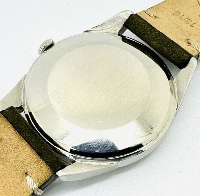

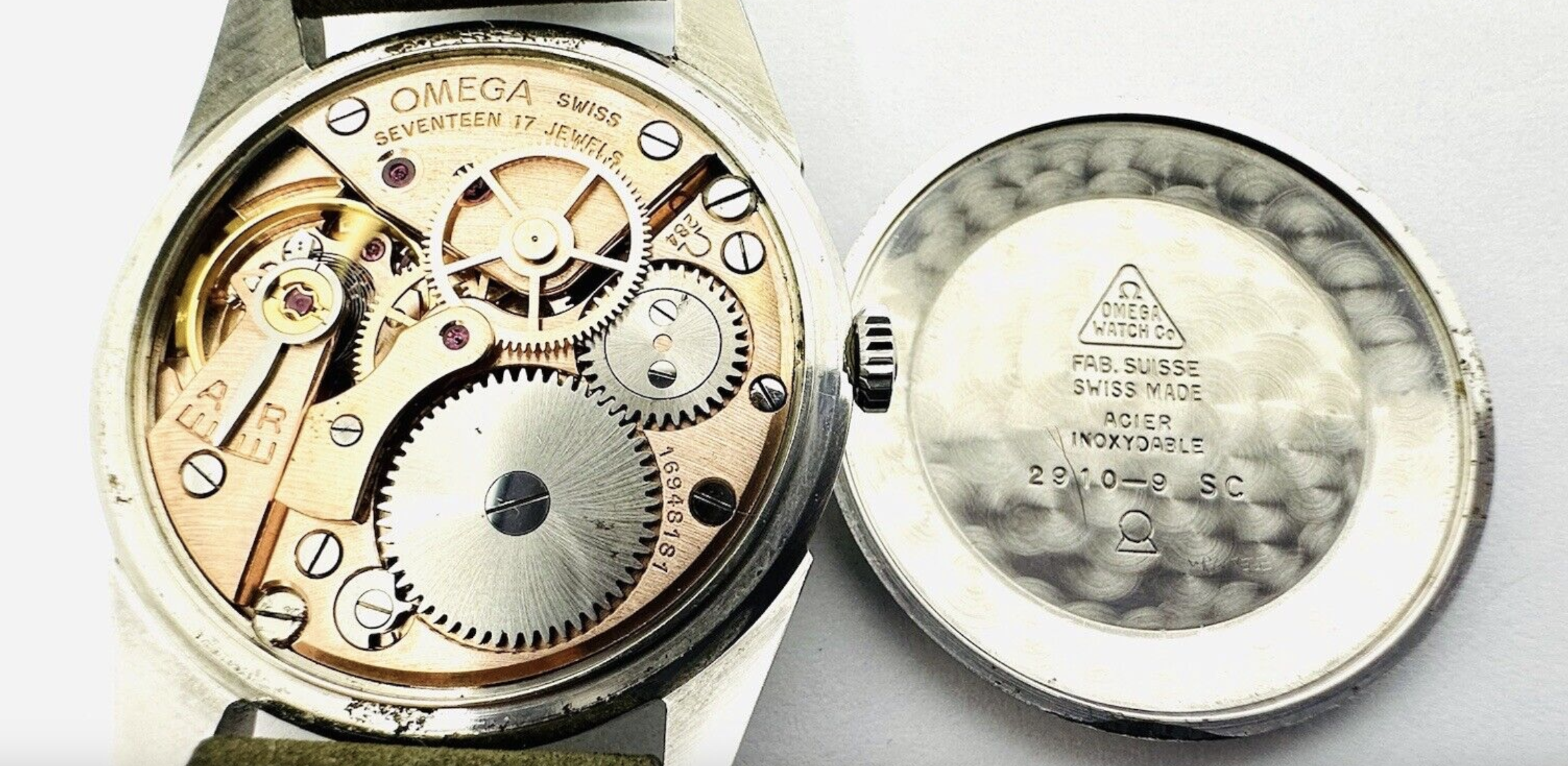

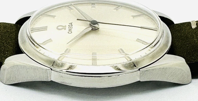

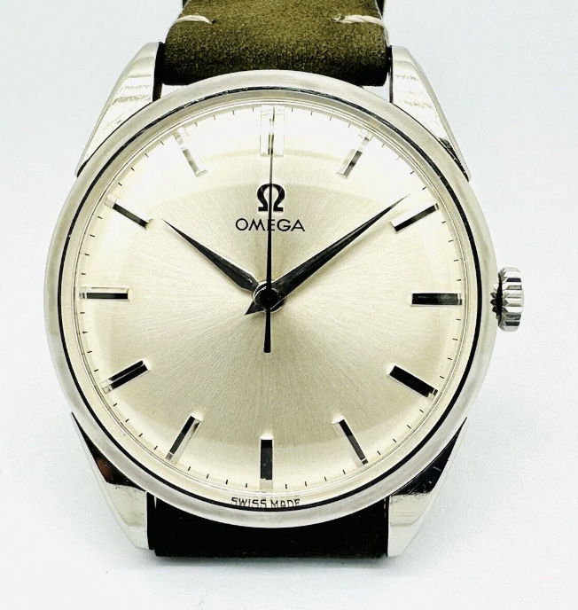

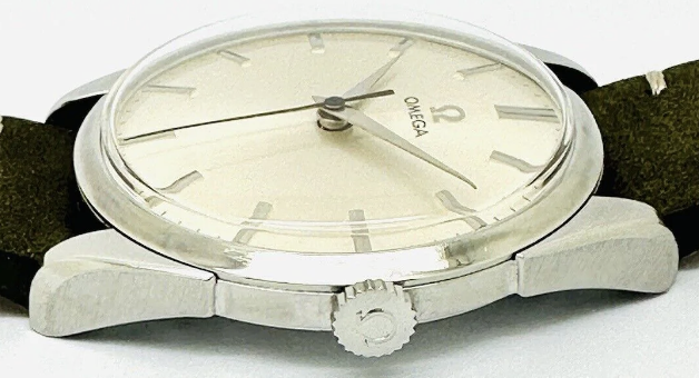

Mismatched hands, one alpha and one dauphin, I'd pass on this issue without looking any further.
All parts are clearly not original.
And there appears to have been an attempt to refresh the case.
9
Thank you! Will definitely pass in that case.
3,595
13,551
Also, this is a service dial at best. Sunburst finish in a mid-50s reference isn’t a legit combination.
Same result, of course: A pass it is.
