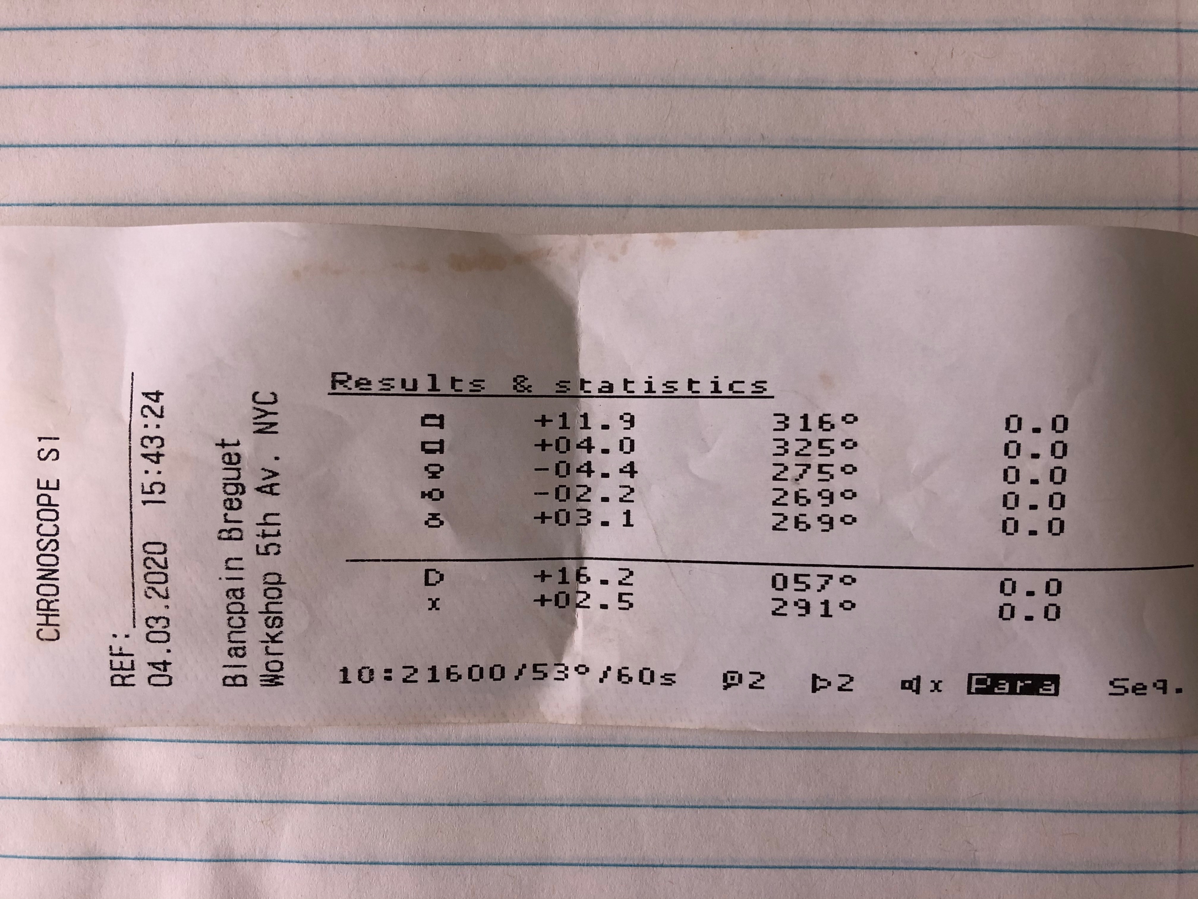

So, first of all, attached is the result of a fully wound watch I had the BlancPain boutique run a couple of months ago before the lockdown. Is there a reason why you would need to know all of the positions rather just a couple? Let's say if it's already -7 sec/day face up when it's around 40% reserve does it matter what the other position shows since face up is usually one of the faster positions?
Also, isn't the accuracy suppose to stay relatively stable in each position, say, face up, through the entire range of power reserve, say, 80% - 20%? If I'm getting large variances, doesn't that mean I need it to be re-serviced? What I'm really concerned about is the tail end of the reserves. It's losing around 30 seconds towards the last day of reserves. That can't be normal can it?

Face up usually one of the faster positions? Where’d you pick that up? Maybe so with your particular watch, but not with every watch.
