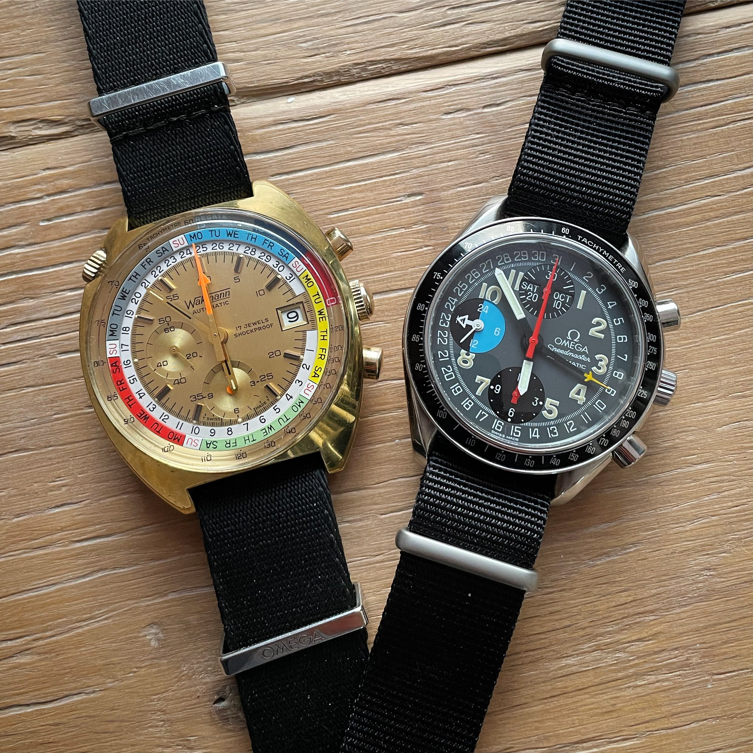

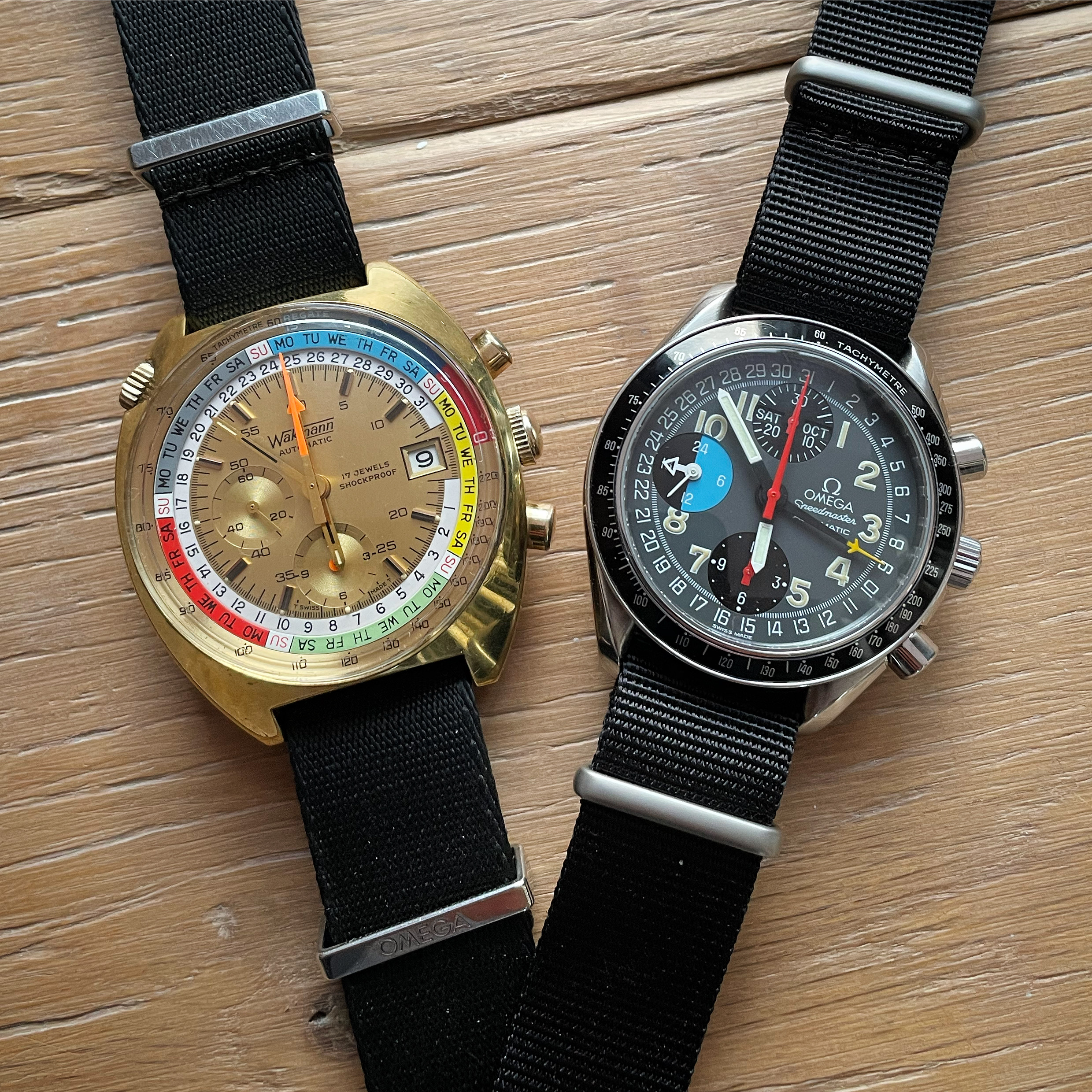

Well it didn’t take me long! Pictured with my MK40, let there be colour!

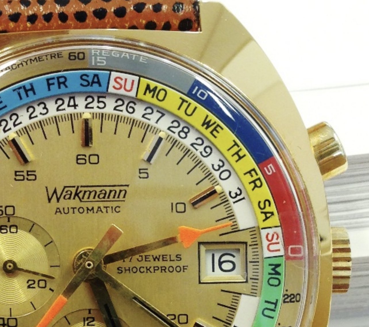

The main function of a regate watch is to time the ten minute start so as to hit the line on the start gun hence the Lemania 1345 minute circles and the flyback seconds hand etc. . I noted in this years Olympics yacht races some competitors were wearing watches with that function albeit quartz no doubt . I cannot for the life of me see how this function works on the Wakmann accurately. Anyone know?

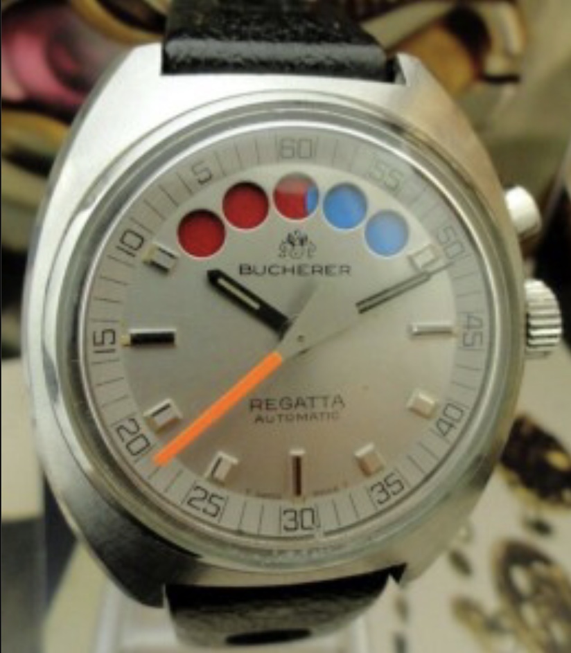

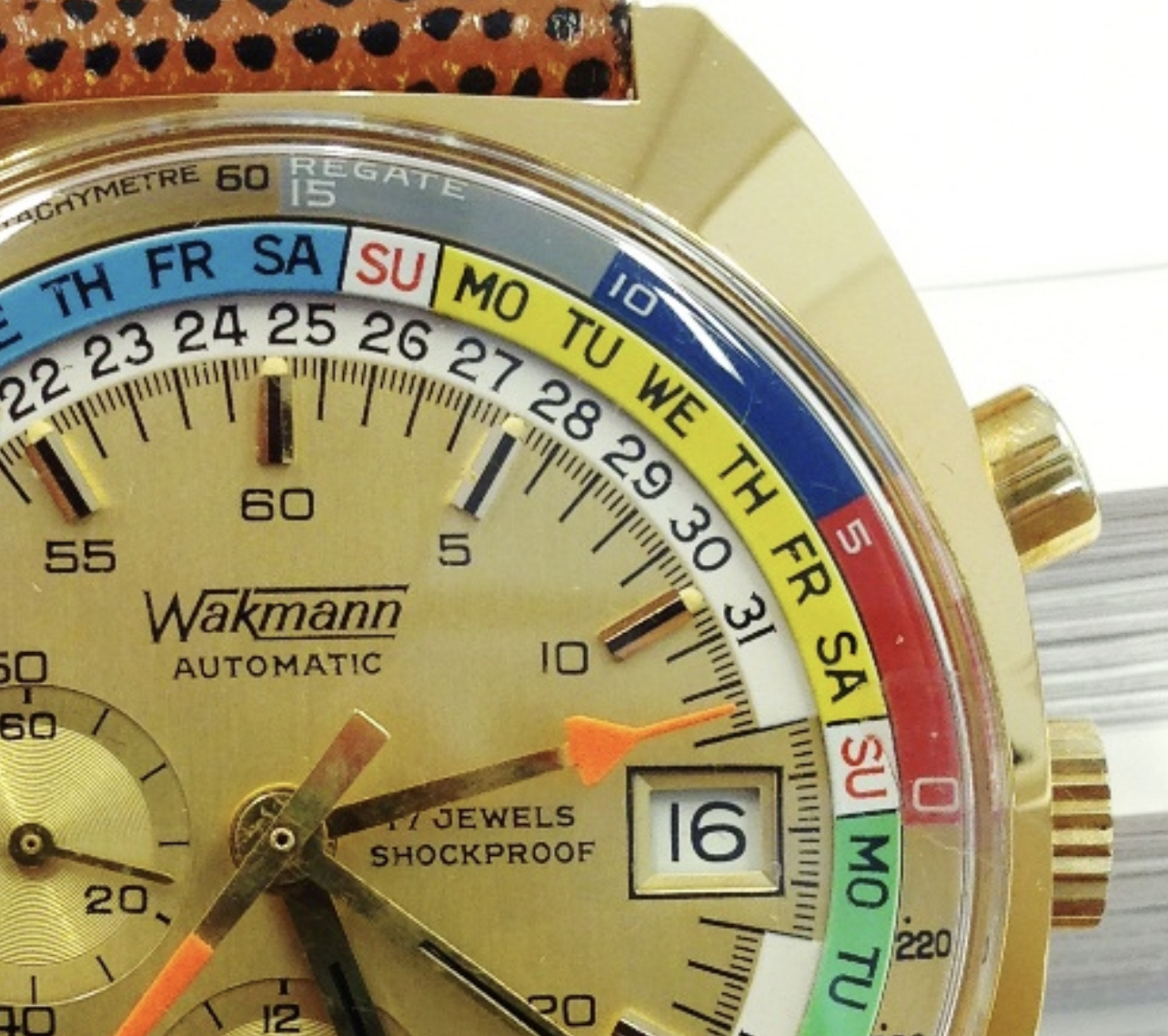

Well, I can’t speak for the nuances of the regatta race etc., but I can say:
This caliber chronograph has a central sweep minute totalizer - the big central hand with orange “airplane” tip - circling the dial once an hour
Starting the chrono, then, would send that minute hand through the regatta colored sections of the inner bezel
For example in the below, there would be ~2.5 minutes left in the 15 minute countdown

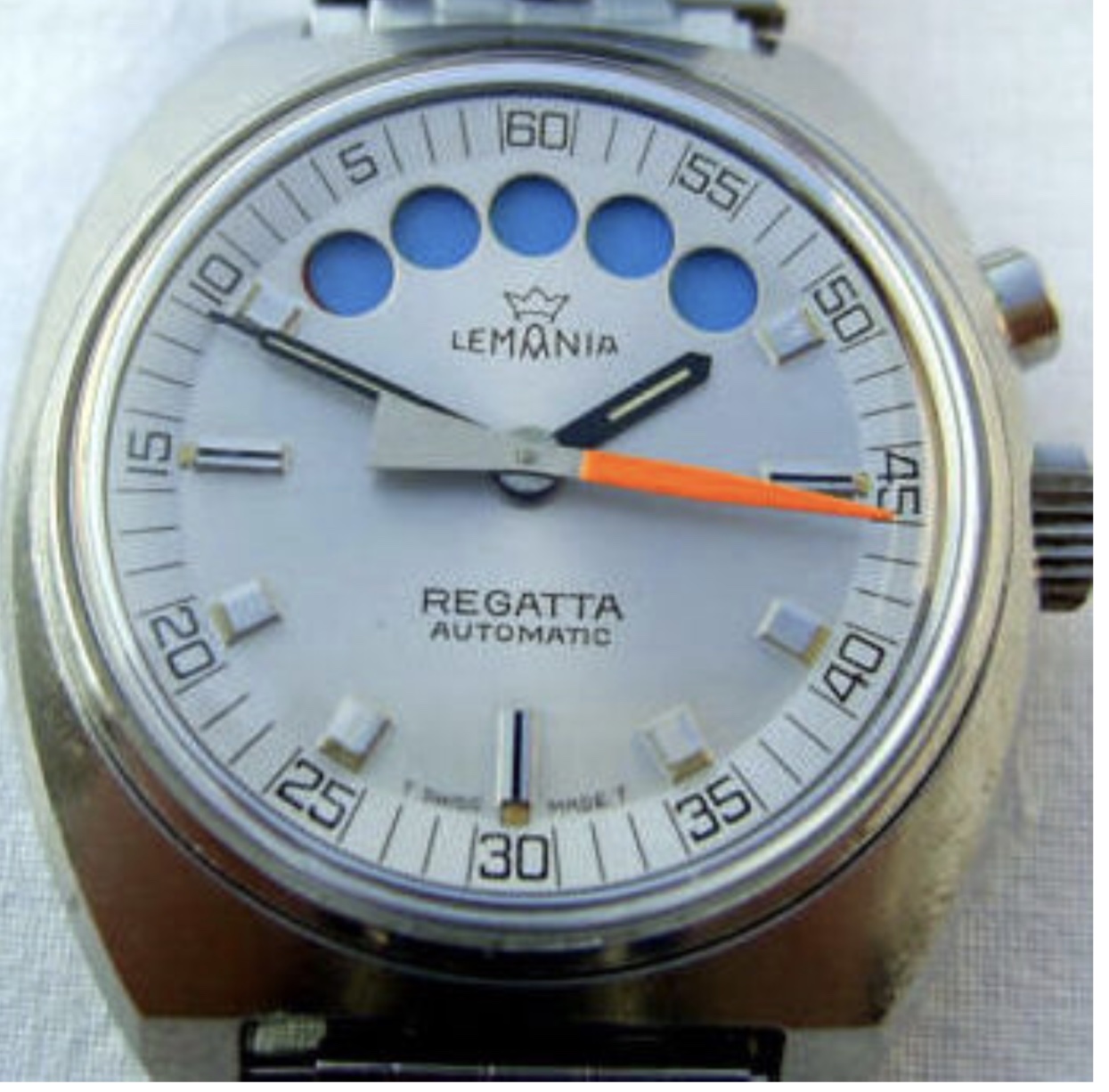

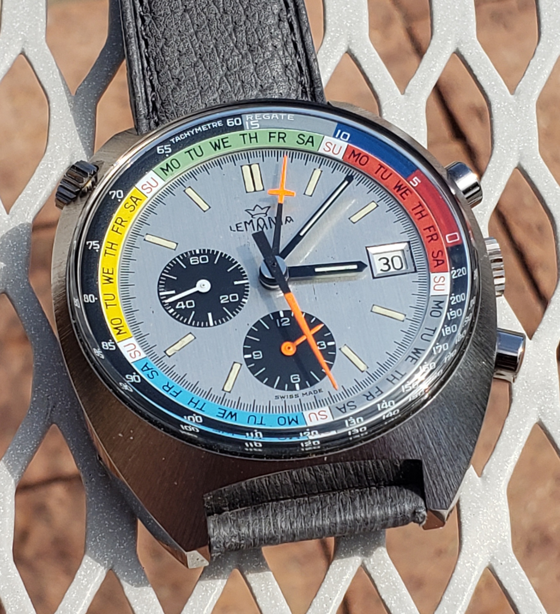

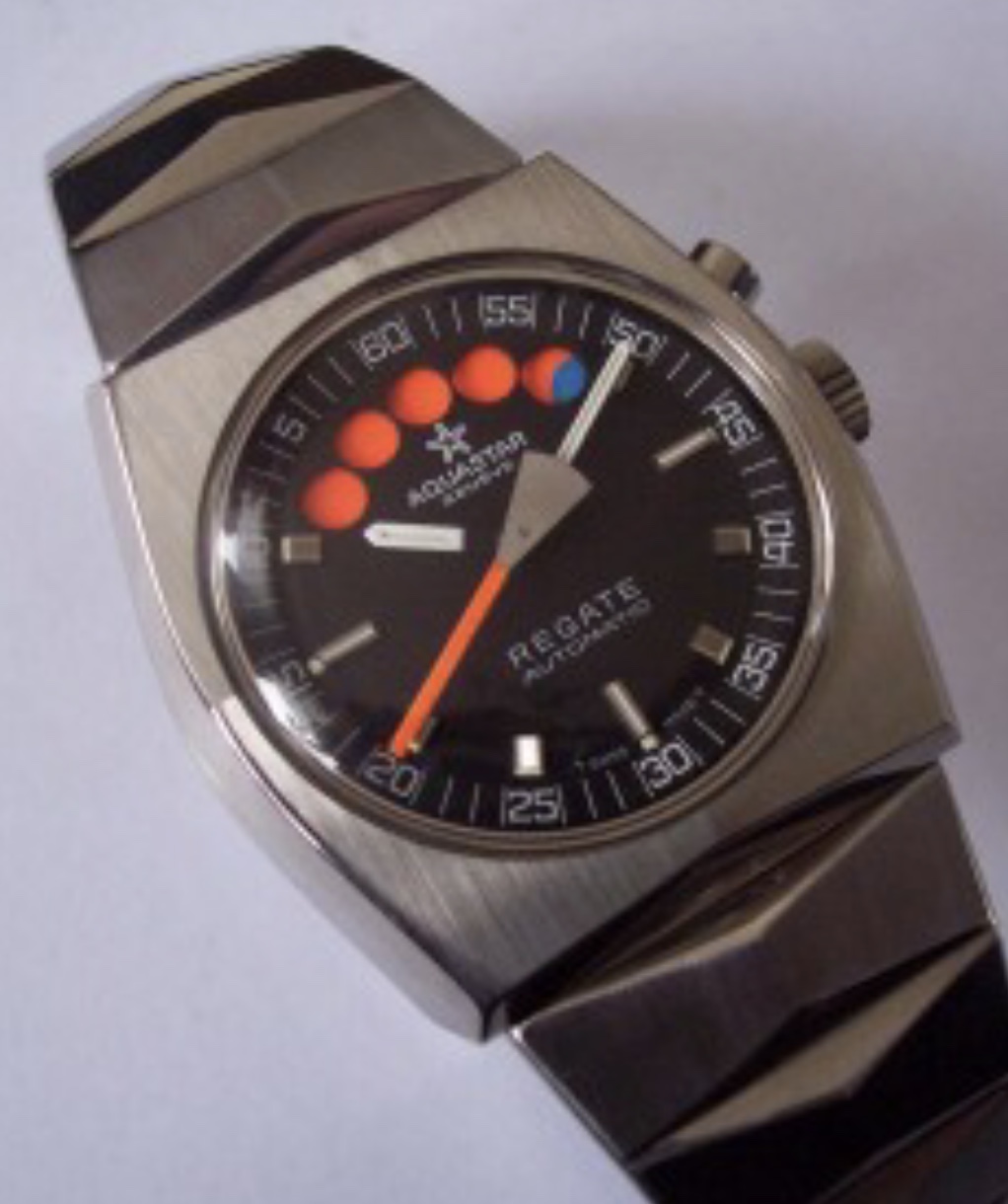

(Anyone have examples of Lemania-branded watches for models otherwise offered by other brands containing Lemania movements?)”

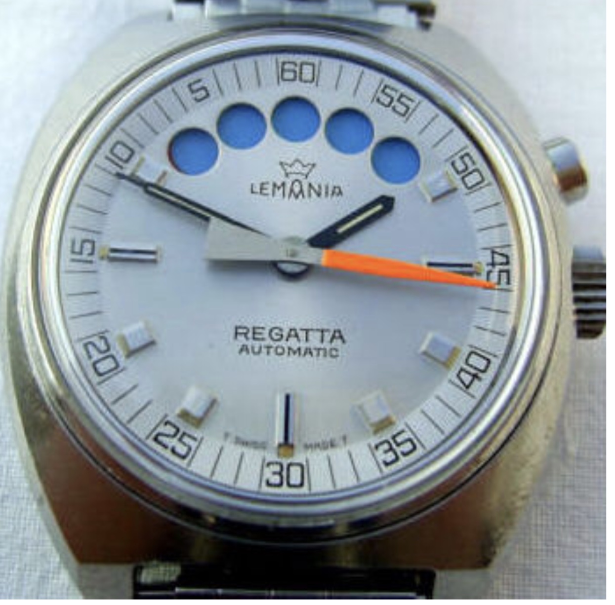

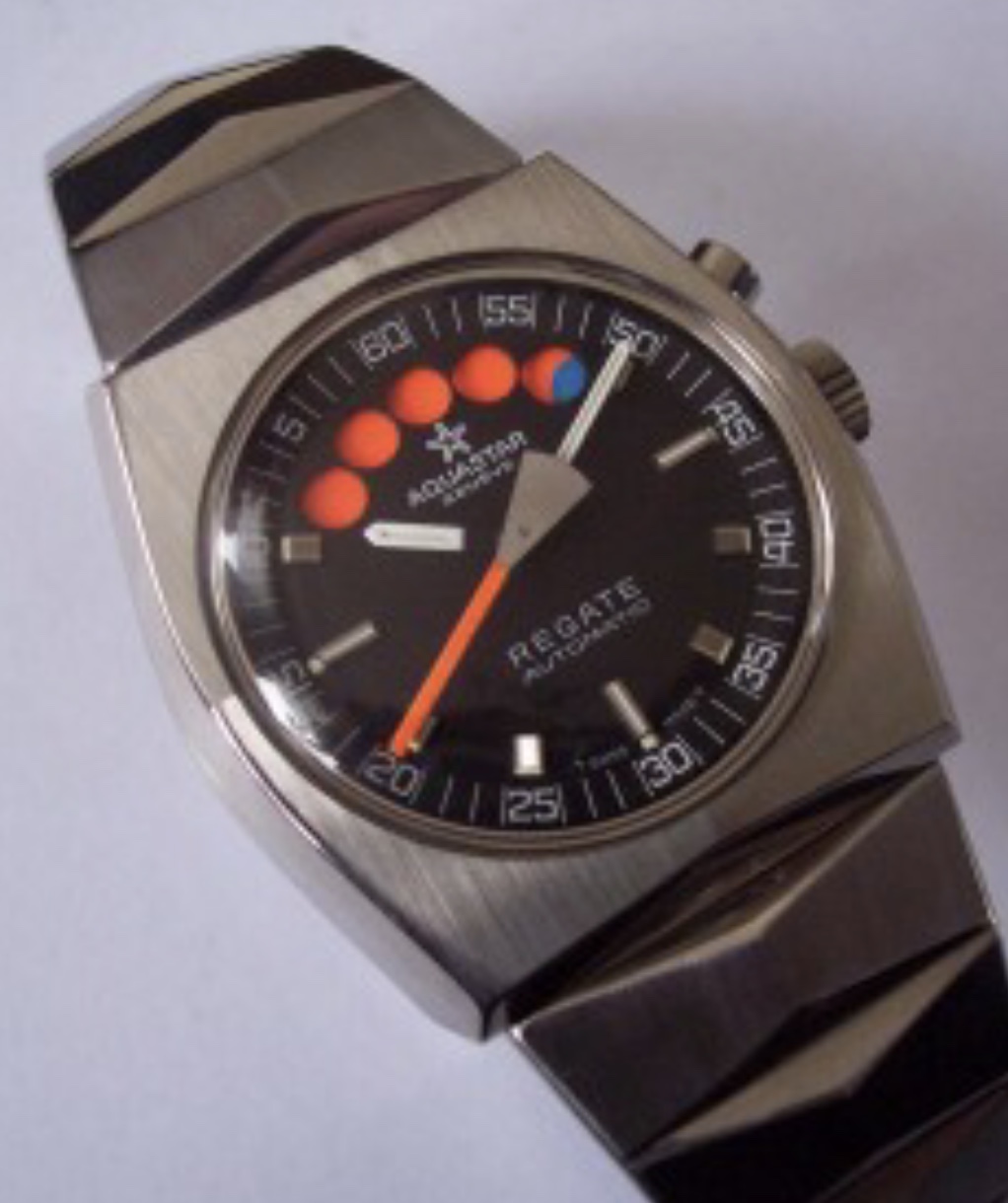

Not sure if I missed an answer to this however the 1345 movement can be found in Lemania Regatta branded watches as well as aquastar and their many distributors such as tissot and Heuer. The 1345 was also used in the Paul Elvstrom regate watch marketed by lemania . Examples below.
As I understand the chrono movement was plonked on the 1340 for aquastar initially

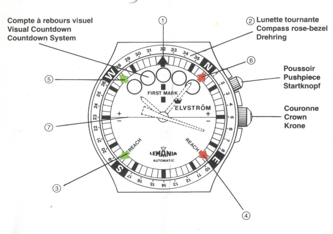

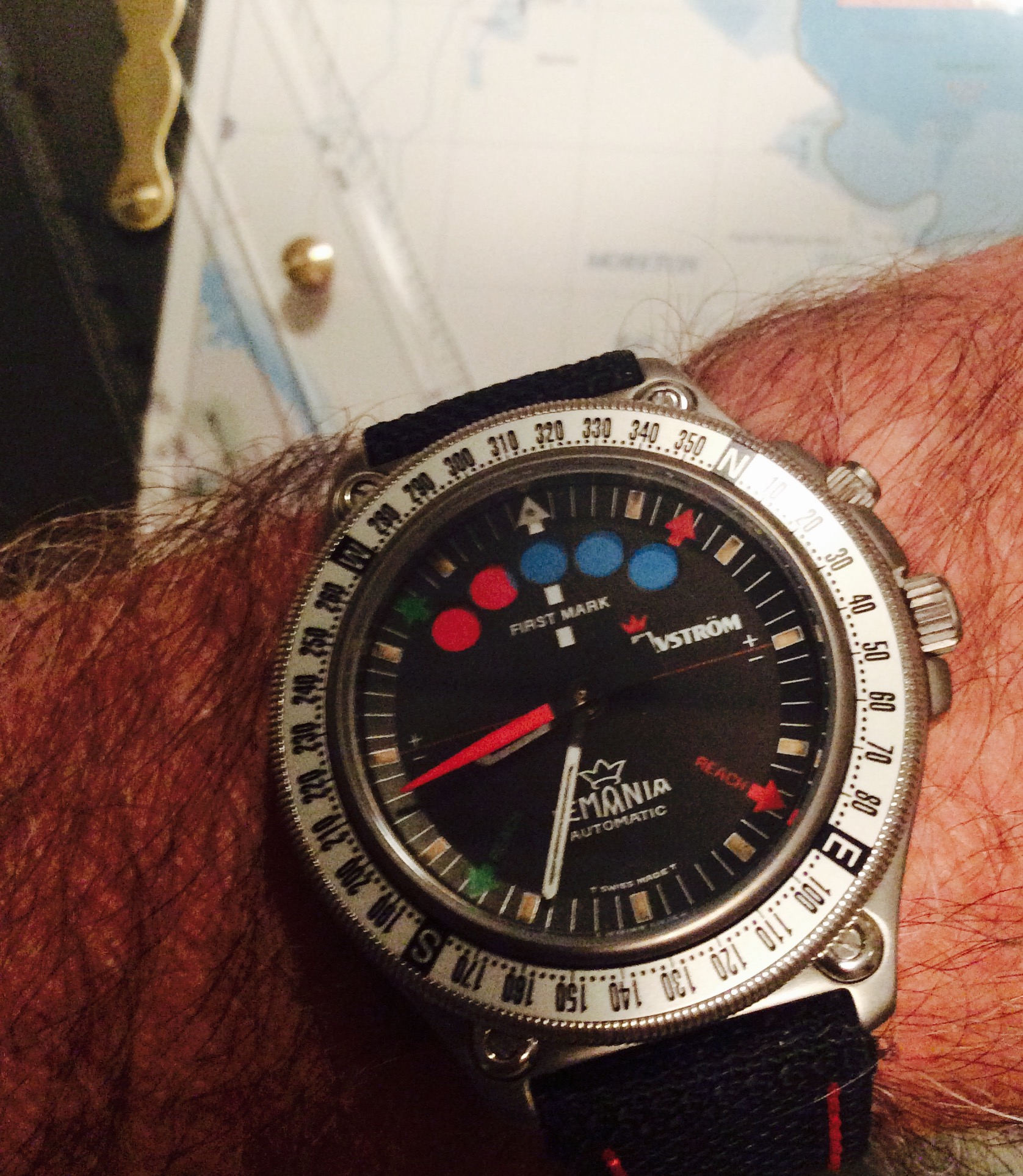

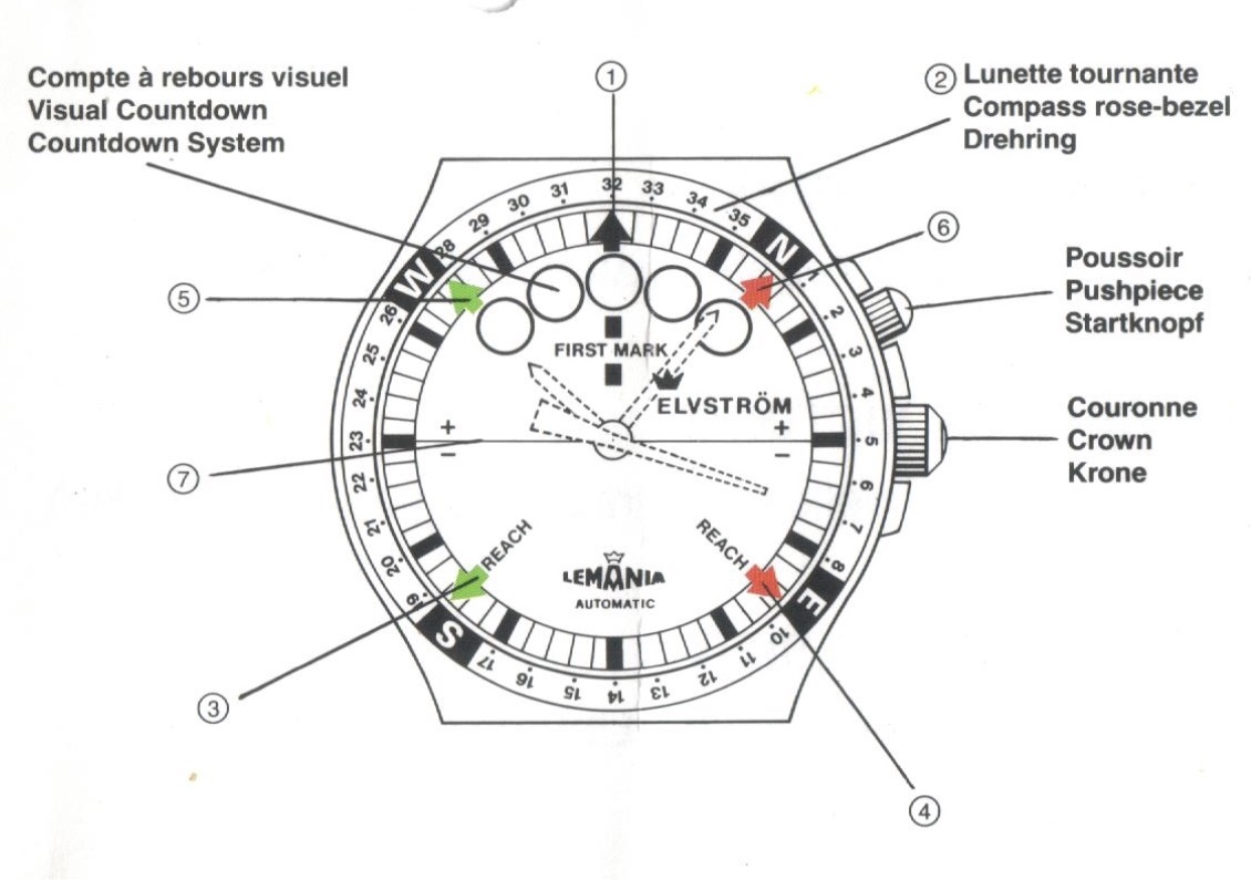

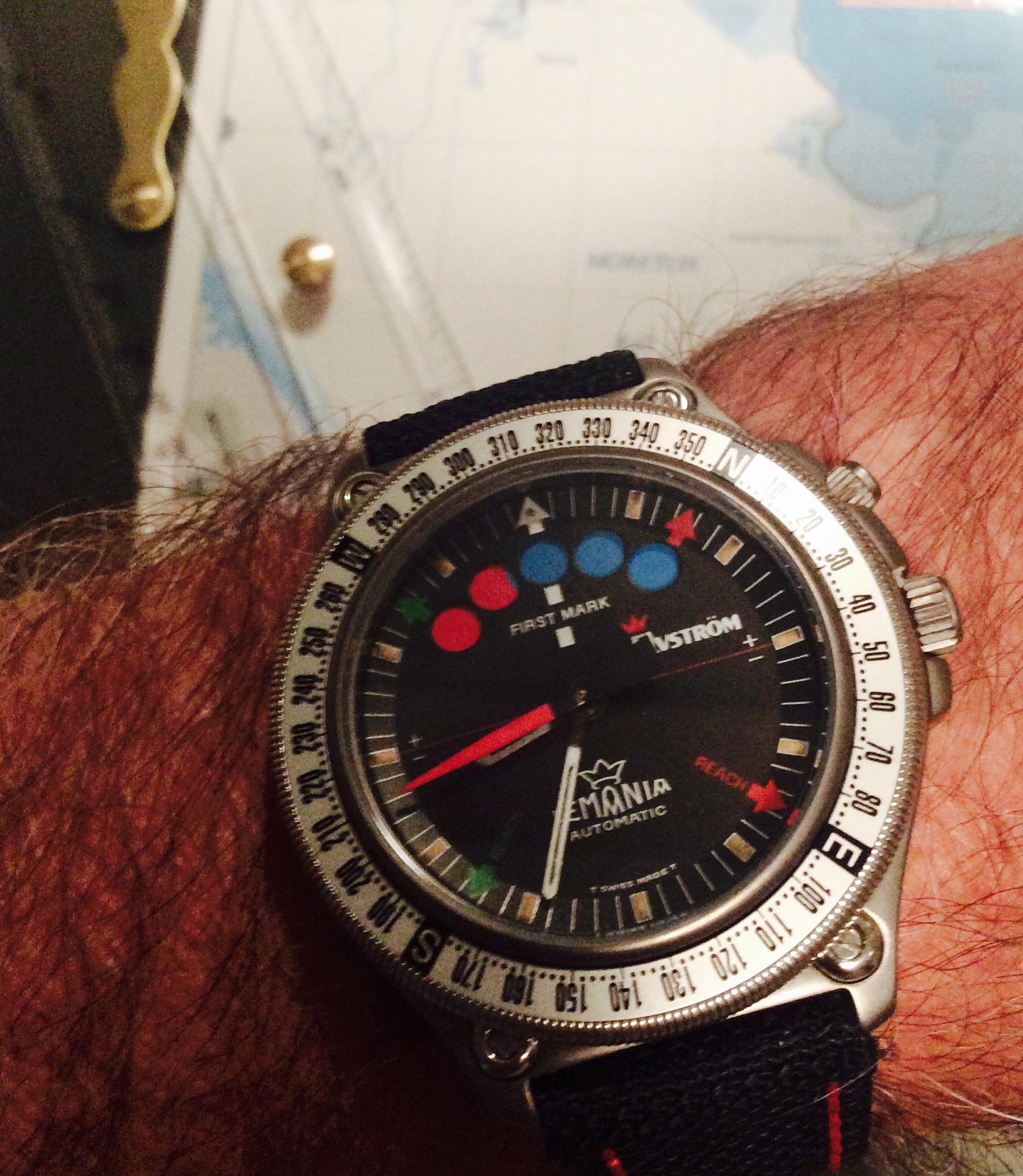

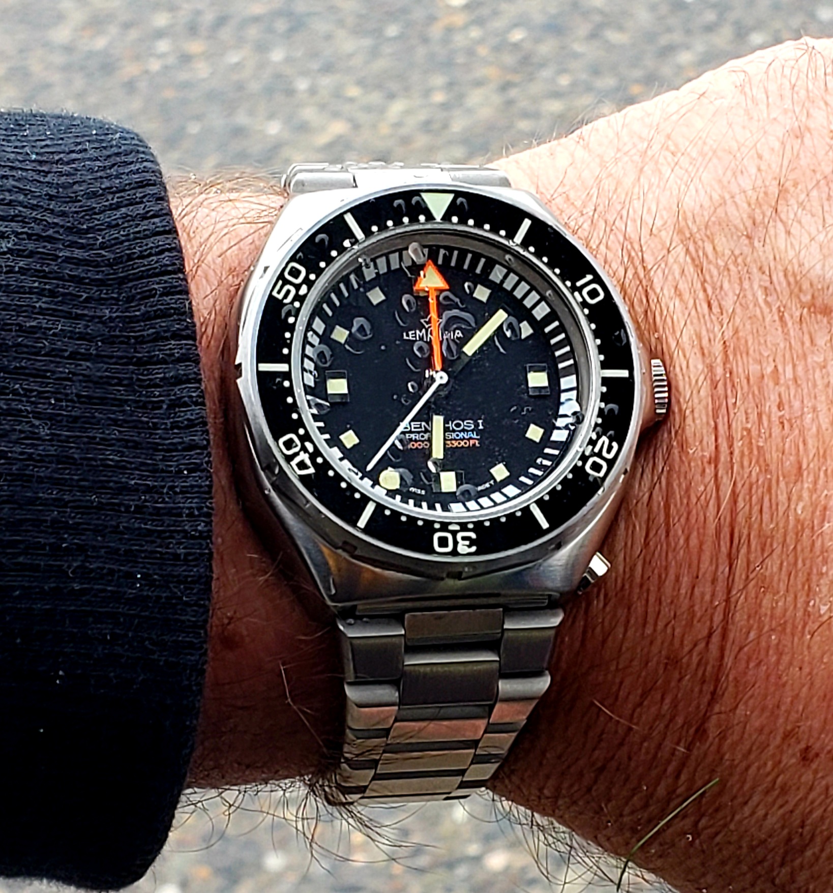

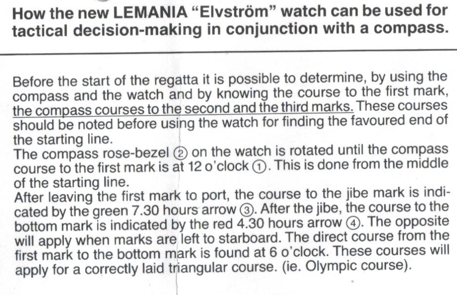

Regarding the last watch pictured, do you happen to be familiar with the arrow markings and nomenclature regarding “first mark” and “reach” etc?
110
207

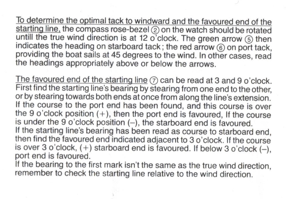

Absolutely. That is my ugly arm . The dial was designed by Paul Elvstrom a distinguished Sailor and Olympian. It is designed for use tactically on Olympic courses and also for establishing the the bearing a sailboat would take at 45 degrees to the mark. Forty five degrees being the average closest a sailboat could sail into the wind in those days . For me I would preplan a compass bearing from the centre of the start line to the first mark and move the bezel so the bearing is at 12 and repeat at each mark to the next. That way I knew the optimal bearing without seeing the mark . Especially useful solo racing before electronics took over. Below is an extract from the manual.
As an aside as I understand not that long after these watches were produced Elvstrom signed a contract with Rolex and Lemania’s owners instructed all unsold to be withdrawn and spare parts returned. A Stainless steel and later titanium cases were produced . Mine is titanium.

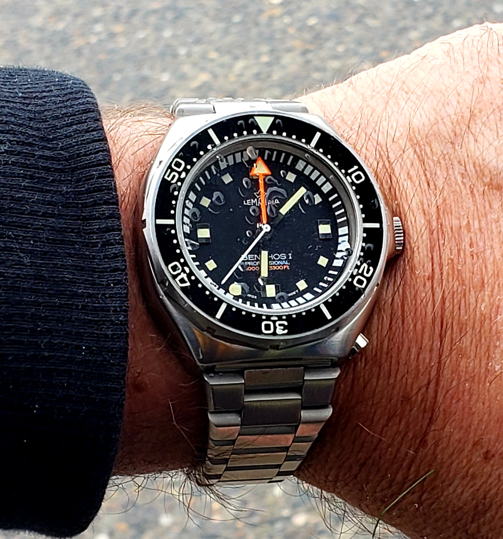

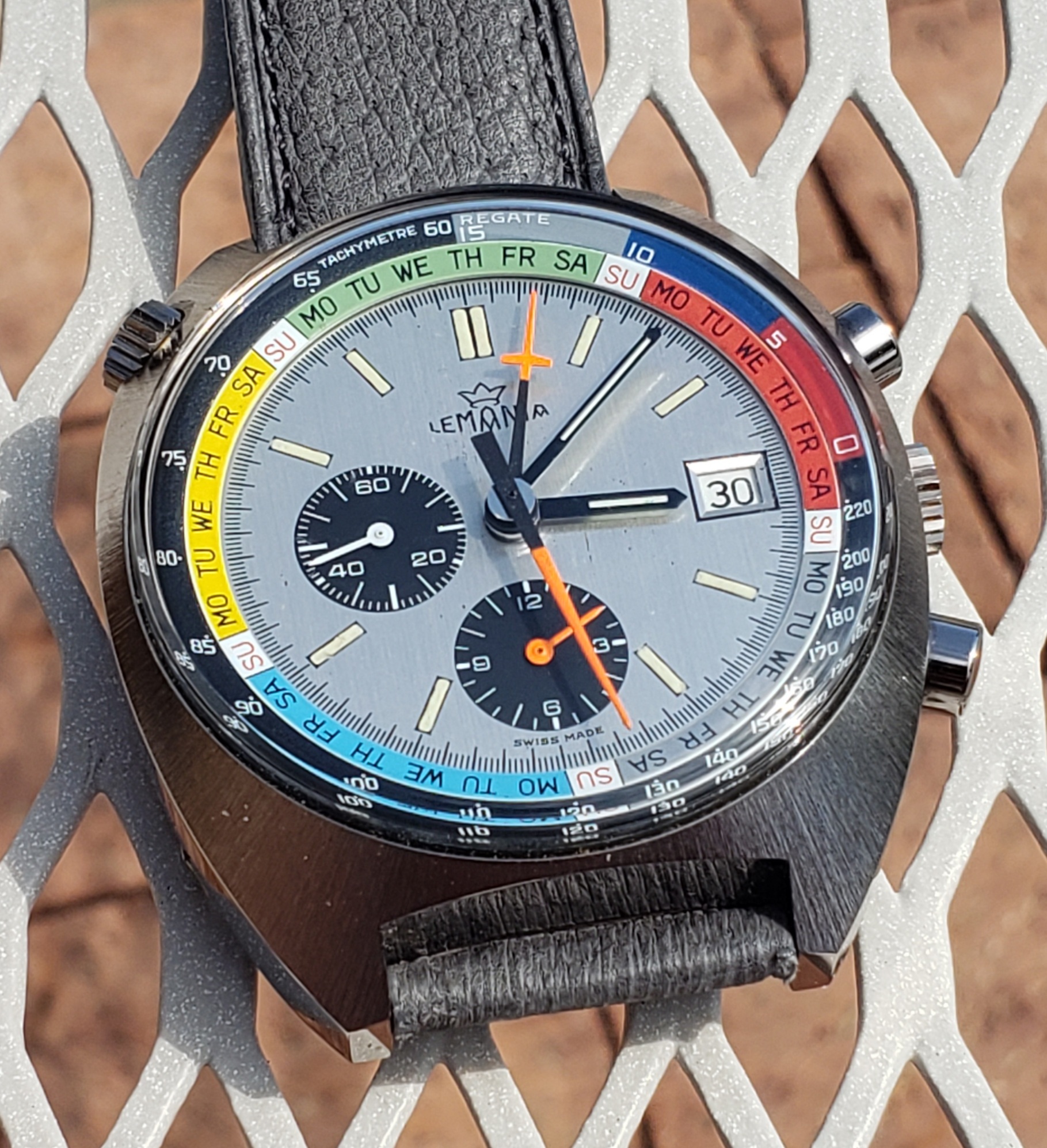

I have an SS-color 😀)) Lemania version of this watch and have never been able to find any information on it. I randomly found out about the Wakmann connection from a social media watch group and that led me here!
On other Lemania-branded watches: I have a Lemania Benthos (more commonly seen branded as Aquastar).
