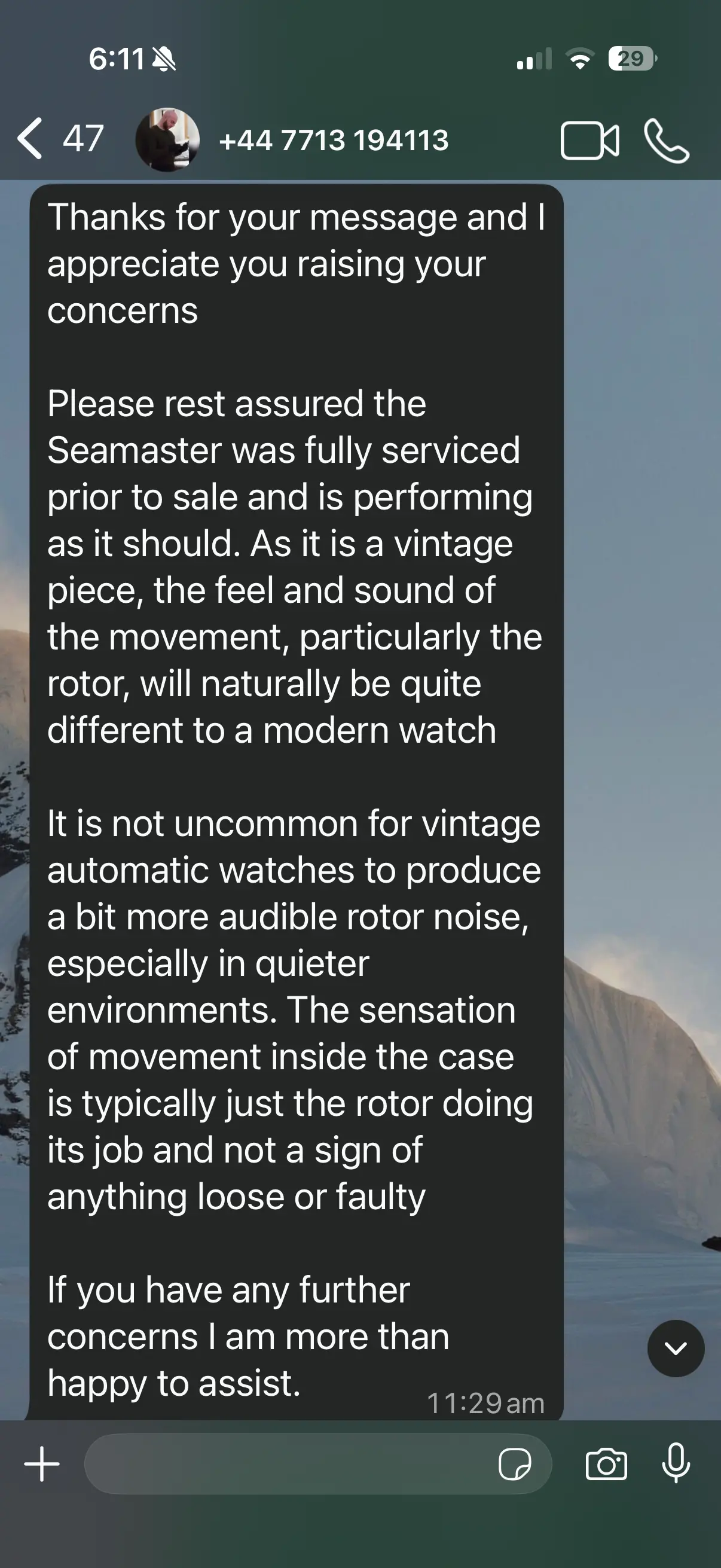

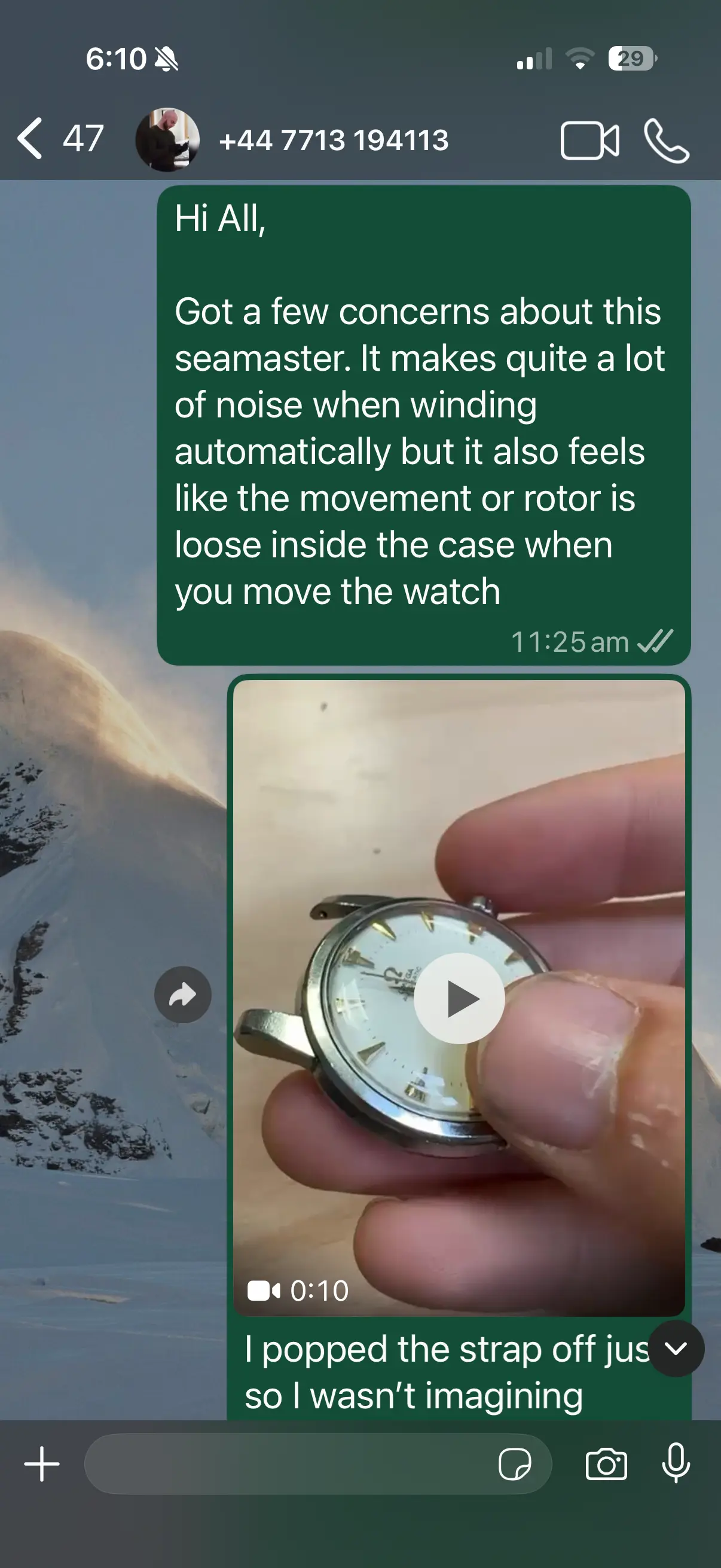

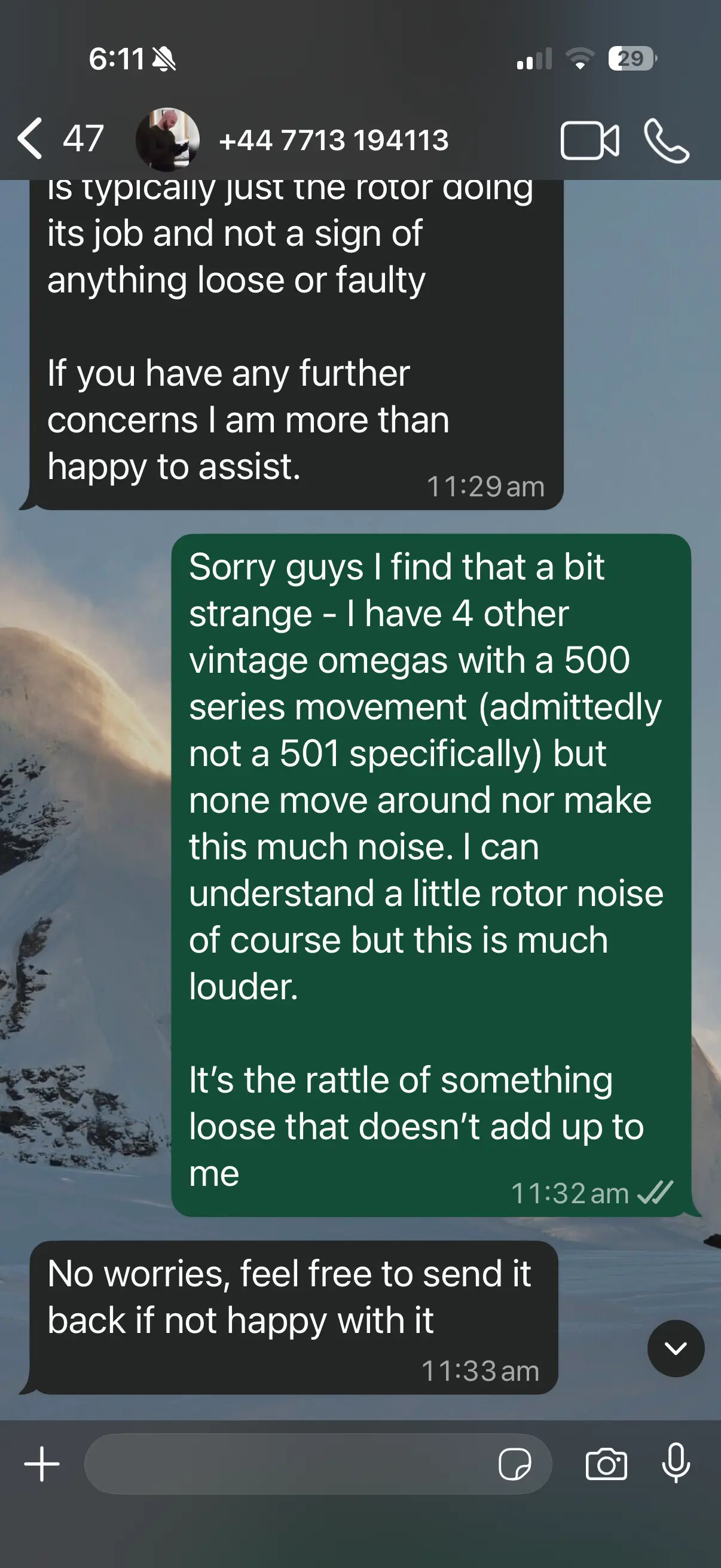

Yes really was disappointing. As the saying goes, “buy the seller”. When you look at their polished instagram you like to assume they’re a 100% trustworthy operation.
Here’s a snippet of how the initial conversation went down.
Once again, full disclosure they did refund me my money. So they’re not criminals. I just don’t like how they warped the truth.
This is between me and their business WhatsApp number.
As mentioned I took it to my friend who’s a watchmaker who confirmed the watch was in fact in need of a good lubrication at a minimum if not a full service and the rotor was loose (I may be butchering that, rotor post, rotor bearing? I can’t remember the technical term for it he said as my knowledge is limited in watchmaking) and that was what was causing the knocking sound.

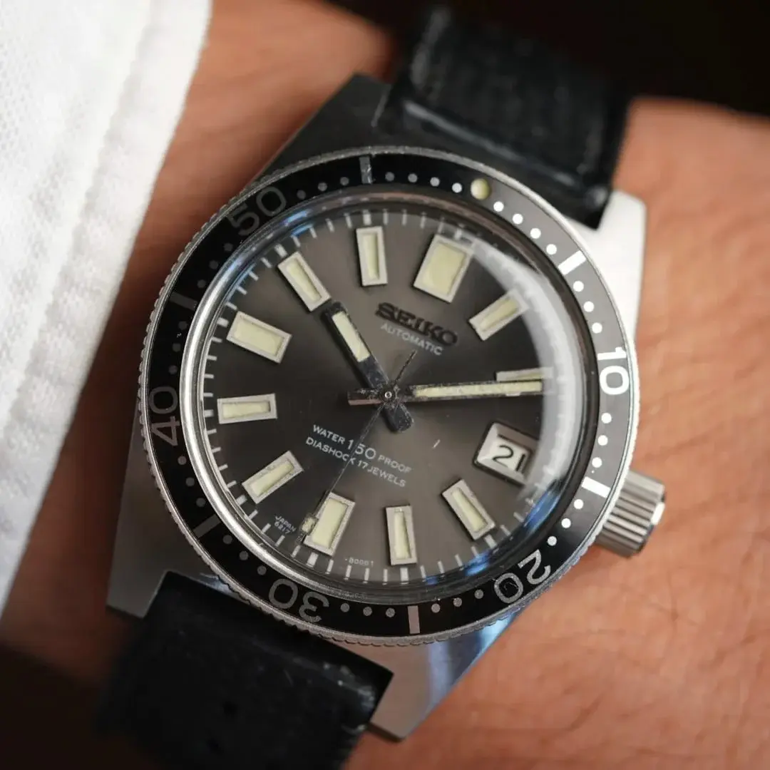

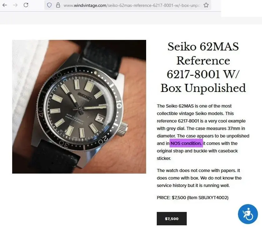

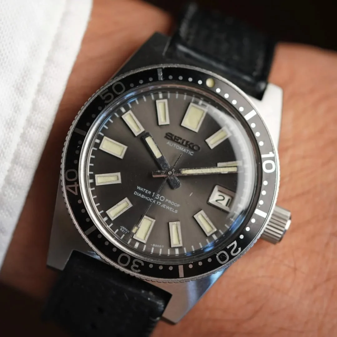

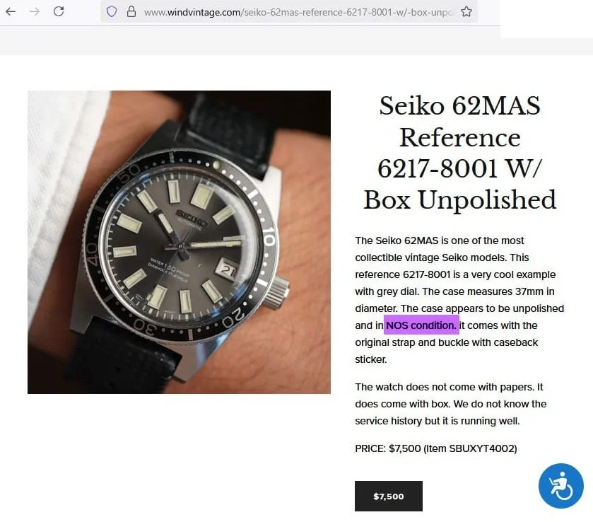

That being said, I just had a great experience at Wind Vintage.. they had a watch I was looking for in a condition I found very difficult to find anywhere else. Very easy to deal and transparent.
Even Wind Vintage has his controversial listings. I remember this supposedly "NOS" 62MAS, from a few months ago on Reddit.
762
916
Fair enough but wow that 62MAS is in stunning condition. Amazing watch and somewhat rare.
There are great dealers out there but with vintage it’s just hard, I don’t think you can ever just blindly trust someone.. which is a big part of why I like vintage. It’s hard and takes effort to get right.
524
1,130
Yes, probably the best condition 62MAS I've seen. But, NOS it is not.
I also find the phrase "appears to be unpolished", sneaky if it's supposed to be NOS.
