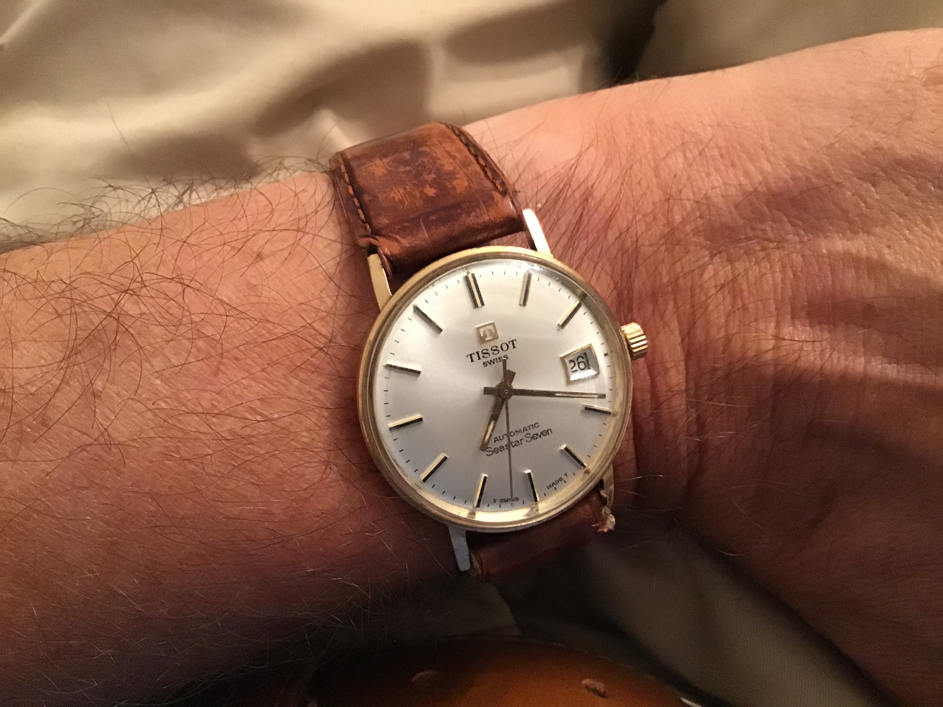

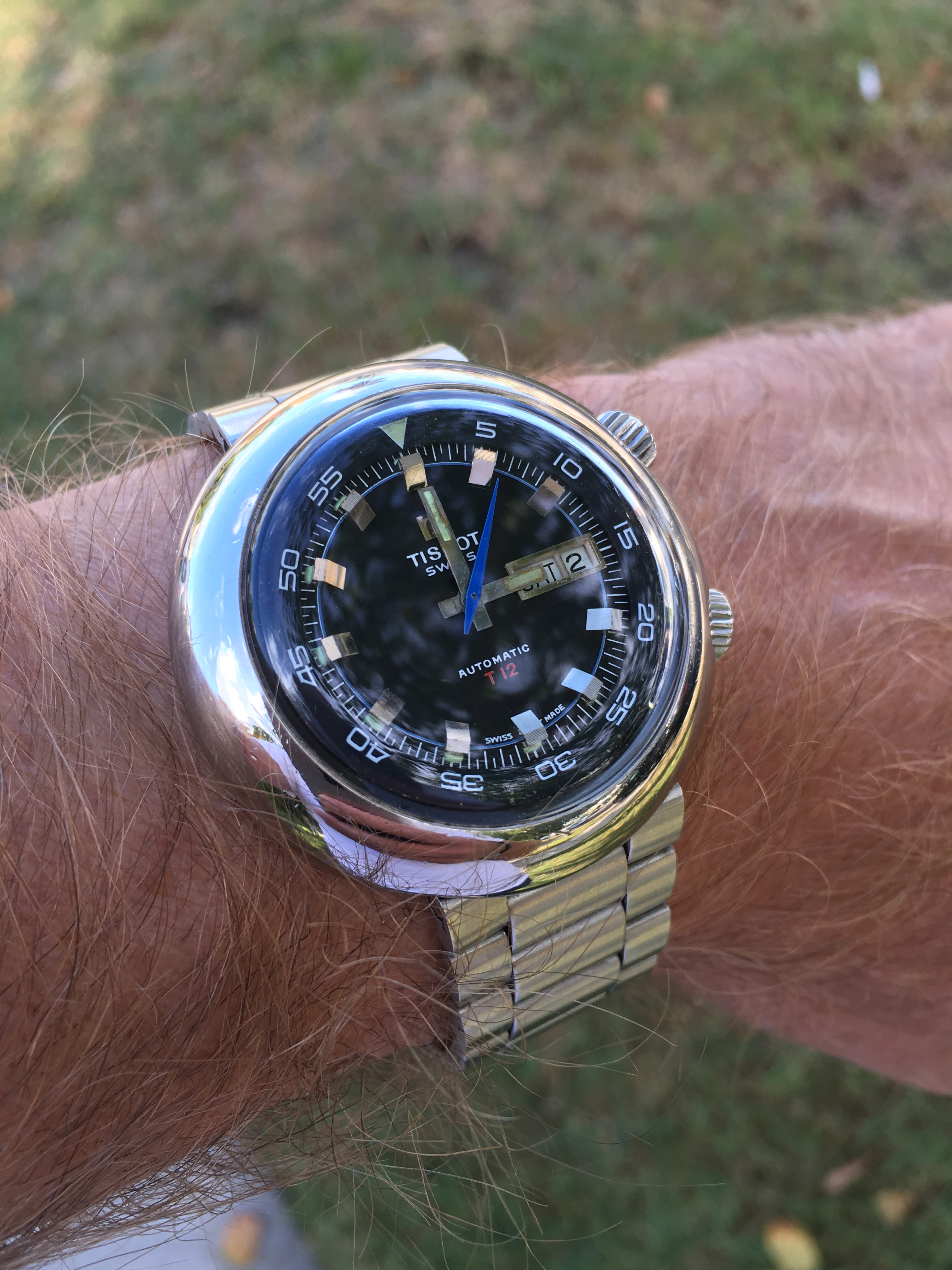

Here’s mine , I just don’t wear it anymore & would happily pass it on to someone else who would . Watches deserve to be worn ,

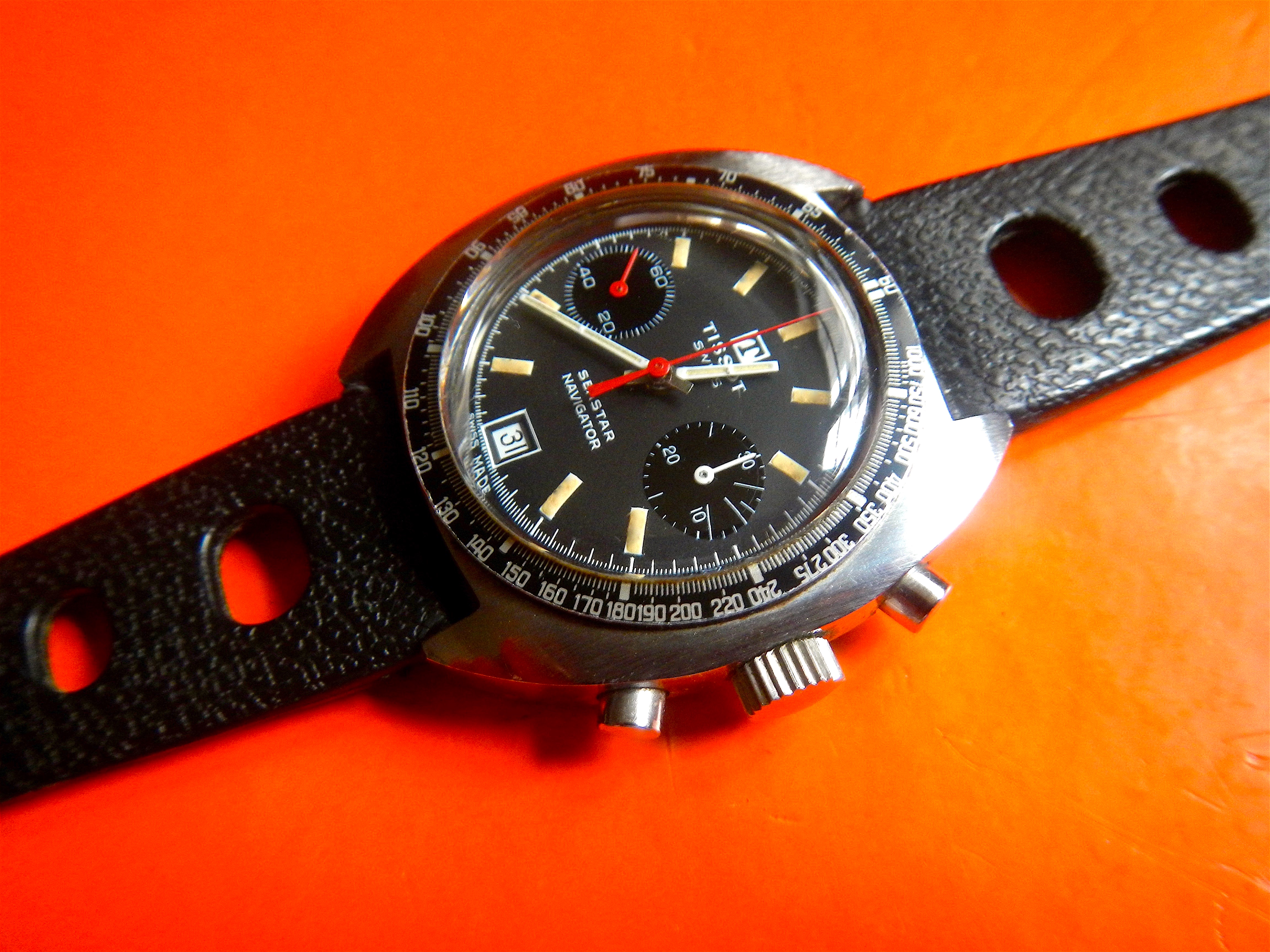

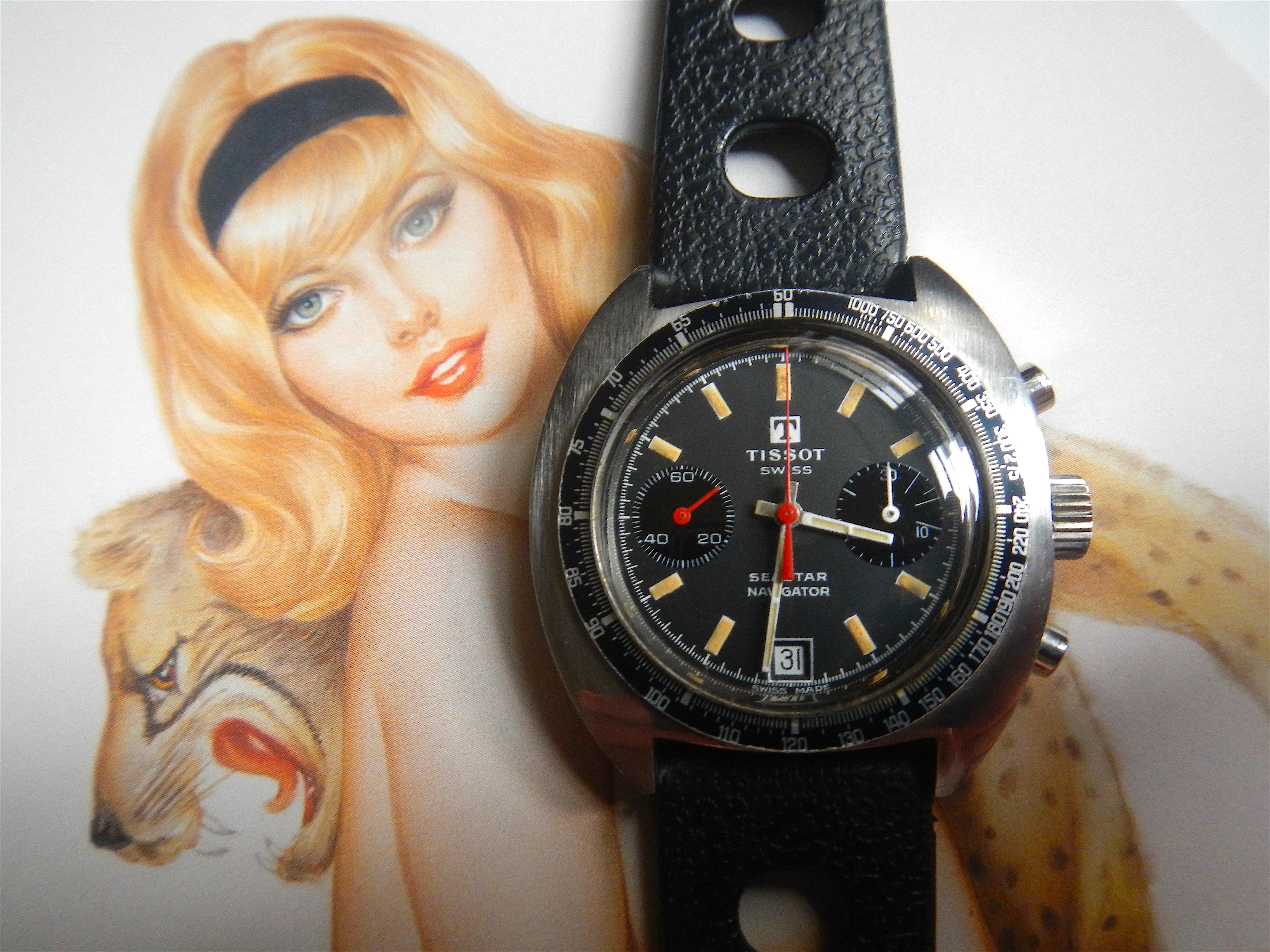

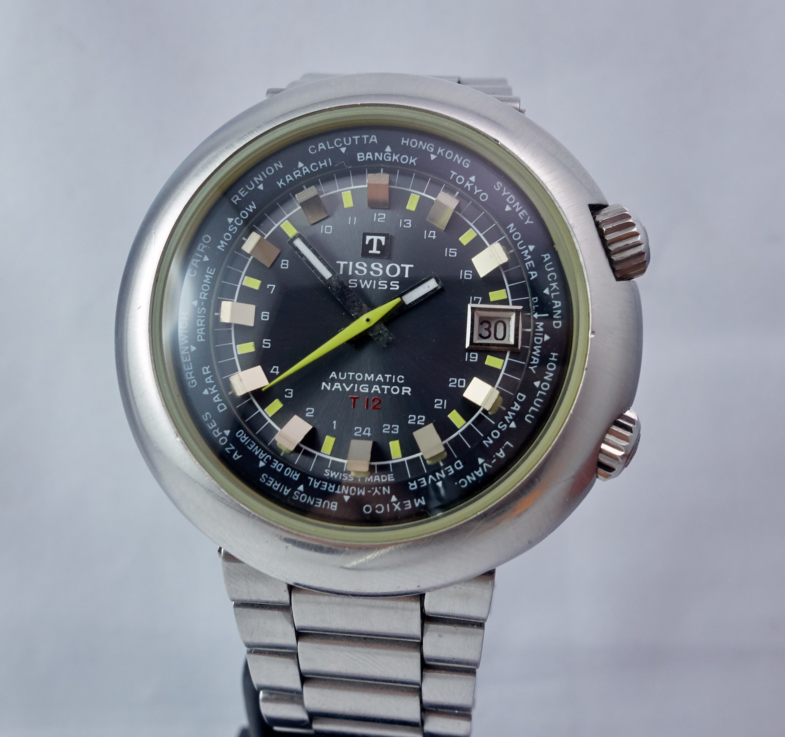

@hmmmcamu if you need pictures of my Navigators you just have to ask 😀
@Cricket33 , I will try to make some picture of documentation about Navigator

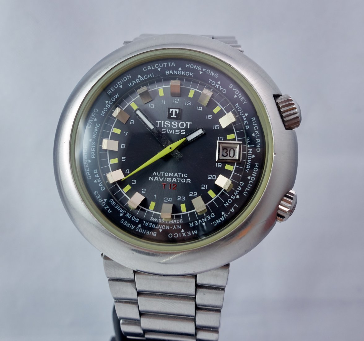

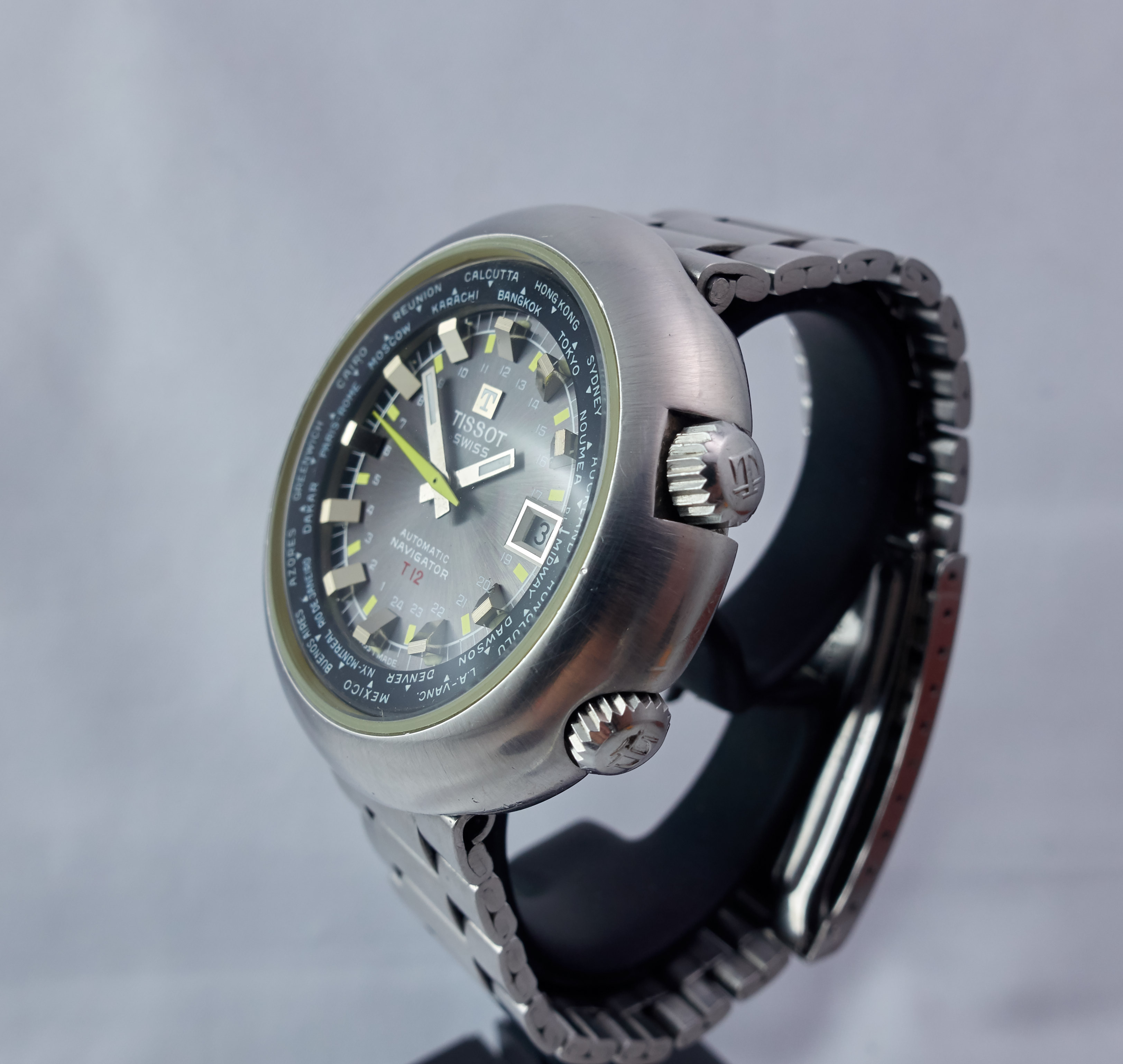

G'day Willbur,

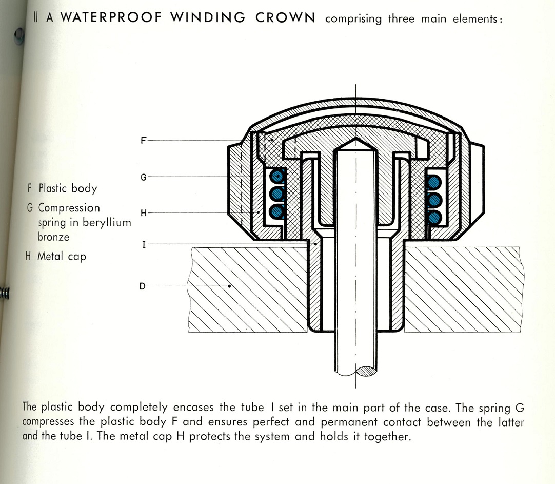

are the crowns original on this one? I would love a pic, if so.

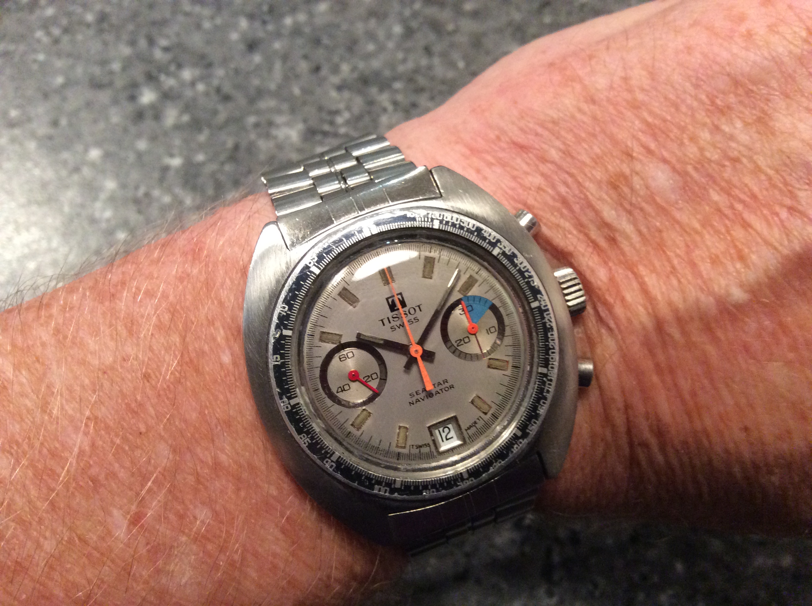

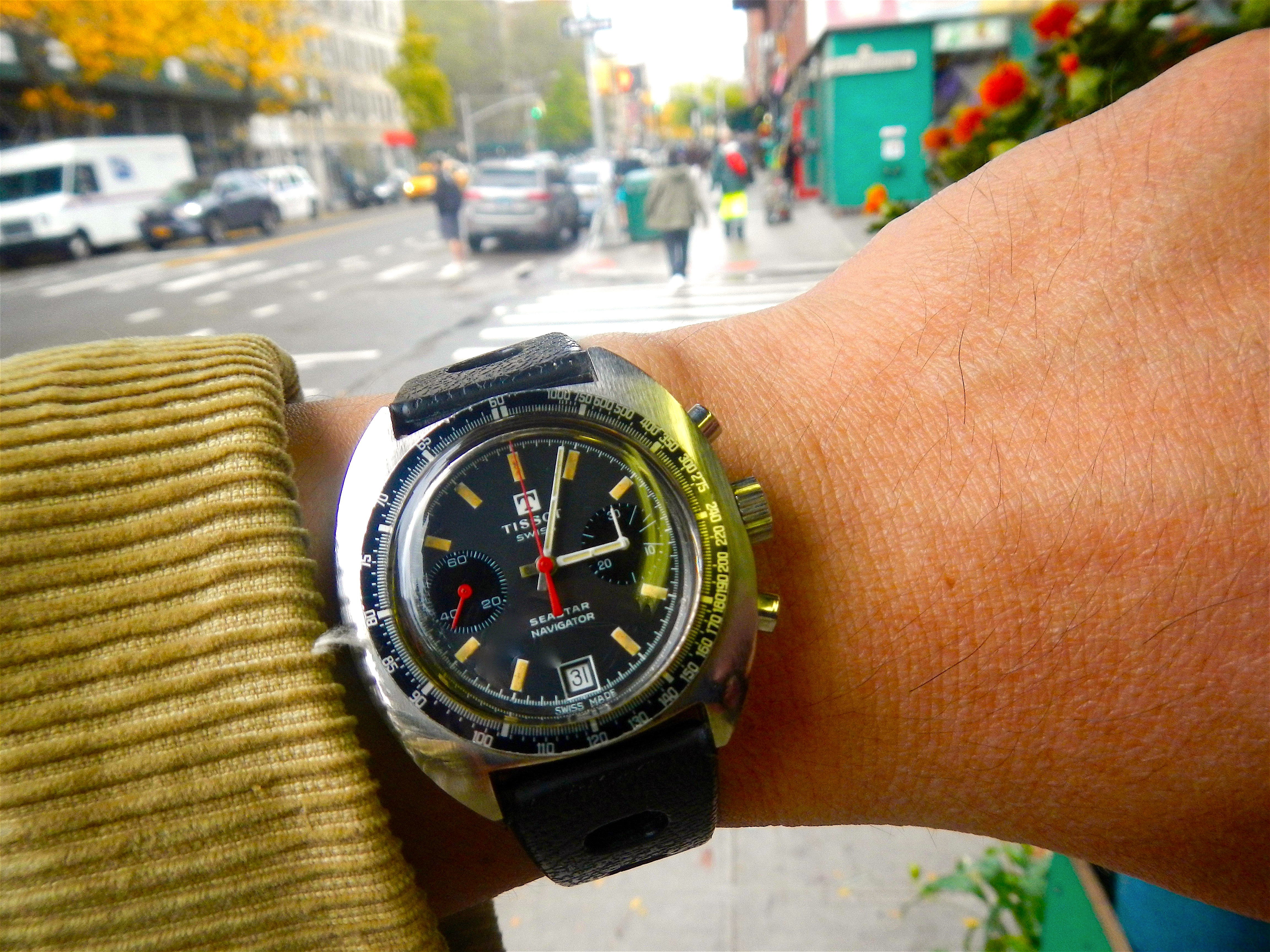

Here’s my contribution

@michael22, Yes crowns are original and specific to T12 watches.
As I remember crown for inner bezel is a Tap10 and almost impossible to find the other one is something available on Ebay.

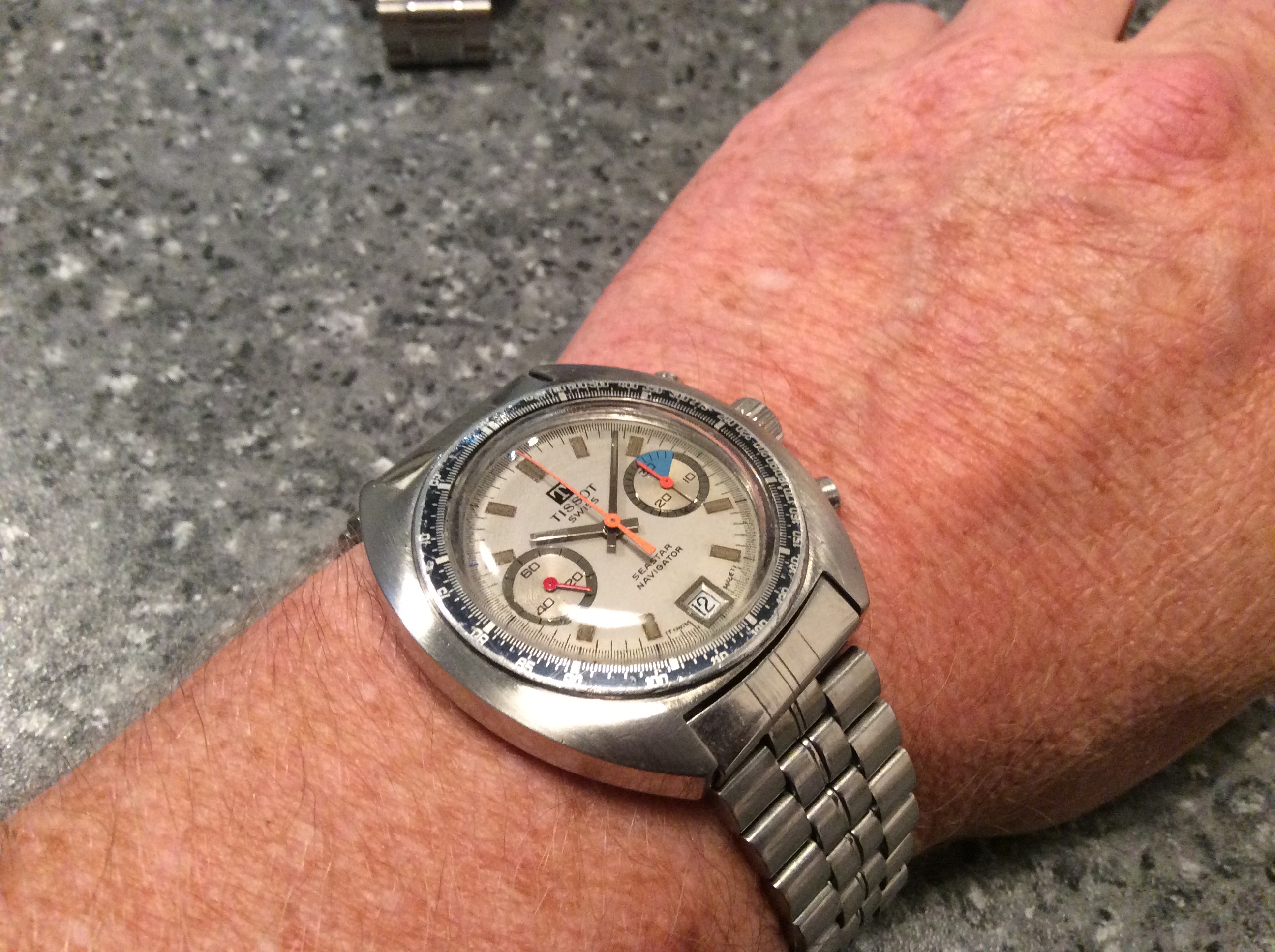

I am a fan of those with the blue segment for yachting.
