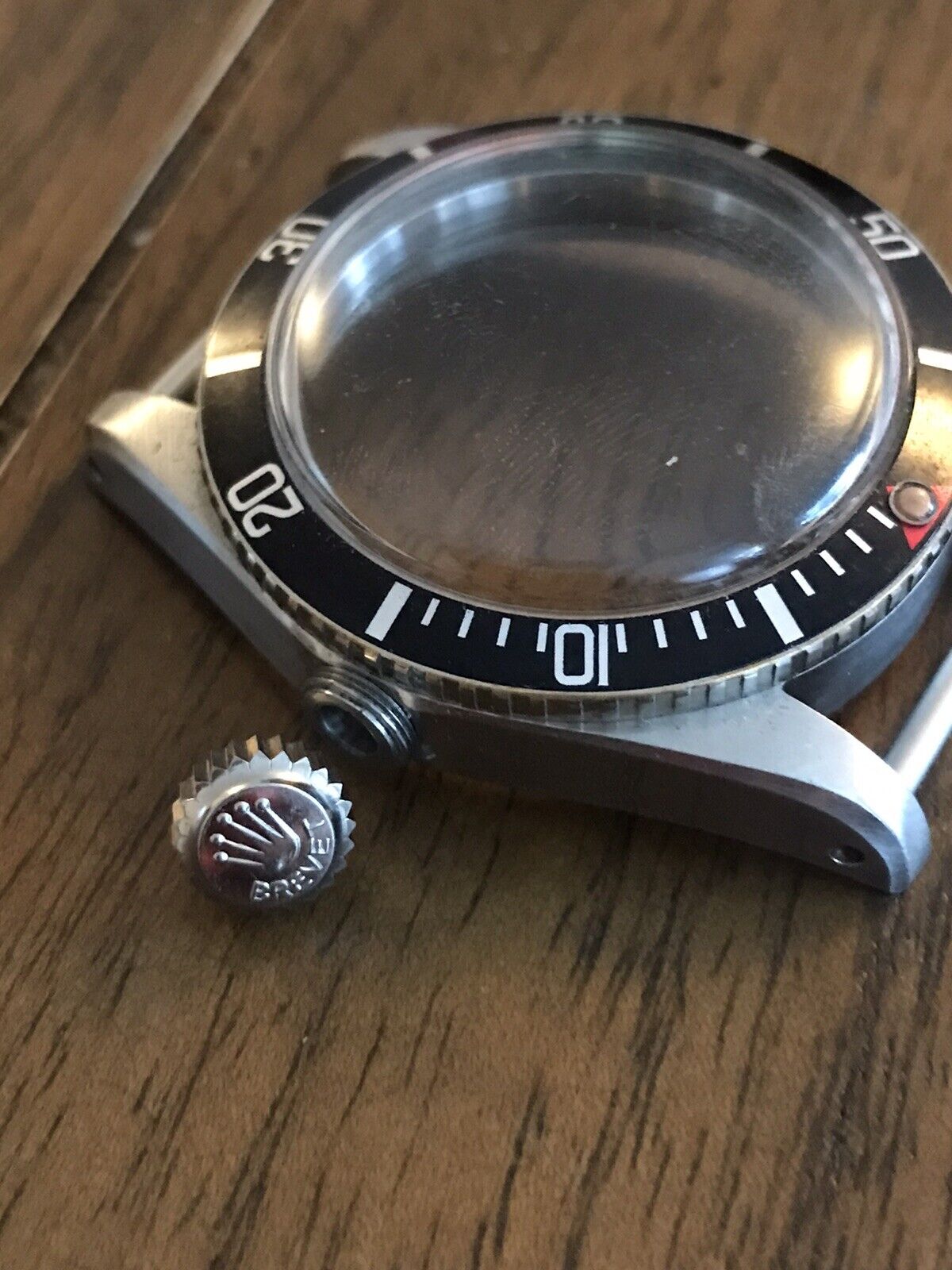

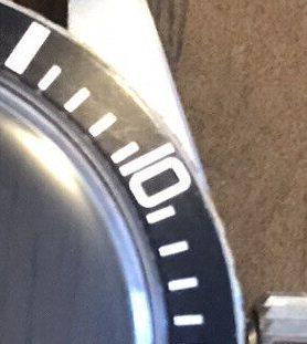

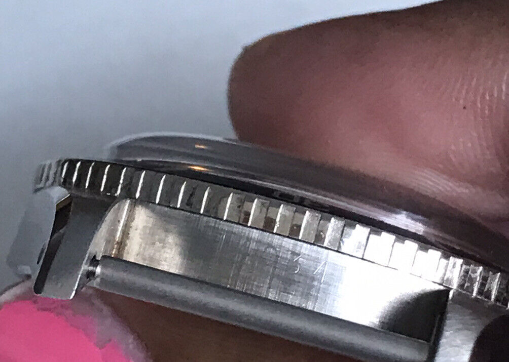

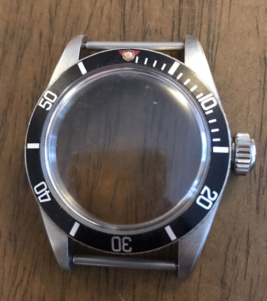

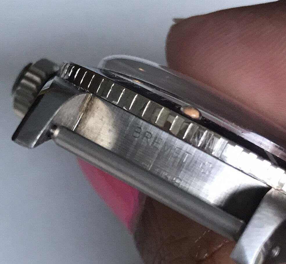

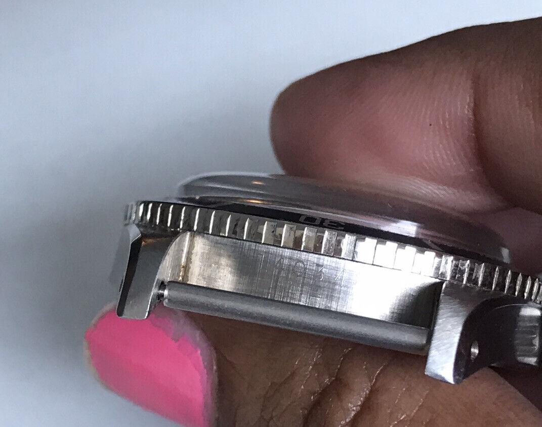

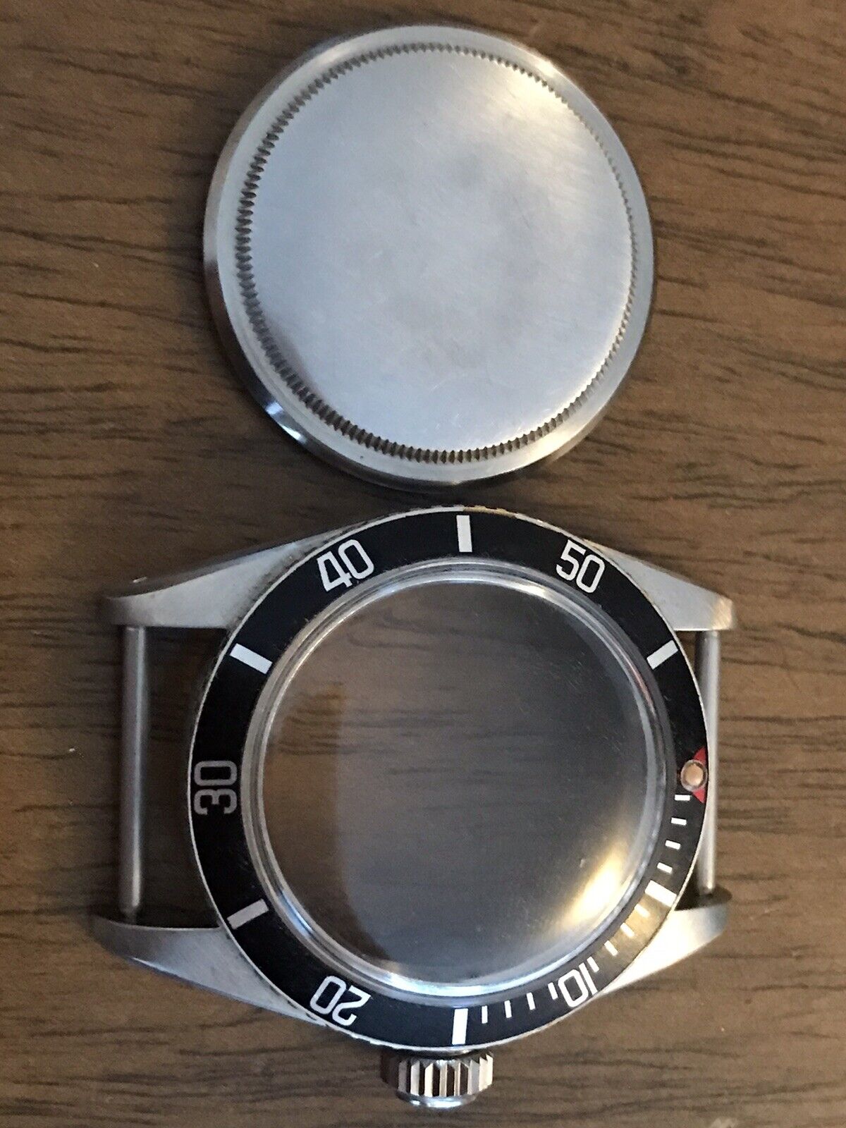

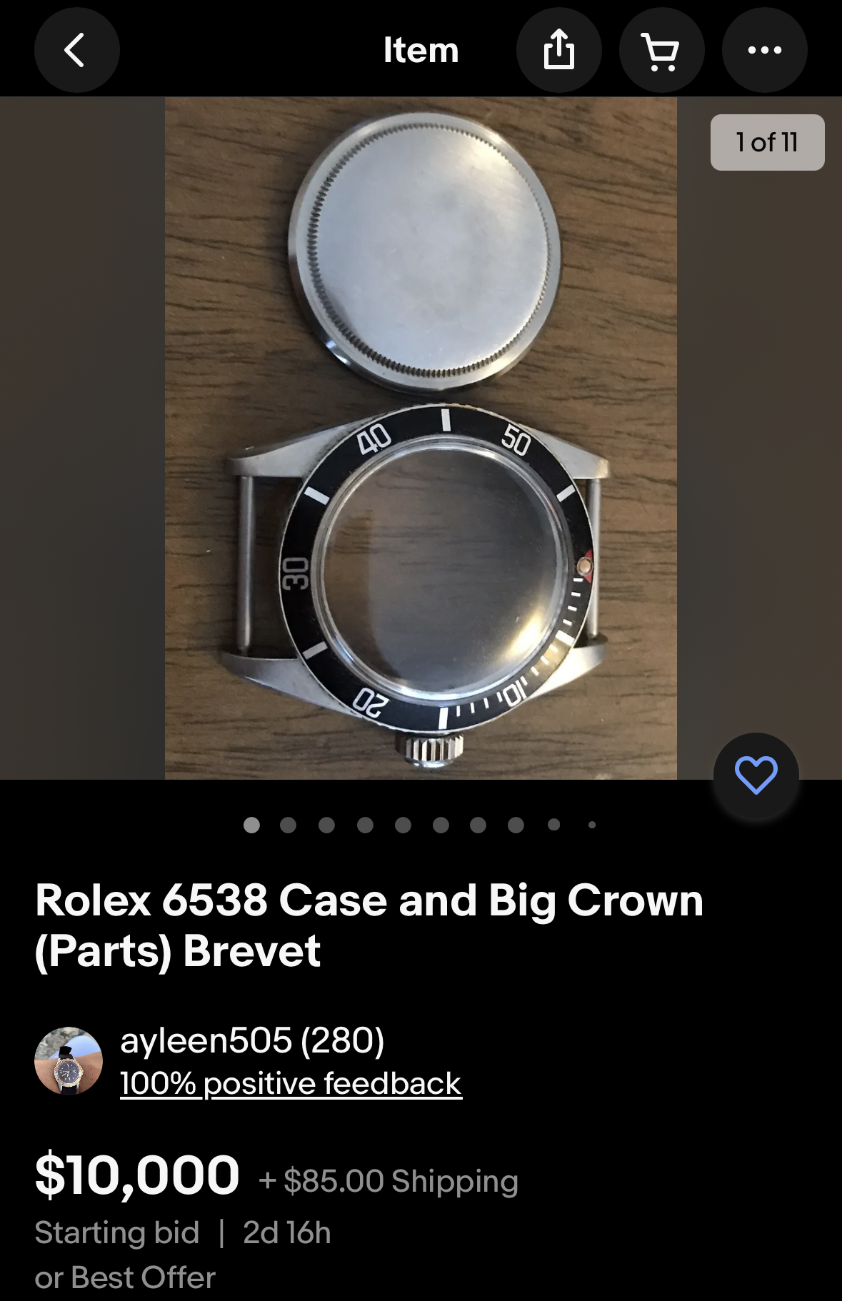

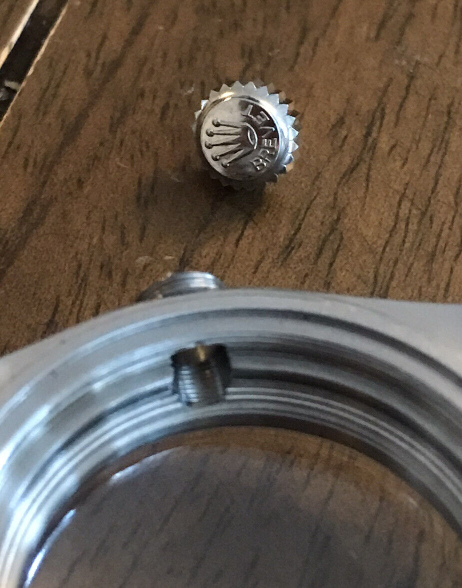

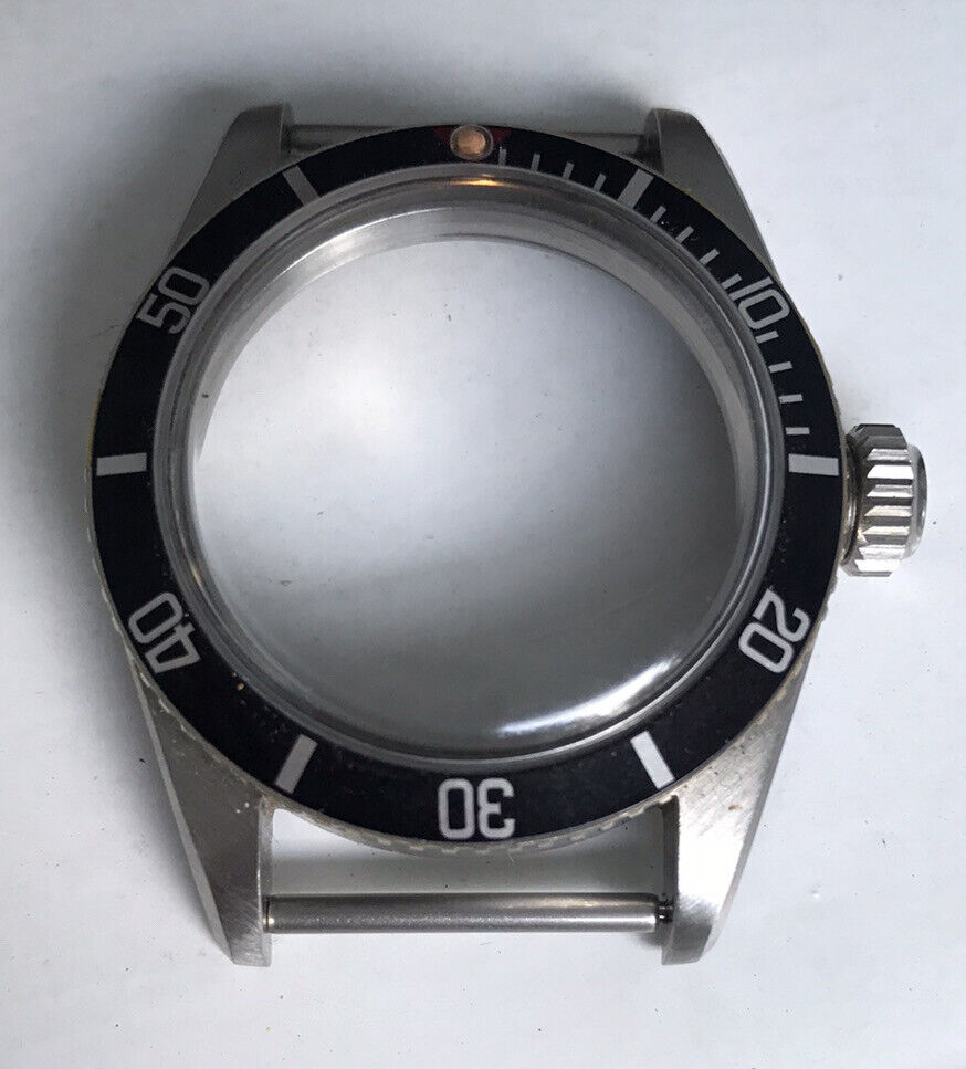

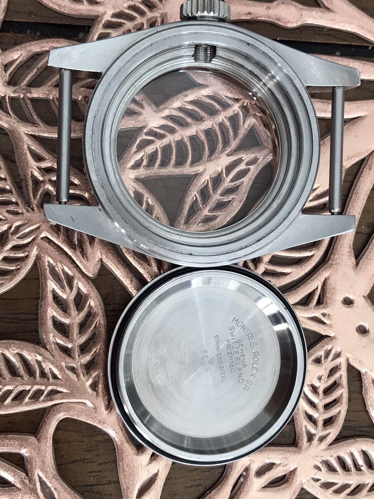

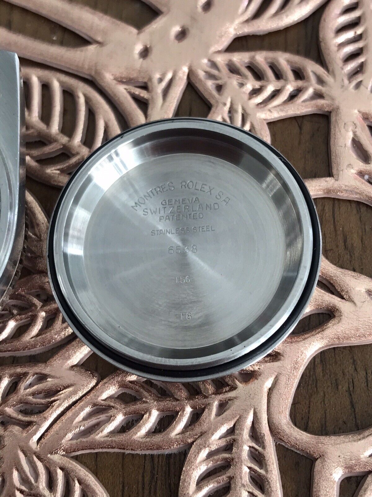

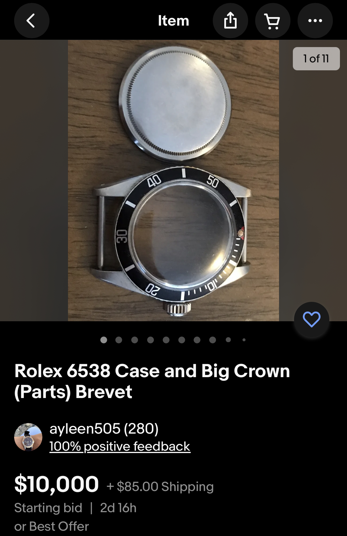

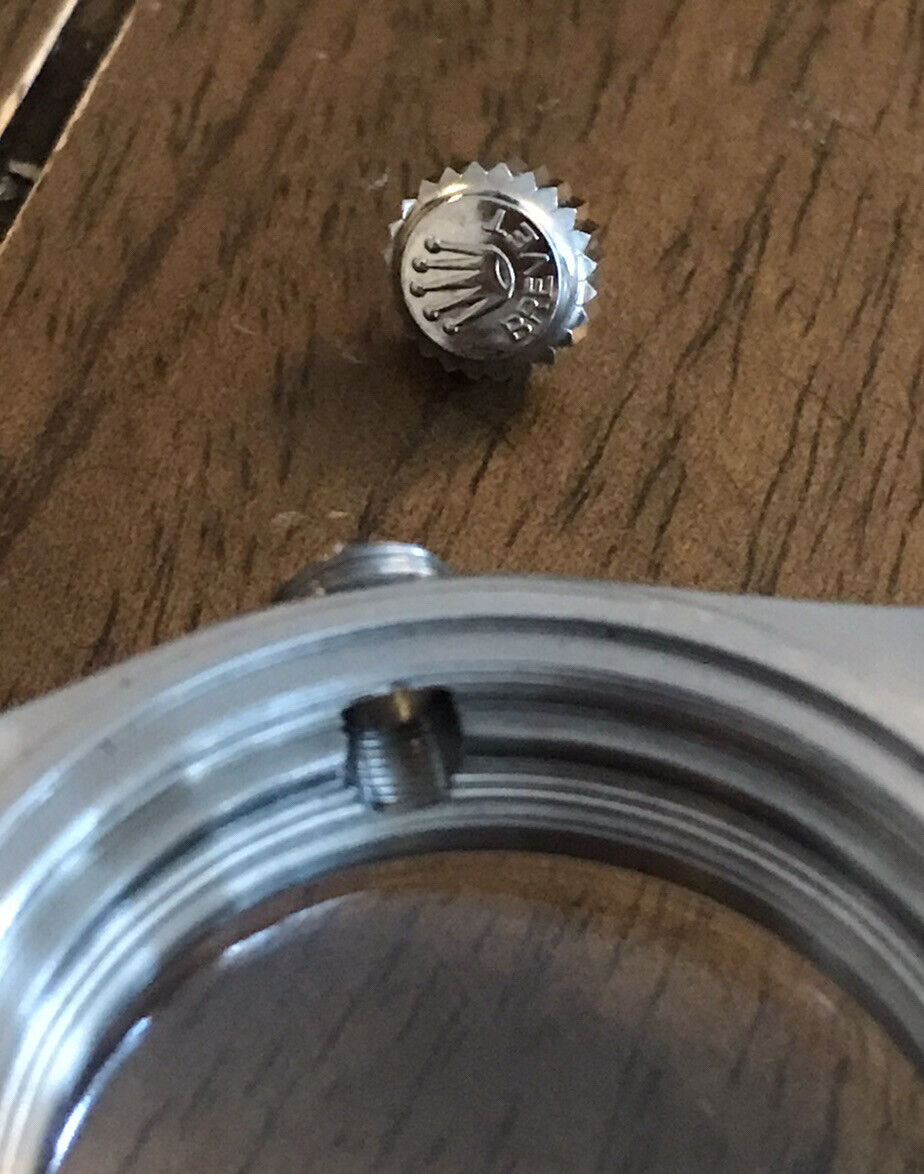

I bought this on Ebay thinking that they would authenticate it for me. They did not.
Can anyone tell if this is genuine from Rolex or not? I am okay if it is a service case. It just needs to be genuine.

eBay authentication program is for complete watches not watch parts; though, I would not have trusted them to be the source of expertise with this anyways.
However, for the $10K purchase price of this case, I highly recommend asking for help before purchasing vs after. How much research/how many 6538’s have you looked at prior to purchasing this?
Based on my limited knowledge, I believe this is a fake. The case looks like it was made yesterday. The lugs look short and thick as opposed to the long slim elegance of a 6538 case. I’m sure someone with more experience will correct me if I’m wrong, but this does not look right.

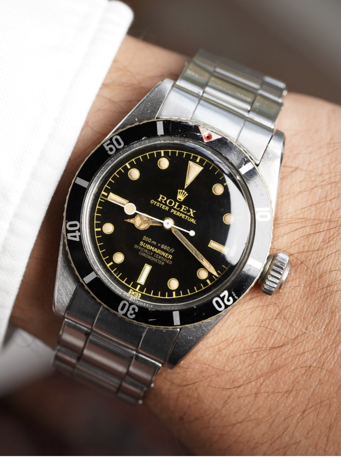

Edited to add- this 6538 from Wind Vintage for comparison of case shape and bezel font.

On pictures 6 and 7 there are no traces / signs of wear of a worn metal-bracelet (end links).....😕

Brand new fake case, artificially aged between the lugs with sandpaper using a side-to-side motion.
