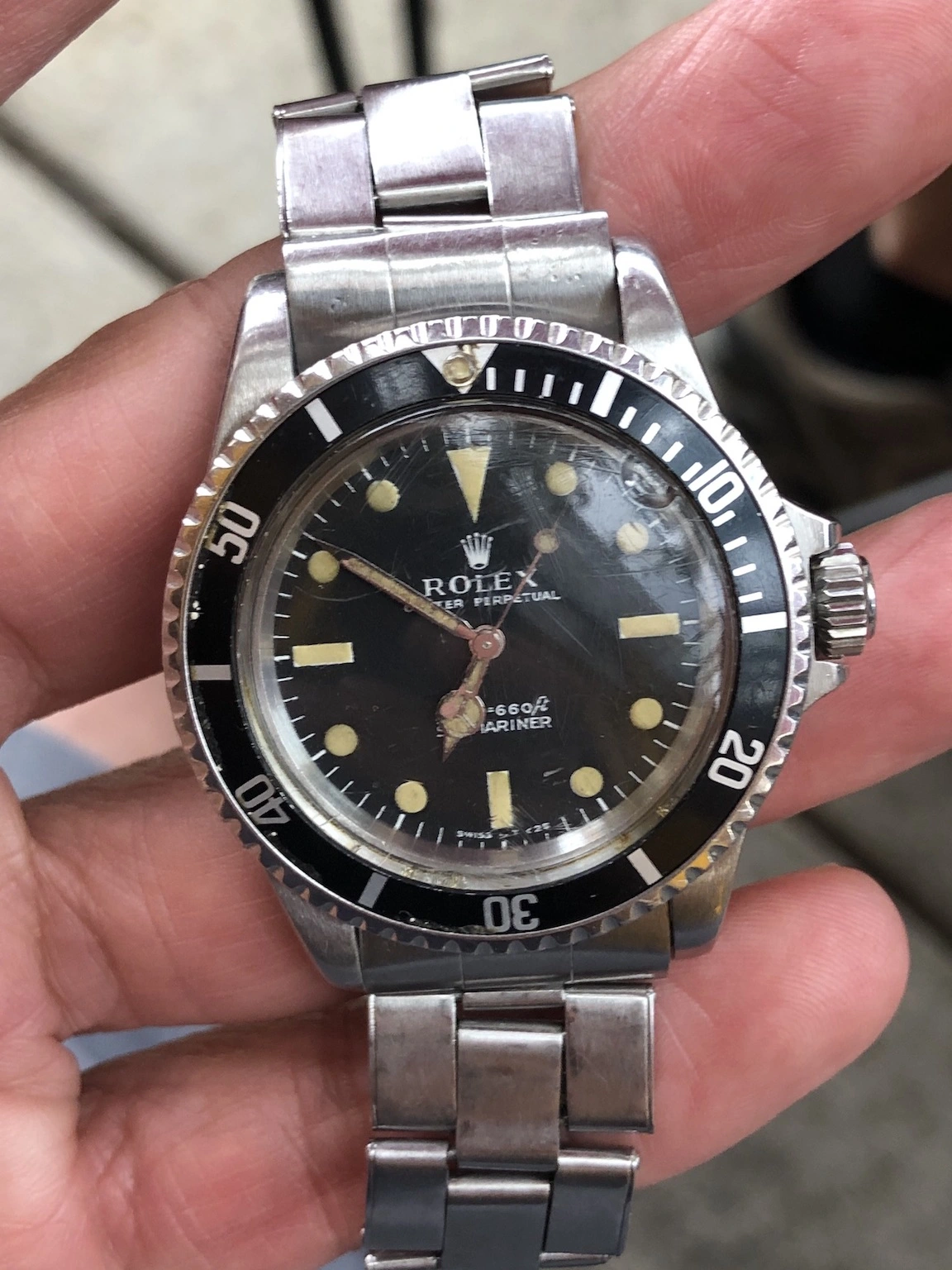

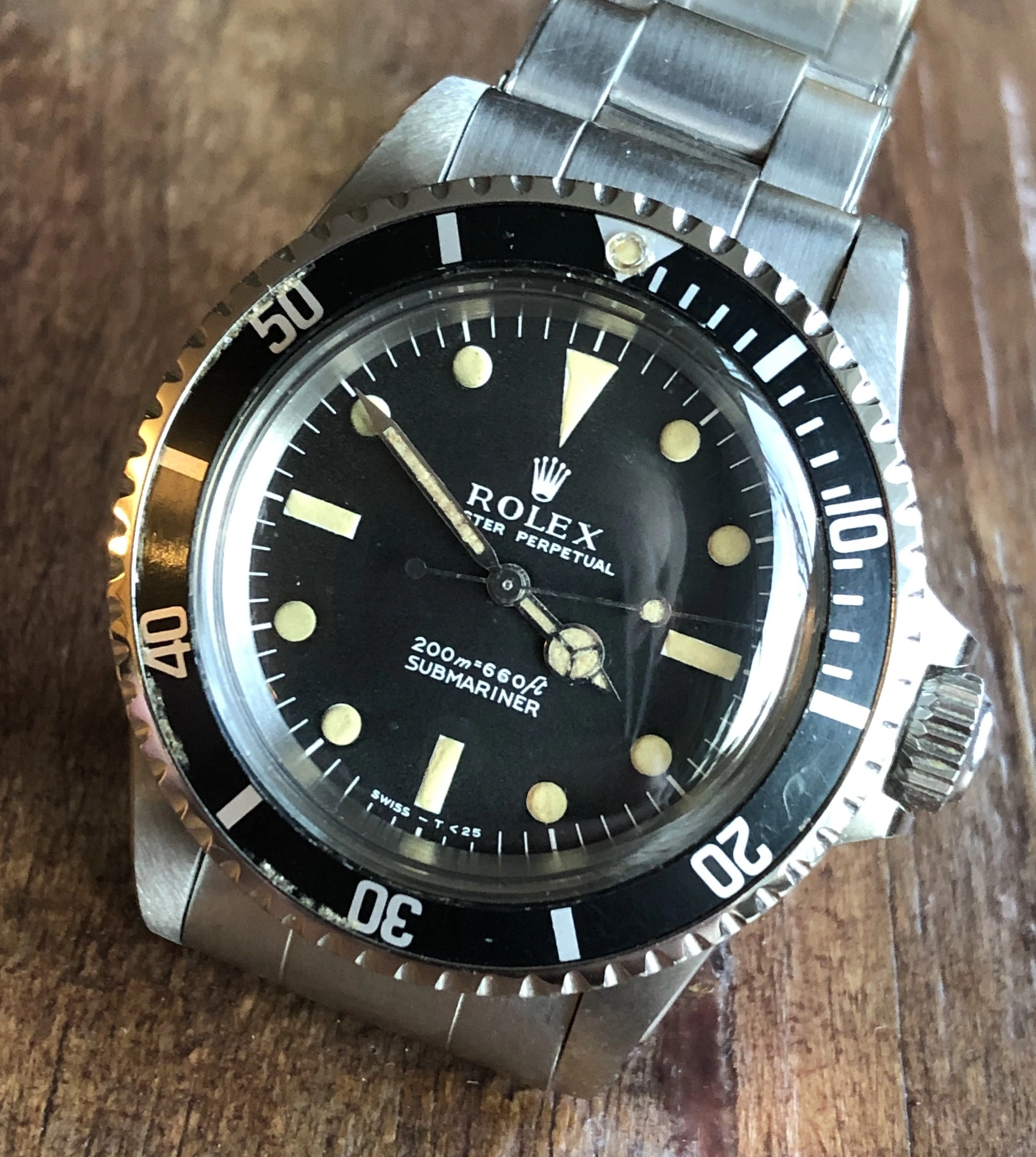

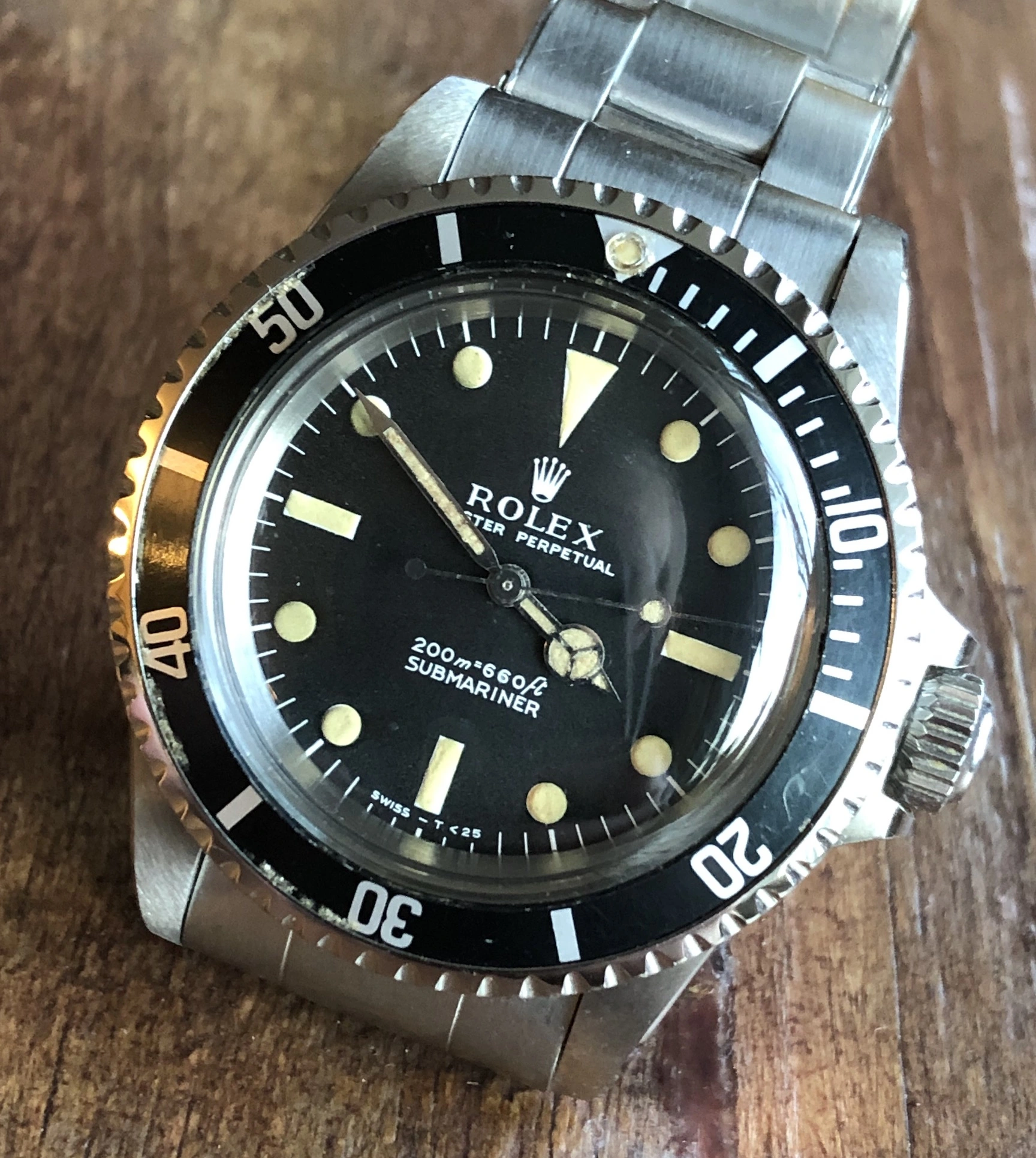

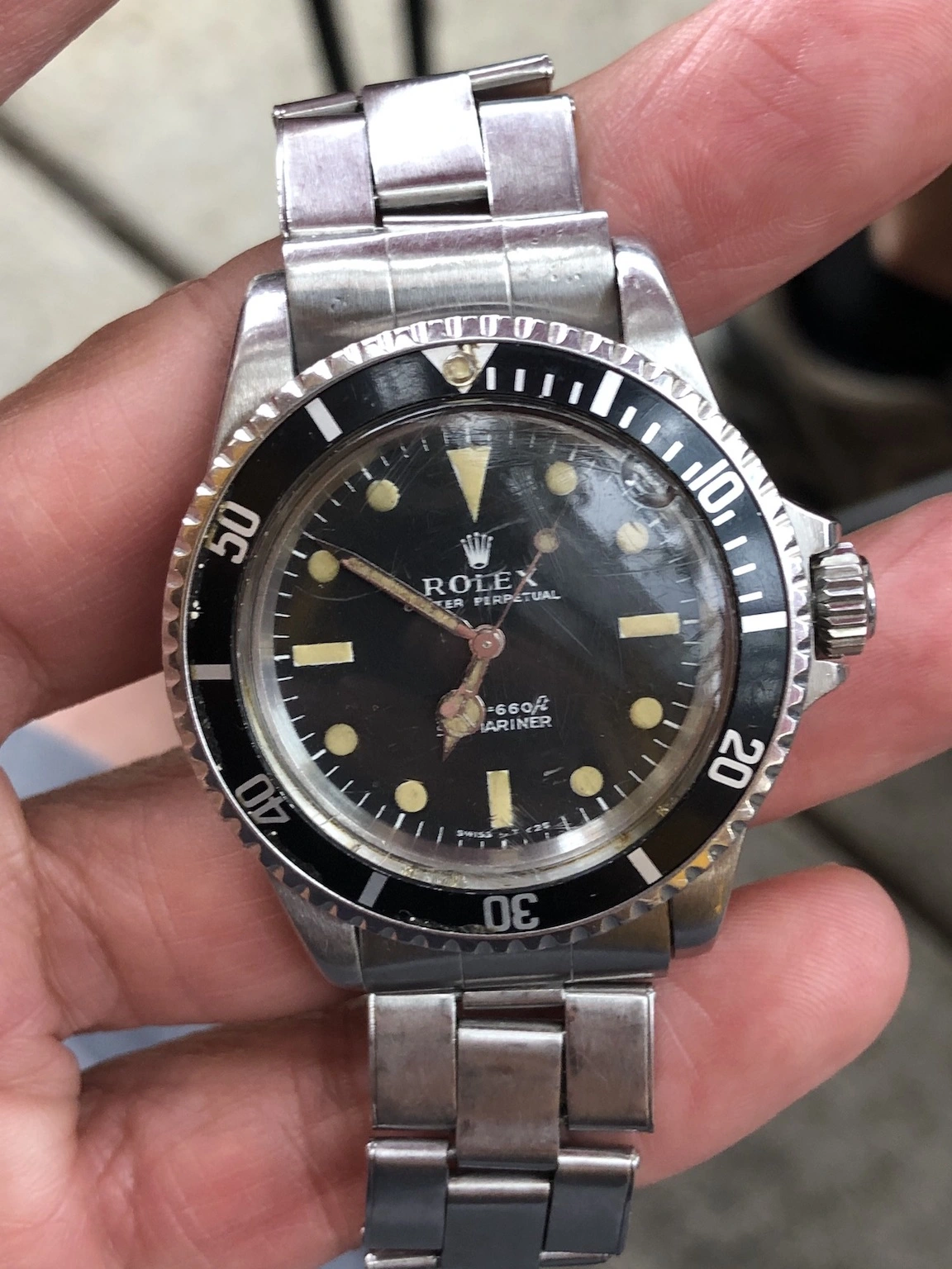

I agree that you can't really get a decent MF for 10k these days. I found this one locally and purchased it from the original owner. It needed some TLC: before and after below. Fortunately, the dial, hands, and bezel were still good.
