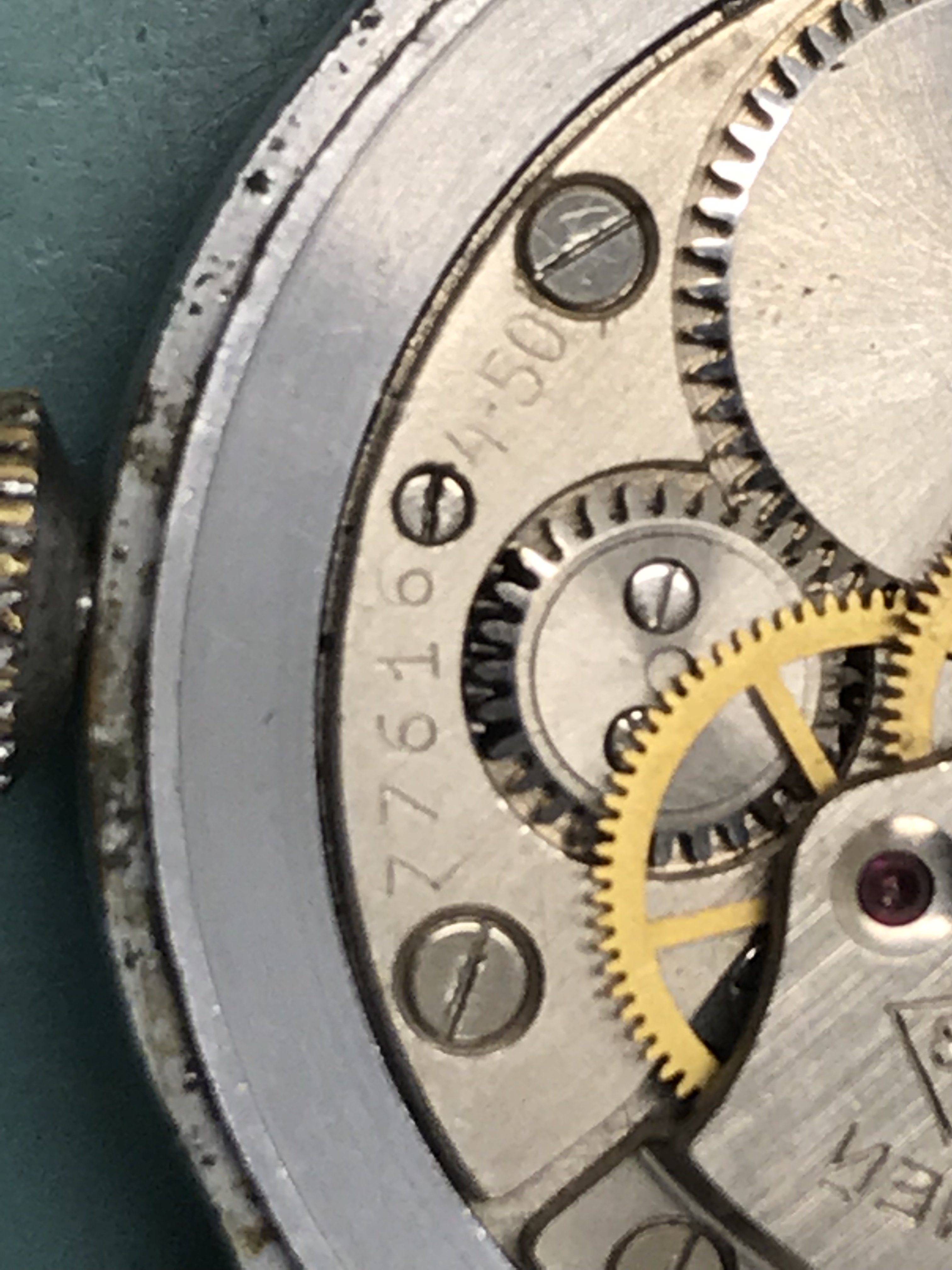

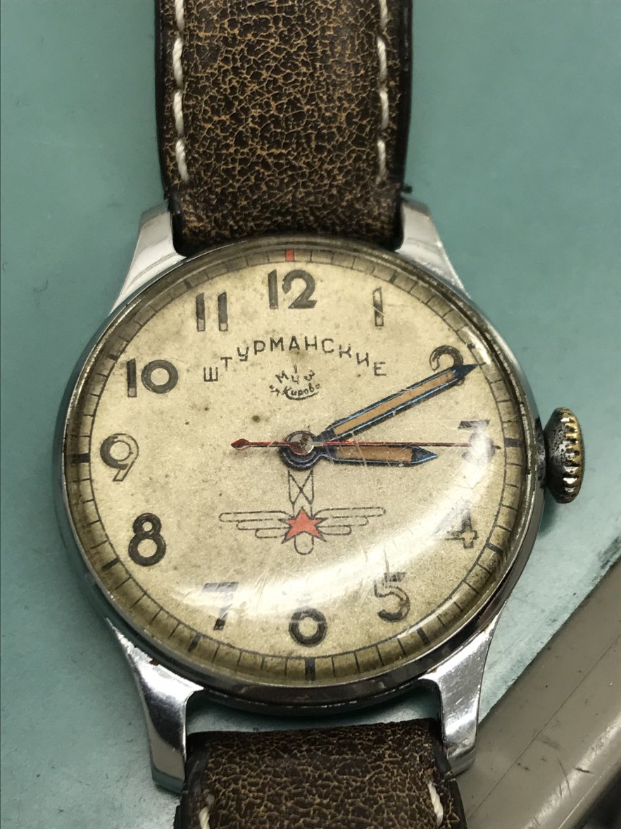

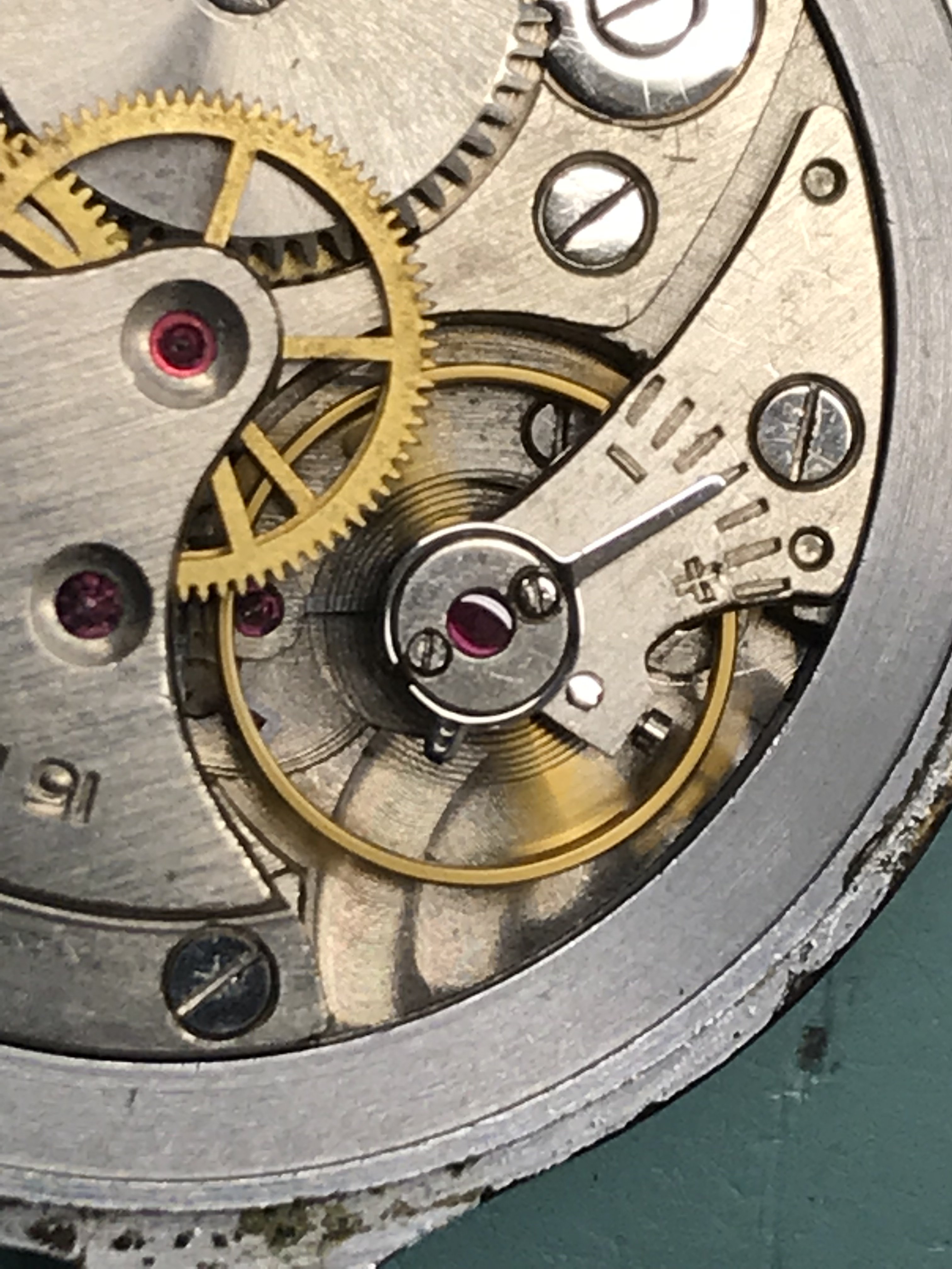

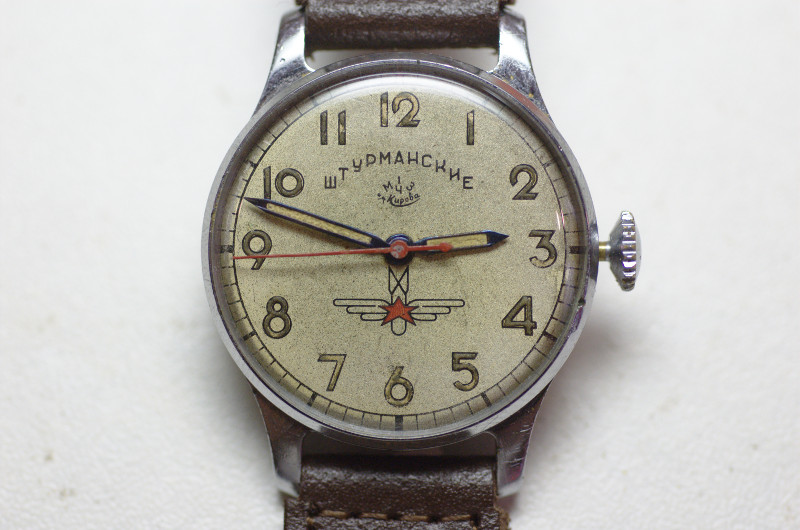

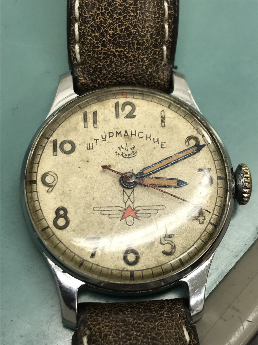

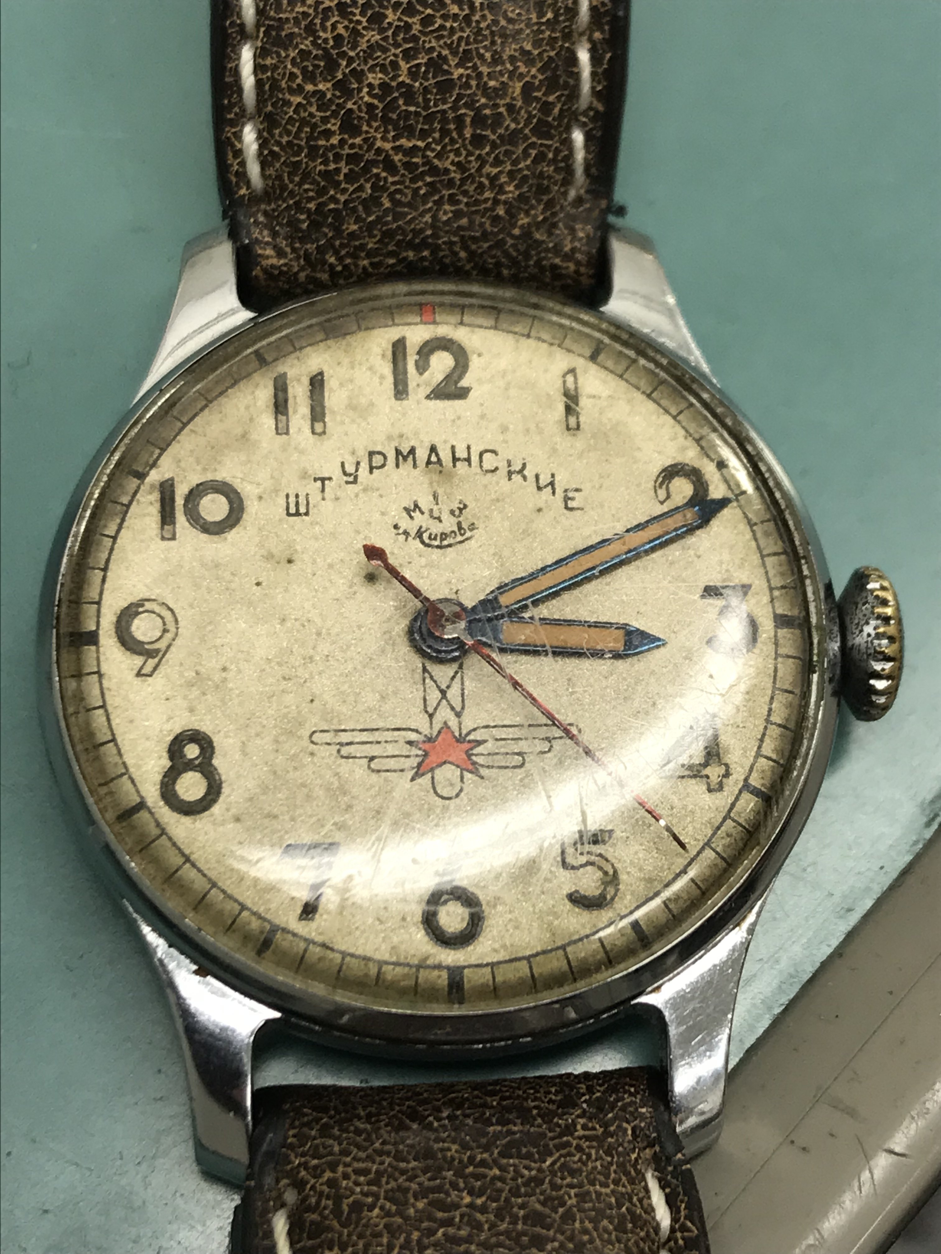

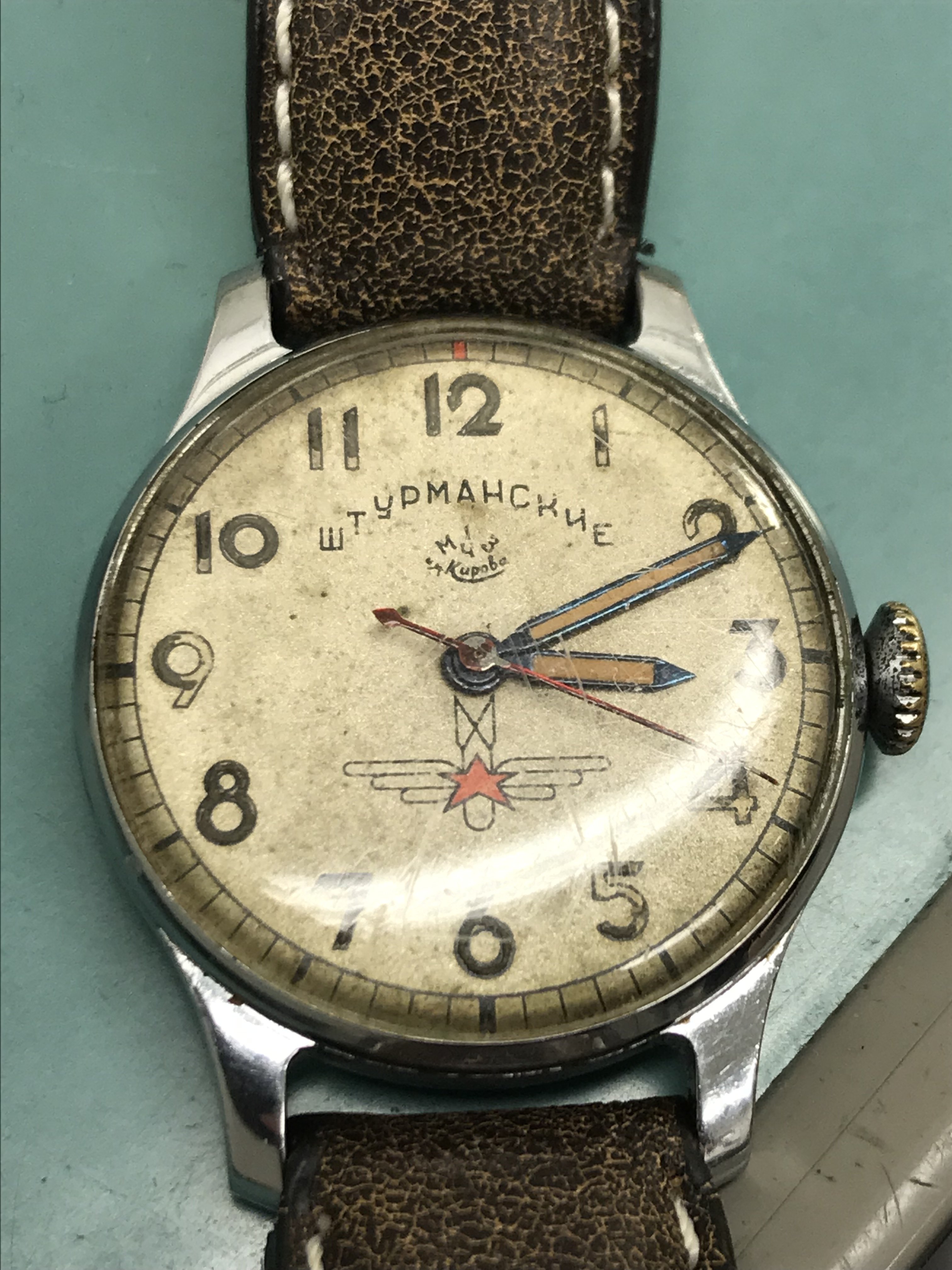

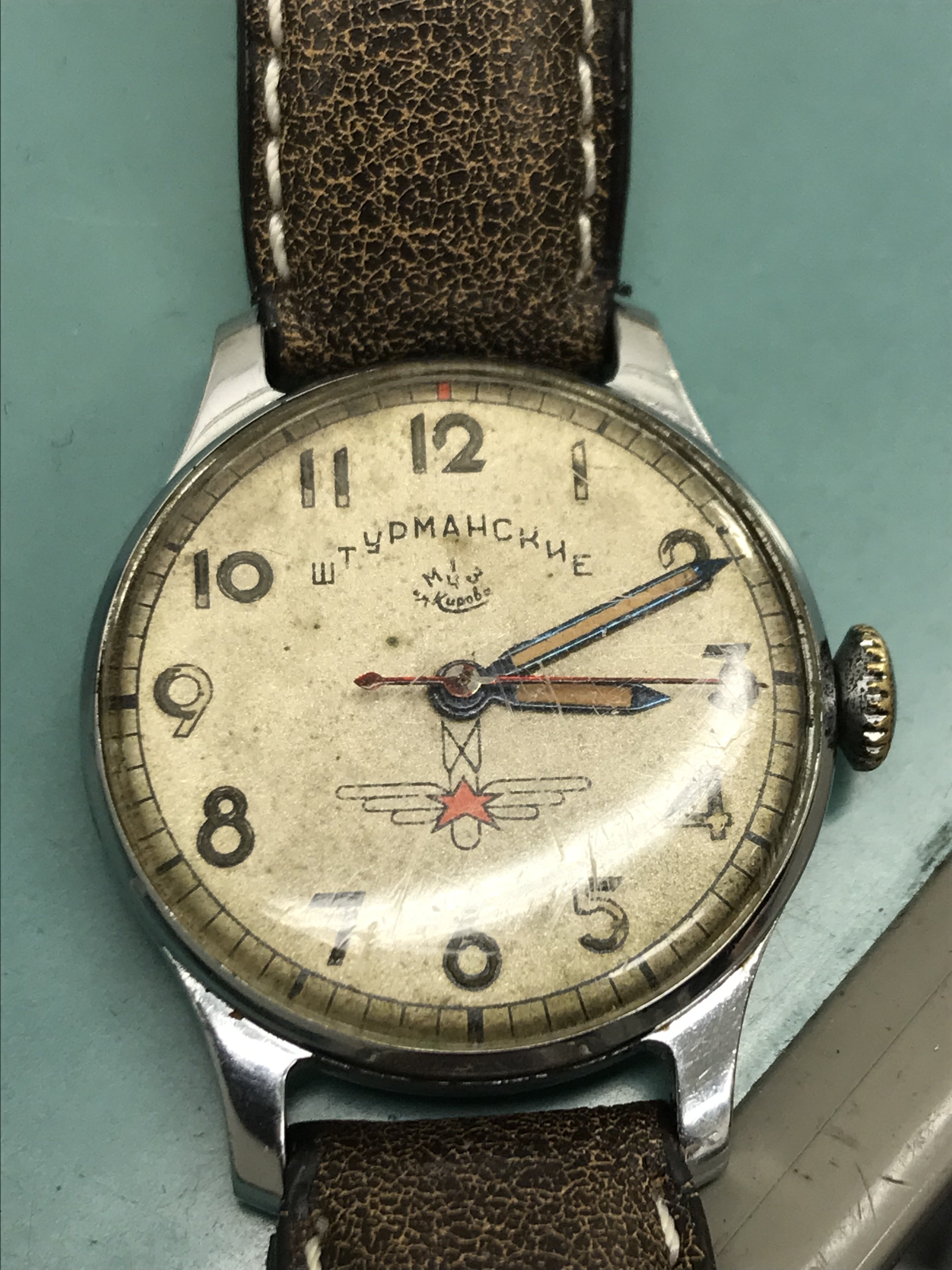

A few genuines of my collection for reference:

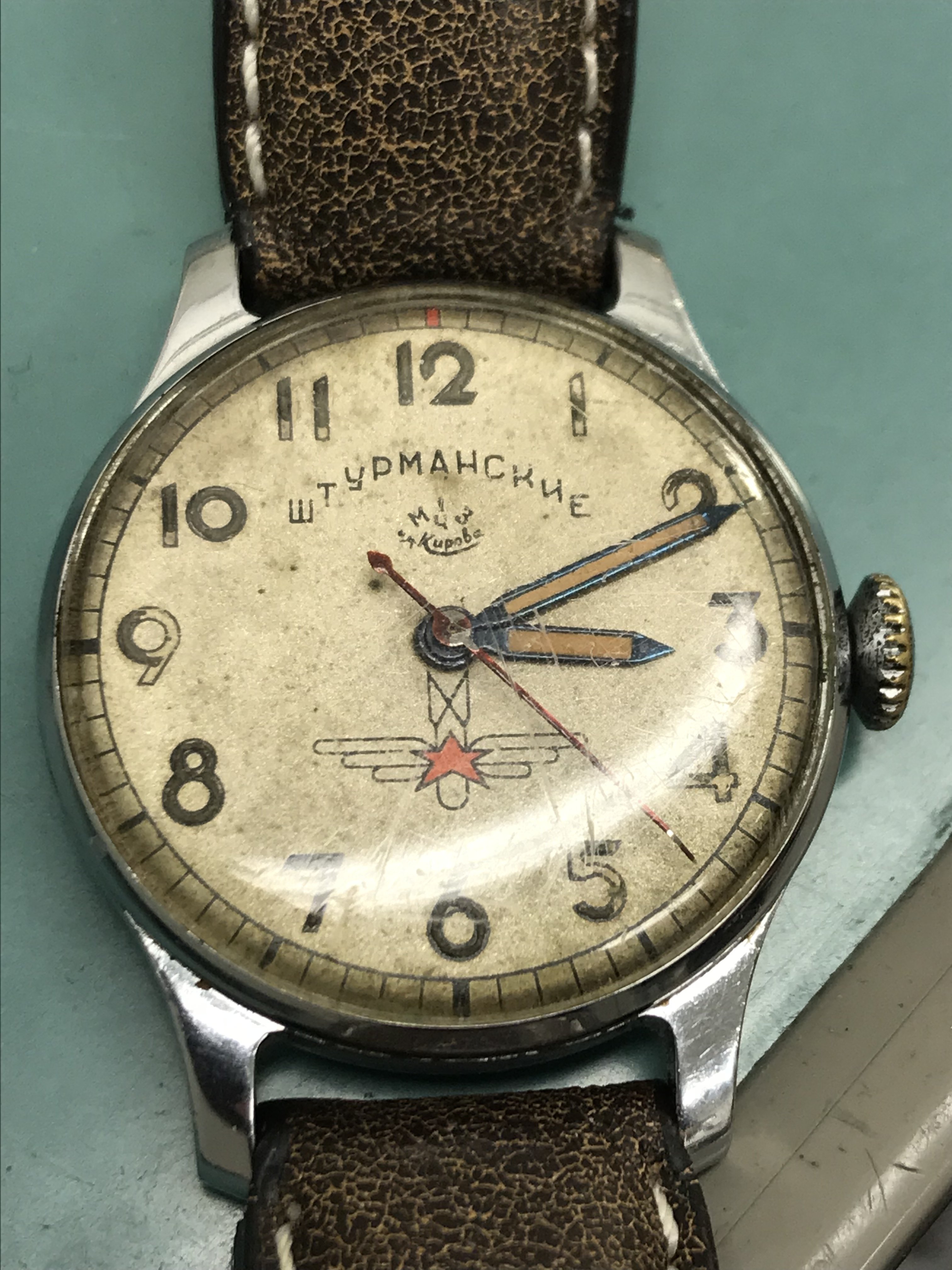

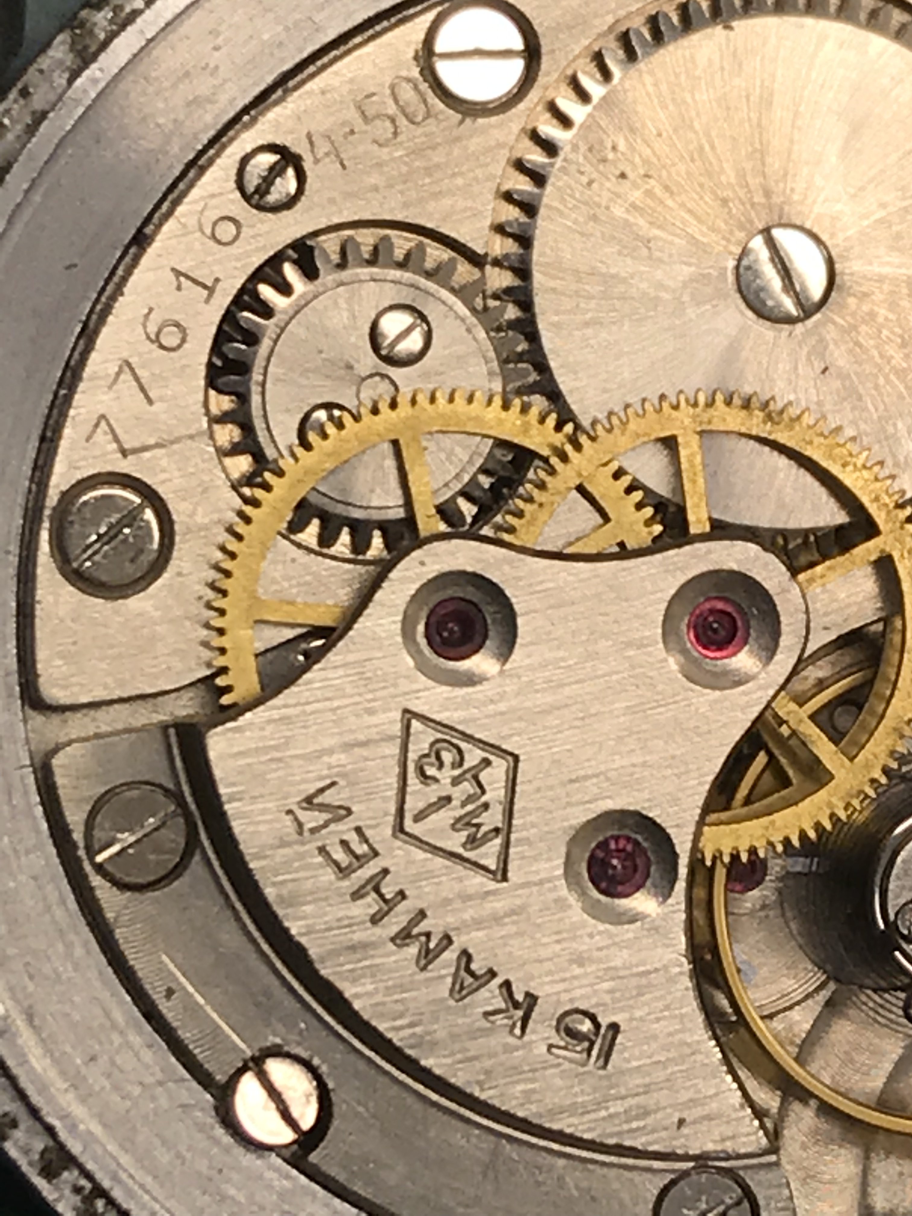

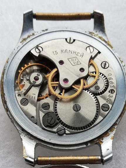

Bridge probably replaced, jewels are not recessed; it hacks though:
1,583
10,359

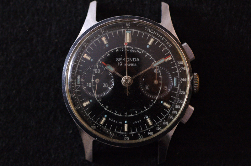

Leonov had a poljot cal. 3017, not a Sturmanskie. I only have a black dialed latin Sekonda (export brand), I think Leonov had a white dial Strela class1 in cyrillic:

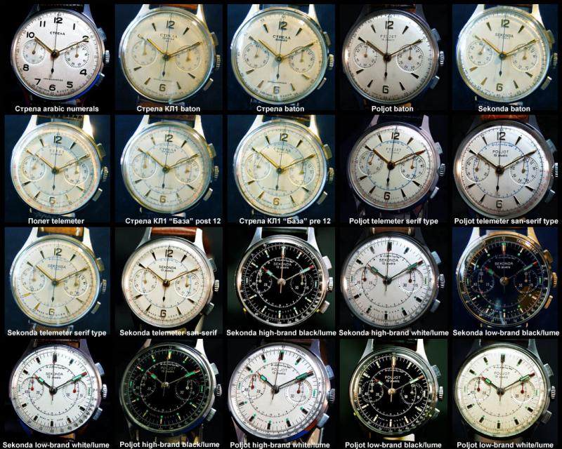

Well, all these were produced by the 1st Moscow watch factory (1MChZ im Kirova). In the 60s the Poljot brand name was created replacing the 1MChz branding on the dials.
Sturmanskie is a model name, meaning "navigator", for the watches delivered to soviet military pilots.
Strela ("arrow") is also a model name for the cal. 3017 used for the Russian market mainly. Confusingly it is also produced without model name (poljot only) or under the Sekonda name. Sekonda is a UK brand importing soviet watches...

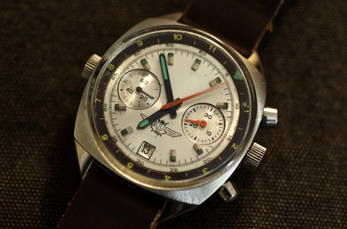

Another 3017 using no model name under the poljot brand, from the 1960s:

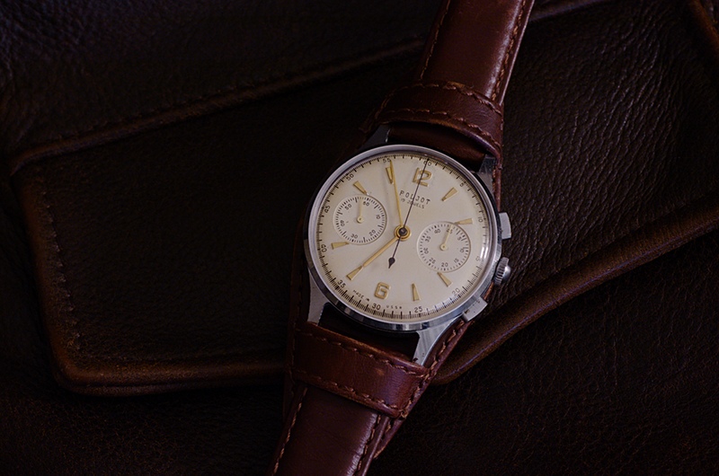

A montage of different brandings of the 3017 chrono:

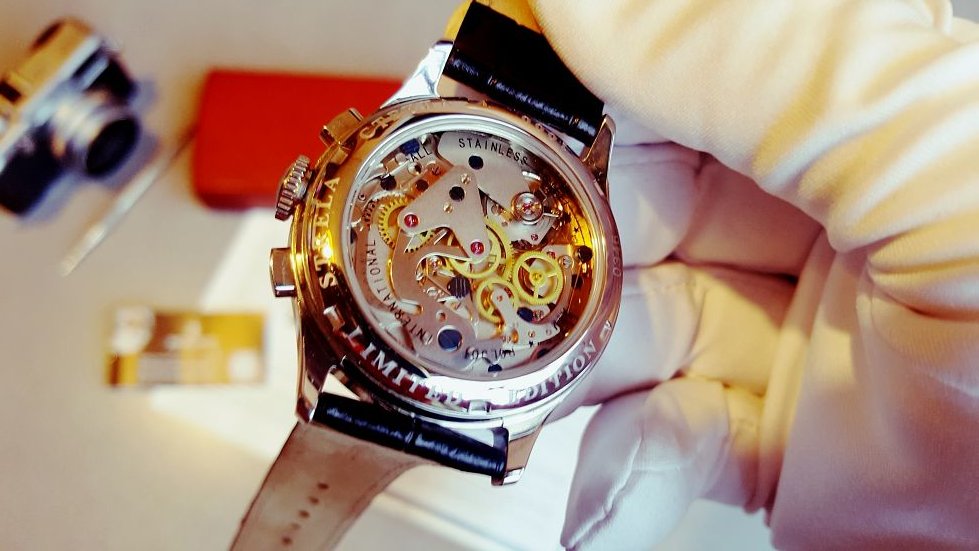

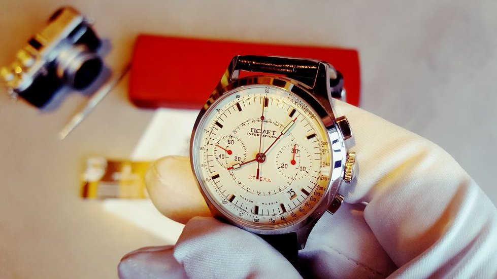

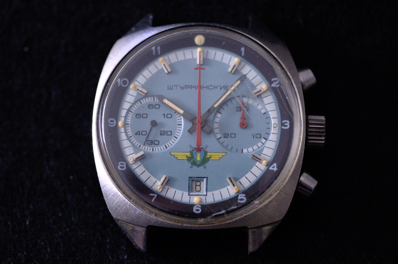

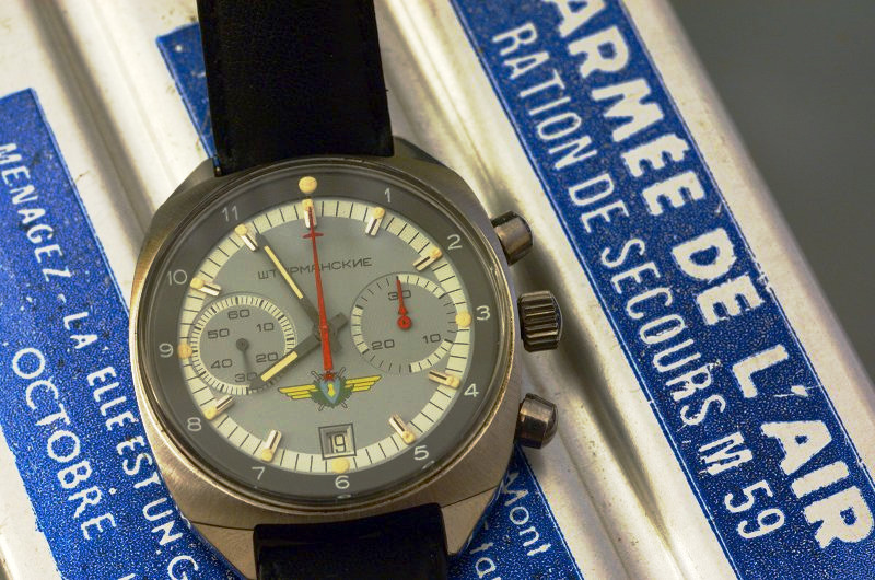

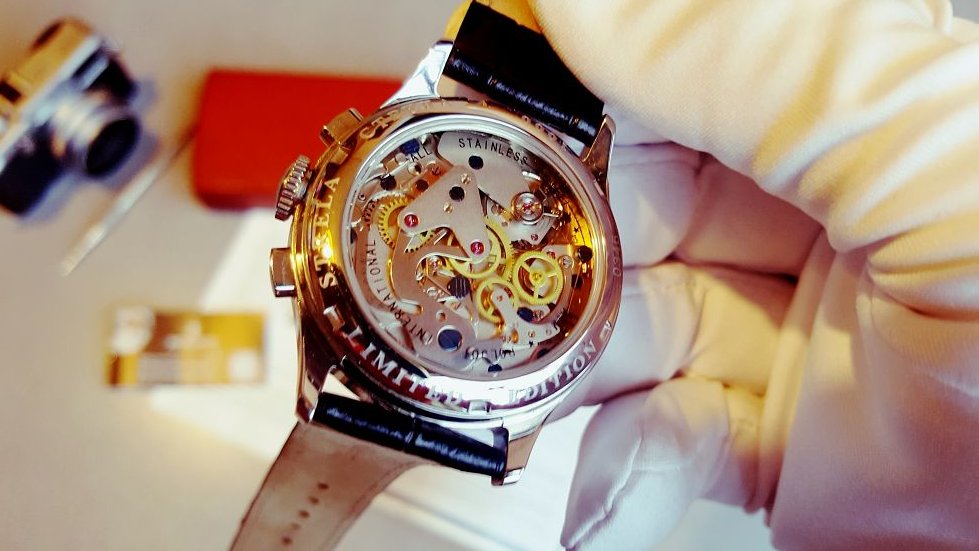

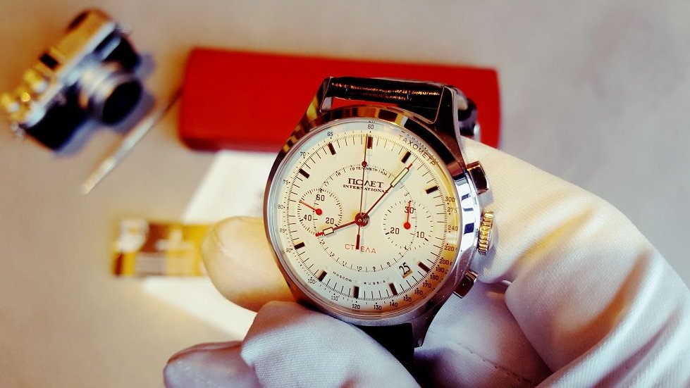

Waou, I understand that I was far to understand... Some of them look like a "modern" one I bought 2 years ago, for not much, just because I wanted to have a watch "looking" like this legend space watch, the Strela...
1,615
3,862
What you have is some sort of "reissue" of Leonov's Strela, using the other Poljot chrono, the 3133. The "poljot international" (German brand) are said to be well made. Nice watch!

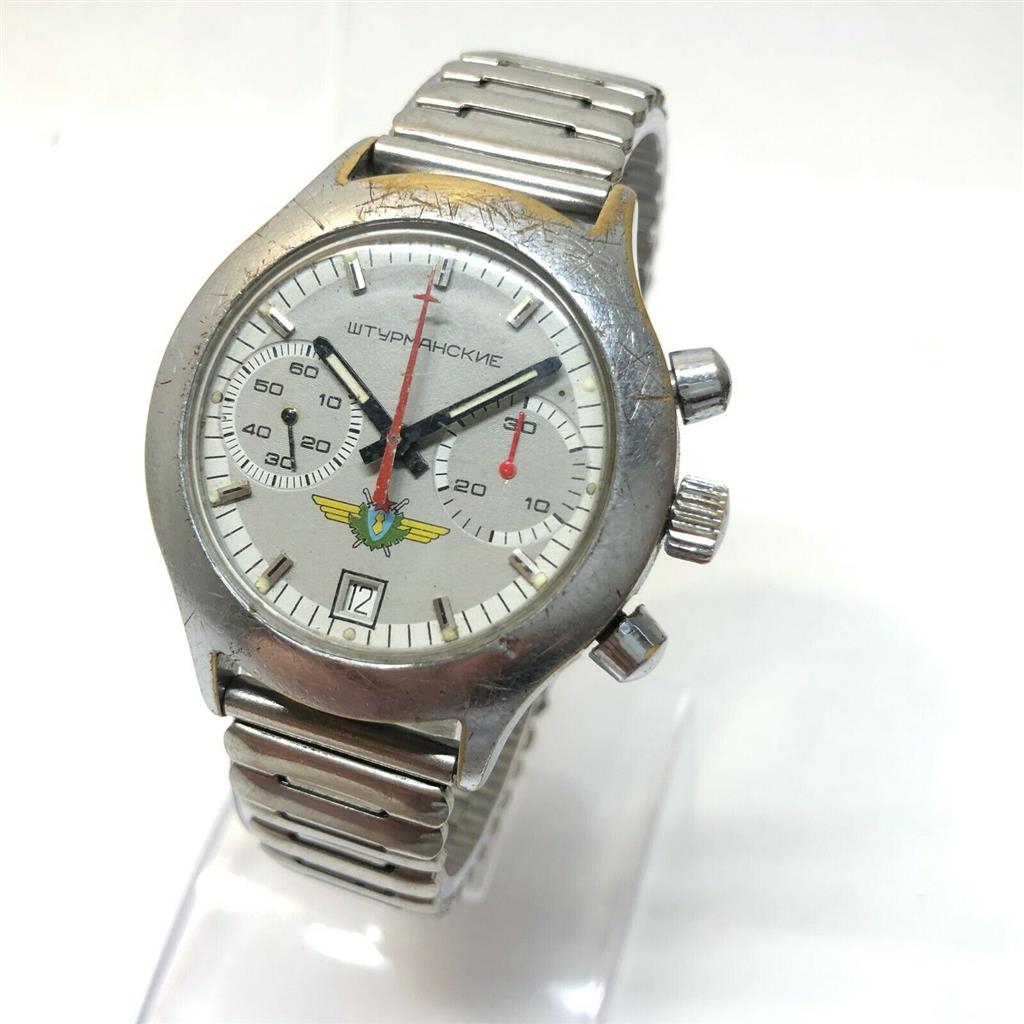

I ran across this very beat up one with a low(?) buy it now price.
Despite the doggy case they claim it runs well and remains accurate.
Any thoughts on this?

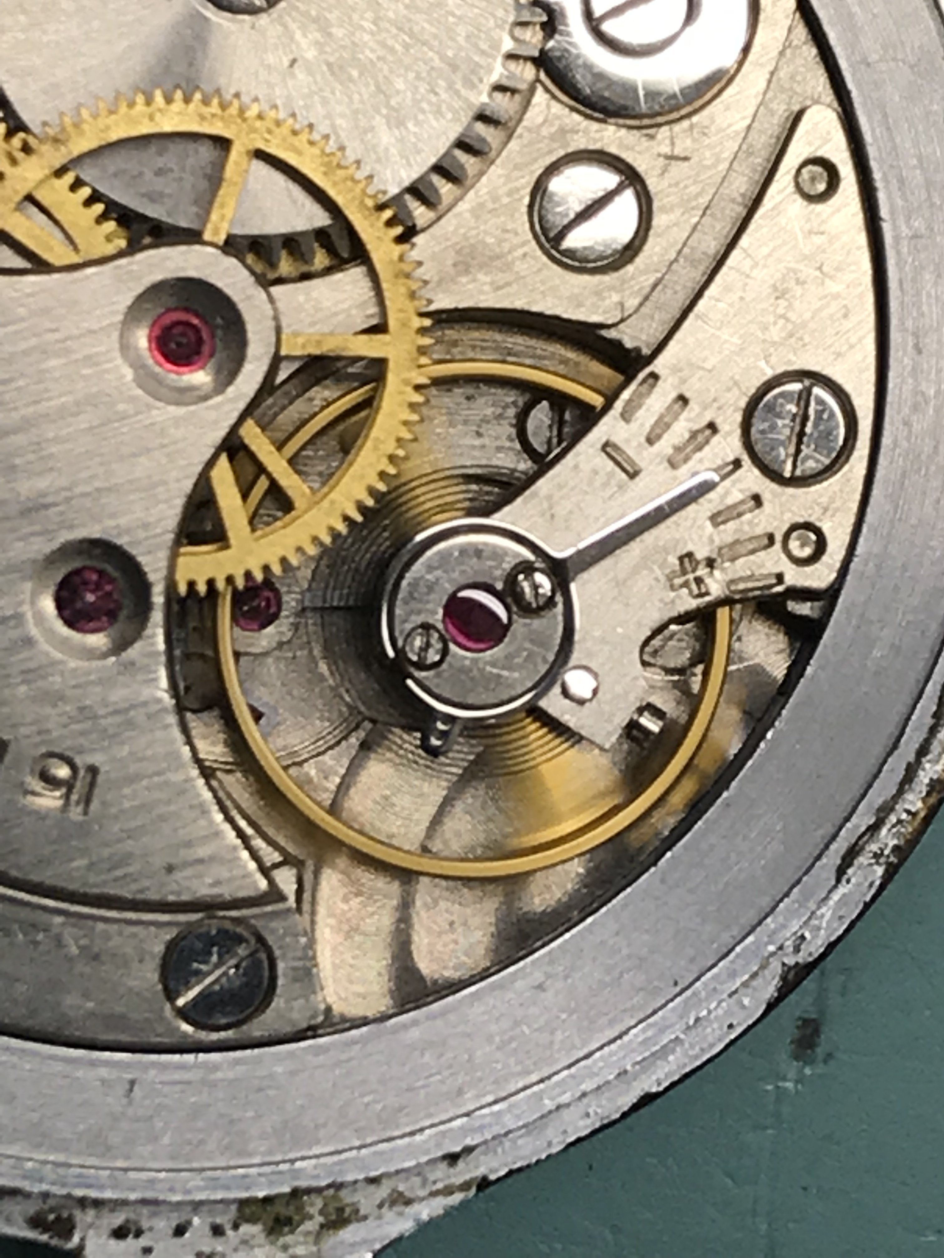

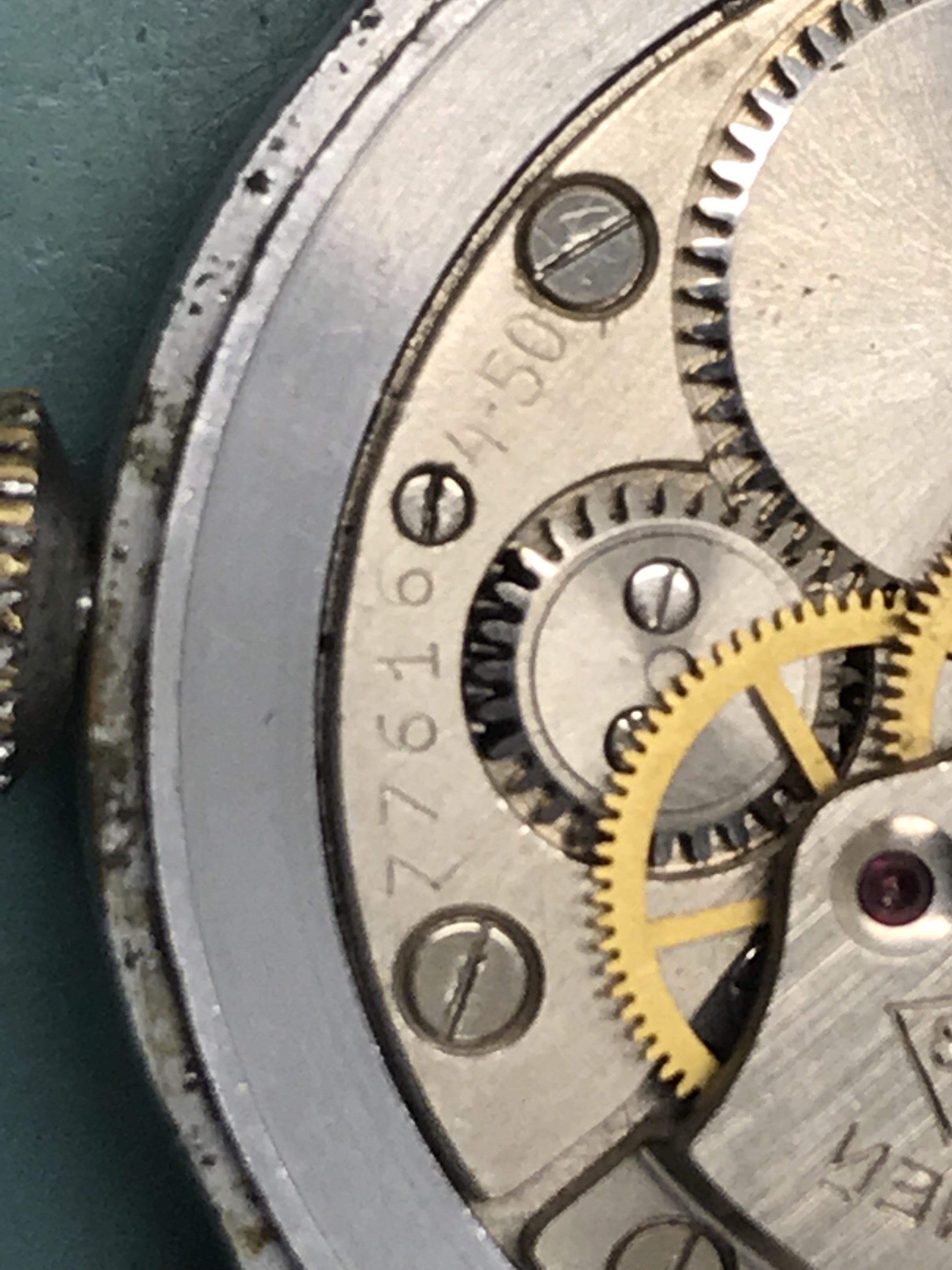

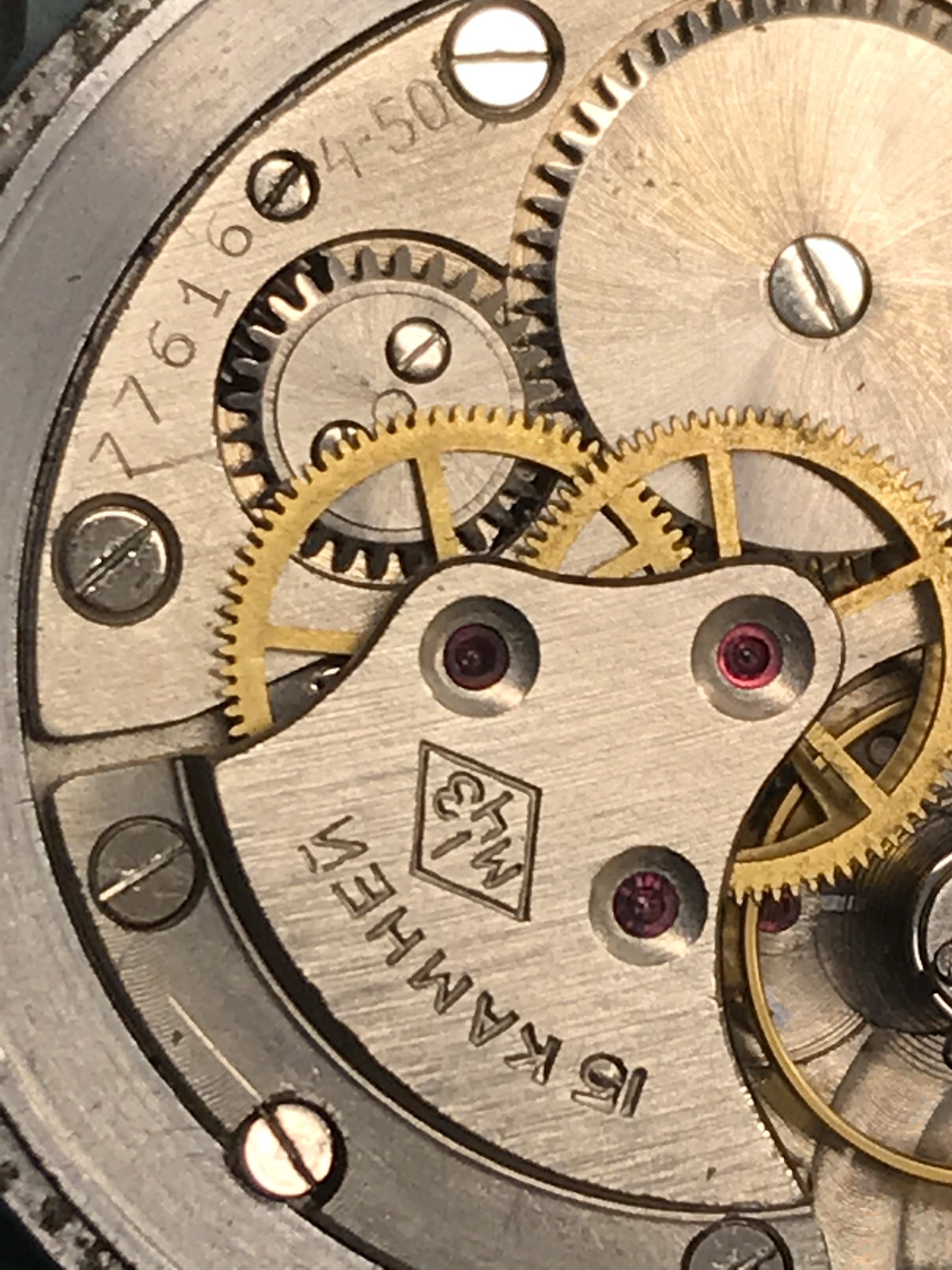

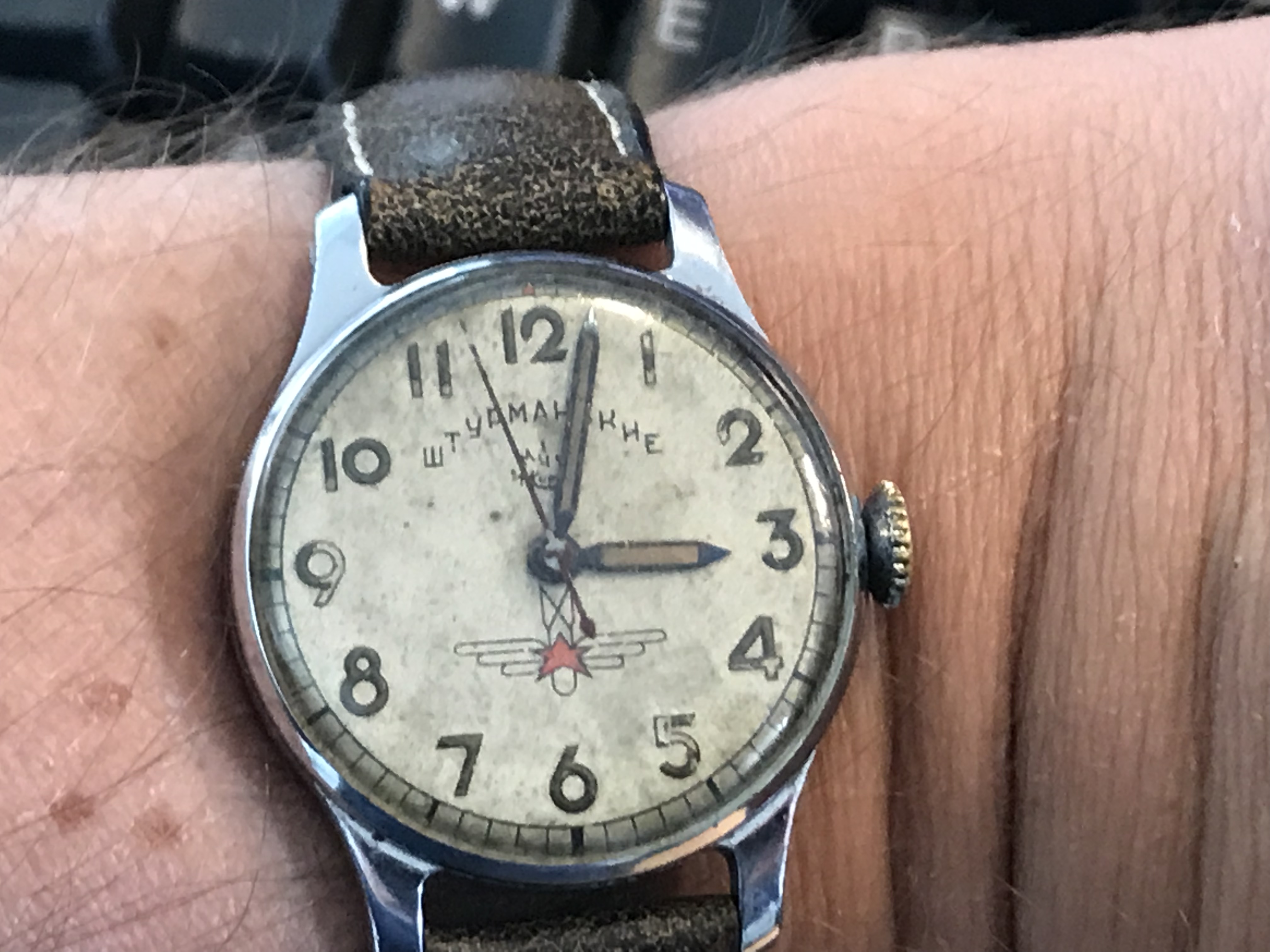

414
609

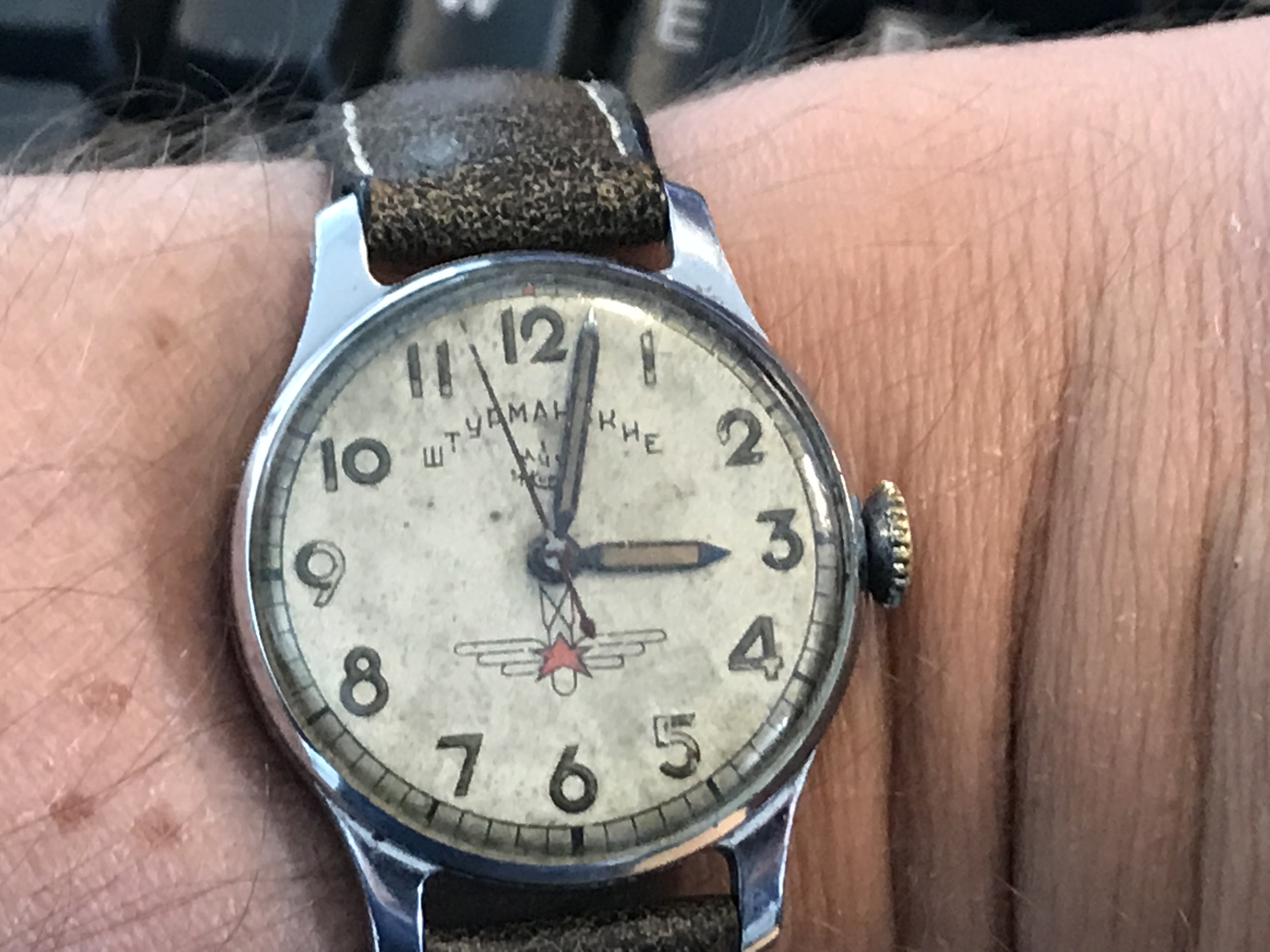

I bought this Sturmanskie on an auction 2 years ago. What do you say? Is it original or is it one of the many fake ones?
and - do any of you know if this is the model that Gargarin had on his wrist during his space travel?
Thanks.
4,857
12,283
Thanks.
I believe he had the 17J version, see the links I posted in the recent thread on Soviet watches. There also seems to be conflicting information, I recall (but can't find the source) reading that there was debate about the exact model he wore.
4,857
12,283
Thanks.
According to this link (originally provided by @Foo2rama ) it passes all the tests except lacks the polish stripped pattern (Geneva) on the movement.
EDIT: Here is the link: https://forums.watchuseek.com/f54/s...el-sturmanskie-tammo-23013.html#/topics/23013
Typical new style and civilian chrono, late or post soviet. Not a military one.
