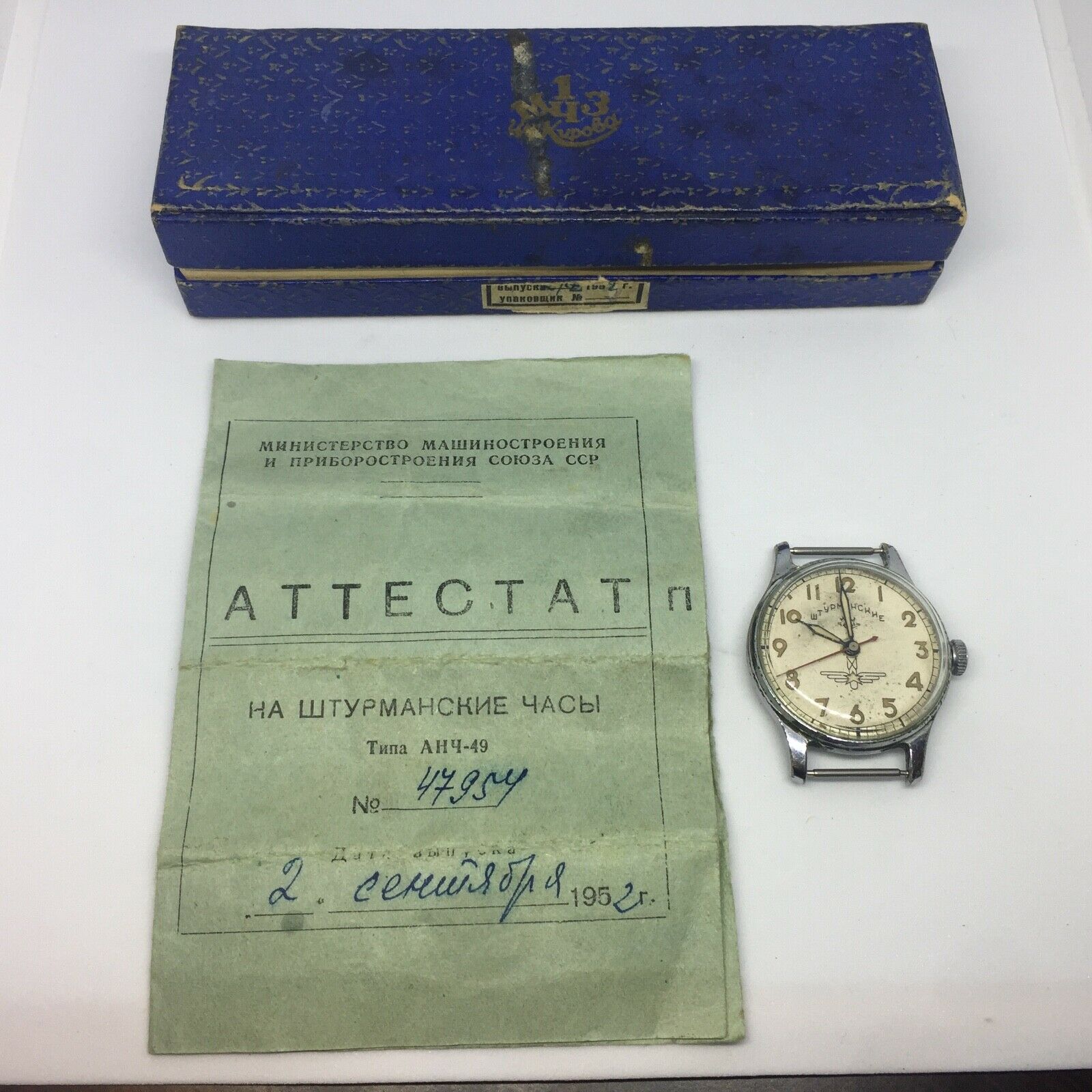

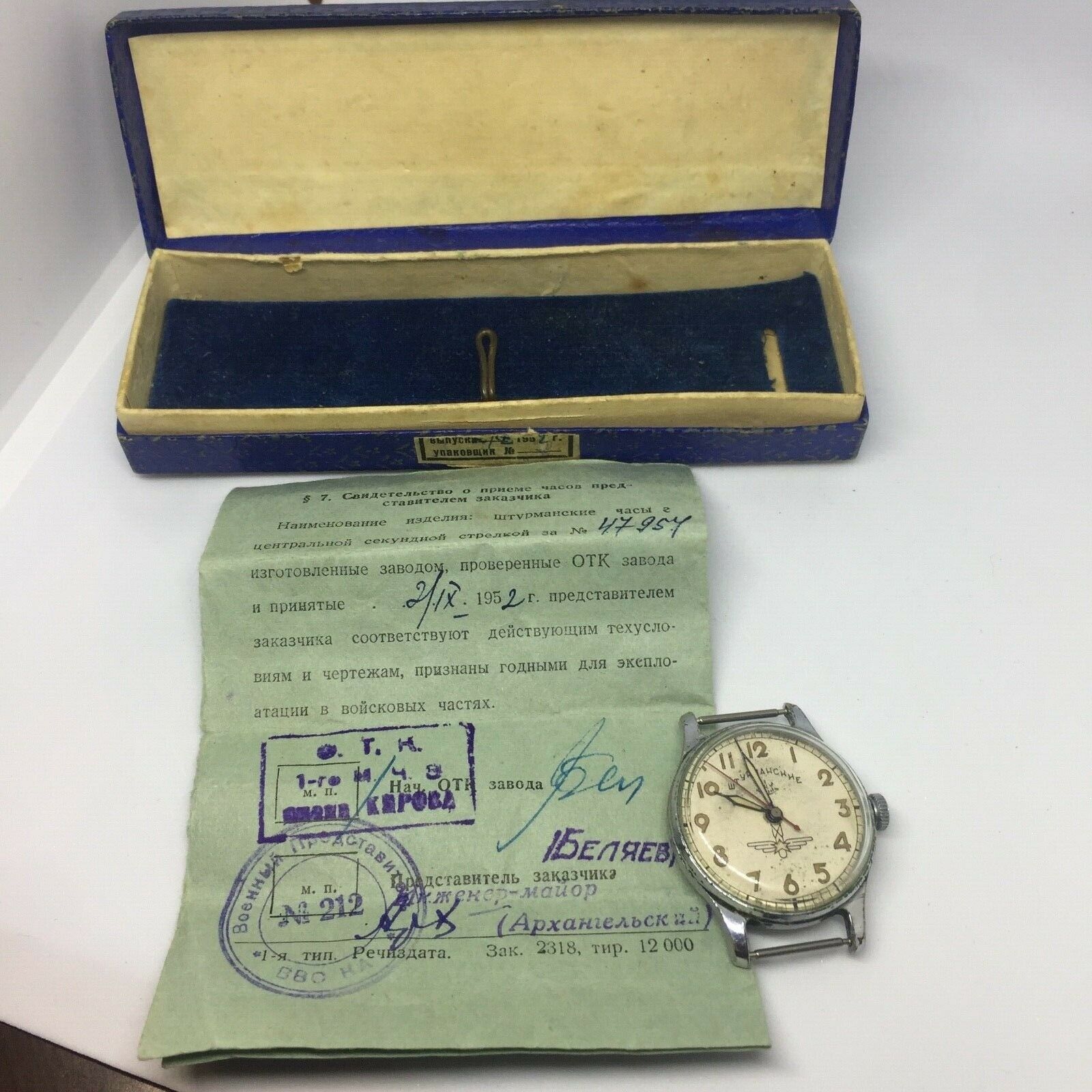

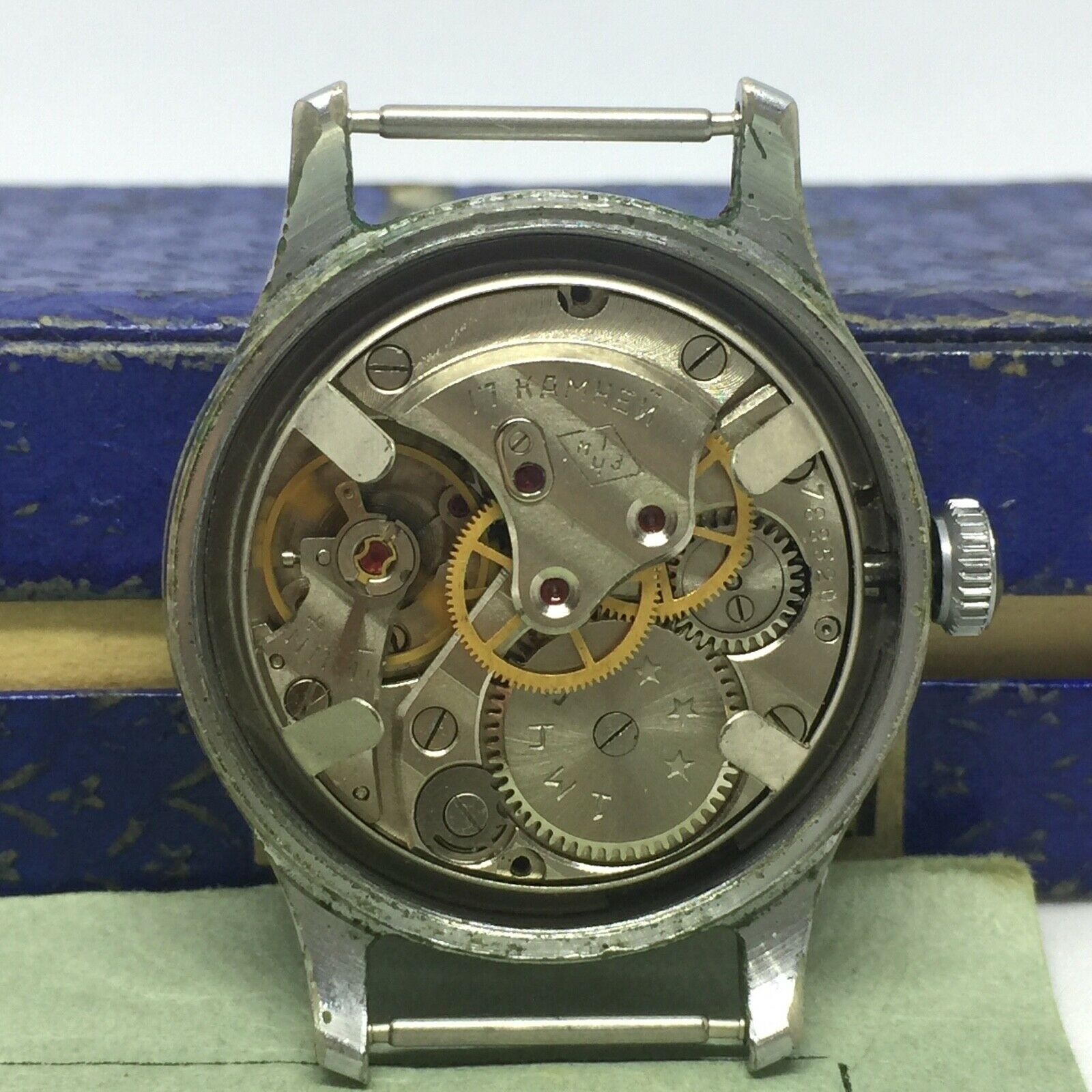

Hi everyone,
Since I got my Speedmaster Moonwatch I've been into collecting space watches. I'm too broke to afford a 321 Speedy right now, so I'm eyeballing a genuine Sturmanskie. After some initially research I found out that Gagarin most likely wore a Sturmanskie 17j (33mm) on his first space flight. Still according to my research, the 17j was produced from 1954 to early 1960's.
I found a "full set" Sturmanskie on the bay for US$850, however I have doubt about the legitimacy of the box and paper. The paper is dated from 1952 - 2 years prior the 17j - and the paper number doesn't match the movement number. The watch looks genuine on the other hand. So here are my questions:
1) Can you confirm this is not a full set, but rather a repackaged unit?
2) This listing has been on eBay for couple months now, what price would you recommend for this (with/without box/paper)?
3) Any other remarks/observations?
I'm new to vintage watches so thanks for your help!

The box and "passport " look genuine to me but they don't match the watch. The watch looks genuine but the crown is a later replacement. I don't think its worth the asking price.
Thanks, that's the kind of feedback I was looking for. I suspected the paper must have been from a 15 jewel Sturmanskie. And now that you mention it, I can see how the crown looks much more recent than the case itself. I will pass then.

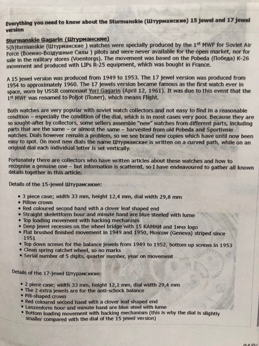

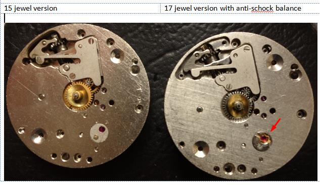

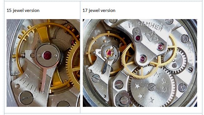

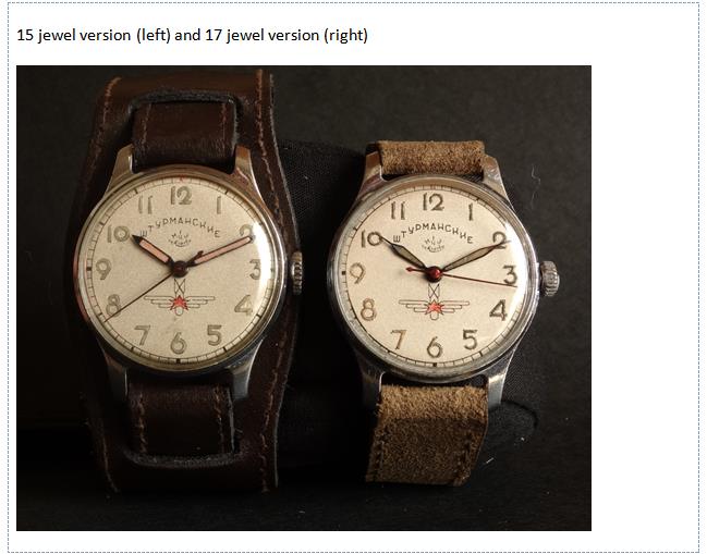

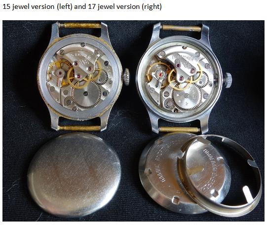

I did some research on Sturmanskies a few years ago and here's what I found. I see from these pics that I may have been wrong about the crown, but the one in your pic does look much newer than the rest of the case.
102
162
That's one of the article I came across. Still a very good source of information nonetheless and thanks for sharing it here! From the picture the movement and the dial/hands seem correct at least.

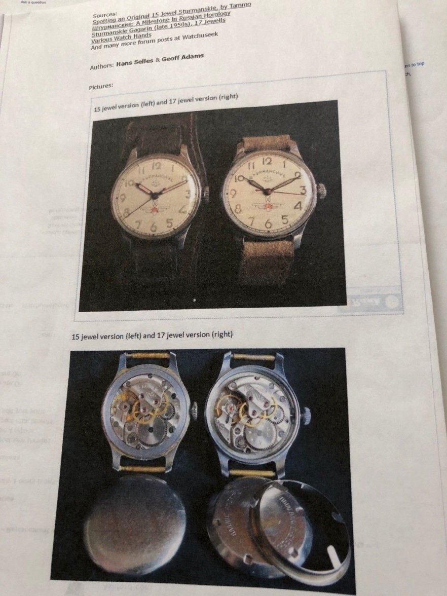

Many thanks for the useful information, GordonL, especially the page with comparison of the two types. I was wondering if the description of type-2 was continuing on the second page of the document you attached. Could you, please, check that? Thanks!

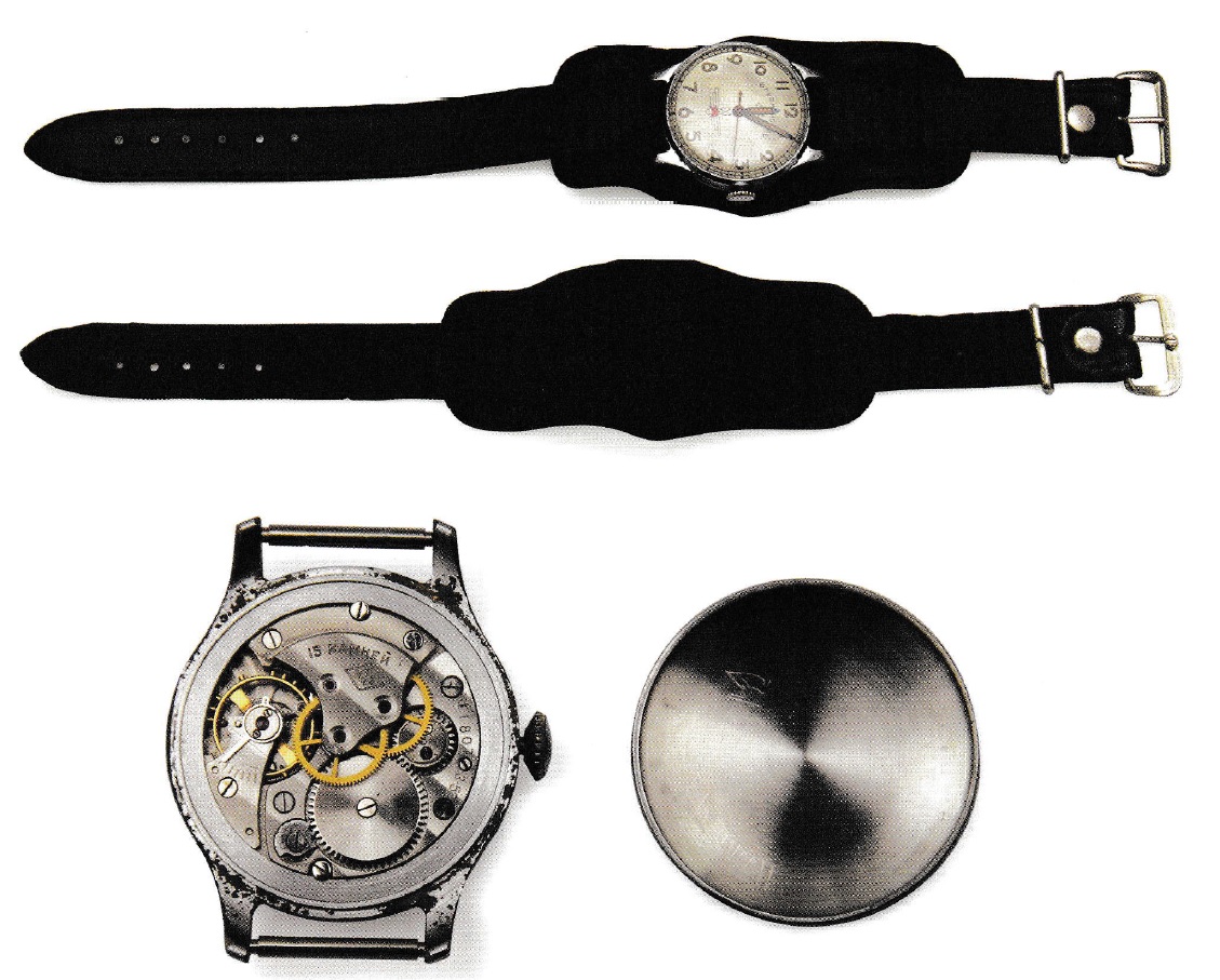

I am sorry - here is page 2. I'm not sure why I didn't post this the first time!
