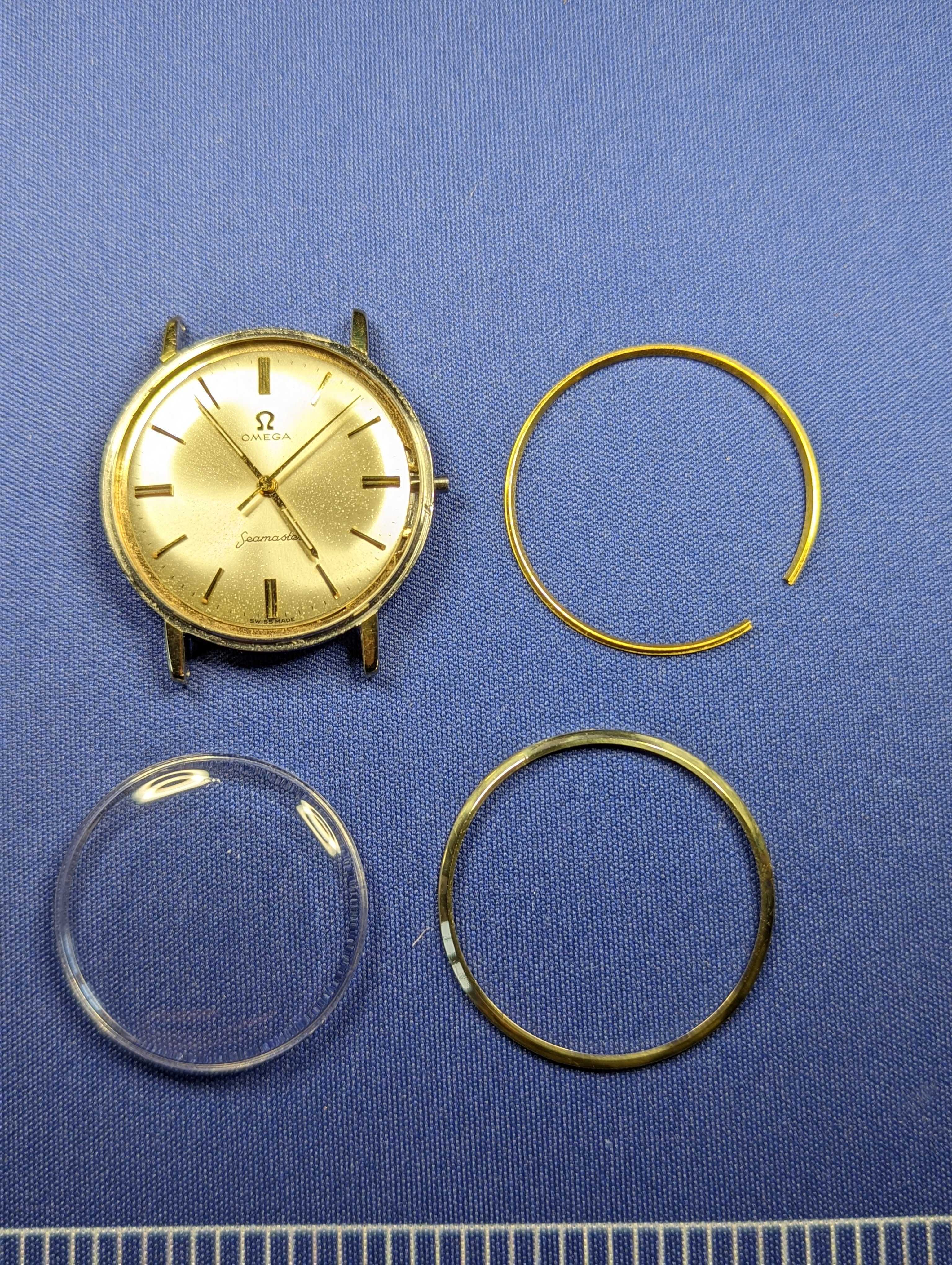

Hi Everyone,
I'm rebuilding my Seamaster 14750 case and cannot for the life of me get the small gold bezel to fit the new crystal.
I've read this should almost be a push/snap fit but only seem to be able to get one side on, then the other would need the force of Thor to fit.
I have a crystal lift and a cheap glass/case press. I don't think the case press die's have a large enough recess to work and have read that some people use the lifter to fit the bezel but have found nothing in the way of instructions for this method?
(Watch Repair Channel on YouTube has a video but he seems to use a Robur glass press and it just easily pop's on).
Any advice, links or info would be really help?

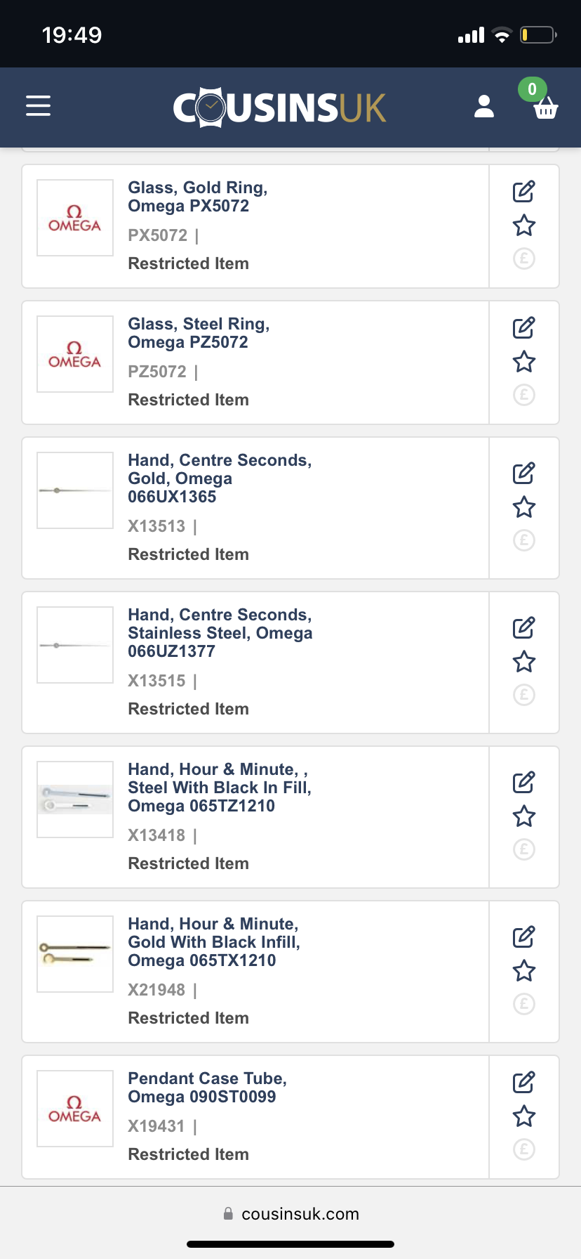

Do you definitely have the right crystal - px5072? Cousins is showing out of stock.
55
53
I believe so, they only had the one when i ordered. Assuming the gold/steel are the same that is?

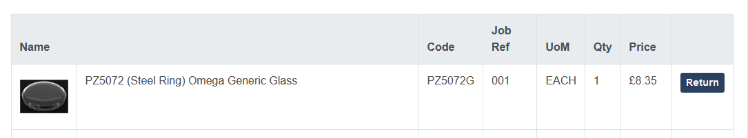

Ah so that’s not an Omega crystal, it’s a generic replacement.
That said, if you can’t get the bezel and original crystal back on it suggests operator error. I’ve never had problem with a genuine crystal or refitting an existing. I’ve done it before with the lid of a calpol bottle.
Whatever you do, don’t break the bezel. You won’t find another.

Arh i had assumed that with the same part number and genuine omega packing/mark in the centre of the crystal it was the correct one? EDIT- my dyselxic brain has just noticed the G in my code number, d`oh!

I just took one apart and put it back together with gloved fingers. It feels like you're going to break something, but I never have. BTW, correct stepped generic crystal. I always press the crystal down onto the bezel. The step in the crystal is what is holding the bezel on.
792
845
I just want to echo what was mentioned above. In my experience, these don't need too much effort to install and I only use a press when pressing the bezel back into place with the crystal.
1) place the crystal into the bezel
2) insert the tension ring into the crystal
3) align and press the crystal/bezel into the case
If your watch originally had the correct crystal, then reuse the original tension ring. They usually fit better than the generic tension rings. I've had issues with generic tension rings fitting on more than one occasion.

Hmmm yeah i THOUGHT it should be push fit too (everything ive read and seen it's push fit lol).
I'm reusing the old tension ring, that fits like a glove and both crystals fit into the case like a glove so now i'm wondering if there's something off on the bezel maybe. The new glass doesnt have the outter step but even the old glass wont seat with the bezel.
i'm going to triple check the bezel is true now...

You do need to push equally around the perimeter of the bezel. Ie you cannot push it completely down at the 9 o’clock side, then push the 3 o’clock side down.
Pressure should be applied in a uniform manner so the entire bezel engages at once and remains parallel to the top surface of the case throughout
Arh yeah so getting it in by hands alone would be tricky Vs using the press then i persume. I'll see if i can get a die to fit (the slightly domed glass is too tall for my cheap ass newbie press!)

No I mean the case. The bezel/crystal assembly should be placed flat on the case so it’s parallel. Apply pressure evenly so the bezel depresses in a uniform manner so it’s always parallel to the case (I.e. there isn’t more pressure applied to one side of the bezel so that area depresses quicker, leaving the bezel at a slight angle compared to the case)
55
53
Arh right, yeah that part ive done a fair few times on quite a few different watches. What i'm struggling to do is fit the bezel to the crystal itself. (assuming you fit this, then apply the bezel/crystal "assembly" to the watch).
