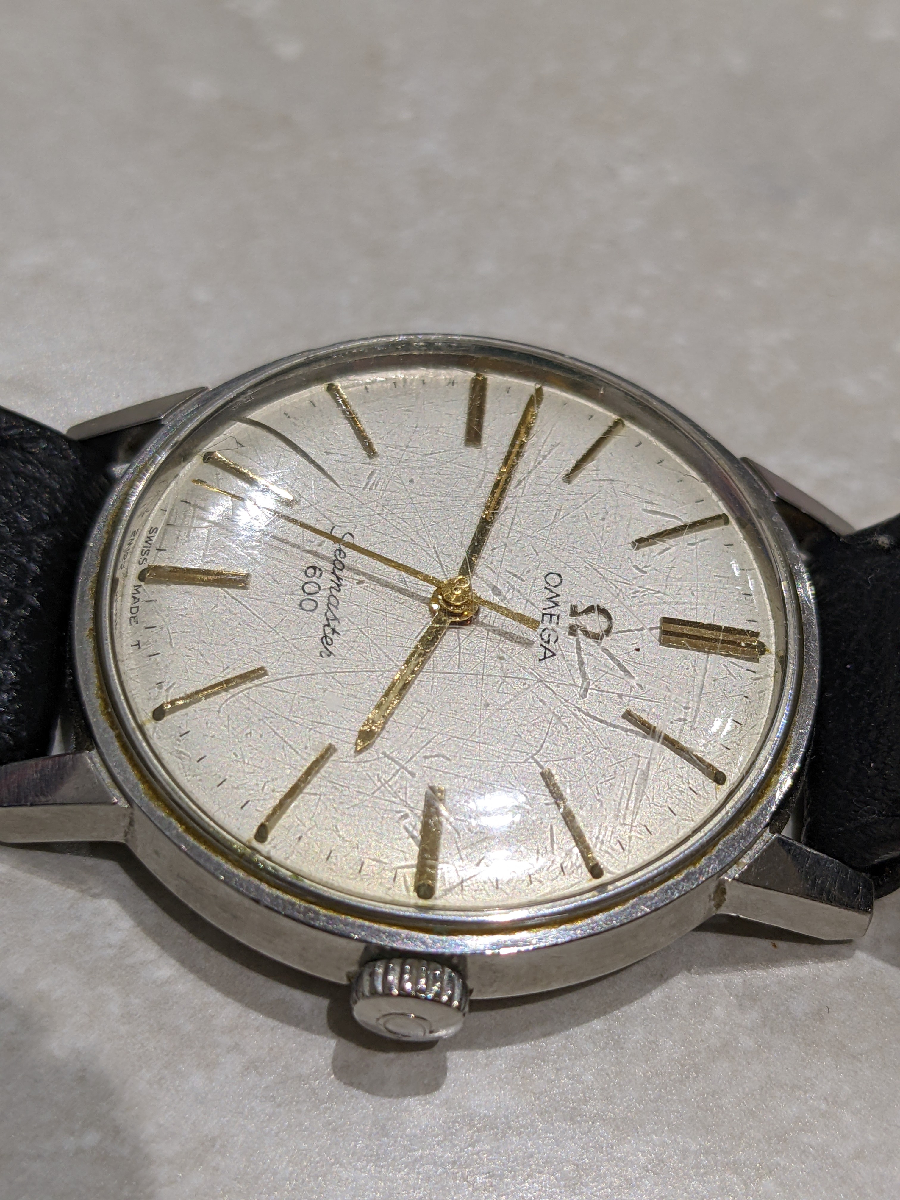

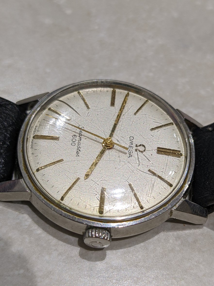

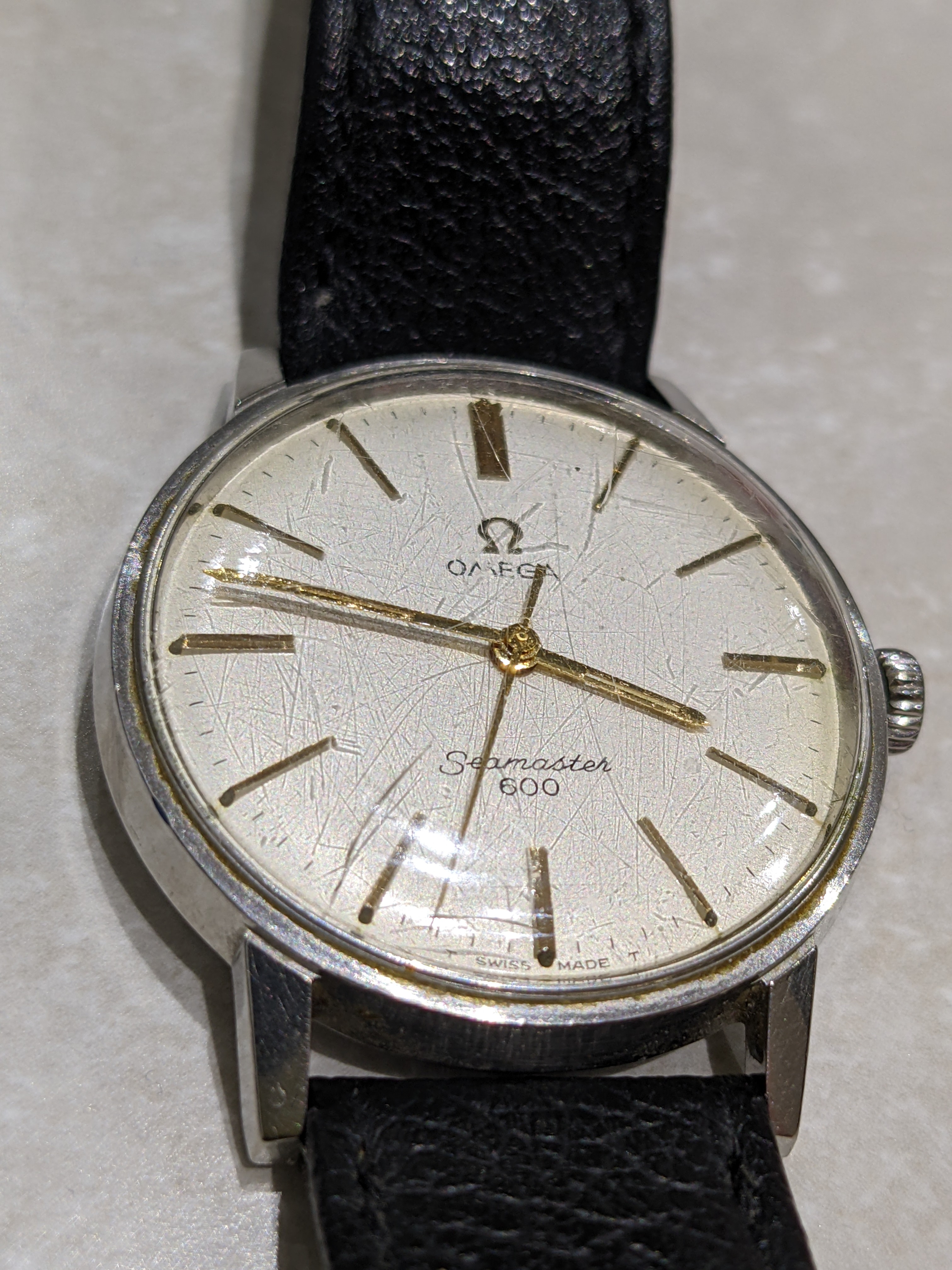

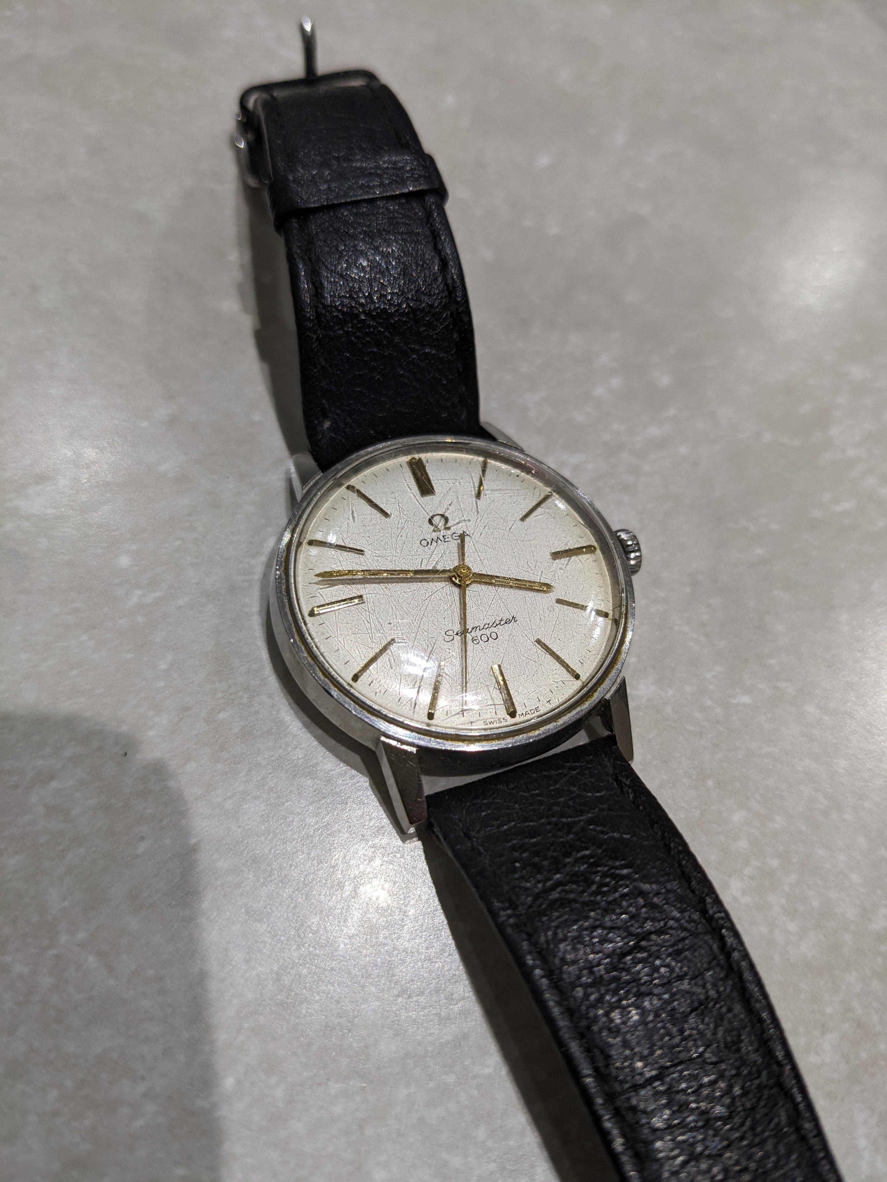

Hey folks,
First Post here.
I've inherited my dad's vintage Seamaster 600 purchased 1967 from Saudi Arabia.
Welcome any more information.
I'm interested in getting it serviced and in two minds about part exchange.
Any servicing tips? Do I need to go to a specialist, can I find them on most High Streets (I'm based in London)?
What would I expect to pay?
For part exchange, any good dealers worth talking to?
Its got a few scratches, and was wondering if its worth getting that repaired or replaced?
Thank you in advance

What do you mean by part exchange? To me, the watch looks fine, and just needs a movement service and a crystal polish or replacement. To find recommendations for servicing, try the search function. There are many threads on the topic.

This sure looks like it’ll clean up nicely! You won’t believe what difference a cleaned case and a new / polished plexi will make!

Those edges look nice and sharp. I would instruct them to not polish the case.

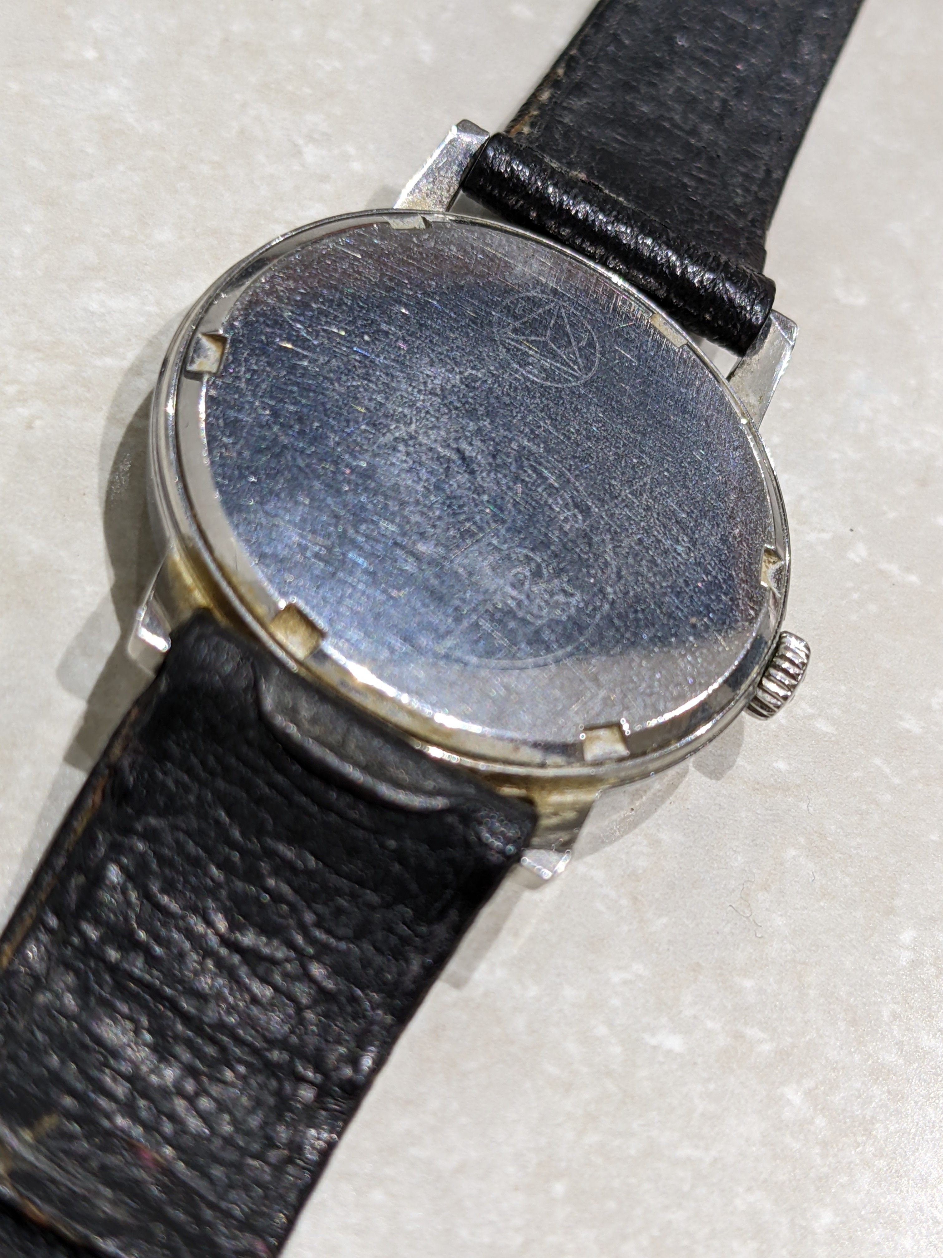

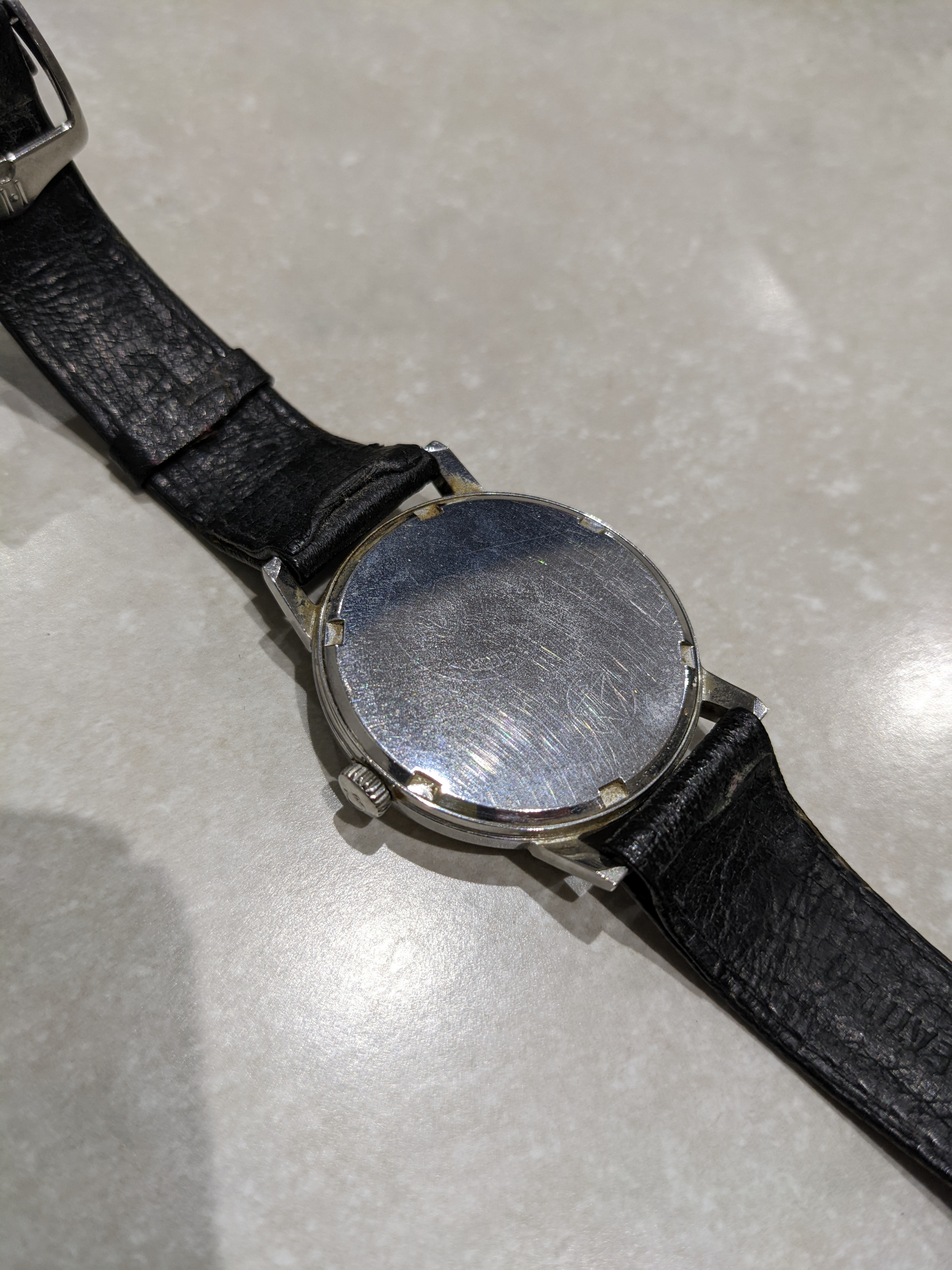

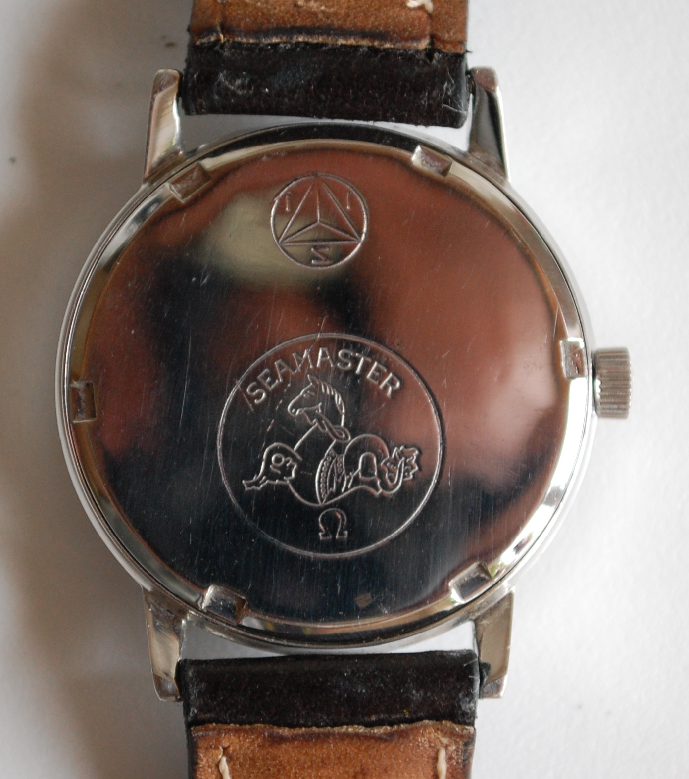

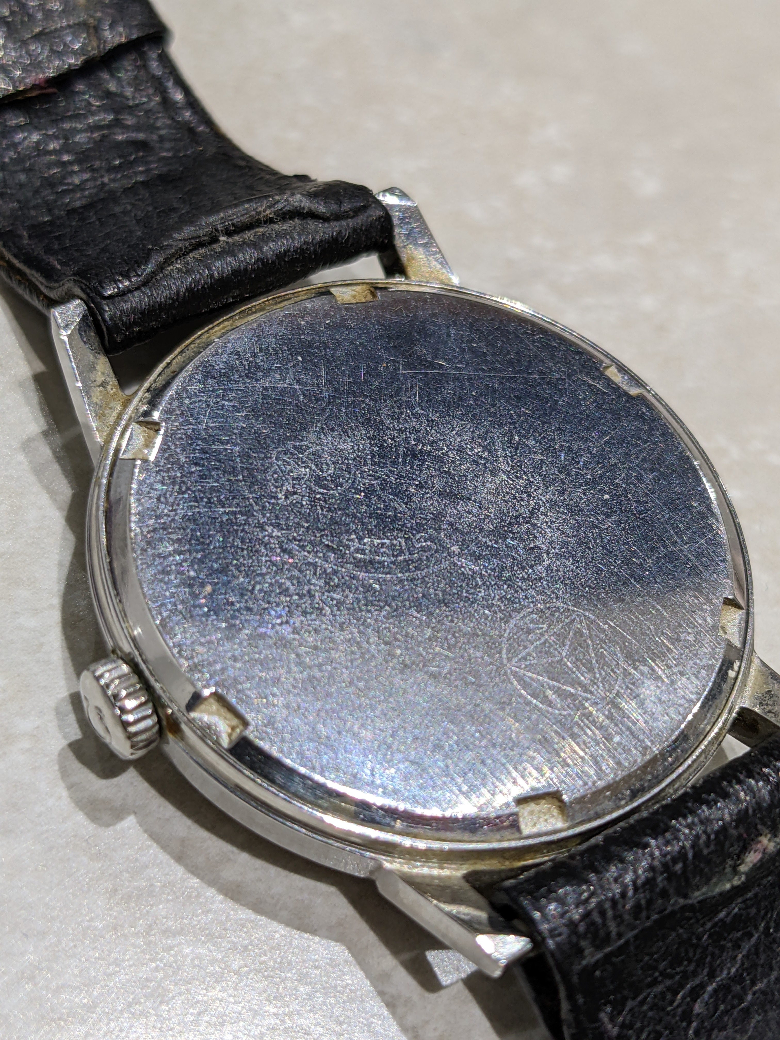

Did he buy it new in 1967? Curiously, it seems to have the engraving for the Afghan Air Force on the back. Rare piece.
Here is another example:
I concur with others. All it needs is a service and they shouldn’t touch the case. The dial looks nice and a crystal polish should really bring it out.

Welcome, great family piece.
As already noted, this should clean up nicely with minimal effort.

In the UK Simon F, WatchGuy and Mitka are all solid.
If you want a no expense spared service, with a company that has an Omega parts account consider Swiss Time Services.

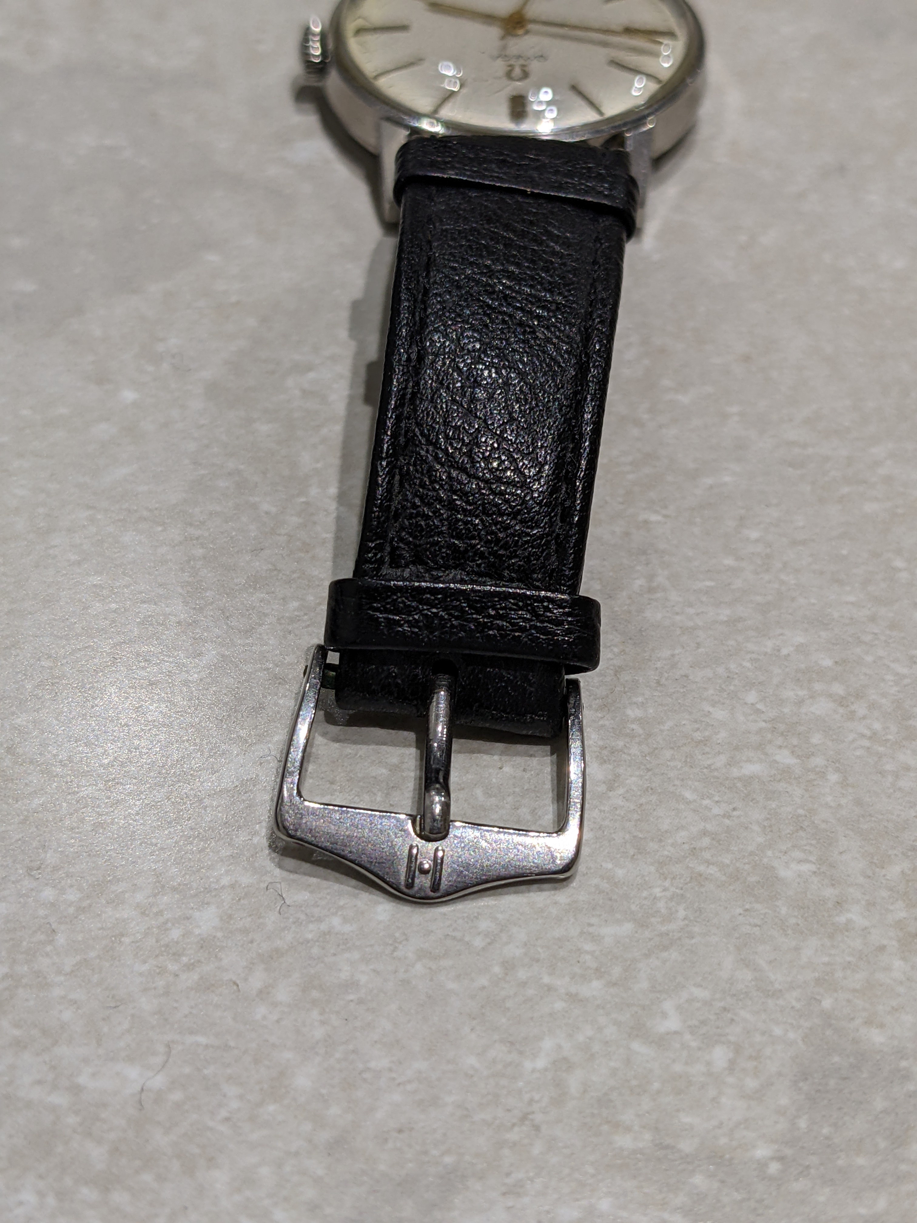

That will clean up wonderfully though. You can use polywatch (or even autosol or toothpaste!) yourself to get that c dry strap looking better in ten mins.

Wow! thank you for this. Yep purchased new in 1967.... Ironically my father is from Afghanistan / Pakistan. I'd have to find out more info next time i speak to him.

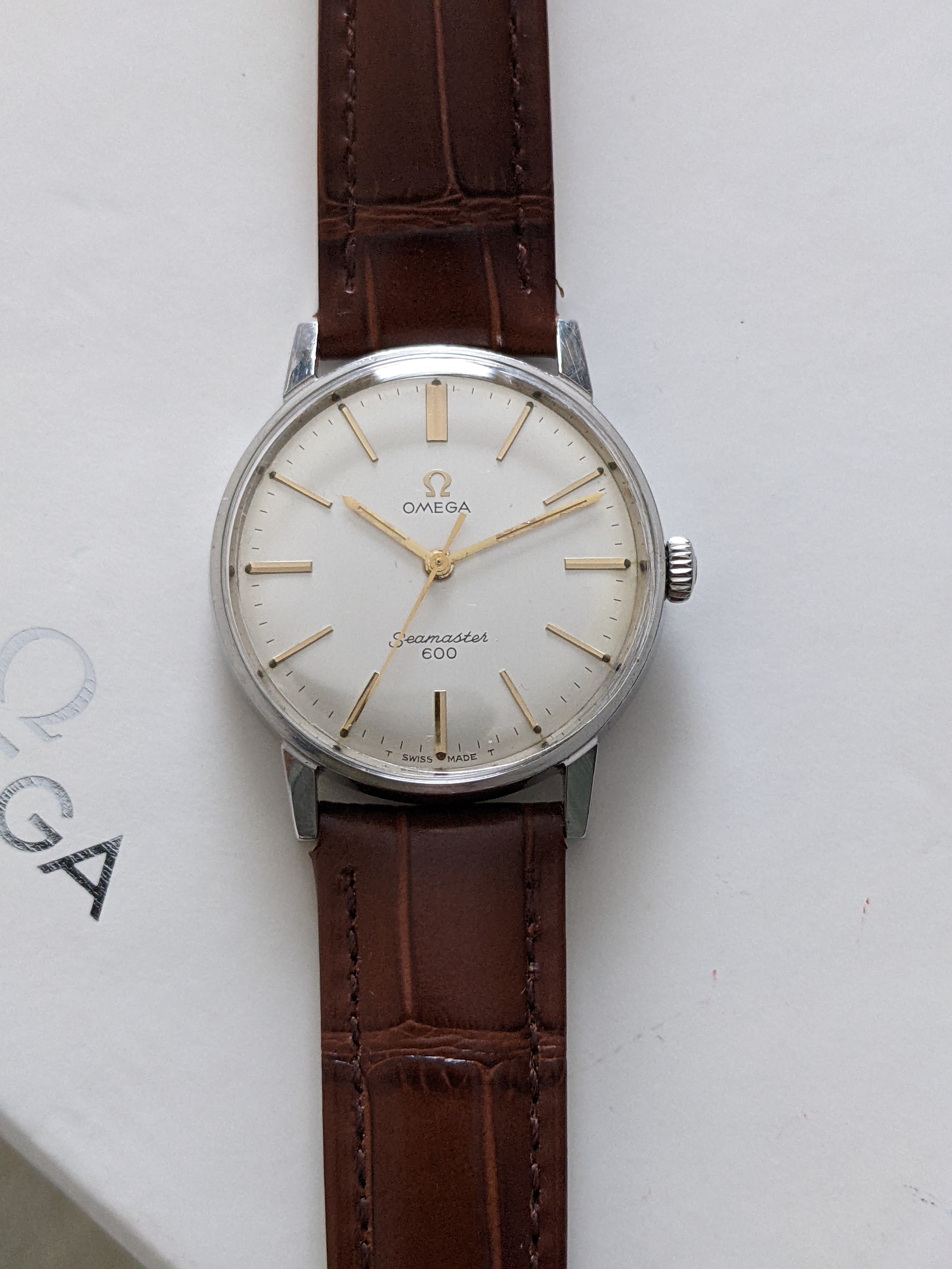

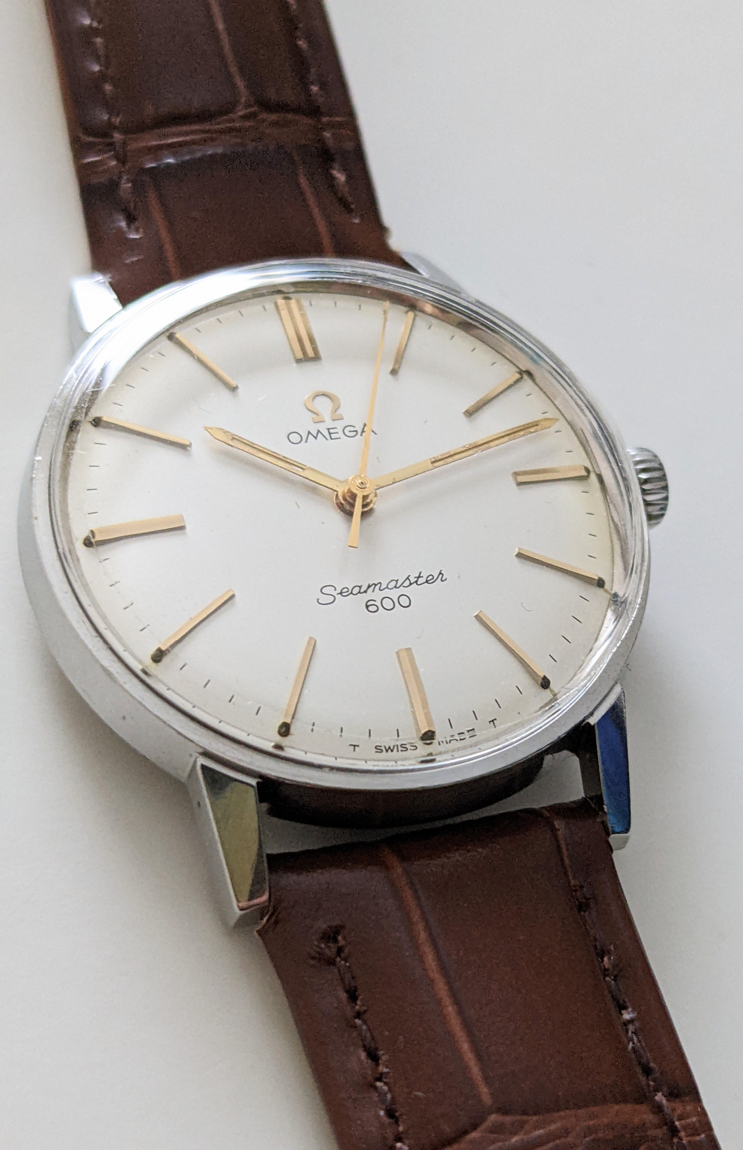

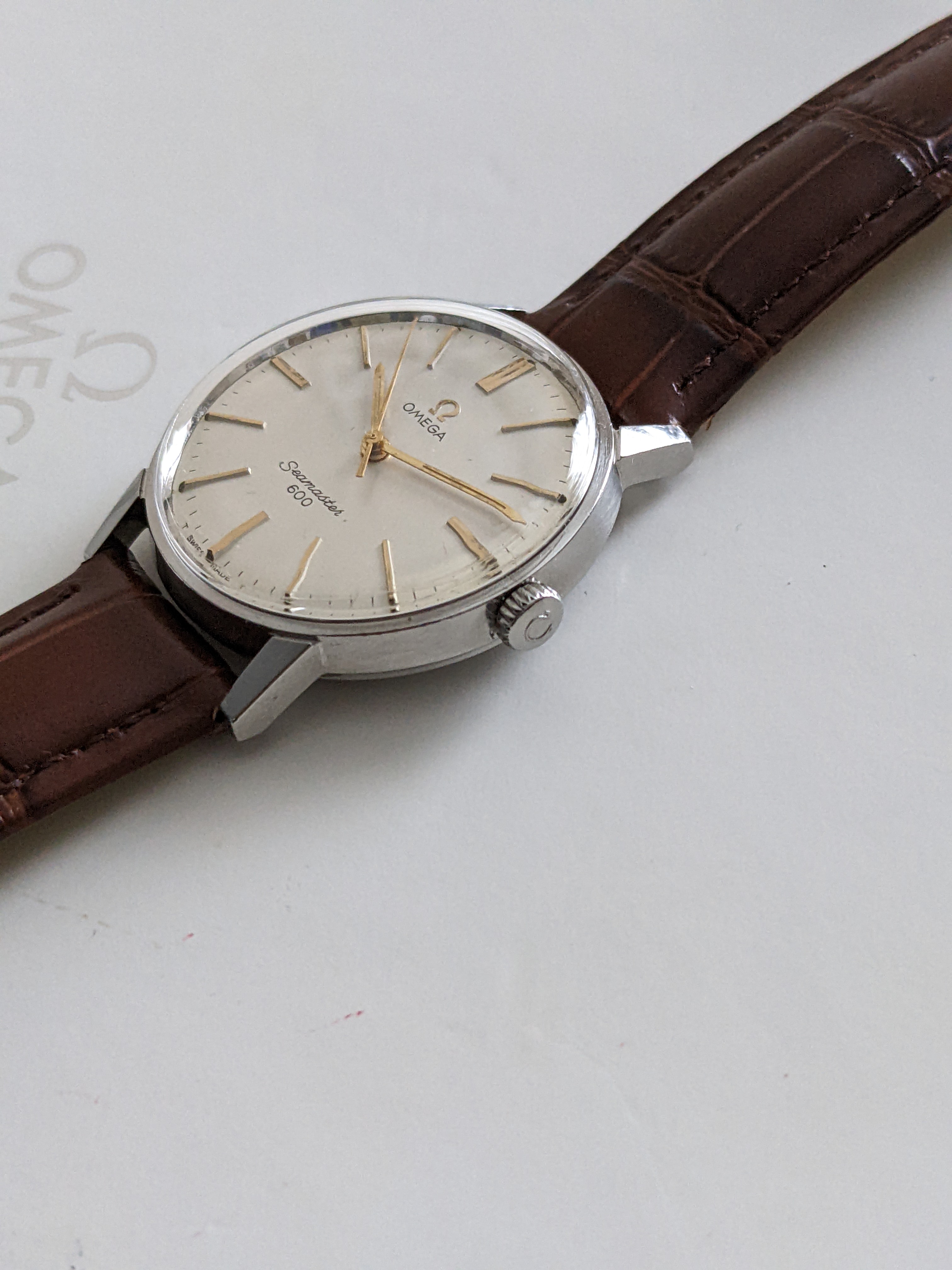

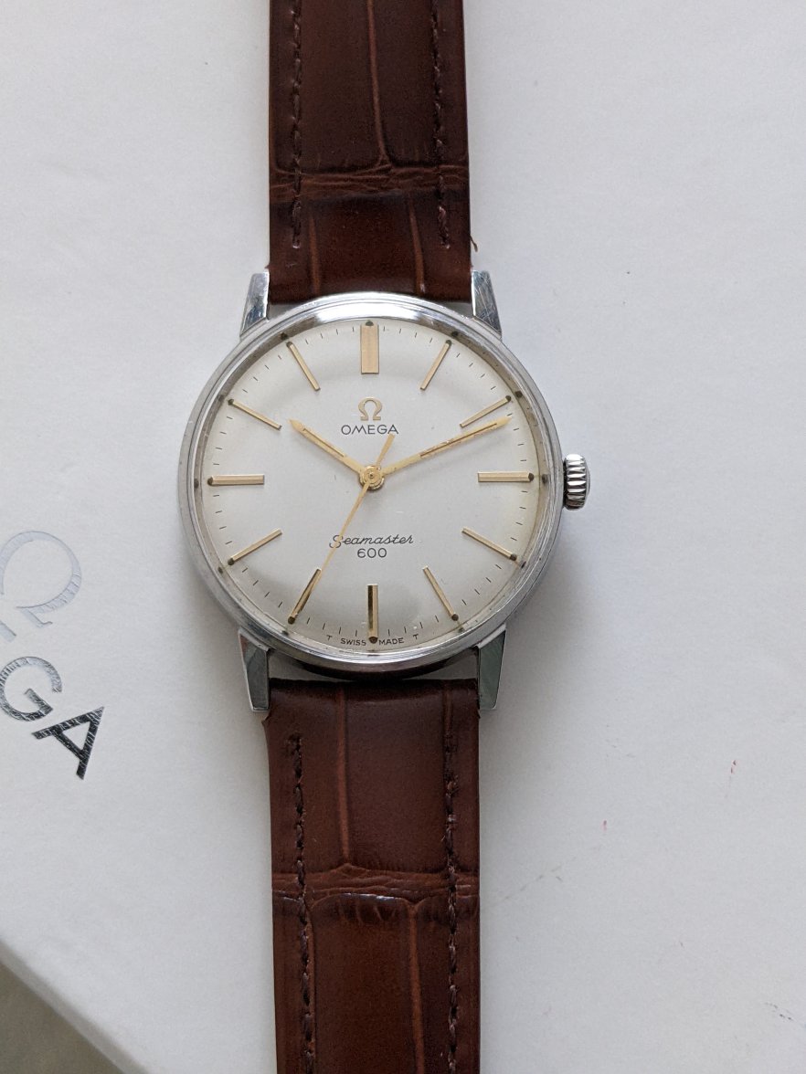

Hey Folks thank you all for tips and insights... I've managed to get the watch serviced, crystal replaced with original version [the old one was cracked unfortunately - but I've kept it]. Its come back looking pretty good, ticking nicely.
I only saw comments about not polishing the case later, hope it's still okay ;-)

Looks very nice, and if the watchmaker did polish it, they did it with a delicate touch- which is what we would hope for. You don’t want it coming back looking melted butter.

Yep heard horror stories about over polished.... Thank you for the feedback, that's great to know...

It’s really shame when it happens as you can’t put the material back on. Some of the early 70’s Omegas had multiple case finishes, sunburst brushed on top, horizontal brushing on the sides and sharp crisp highly polished bevels. These finishes catch the sunlight and sparkle. Once you hit those with a polishing wheel- all those crisp edges are gone, brushing softened and dulled- you lose the whole point of watch design.

Agree, that detail to the direction of finish is key. I've noticed the engravings on the back on my watch are quite faint / not as deep as other examples out there.... I don't think my dad had the back polished... is this variation something that happens when it was engraved with less pressure?

It may have been polished to get scratches out if it had been serviced earlier in its life. If it had a brushed finish, it could have been re-brushed. Some engravings weren’t as deep as others but if they are very faint- most likely some of the material has been taken down.
Not until the last couple decades did watch owners really pay attention to this. It was SOP for a watchmaker to refinish a case during service to make a watch look “like new”- most customers expected that. Some would even repaint the dial if there was moisture damage and many times the customer didn’t consent to it, and possibly didn’t even notice or were pleased with the fresh looking appearance. We regularly see dials with incorrect fonts, text placement, wonky minute track placement and sometimes even misspellings! None of this was done in malice or in an attempt to deceive- the trade and customer’s expectations were just different then.
Many older watch makers still don’t consider the job done unless they have refinished the case- even when you tell them not to, they don’t understand why you wouldn’t want it polished to look shiny.
It took me several failed attempts to impress upon my watchmaker to do NOTHING to the case other than scrub it with soap and water- he finally got it. But he’s told me that it’s expected by the jewelers he does spec work for to make every watch he services for them look like new.

Thanks, thats super useful... definitely quizzing my dad next time to find out more... hopefully he can remember. He did mention the last service was in the late 90s
